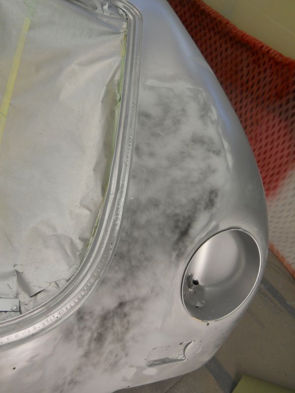

      So this is the area after recleaning and that Axalta builder primer applied with a guide coat fogged on. I felt really good about this repair but it needed to cure properly. The plan was to begin blocking after a couple of hours and then hopefully apply a coat of base. I still held no hope of that as that area is tough to shape smoothly especially trying to "free style" that edge without the hood there while you're at it.

      So needless to say we lost our window to finish the body so it would all have to be reprepped and shot again. It was a crying shame as it was so pretty but at least the fender repair could cure properly in the coming week while I reprepped everything. That's next. Thanks for reading this very sad tale. Justin

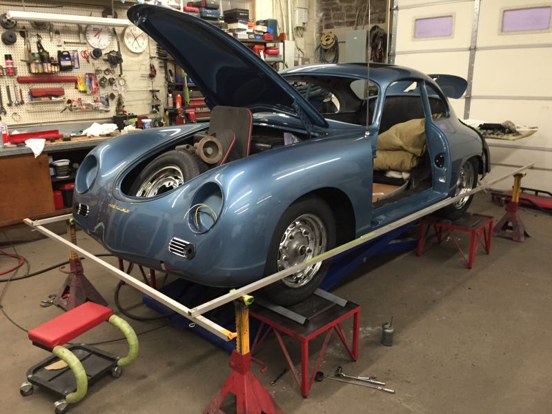

          Loaded for alignment.

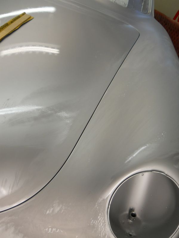

                  I gave this area an initial cut on Monday to open the primer to help ensure a thorough cure. By Tuesday afternoon I had it blocked back into shape and we had this area back in base color. A good heavy couple of coats of clear would go on next to give me enough material to block sand against the hood.

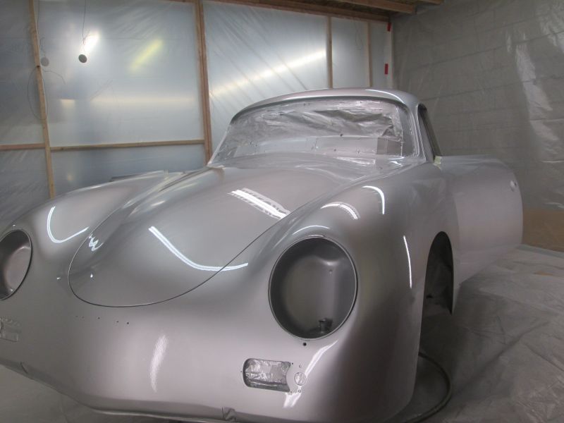

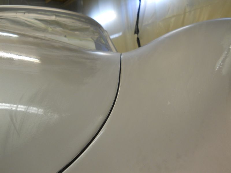

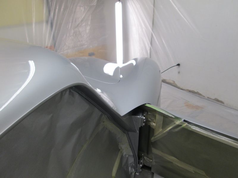

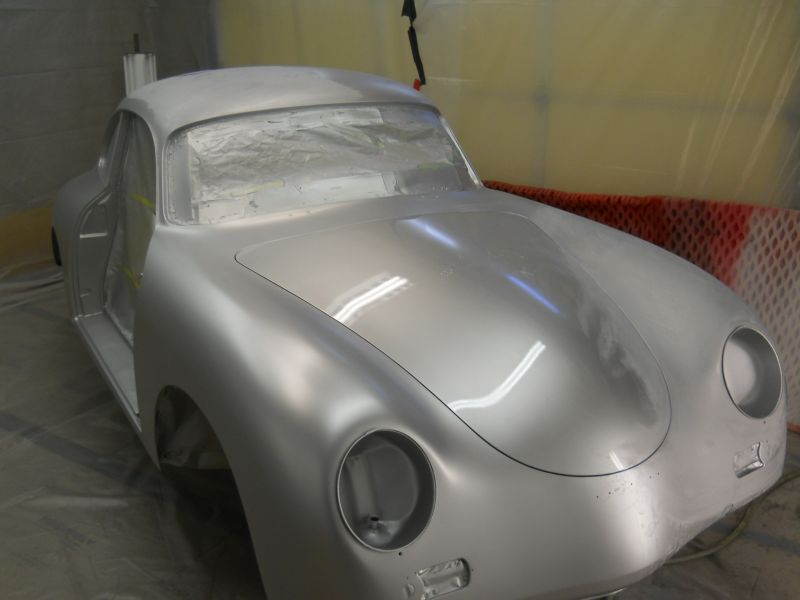

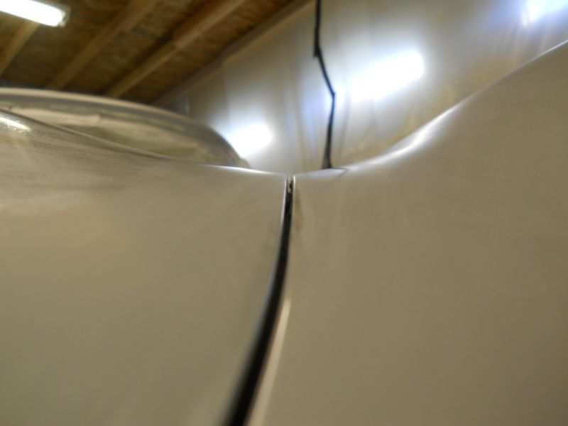

                  Hood was remounted with its seal and latched closed for a final shaping and blocking to ensure I had my lines back. By this time I had already decided (thanks to Bruce and Jack)that we would be painting the car as a whole.
                  Final shape leveling against the hood here.
                  I was pleasantly surprised to find that it really wasn't far off from where it originally was as far as the elevation with the hood went.
                  It was very relieving to see this area coming back.

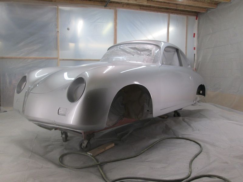

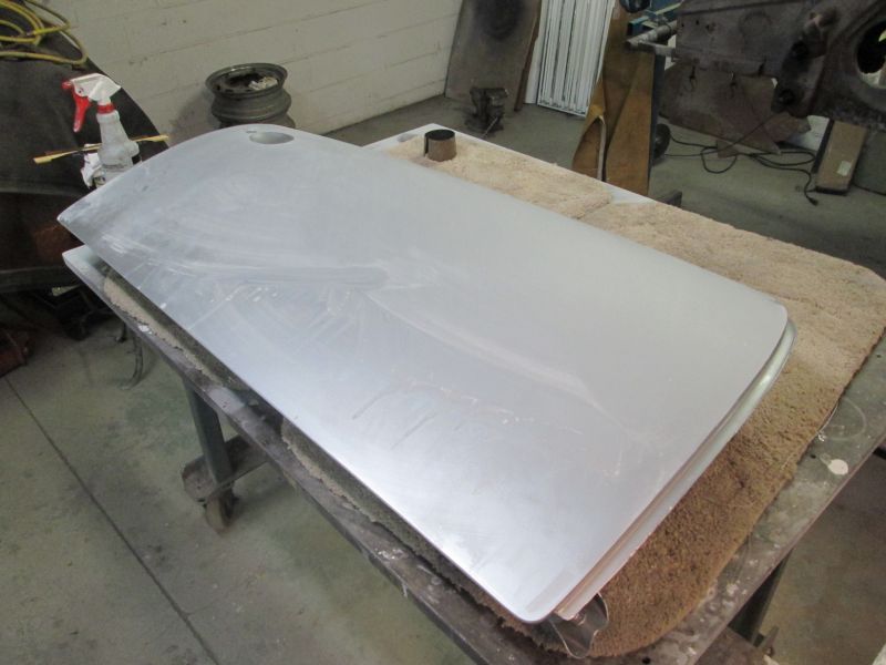

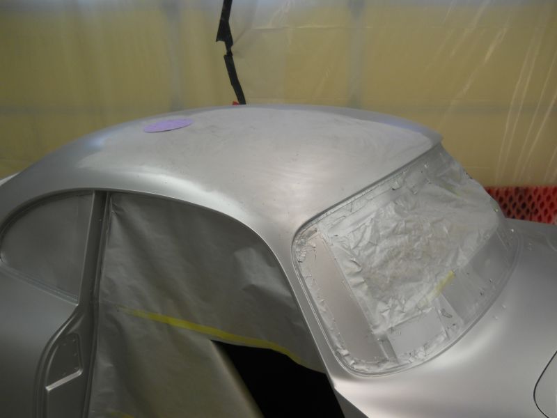

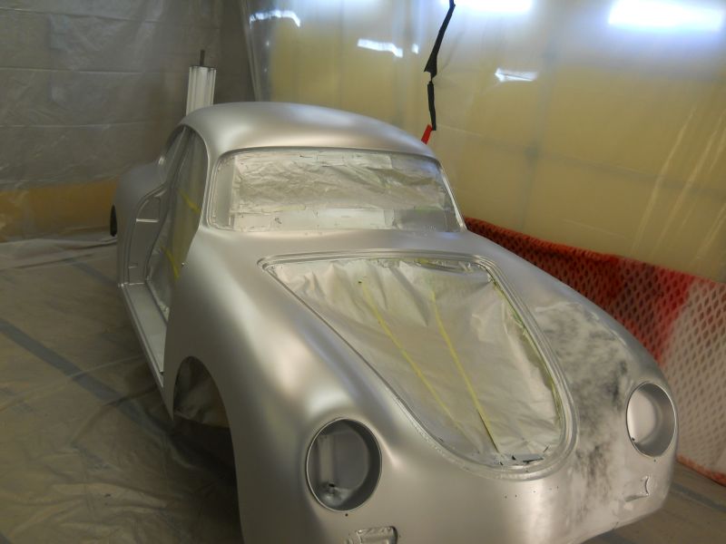

                  This is where I was at as of Wed. afternoon. I had a little more than a day and half to sand, remask, assemble and prep the booth.

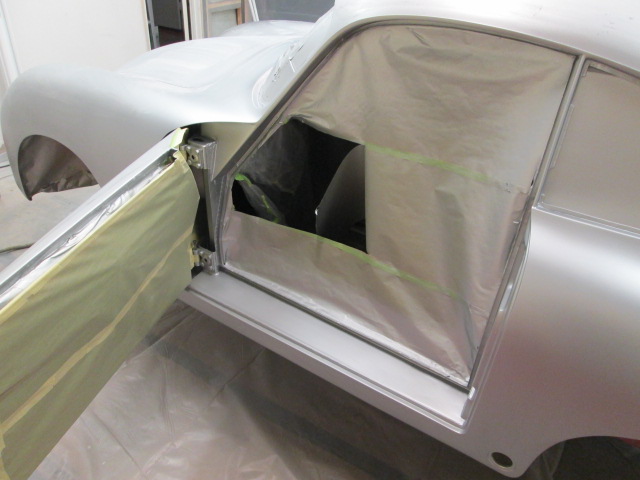

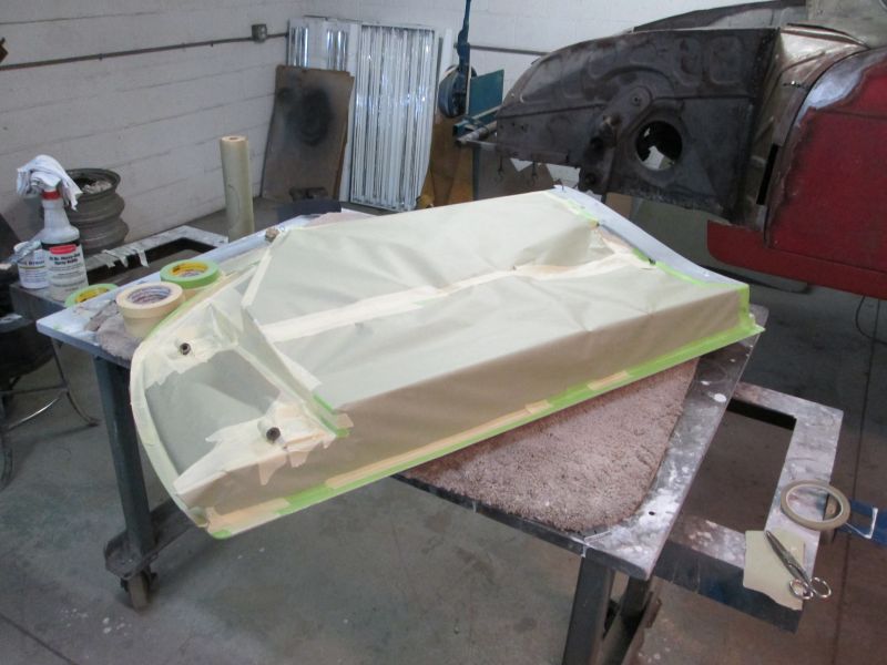

                  Thursday I prepped the closing panels at my shop. Block sanding the clear back down here. The first cut to this finish was painful. The 600 grit I was using felt like 40grit on the first several passes.

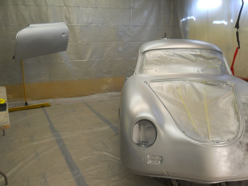

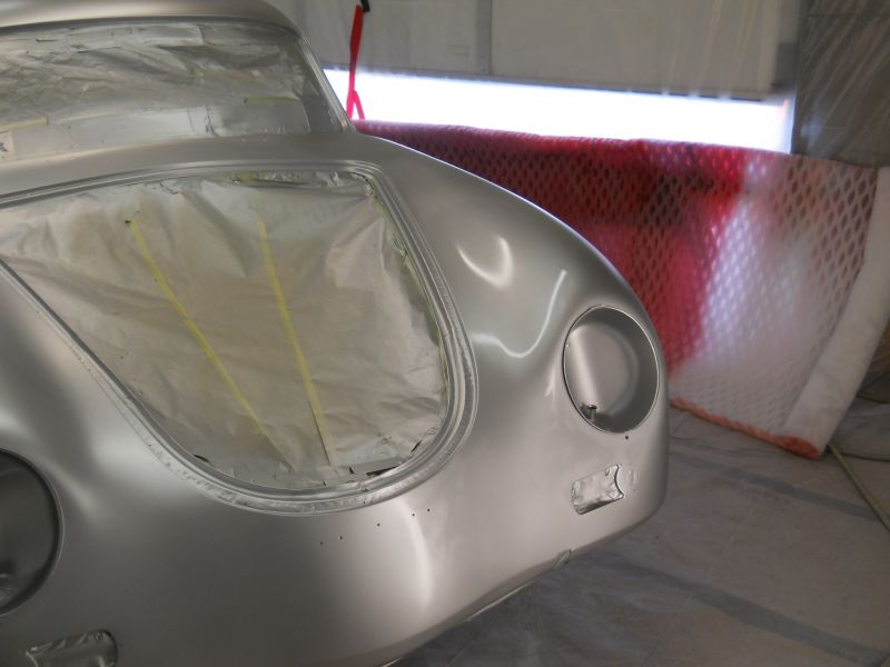

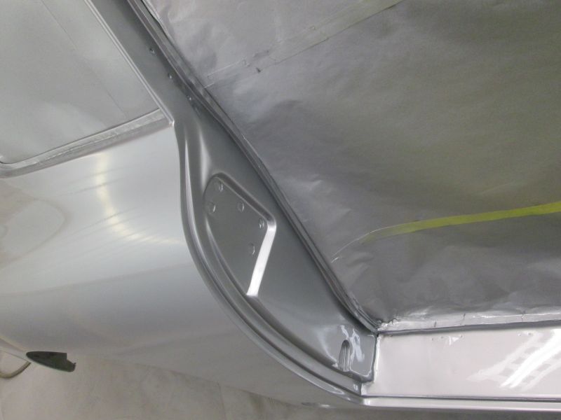

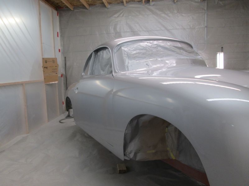

                  We weren't reshooting everything. Careful back masking of all the closing panel jambs and substructure in process here. This really ate up the time, I think it took me a little over an hour to do each door. The paper and tape had to be tight so it didn't touch the wet jambs as he opened and closed the door during the shoot.

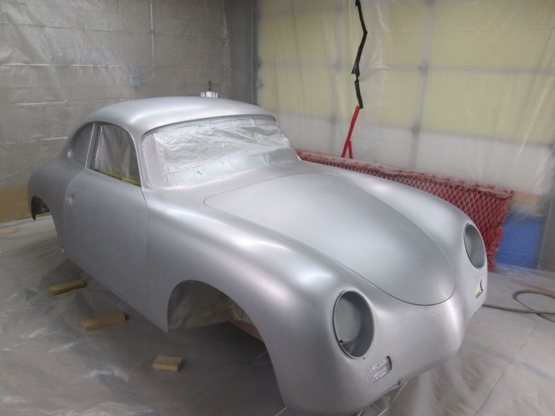

                  By mid Friday morning the car was staged with all closing panels mounted back-taped with just a few more loose ends to tie up.
                  Things like fixing the paper where I had to break in to remount the hood. All kinds of little shit that kept me running.

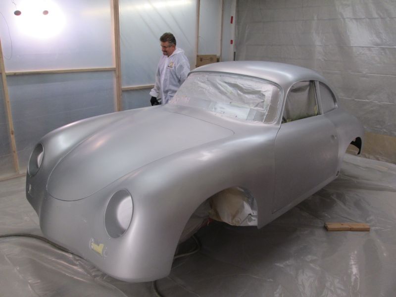

                  Just about ready for final wipe down here with Rick due at any minute.

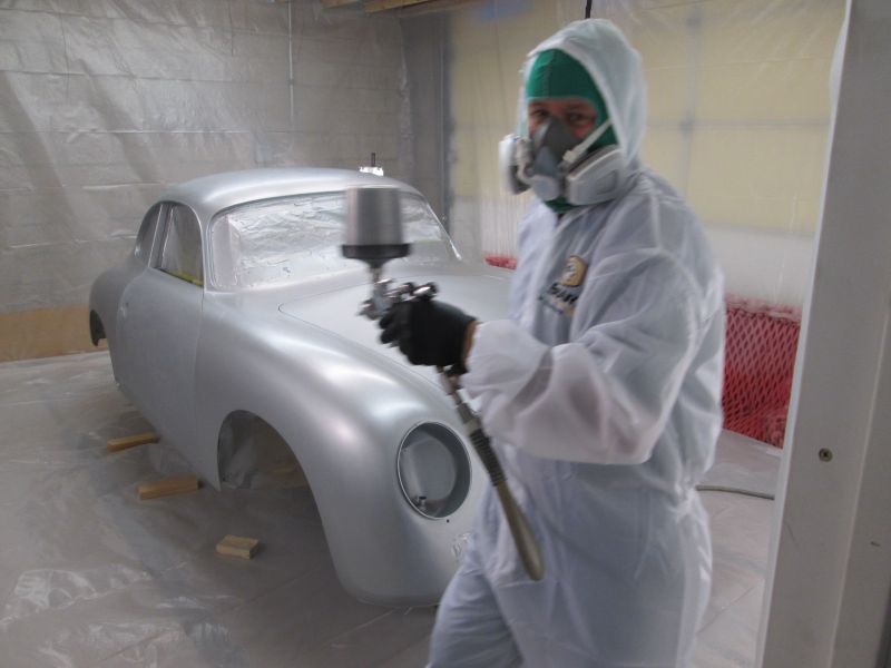

                  Rick all suited up and ready to give it another go.
                  "We dive at five...No muff too tough" was the last thing I heard.
                  Here goes nothing!

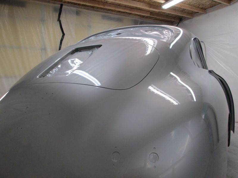

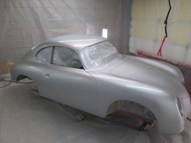

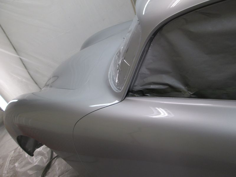

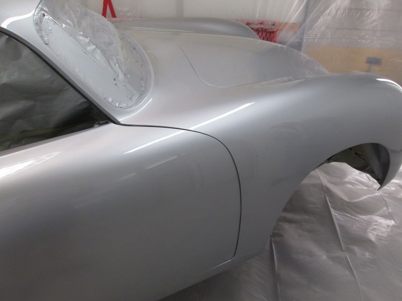

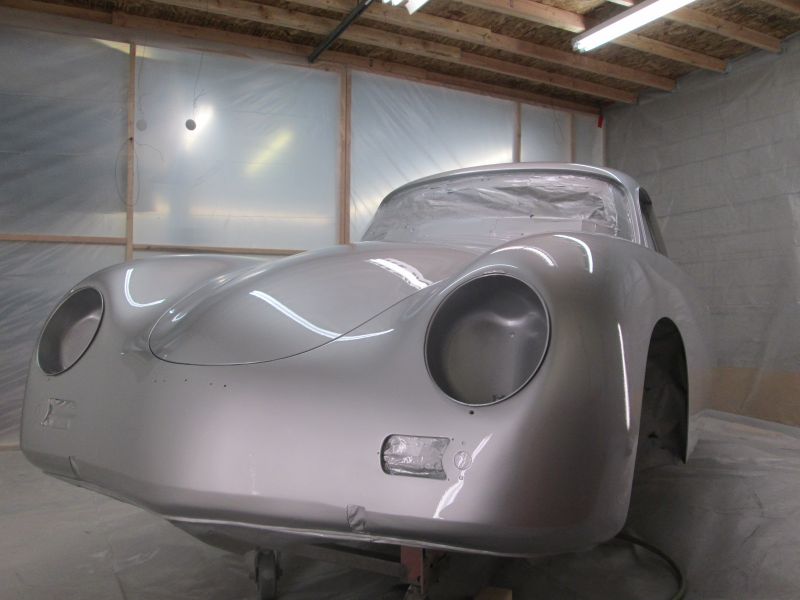

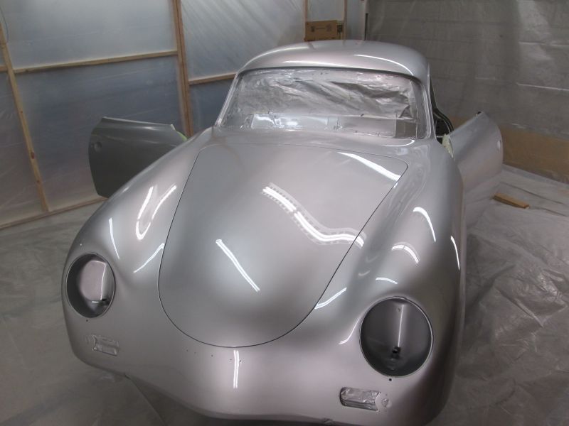

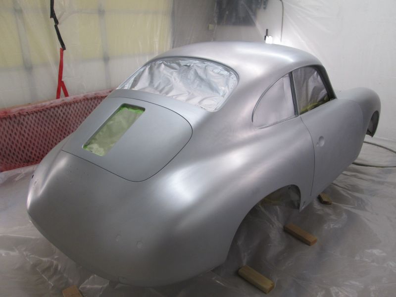

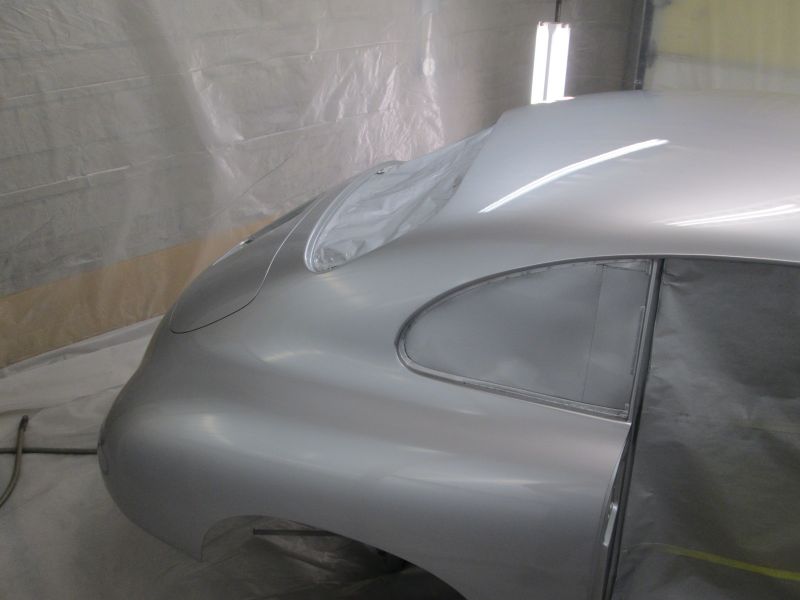

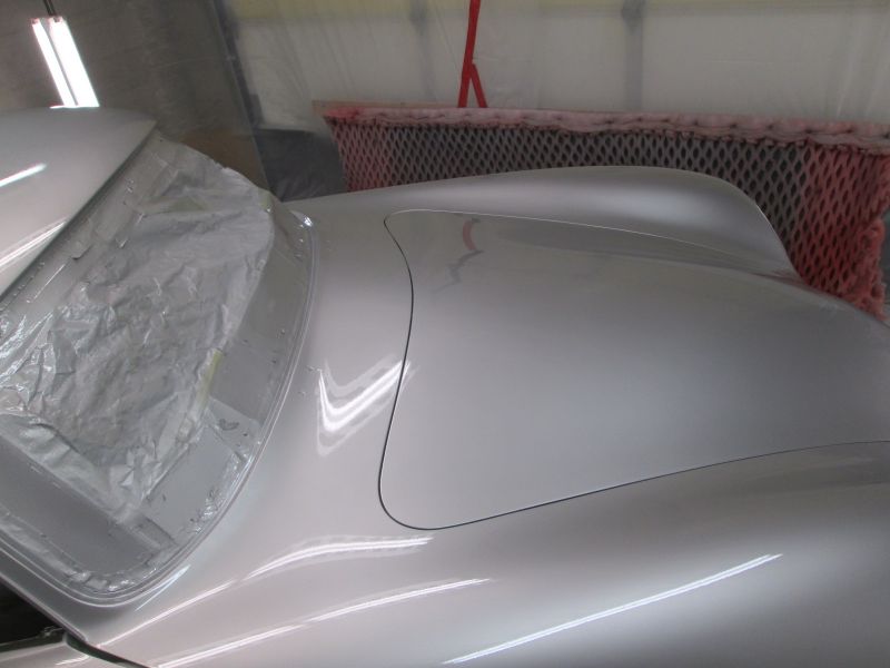

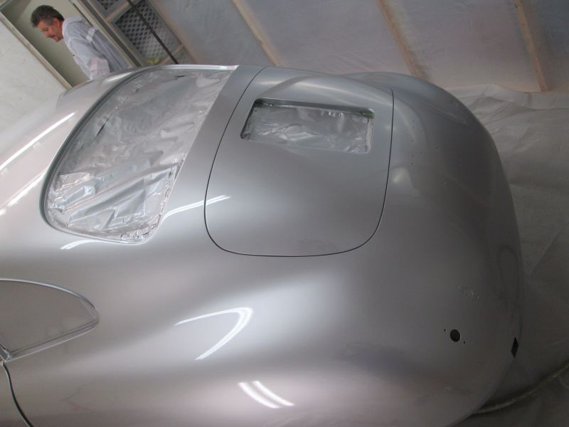

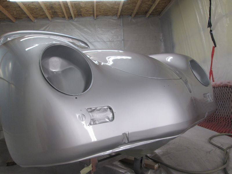

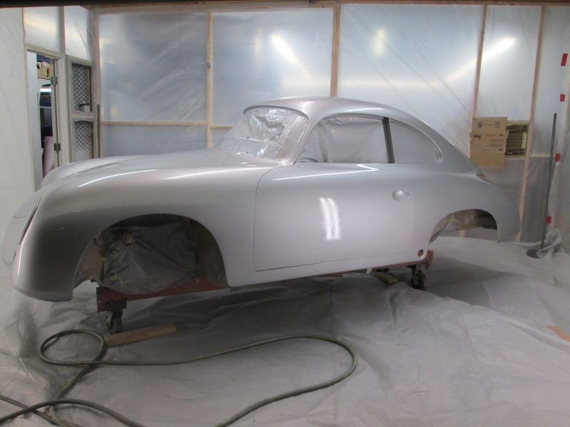

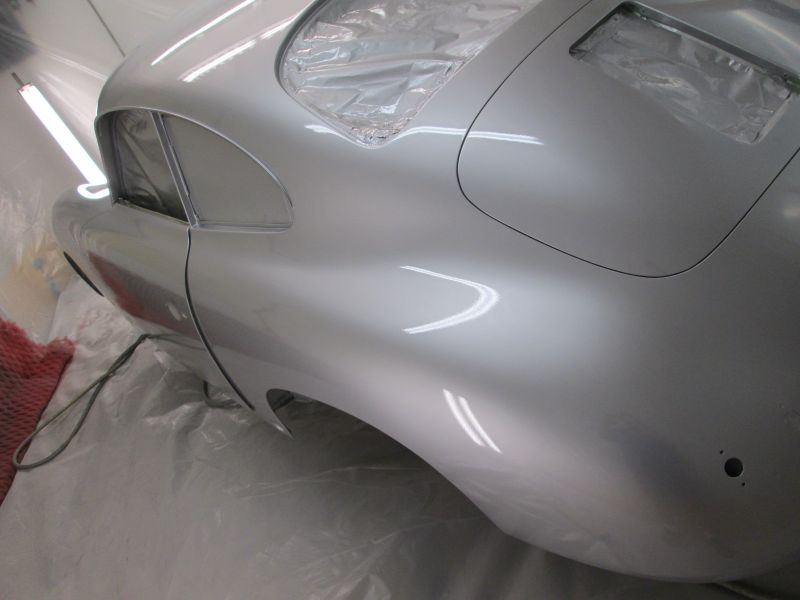

                  • Friday Oct.16 at 11:30PM it was at long last all over with my dads old car was in its final coat of paint.

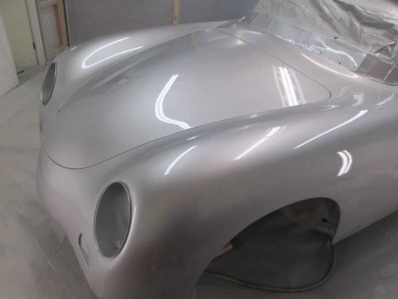

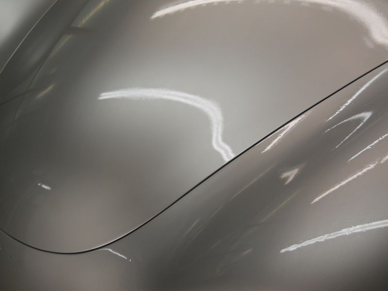

                    A few hangers and dry spots here and there but nothing that won't polish out in the end. Save for that it could not have turned out any better. Rick made the suggestion between coats of clear that we could stop half way and block sand it one more time tomorrow to get it just a little bit better. I said, I really appreciated that offer but I AM DONE HERE my man; Lets just finish this damn thing up. The end result would have not been any better to justify all that extra work. Not to mention going home again in the knowledge that it still wasn't done. I just couldn't bare that mentally after the week I had. This car was finished and so was I.
                    The true test would be how it looked in direct sunlight; That next.
                    Thanks for looking! Justin

                              Rick made the suggestion between coats of clear that we could stop half way and block sand it one more time tomorrow to get it just a little bit better..............
                              Think LA's "Junior".....a great painter's rep was made for doing just that (numerous times per car), but it's already not what Porsche did as they had no base/clear and got the finish smooth by baking the straight enamel. I try to duplicate that as best as I can in today's chemistry. (Smooth and shiny but not looking Kandy-Koated/dipped.)
                              Actually, I like the idea of the "rat rod" but you couldn't leave the metallic base uncovered, but flattener in the clear would work.
                              Too late now. That will be stellar when lightly sanded and buffed.
