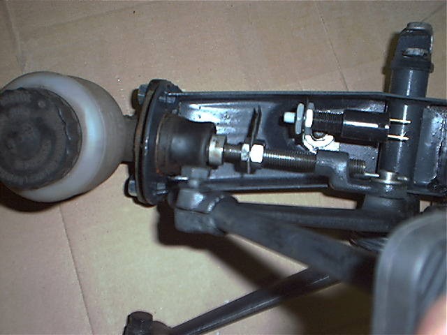

    Timely for me. I put a dual circuit on my PreA years ago. Got the kit from Klasse 356. This kit used the ATE M/C, and I assume the new owners still provide the ATE as their kit is quite a bit more expensive than Zim's. I called Zim's and they use the Brazilian M/C probably the one you have. I did install a mechanical switch on the PreA pedal assembly and have done the same for Foam Car. I uses a GM switch, but see that many use the 911 switch.
    This pic shows the pedal depressed so the switch is activated. My method requires adding some more thread to the push rod for the actuation tab. The GM switch has a pretty fine thread so you can really dial in when the lights come on. I set mine for very slight pedal movement so I can touch the pedal without breaking if someone is too close behind for comfort.

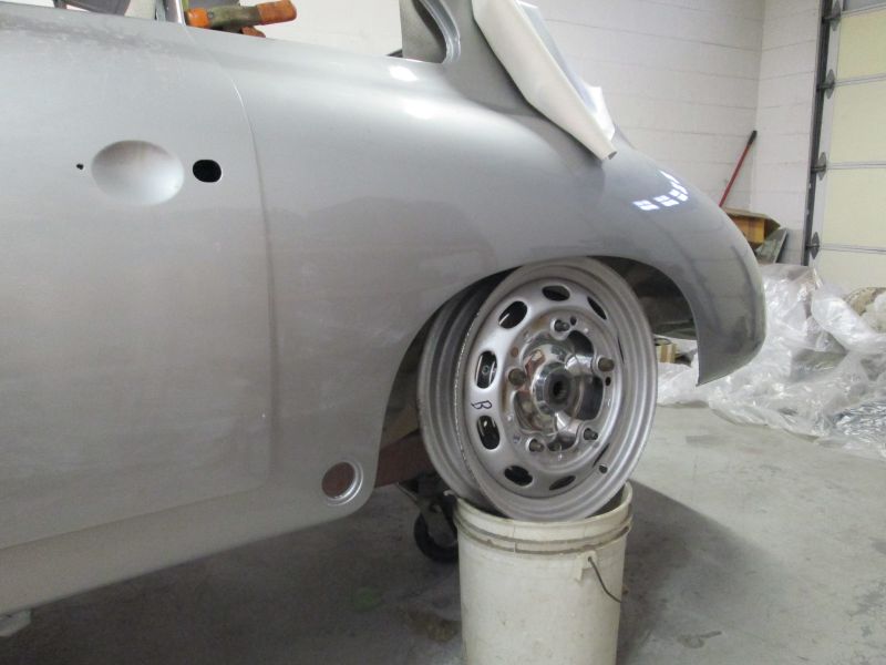

                          • Hey Justin.......just curious, what wheels are you going to run?....bb
                            • Hi Bill,

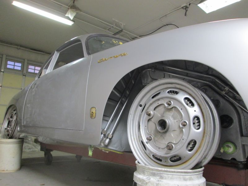

                              I was originally going to these GT 4.5's up front with the deeper RSK 5's in back. However I have changed my mind (again) and have since sold this set.
                              Never really took note before, but a few 16 inch wheels came to me recently and during closer inspection and mock up I realized that I much preferred the looks of a 16 inch wheel center versus a 15 center. What does it for me is the vent opening profile. I love the more open and flatter profile as it must to reach the ID of a 16 hoop where as a 15 is scrunched and rolled quicker to squeeze into the 15 inch hoop. I was sold on the looks of this version the minute I stepped back

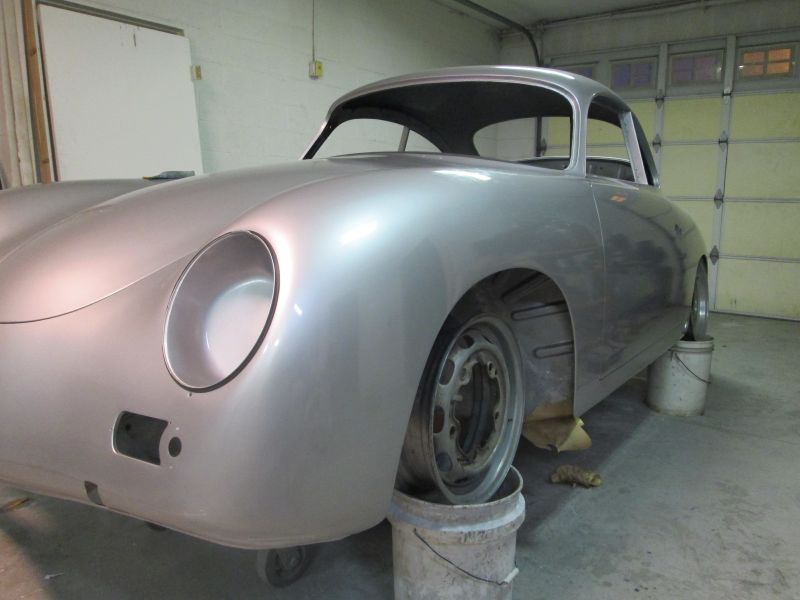

                              with my GT spacers in the rear. After seeing this no way was I going back to my 15's.

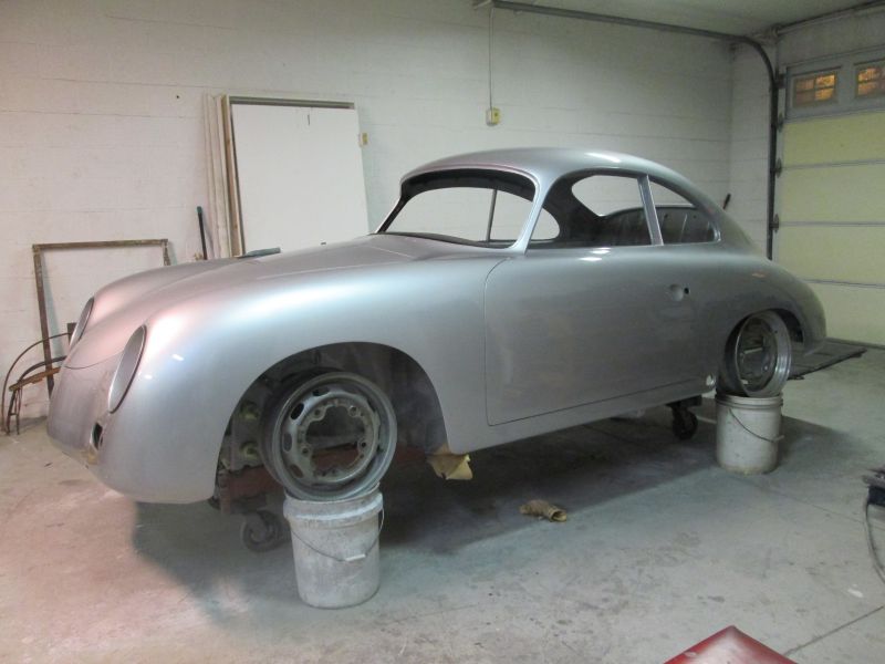

                              Here's a mock I did with those 15's right after I got the body painted.
                              Looked alright but it sure didn't knock my socks off like the 16's did.

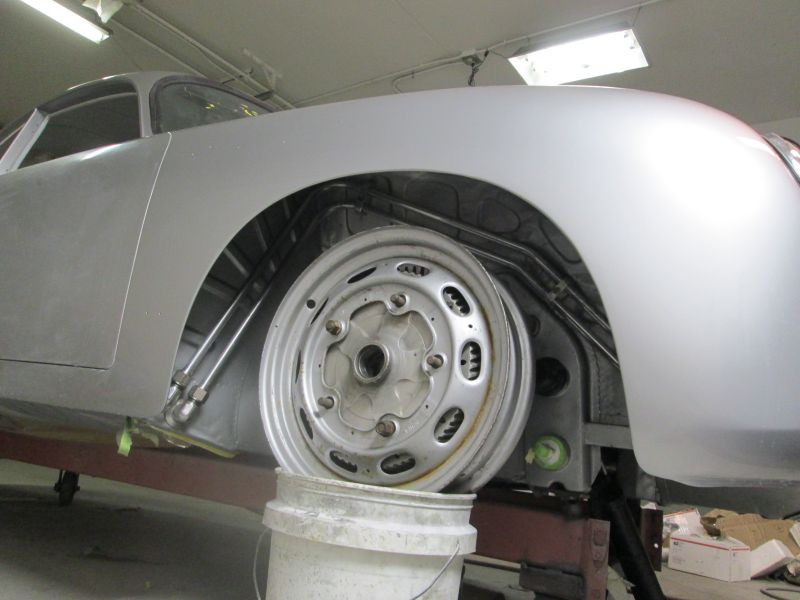

                              Of course the problem here is that they are only 3.5 inches wide stock Not quite enough. So I'm in process now of having a set specially made that will be 5 inches up front and 6 inches out back with custom offsets for this specific application. Alloy barrels BTW.
                              I have seen that really nice set of original GT wheels you have for sale here in the classifieds Bill. A few years ago I would have been hot after them but as you can see I'm going in another direction.
                              Thanks! Justin
                              • Can`t wait to see those new wheels Justin! The car`s lookin great!.....keep it up.....bb
