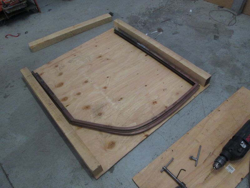

      Today's chore was building a secure crate for my door frames so I can finally get them off to Victor miles. I've been meaning to send these for about a year now but procrastinated mostly due in part of building this PIA wooden box and also the grand it will most likely cost to refinish them. No choice though, as Roy says it another bullet to bite. The silver lining here is that its the last of major trim that I need replated for this car. Wooden box is overkill but I just can't take any chances of damage during shipment especially on the return trip.

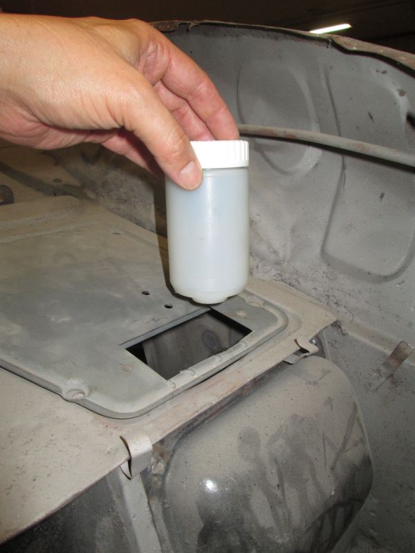

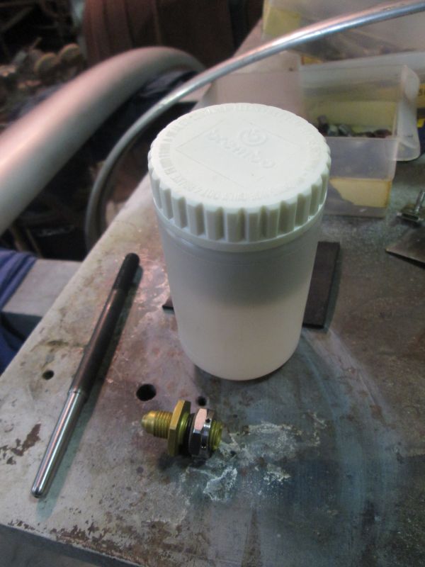

        Ashley Page was kind enough to hook me up with this Plastic Res. by Brembo that his company offers. He also included a slightly longer actuating rod which might be necessary for this application.
        My plan is to build a custom mount that will work off of what would normally be the forward little rectangular access/trapdoor for steering box adjustments. The feed line will run through this new mount/door which will require NO modifications to the car or this OG GT cover plate; this being the primary goal other than it working properly. I'll have Bill machine me up something clean after I get it drawn and planned out. I wanted to thank Ashley once again for supplying me with these great parts!

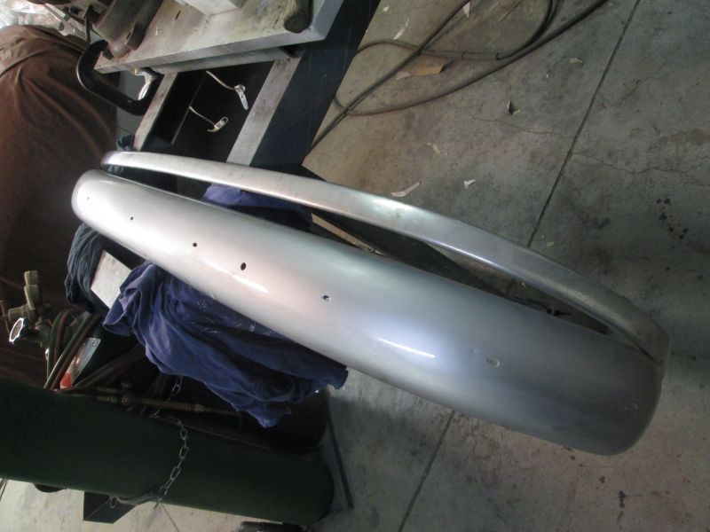

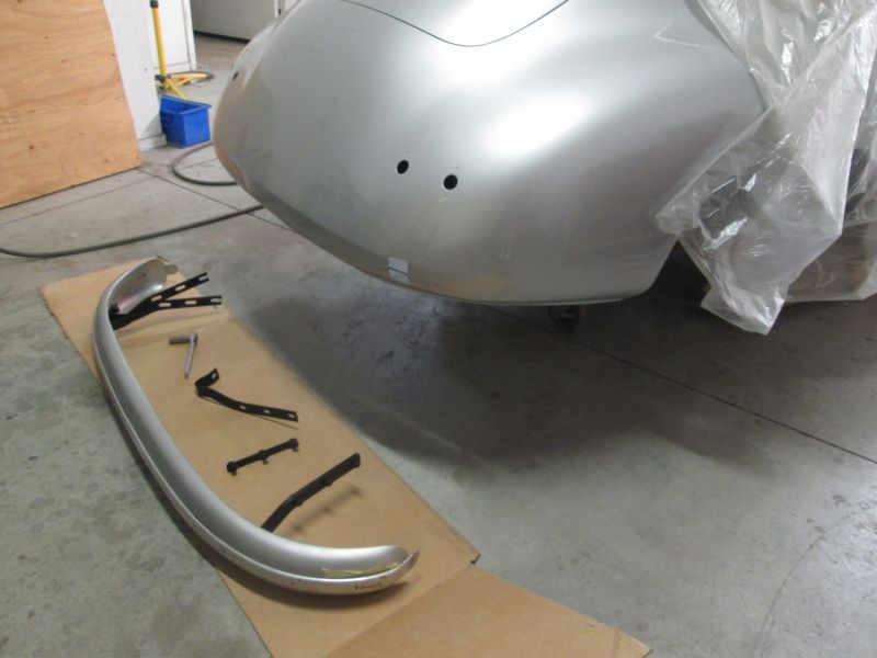

          Begin sorting bumper trim and hardware.
          I'm going in several different directions all at once on this car as of late but it all has to eventually be done so I found myself addressing the bumpers a few weeks back.
          I broke a cardinal rule here by not fitting this trim before final paint. Be it laziness, excitement about final paint or both but I just didn't want to be bothered with it at the time and now I'm paying the price and running a risk. Began with the rear bumper first. Kick myself square in the ass for this one.

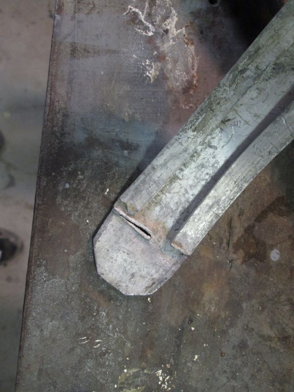

          This old original has no dings or dents but the folder over tabs have cracked so the ends will need to be fully relaxed, TIG'd and fitted to the bumper.

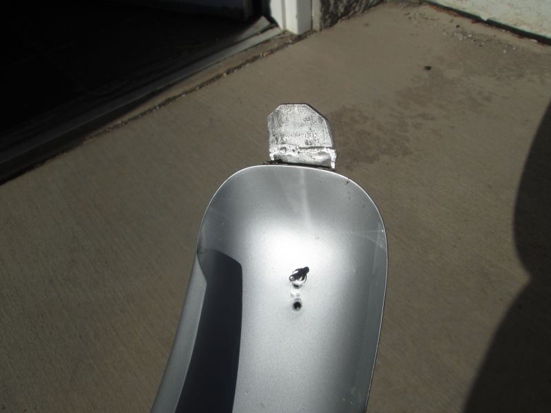

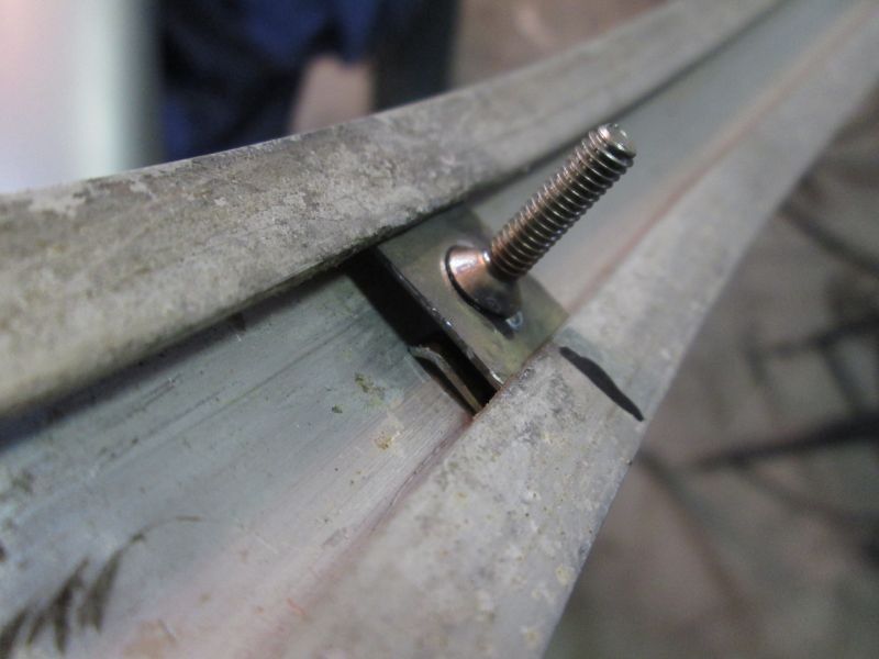

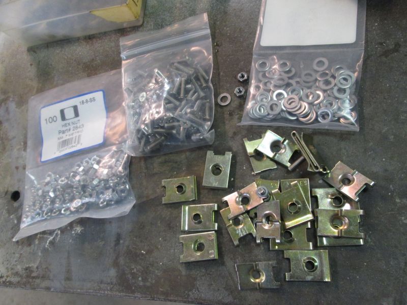

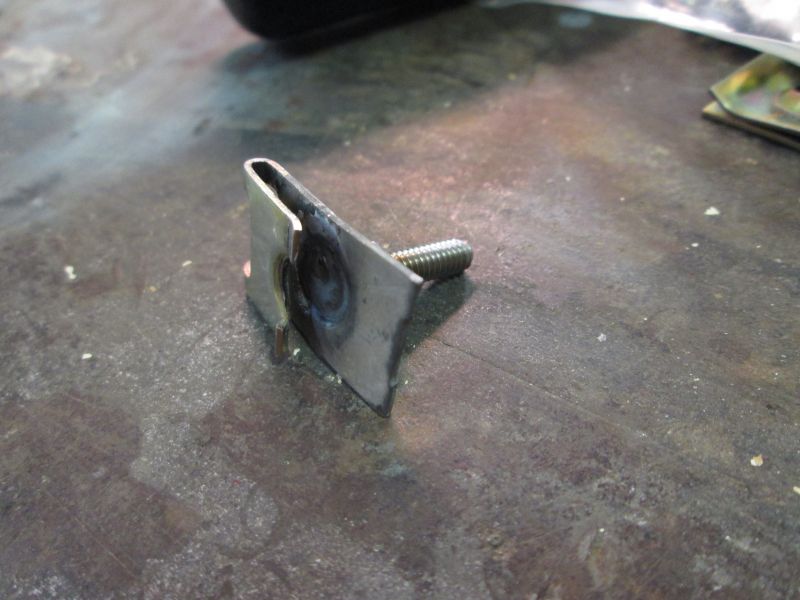

          decided to make my own mounting clips. Found these light spring clips and stainless hardware about a year ago.
          quick little plug weld and its done.

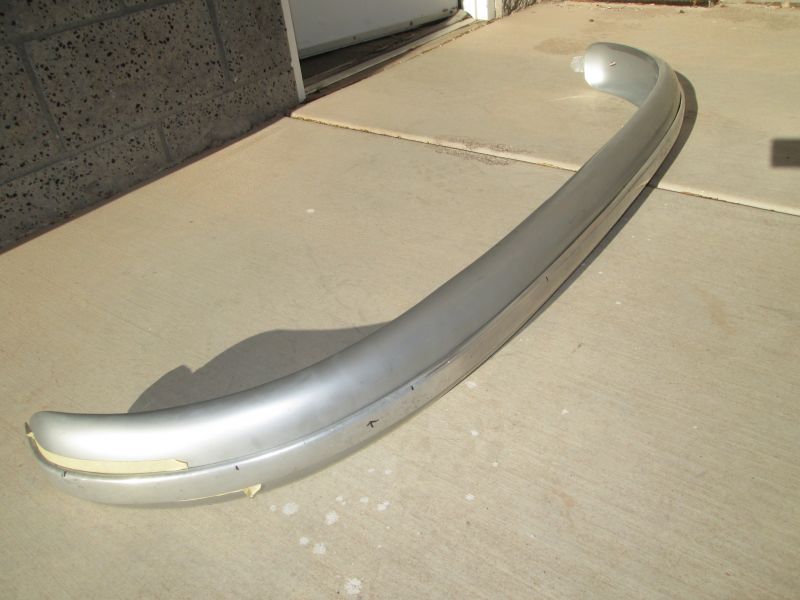

              • 10/19/16
                Thanks guys! Several of the prefab clips I was looking at were too heavy duty with standard threads. After some scratching around at McFadden/dale I figured I could combine these lighter clips with some metric SS screws and have all that I was looking for.
                Trim centered and all bolted up without scratching the paint.

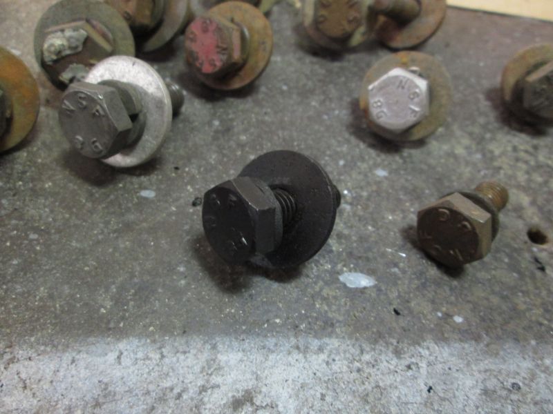

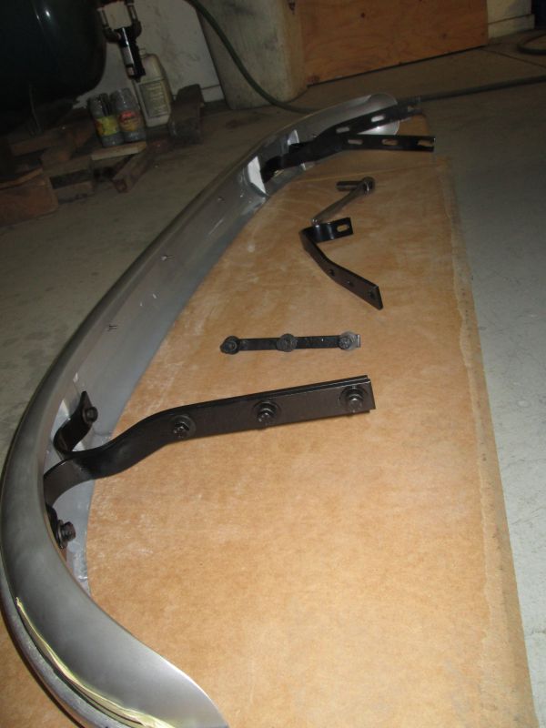

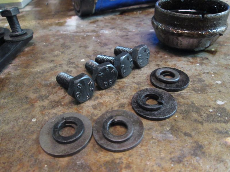

                  First chore was rounding up enough original NSF bolts and washers to mount my bumpers. Then the process of cleaning, blackening and clear coating each piece.
                  Too much time invested in the treatment and restoration of each item. but these are lengths I'm willing to go to keep and use original parts. Original thread plates and bumper brackets were powder coated many years ago.

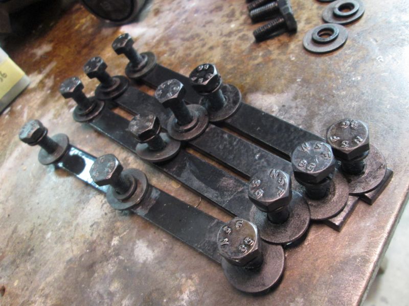

                  It took several sessions to get here but I was finally down to my last batch on the bumper side.

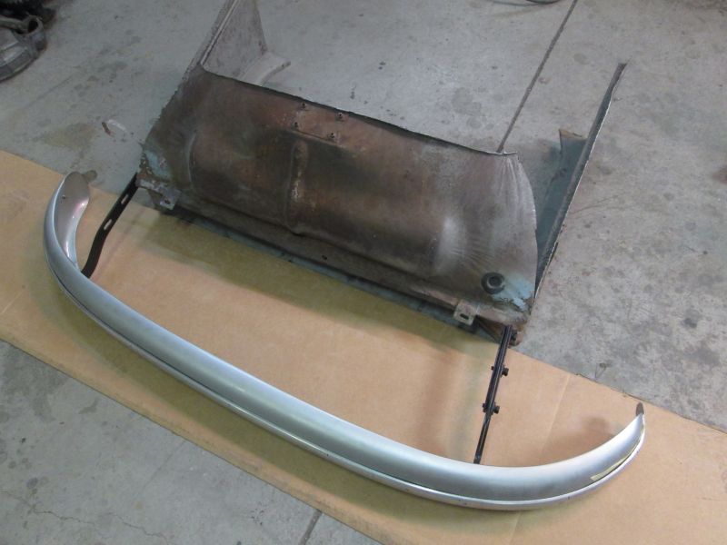

                  Begin fitting original brackets to the bumpers. These are not OG to this car or the bumpers so a bit of careful tweaking will be required.
                  Again, like the alloy trim this is shit I should have fitted and established well before final paint. Paying the price of procrastination and laziness.

                    • I see you have a bend in the bummer bracket. Mine are straight. Have you bent yours to bring the bummer closer to the car? Which I think it a better look.
                      • Are you referring to that kick in the profile? If so, all rear brackets need to have that in order to drop down and clear the hole in the body. Otherwise the hole would have to be cut in quite a bit higher to allow for a straight shot at the rear bracket mounts. The fronts on the other hand are straight.

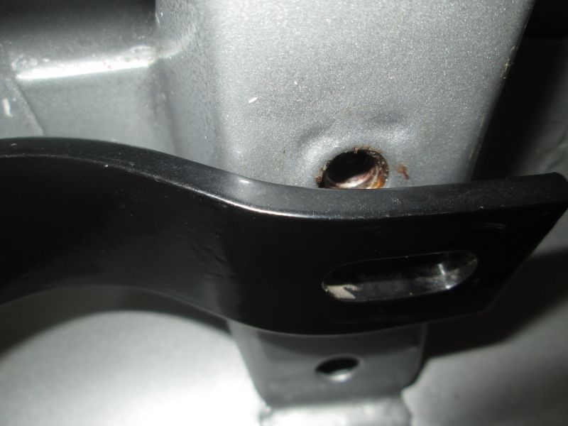

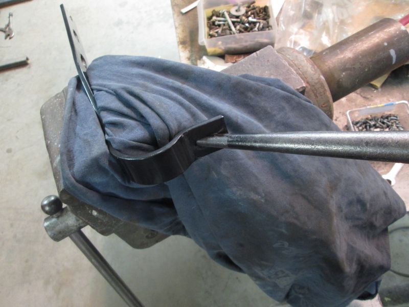

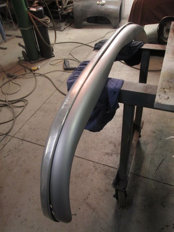

                        Once the brackets are synched down to the bumper they're pointing in an off angle. To get them dialed in I'm using this old frame section for mock up to save me the risk of scratching the car. I'm still kicking myself in the ass for not taking car of this before paint.
                        To mount straight this iron has to be relaxed
                        Taking all the precautions I can to try and save the finish while I manipulate it but I'll probably end up repainting at least one piece before its over. Remember to test fit all your parts before final paint so you don't end up like me.

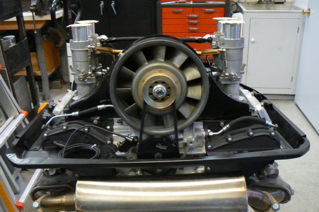

                              Several recent photos enclosed.
                              Cheers,Pete
