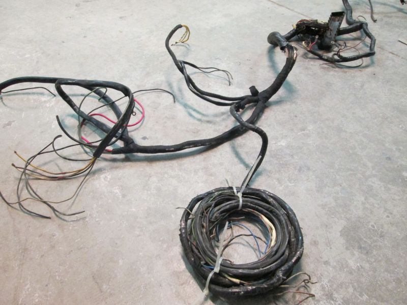

            The next major items that have to go in next is either the headliner and or the wiring harness. I still have to order both. I purchased a new headliner some time back but was completely unsatisfied with the perforated material they used to make it. It was much too course of a grain and seemed very much like a VW bug headliner material. I'll get hold of autos and see if they'll send me a sample. Bruce, Jack or anyone; who makes an accurate headliner for an A-car these days?
            Wiring Harness:

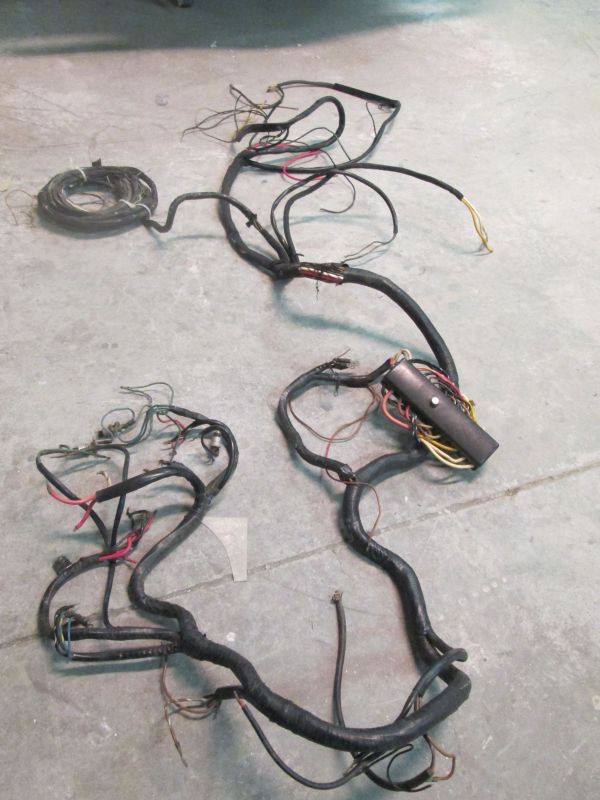

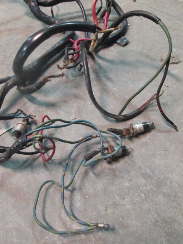

            The original harness from this car is actually in decent condition. The cloth covering of course gave up years ago but its intact otherwise. I've been thinking about getting a new from YnZ's since 1989 but just could not decide to throw this one out or use it.

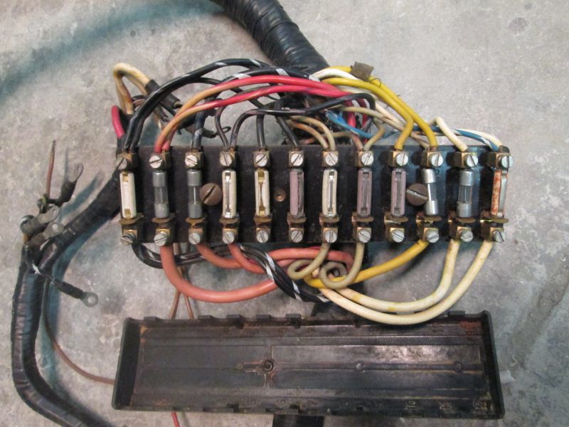

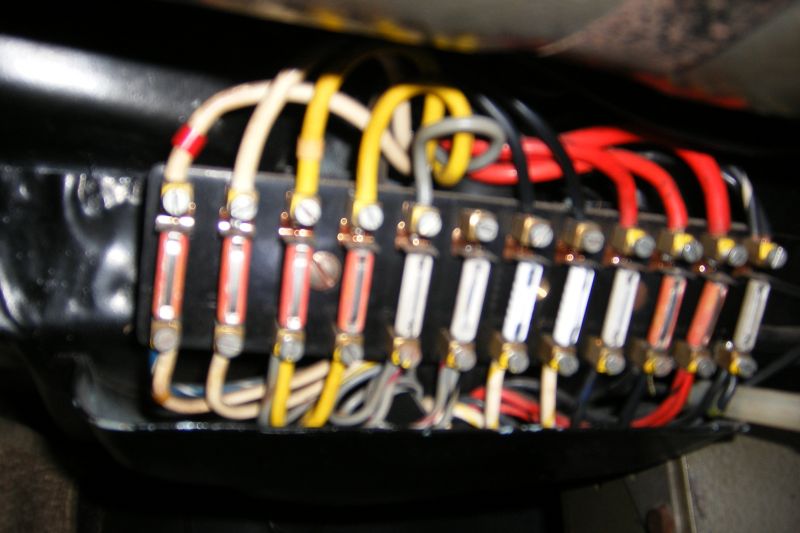

            Fuse block is good. God, I remember how sacred I got the first time I started disconnecting the gauges and began pulling out this harness. I thought it was sooo complicated. I've since mapped out a late model chevy engine with EFI swap for my Toyota; this harness is not so intimidating now.

            I wrapped it in tape and shrink tubing way back when but was recently looking into this new wiring harness weave that simulates the old cloth but I don't know if its worth the effort. I don't know I'll probably just get the new one.

              As for wiring....it's old if out of an old car. Set in it's ways, so to speak, and usually corrosion is at the ends of runs and goes fairly far back into it's insulation. I have used harnesses from Wocheslander in Germany, Rhode Island Wiring and Y's-n-Z's and they are all good, but Y's/Z's is probably better because they do more of them and more accurately...but their wait is usually longer than the other two.
              If the 356 is going to be or was 12v, the harness is not as important as with a 6v car. The corrosion matters more to electrical performance with a 6v system, but in your case, it's a nice car and all parts of it have to be to the same standard, so I'd recommend a new harness, regardless of voltage.
              I save the old harnesses either intact or if butchered previously, in rolls of each color coded wire for repairs of other harnesses. I don't throw away much of anything reusable.

                  Bruce is correct in my view, the wiring loom is important to be perfect. ( Are you going 12volt, can't remember )
                  My 6v loom looks almost perfect. The fuses are the original ones I have cleaned once or twice with electrical cleaner in 47 years. All my electrics work but...taking just the long 10mm diameter starter to battery cored wire and the wire from the starter solinoid to the ignition switch what looks fine isn't always the case.
                  That wire to the ignition at the solinoid end had gone hard for about an inch. I cut it and you can see the green verdigree in the picture below. The main 10mm wire looks fine both ends but I still need to check it for voltage drop. I am not convinced its perfect.
                  As Bruce says the wires may be okay but under the insulation who knows.

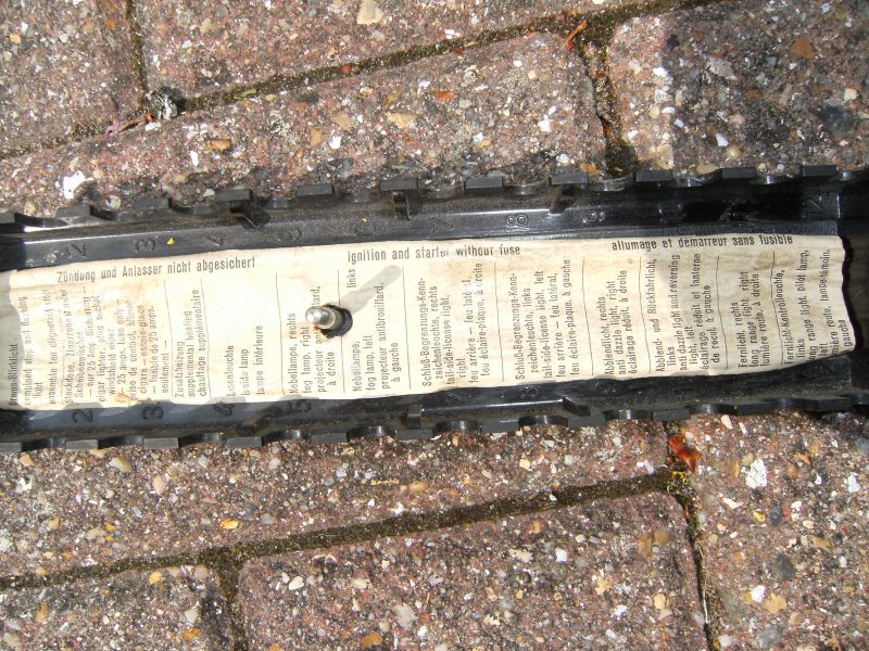

                  shows the paper fuse description I think you can buy those?

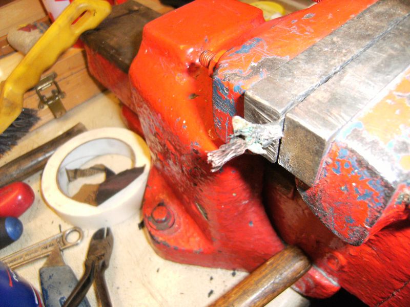

                  Poor old wire in bad condition
                  • Justin,
                    I would like Bruce suggests buy a new loom. Mine still with original fuses etc. works well but he is right the oxidation of wires under the insulation happens after many years. Attached a photo of the thin wire from starter solinoid to ignition. I ended up going back about and inch to clean copper.
                    A pic of the bad wire. ( that did not appear on my last post )

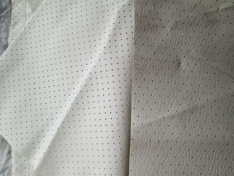

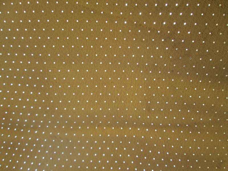

                        Here's a remnant piece I have which I believe to be the correct perforation pattern? Right?
                        However from my memory the grain seems way too course. Unfortunately Roy, I wasn't smart enough to keep the original to mine back then. Can you take a few detailed shots of your headliner? I assume its the original.

                        On the left is a 911 headliner with the square pattern Bruce was describing and the hole pattern is much tighter and more numerous. Its a new one and I can only assume its right for an early 911. I'd have to look at our '66 to be sure. Anyway the grain seems softer and more like how I remember the original in this car being. Some pics of an original sure would help.

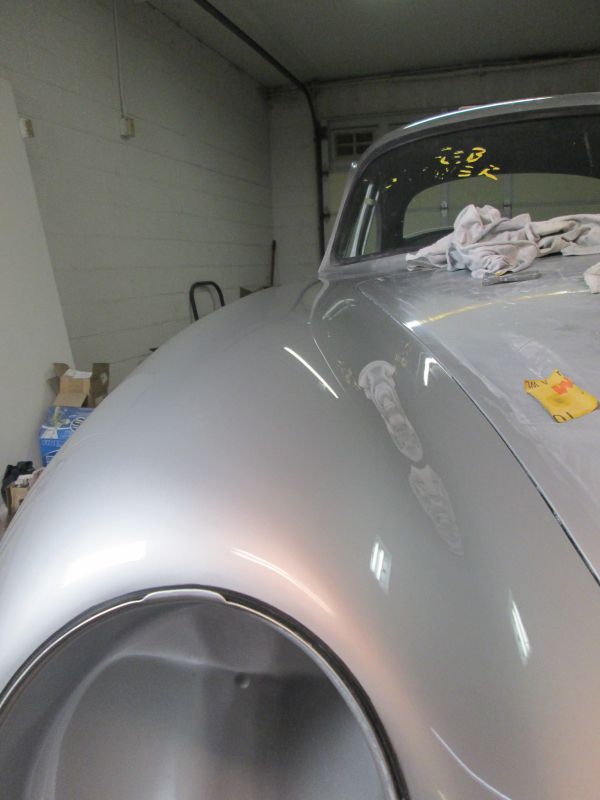

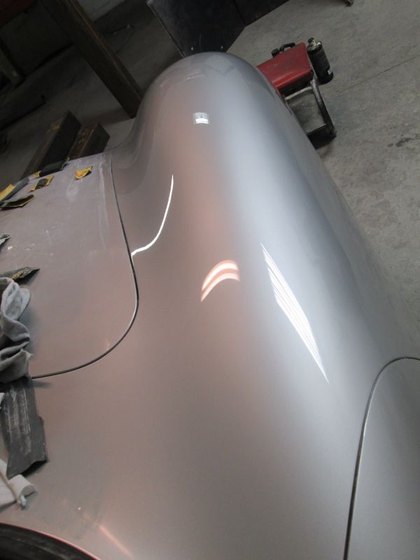

                        10/29/15
                        Block/color sanding continues.

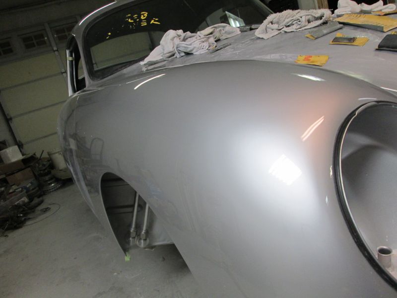

                        Right fender is officially cut and initially polished up to the A-pillar and around half of the nose.
                        I'm very slow but am taking extra time and care around all concave surfaces. I had several hangers and the pooling at the hood lip to carefully shape down so it took some time.
                        Doesn't give the depth or feedback a Black paint job would have but you get the idea. It will get a little better than this once it cures completely and I begin micro finishing it once the car is assembled.
                        Thanks again guys!

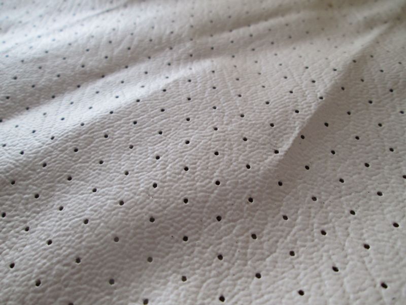

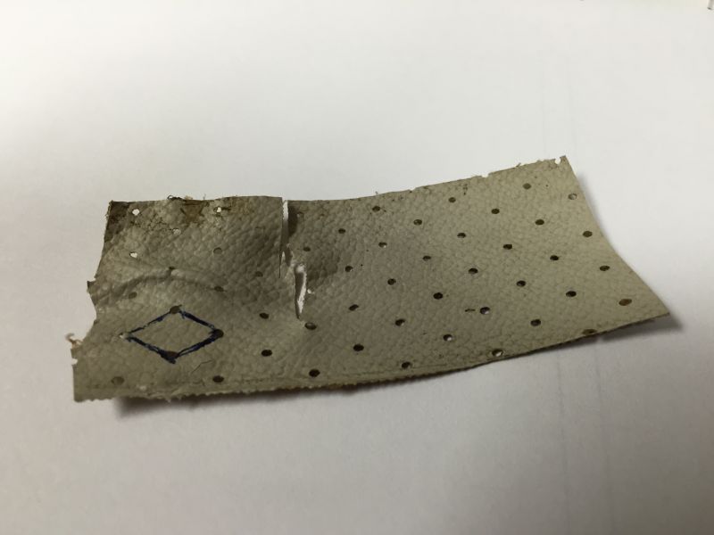

                              • Roy, Justin posted the better comparison that shows the 'square' pattern (as in the SM ad) is not right for a 356. Probably "good enough" for an average resto but not for a "no excuses" car.
                                Here is a sample from an original '63 T-6 C-2:
                                As Justin says, the grain is 'softer'...but truthfully, the punched pattern is what those "in the know" will notice first. The color can be matched and sprayed and that would help disguise the grain's depth.
                                The sample I got of the correct 'diamond' pattern had smaller punched holes and care would be needed to not spray the color and make the holes look even smaller. That's if I wasn't misled on the first sample/first contact and subsequent same PN but square pattern on the same vinyl on a repeat request.
                                I have asked vendors about the chance of dusting off the old punches and producing another roll of the diamond pattern...and have been told "Oh, those are all long gone."
                                Yet, I have heard of a few purists that have found old US domestic vinyl that was re-worked to look like that Porsche used early-on with the 'correct' grain and color and still show the supporting woven texture underneath.
                                "Where there is a will (and deep enough pockets), there is a way." I'm working on it....but would love to hear how the "high end" shops solve this sort of dilemma when "originality" is involved.
