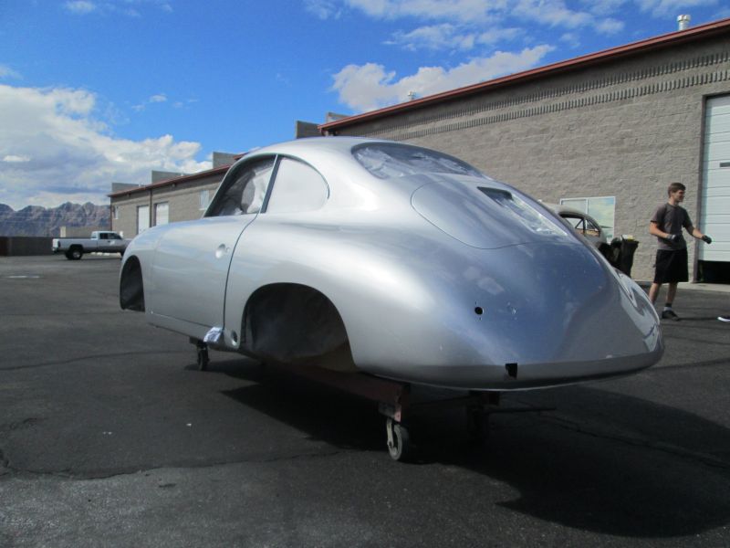

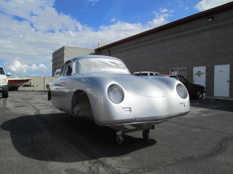

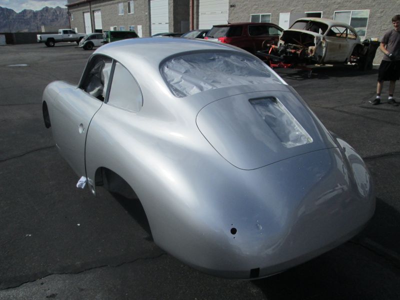

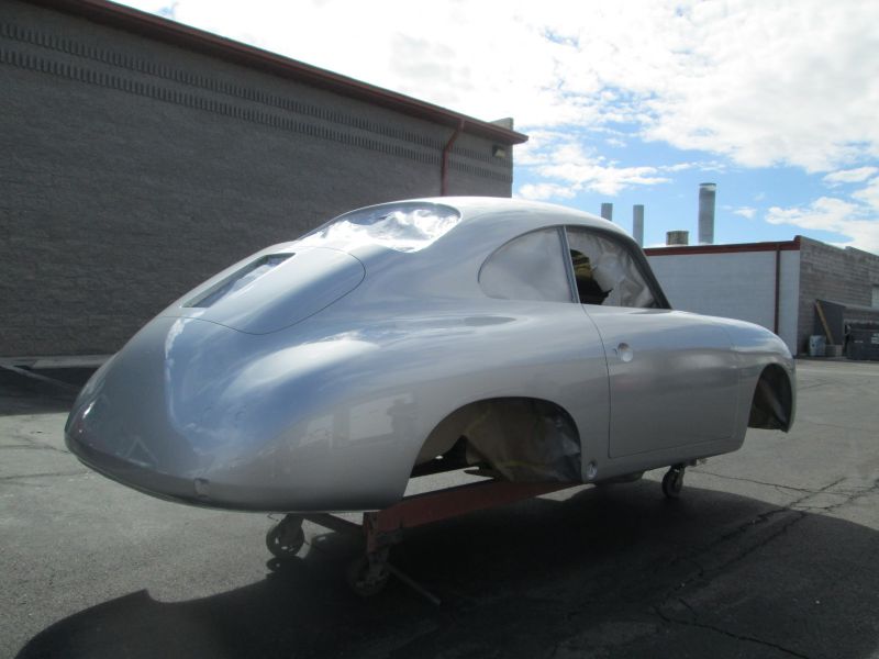

    Saturday Oct. 17

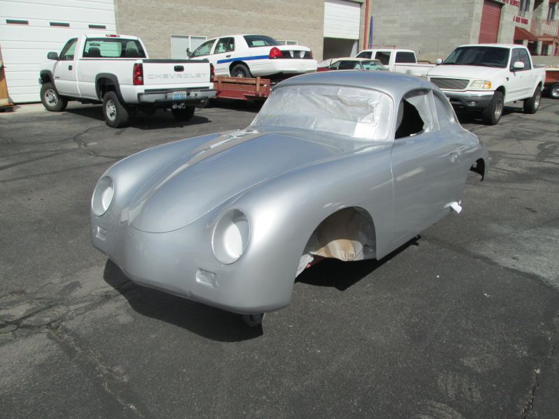

    Ready to come back home.
    Time to roll it out of the booth and into the sunlight.

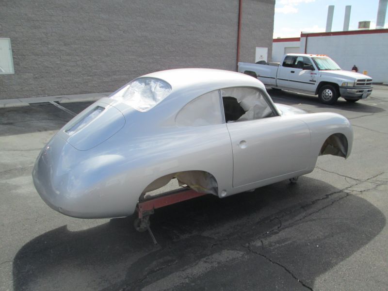

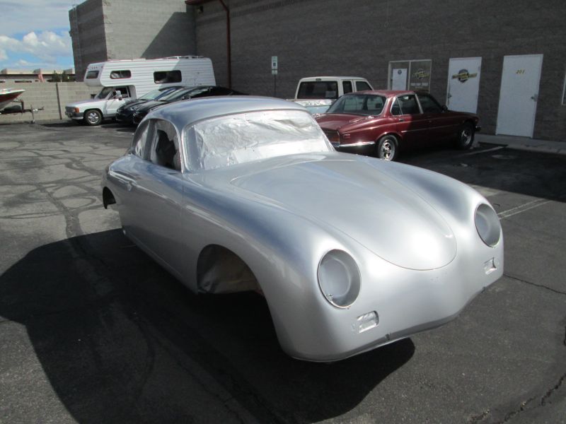

    Much to my relief the flake was just beautiful. It would blow your eyes out at the right angles which was just what I was hoping for. I thanked Rick Profusely as it would have never turned out this nice if I shot it, no way in hell. Quoting from Bruce earlier: "A man has to know his limitations"
    Door got a little dry but again nothing that won't polish.

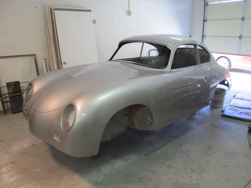

    The next bit of fun was unwrapping it once we got back to my shop.
    I have to be so careful now. I told Rick the Polarity of this body has now changed as it now attracts damage. Before you could walk by it with a hammer or blunt instrument without a care or damage. Right after you paint them everything seems to be attracted to the new surface. I'm working on an isolation/clean assembly section now.
    Thanks for looking! Justin

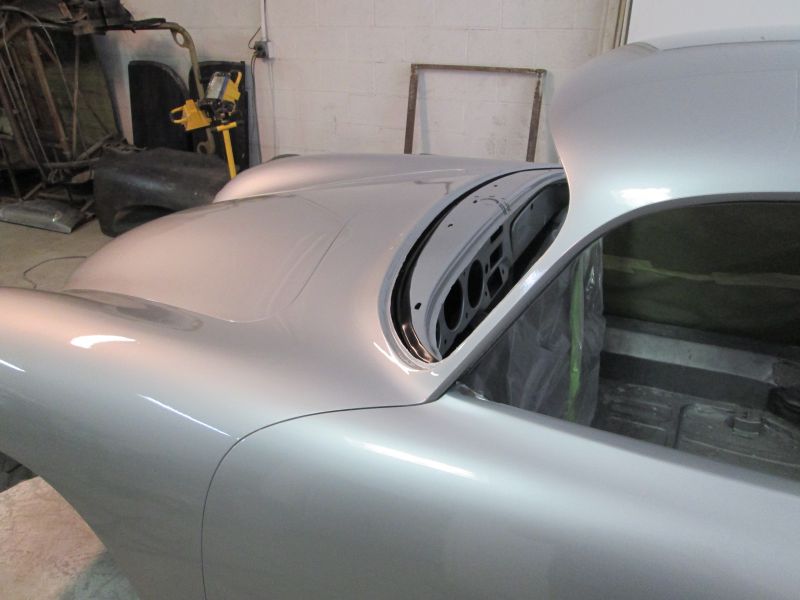

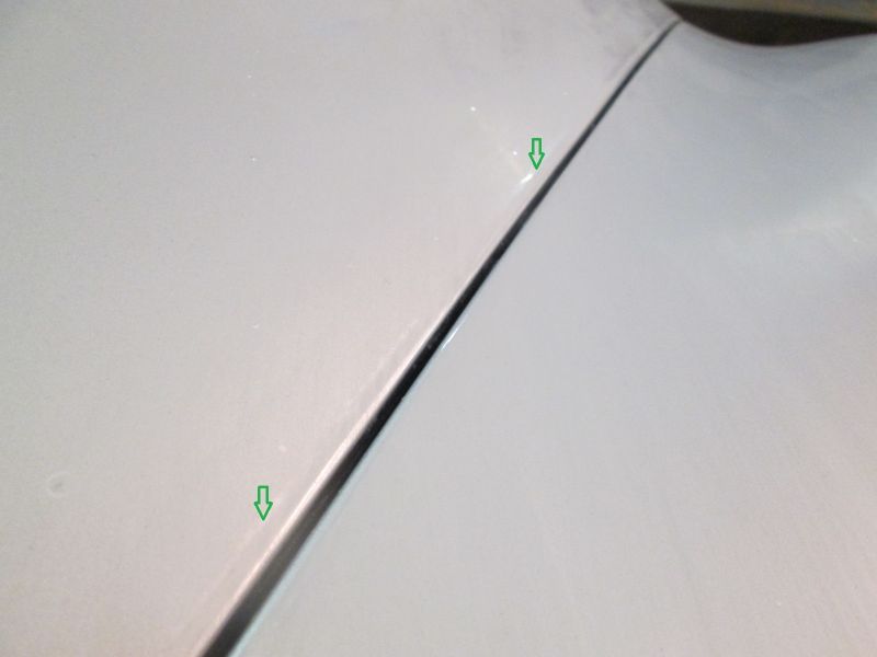

                  Speaking of gaps:

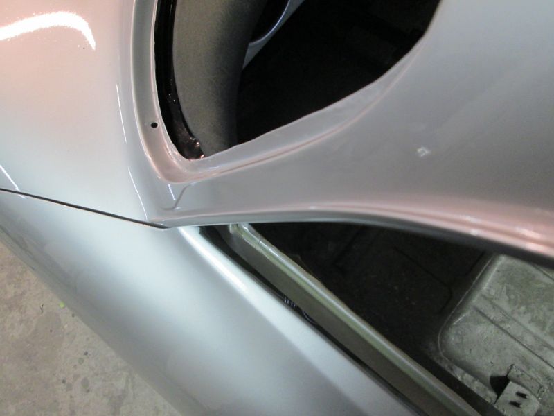

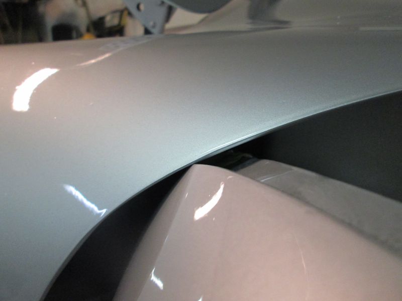

                  I pushed them about as far as you can. I was very relieved to find that the final paint thickness will not be a clearance issue, at least not yet.
                  However don't ask me how these two clear without damaging the edge of the door but they do. I can't even slide a piece of paper between them, I tried. They clear now but heat expansion could become a factor as the sun warms the surfaces once its out in the world but I'll be color sanding a bit so hopefully that will provide the extra clearance needed for that variable. Time will tell.

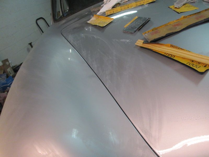

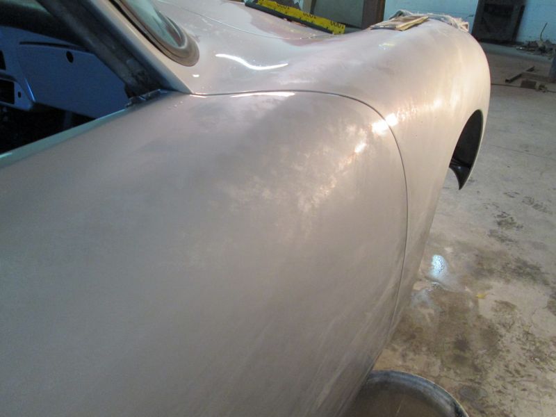

                  Color sanding is what I'm slowly getting into with the right front fender and door. I'm taking it a little further and long boarding to true the surface as well as get the orange peel, lint and other trash that settled on the clear.( note that its "on" the clear and not "in" it; won't be able to do much about the ones that are in it ) Again this is way overboard for any shop to perform cost wise. I'm just doing it because its mine and I'm able to invest the time.
                  The door was latched with seal so I could long board across the gaps. You can see here that I'm getting out more than just the dry spots of orange peel. There are slight hangers and rollers where the clear accumulated unevenly. I can't tell you how slow and cautiously I have to proceed. That piece of plastic is very unforgiving and if any foreign aggregate gets between the paper and surface I could scratch it badly and be in big trouble. Just have to go slow and use lots of water. Continuing with this tomorrow. Thanks again for looking! Justin

                    • Justin,
                      How far is it to 'Pebble Beach '?? I don't think I have ever seen another 356 ( and I have been looking at 356 gaps for around 58 years now) that seem to compare to your perfection. I am not into car shows as such, but my goodness that 356 body just needs to be seen.
                      The fact you can long board across the door and fenders is something in itself and I am like you a little surprised you can open that door without it touching on the arc.
                      Some years ago I advised John Wilhoit that he and his team were artists in metal, you could join his team for sure.
                      • Justin.
                        Out of curiosity, what grit are you using on the clear?
                        • Originally posted by JTR70" post=30614
                          This worries me, and not a little bit. These chassis flex, even on a coupe, particularly when parked on an irregular surface, or up on the air on a lift or jack. It's gonna get really dicey when you have to take the door off and on (do you need to install the rubber bumper stop, and/or air vent shafts through the carpet?). I like a credit card to slide through, but at least a business card. I've had a few come through the shop like like yours and corrected the problem somewhat by filing the inner fender lip with a half round with no noticeable effect on the exterior, brush touching the filed area.
                          • Thank you very much Neil! I'm now looking forward to seeing your project in paint.
                            Thank you Roy, that is very kind of you to say! Pebble beach? Too many mistakes in it to ever be in that league. In the end it won't be fully correct car anyway but rather a Hotrod/GT clone so no concourse. but it will be just to my liking. Thanks again Sir!
                            Don, I'm using 1K grit for the initial cut and level. Then its onto 1500 and finally 2500 then onto cutting compound then eventually to the finer finishing compounds. I won't be doing any fine finishing compounds until the car is assembled as it would be a waste of time with all the handling of the car still involved. Also the paint has to be completely curd and hard to get that really high gloss back that these finer compounds bring out. If the paint is still soft those super fine "spider web" scratches or haze will not disappear.
                            Thanks Jack! I hear you and it all makes perfect sense. The saving grace here is that I have yet to install the rubber snubber so with the doors totally maxed out like in the photo the edges still are not touching. Once I get the buffer in there and the paint cut down and polished a bit I'm pretty sure I'll be able to at least get a business card in there. Yes, the vents are not installed either so the doors will have to come back off at least one more time if not more. I've gotten very lucky removing and installing the doors without damage to that edge with about this same clearance for quite some time now. Along with a great deal of caution I have my little system down pat for installing and removing them on my own. Hopefully my luck will hold out for just a few times more while I wrap it up. Of course I'm in final paint now so I'll probably end up dinging them You know how that goes. Thanks again! Justin

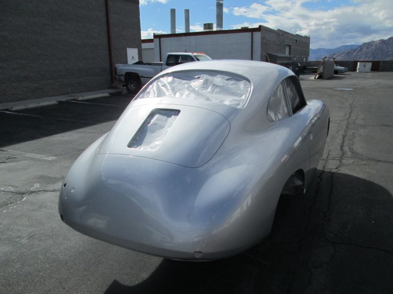

                            10/25/15

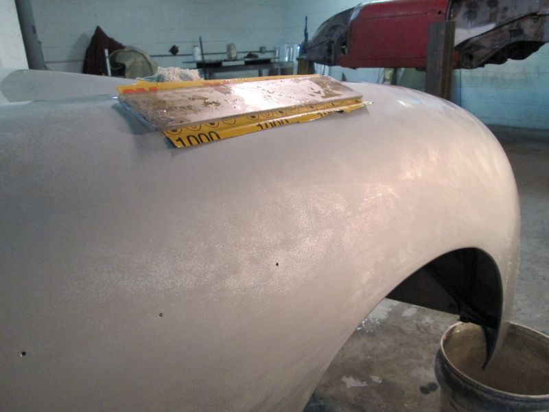

                            Careful block/color sanding continued.
                            Finished up the side portion of the fender then worked my up and over to the hood. Switching off from my hard plastic block to a paint stick when needed.
                            Part of leveling out the clear that I described earlier also includes taking down this shouldered edge that accumulated during the shoot. That will distort the reflection for sure.
                            Side area now cut and leveled as far as I dare to chase it. I had to really fight myself to keep from getting too greedy. I had to constantly say "if you cut through this clear you are not going to be happy". So I stopped. I'm good with it, you can see my junk pile there in the corner reflecting pretty sharply. Looks nice in this light and angle but in direct sun it would be hazy as its only been polished with cutting compound. This however is where I want the rest body to be as reassembly continues. Thanks again for all the great feedback and cautionary tips you guys!

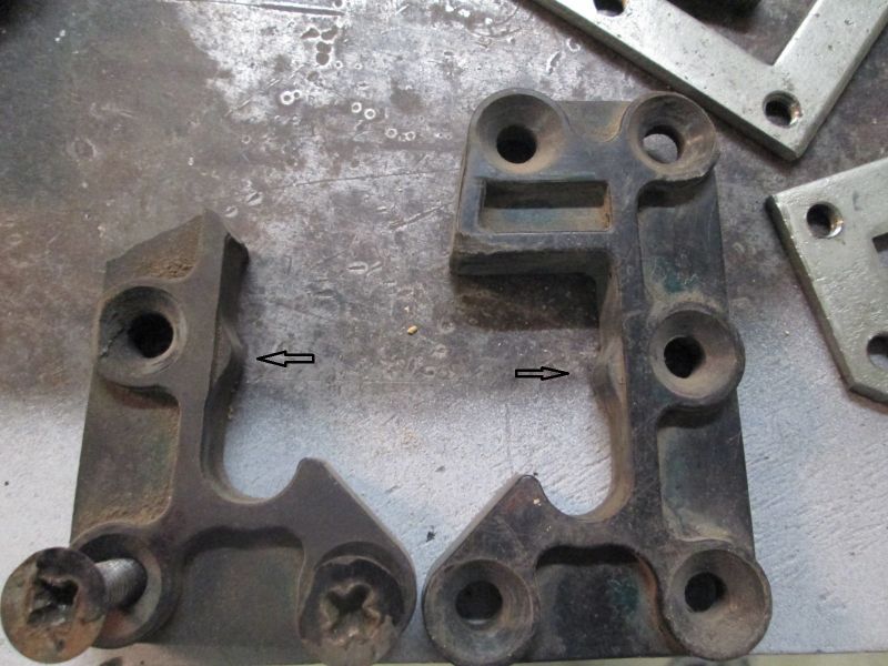

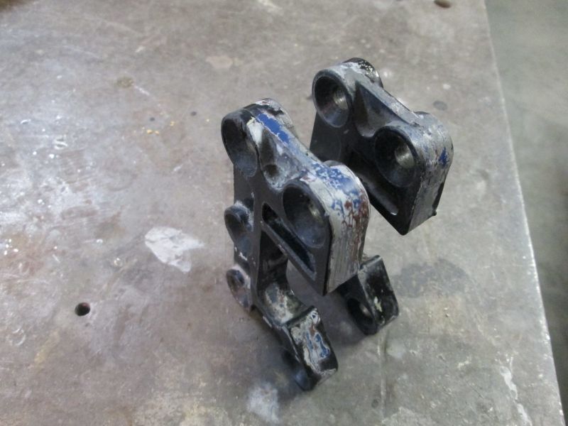

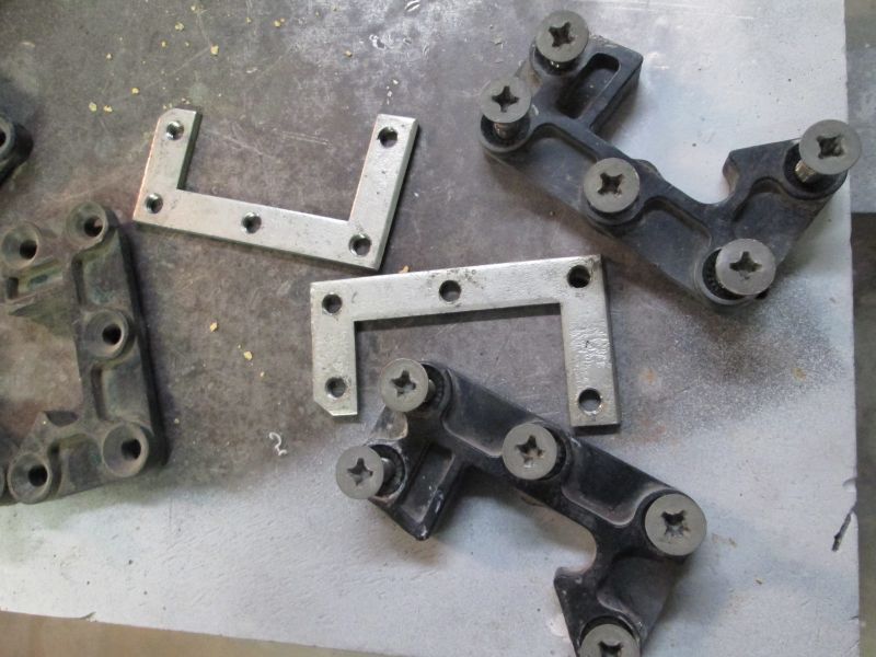

                              Here are what's left of the original striker receivers to this car(still some old green paint on them) Unfortunately broken and cracked. I was also very hasty with the original screws when I first removed them as a kid by using the wrong size screw driver which chewed up the heads. Wasn't a second thought back then but sure does to me now.

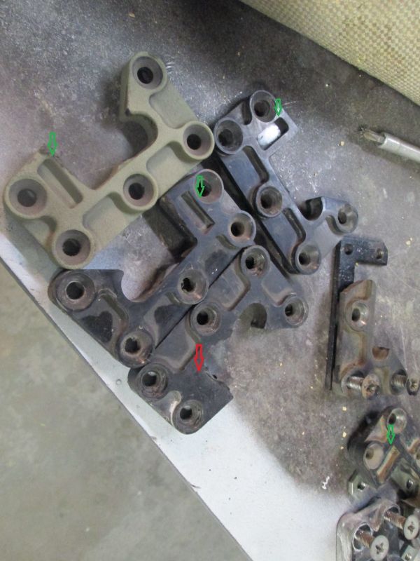

                              Again spent several years buying various ones on line looking for a pristine pair. Most times if not cracked they were badly worn or gouged from misalignment.
                              At last I got hold of a really nice original pair with no cracks, damage or wear. I just had to clean all the past paint job attempts off.

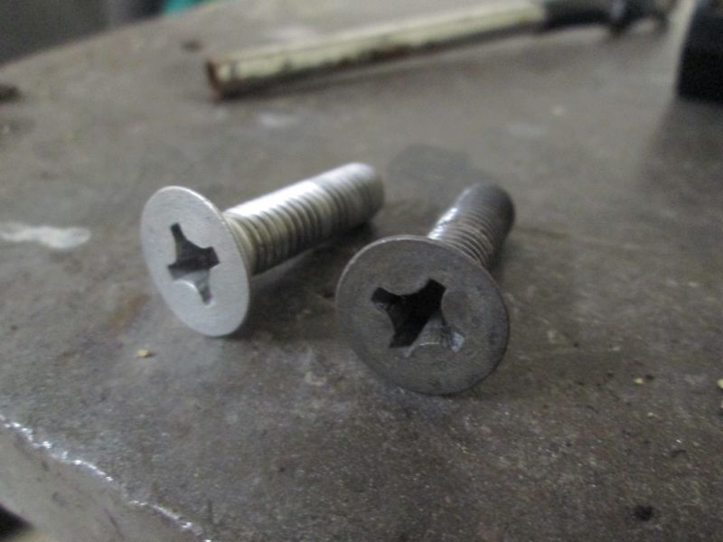

                              I was also able to round up another set of original Philips head screws for the job. All the other screws on this car are spade but the strikers were Philips head originally.
                              I thought the screws might be black oxide originally but found zinc or cad on the undersides of the head so they'll need to be replated. Prepping the faces here by planishing edges down from previous removals.

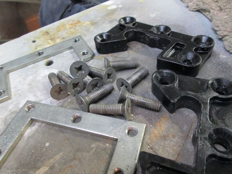

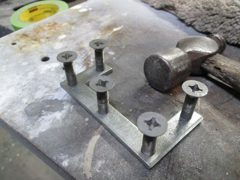

                              Everything now cleaned and ready just have to get the screws replated. The original base plates I had zinc plated several years back. This might seem crazy or silly to some but all these original small details will definitely add up in the end.

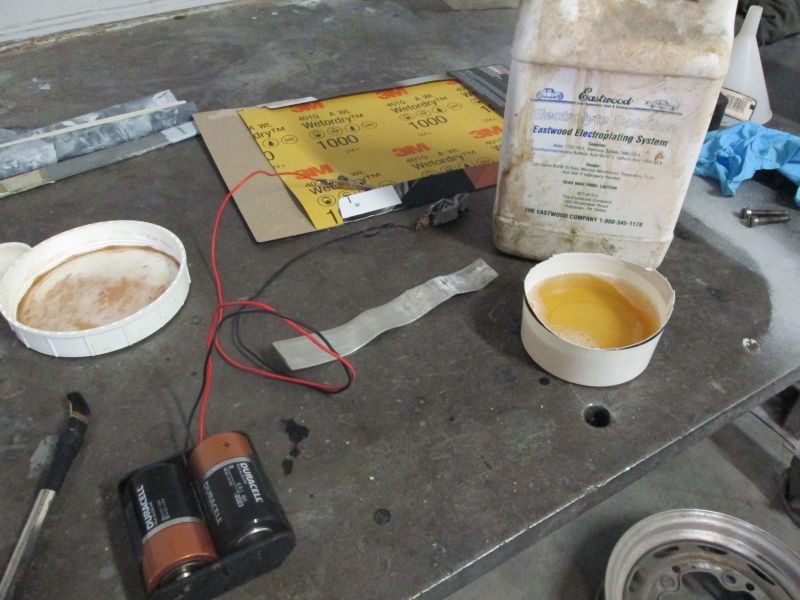

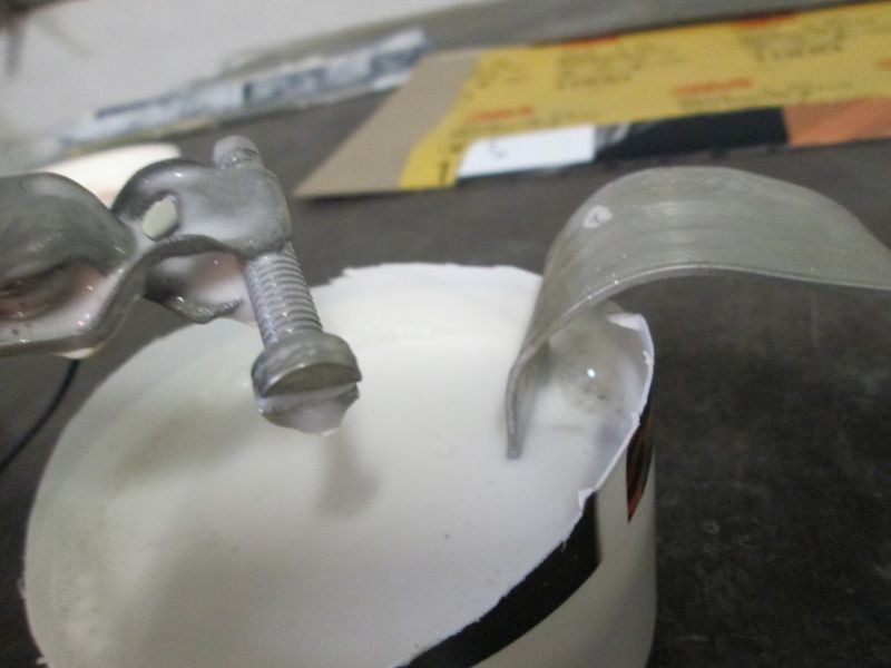

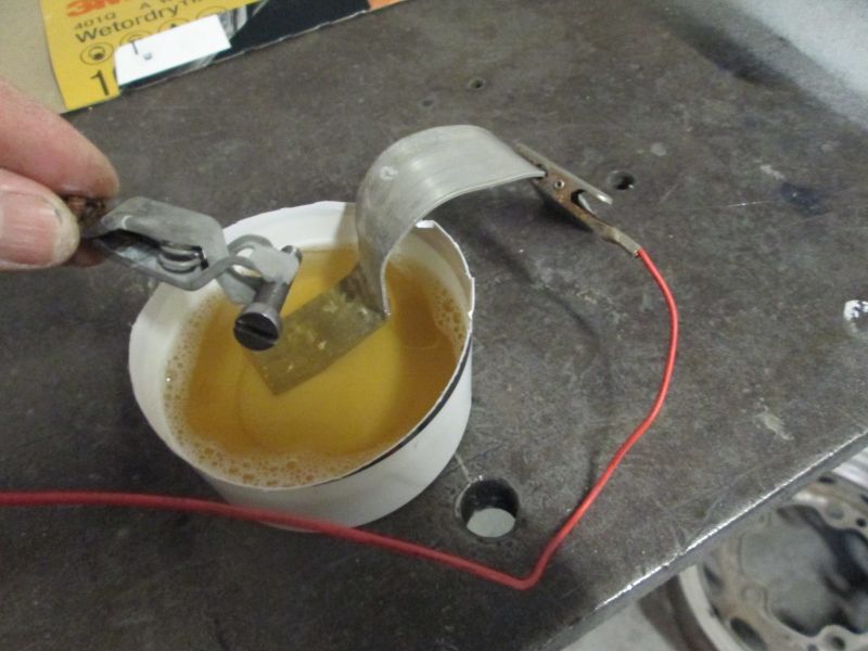

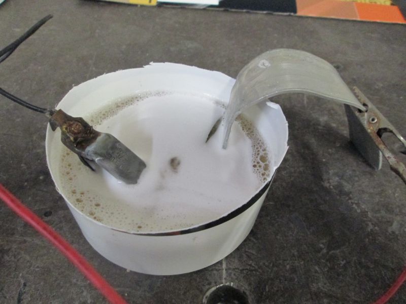

                              To save on expense and potential loss of hardware(lost several fasteners at the chrome shop in the past) I bought Zinc plating system from Eastwood. It actually does a pretty good job for small piddly stuff like this. Just needs a couple of D-cell batteries to power it.
                              Pretty simple, the positive wire goes to the Zinc anode and is partially submerged into my tiny electrolyte bath. Negative side goes to the part to be plated.
                              Part is now placed in the bath and plating begins. The current carries off the zinc which is then attracted to the negatively/grounded part. I normally leave it in for about a minute and sometimes longer. The longer it stays the more zinc accumulates and thicker the item is coated.
                              Parts usually have a smokey/hazy look to them after rinsing but a quick polish with a rag brightens them right up.

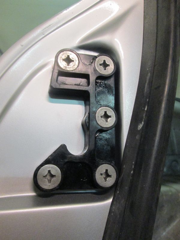

                              One original Door striker assembly with hardware cleaned and mounted for the last time.
