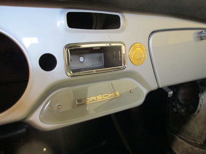

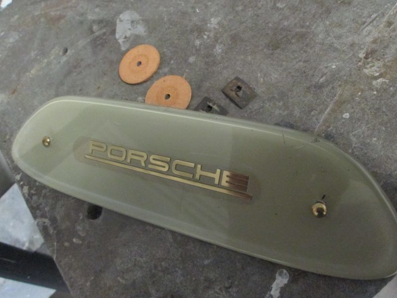

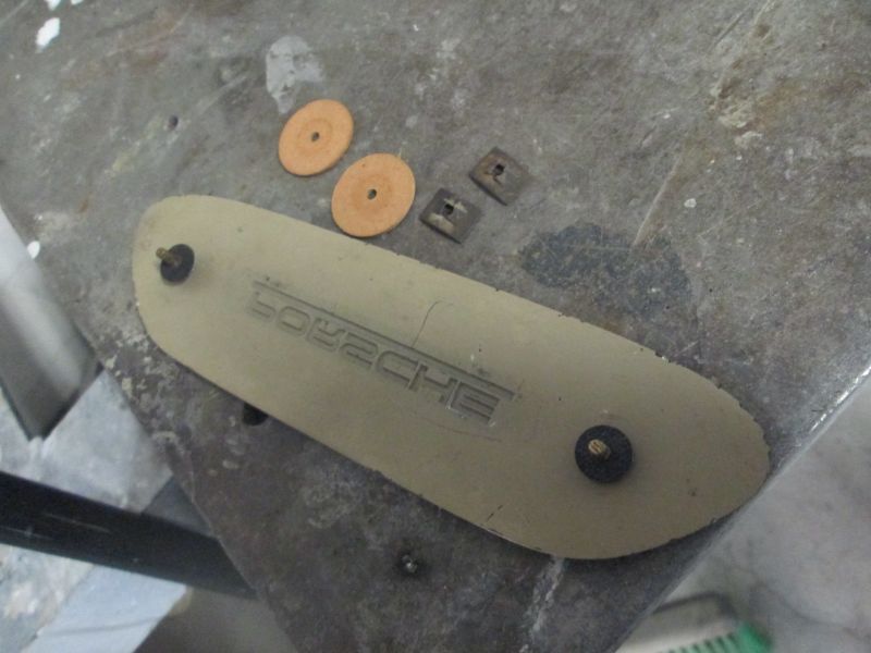

    A few years ago I found this original delete plate in good condition and in the hard to find color of grey/green to match the knobs. A few light scuffs to the paint but the plastic face polished up great. Note the hallo discoloration around the "Porsche". Must have been some sort of applied barrier to insulate the gold leaf from the paint. Its aged discoloration is now a great authentic tip off detail.
    I had rounded up original mounting pins. centering washers and clips through my other radio delete purchases through the years.

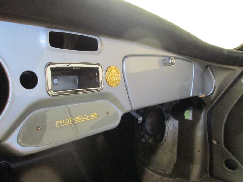

    Looks right at home. The dash medallion and the ashtray housing are original to this car and were restored by Victor Miles; he is so worth the money!
    It was extremely fun playing around with this but am running out of things to add before the headliner and harness take precedence.

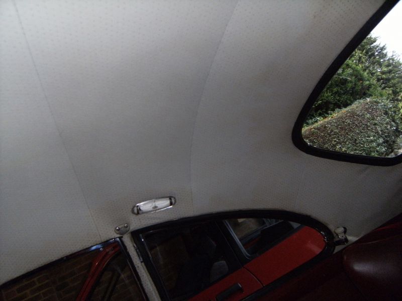

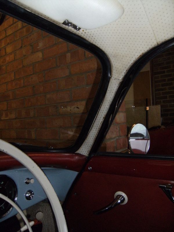

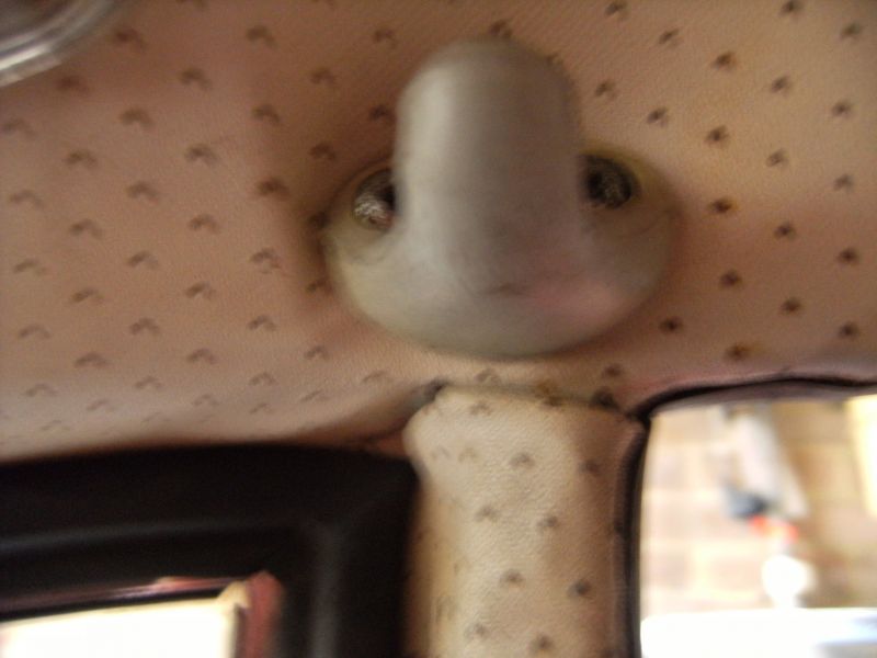

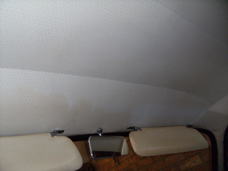

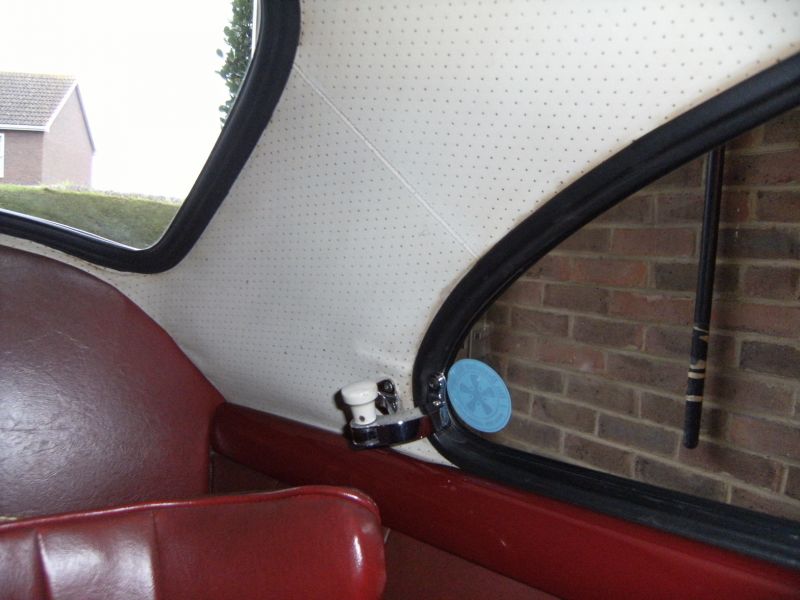

      • Justin,
        As you requested I attach 6 photos of my original headliner. Thought a few more might be useful to see how they did it back then. Please be aware my photo flash shows up every discolouration and made area's much lighter than they are as its much more a light tan colour than white now.
        Yours (or Jacks) assumption is so correct its a pin point texture for sure. U20152/RF is so close. Better explanation than mine!
        Remember the separate pillar pieces that look now so tatty on mine are on the central pillar at the bottom end covered by the red side upholstery. Probably that alone has kept it in place for 56 years. The front in places has lifted from under the original windscreen seal so make sure its under it! The top join on the front side pieces looks as though it could have been neater. When it was new I guess it blended well.
        For 36 years my car has been in an integral garage to the last 2 houses I have owned. So little condensation. Before that my first house had a separate garage and it was there for 10 years. I believe the foam in the front seat uprights and the foam? under the headlining was affected by that moist winter weather. I get powder from the seats and the roof at times. But... the smell is so 1950's
        it helps the originality if nothing else
        The pic's need no explanation below.

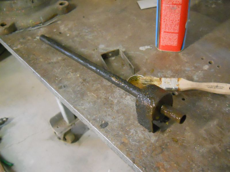

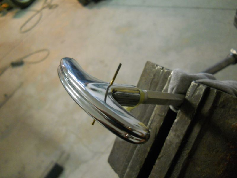

          T-handle along with the operating shaft/cable was sent to Victor Miles for chrome and CAD plating.
          Locating the hole for the roll-pin was a little dicey as I really had to crank it on tight to realign them again. I thought I was going to crack the handle but this is how it came.

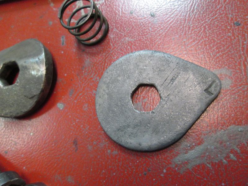

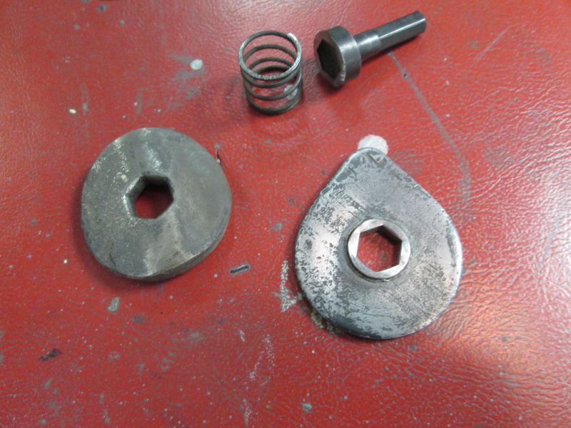

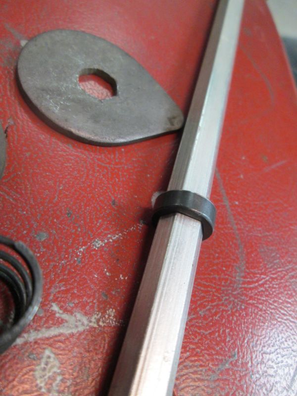

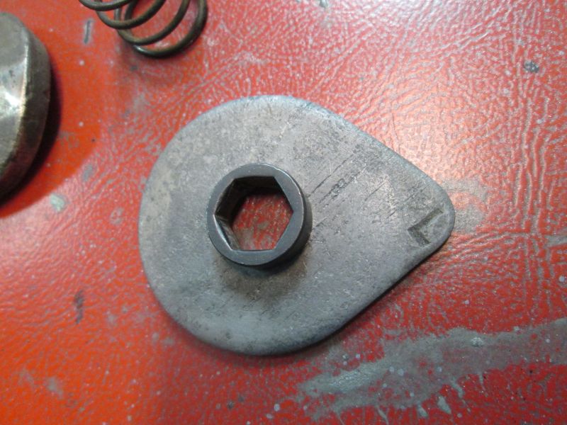

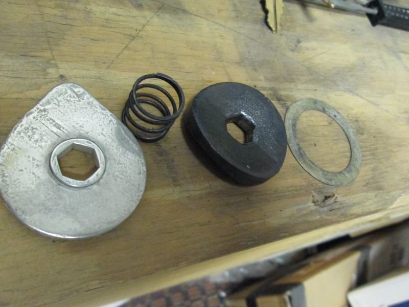

          A small holdup was the limiter washer hole was nearly worn out and was barely able to grip the shaft to continue doing its job.
          The idea of sacrificing one of my 10mm sockets soon came to me to repair the washer.
          It of course fit perfect and there was no chance of this happening again as this section is case hardened.

          Had to locate and orient the new piece with the tab ear then drill the hole to size.
          Had a really nice press fit
          and a few tack welds on the back. Its not going anywhere especially for what its asked to do.

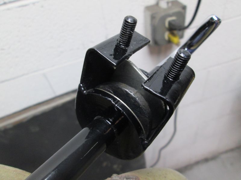

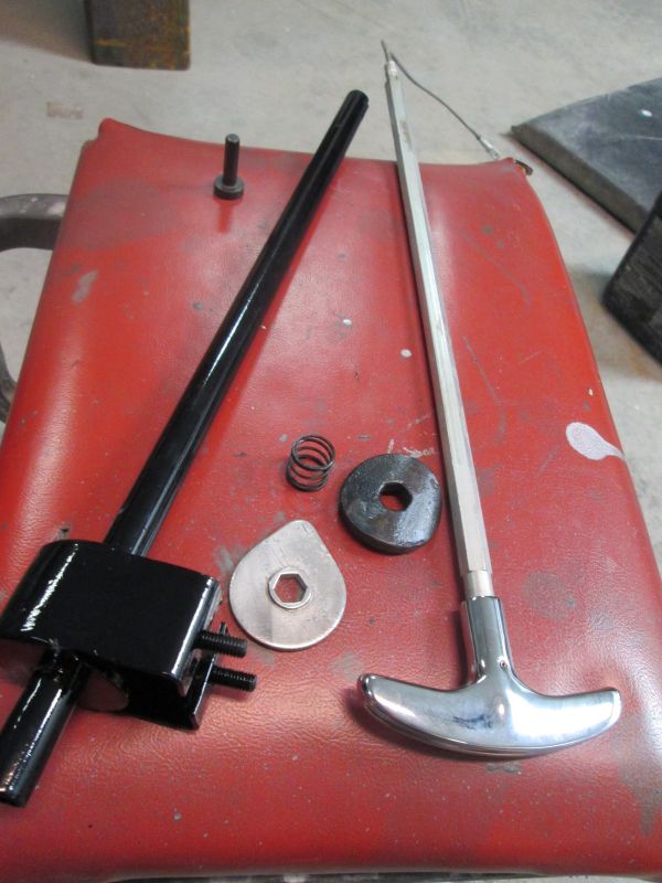

          Everybody's ready for reassembly.

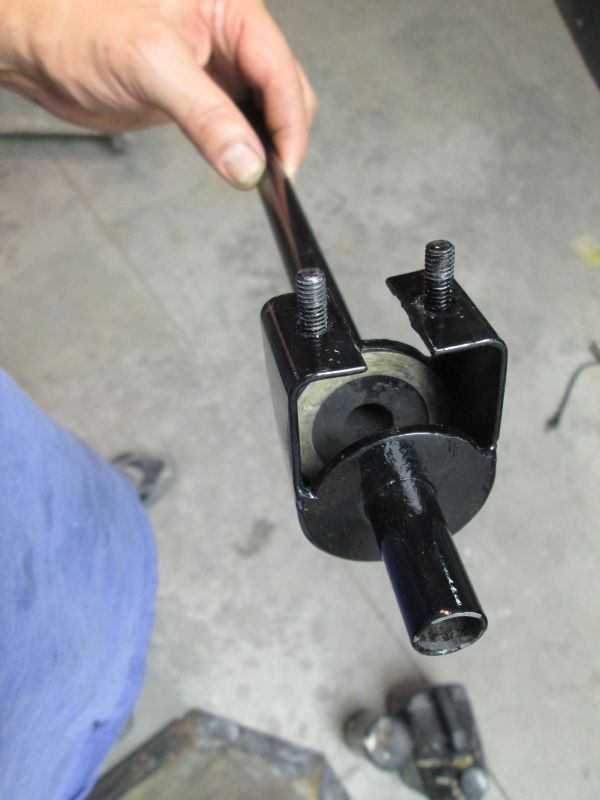

          Double checking the this little mechanism before I load it into the housing. Thanks for looking! Justin

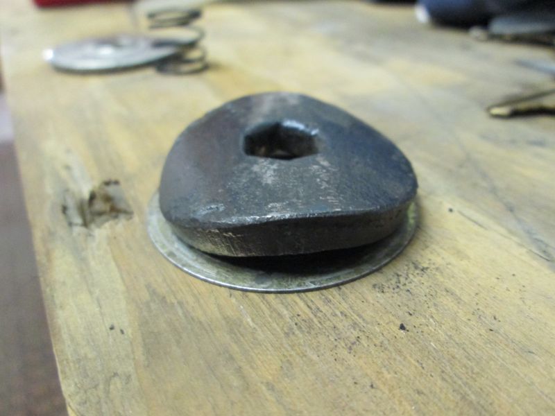

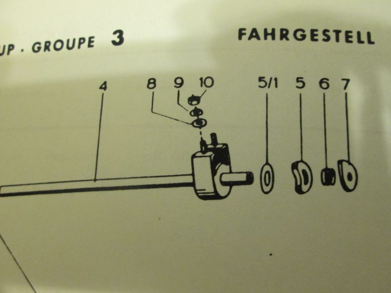

              • I don't see the thin shim.
                • OOH! Thanks for pointing that out Jack. I've had this unit and the one from my '56 apart and have never seen or noticed the buffer shim you described.
                  My '57 parts manual certainly confirms that there is supposed to be one. Maybe its stuck against the housing? I'll hunt for it tomorrow and make sure either way that there is one in there. Its so nice to have guys who actually know what their doing keeping all of us who don't on the right track. Thanks again! Justin

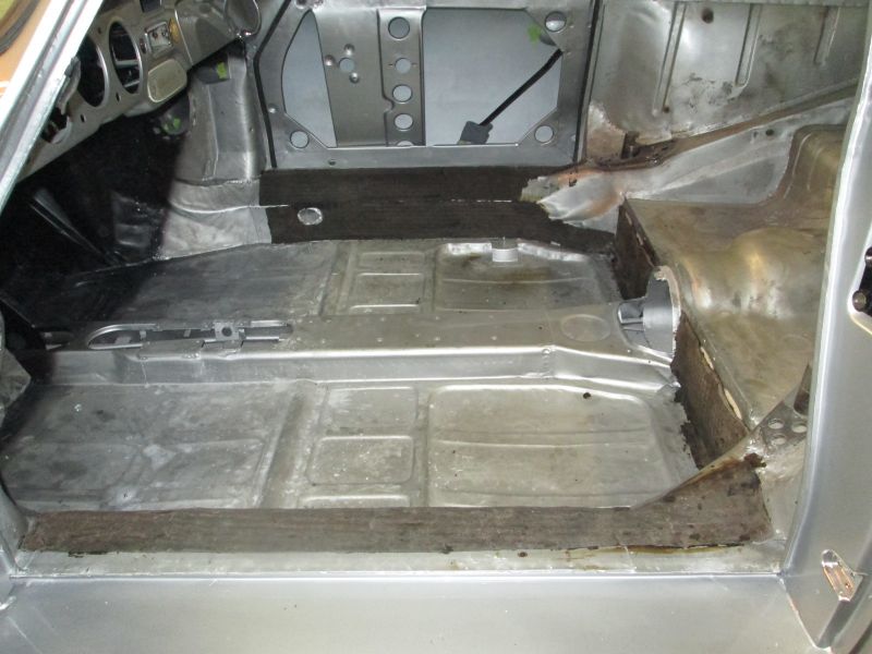

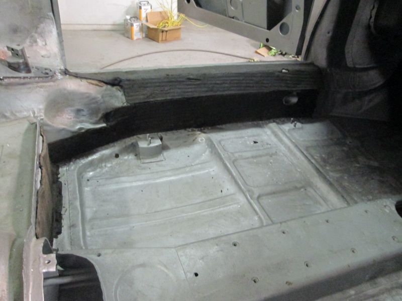

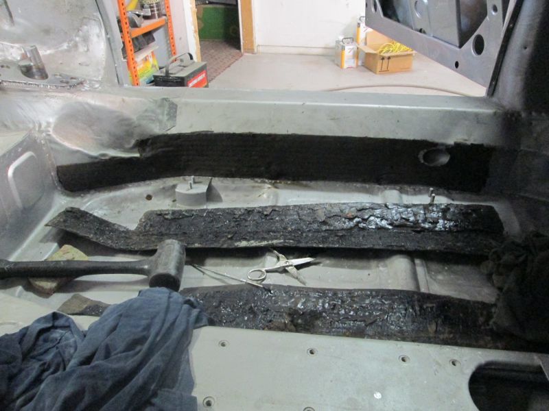

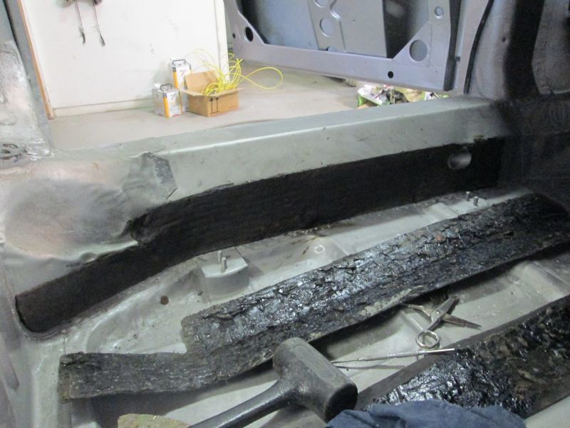

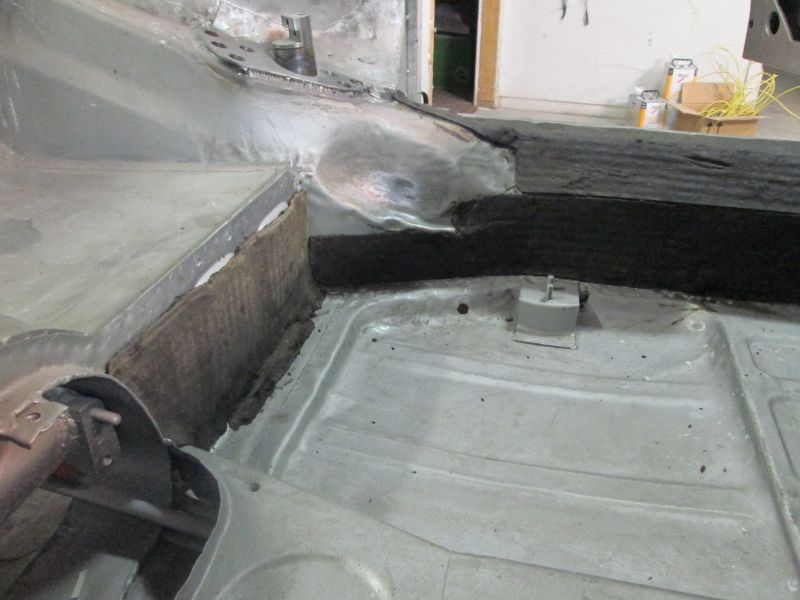

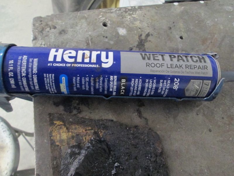

                  Installing a few original sections of sound deadener.
                  Bruce, is going to think I'm crazier than I already am but that's okay. My Dad always described 356's as having a unique smell to the interior. Aside from age and mildew I think part of what creates that ambience are the faint fumes from the inboard petcock and the Tar/paper sound deadener. To help recreate some of that old effect I decided to install a few perimeter sections of old original Tar paper I carefully harvested out of that '58 hotrod that was here some time ago.
                  I only got a few sections out in one piece I always meant to harvest more but I ran out of patience for it so these threshold and rear kick panels are all I got.

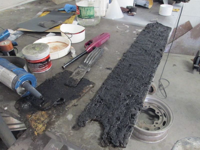

                  The residual tar on the back I was going to reanimate with heat but I also thought it best to bridge the adhesion gap with some fresh stuff. I found this asphalt based patch repair at the local hardware store. Its mixed with solvent so it can go on cold like calking then eventually hardens once the solvent leaves.
                  Coated the backside generously with it.

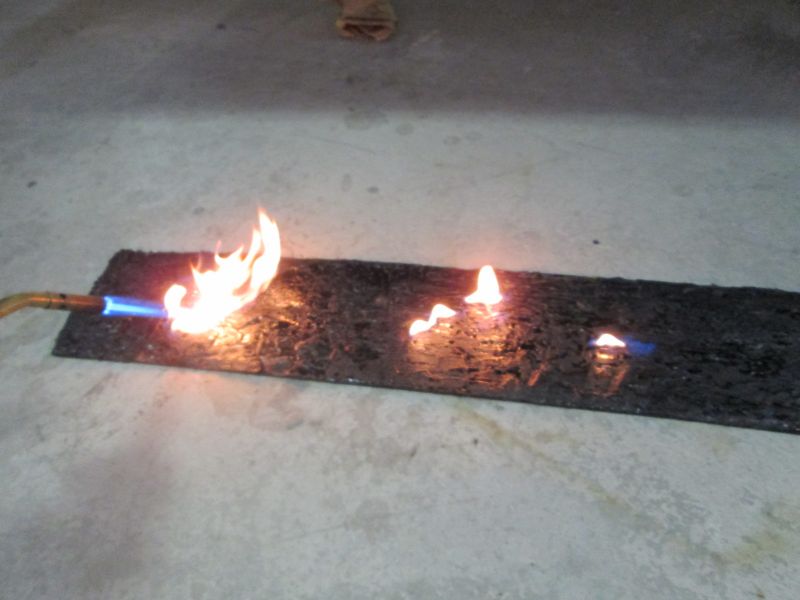

                  Once coated it was heated with a sort of controlled burn to get it all nice and warm and gooey. The solvents from the new stuff really helped this process along BTW. Once it was thoroughly hot I blew it out and quickly put it in place.
                  First section in. Once its up to temp the paper is very easy to mold and work with and very much had the consistency of a chocolate brownie.
                  Once positioned several smacks from my dead-blow hammer ensured good contact with the metal.
                  Threshold sections on.
                  along with the rear kick panel.
                  Finishing up with the right side. Silly effort yes, but they went on great and look original because they are and that great Tar smell that I remembered working on it as a kid is back as well too. Looking for that shim for the handbrake tomorrow.
                  Thanks for stopping by!

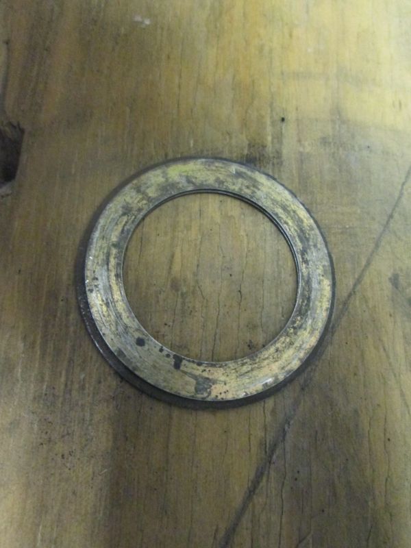

                        Searched high, low and in every box and bin at the shop today looking for the missing handbrake shim.

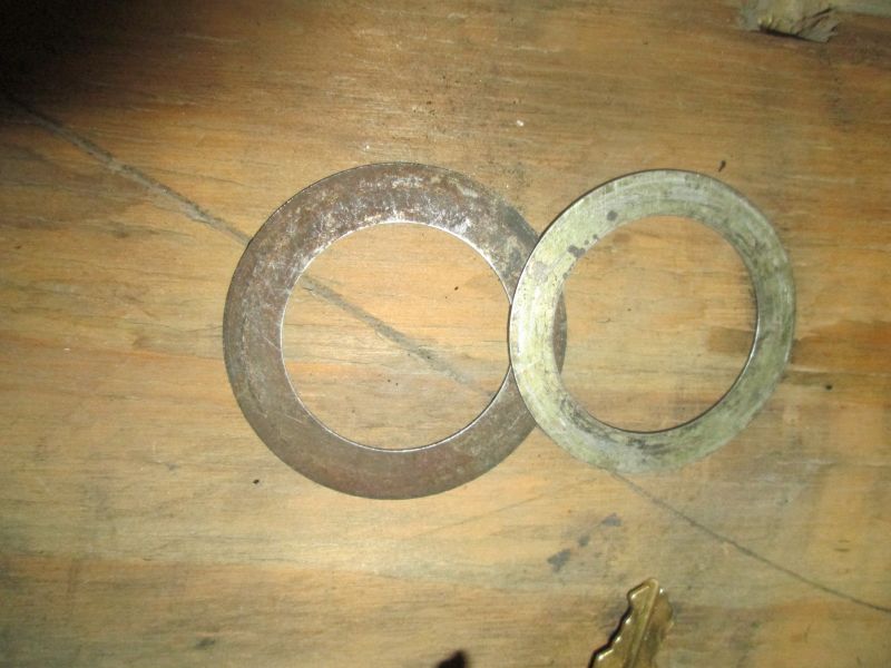

                        The closet shim I could find was a rear axle shim but the OD was a bit too big to fit into the housing. Then I found one a few MM's smaller in OD that fit perfectly in the housing but had a pretty large ID.
                        You can see here its a touch smaller which is what I needed.
                        Its a nice snug pressed fit in there though.
                        Though narrow it will still perform the job of giving the locking collar a surface to ride on. It will work and should last forever with the amount of action this unit will see.

                        Okay, time to put it together again.

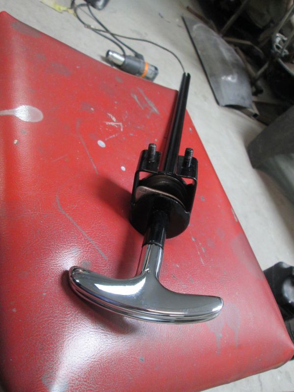

                        Assembled.
                        Ready to mount in the car.

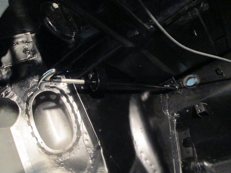

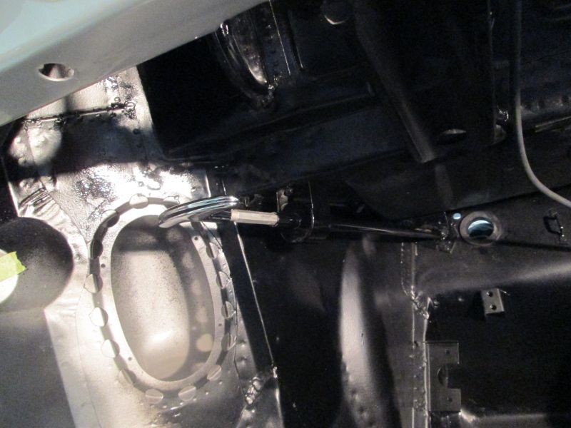

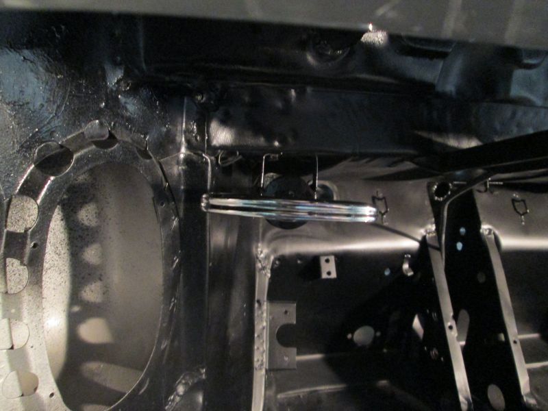

                        Mounted in for good.
                        repaired limiter tab maxed out against the housing wall with T-handle oriented in the proper horizontal position. So relieved that turned out right.
                        Locks and releases like its supposed to.
                        One more small component added making the car just a little closer to being completed. Back to color sanding tomorrow.

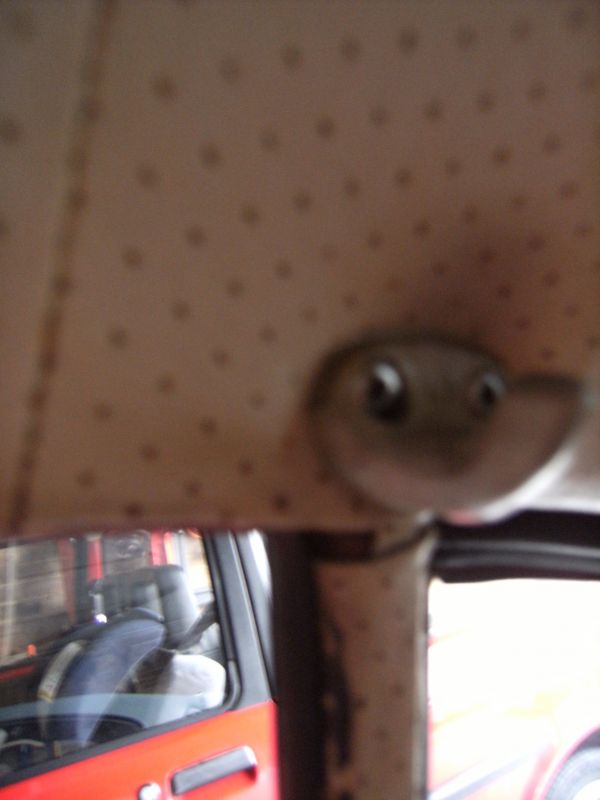

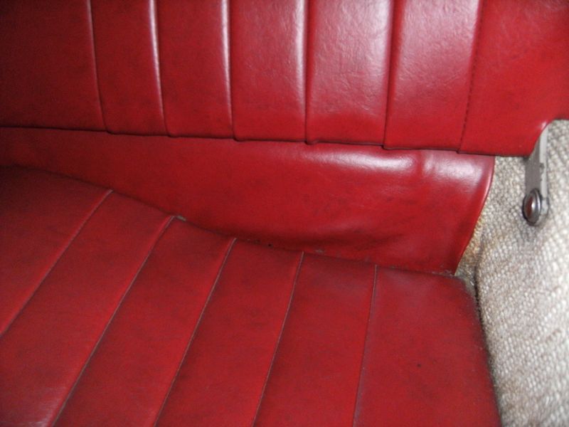

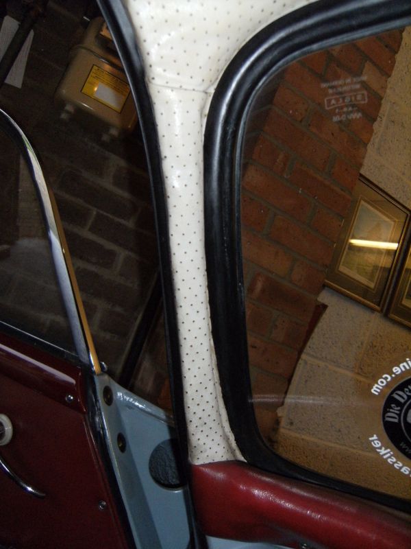

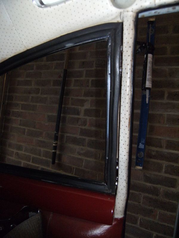

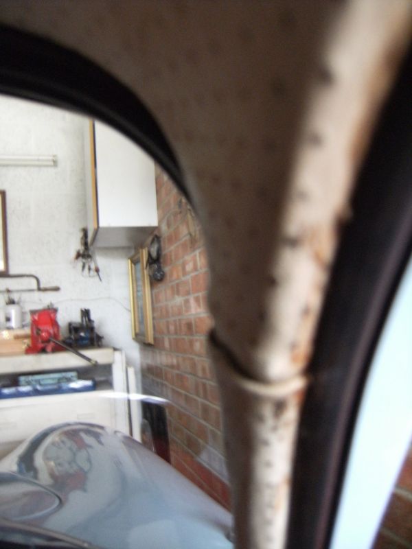

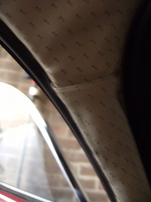

                          • Justin,
                            Have taken the pics yoy require for the headliner uprights.
                            I make some points below for you to reference against the photos.
                            1). first photo shows the windscreen right side upright. The upright is covering the top headliner. Note !!! the top join is folded over then stuck down over the main headliner. Over 53 years the stuck down piece on these uprights has sort of swelled up or come unstuck. The front windscreen side on the left(pic 4 ) is still stuck and looks flat and in good condition.
                            2). Please be aware the uprights sides are hidden under the seals on the windscreen and quarter lights. The bottoms captivated by the red upholstery on the bottom ends and the quarter light hinges. Look for the screw holes before sticking it down just to make it easier to fit tghe hinges.

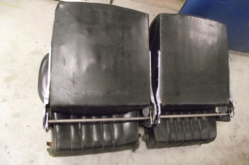

                            3). The red back seat has nothing to do with the headliner (pic 5 ) but please note on t2 cars the space between the seat bottom and the seat upright has a vinyl insert not carpet! Seen so many cars with new carpet there! Maybe T1 cars did have carpet you should check!!

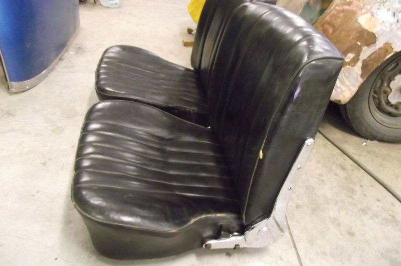

                                I scored this original pair for this car some time ago.
                                As they are nice shape and the right color I see no need to ever recover them unless the stitching gives way. However, these will end up in storage as I'll be running GT seats in it for the most part.
                                Thanks again guys! Justin

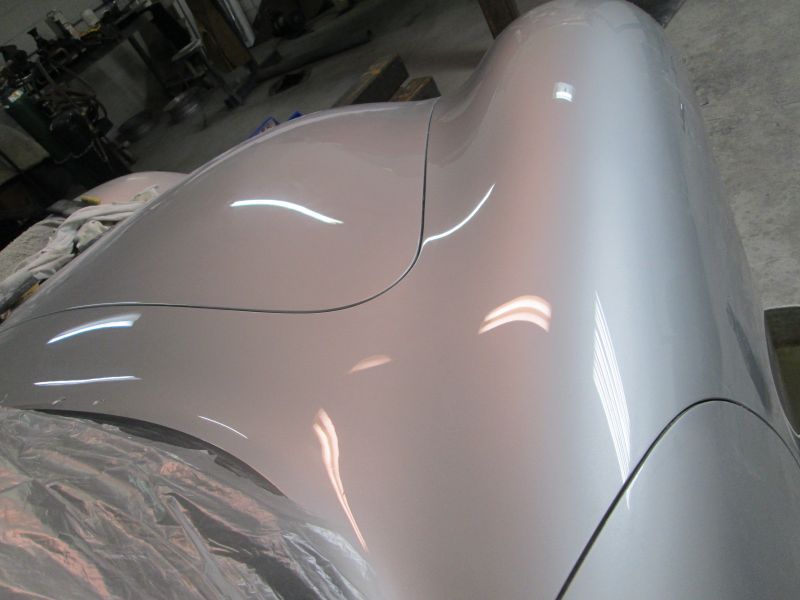

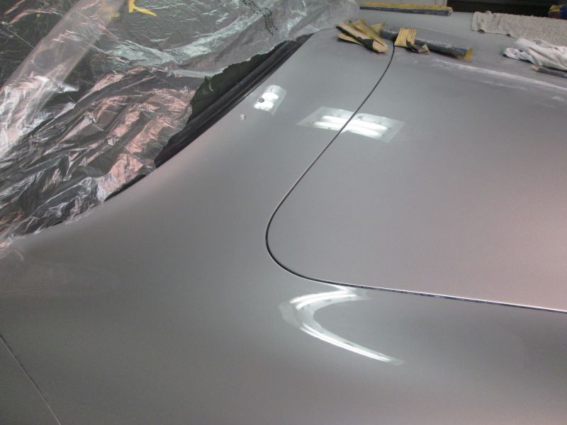

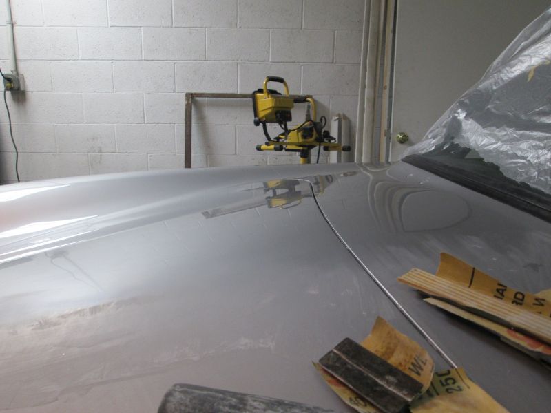

                                11/9/15
                                color sanding progress

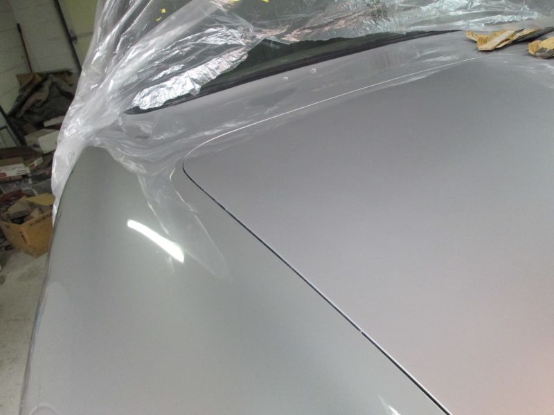

                                Proceeding very slow and carefully but the right fender, hood and cowl area are blocked and initially polished to my liking.
                                Finally got the clear reflection I wanted after several rounds of sanding, polish then resanding the areas I wasn't happy with, then maybe doing it again for a third or fourth time. This is partially why its taking me so long. Rick definitely put enough clear on; thank god.
                                The florescent lights are tough, You'll find more blemishes and mistakes in the paint then you ever will in sunlight.
                                doesn't give the feedback of a dark solid color but you can make out the clear details of the plastic's reflection in the cowl's surface.
                                Gradually moving on to the left side next. Thanks for looking!
