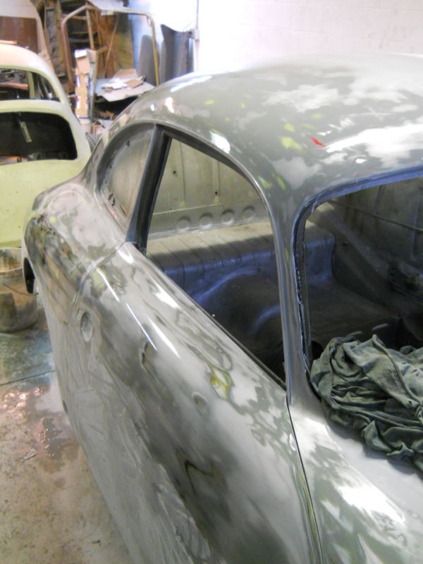

  • I know Mark, I'm beginning to question my sanity. Since I am following my painter friends advice to use a sealer before final paint my game plan has changed a bit. I am now compelled to thin this work out as much as I can to make way for it.
    Thanks Jack, yes, this area along with the back of the decklid and hood hinges were just brushed in as well.

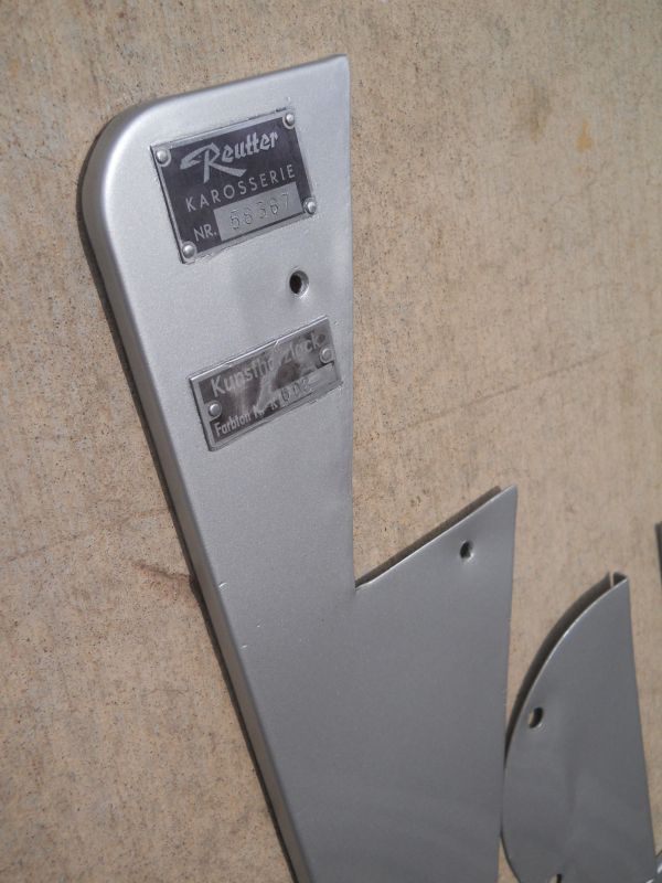

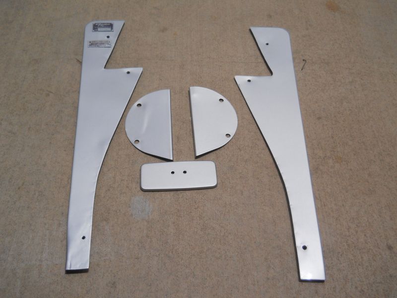

    Blocking continues and finishing out small loose parts along the way that need to be silver.
    All that remains to paint are the body plugs and the access cover for the steering box. Only the big stuff will remain after that.
    Thanks for looking! Justin

      • Looking quite nice, Justin!
        FWIW, the D plates for the upper trans hoop bolts were sprayed black enamel, with no metal prep, at least in my experience.

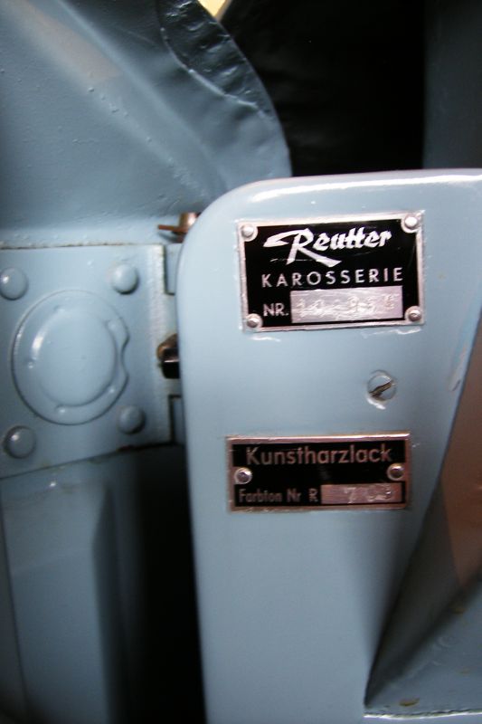

        • Justin,
          I presume and hope the Reutter chassis and paint colour plates will stay riveted in place and you will mask them? That will be then just about the only remaining part on your car where the original paint is still underneath something
          I have never removed mine and for the first time my items look less faded than yours Go on blame it on the Las Vagas sun!

          • Very neat and clean after all these years Roy!
            Sometimes there isn't any sun in Vegas.
            I heard they had a monsoon last Monday, the day after I left town!

              It always rains in Vega for me!!
              • Thanks Mark, so close yet so far.
                Thank you Jack! Yes, I do remember these plates being in just flat black with no primer as it was peeling off in good sized chunks.
                Hi Roy, yes the original paint still lurks under those ID plates. Now that you mentioned it I'm a bit curious as to how close this new color they are in matches with the original. I guess I'll never know...
                The ID plates have definitely faded a bit as this car was not pampered like yours and was exposed to the desert elements for the first 35 years.
                Yes, the summer time here is our monsoon season and the cloud cover provides a welcomed break from the direct summer sunlight, however the trade-off is higher humidity. Thanks again you guys! Justin

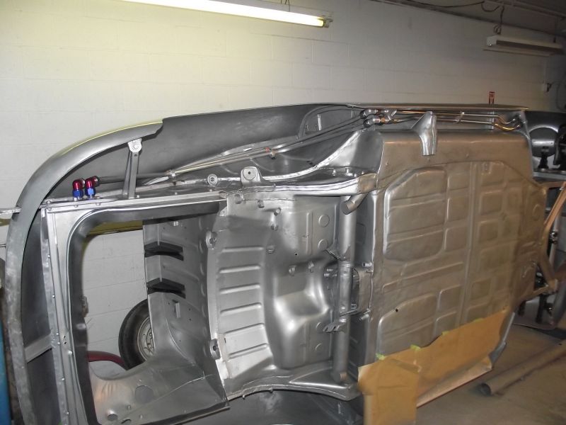

                              I'm going to run its stock Carrera oil tank and will plumb it to reach over to the other side of the motor. If this was a push-rod car originally I'd have used the 911 tank which mounts on the correct side of the car for this engine but this car already has a tank so I'll have to make it work together.
                              Oil lines for the system are 18mm
