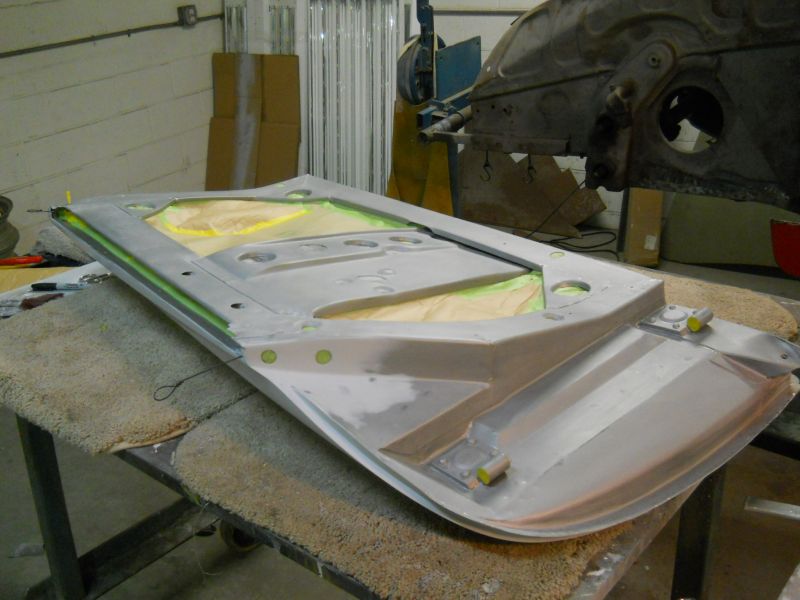

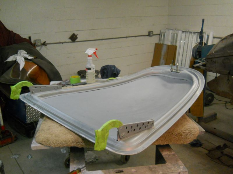

    Hood taped and all final sealing and finish sanding done.

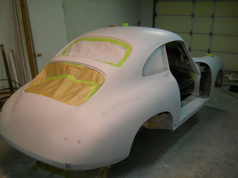

    This is where most of this last week went. I ended up stripping both door wells back down to metal. I was going to just sand and scuff them but as I did I noticed the clear coat was still soft. I painted these well over a year ago so I messed up on the catalyst. Anyway, I just could not risk this area wrinkling up as this anticipated final paint goes on. I've made this mistake too many times in the past only to watch it begin to crinkle as the solvents went to work. It was a total pain but I just couldn't risk it and besides this does keep the paint thicknesses in check which I like.

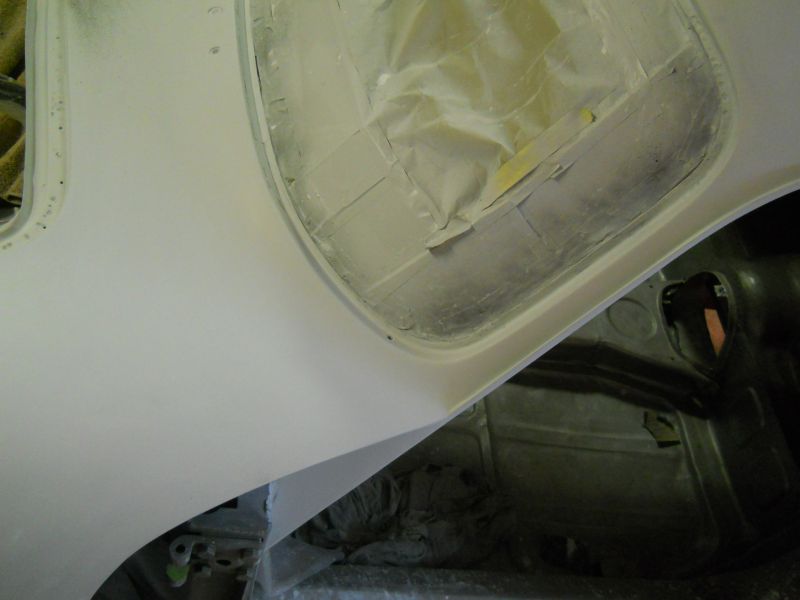

    Wells primered and am in process of smoothing out the A-pillar and door jambs here.

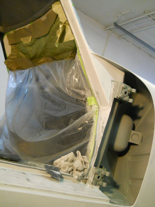

    Lots of time burned on all the facets all the while trying not to sand through.

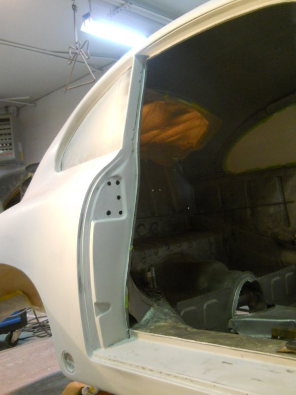

    Lots of time spent truing the edges, smoothing and trying not to sand through.

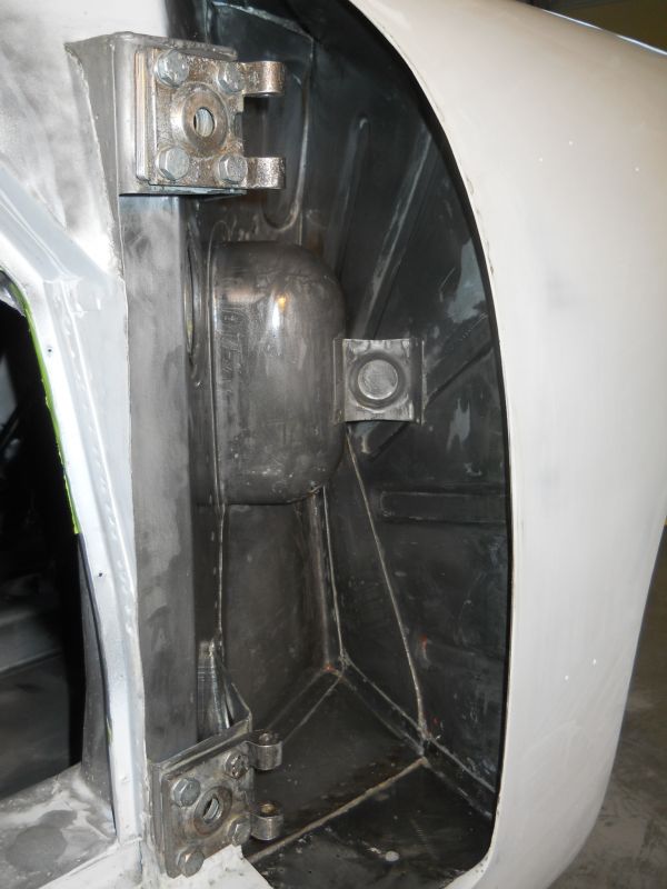

    Sanded through on the lower rolled edges as they were very thin so I had to reseal both front and back.

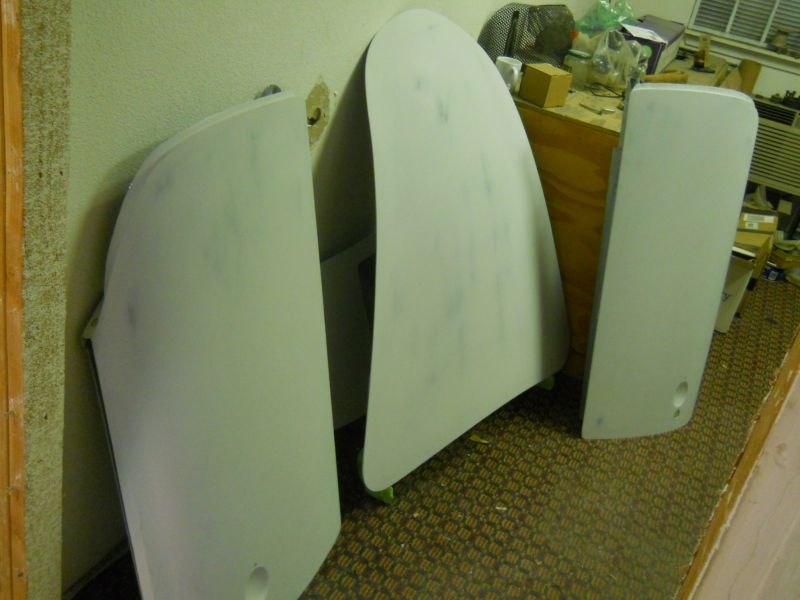

                    All the closing panels are officially ready as of wed. evening.

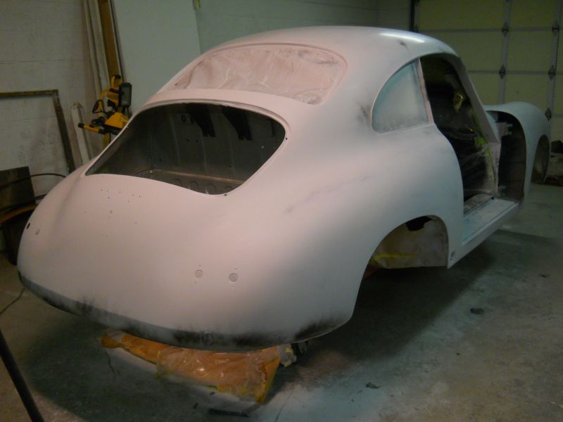

                    The final sanding on the shell was completed late this afternoon then I came back after dinner to begin remasking it.
                    I've got the trunk, door openings, and lower skirts to go then a final once over inspection just to make sure but come hell or high water I'll have it knocked out before I close up for the night tomorrow.

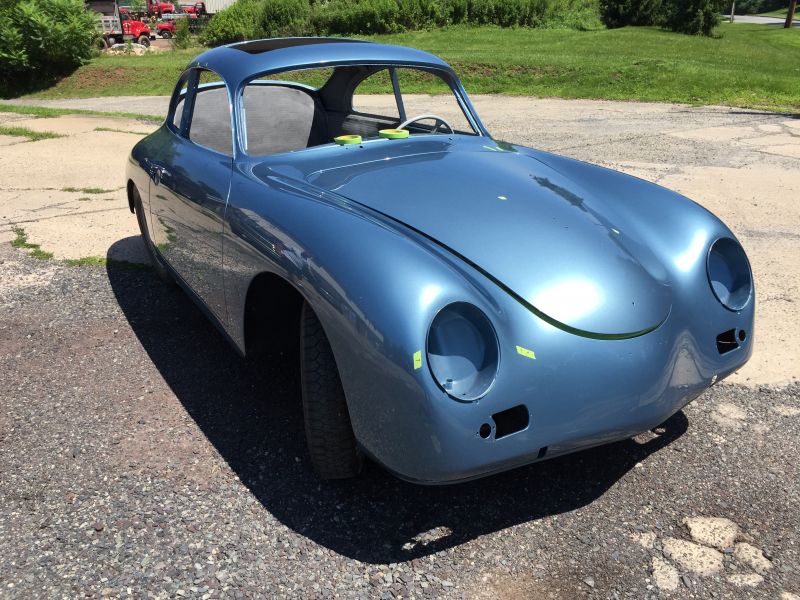

                        I didn't want to paint this A at my shop 'cause my usual space was filled by another job, so I asked a neighbor who owns a collision shop with a nice booth a half hour away if he'd paint it for me as a sub. He is a 911 guy, but he jumped at it. He had gotten a new SATA gun ($900!) and was anxious to try it. My guys went to his shop to prep the car and mask it and he sprayed it. I went over after a bake to get it and saw subtle "tiger stripes" in the base as you describe so well.
                        He couldn't imagine what went wrong, so I suggested he see on a piece of masking paper how his new gun's pattern looked.....and sure enough, it was a defective nozzle (not adjustment) that made the ends of the fan heavy and the center light. $900, huh?
                        I brought the car back to my shop, we had a "sanding party" and sanded everything down with 400 to the base, set up my area (a real time-consuming PITA) and Ed sprayed it again.
                        Should have done that the first time. Live and learn. (The green tape is to note dust specks to nib carefully prior to 2000 grit.)
                        With added materials and time, my neighbor and I each lost a ton of money, but the car is better for it (with the world's most expensive primer coat) and at least he learned the hard way to use my shop motto= "assume nothing."
                        Then again, I'm sure I am the only one on this forum who has this record of bad luck and poor choices...and YOUR Coupe will be just fine with NO drips, runs, sags or errors...right?
                        Seriously....good luck and jus' git 'er done. Have a good "birthing" regardless of who pulls the trigger...or the zip-tabs. "Stress kills"....a great paint job.
                        PS, the biggest PITA was really getting that Aquamarine blue metallic to look 'right.' Thanks to this site's help, we were able to satisfy the 30 year owner's color memory.
