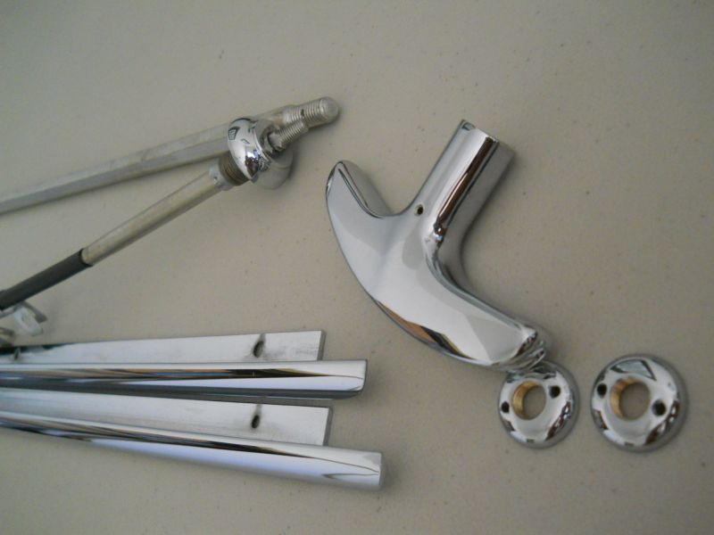

      Parts group back from restoration with Victor Miles.
      Just received that small batch back from Cad. and chrome plating and of course Victor came through once again.

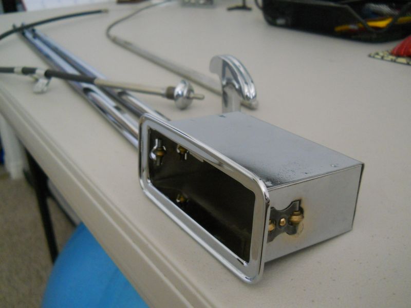

      Ashtray came out beautiful. Victor was telling me this was the nicest and best preserved T1 unit he had seen and really hated to replate it but it had surface rust on top and I had long ago cleaned it in acid stripping off the remaining cad plate and the chrome off the bezel which was now down to the nickel. So it had to be rechromed.
      T-handle came out perfect along with the outer door trim and these dash bezels.
      Perfect reflection with no wheeling marks. Edges, corners and contours all preserved. This is why you have to step up and pay for the best. These parts are too valuable now to leave them to some local production chrome shop. I've already been through the anger and heartache of that experience. Thanks for stopping by!

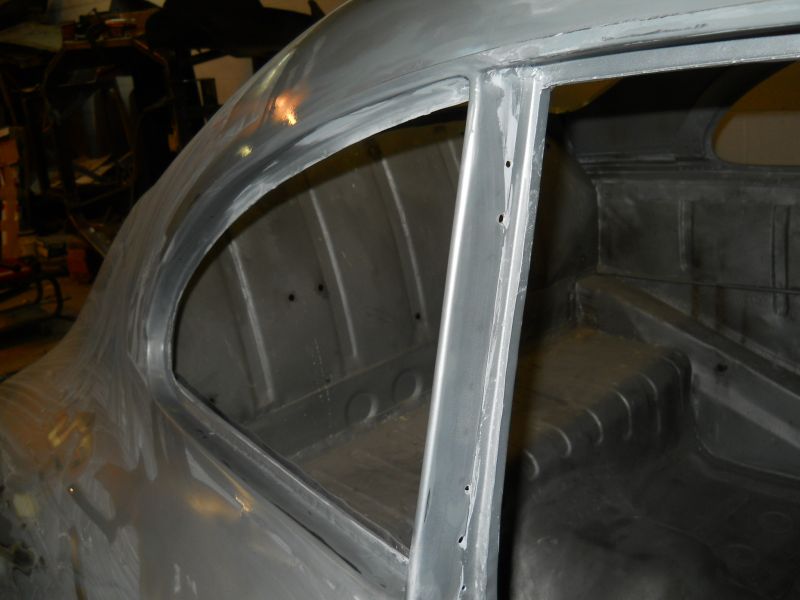

      • 6/22/15

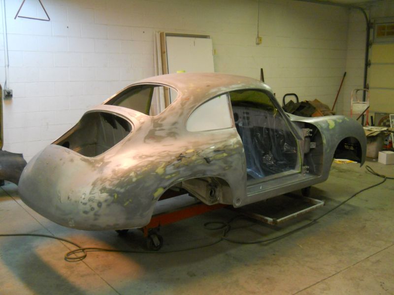

        Prepping all the piddly areas for final sealer.
        Major sanding pretty much complete and am now down to all the surface areas that most won't see or even care about.
        the unpleasant job of sanding the lower skirt. Requires laying on my side being soaked in sanding sludge.

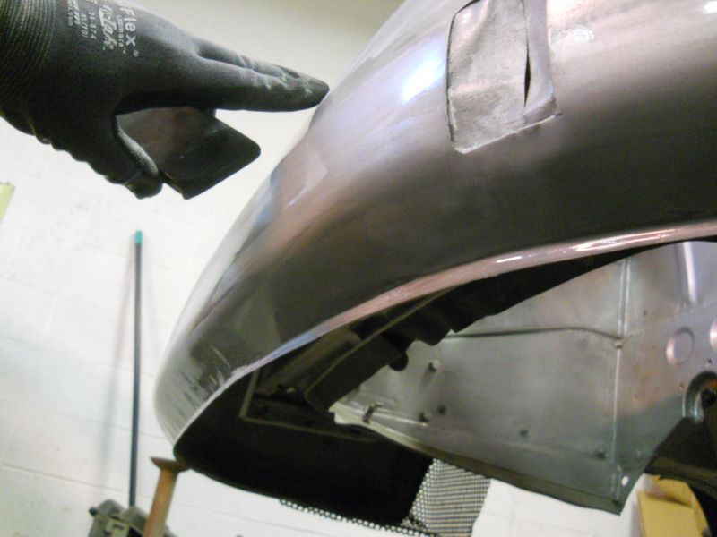

        As you can see I left this final turn a little wavy and choppy. I wanted no excess filler here as it leads a tough life getting dinged up by road debris or an exhaust system. Hard to see this area once its on the ground anyway and not trying to pretend this is a freshly minted body. She's an old girl with a few stretch marks.

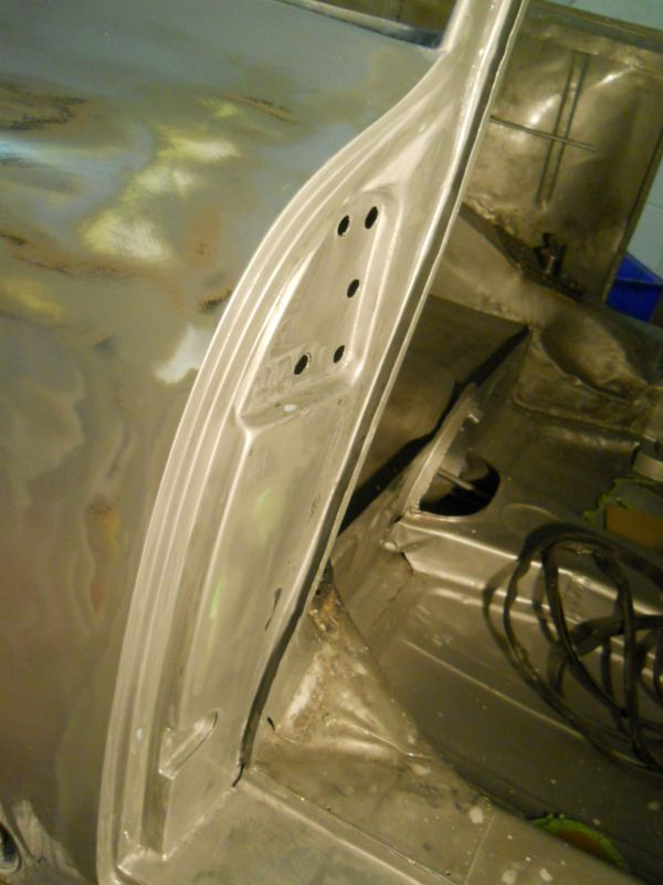

        Blocking the gutter face and window opening ledges.

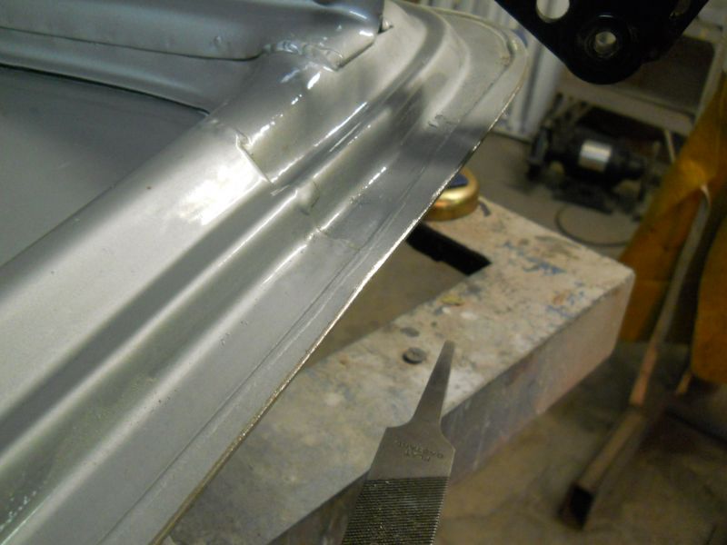

        Then onto the strikers. Had to really watch myself around that last step next to the skin as not to sand too much changing the door gap or surface profile.
        Nothing exciting yet, just a lot grunt work before the big pay-off.

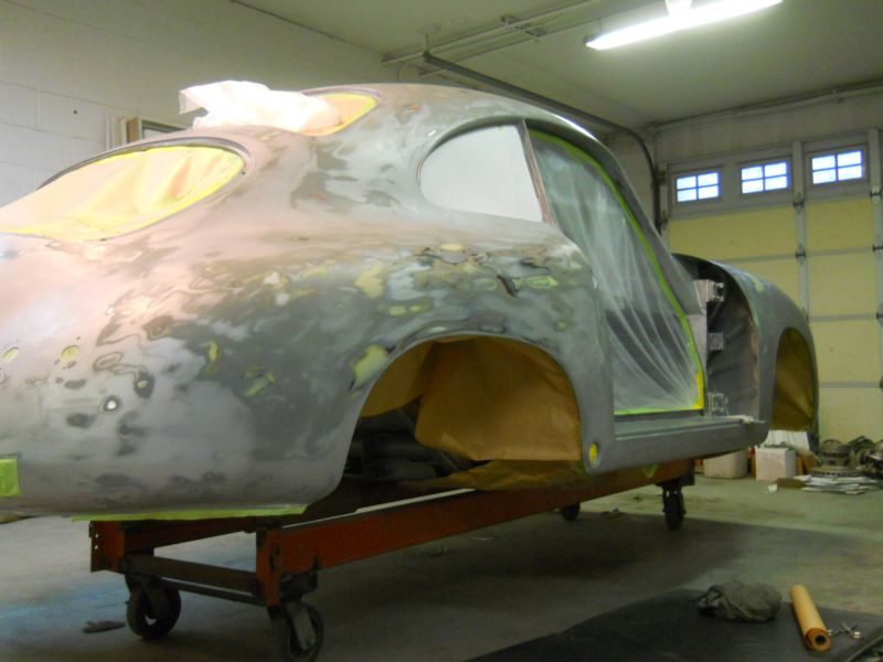

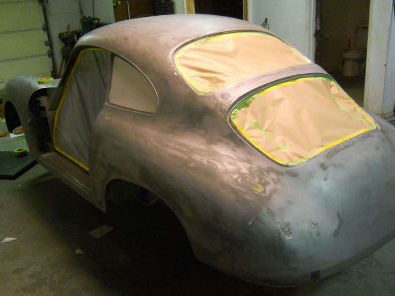

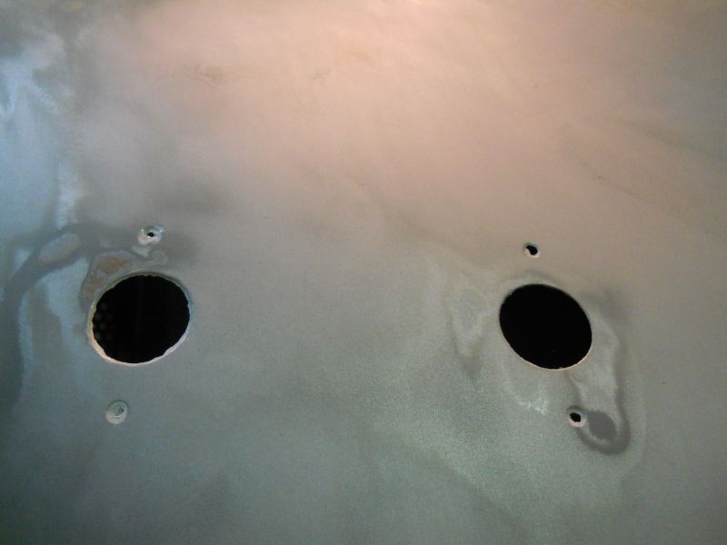

            Began by masking off the cock pit. Double masking that finished dash just in case there's a breach somewhere to the outer barriers.

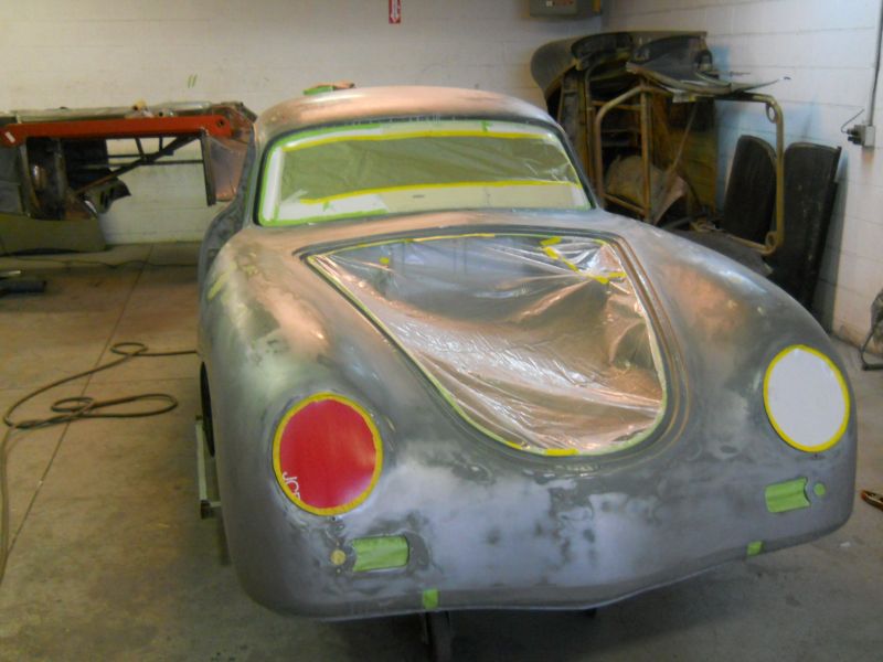

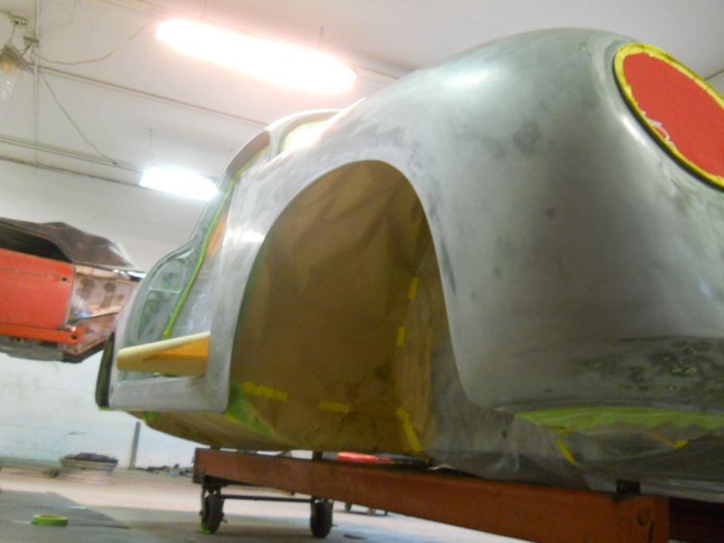

            All body openings masked off.
            Retaping all the holes and filing away any excess material as it goes.
            I have several solid hours in masking with only the bottom and wheel arches left to skirt. Thanks for stopping by! Justin

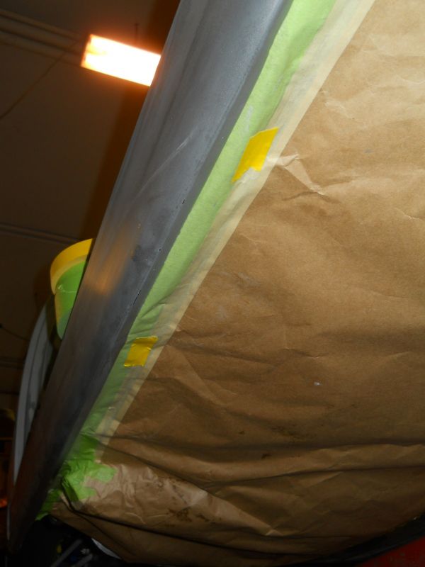

                Masked the wheel houses in close to give Rick ample room to get his spray gun in there to get the entire wire rolled edge.
                Front is sealed and am working my way around back.
                A total and complete time consuming PIA but the underside is almost masked off. I figure I have at least 6 hours just to get this far. Had to take it slow over several sessions to keep my sanity.
                Thanks for looking! Justin

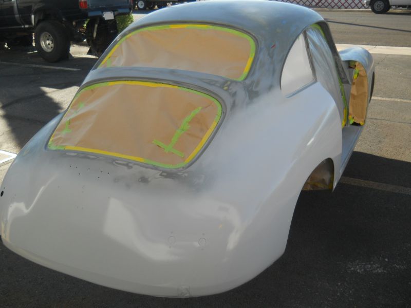

                  After several labor intensive sessions off careful masking I finally had the body completely back taped so the final sealer could be applied.
                  My buddy Rick, was nice enough to come over and shoot it on for me too.

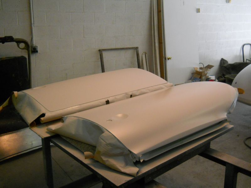

                  Had just enough time to tape off the doors so they could be done but ran out of time to get the hood and deck lid in. I'll seal those up later this week.
                  Sealed! Well, the next time this thing gets painted it will be for the final time. I can hardly believe its so close now. Begin blocking it down (for the last time)this week. Thanks for looking! Justin

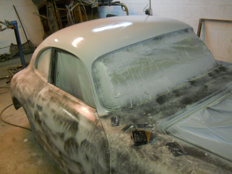

                  • 9/9/15
                    Final blocking of the sealer coat.

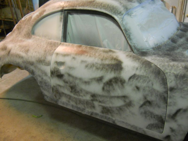

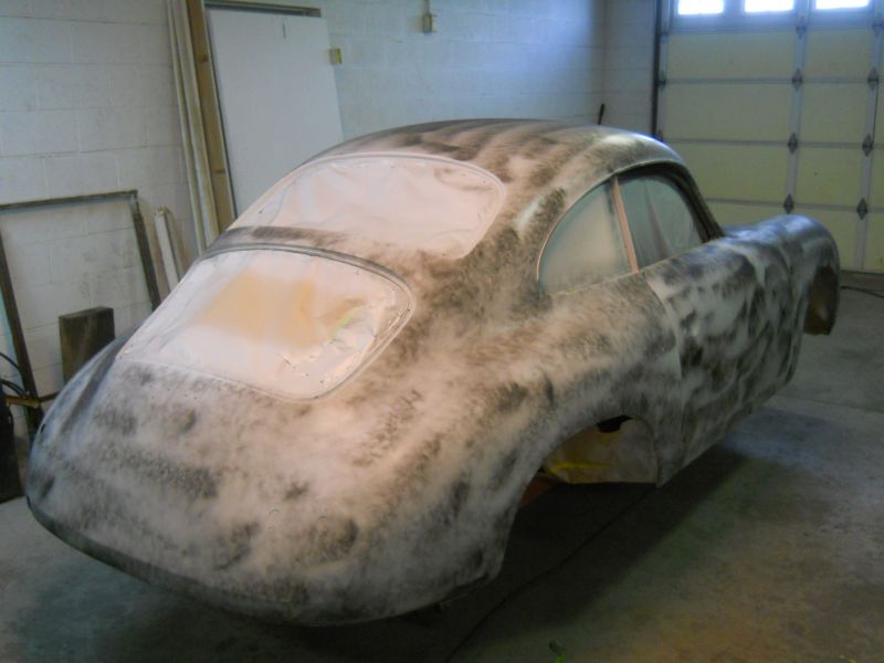

                    guide coat applied in preparation
                    Doors remounted with latch and seal. Not exactly necessary at this point but I wanted to make the extra effort to ensure that the reflection stays true across the door gaps. I've got way too much time invested here to risk sanding them off the car only to have them change shape on me at the edges. This also allows me to open the gaps back up for paint thickness since I've chosen to cut them to close.
                    Lid and hood will also be mounted for the final once I get them in sealer.

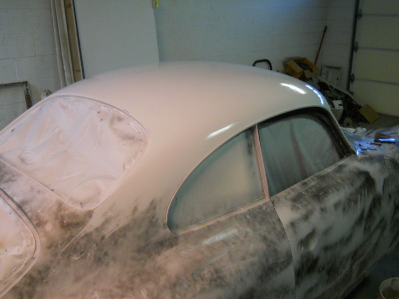

                    In the mean time I began with the roof.
                    A lot careful sanding time spent in and around the gutter and A-pillar shapes. My two basic goals are to carefully level it so I get one more crack at getting this body just a fraction straighter than before and to thin this material out as much as possible without sanding through. Back in it tomorrow. Thanks for looking! Justin

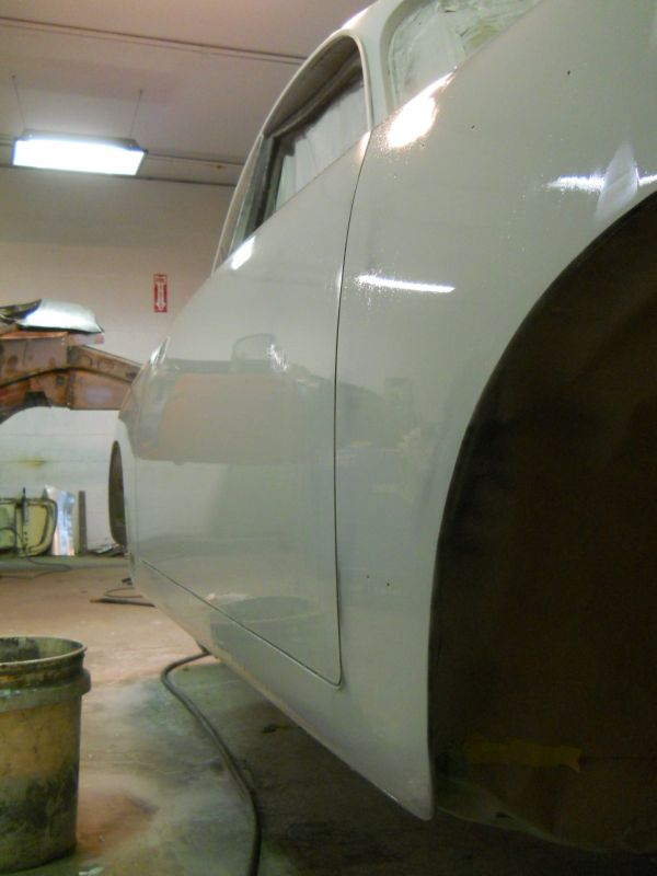

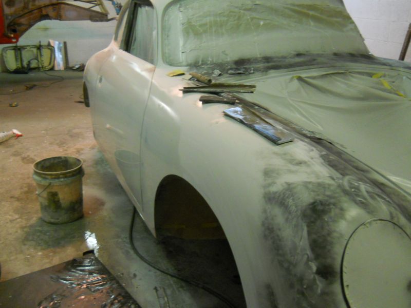

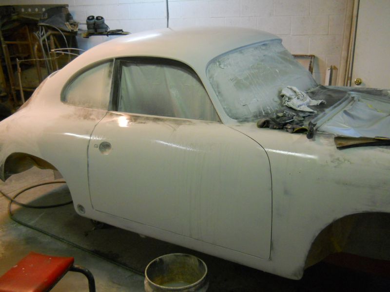

                            9/10/15
                            Right side final blocking
                            Roof is officially done now so it was onto the right side of the car this afternoon.
                            Didn't have the luck I had with the roof and went through along the edges in some spots as it progressed but it will only need a light fog coat before paint.
                            Pretty much down as far as I can chase it. Still seeing subtle rolls in the reflection at times that I could easily obsess over but I quickly remind myself that its time to let go and move on.

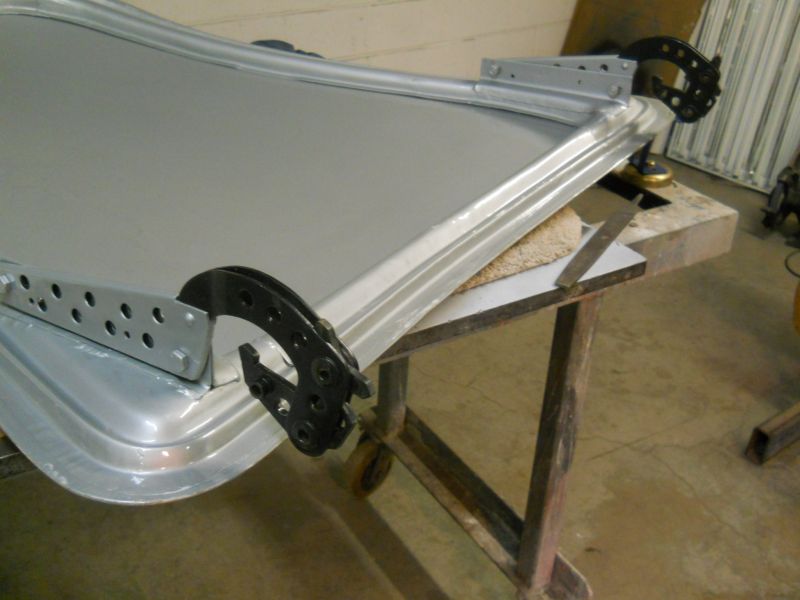

                            Prepping the hood for final sealer as well...
                            Again since I've cut the gaps so tight I have to make slight adjustments along the way. I'm carefully filing the underside edge to buy a little more needed clearance as the hood articulates on its hinges. Doesn't need much removed but it does need some.
