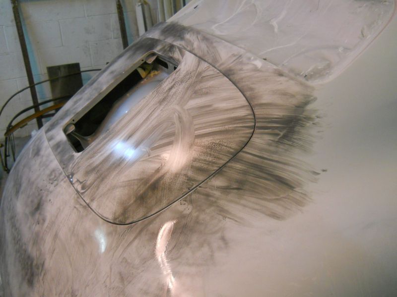

                9/13/15

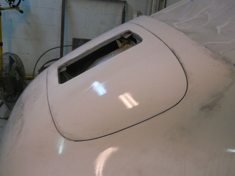

                More final sealer prepwork.

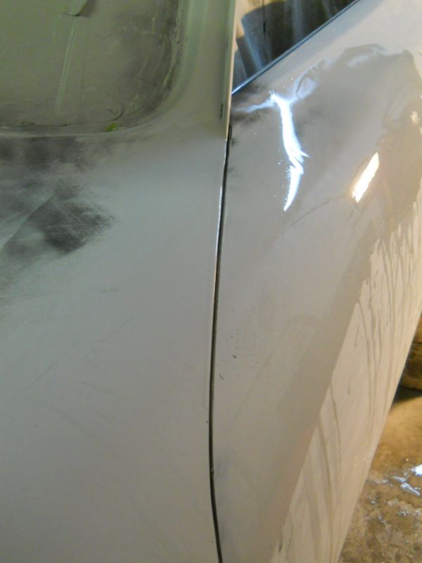

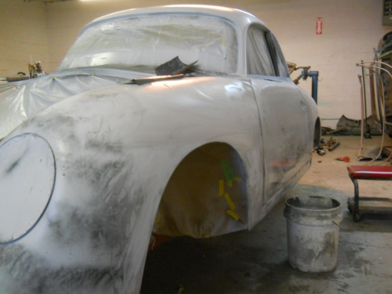

                A good session spent slowly opening the edges back up to make room for paint thickness.Now that its all one uniform color it was easier to spot a few irregularities in the line that I over looked. the gap narrowed a bit too much as it approached and wrapped around the gutter and A-pillar. Had to slowly and carefully carve it out one swipe at a time.

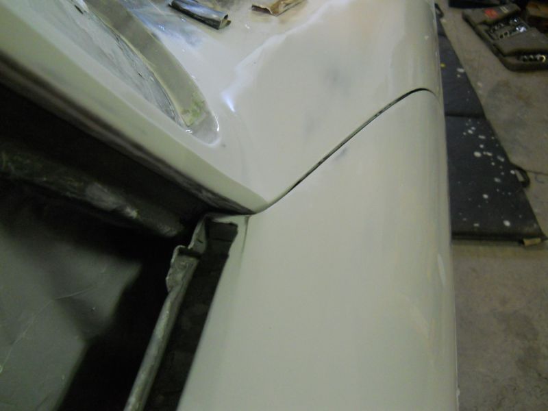

                Trickiest part was shaping the turn around the pillar all the while not taking off too much and creating more work for myself. I'd already screwed this up several times before.

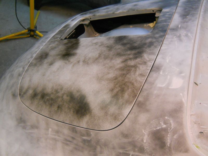

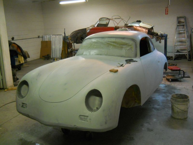

                With the right side set I moved over to the left to both open it up and match it to the other side.

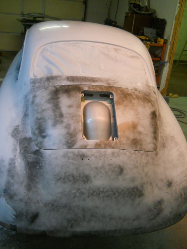

                Here's another low-tech tool for the job. Just a bondo spreader stuck into the gap for one tedious swipe at a time. The paper is not wrapped all the way around at this stage. I only want to be cutting one surface at a time which is now just the door side of the gap.
                Eventually my fingers got tired of holding onto that so I began long boarding the left side to break it up a bit. A little closer to final paint. Thanks for looking and thanks again you guys!!

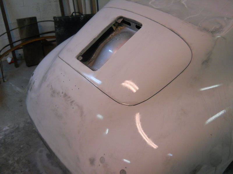

                    Front and rear lids in sealer and remounted for final blocking.
                    Completed the last major sealing hurdle before the final finish.

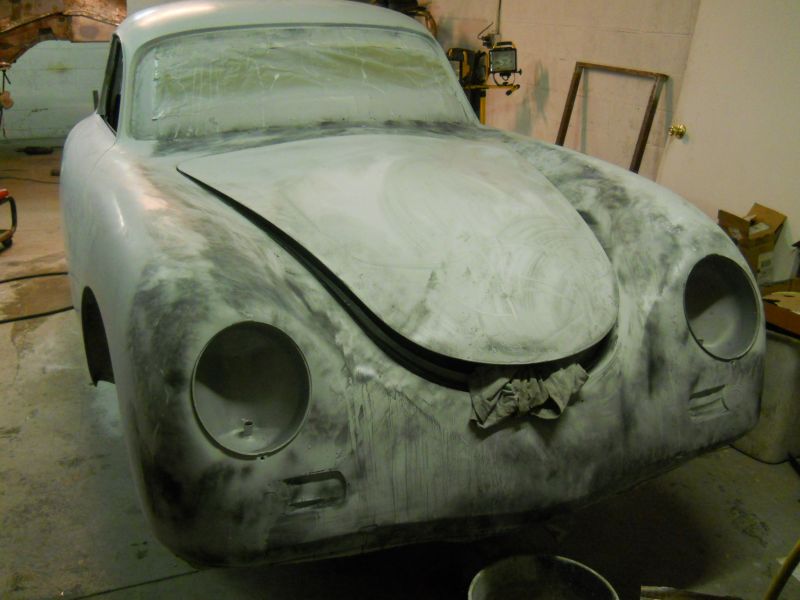

                    Same treatment for the hood as I had to reinstall the seal to get the hood level and back in the sweet spot with the body. Again more tedious and time consuming prepwork but I can't cut corners now.
                    Hood back on safely for the last go around.

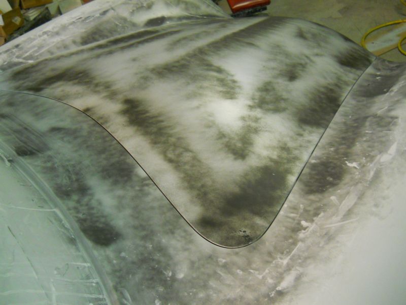

                    began taking it down with my paint stick wrapped in 600 grit.
                    its all leveling out nice.
                    Some orange peel and spots yet to finish but it was a good start. I was just glad to get these last panels sealed so I can finish up here.

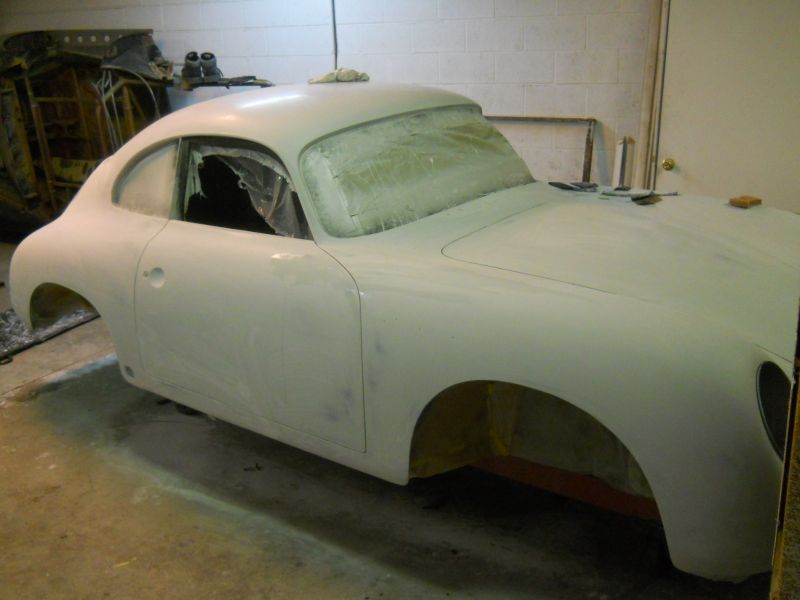

                    • 9/22/15
                      Final block sanding complete.

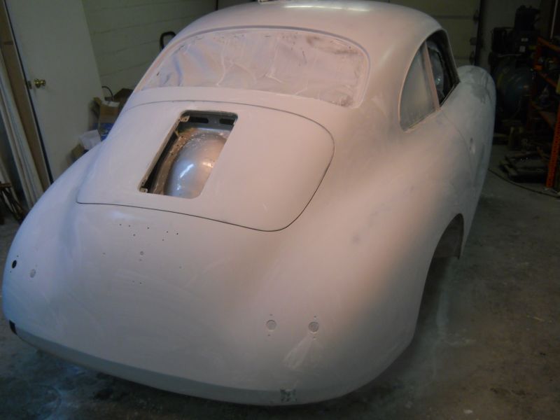

                      Final body block sanding completed this evening.
                      After all these years I can finally put all my long sanding boards of various shapes and sizes to rest on this body. Doesn't seem real after all these years as this "to do" chore has always been a constant in my life but I'm more than ready to move onto the next chapter.

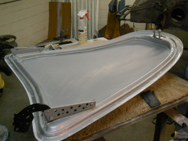

                                Decklid prepped and ready. Hood in process.

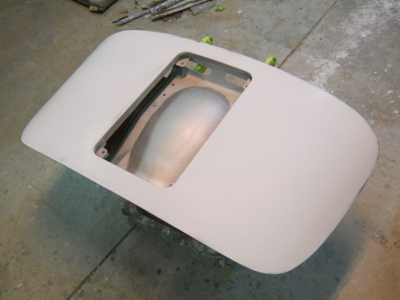

                                All the final sanding and masking on the engine cover complete.
                                I debated long and hard on both this lid and the hood as to wheather I was going to preserve my previous "final paint job" or just reshoot it as a whole. I came to the conclusion that it would be far less trouble and pain just to have Rick reshoot it all. Still concerned with paint thickness, I'm going to have him just dust the underside with base and 1 maybe 2 wet coats of clear on the undersides.

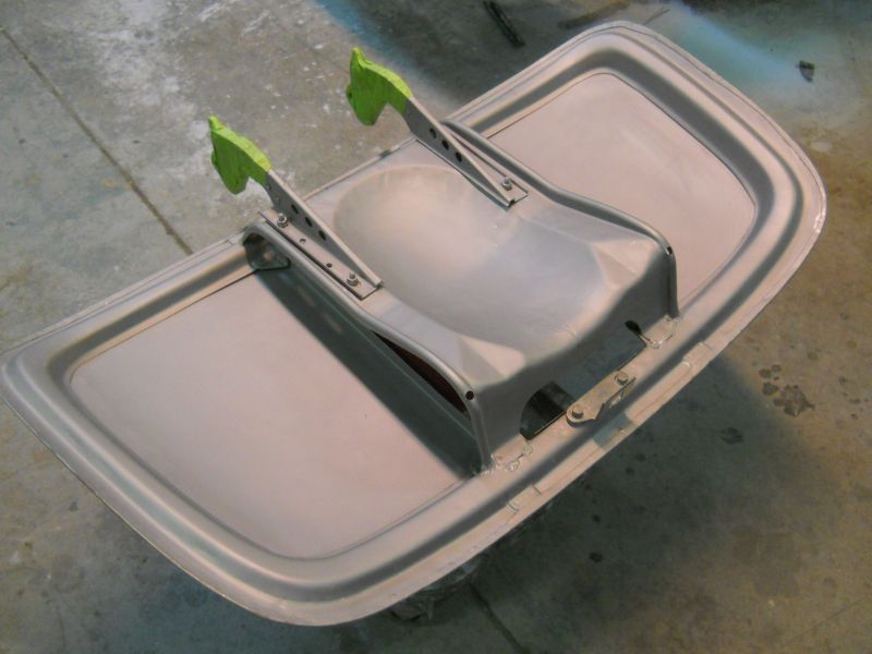

                                With the decklid done I reluctantly began blocking the underside of the hood.

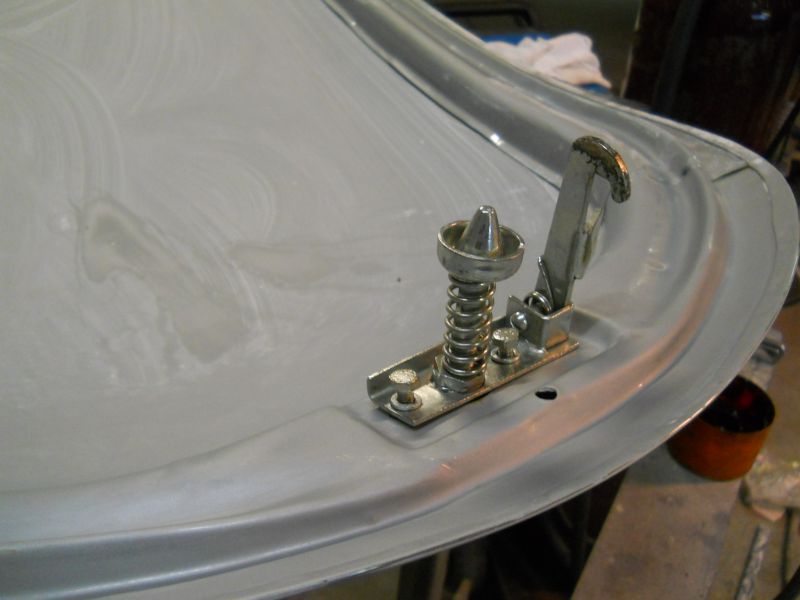

                                Again back to paint thickness concerns and gumming works I removed the latch and soaked it in lacquer thinner to remove the paint. I want this mechanism only dusted in a light coat to reduce chipping. I had it zinced years ago as an additional rust barrier.

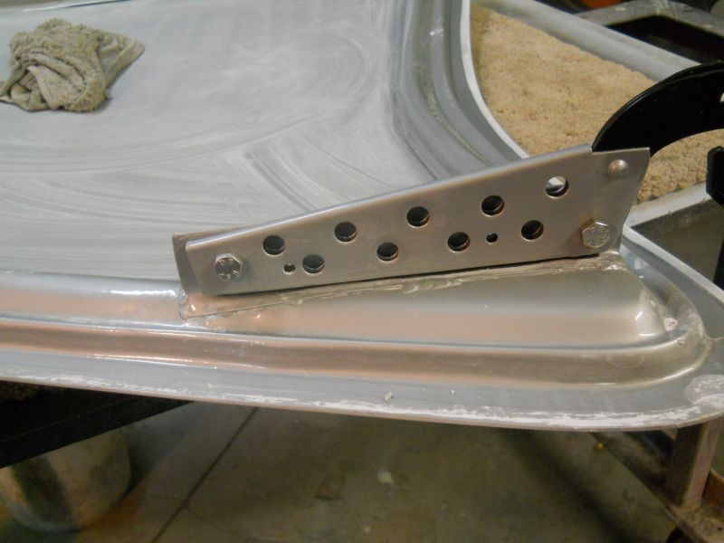

                                Bolts were removed one at a time (so I didn't lose the adjustment) and also removed of paint. This also allowed me to sand the area around it level as well.
                                I felt bad about this redo but the more I worked on it the more things I found to correct. I had unwittingly cracked the paint here a while back as I beat this edge up to meet the cowl at level to reduce the need for filler.
