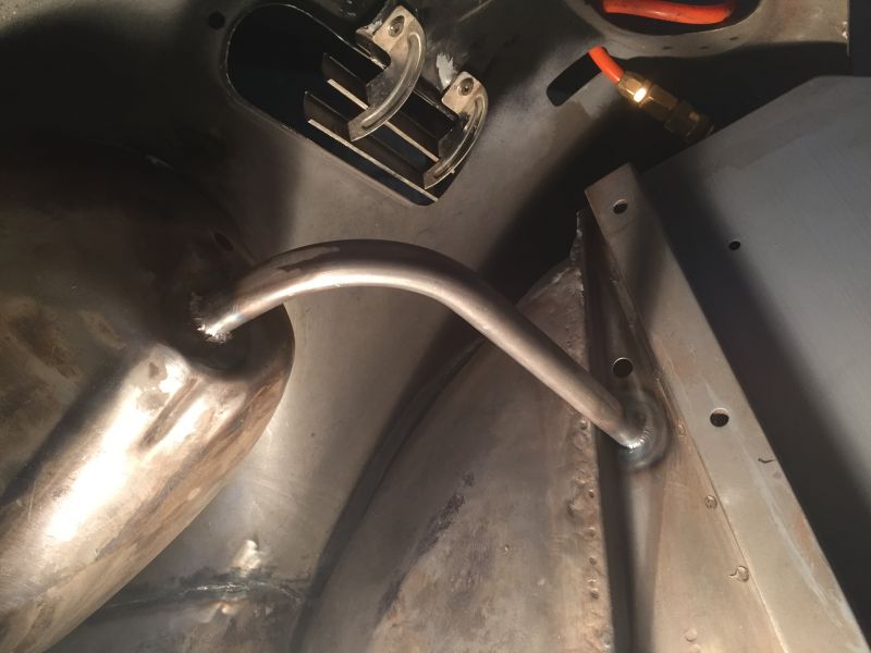

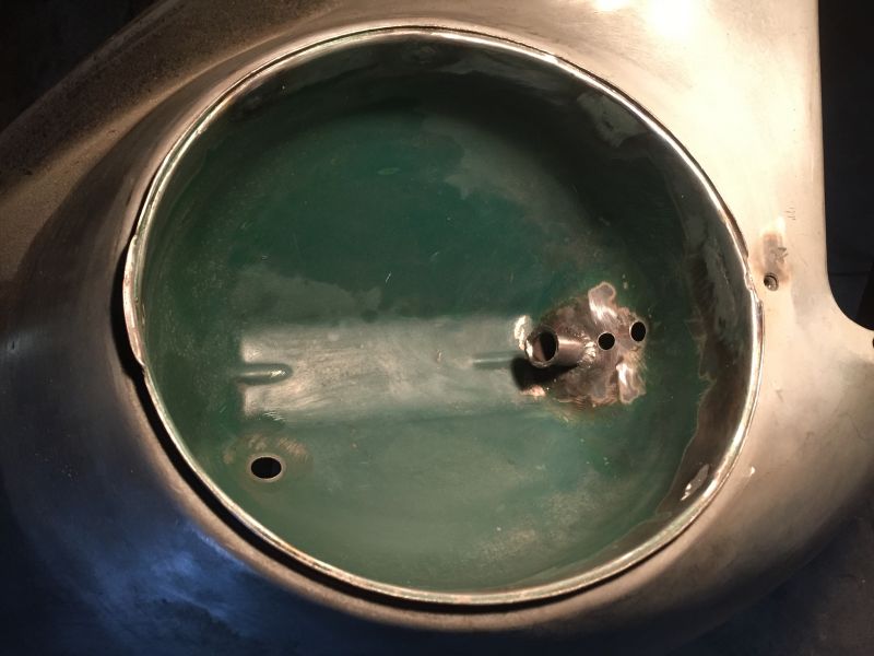

      • Small progress made today installing fender bracket/light conduit. The original conduit was rusted and damaged after transferring this original headlight bucket to the new nose section.
        I flared the top of a new tube and welded in to headlight bucket. Will finish welding the back of the tube from the bottom side next time the car is flipped over.

        • Hey Tom, Welcome back and glad to see you making a little progress once again. Its those numerous tiny loose ends like the one you just finished that can be the hardest to get yourself motived to finish. BTW: how many more little chores like this one do you have left to do before it can go to paint? Best of luck with your body shop search.
          • Thanks Justin, I've definitely been following all the great projects here. I'm down to a fairly short list, but some items will be harder to tackle such as the bumpers. My mind keeps telling me that I can do better here or that gap could be tighter, etc. So trying to find the good enough point is always hard.

            Here's the wire conduit from inside the fender. All sealed up.

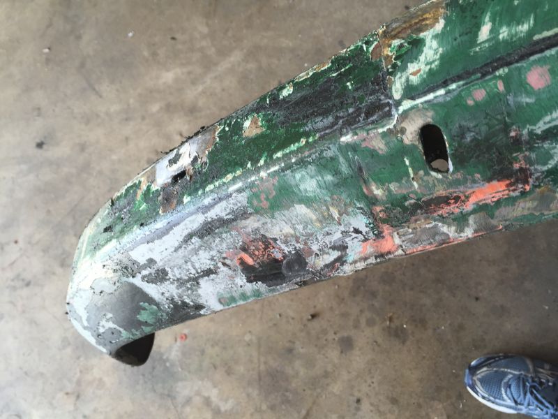

                  I think this is the last of the paint stripping thank god!

                  I also stripped two rear bumpers, one extra, but I didn't snap a picture I guess,
                  They need some straightening and TLC for sure.

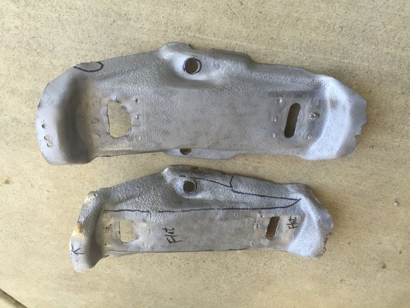

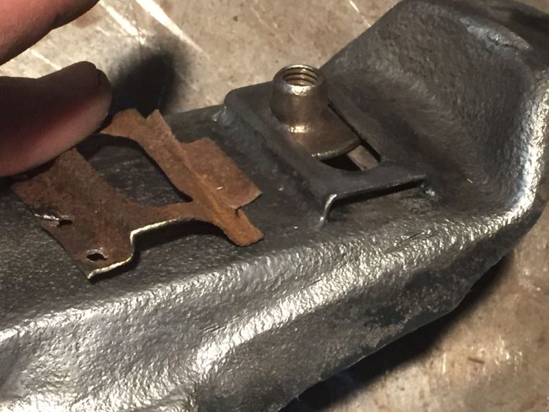

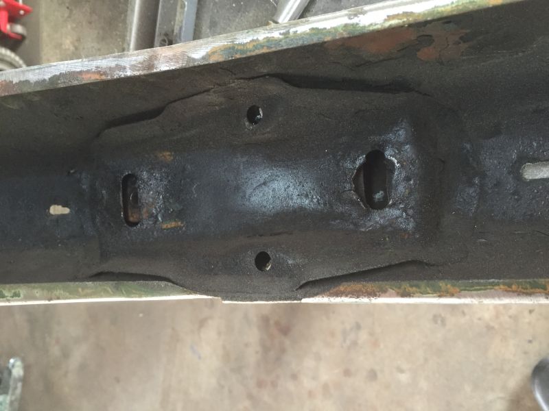

                  Here's the internal brackets with a missing nut.
                  I ended up drilling out a previously brazed in repair by someone else.

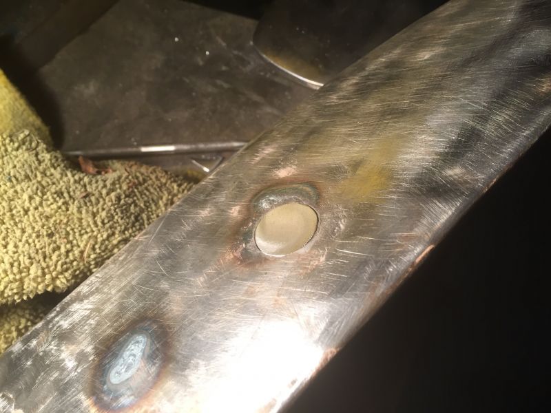

                  I removed both brackets because they both have damage. Someone else removed one side before and messed with it unfortunately.

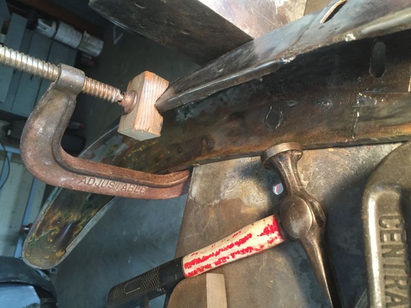

                  I spent a few hours pounding out dents in the bumper too. It's tough to get a uniform fit to the body, so I've been doing some picture research to see what the factory fit is like. Best I can tell is that the gap gets a little wider near the turn indicator lights.

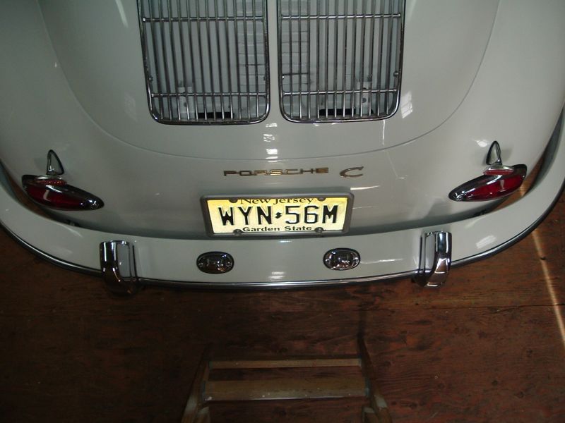

                  • Tom,
                    Here's a shot of my "C" rear bumper to body. The ends are a little tighter as the clearance is determined by the large round rubber spacers.

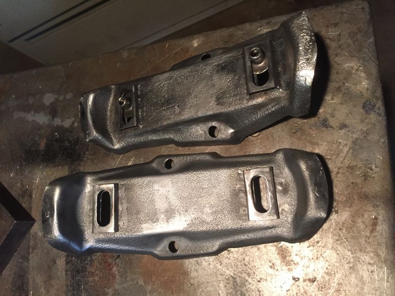

                      Almost done fixing the brackets. Just waiting on some weld nuts to finish final welding.

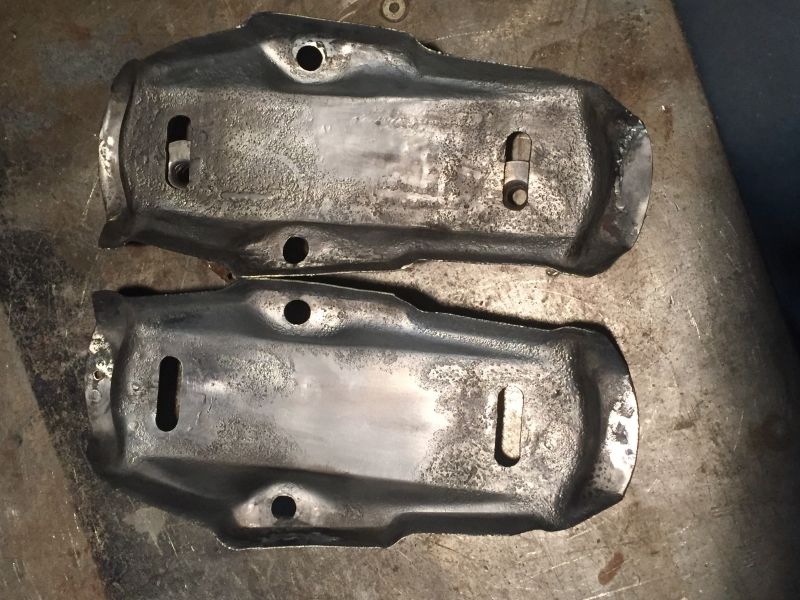

                      I changed the floating nut cage a little because I don't have a spot welder to install as originally done. So rather than bending the hat section, I just bent two flanges and fillet welded it the the bracket. No one can see these once installed and it saves time. Plus it's probably stronger especially since I used a heavier gage sheet metal for the cage.
                      Flip side.

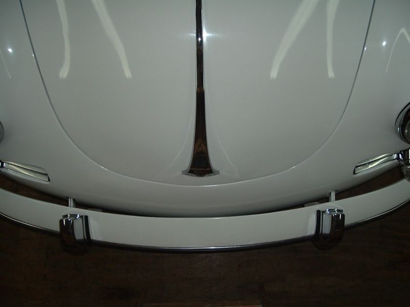

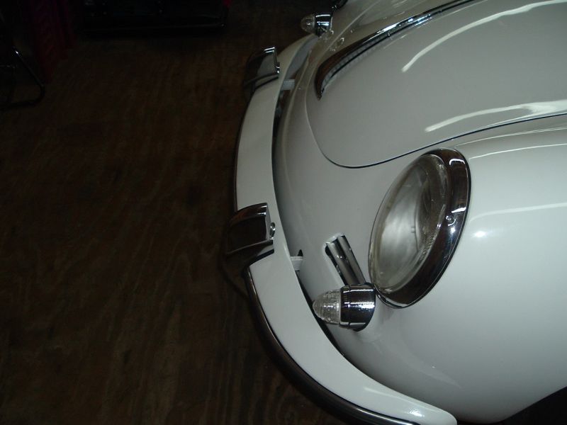

                        Tom,
                        My front bumper and nose were attended to by "Bubba" and is tight in the center. Here are some shots anyway:
                        • That looks like a pretty typical fit to me Don.
                          • Yes it looks fine to me too. Also that front bonnet gap looks very nice as well
                            • Thanks for the nice comments. My car looks OK from 10" away but goes down hill the closer you get. It's a driver so I'll live with it, I don't know if I have it in me to "open the can of worms"!
