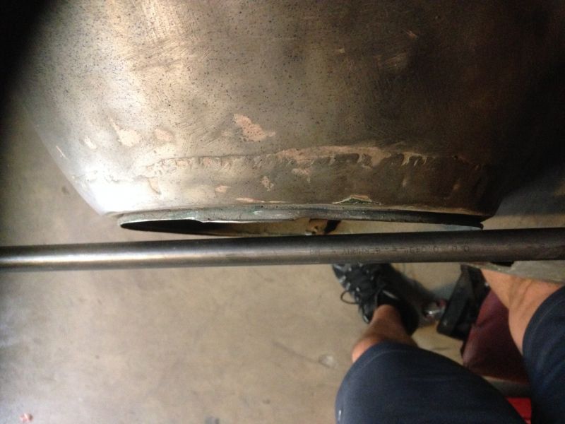

  • Thanks Phil and Bruce for your help. I really like the idea of using the hole in the dash to check headlight position. I did several left to right measurements all the way back to the quarter windows. After sleeping on it, I'm feeling more and more comfortable with the fit of the replacement nose.

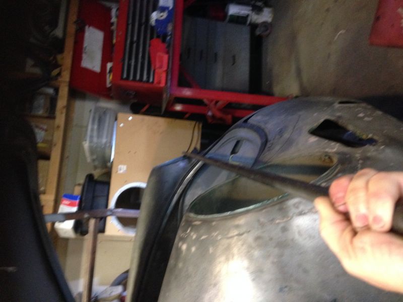

    Another thing I did was to install the bumper bracket and shim the nose off of it, so it can't move during welding. Also to make sure in lines up.
    Here's my attempt to take a picture and hold a straight edge at the same time. This is the old nose.

    The new nose has a much smaller gap that I can live with.
    Today I hope to trim and tack this in.

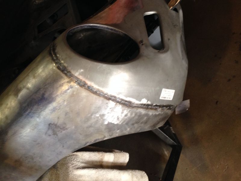

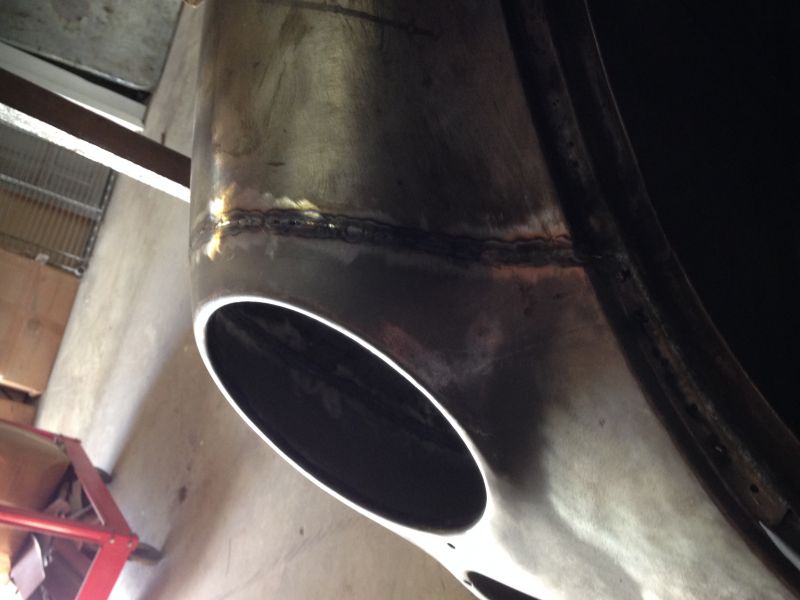

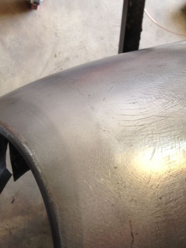

                • Nose is completely welded, except for a little section on the bottom remaining. Once I'm ready to rotate the car upside down, I should be able to do a better job when I'm comfortable.

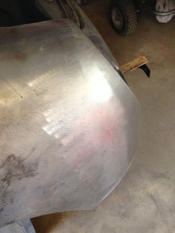

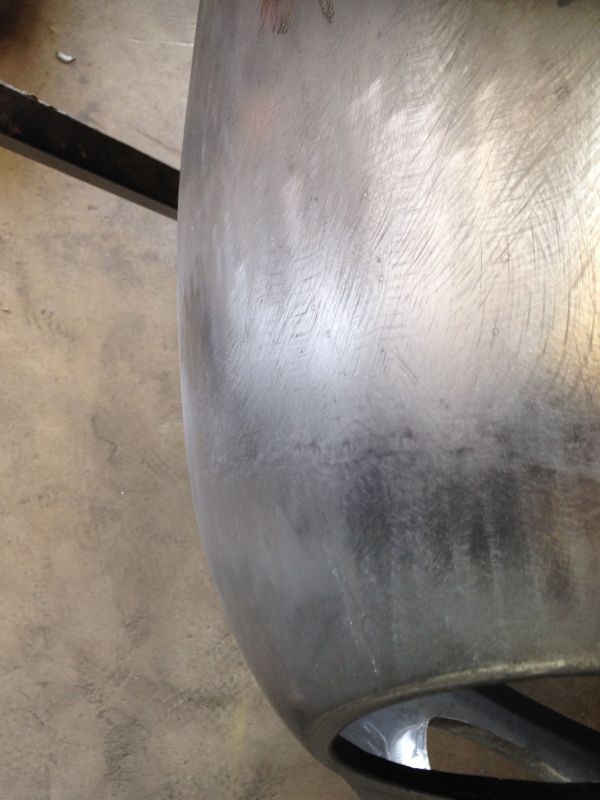

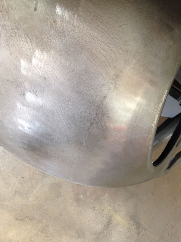

                  Metal finished.

                  • Looks great Tom! what was your approach to welding the seam? Curious to learn. Also interested in knowing how much hammer and dolly work was required to get everything nice and smooth.
                    Thanks for sharing,
                    Joris
                    • Wow! Fantastic work, Tom. I see that you TIG welded it in short ~10mm welds. Did you use any heat absorbing/dissipating material to help control the warping?
                      • Thank you Joris and John....I'm happy with the way it came out
                        Here's a quick run down of the process.
                        In my opinion the panel fit is the most important step and where about 80% of my time was spent on this repair. I try for zero gap, but it ranges from 0 to 1/16" in some places. If the gap isn't good and the panels don't fit well cold, then its difficult to keep the weld and heat input consistent.
                        Once everything fits I tack the entire panel top to bottom to ensure nothing moves during welding and the gap doesn't change during welding. If the gaps change, then its time to stop and stretch the last few welds until everything goes back into original shape. So yes, hammer on dolly technique used during the welding process.
                        Weld length varies from 10-20mm and I skip around to whatever gap/offset looks the best.
                        I try to keep the blue area affected by the weld even (about 3/4" wide)to control distortion. Sure, it will still distort but at least its even.
                        I didn't use any heat absorbing material or backup plates during welding. The access to both side of this nose seam was great, so I let it shrink and then hammer stretch it back to original. I've never tried the heat absorbing stuff. If the heat sinks into another material then more heat needs to be added to weld puddle to get the same penetration, no? Others use those materials successfully without a doubt, but for me its another variable that I don't want. If access behind the panel is poor than I see a bigger advantage.
                        To smooth out the weld seam, I grind any high spots down first. This may sound strange, but I use a cutoff wheel on a die grinder for this step. Its light weight, had great visibility with the guard off, and I can use my knuckles/fingers as a fulcrum.
                        Most of the final weld flattening is done with a file. I used to use roloc disks, but they contour to the shape of the weld and too much material is removed next the weld and not enough of the weld.
                        Filing shows any low spots and distortion, so more hammer and dolly time is needed until its perfect. I alternate between the die grinder, file, and hammer dolly until its good enough.
                        Hope that helps. Everyones technique is different for better/worse??? I've had lots of practice on this car that is for sure. I still think the rear seat pans were probably the hardest for me.
