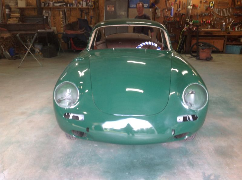

    Is it ready for paint?!!!! If so.....CONGRATULATIONS
    JP
    • Tom

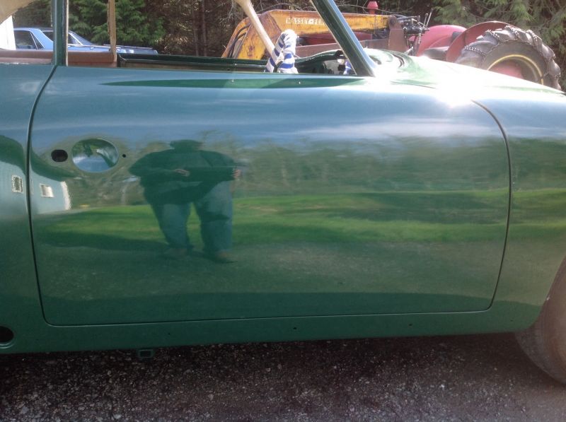

      I just finished a C coupe in this color. Glad to see yours done. Wait three full weeks before the wet sanding. The PPG paint took forever to finish out gassing.

      • Any day now it will all be green!
        Jbrooks, I saw that car in your thread and it looks great. We have planned dry time already. It will be another few months before I get the car back. He's going to undercoat after paint but before color sanding.
        • Tom
          Undercoat is good, truck bed liner is better unless you are worried about the authenticity police. As clean as the bottom is, professional bed liner over the primer will hold up better. You can always spray some wet tar over it, for the black finger judge look.
          • "Wait three full weeks before the wet sanding. The PPG paint took forever to finish out gassing."
            Herr Brooks is correct and it applies to all "plastic" paints (acrylic or poly urethanes, epoxies)... from any manufacturer. The only way around a wait is if that natural heater gets involved (dare I say "the sun"....which has not appeared in PA for more than a day at a time once in a while for many months) and that shortens the cure time.
            On the flip side, waiting too long for a "cut and buff" can make the "paint" be like a concrete floor to get shiny again. One method is to wait three days and wet sand with ultra fine paper to open the pores and let that layer "gas out" and then a day or so later, compound and polish.
            Lessons learnt by yer's truly: Production paint shops don't wait weeks or even days, they have heating booths or other force-cure methods...and often don't sand and polish due to really clean environments and hardly any dust to contaminate the job. Git 'em in, git 'em out.
            Second lesson is that I miss lacquer....except on humid days (causing blushing) or really dry days (static drawing dirt and fuzz into the surface)
            • They nailed the color Tom; Both in direct sun and indoors. Can't wait to see it in paint...going to look amazing!

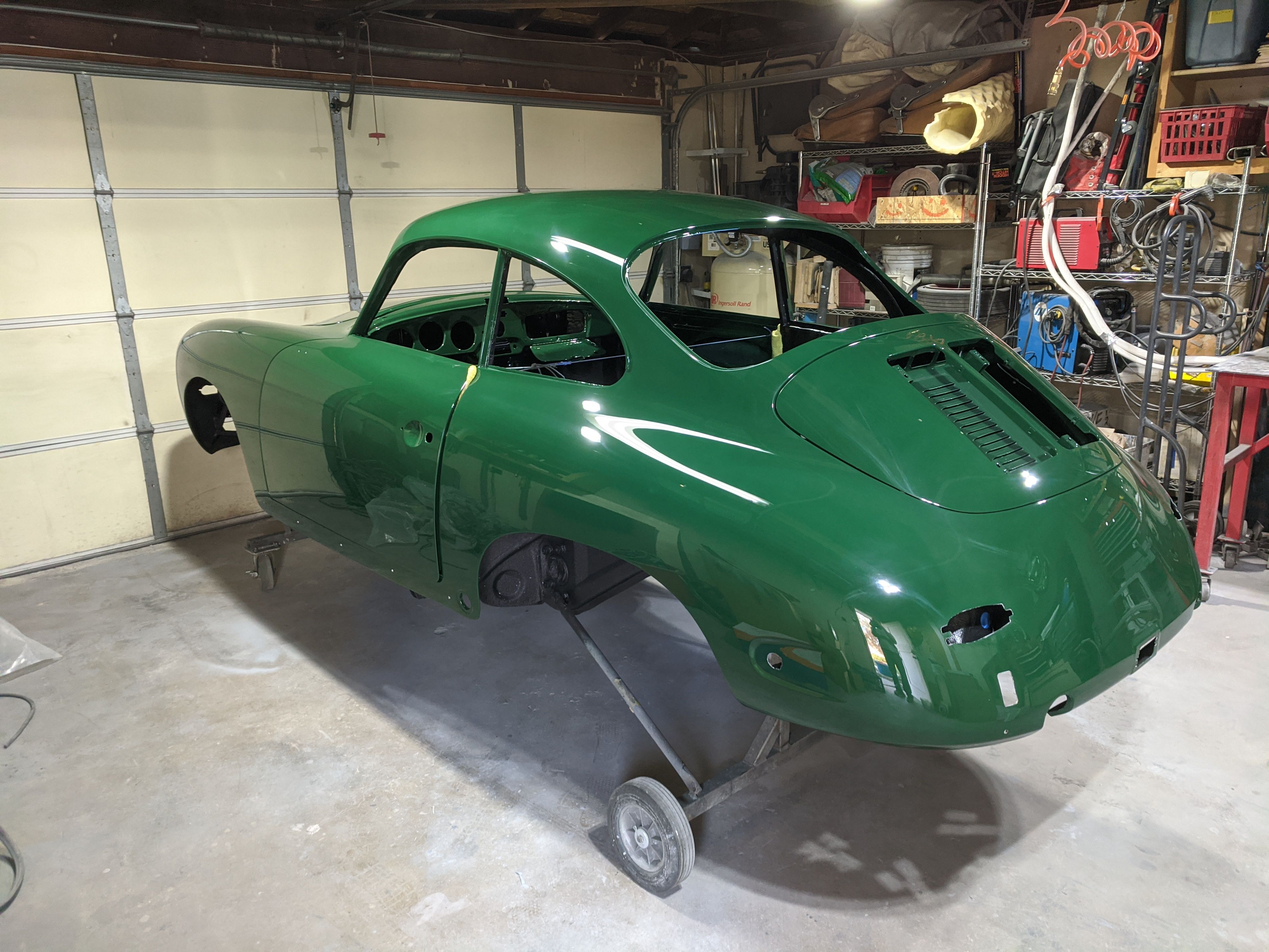

                    • My car is back home! I got a little side tracked by a 911, but I hope to get this back on the road!

                        Congratulations Tom, She looks really nice!!
