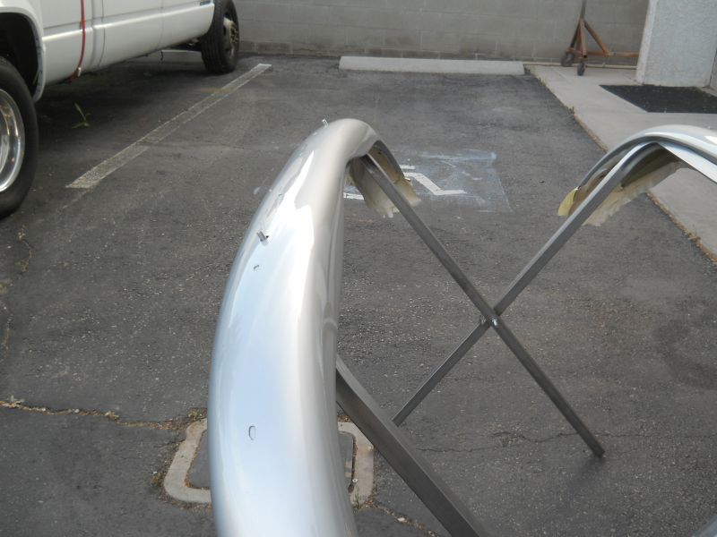

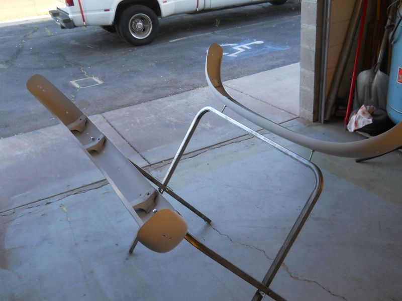

  • [quote="tperazzo" post=33475]Thanks Justin, I'm just glad it was caught in time otherwise I would have to live with it.
    Here are pictures from every angle of my mocked up front end. All you eagle eyed guys, please let me know if something is amiss or could be improved upon.
    Fire away!

    Well that's me, throwing a monkey wrench in the works. The contour of the front bumper looks better than probably any OG car that I have seen. But... recently Trevor and I were measuring 6 or 7 cars we had around, including cars with OG nose and bumper there, and found significant differences as to how far the bumper wraps around towards the wheel arch. We were amazed and startled about the variation there. Not one was equal, with variations between 3/4 to 2 3/4 inches, usually short on the right hand side!
    Have fun with this.
    • Thank you Jack, that is great information to know and relieves a lot of unnecessary worry in this process. With that much variance in mind you have to ask yourself where do the discrepancies lie? Is it in the bumper, the wheel arch...or both??
      Thanks again for sharing what you guys found.
      • Thank you everyone for commenting on my progress before paint. I truly appreciate it! The good and the bad. More pics to come soon.
        I too have seen lots of variation on bumper fit and I've also snooped around on other sites like Willhoit Restoration and some factory photos too.
        I'm the first to admit that the fit of my bumper is probably "over restored". It needed some reshaping to begin with due to collision damage, but I purposely tightened up the fit to the body more than the factory did I think. I do like the way it turned out though
        As for the variation to the wheel arch, I get 2 3/4" on each side which is on the high end of your results. As you know the brackets are slotted. I have my bumper pushed all the way in as far as it will go. I ended up de-welding the battery box bumper bracket to push it back further and re-center the bracket to the fender slot hole. I didn't move it 2" though....wow! The repro wall was off a little bit in regards to the bumper bracket position.
        My drivers side nose and front fender were in nice shape, so I tried to make everything match that side.
        Thank you Jack and Trevor for reporting your findings here. Its so helpful to have extra eyes on these things. I put more time than expected on that bumper! I think the rear bumper will be easier to fit, hopefully.
        • For clarification, the measurements we took showed DIFFERENCES FROM ONE SIDE TO THE OTHER, measuring from the end of the bumper to the wheel arch. None were equal on any given car, with distances of up to 2 3/4" variation. These measurements were taken on cars where the general fit of the front of the bumper appeared well centered to the nose panel. Further adjustment to allow the wrap around to be more symmetrical would cause the fit of the bumper to be significantly off at the nose.

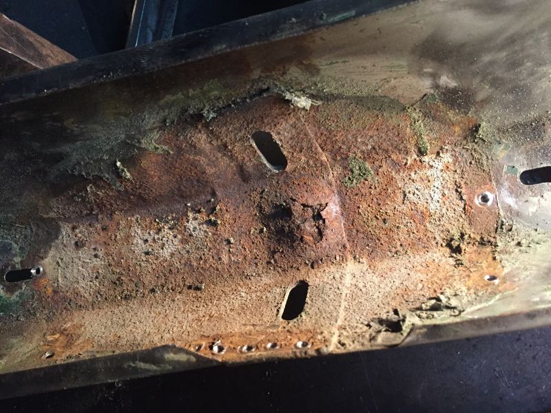

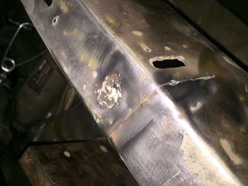

              Now I'm working on the rear bumper. It has several small dents but it isn't mangled like the front was. That's the good news. The bad news is there's a nice rust volcano hiding under the bumper bracket. Just when I thought I was done with rust repair I get shoved right back into it.

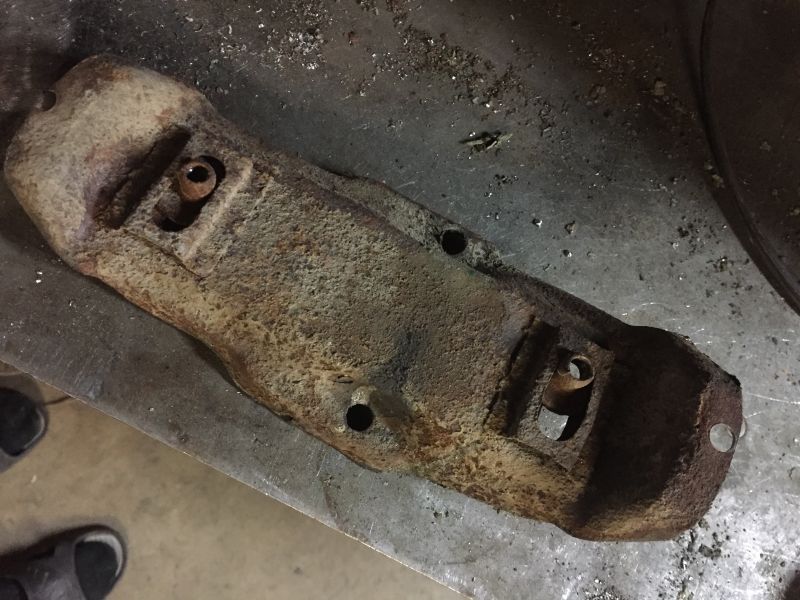

              Looks like Porsche didn't paint or primer behind these parts.

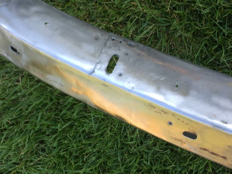

              The rust bubble is where the overlapping sheet metal is spot welded together.

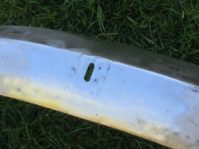

              Here's the outside that was filled with bondo.
              Not hard to fix presumably.

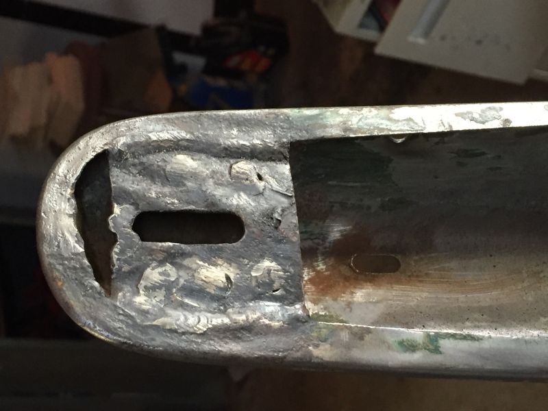

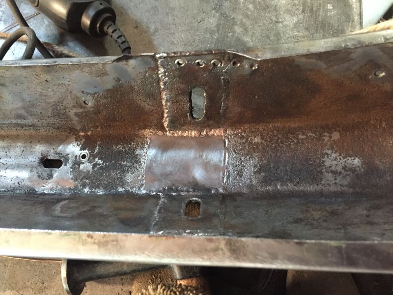

                  Finally got a good chunk of time to finish some chores on my rear bumpers.

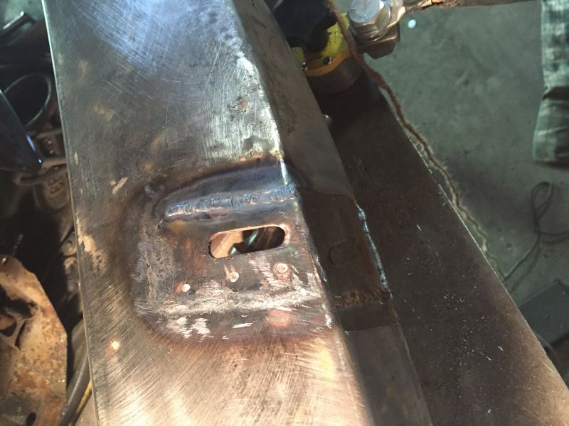

                  I cut out a large section of rust where the bumper thirds overlap, but rather than take the entire section apart to look at all the overlapped sections I decided to weld all the seams shut. Theoretically this will prevent further rust by starving it of oxygen.
                  I even fused the edges together where the oval cutouts are. Here's the outside.
                  I did loose the vertical edge that is normally visable on the outside. This edge is covered by the bumper guards though. I think this butt welded seam will fair better than overlapping sheet metal in the long run. Although, if Porsche would have put a little primer behind the bumper mounts I'm sure it would still be in good shape today.

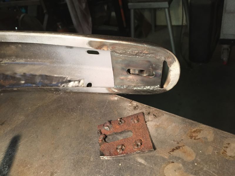

                            Someone else has messed with the side bumper mount plate and there is no captive nut???

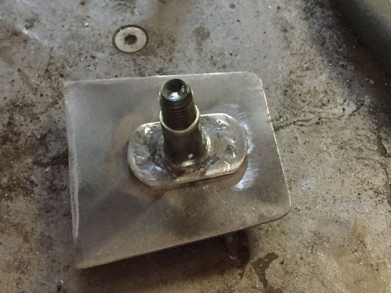

                            For me it was easiest to cut that out and rebuild.
                            Here's the new plate and a modified weld nut to be the same as original.
                            I made the cage and welded it in the same way I did on the front bumpers. No overlapped metal.

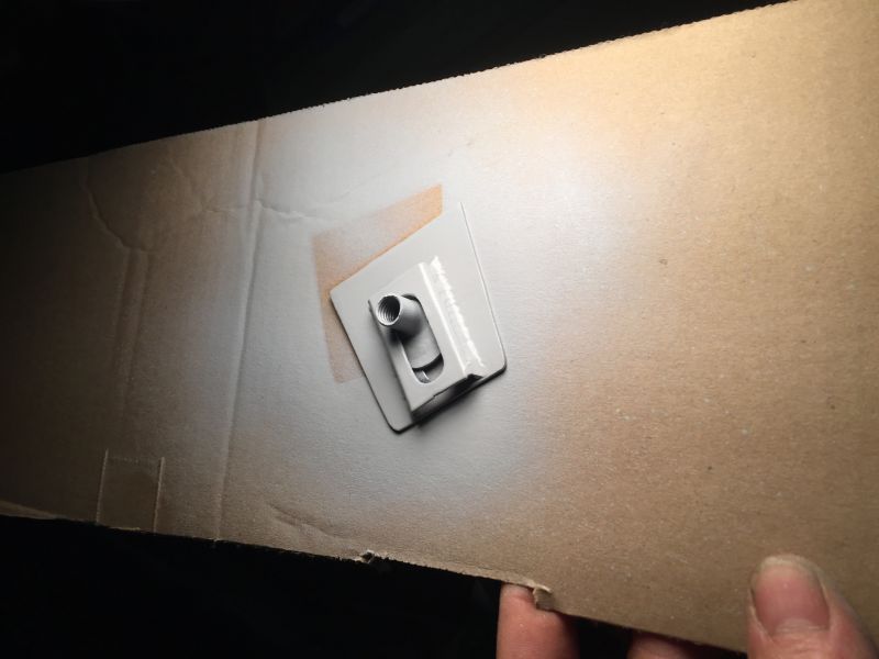

                            Primered,
                            Finished,
                            Could this be the last weld on my 356???? I don't want to jinx it but I can't think of anything else!
