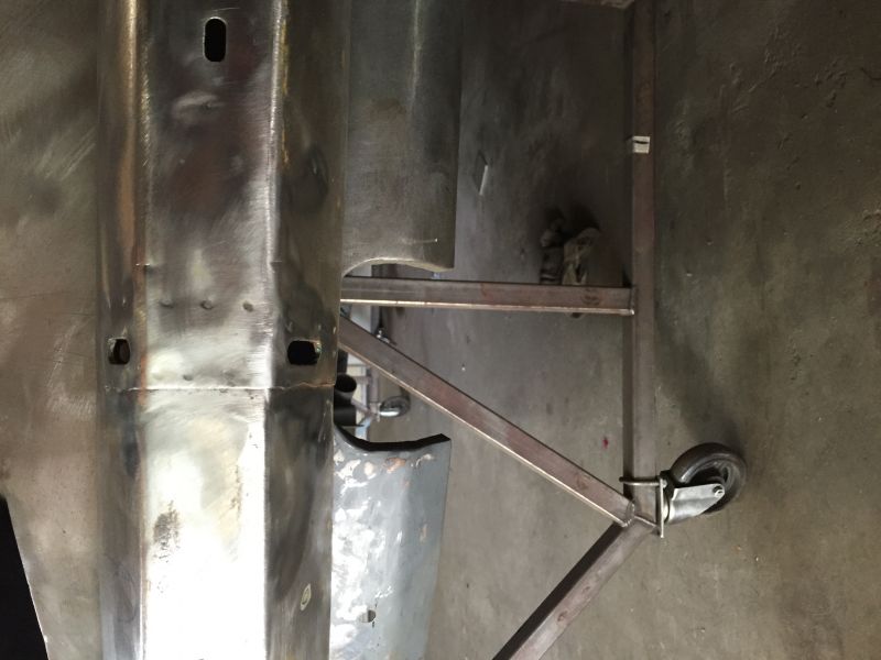

    Nothing is easy though as I expected my rear bumper to bolt on with excellent fit since it wasn't nearly as damaged as the front was.
    I straightened the bumper brackets so that they were parallel to the car and straight. I learned from the front bumper that it's no fun to fight a springy bumper bracket because it's pointing the wrong way.
    I centered the bumper so that the exhaust cutouts were lined up.

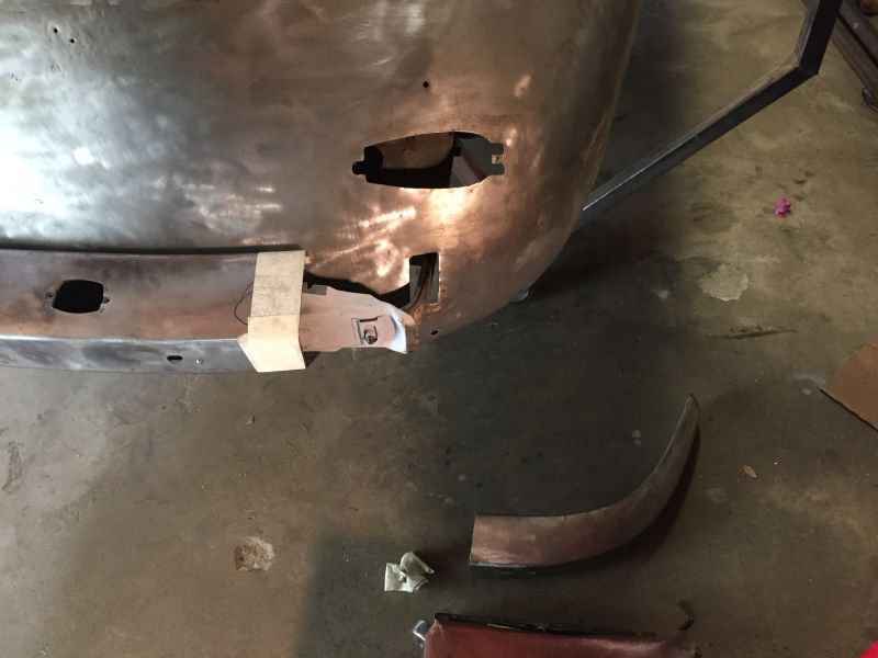

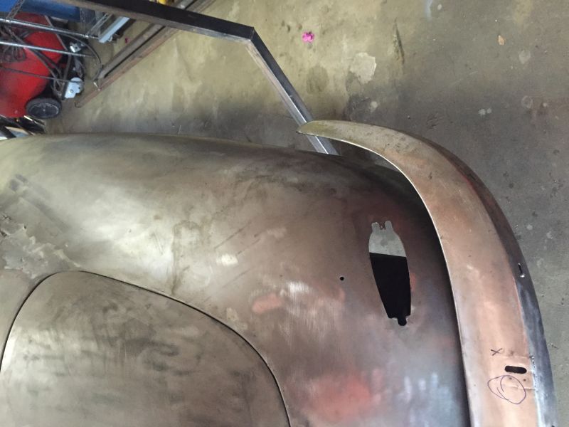

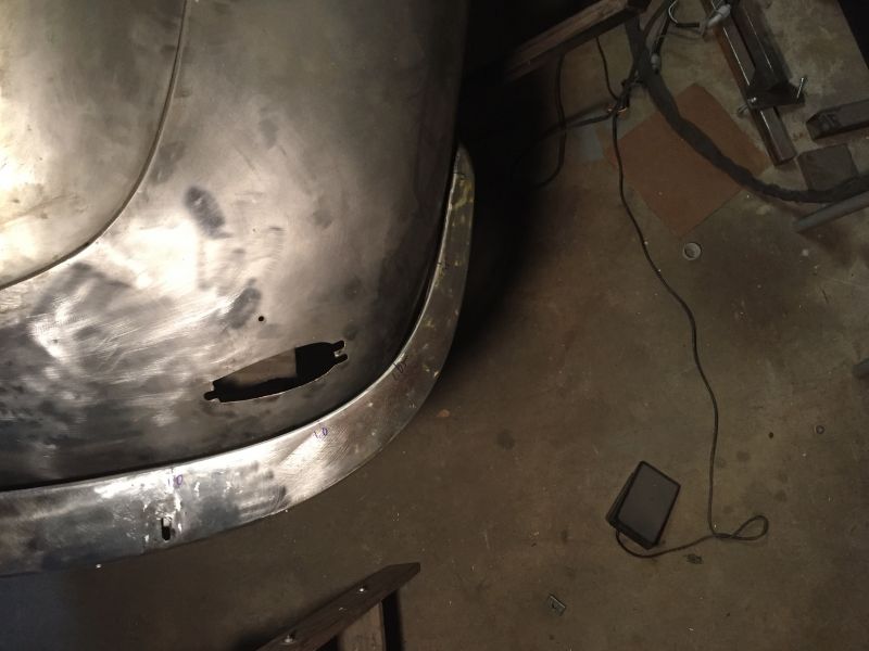

    The passenger side doesn't fit well with the body.
    It sticks out almost 1.5 inches on the side of the car that has had no rear fender damage.
    The drivers side is better and will probably draw in when the rubber spacers and hardware is installed.

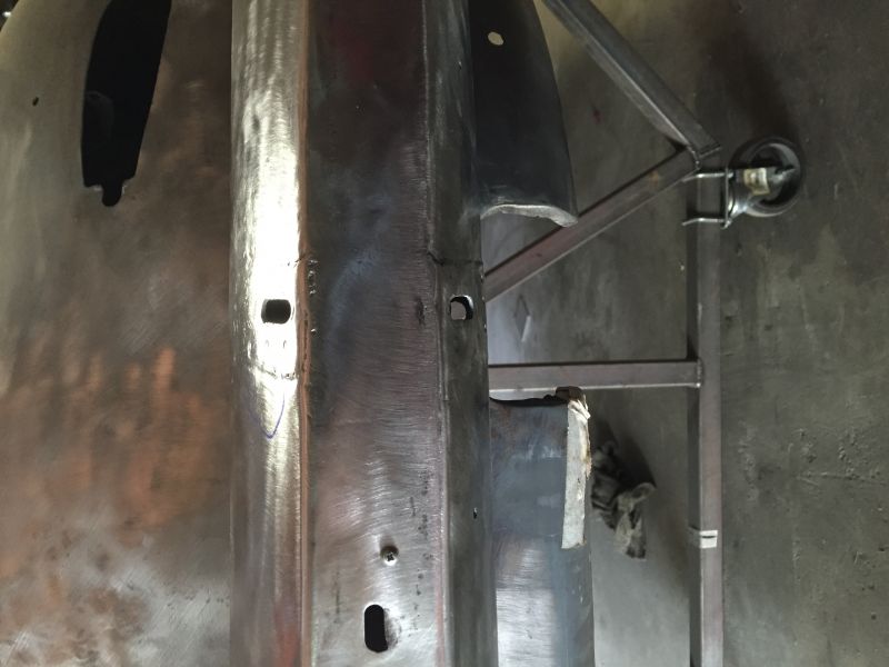

    I don't want to kink or distort the bumper so it looks like I'm with Trevor and will section it.
    Didn't expect this would be needed on an original part. I did hammer and dolly several dents out but don't think I stretched it that much.

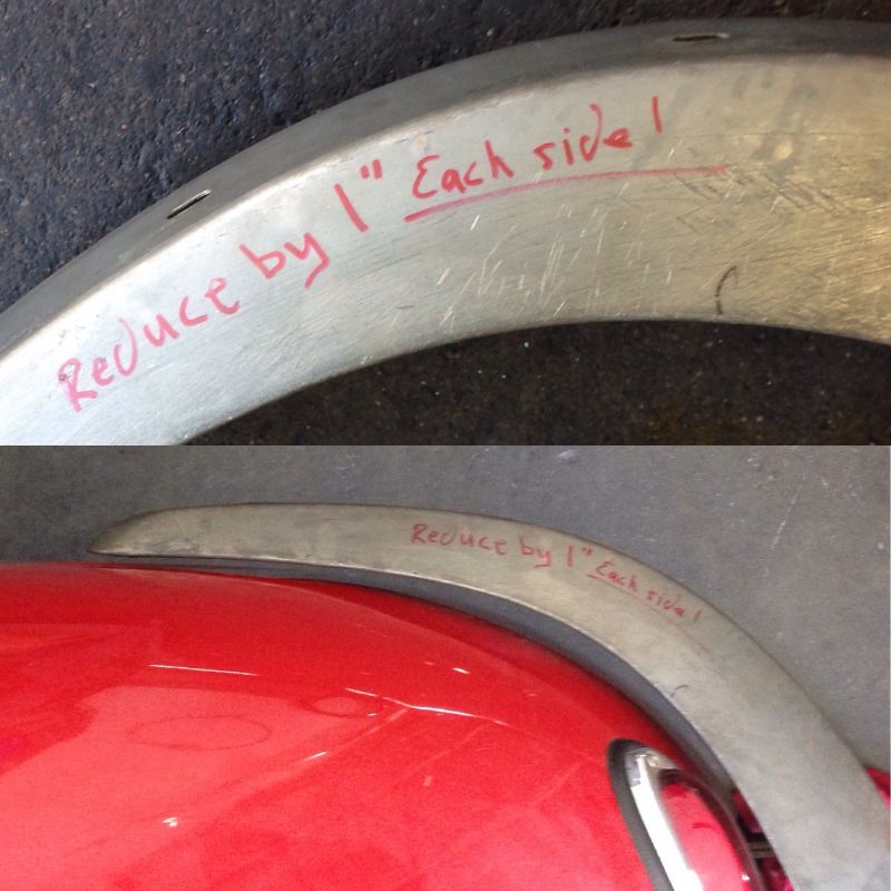

    • That's an easy fix for you Tom. Jack and I had the exact same problem a few months back, except it was "only" out 1 inch from where we considered ideal to be. Use a cut off disc and cut a slice through the bumper around where the end piece attaches to the middle; underneath the bumper guard. You wouldn't think it (I didn't... but Jack did), that just taking out the thickness of metal equal to the cutoff disc would make an impact but it tucked the bumper in by an inch. Of course you can always widen your cut to take out more metal and tucking the bumper in to the fender more - if necessary. Start with a thin cut off disc, that way your gap will be good when you go to TIG it back together. You have to make the cut top and bottom to get the bumper to move easily, but leave the middle (where the deco strip goes) alone. I didn't take a pic of the location where we cut, sorry! I hope this is clear.

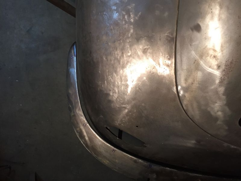

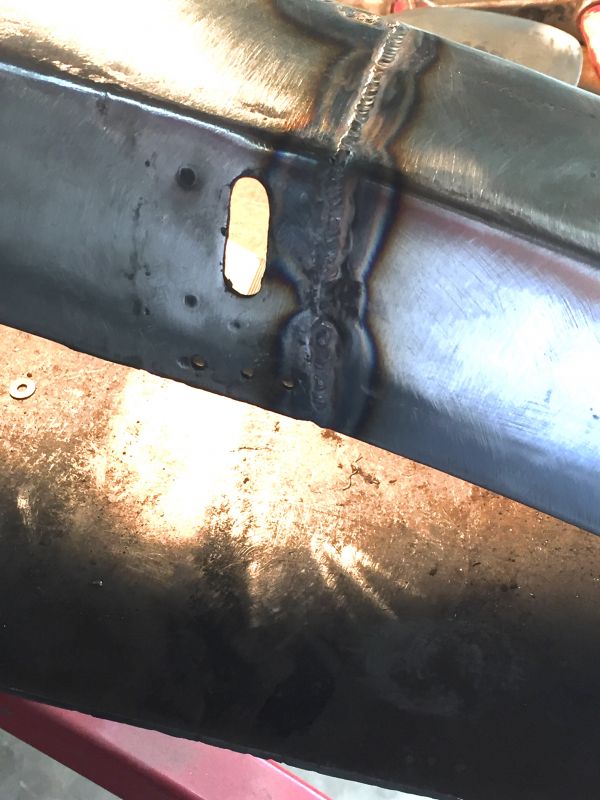

            Tacked back in place without any side bolt pressure.
            I may alter the other side a bit, but only after I get the hardware installed and do another final adjustment.

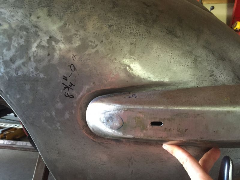

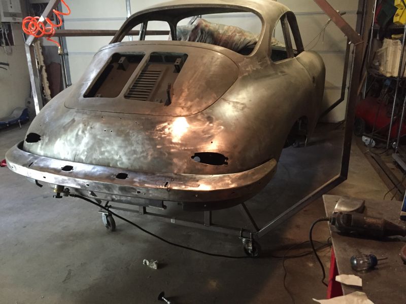

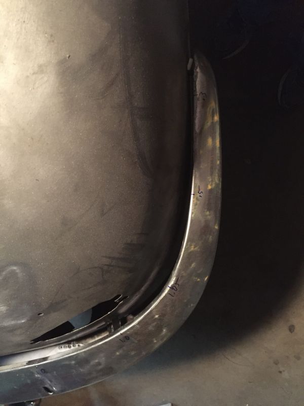

                So here's the spacing I'm at without any pressure from the side bolts.
                I think it's a compromise between how the factory did it and how I like it. As Jack said in another post the spacing is tight in the middle and ends. Then it widens as is goes around the corners.
                It's kind of hard to take pictures of the air gaps. You might be able to see the measurements written on the bumper.
                I'm waiting for the rubber donuts to synch it up better. I will also dig up the guards and lights from storage and install them.
                Also the fender to frame dimensions through the hole is 8 3/4" on one side and 9" on the other. The fender brace brackets can easily push the fenders around plus minus 1/4".
                This bumper wasn't happy until it was removed and installed at least a dozen times.

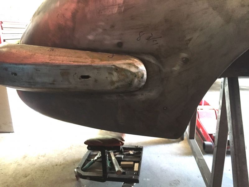

                      • Thanks guys. There is still one nagging detail after everything lines up well along the back and the cutouts, sides, etc.
                        Just like Trevor and Jack were saying about the front bumpers, I have the wrap around distance problem on the rear. I like how the drivers side flows with the fender indent.

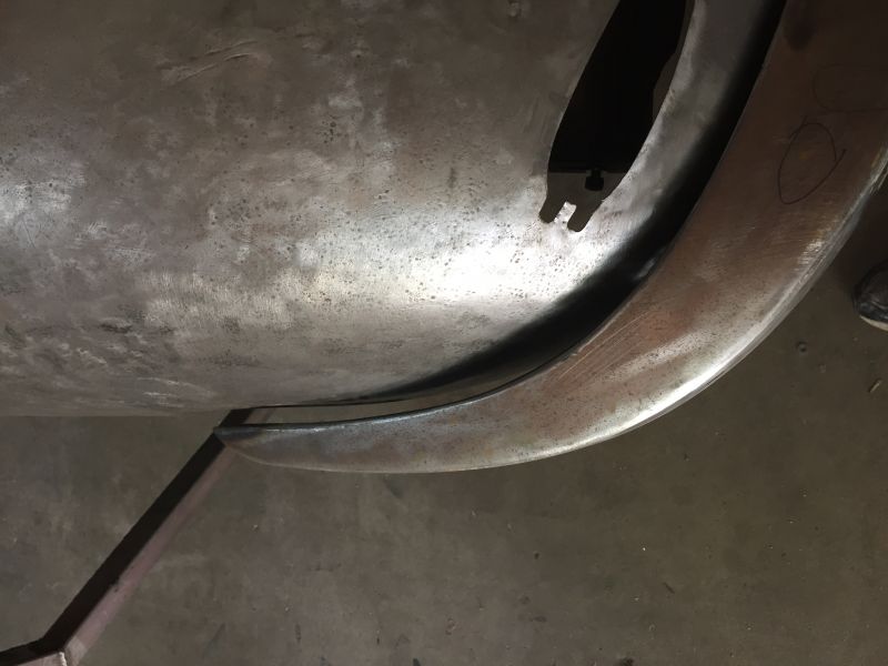

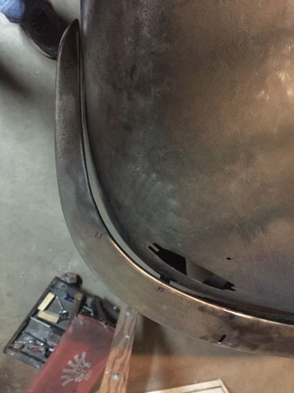

                        But the passenger side is a bit short.
                        When I cut and re-welded the section under the bumper guard I mostly narrowed the bumper and tilted it in a bit which I don't think affected the length that is parallel with side of the car.
                        Even though I can't see both sides of the car at once, I'm still thinking I should fix it.
                        What do you guys think? Leave it alone or no?

                              • I haven't sawed off my bumper yet, but it's inevitable...maybe today.
                                The problem is both the fenders and the bumper. The right side indent varies 3/8" from the left side when measured to the wheel arch.
                                My solution will be to lengthen the bumper only by about 3/4"
                                Crazy how these cars differ from side to side.
                                I thought repro parts were a PITA, this original bumper is just as bad!
