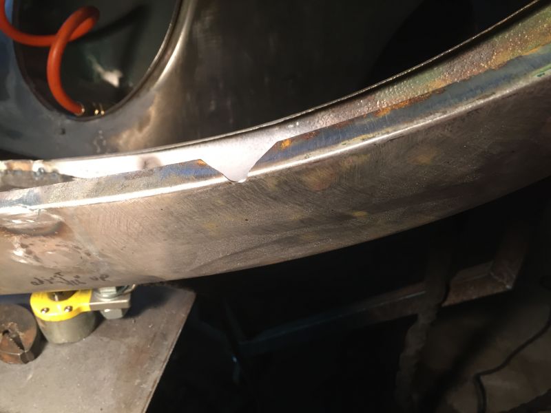

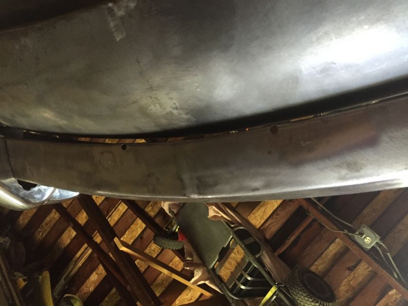

      I've been struggling with the fit of my front bumper as it has been hit hard at some point.
      Several experts suggested that I mock up everything that touches the paint and this proves to be good advice.

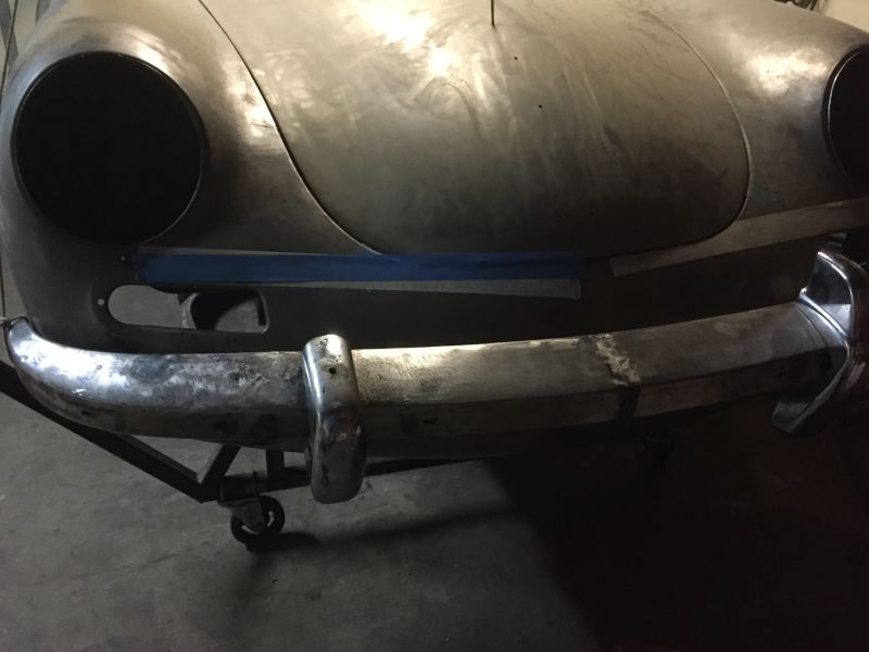

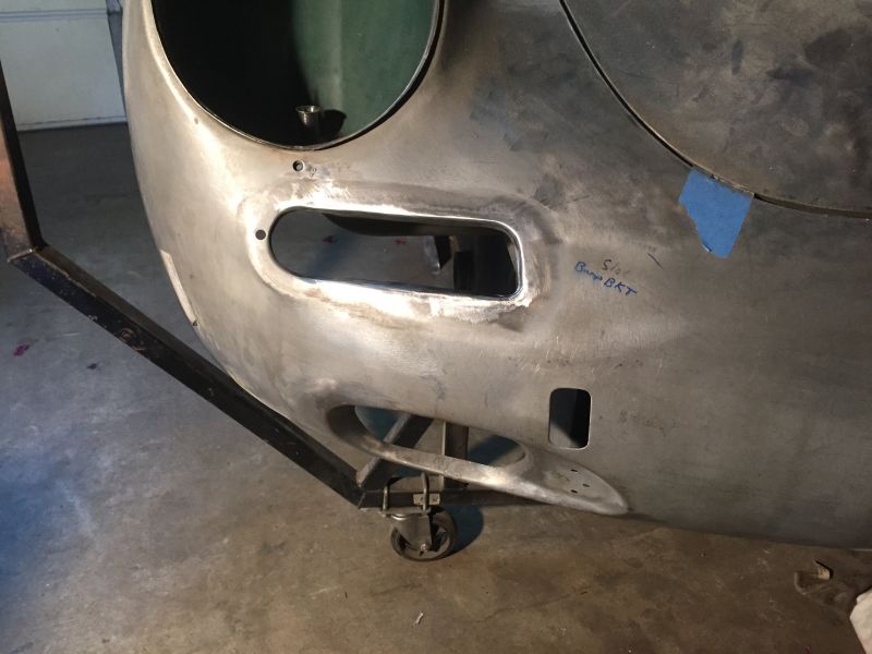

      After straightening the bumper something just didn't look right when I mounted it on the car. The passenger nose was replaced by me last year and I noticed then that grill cutouts were on a slight angle. Well the bumper creates a nice horizontal line that drove me nuts when looking at the front of the car. It's like the grill was winking at me.
      The tape lines indicate the deviation. So I cut it and re-welded it so its symmetrical.
      Also fixed several of stress cracks on the bumper flanges by cutting well past the crack itself.

      • The tape really high lighted the deviation well. This is the kind of stuff that the general public at large would never catch once finished but I admire your determination and patience especially this late in the game to continue chasing subtle flaws. Nice Work as always Tom!
        • Thanks Justin, I'm just glad it was caught in time otherwise I would have to live with it.

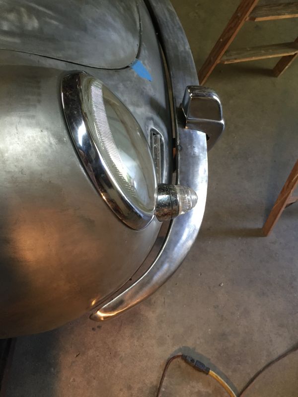

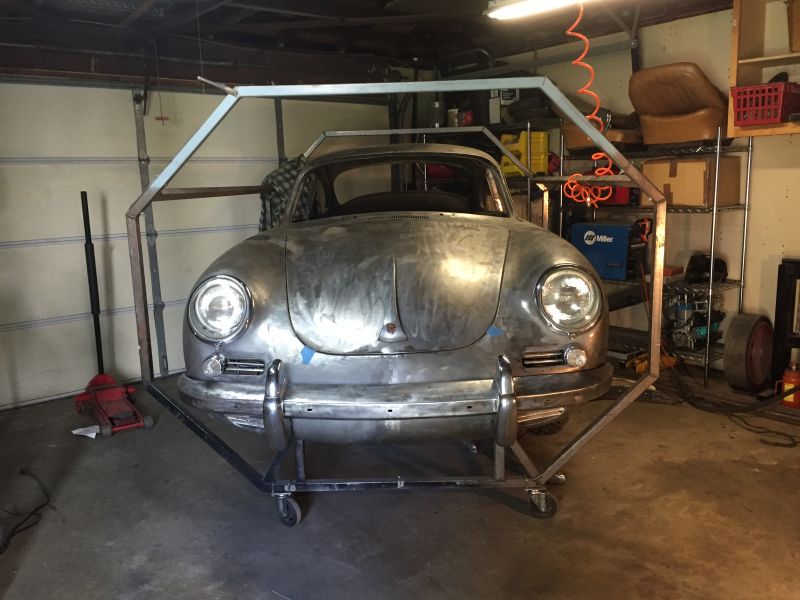

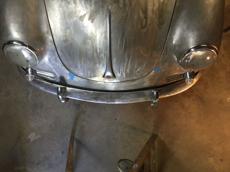

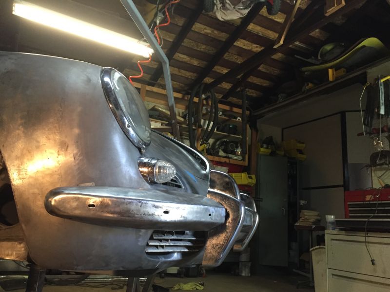

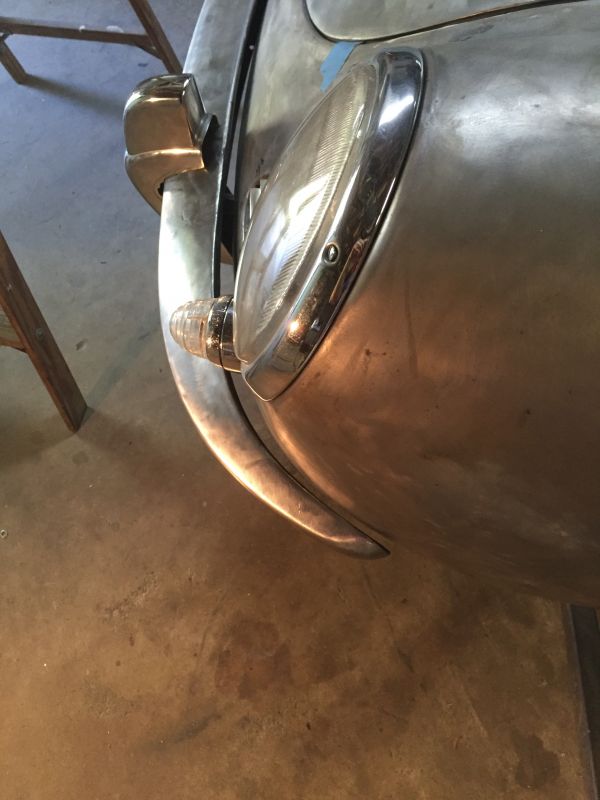

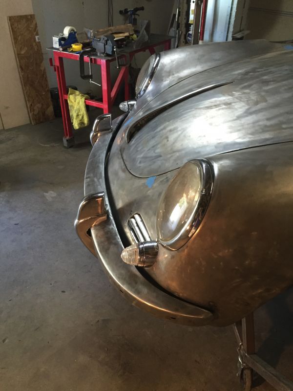

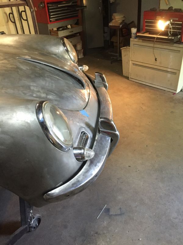

          Here are pictures from every angle of my mocked up front end. All you eagle eyed guys, please let me know if something is amiss or could be improved upon. I know the hood gaps need a bit more work and that hasn't been crossed off the list yet
          Fire away!

            Thank you all for your help and checking this out for me.
            • looks great Tom!
              • Looks dead on even with the bumper. Nice welding job!!
                • Beautiful! I think you're there...
                  • I like it too Tom. Looked hard still looks fine.
                    Well done!

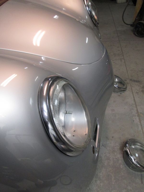

                        • This whole conversation of fitting headlights with seals really got me thinking this afternoon.

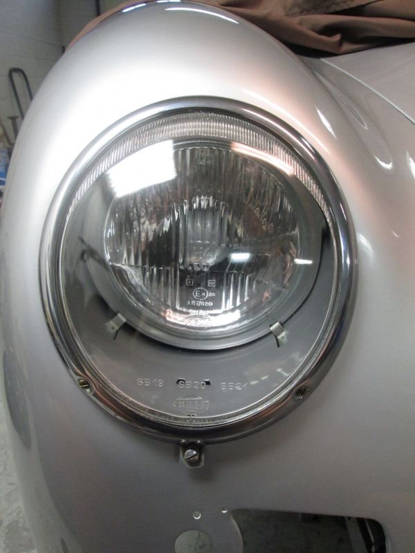

                          As headlight bucket distance (when I repaired this side) and paint thickness was always a concern I really hadn't tried to mount my light assemblies in earnest since I got her in final paint. I ran into a few fitment issues (of course)concerning the seal, Proper hooking at the top and overall final flush fitment against the body.
                          By sessions end I really got my head around it and discovered a few things along the way. I'll start a dedicated thread on the subject and maybe the more experienced can chime in as well. Anyway I got them to seat properly but nothing more scary than wrestling with these at this stage. Each time I "gathered up" the unit off the fender I was scared to death I was either going to drop the assembly on the concrete, scratch my paint or both. Glad to be past this!
                          • Justin,
                            Before I read about your last comment of scratching that paint putting the headlight assembly in place, I was thinking to myself, I bet he had to be so careful doing that after looking at that perfect silver painted front in that first photo!!
                            Bruce's point is interesting about seal thickness that can vary. These headlight seals do eventually part company, I have replaced mine with new some years ago. The wings (fenders), the buckets, and the complete Bosch headlight assemblies are all original with no repair work done other than painting but I notice today there is a slight clearance on the seal between chrome rim and wing on the sides. In other words the top of the rubber seal is more compressed than the sides. When you look at it, everything is great, only when you try to move the rubber do you notice this. Maybe the case to have a slightly bigger clearance than not enough to take into account the paint?
