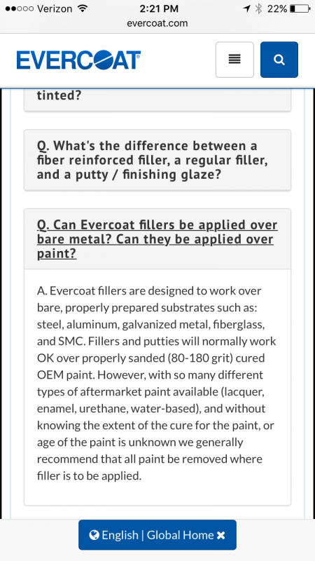

      I'm not a paint expert and there are stories all over the net supporting both sides. Here's what the manufacture says in brief form.

      Here's a link to someone who tested both ways.
      http://autobodystore.com/filler_&_epoxy.shtml
      I gather that today's bondo is pretty good and is ok to apply over metal that is clean and ground with 80 grit. It's done all the time.

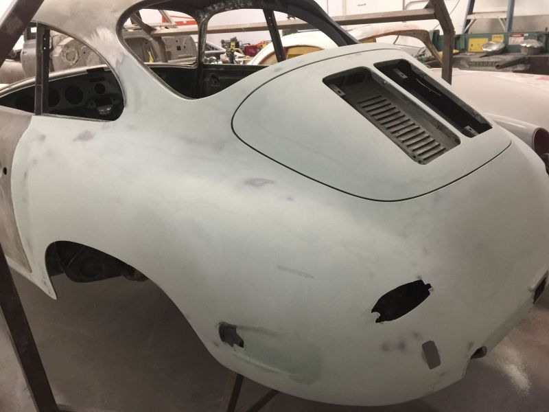

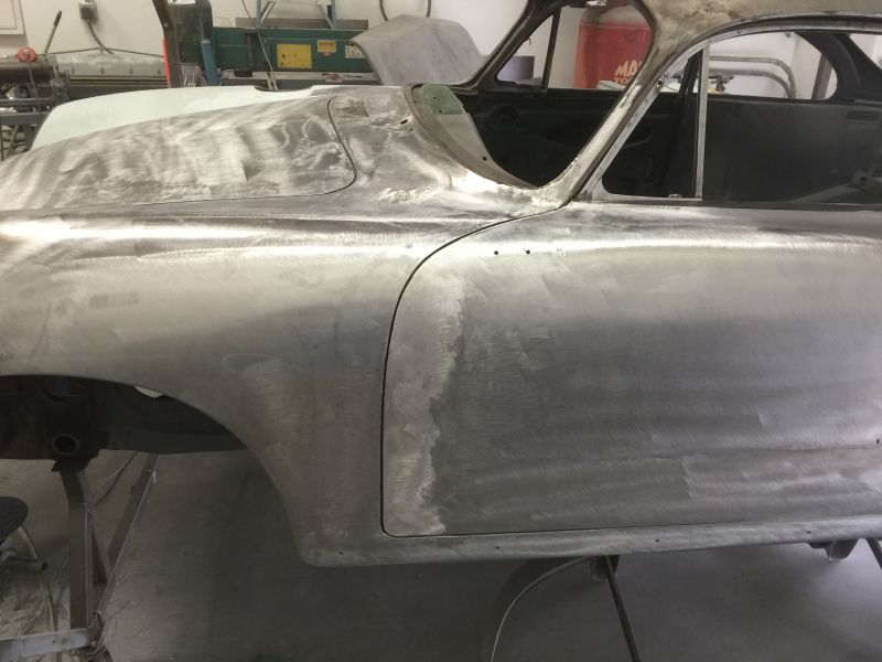

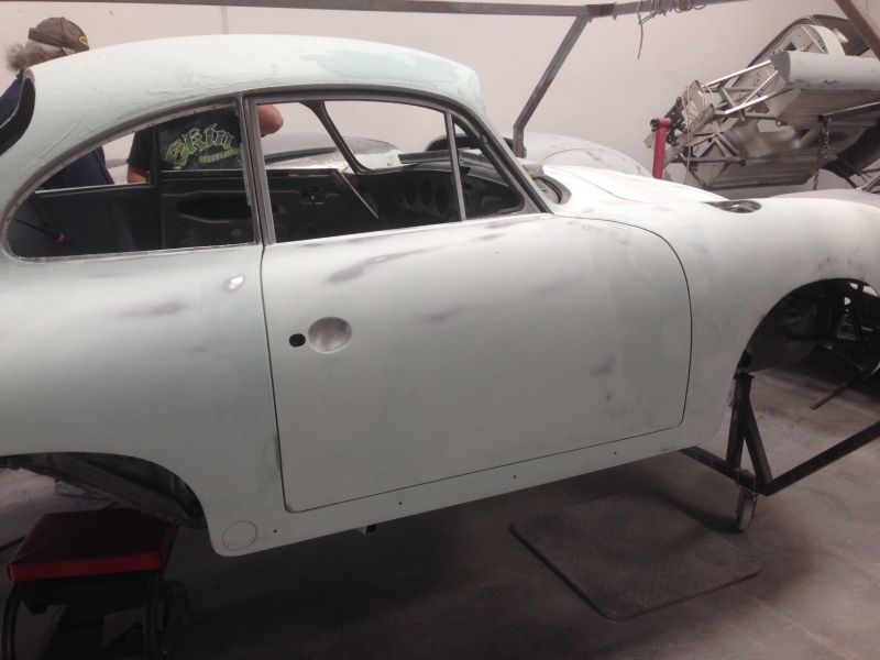

              • Here's a few more shots showing body work. What looks like primer is not.... It's the skim coat of filler. Whether the car needs it or not the entire car gets block sanded with the filler. Most of it comes off, however my car most likely needs the filler despite all my straightening efforts, ha ha. The alternative is to use lots of high build primer I suppose, but my body guy prefers filler because it is much more stable and tough.

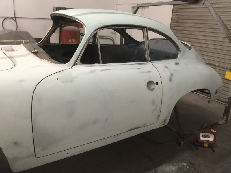

                Here's a before shot showing the body file work to check straightness and perform any last chance dolly work.
                Thanks for watching! I'm watching too now as it's out my hands! Tough to hand over, but a relief at the same time.
                • Looks like she's smoothing out really nice Tom! I know what you mean, it was so nice to let someone else take the wheel when it came down to getting my car in paint. Enjoy the ride.
                  • Tom, coming along nicely!
                    FWIW, the best polyester fill primer I have used, and I've tried most of what's been out there, is Spies-Hecker 3508, a catalyzed product that fills well and sands very easily.
                    It is like a sprayed finishing putty, just smooth and easier to sand with 180. It is usually over metal that's been finished with a thin coating of filler as shown on your shell... as it's basically more.....well, filler. It's what we use to fill sanding cuts and scratches, file marks that were exposed with the spread-on filler, pin-holes, etc. A 'final filler' that is, did I mention?... very easy to sand.
                    We often use multiple coats with sanding each time with a powder guide-coat. Often, one coat is enough, but if there is a break-through while sanding, we seal those edges with a bit more 3508.
                    When sanded dry with 180, coats of wet-sandable (and tintable) urethane primer is it's next coating, then the top-coat of color. Funny, all of these products are not "paints".... they are technically "plastic coatings." Gone are the "good old days" of lacquer primer, lacquer putty, lacquer paints, the good buzz from the fumes, then the headaches, then the sand and polish. And beer. Simple chemistry, simpler times.
                    Continued good luck,

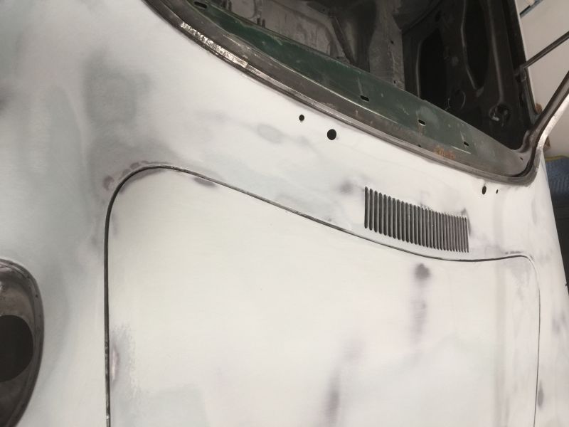

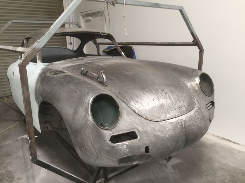

                      • Here are some more body work shots.
                        Happy with the progress so far in no particular order.
                        Thanks,
                        • Looking good Tom, your guy is leveling that out nicely! Those shots are bringing back alot of frustating memories for me. You were very wise to farm this very messy and labor intensive phase out. Looking forward to your next update.
                          • Great gaps!
                            You'll be happy you spent the time on them!
                            • I agree with Don, those are great gaps! Its the first thing people look at. They look closer than factory to me.
                              Well done

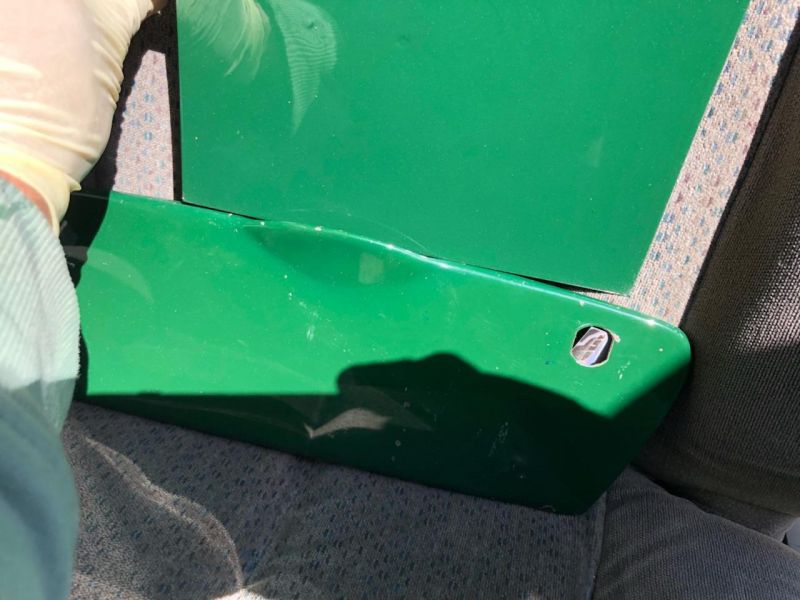

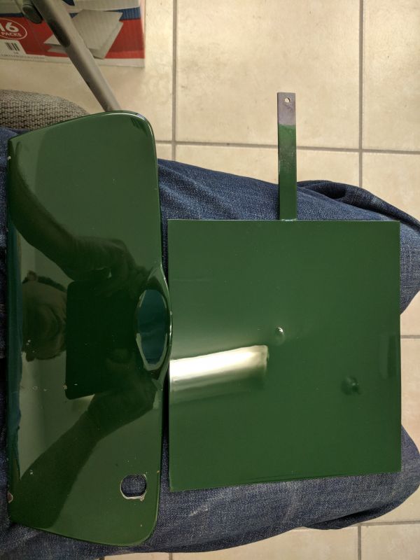

                              • Here's the color match to the original glove box door.
