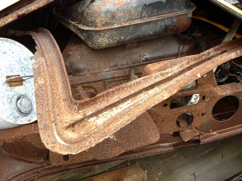

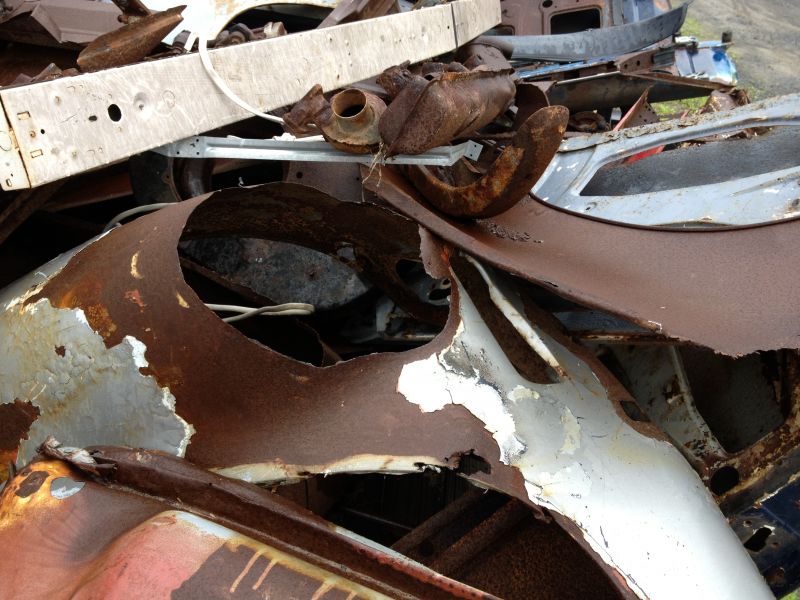

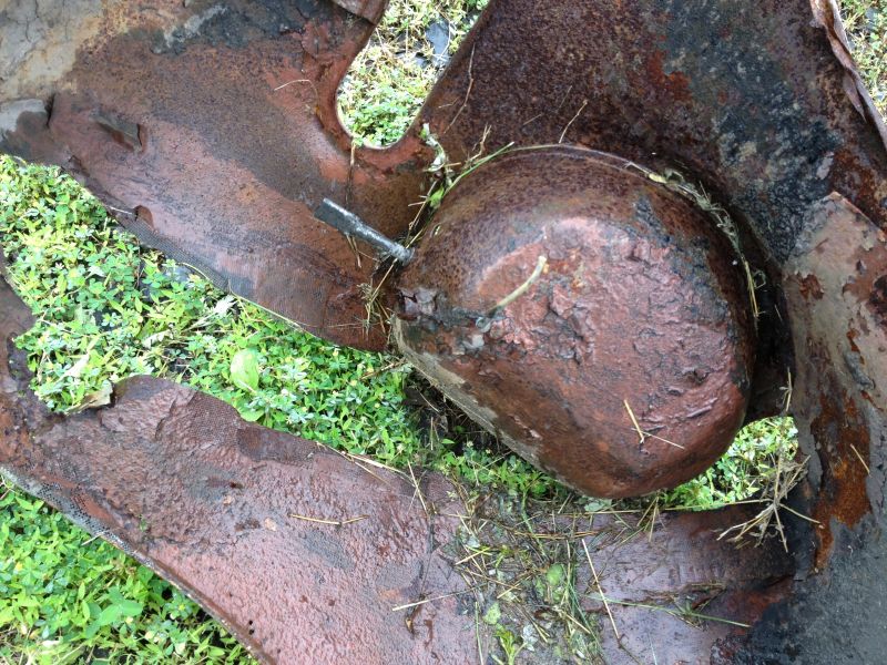

    Following are pictures of old 356 parts that have 'project potential' written all over them. The headlight bucket is a keeper. Or at least the rubber drain. The two hood inner frames, while one is reinforced, would be difficult to ship.
    Seriously, these parts with others of more bulk (brake rotors, old batteries and bad crankshafts) are going to 'the scrapper'....a better cause than most by being a former neighbor with a seriously handicapped son who rides around in a van with him, towing a trailer, collecting whatever people give him to take to the yard...to help ends meet while his wife works at a modest corporate job. "There, but for the grace of God, go I...."
