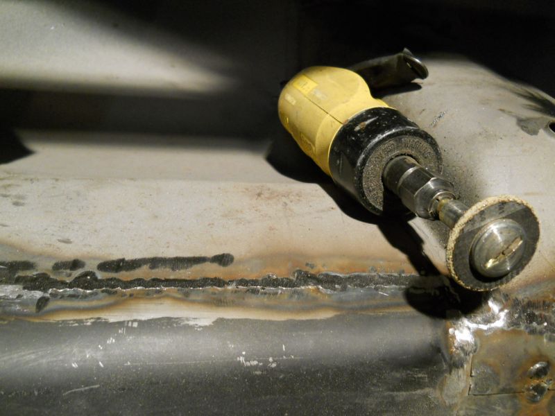

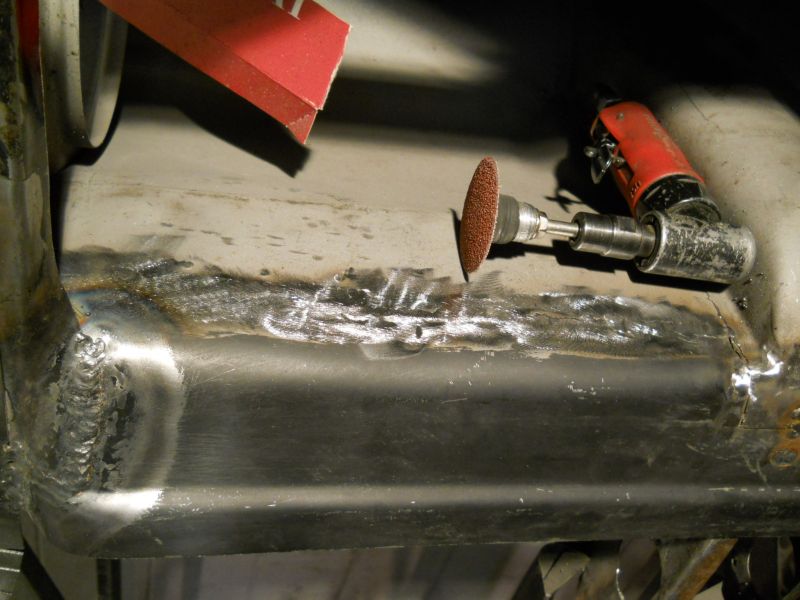

      Yes Mark, I just let the MIG blobs flow right out with the torch. I just use a standard Victor handtorch for this.

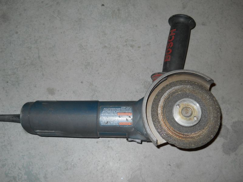

      I use the 3M Roloc system as well but I take down 90% of the weld shoulder with a cutting wheel.(wheel and end stage pictured) Since the welds are harder than the surrounding steel leveling them first makes the roloc stage much cleaner. It also saves rolocs.

      If I have a clean shot at it I prefer to do this initial leveling phase with my electric grinder
      I then use my angle grinder with rolocs to finish the joint.
      I too have tried all the cheap cutting wheels and disc's. They just don't last and I think its more cost effective in the long run to go with the good stuff. My very wise friend and mentor Greg Parker gave me this pearl of wisdom many years ago: "Buy the best and cry only once"
      As the years roll by I am finding out more and more how right he was about alot of things. Justin

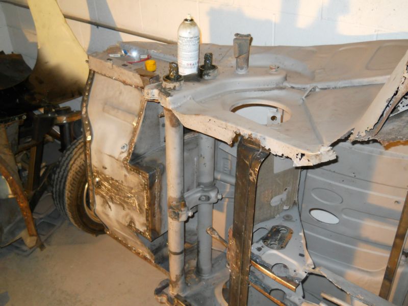

              6/30/13
              Addressing the left forward frame section.
              Chassis has now been flipped on its right side so I now have a clear shot at this left forward section.
              Strut brace cut free here. This side should go a little quicker with the toe-board section already in position. Thanks for looking! Justin

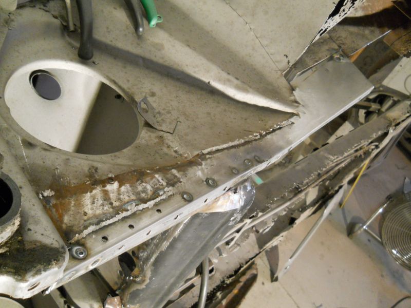

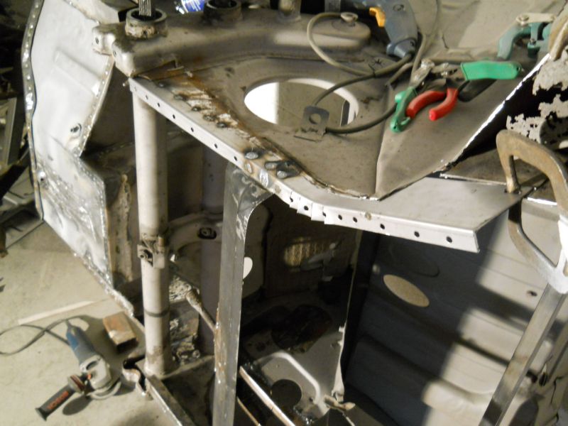

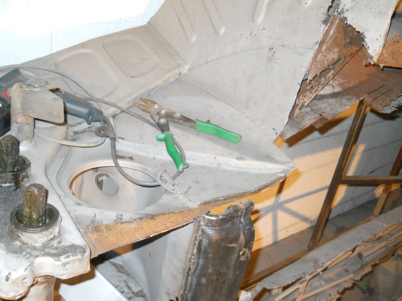

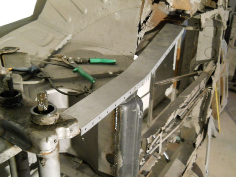

                    Left forward repair section tacked in. 7/1/13
                    Rough trial fitments again for the new panel. Relief cuts have been made on the flange to achieve that gracefull curve. If I owned shinking and stretching jaws I could have avoided making those cuts. Yet more tools I'd really like to have. Another tool added to my list.

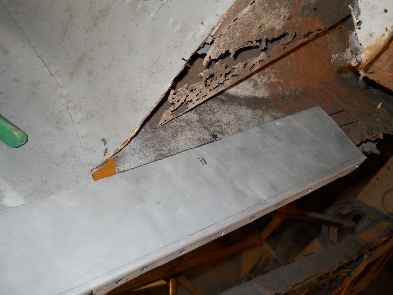

                    This side is just a bit rustier than the right side. The cancer along the splash pan mount flange runs higher than the perimeter kit. A seperate patch is required.

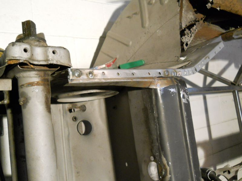

                    Both the frame and the new section have now been prepped and trimmed to fit so I can begin tacking it in.
                    New section tacked in this afternoon. Will finish stitching it up tomorrow. Thanks for looking! Justin

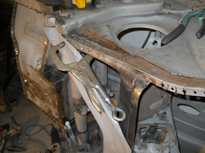

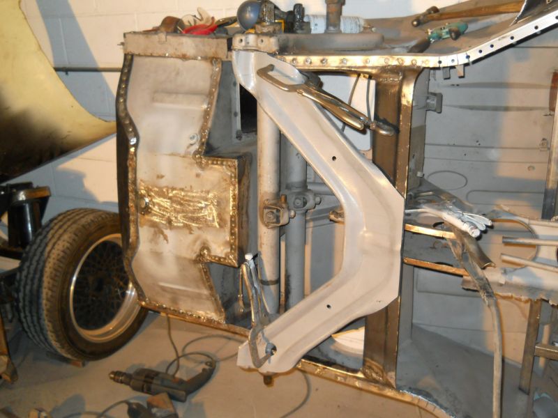

                            7/3/13
                            Stitch welds all but finished here.
                            Installing the T1 Style reinforcement runner on this side. Just about ready to button this up. This side went pretty quick for a nice change.

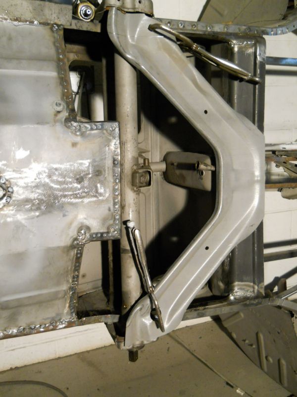

                            • 7/5/13
                              Right side lower forward repair complete.
                              Finished welding up the T1 style reinforcement runner this afternoon.
                              Test fitting the new diagonal brace.
                              Will try and get this tacked in tomorrow. Thanks for looking! Justin
