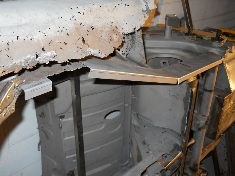

            6/6/13
            Toe-board Bulkhead tacked in.
            Yesterday was spent fine trimming and trying to achieve the best average fit.
            About as close as I could get. Ready for a couple of tack welds to double check.

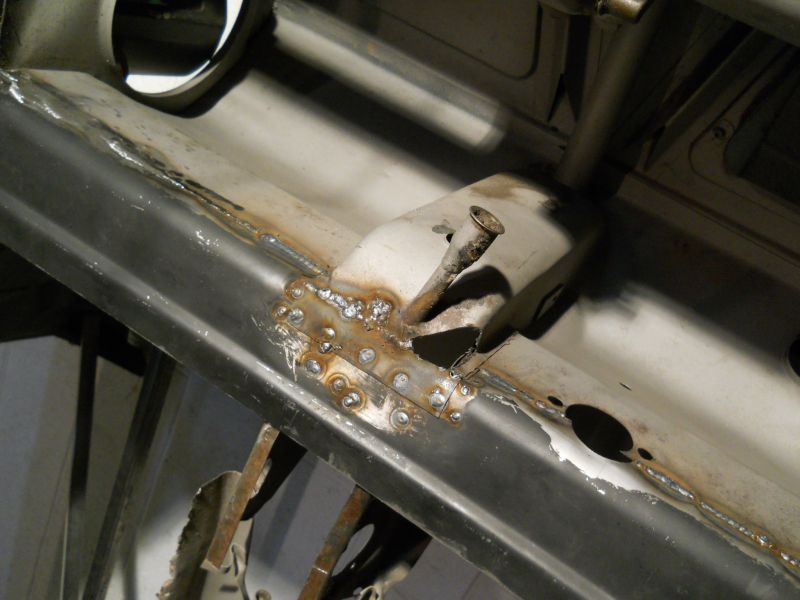

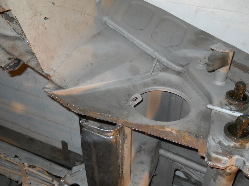

            The pre-punched hole for the master cylinder is just out and low to the original hole in its best adjusted position with "frame rails" and center pocket. I ran into the same problem on that rusty Speedster I did several years back.
            Here's a shot of that old Speedster. A now confirmed and conistent misalignment with the original hole. If your doing this repair above the old master cylinder hole be sure to make a templete and keep track of where it originally was or you may experience alignment issues when you go to install your pedal assembly. Don't assume the repro part is correct; its been my experience that it is not.
            This is as far as I got today. More welding tomorrow. Thanks for stopping by! Justin

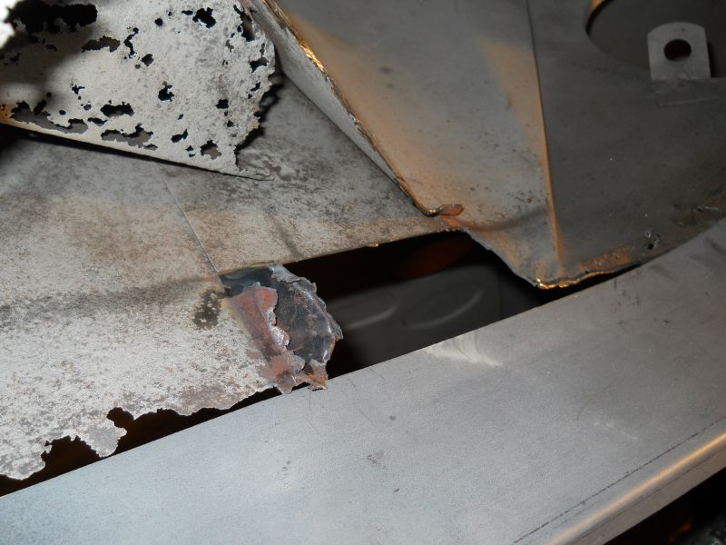

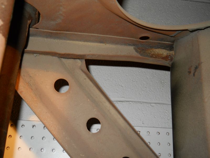

                6/20/13
                Right side forward frame/flange repair.

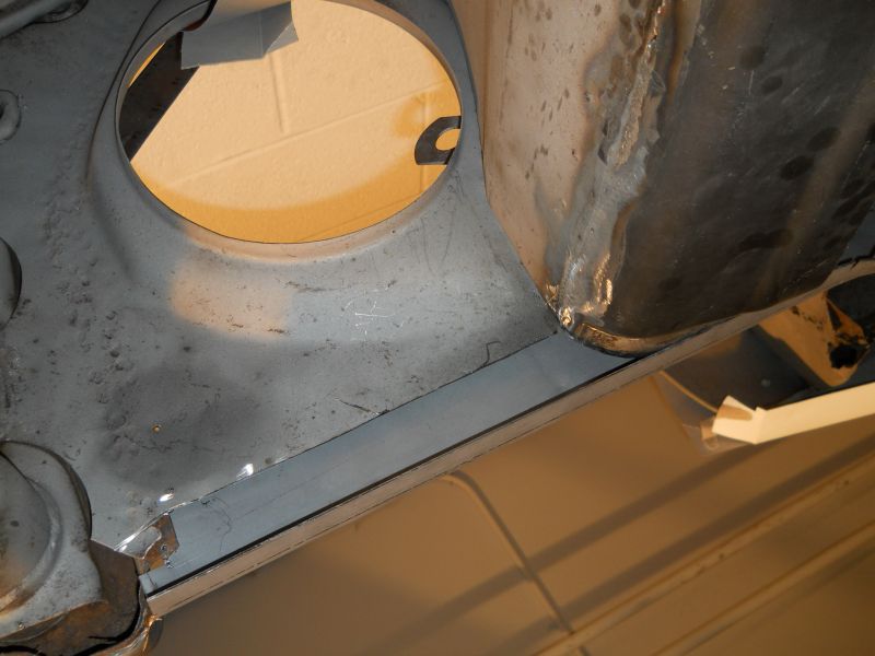

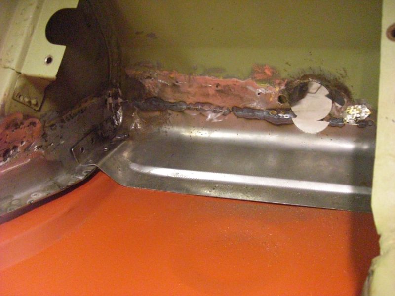

                Lower toe-board panel just about all welded in. Replicated the lower mount flange on the original pocket. Have just a small patch to one side of the pocket to add.

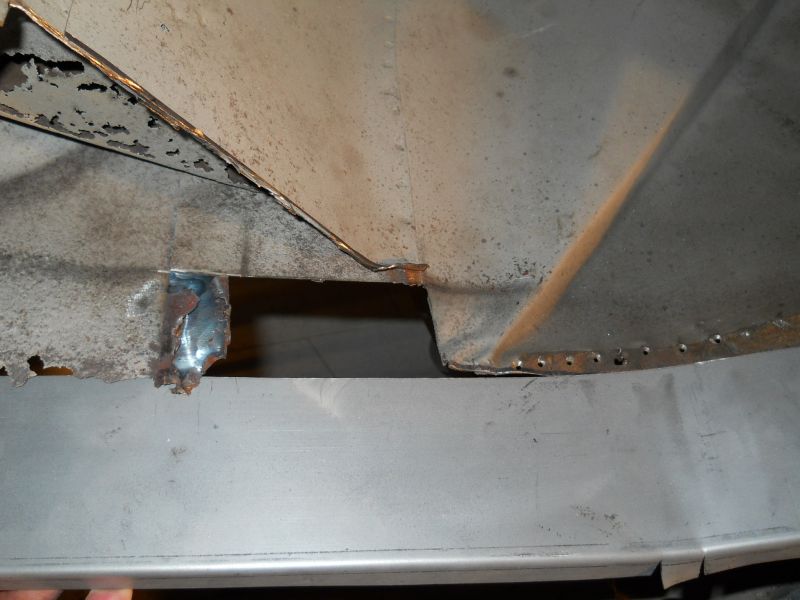

                The actual elevation of the step flange is undetectable so I had to take a measurement from my car using the heater tube opening as my landmark. Sample section clamped into position here to establish the correct height.
                I could now set the proper height on my new piece and get my cut lines drawn in.

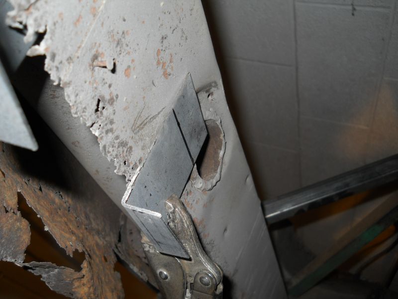

                  Just about confident enough to draw some lines. Thankfully all the new pieces seem to be tying in nicely together; the Toe-board flange at lower frame area here.

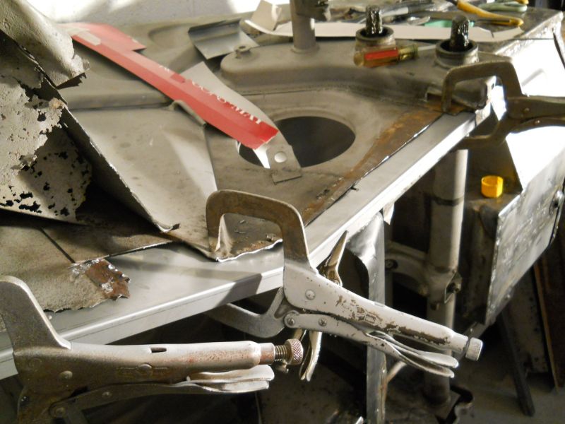

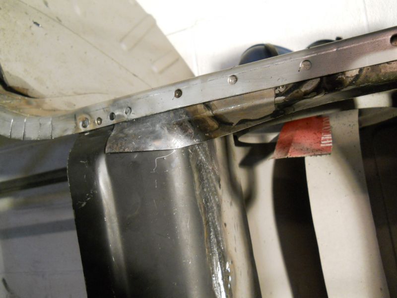

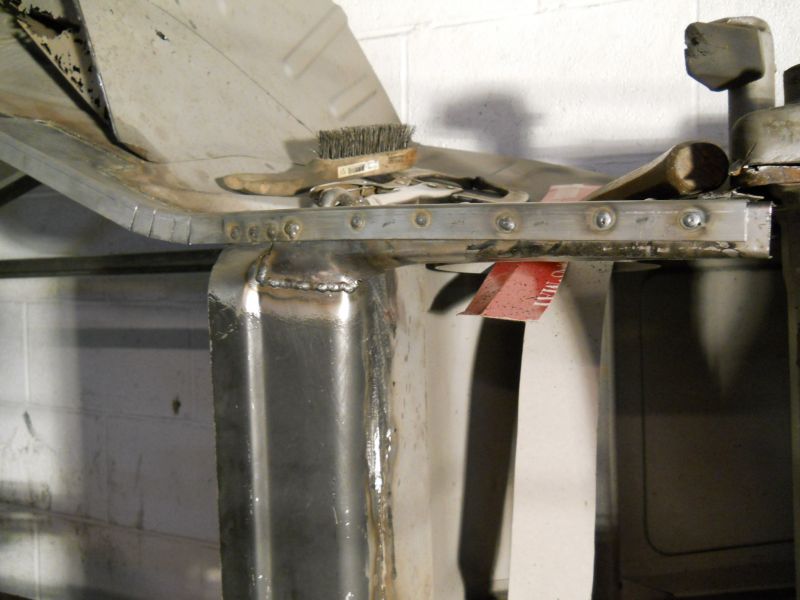

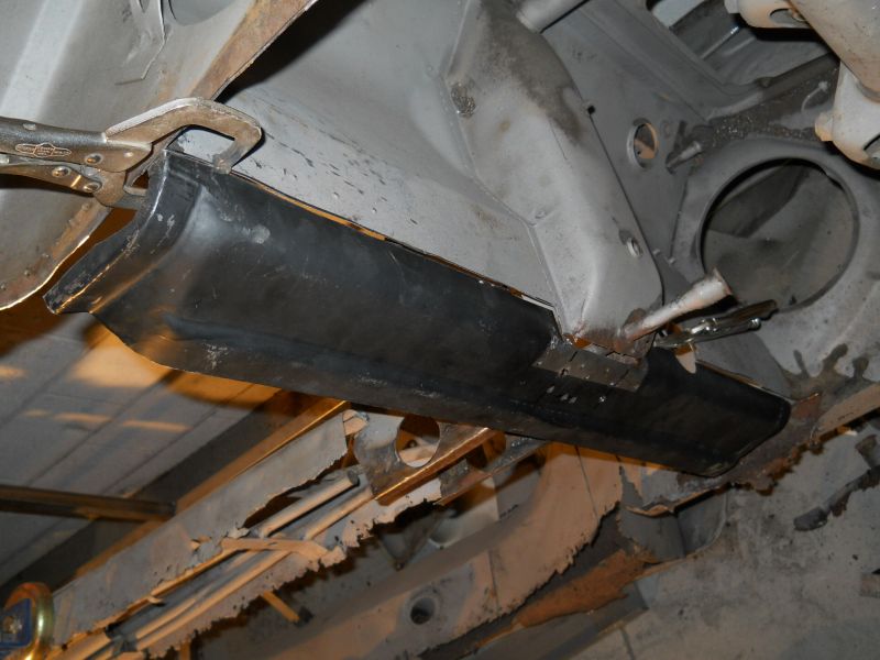

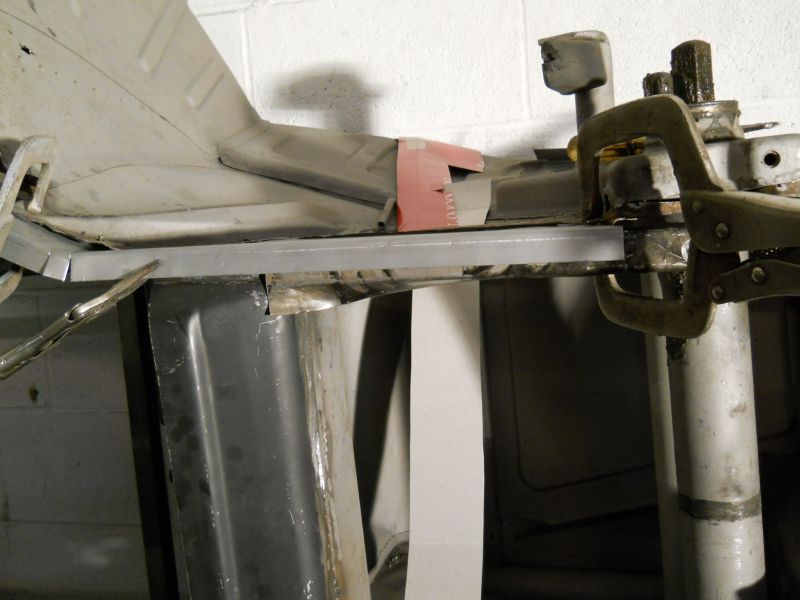

                  Again the owner wants a detail correct T1 conversion so the outer reinforcement T2 strut is out. I have to fab-up a T1 style inner runner like the original example above.

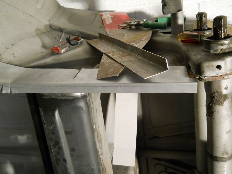

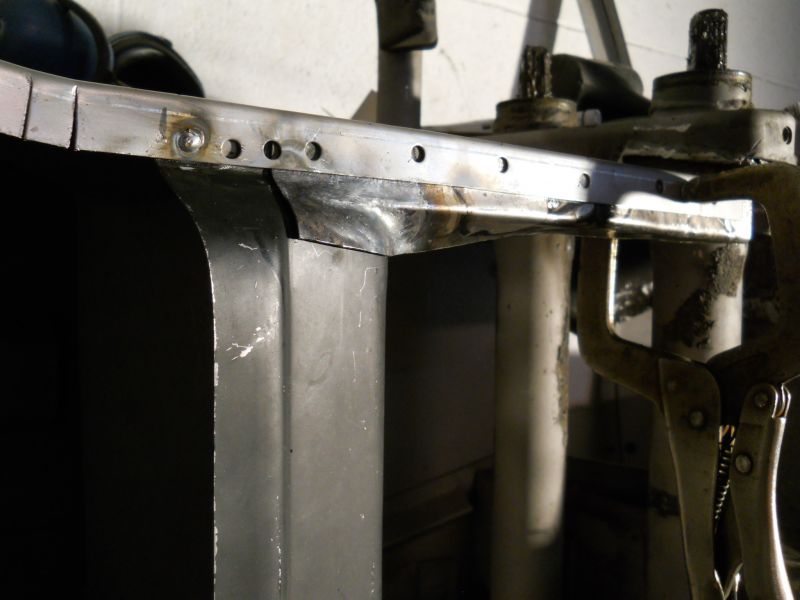

                  Began by making my first bend in some scrap I measured out based on the original dimensions.
                  My new U-shaped channel complete here and ready to be fitted.
                  Slowly fitting it in with the new repair section here. Looks and fits just like it should; overlaps the lower flnage just the original did. inside wall by the bulkhead gets turned down and seam welded to the toeboard flange.
                  Original detail example pictured here of my T1 coupe.

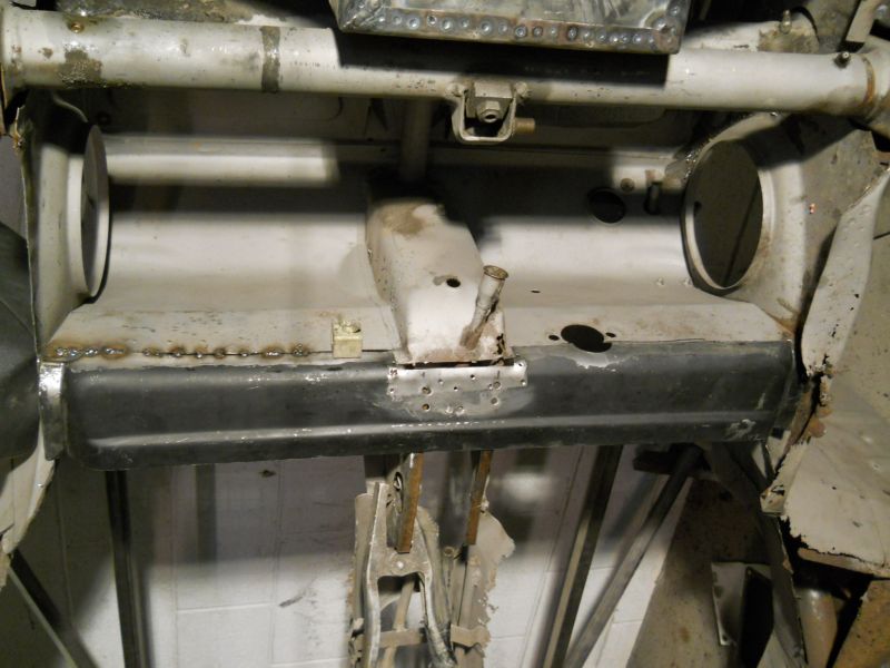

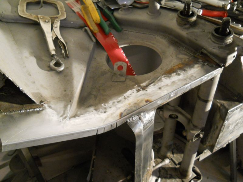

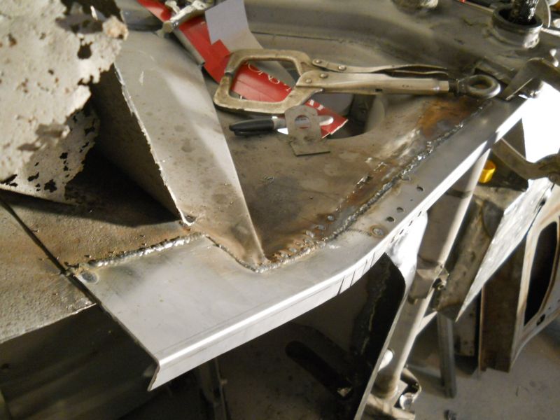

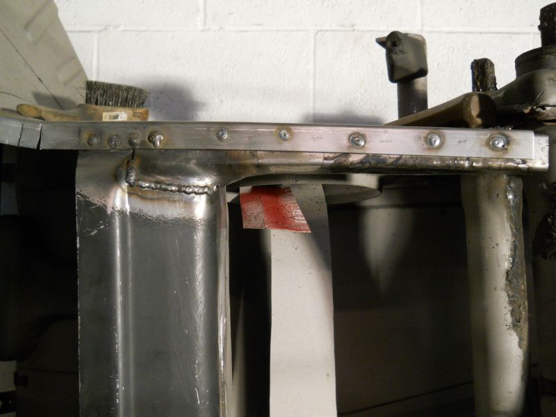

                        6/21/13
                        Section now welded in
                        New lower repair section cut to shape and welding begins.

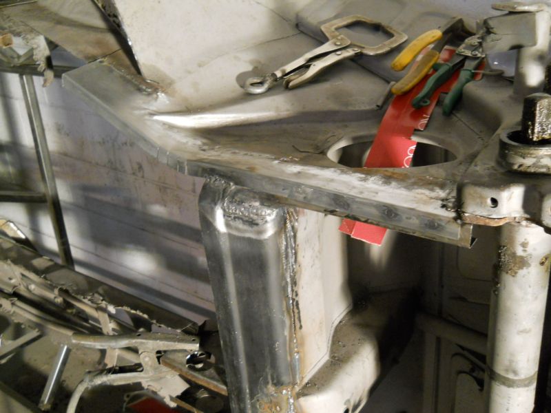

                        Just about stitched together here. Again the factory joint/break replicated at the end here. Also punched holes to plug weld the Toe board bulkhead wall onto this new section.

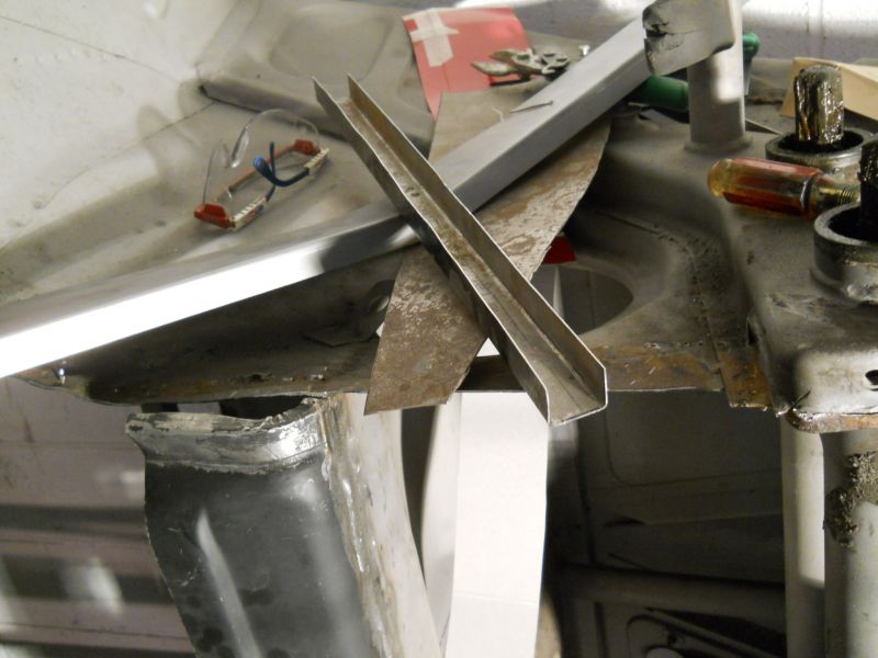

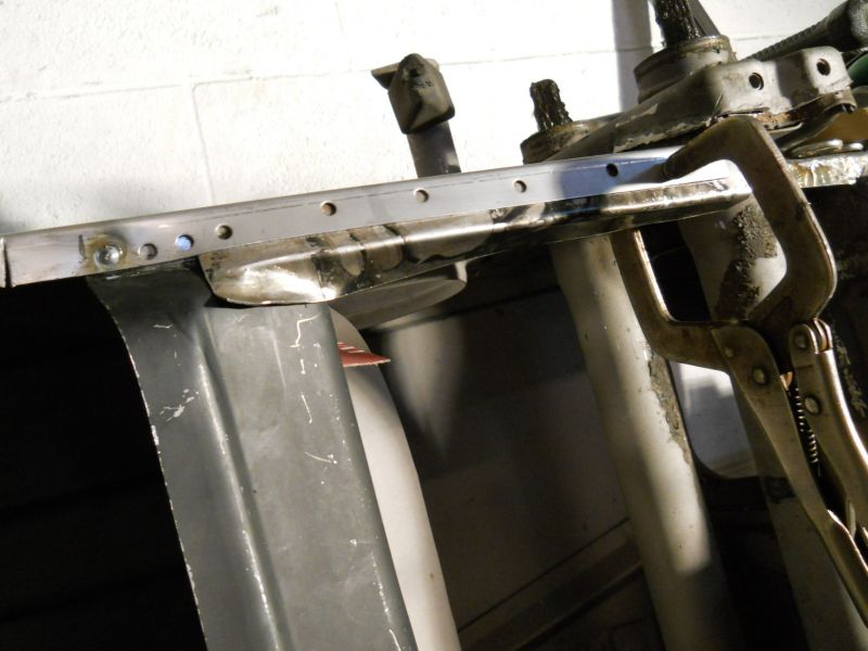

                        With the new section most of the way secure I began tapping the new T1 style reinforcement runner into position.

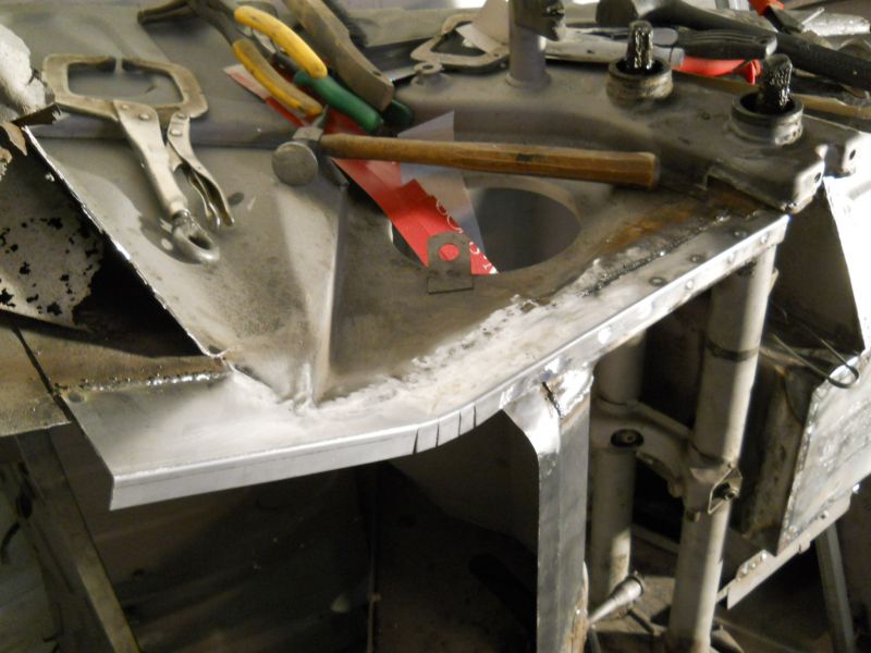

                        Now that it was in final position a little torch heat was needed to form the flange tight against the bulkhead.
                        form fitted and ready to be welded on.
                        Welded
                        Will go back with my torch to replicate a gas weld as originally.

                              Thank you Brock! No, I'm not going that crazy. I just follow the areas that were originally supposed to be seam welded with my torch. Yes, you will always be miles ahead starting out with a dryer chassis! Smart move on your part.
                              Hey Mark, I'm just melting my MIG welded seams with my torch for a more authentic detail. I've seen several spot weld replicators but I have my old Lenco panel welder here that gets the jog done.

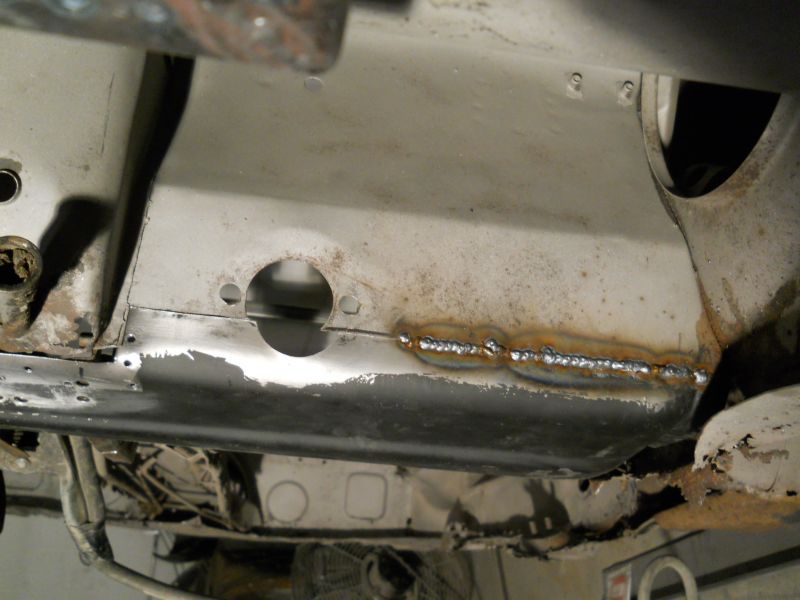

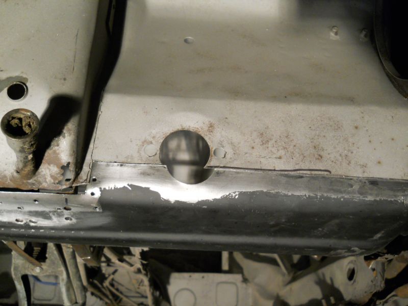

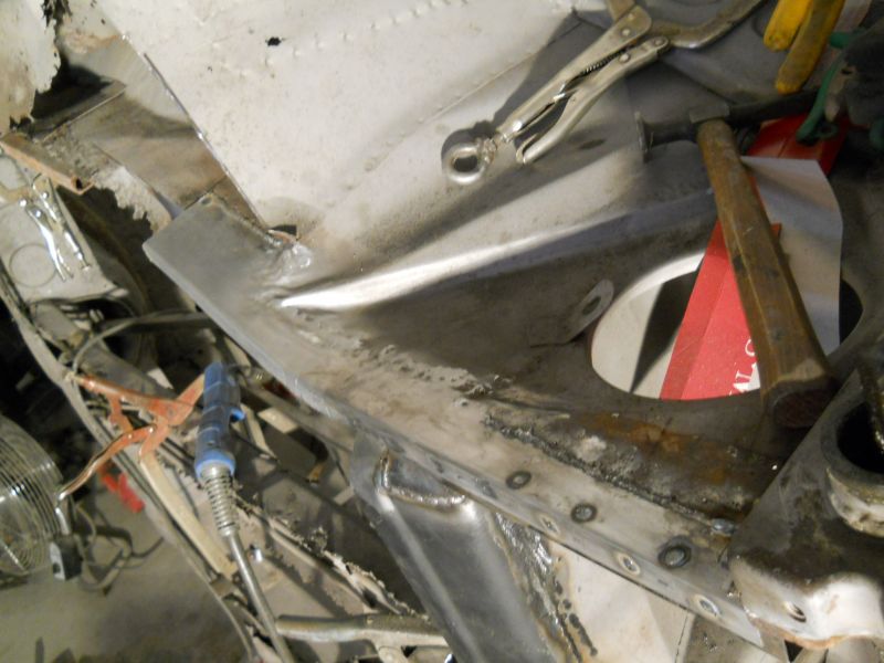

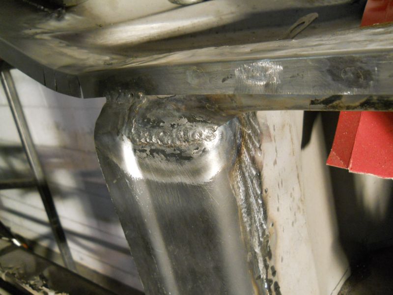

                              6/22/13
                              Repair section now fully welded and dressed.
                              Done on this forward side.
                              Seam welded here just the factory did it. I chased my MIG welds with my torch for a more correct gas welded detail.
                              Okay, repeat other side. Starting that tomorrow.
