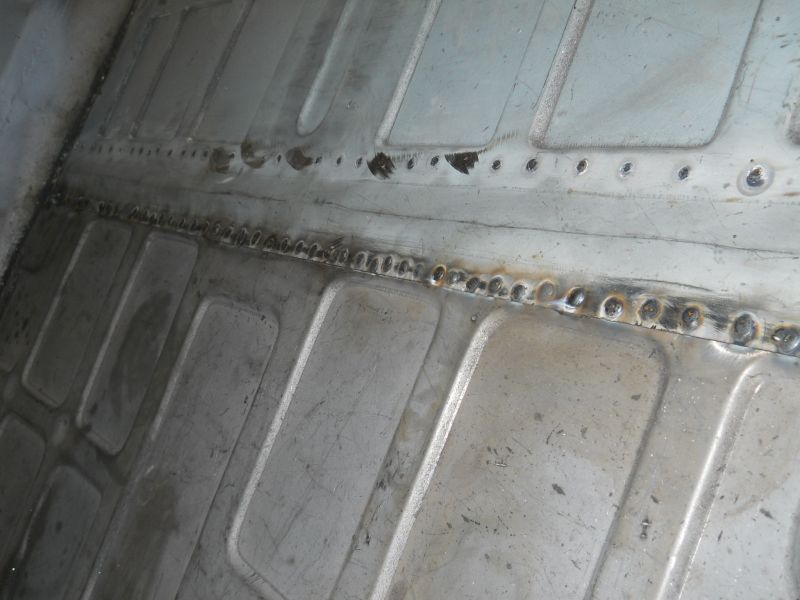

            They are spot and/or plug welded on both sides.

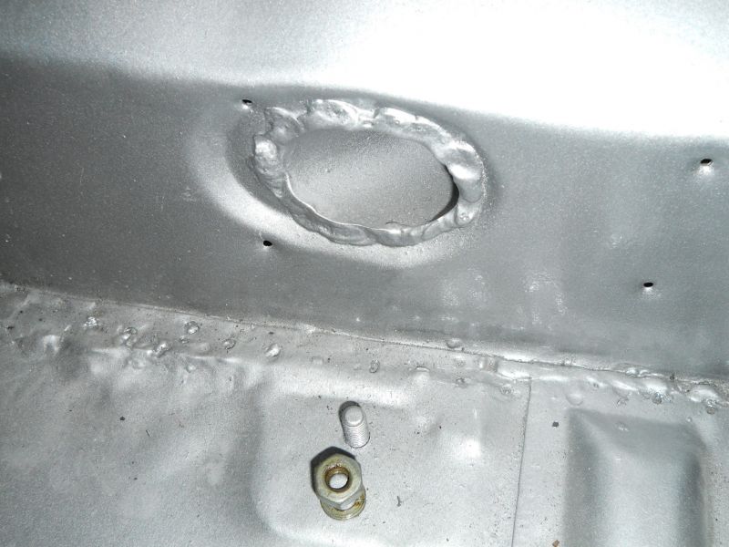

            This lap joint was also seam welded along inner lateral sections up against the wall. You can see the original welds here on my coupe floor.

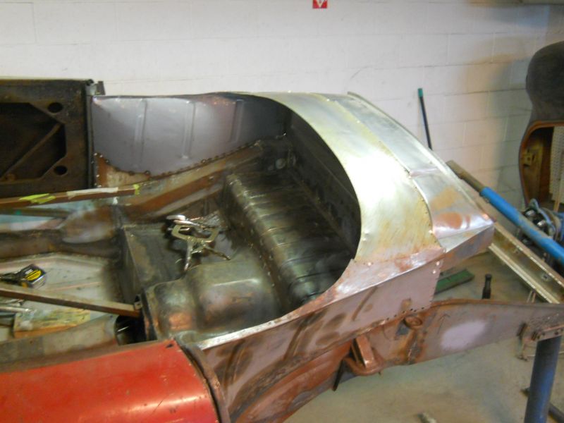

            Inner closing panel set.
            With the cowl measuring out even I could begin attaching this new panel to the lateral sections to tie them all together cementing their positions.

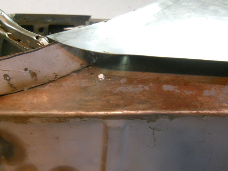

            removed the cowl again to begin welding this panel to the firewall flange.

            Plug welding begins.
            Thanks for looking! Justin

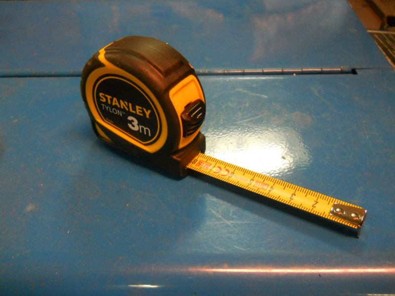

                  A metric version tape. He was kidding me earlier on this thread about using a standard tape to build Porsches so while he was at the Hardware store he felt very compelled to upgrade me. Thanks a lot for this nice gift Per I will use it regularly and with pride!

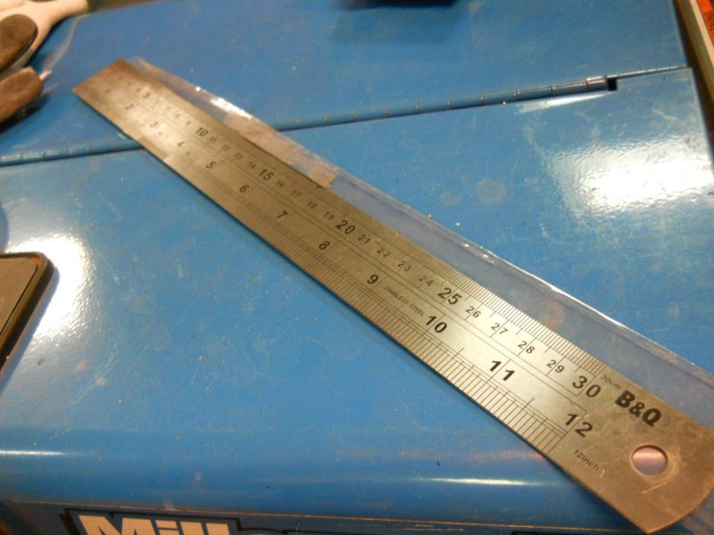

                  BTW: some time back I received a package from the UK from my buddy Steve Masefield and in it was this nice stainless standard/metric ruler with helpful conversion table on the reverse. It has come in quite handy as well so my thanks again to Steve! I must really be driving all the European guys crazy with my standard measurements and didn't realize it. My thanks again to you guys for not only these nice gestures but for being part of this site. I am very blessed to have such a great group of fellow enthusiasts here!!!

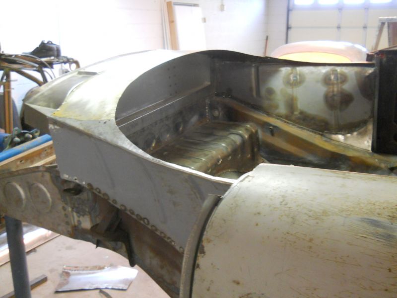

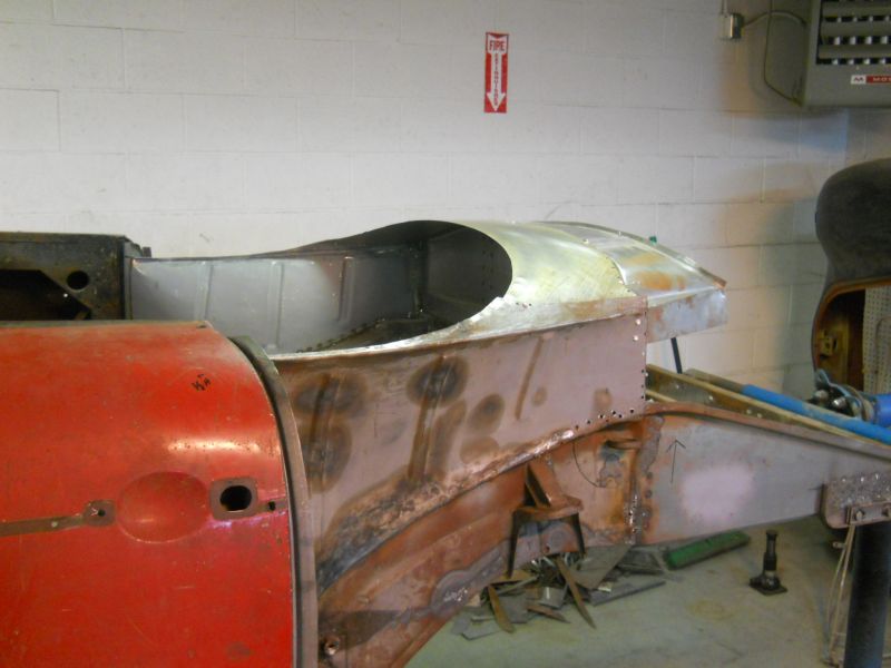

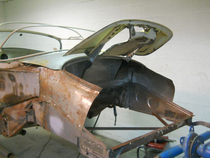

                      9/28/15
                      Engine compartment forward closing panels.
                      Now with the cockpit substructure getting close it's time to begin fitting the rearward sections.

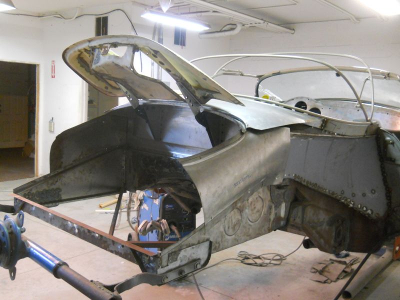

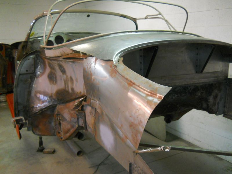

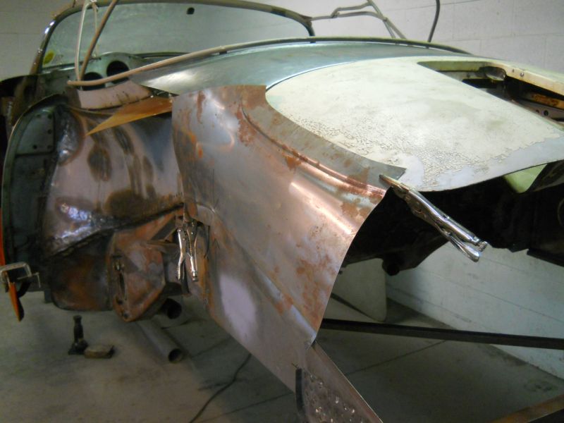

                      Decklid remounted and profile set to continue the line off of the cowl to begin fitting the new corner pieces.

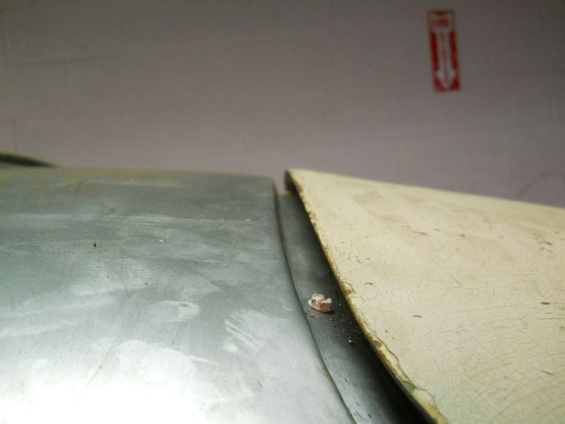

                      As you can see I have an elevation issue with the hinged lid. I could weld up and redrill the hinge holes lower to level it but...
                      An easier approach is cut and take a few mm's out of the lids hinge mount where I'm pointing at. I made this exact adjustment on a spare lid I had for a coupe a few years ago. Fortunately as luck would have it I was talking with Rusty Tubs about this and it turns out he sent me the wrong speedster lid for this project. This is actually your lid Drew so thankfully this mistake was caught before I cut on it. Will be sending it out to you shortly.
                      In the mean time I could still get this closing panel within striking distance with what I have.

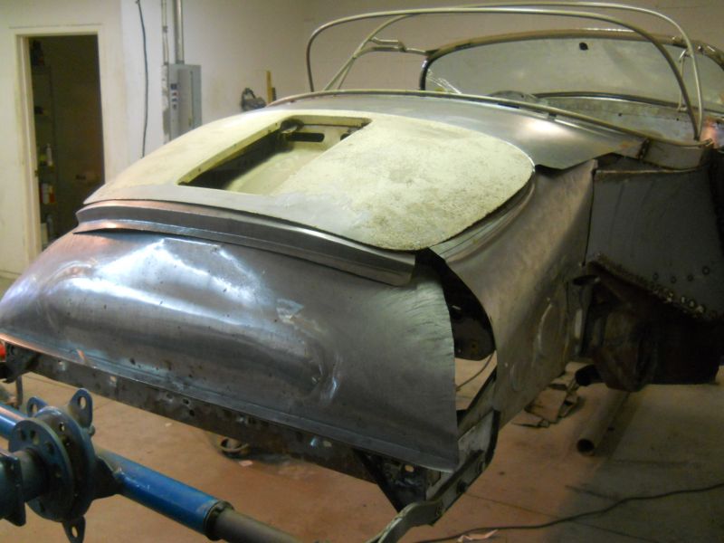

                          Wow, its already been 6 weeks since my last entry, how time gets away. Getting my coupe into final paint and also waiting on my next order of panels from Trevor Marshall side tracked the progress for a bit but I just took delivery the new closing rear wall from him so progress can begin in earnest once again. I've had the forward closing walls of the engine compartment mocked up for over a month now but they didn't excite me enough to post about them but with the new wall here I'm ready to share it so there are no gaps in this story.
                          From last month: 10/15
                          Slowly working my to finding the best average adjusted fit.

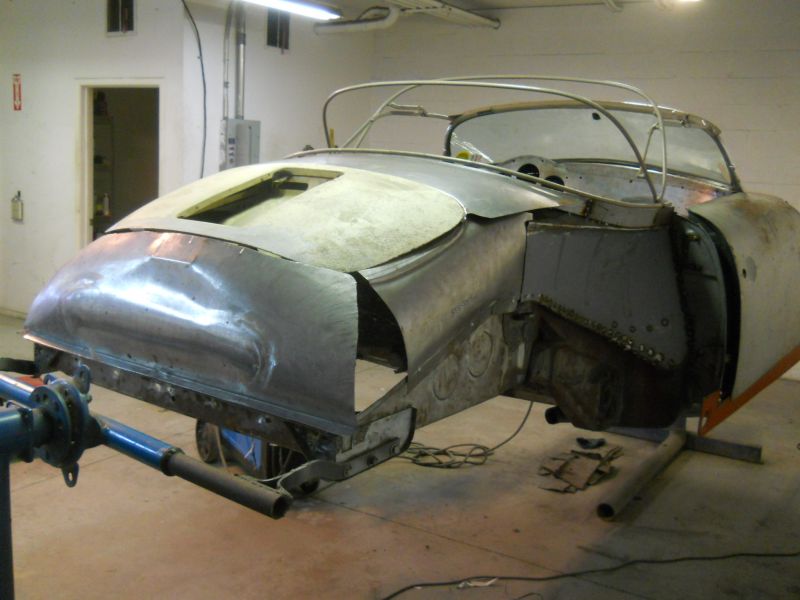

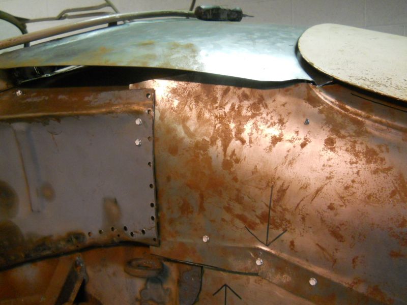

                          Initial trimming and adjustment was making sure that panels flange carried the line from the cowl.
                          By this shot the flange is running near parallel with the edge of the lid. Almost ready for a few set screws.

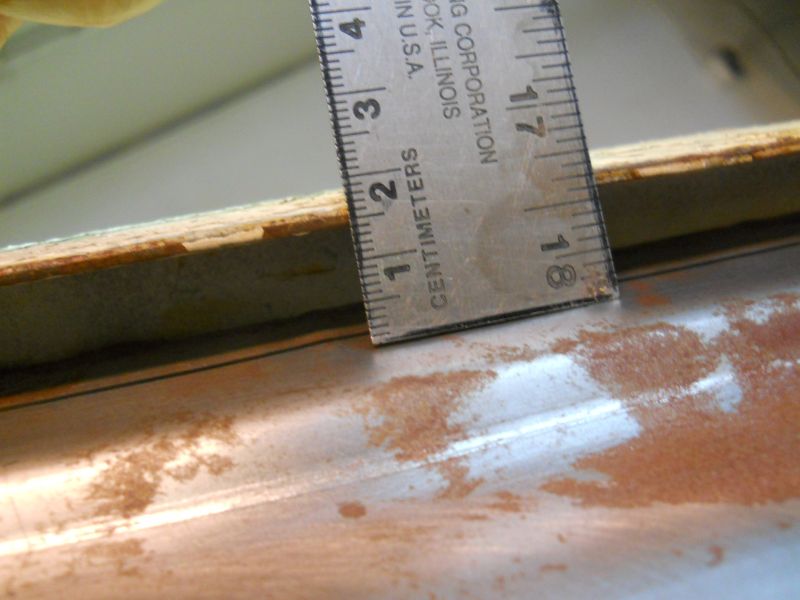

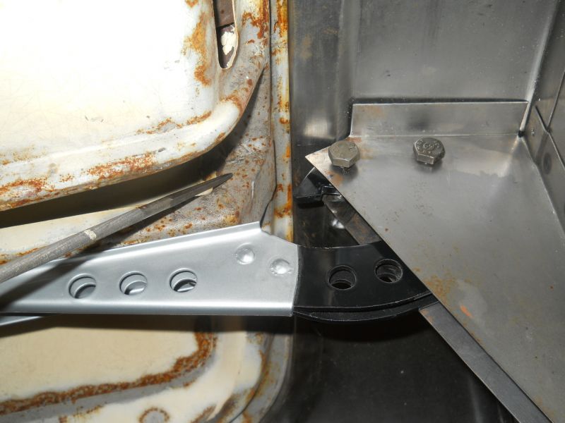

                          The next concern was making sure I had enough relief height for the eventual fender closing flange that will mate to this panel.
                          The NOS Speedster fender was showing about 10mm in relief height needed.

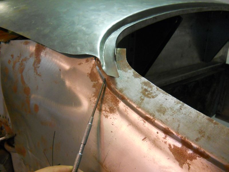

                          there is almost double that distance here. Since I don't know what trevor's flanges will be I thought it best to leave myself more wiggle room. Again nothing set in stone yet, this is all just some place to begin. The picture will come into better focus as it progresses.

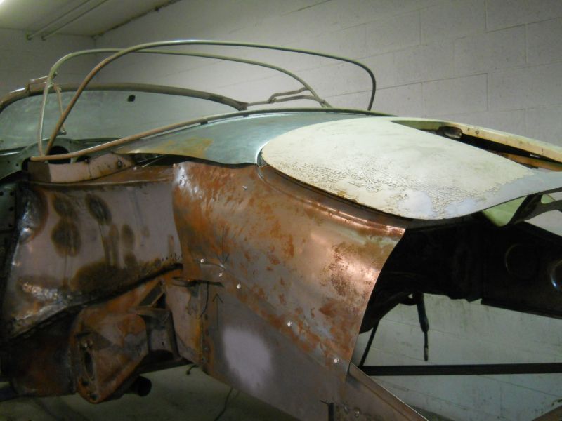

                          As I found on my buddies original Speedster this panel mounts under the forward section which is why I had to leave this area loose some time back.
                          right side also now mounted.
                          Small step but it was the beginnings of an engine compartment.

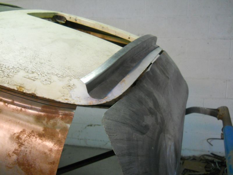

                          To go any further I'm in need of the rear closing bulkhead. I had one, sort of, but this next needed panel triggered a new order from Trevor and this last delay in progress. Will post that story tomorrow.
                          • Cutting our loses on the last of the pre-ordered Hogue panels.

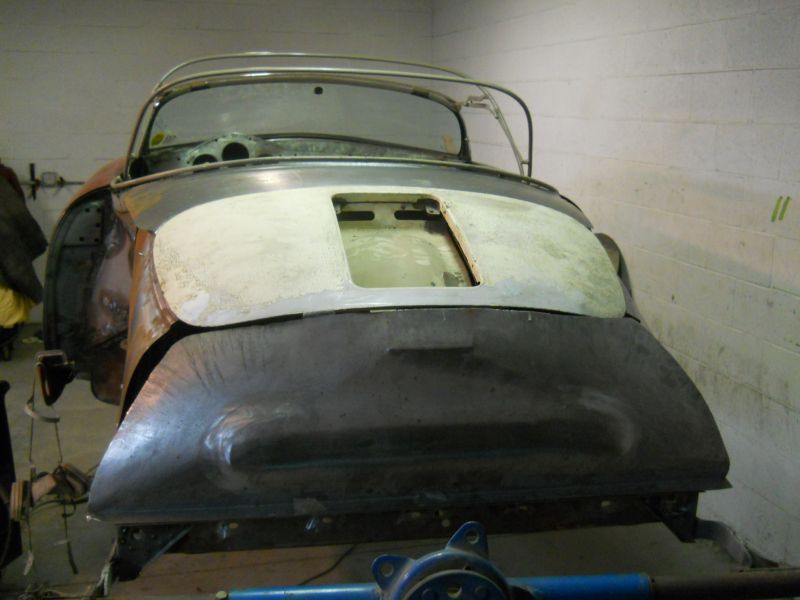

                            This is the rear bulkhead wall that was supplied to me from Steve Hogue. Its not exactly a T1 version as it has a hastily formed embossment for the later optional gas heater for late T1/T2. At first I thought no big deal I'll just heat shrink that back out.
                            But as you can see its also a little short on the corners.
                            The upper mount channel came unattached as well. No big deal and I might prefer that so I can position to suit. The point is that it just added more work and time to the finished panel.
