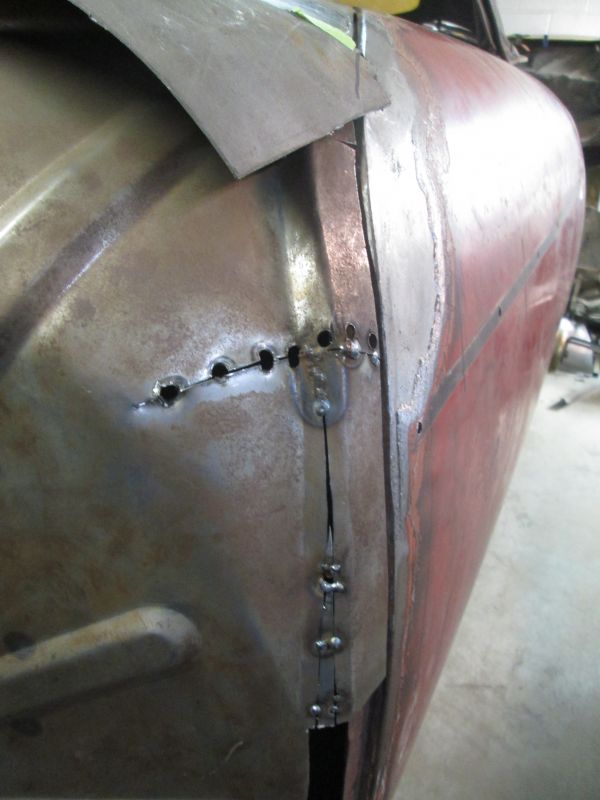

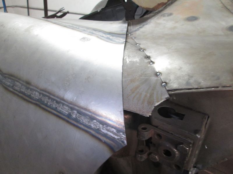

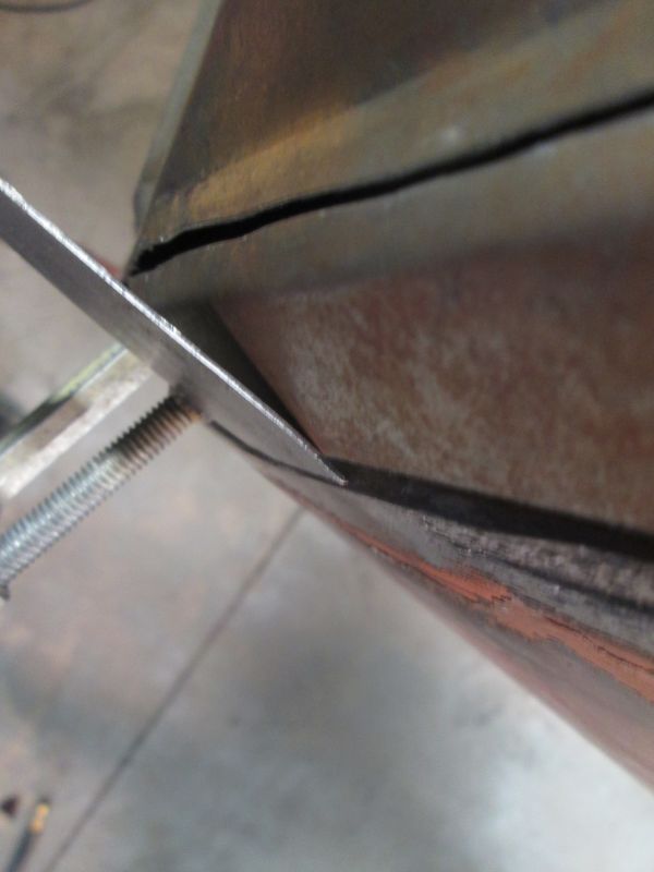

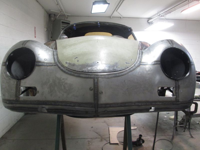

      After some light readjustment I had my basic gap as close as I was going to get it. I began tacking from the center outward. Part of that was also tacking onto the latch base and finally allowing the safe removal of that temporary holding bar I had in there.
      Fully latched once more just to make sure it all still lined up and operated properly. I was really worried about getting locked out if the mechanism jamed. Thankfully it popped right open. Dodged another bullet.

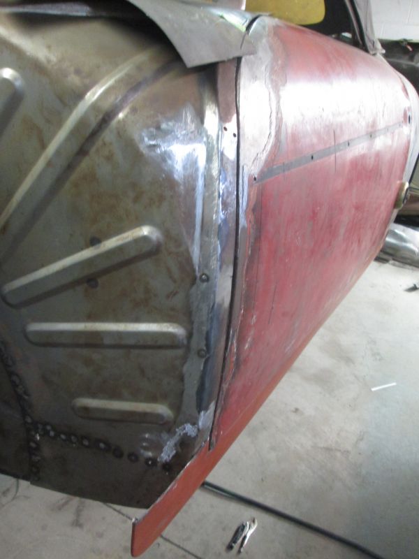

      While close, the gap has changed a touch and gotten wider toward the bottom. Nothing serious but a slight change.
      Not obsessing over it because its still within range and there is alot more variance yet to come as more welding and the fenders are added. Anyway from here on in this old girl keeps her new face on.

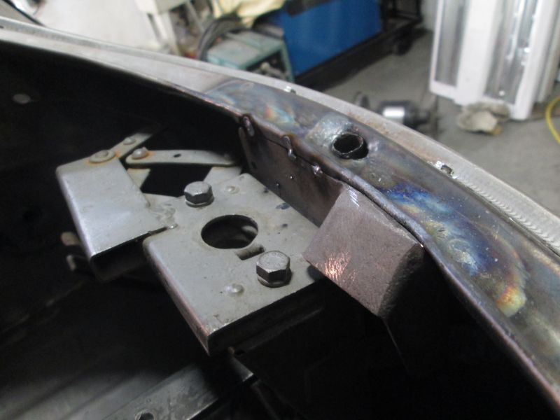

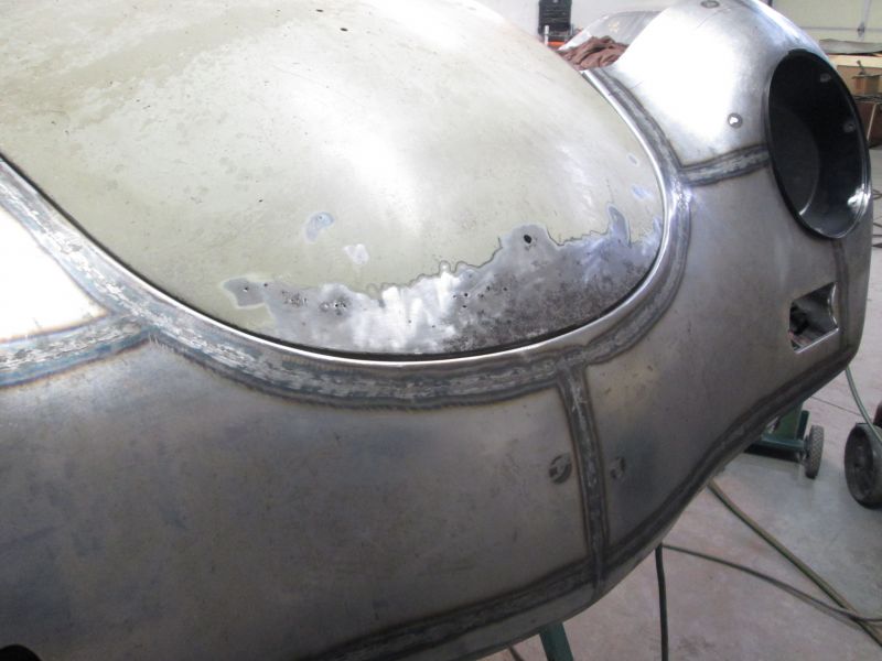

      With that I was ready to commit and begin welding from the center outward.

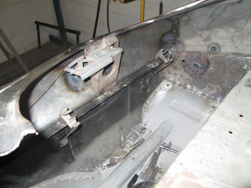

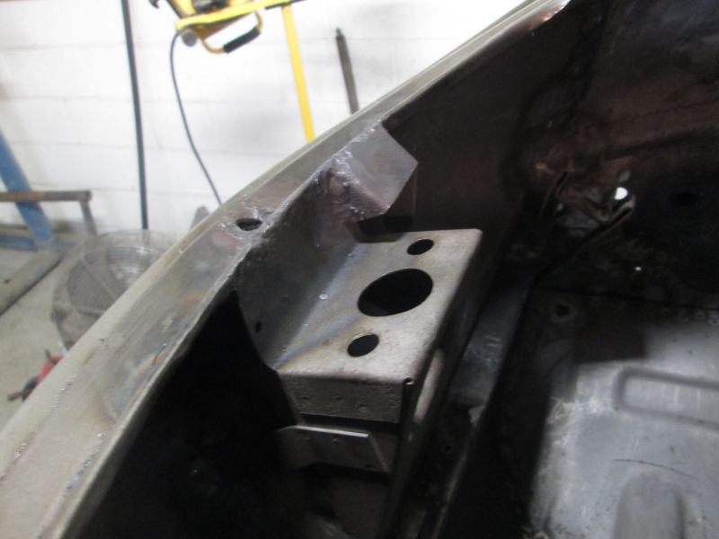

      Gas welded the drain tube and upper run of the latch base as originally found.

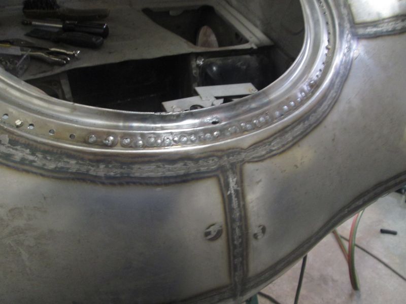

      Most of the plug welds at the center were set before I fused the latch area.

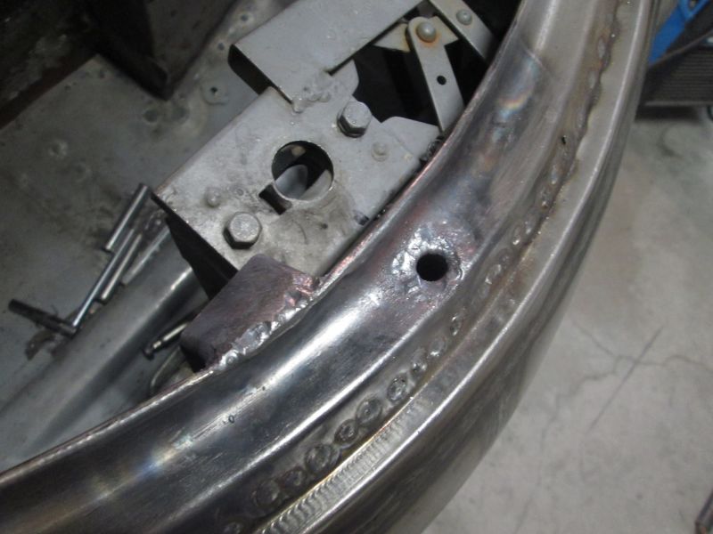

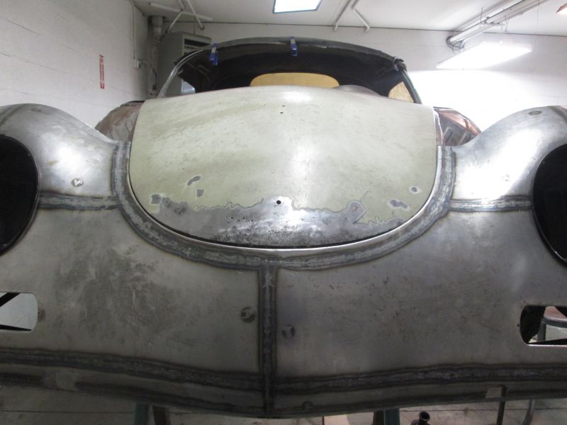

      Entire run all stitched in. A bit a fear soon set in as I worred about possible changes to the base from all the heat. Fortunately it did not.

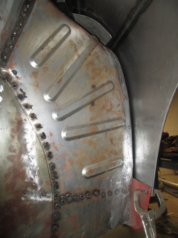

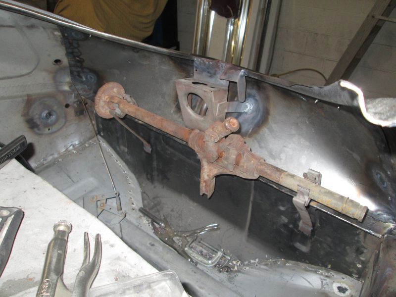

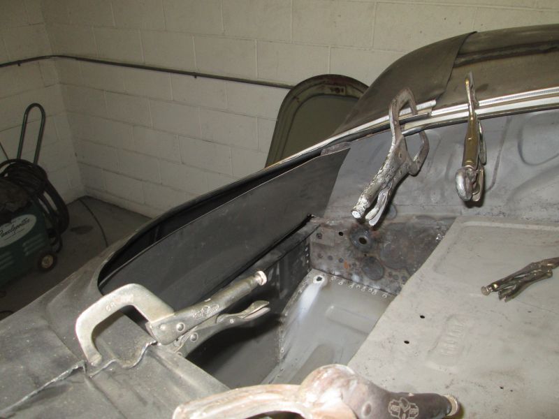

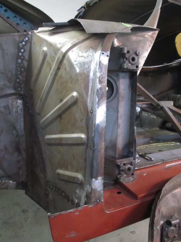

      I was finally able to try out those perches with a real jack; everything seems to fit fine.
      I remember initially mocking all this up trying to get my head around exactly how I was going to make all these panels fit and work together correctly. This was sort of the mental checklist: That crazy curved inner panel thats not fitting too flush at the moment has to butt up tight to the nose, hold the nose in the sweet spot so its gapped nicely against the hood. Then the latch base must be attached to it at just the right attitude so it engages correctly. "your in way over your friggen head here" These where all the thoughts and doubts I was going through when I took this photo. All I could do was put one foot in front of the other and the next step slowly revealed itself. So in other words you just have to go slow and take it as step at a time. If I did it so can you.

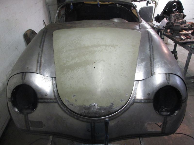

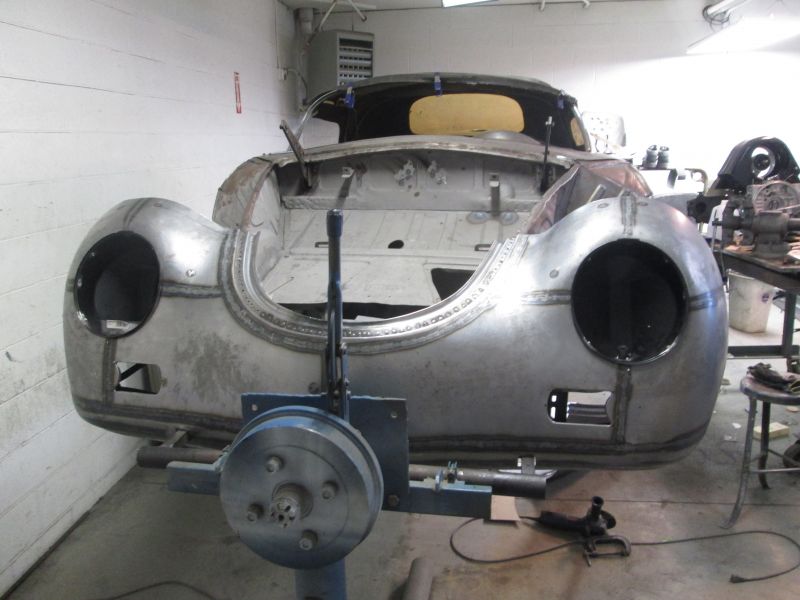

          • 1/31/17
            Car mounted fully back on the hoist.
            The nose was buttoned up just enough to allow remounting on the rotisserie. The ability to tilt it will make fitting the fenders alot more pleasant.

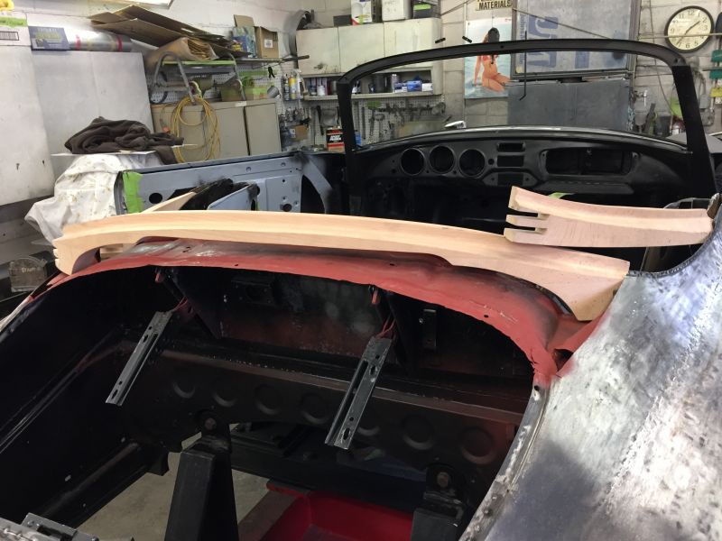

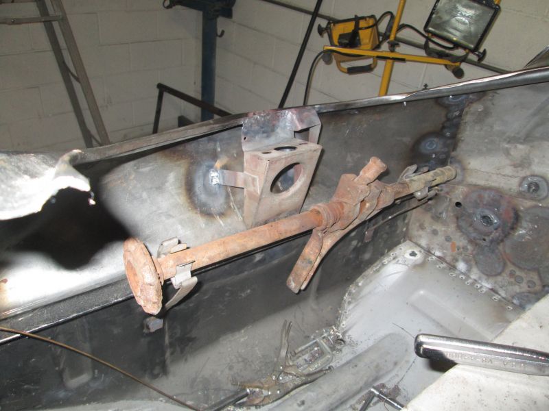

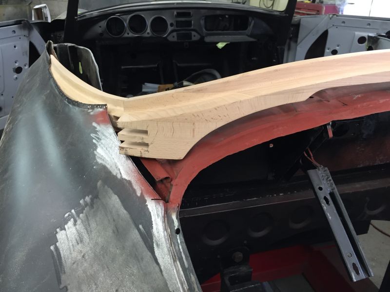

            • Justin wrote: "Love to see Ted's tack strip if you get a chance."

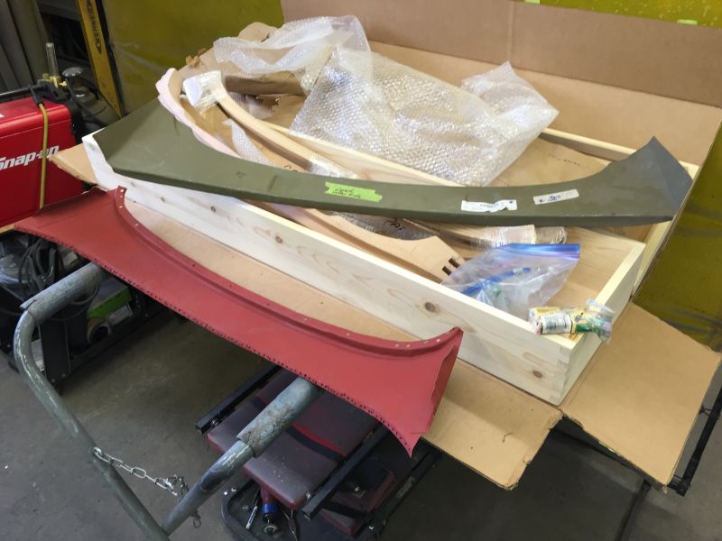

              Fitting the metal to the wood. We are to the point where we do need to shape the wood slightly more to the metal that can't be moved. I cannot see a reason to have done the early Cabriolet top rear attachment this way other then the design was based on old fashioned "coachbuilding".....as in coaches drawn by horses.
              Edit: The last non-Porsche I worked on was a '37 Cord 812 drop-top and there was wood in all aspects of that body, doors, rear lid, etc. It was a body welded to a frame with an independent front sub-frame, theoretically a "unibody" design. I also restored an old Morgan about 20 years ago and had a lot of wood to deal with in that job.
              This Cab is a carry-over from the T-0 into the very early T-1. '56 model year, '55 build. Half of the floor was 'pre-A' and so was the front nose panel. The holes in the front flanks would take either "Continental" or those post-confrontation with Ford, "European." The owner has been doing his homework and keeps me well-guided but now is getting a challenge as to which radio is correct. We only know that the one that came in it is not. Details, details.
              We had to modify a long chisel to shear off the upward screws that were blind after the metal was assembled after the wood was installed, then fashion a long scraper from an old extended screwdriver to coax the remains of the original wood way up toward the door. This is the first time I have replaced the whole of the wood in that cavity.
              Note the box the wooden parts arrived in.....a piece of woodworking art in itself. Also see a NOS later rear cowl underside for a Cabriolet and while similar, how different the details are.
              Justin, this car also has had a lot of what you are going through in the metal parts of the body. Wasn't that rusty but had some residual collision damage that took a LOT of measuring, jacking, pulling and replacing or making of parts that really became a challenge to get "right." I was actually surprised that the car survived and was saved from it's long-ago hit(s), from what was uncovered! With these cars, people at all levels in each step have to be really committed to and love these old Porsches.
              I should BE committed for making a call to my local Porsche dealer for parts, waiting forever for the parts department on hold and listening to recorded messages about how great that dealership is for every facet they offer. I called back after my business with the parts department was connected to talk to the GM. I offered a friendly reminder that the recorded hold blurbs included misinformation. I cheerily reminded him that they sell, service and have many other offerings for the brand Porsche, not "Porsch." That drives me nuts. They can no longer sell a "Porsch" as the 914, 924 and 944 and 928 models are NLA. (oops, those have been replaced by the Panamera, the Cayanne, the Macan, etc.)
              Bruce (Porsch-AH owner since all they made were 356s)

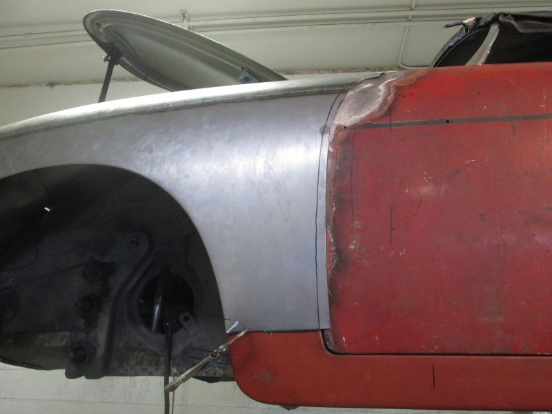

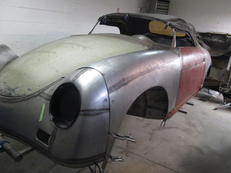

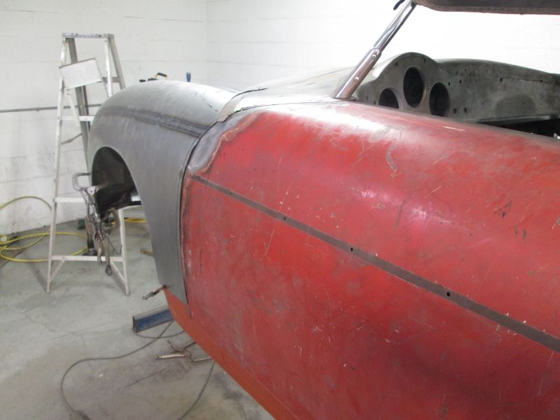

                    2/4/17

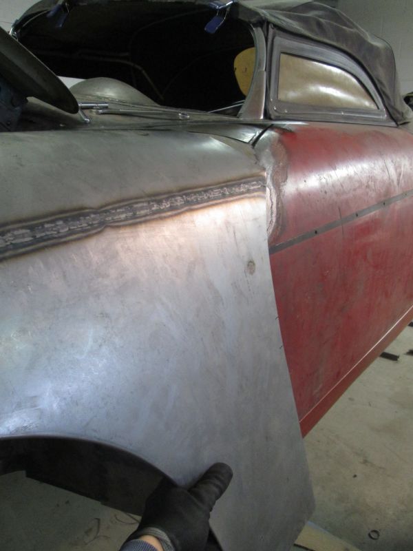

                    Left fender fitment

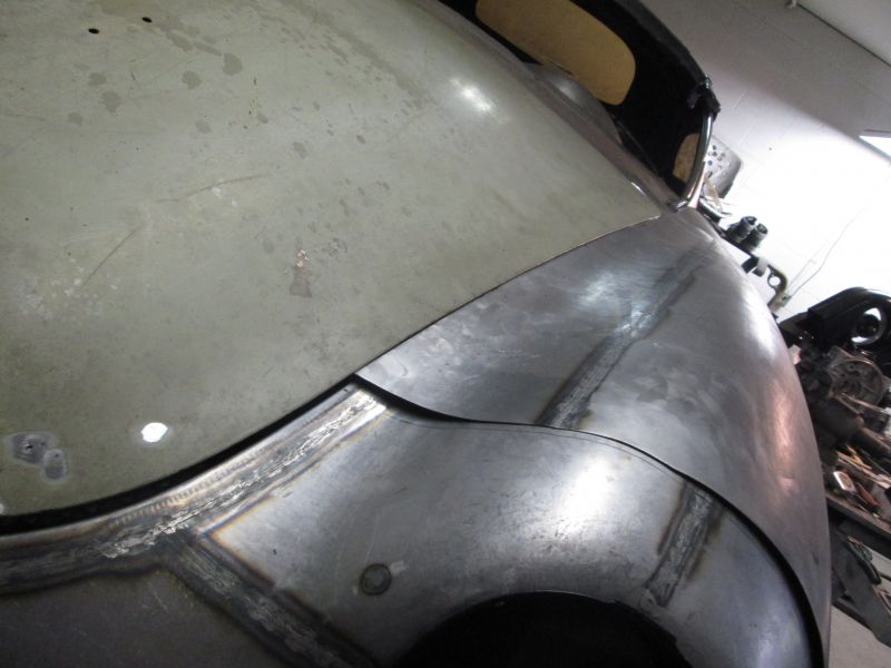

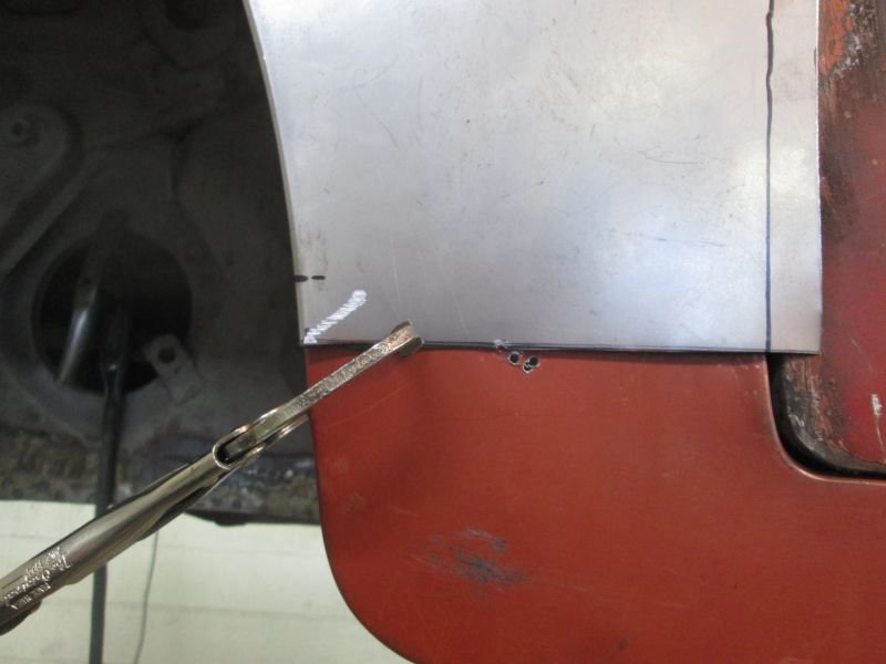

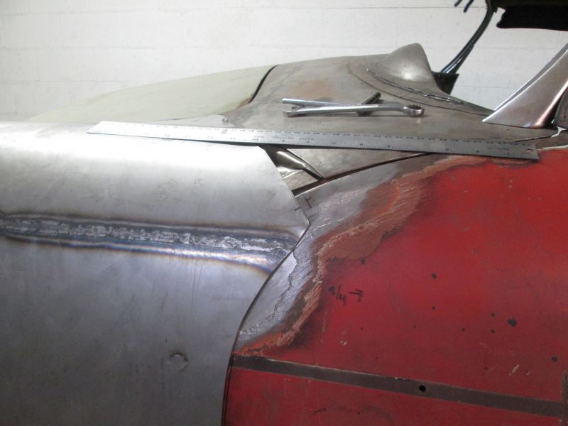

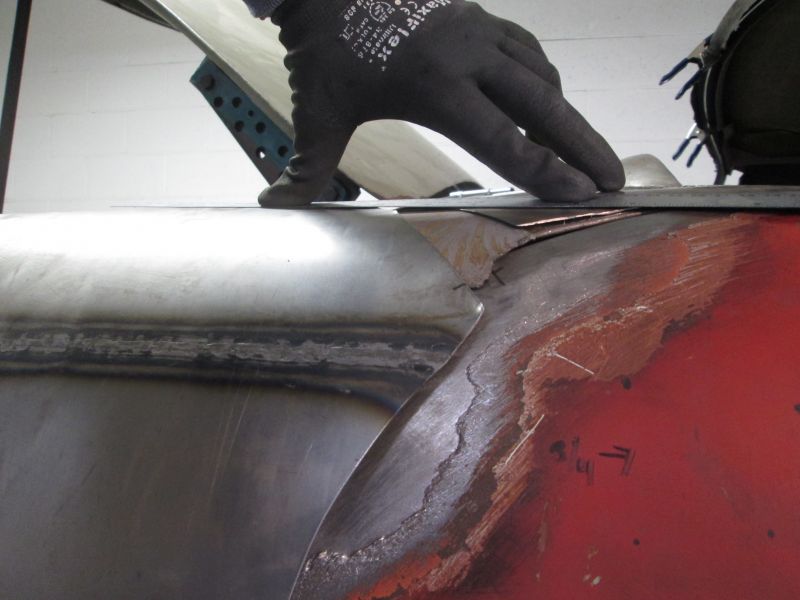

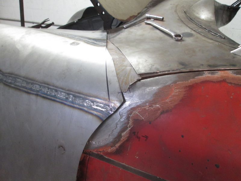

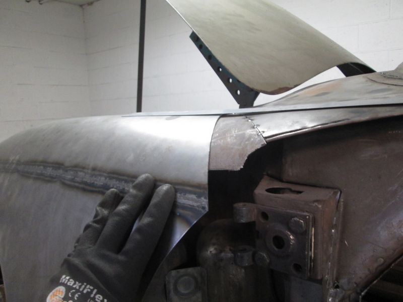

                    Gap is giving a little trouble. I get a nice distance at the back corner and toward the front but most of the middle run is too tight.
                    If I try to get the middle spaced out where I need this corner goes completely to hell. I will most likely end up cutting and splicing the middle to suit to correct it.

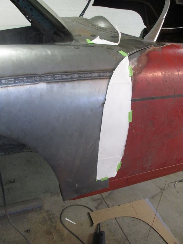

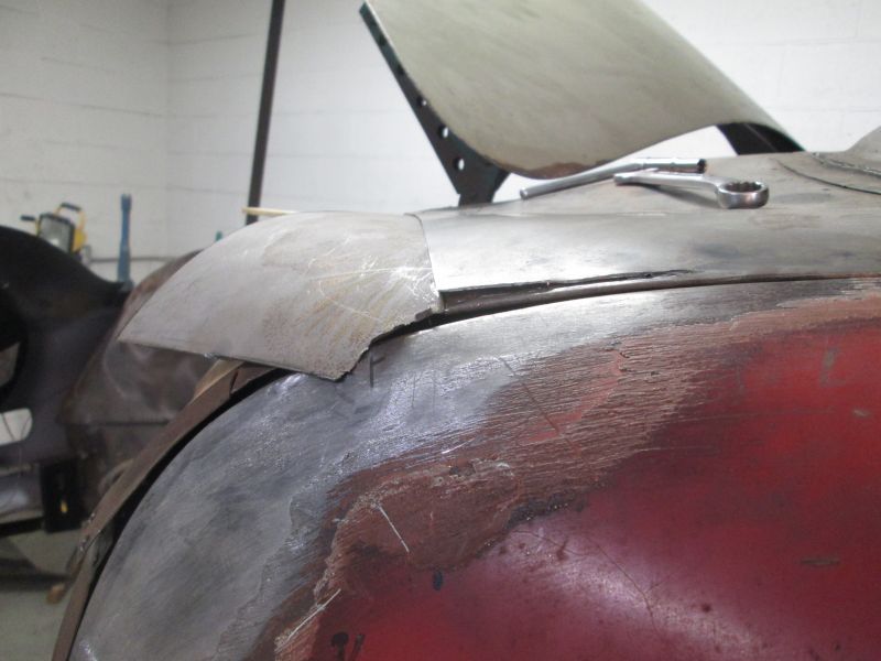

                    Anyway its close enough for now so I turned my attention to this rear shortfall and contour problem.

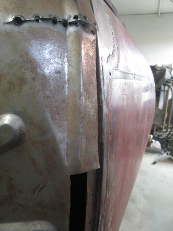

                    The ruler laying on top highlights this nasty subduction zone. Cowl is tapering to quick and so is the end of the fender creating a bowl instead of a nice level transition like I need. Always something!

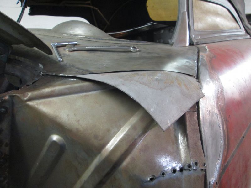

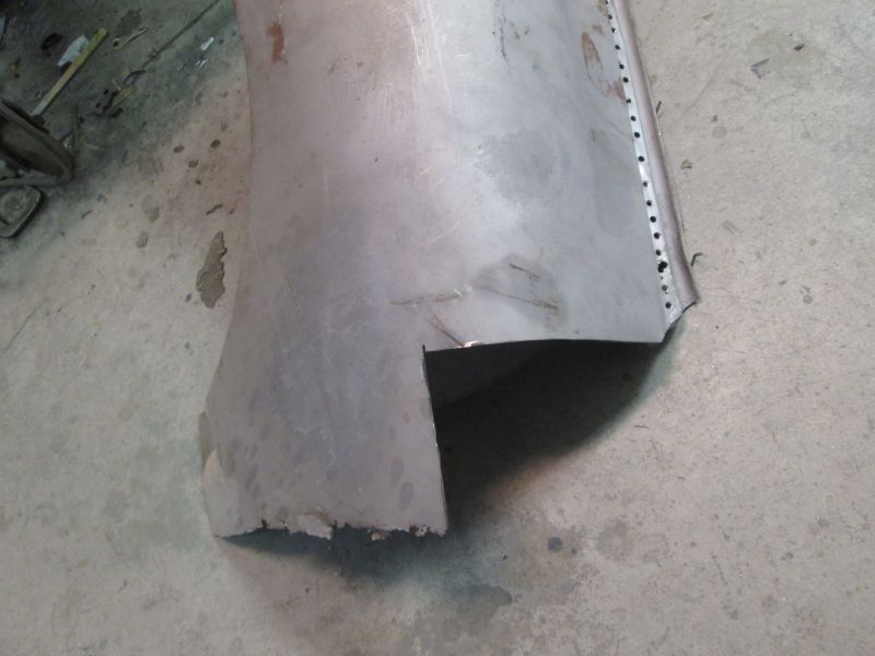

                    For the filler section I'm using the back of this OG fender.
                    Its perfect as it already carries the profile I need.
                    Rough fitment begins. had to add in that relief cut along the edge to allow the cowls profile to come upward.
                    Quick mock up with the fender. It improved but I still have quite aways yet to to go.
                    More later...

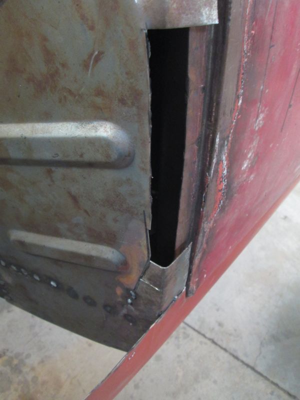

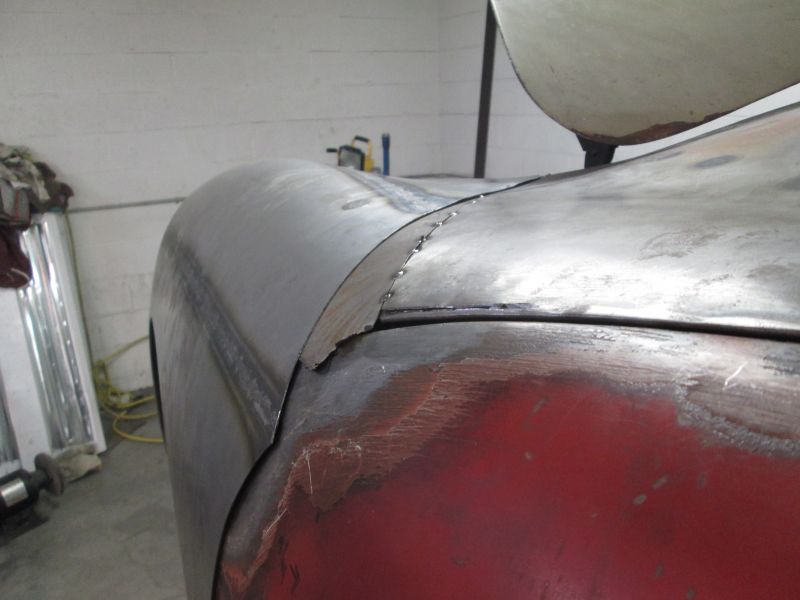

                              2/8/17

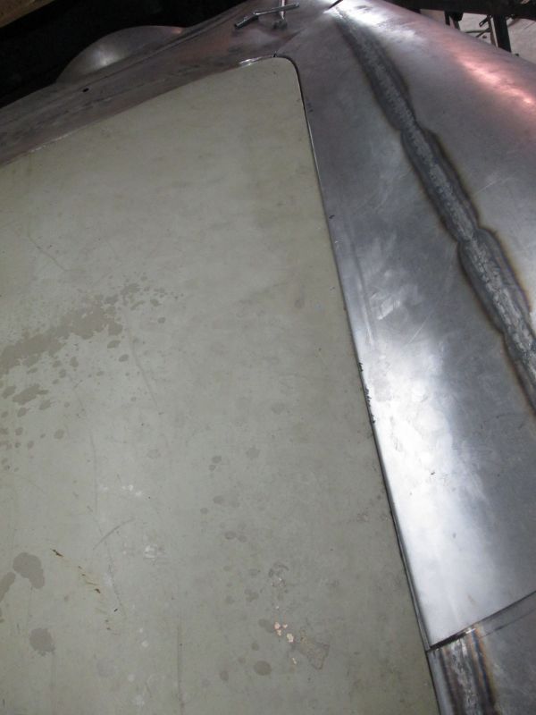

                              Left Fender continued
                              Exploring my options with panel tension to see where and how I might be able to manipulate that low area. As I pull the bottom out it seems to calm that transition quite a bit. It of course can't be mounted this way but I'm just figuring out what I can do to avoid any serious relief cutting.
                              Cutting the fender edge off straight next for a clean joint with the new filler section.
                              trimmed and new section carefully tacked onto the cowl.

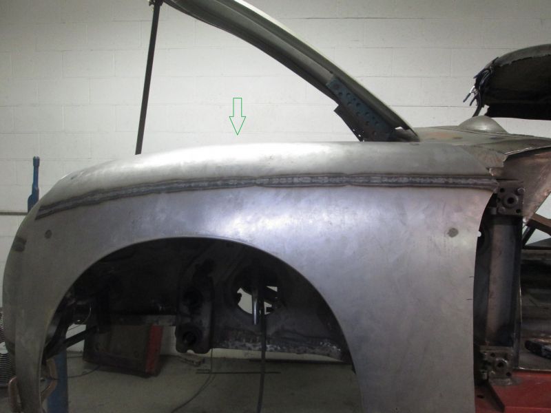

                              Its still fighting me and the cowls approach angle still needs to level upward a touch more.
                              What's also working against me is that I've noticed this new fender arches just a little more than stock. Its peaks a little stronger at the center (green arrow) then tapers and slopes more toward the back compounding the approach angle problem I'm already having with the cowl.
                              This original sweeps too but its much more level especially as it makes its way toward the cowl.
                              I'll eventually get this section to transition smoother but I'm desperately trying to avoid relief cuts in that fender.

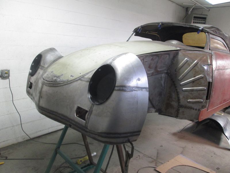

                              Chased it about as far as i could for now. I want to get the rest of the fender fitting closer before I commit any further in this area.
                              Excess trimming around the edges would be next. Made a paper templated based off the edge of the door to get my initial trim line for this back edge.
                              Another section was trimmed off the front edge next. So relieved to see that these two panel profiles matching up well within striking distance.
                              Bottom corner at the rocker was last to be taken up. Rear edge trimmed with enough excess to form the eventual flange.

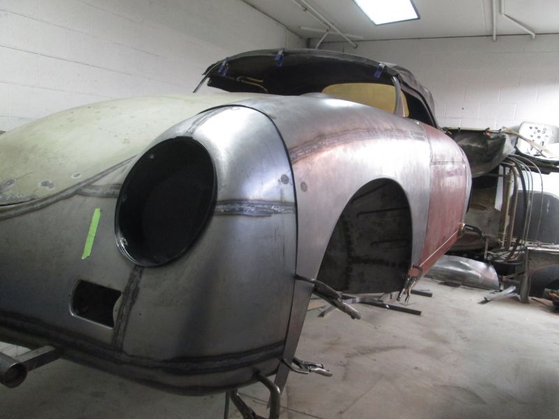

                              With all the trouble I'm having I do have a few slivers of sunshine. Could not have asked for better alignment at the wired edge where these two meet.

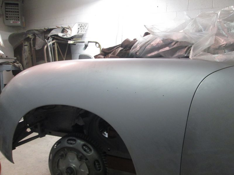

                              I'm also really happy with the general side profile shape of the fender as it continues off of the door.

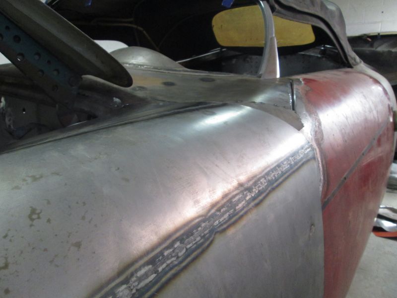

                              The side profile sits flat with no real crown in and around the fenders arch; just like it should. While I do like some crown and muscle at the rear arches I can't stand it on the fronts. Those have to be perfectly stock with no flare or "pulled out" profile as I've seen on a few finished 356's.

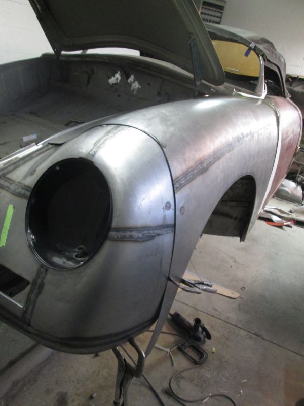

                              So its a mixed bag of fitment issues with all of my serious troubles being at the top of this fender with the hood gap and at the cowl joint. Other than that its very promising down along the side.

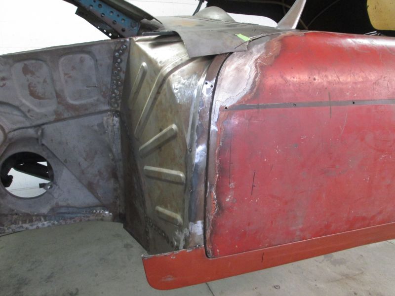

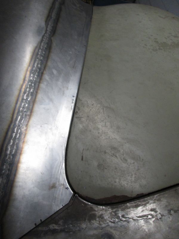

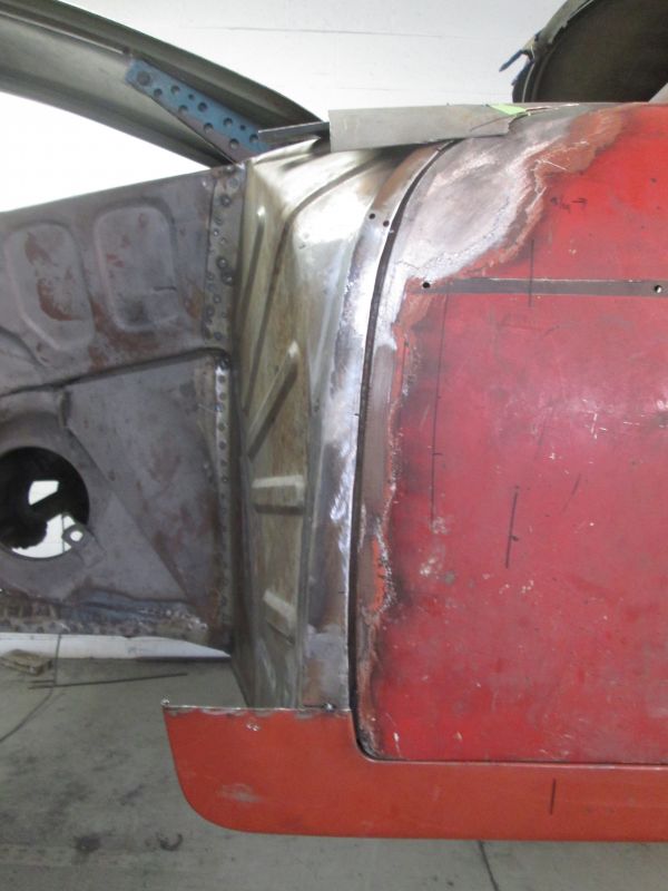

                              With the fender getting closer it was now time to tie up some more loose ends that I just could not bring myself to finish until absolutely necessary. Finishing up the splash pan next.
                              • 2/9/17
                                left splash pan loose ends

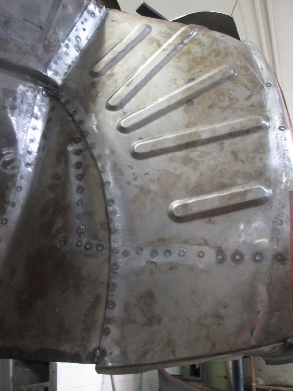

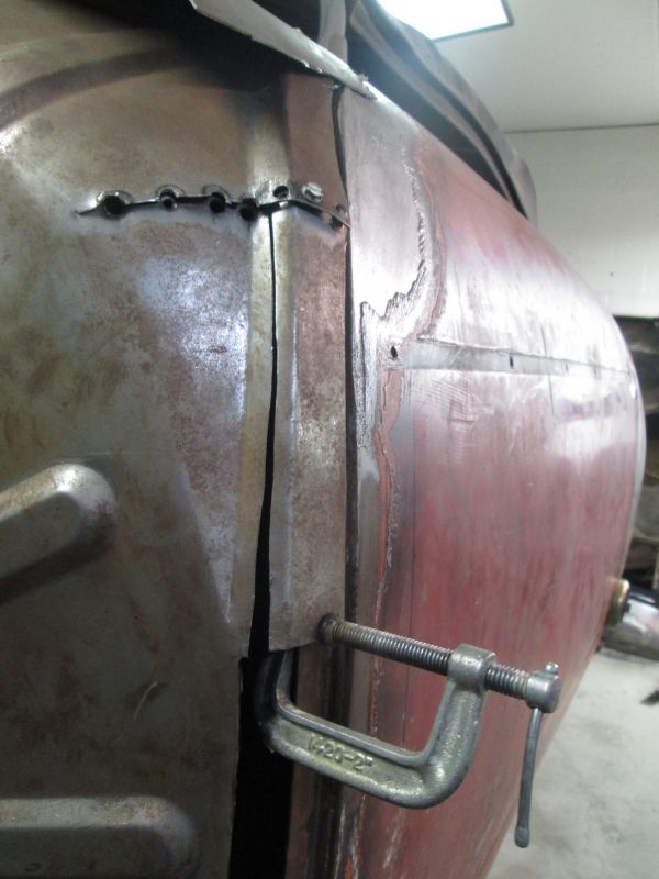

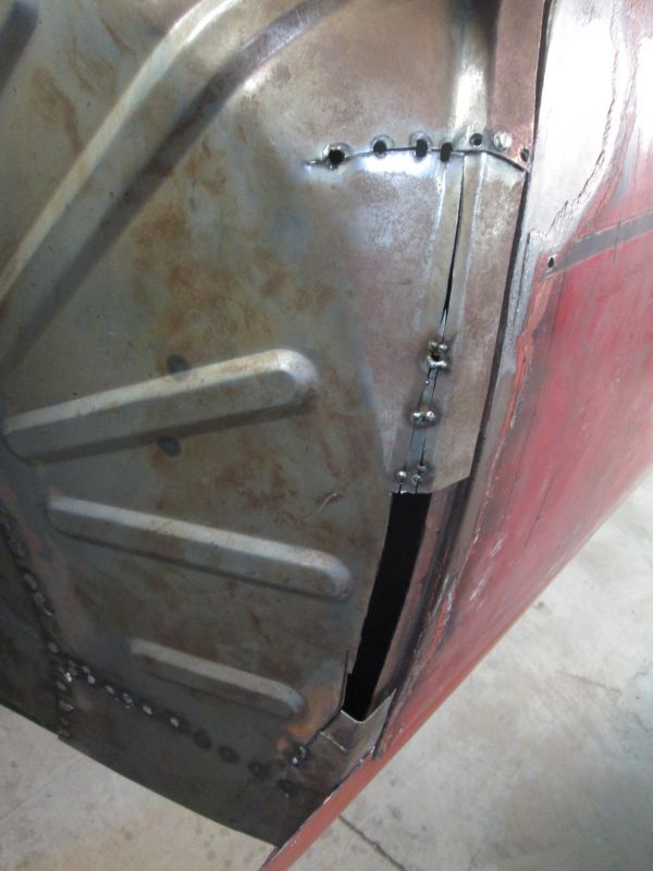

                                From the start the flanged edge of this panel has not been quite the right shape or distance that I've needed for this application. Began by replacing and shaping a new lower corner when I mounted the rocker but never finished the next section above it.
                                Thought I could leave this remaining section alone but determined it to be just a touch shy. Once I have the flange just below level of the door the approach angle is too steep for the eventual skin flange to hang onto properly. The flange surface needs to come out just a bit more to run more parralel with the door.
                                tin snipped this section free and now spaced out where I need it.
                                Strip of 20 guage represents the eventual skin. Flange still tapers away though not as sharply as before and matches what I'm finding under my referrence car.

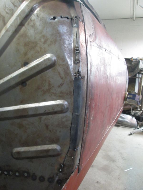

                                Tacked in new position with a quick filler sliver.
                                this spot welded overlap relief is not supposed to be there so the excess was trimmed and will be butt-welded bak together.
                                Replacement middle section fabricated and tacked into final position.
                                Flange fully welded and dressed.
                                Door remounted for a test.
                                Flange hangs just below door and well within striking distance for any needed slight height adjustments as the fenders edge is heeled over it.
                                Quick test fit against the fender. Close enough for now so its onto finishing out all those plug welds.
                                All finished smooth with spot-weld detail. Small seam weld tack detail added at the bottom inner edge as found on my original referrence car.
                                I went back and removed just a sliver more of the flange to ensure enough clearance for a good door gap once the edge of the fender is pinched over.
                                teadious but so nice to have this panel finally finished out. Back to fitting the fender.
