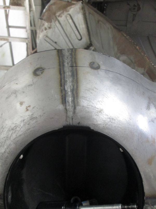

      3/28/17

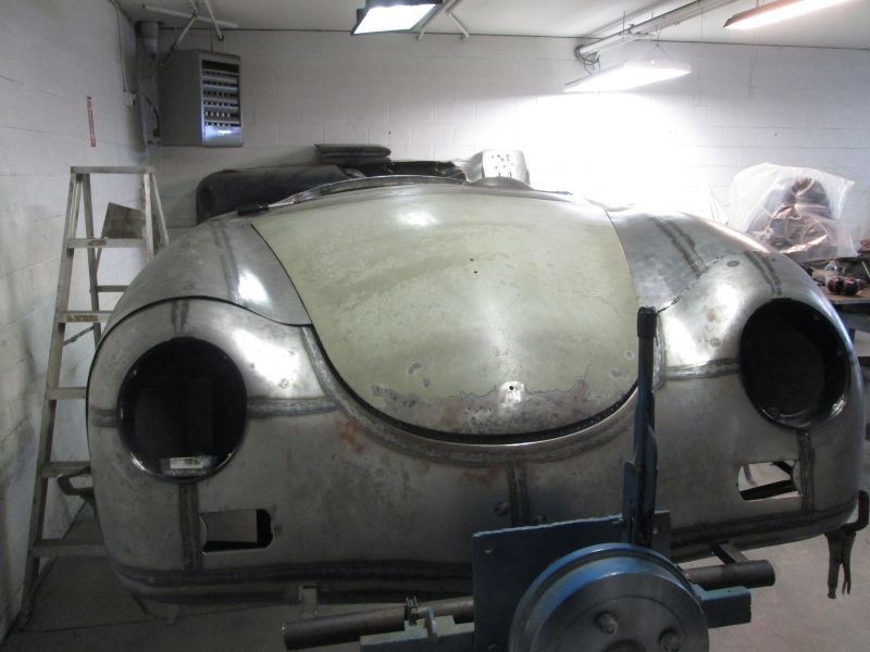

      symmetry issue left to right.

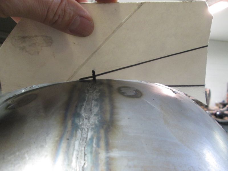

      Right fender/nose arch profile seems to lay flatter and broader than the left.

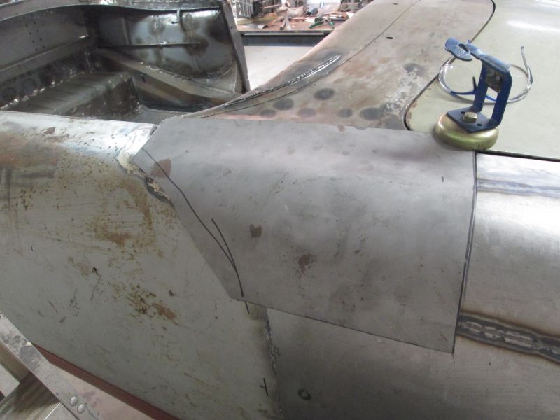

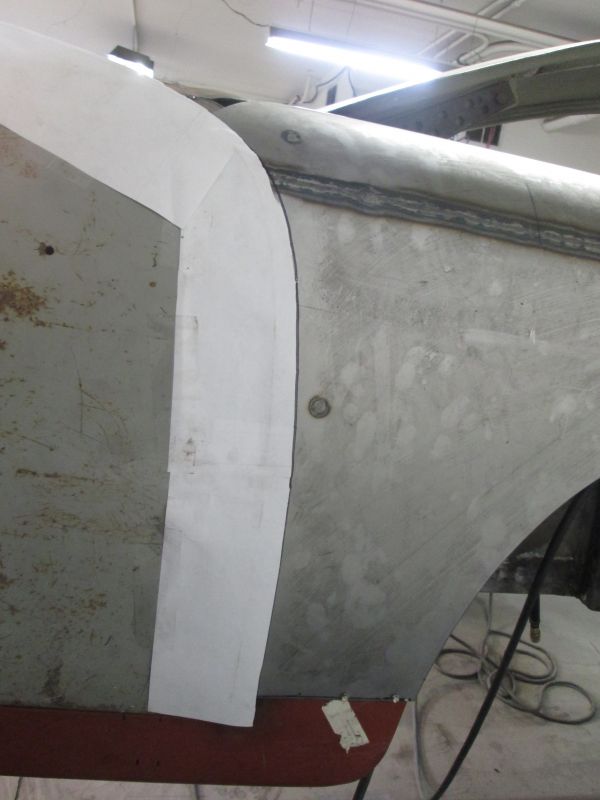

      Traced the back edge of this profile to paper.
      Profile cut out and laid over the top of the left fender here. Its not an optical illusion. The left does bend tighter.

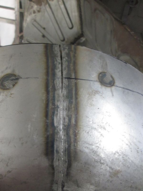

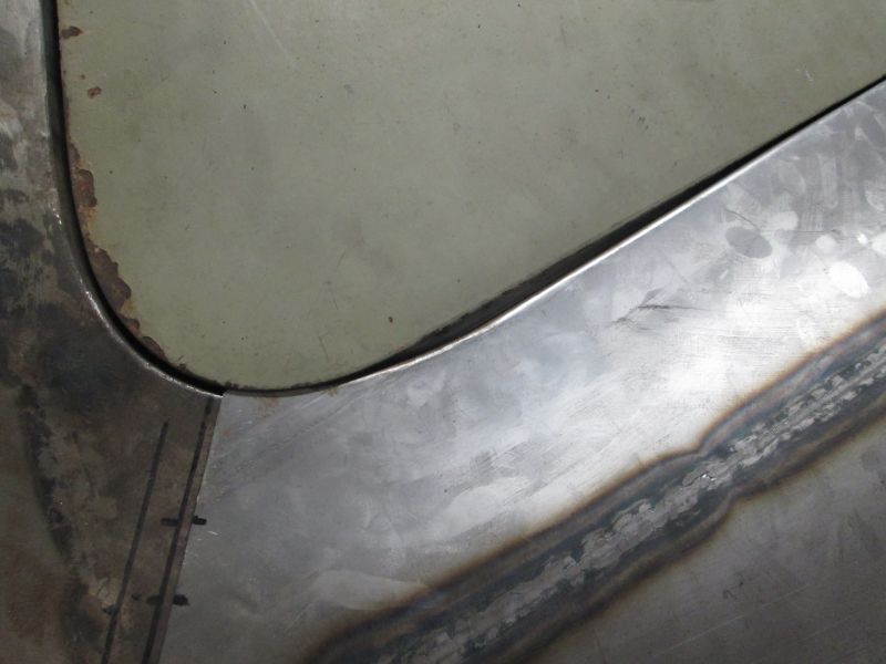

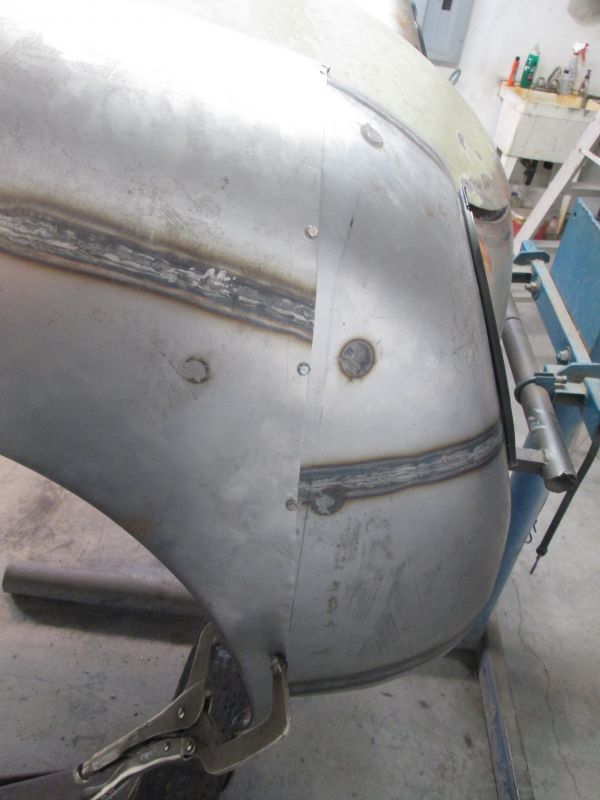

      Went ahead and relief cut the weld joint allowing it to open up and "peak" more closely to the left side profile.

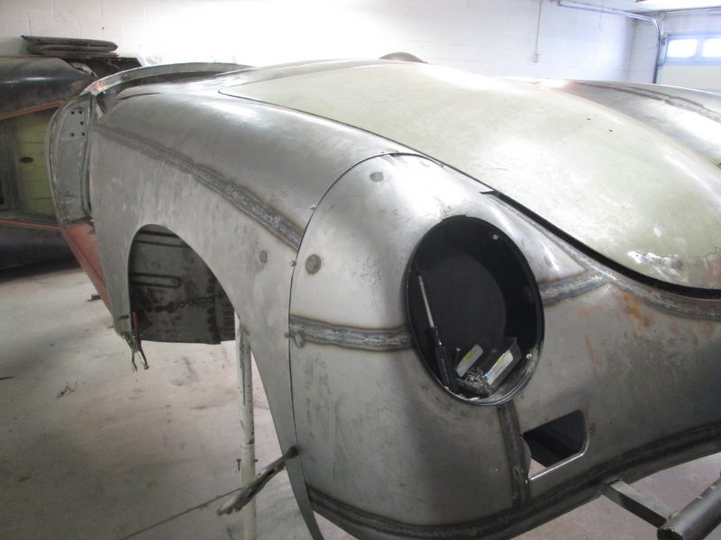

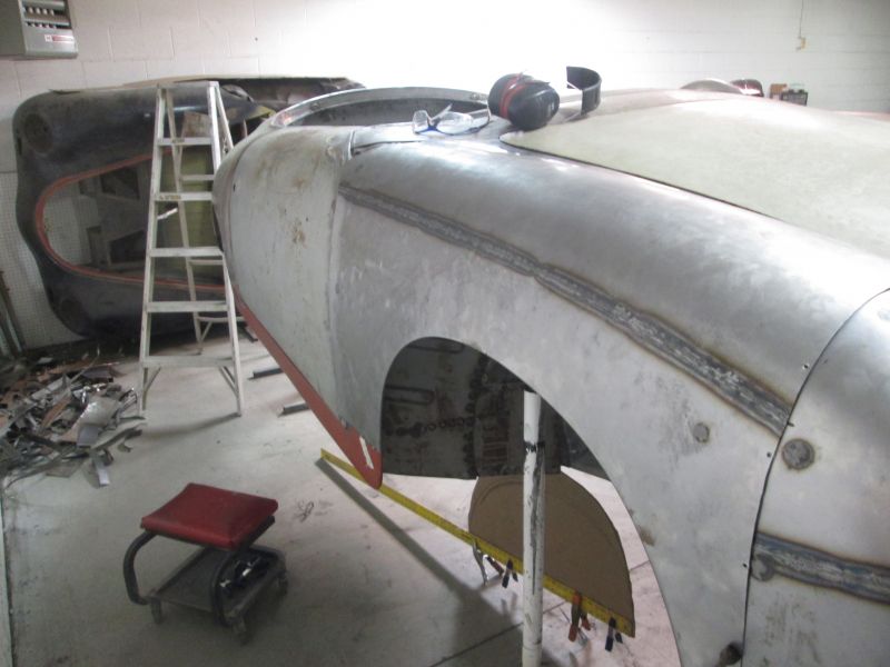

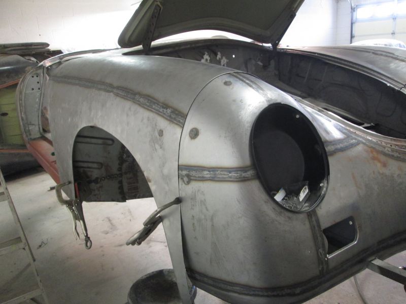

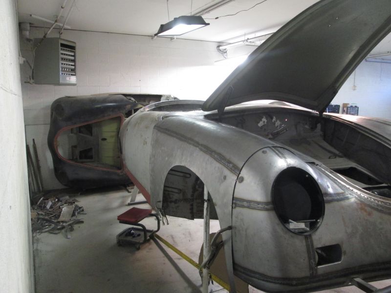

      With this problem fully in mind I went back to locating the fender for best average fit.
      Just about ready to begin adding a few set screws here.
      • 3/30/17

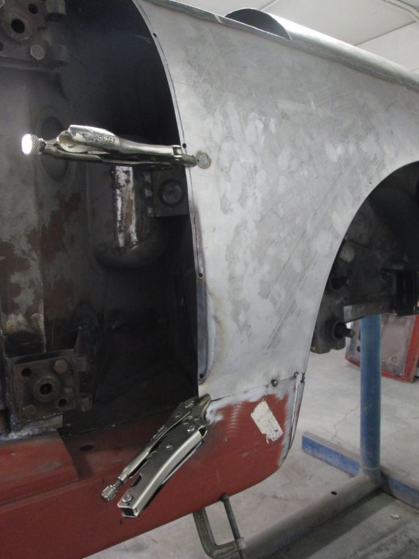

        Right fender adjustments
        Initial set screw position
        Left the top loose so I could try and get that crown to match more closely with the left.

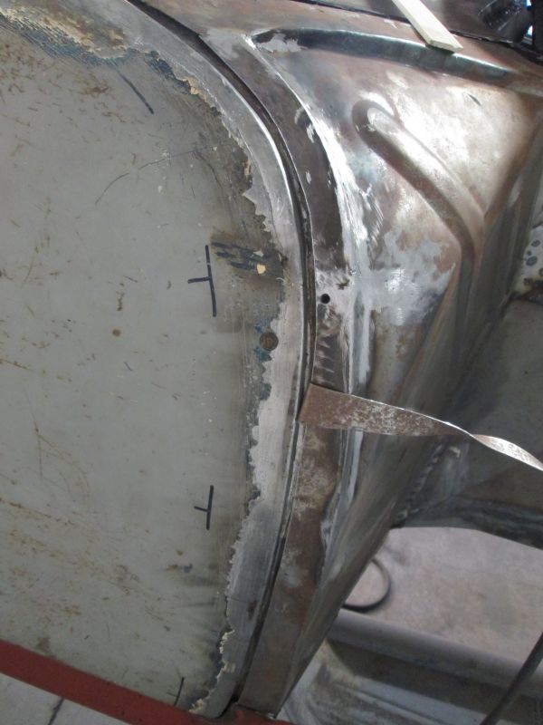

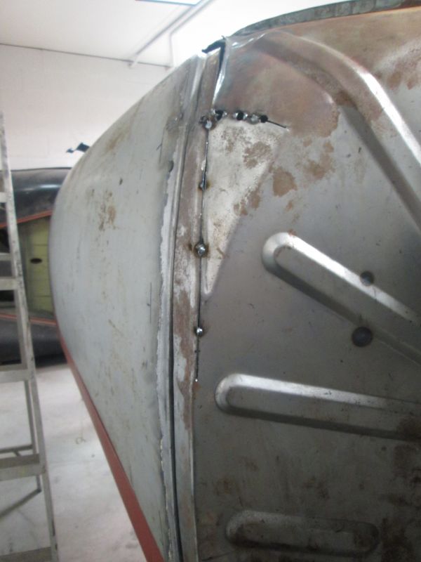

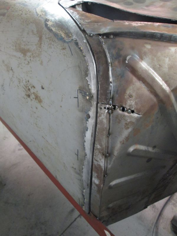

        With my hood gap basically set I'm having a really bad alignment issue at the rear wired edge. To have a decent shot of symmetry with the other side I need to have the fender over shoot the rocker. If I align them in this position the profile will be way too vertical. It needs to sweep a bit more.
        To allow that means moving the fender forward about 10mm. I sacrifice my corner pictured above but I'll be able to correct this with the new patch section going in.

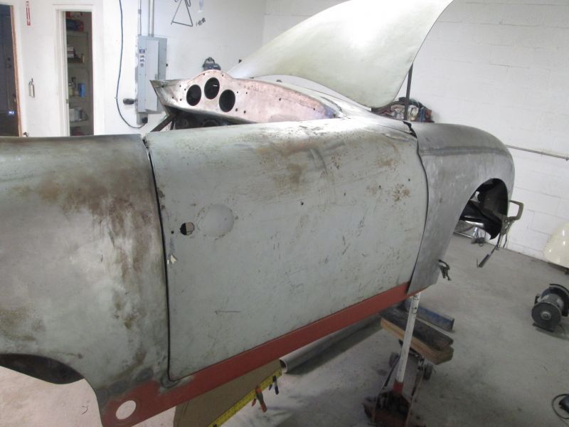

        Added the door back on while making this change.
        General contour off the door is at least close.

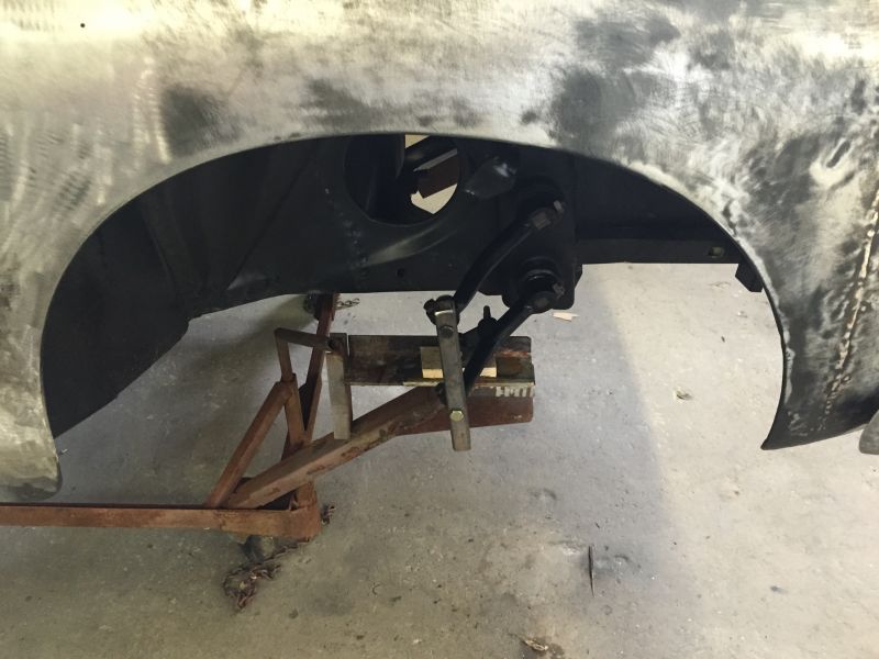

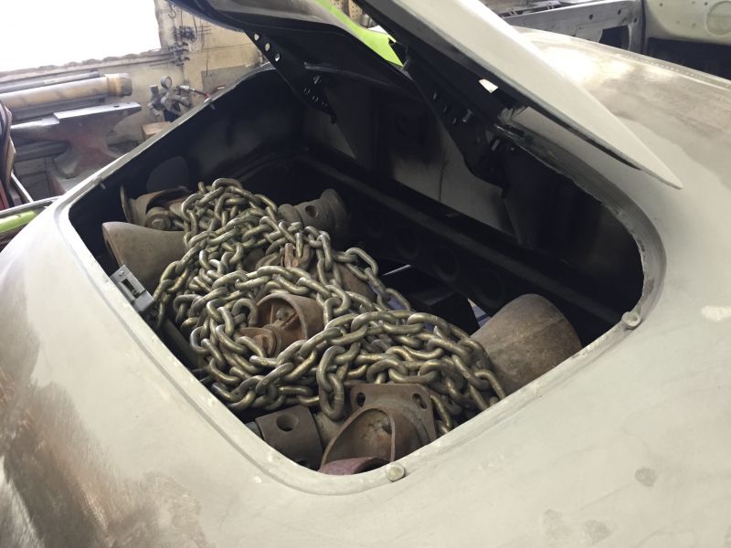

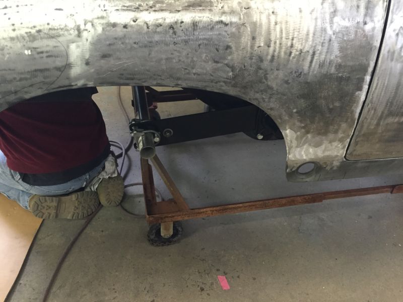

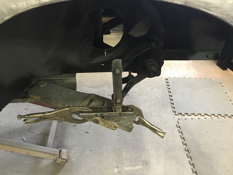

        • Justin,
          A repeat, but here is my way of getting final door gaps before painting the car.
          One now rigged on a Speedster, the other on an early Cabriolet.
          Suspensions are on to stay and will be carefully masked when textured underneath.

          The key is to anticipate the gaps by loading on the suspension with each portion of the shell holding a close approximation of engine, interior and trunk contents of gas and tank, battery and spare.
          The chain and metal casters is the added weight over pushrod of a 4 cam engine. Everything is weighed on a scale and marked.

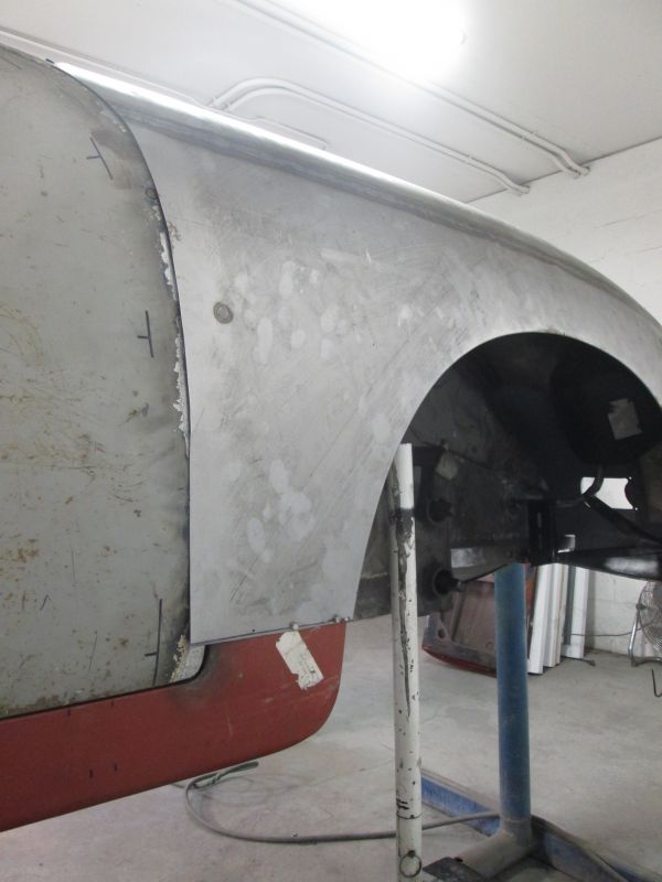

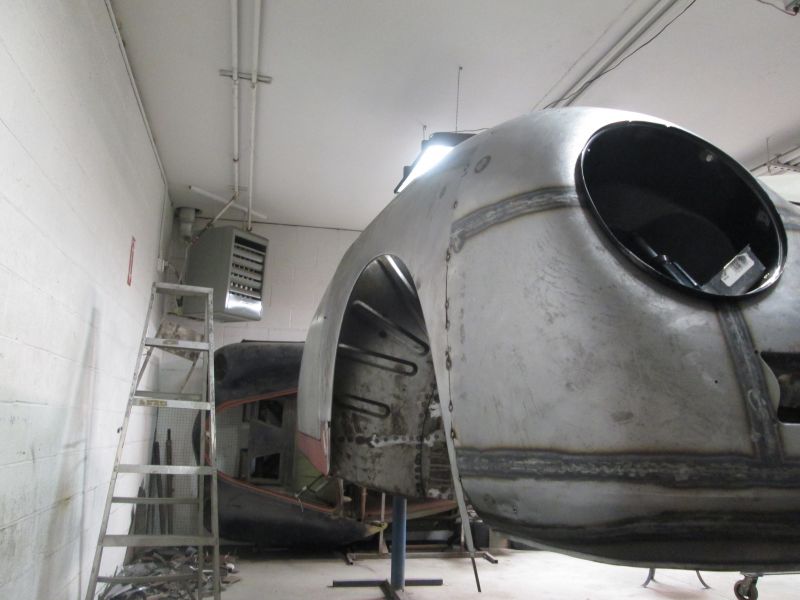

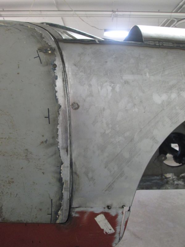

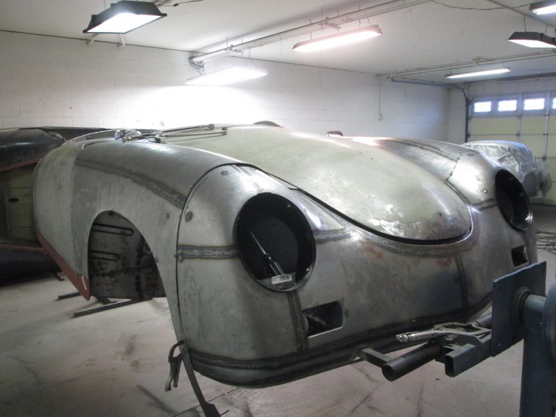

              4/8/17

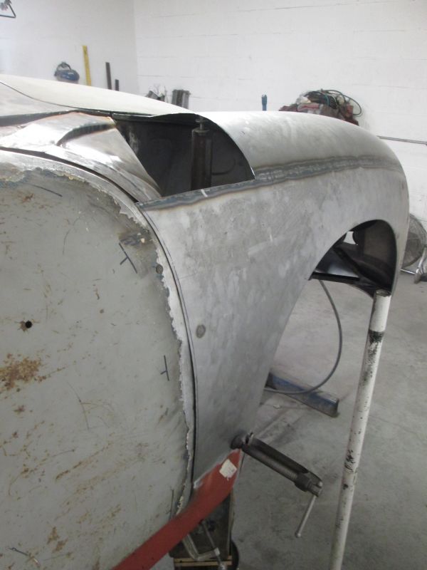

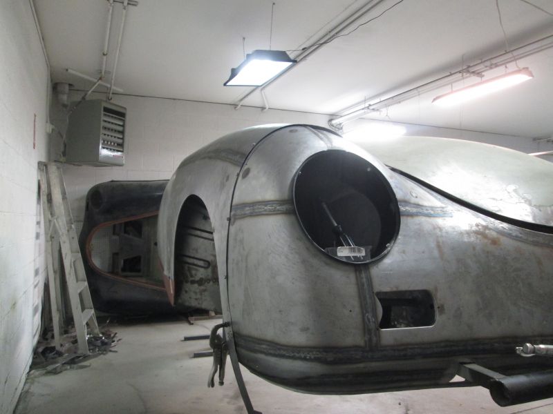

              Repositioning of right fender complete.
              Now that the final position has been established I'm comfortable enough to begin trimming back most of the excess.
              Trimmed, reinstalled and set screwed onto the rocker.

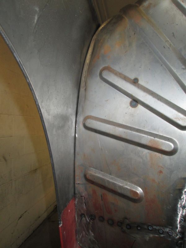

              seems to be laying down fine. After the fender adjustment I rechecked the opening for center with that cardboard template. Checked out fine as the change is so slight.

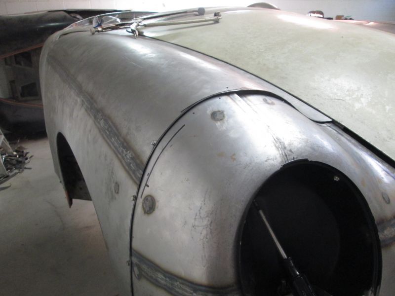

              Begin reset screwing it to the nose while attempting to crown it higher to better match up against the left side.
              Decent general contour and most importantly no flair at the wheel arch.
              Inched it a little closer.

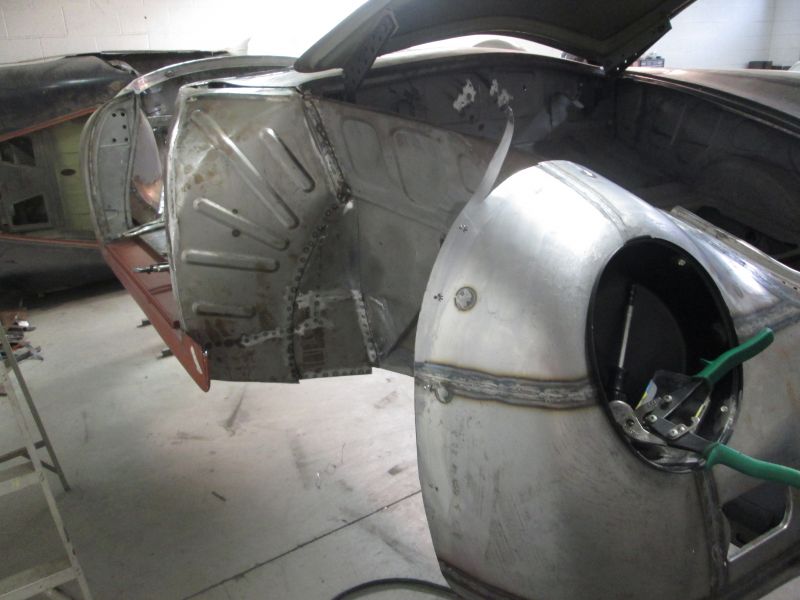

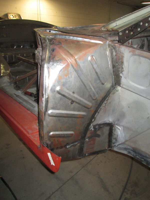

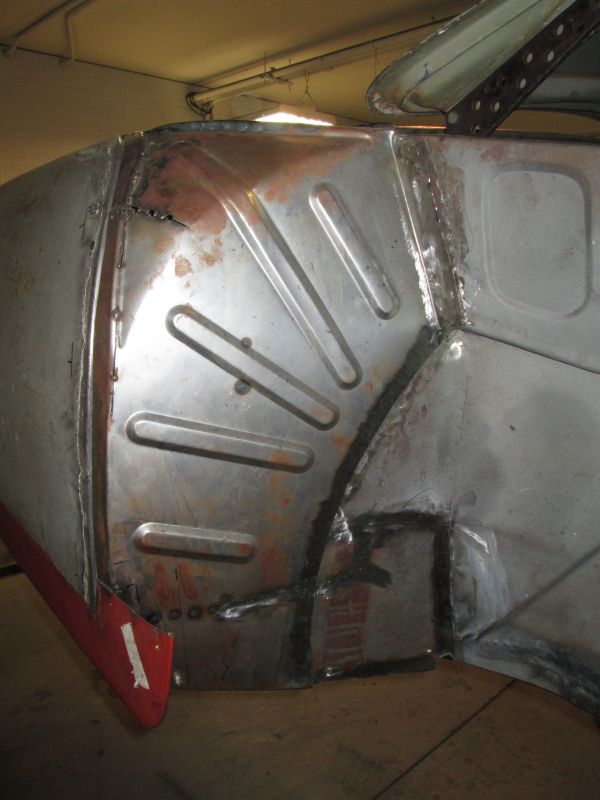

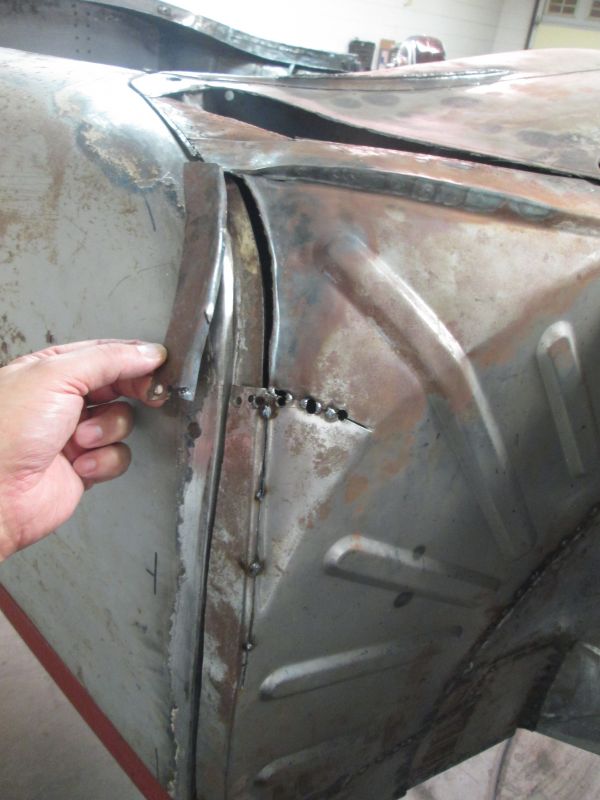

              • 4/9/17
                Getting the right side ready for final install.
                donor section rough cut shape.

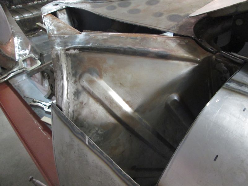

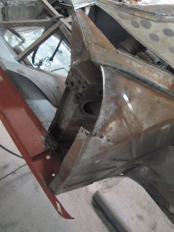

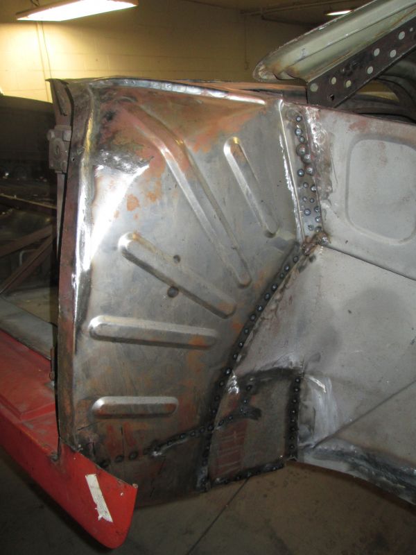

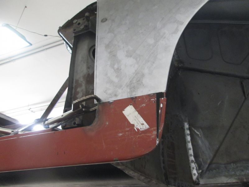

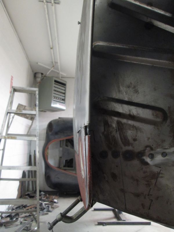

                All but ready to begin installing this fender for the final time but...

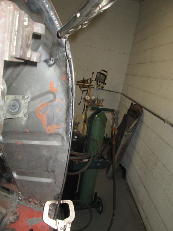

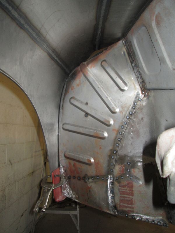

                I've got to grind tons of plug-weld heads and finish out the splash pan flange first. I can no longer avoid it.

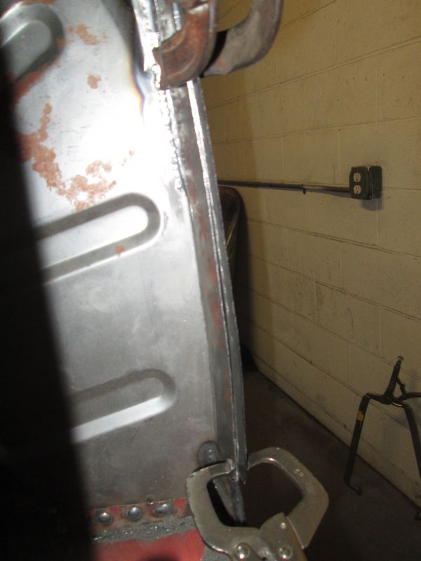

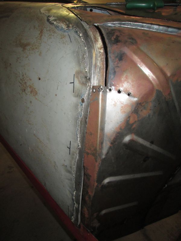

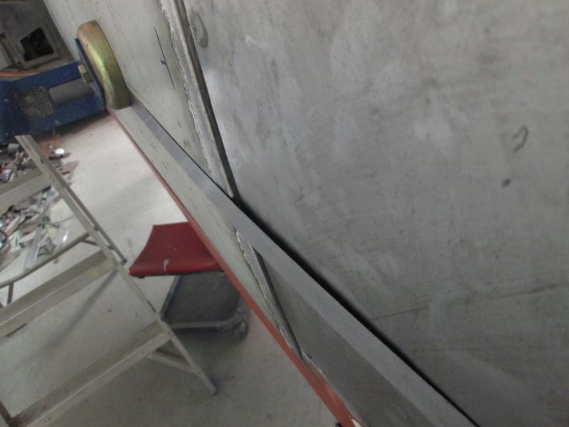

                door remounted so I could gap and index the flange for the eventual skin that will go over it.
                Flange through the middle was dead even in relation to the door so a few MM had to be zipped out to compensate for skin thickness. Tacked into needed position here.
                I gave up messing with this corner well over a year ago. Time to get'er done now.
                Full flange run now tacked into needed position. Also eliminating that old spot welded lap joint relief like I did on the left side.
                Templated the edge of the door to trim the back of the fender even closer still.
                before I welded the flange up I finished out the most unpleasant task of smoothing out all those plug-weld heads.
                Outer flange run fully welded and dressed. Splash pan duties complete.
                Spot-weld detail followed which offically finished my to do list before installing the fender.
                Fender test fitted against the mount flange; Its all teed up.
                back to getting the fender ready for final installation next.
                Thanks for stopping by!

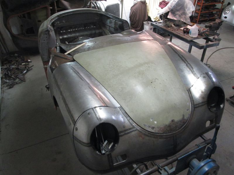

                    4/16/17

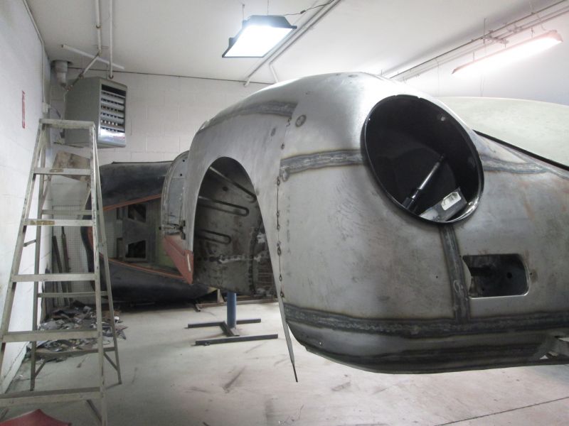

                    Right fender prep nearly complete and about ready to be tack welded on for good.
                    Wrestling with hood gap width and best average contour shape/fit of the rest of the fender. Like the left side I'll end up sacrificing it for body contour first then go back and correct it once the rest of the panel is tacked and established.
                    It took a couple of trim attempts as I didn't want to take too much off but I finally got the flange relieved for skin wrap thickness.
                    Fender remounted after final excess trim and etched for the wrap around this flange. Fits nice and uniform; this area ready to go.
                    Excess also removed at the rocker, relief cut for profile shape and wire exposed and preped for welding.
                    This only leaves trimming away the overlap at the nose. After this I'll be laying down the first series of tack welds. Getting close

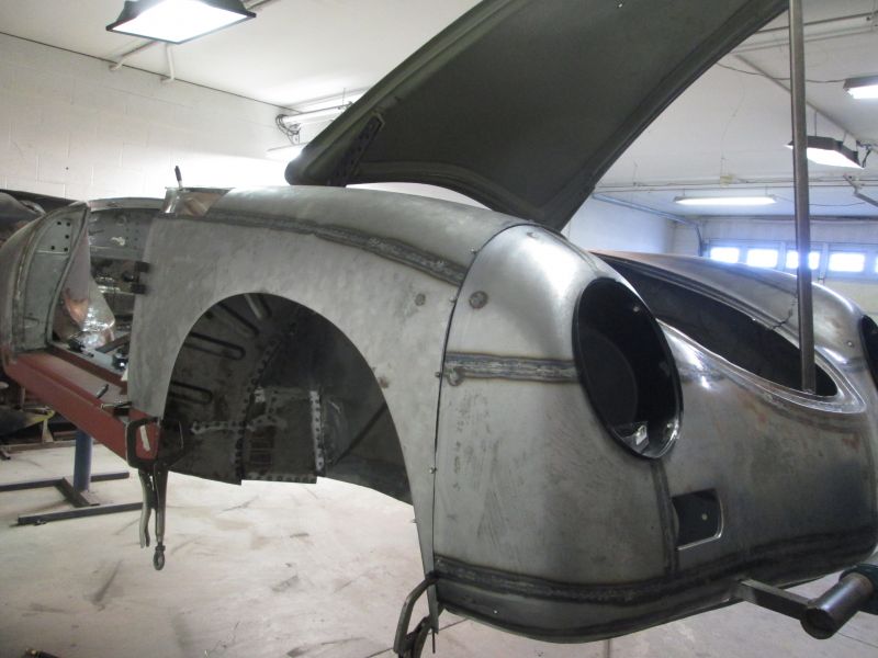

                        • 4/19/17
                          Tacking right fender in.
                          laying down initial series of tacks.

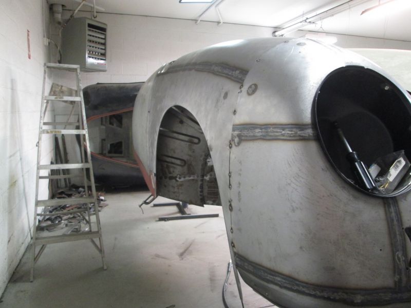

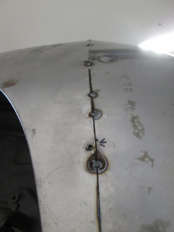

                          Now tacked just about down to the bottom; all the while checking for general profile shape as it went.
                          Both sides "peak" a little so I'll have to relief cut and retack along this line like I did at the center here but This is just some place to start.
                          With the front pretty much set I moved toward the rear. I left it loose so I'd have a chance of an emergency adjustment in case the fender shape got away from me after tacking it to the nose. The back was sagging on me a bit at the top so I had to get out my floor jack to preload it into position to get my body line with the top of the door back.
                          Now that I had it dialed back in again I set screwed it and moved down to begin tacking it to the rocker.
                          Tacked to the rocker and wire welded together.
                          Took a little extra time here as its not supposed to be dead nuts flat though it wanted to be. Eventually got a gentle arch profile that looked right and felt right.
                          Rocker at fender joint continues the line off the door.
                          No flare or crown at the top of the wheel opening with a consistent transition off the door. So far so good.
