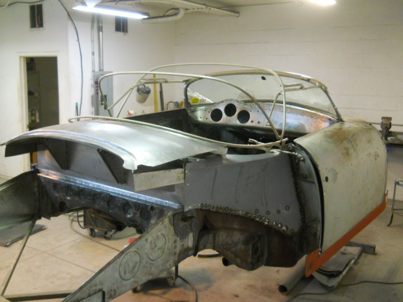

      8/26/16

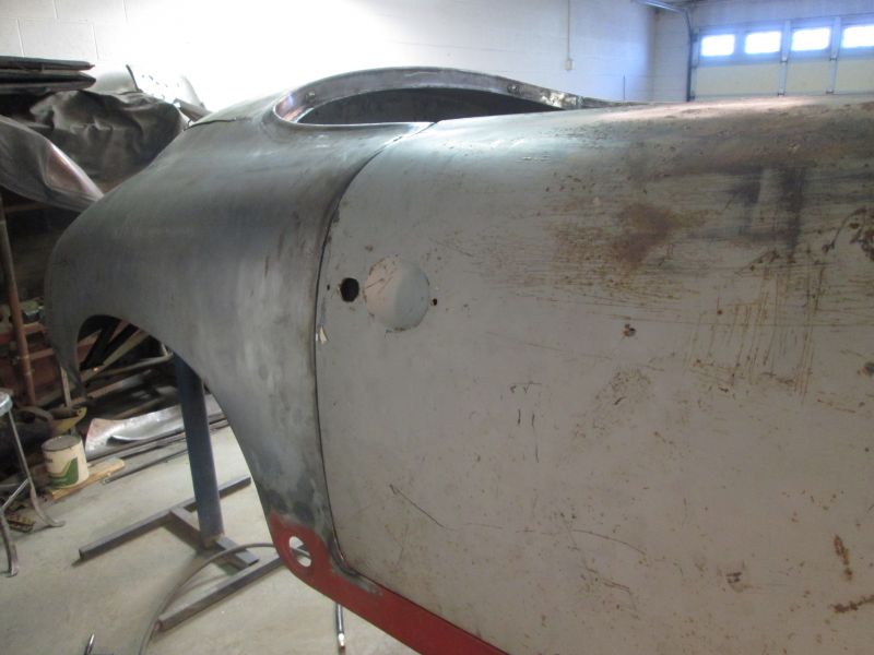

      Fitting up lower right apron section.
      Slowly getting it lined up for contour, the bead roll and lower edge.

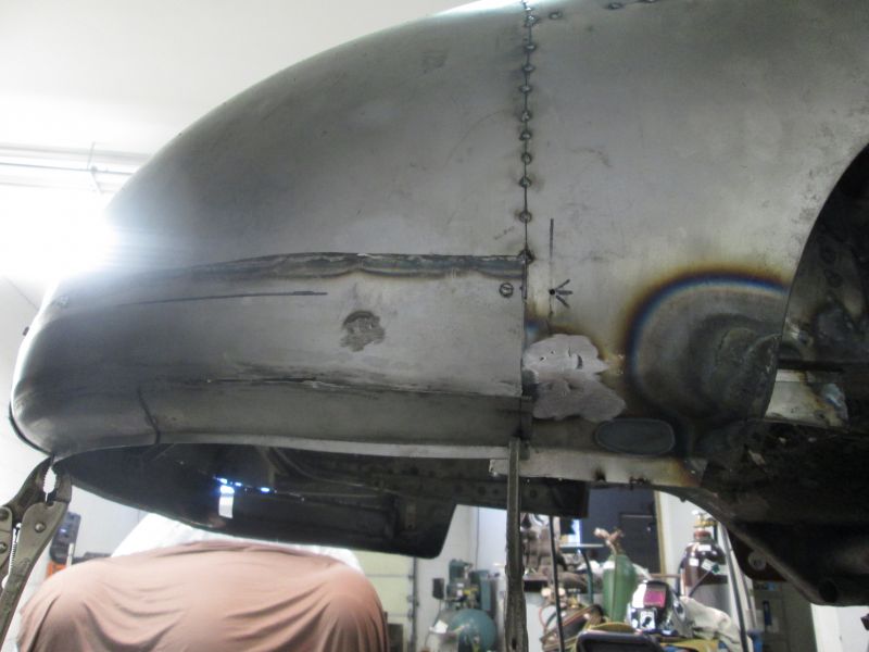

      With it positioned to my liking the lower edge swung too low.
      I ended up cutting the lower seem weld just like I did on the left to get it into alignment with the fender.
      A bit more trimming to go but I should have this tack-on by tomorrow.
      Thanks for stopping by!

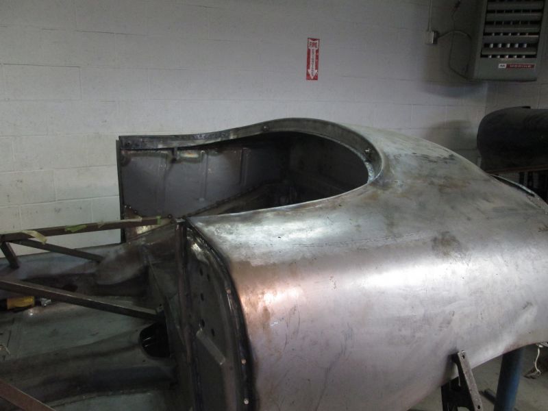

          8/28/16

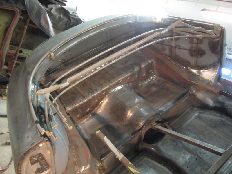

          Lower section attached and body mounted back on the rotisserie.
          excess trimmed and now tacked into its new position.
          This was about as far as I wanted to go until I have the luxury back of turning this car over again. Shaping the remaining run up to the fender will be much easier this way. I should of held off doing the other side but I got carried away. Just need to open that bracket hole back up and its good to go.

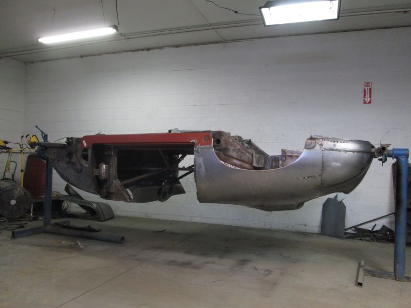

          Mounted back on the hoist this afternoon.

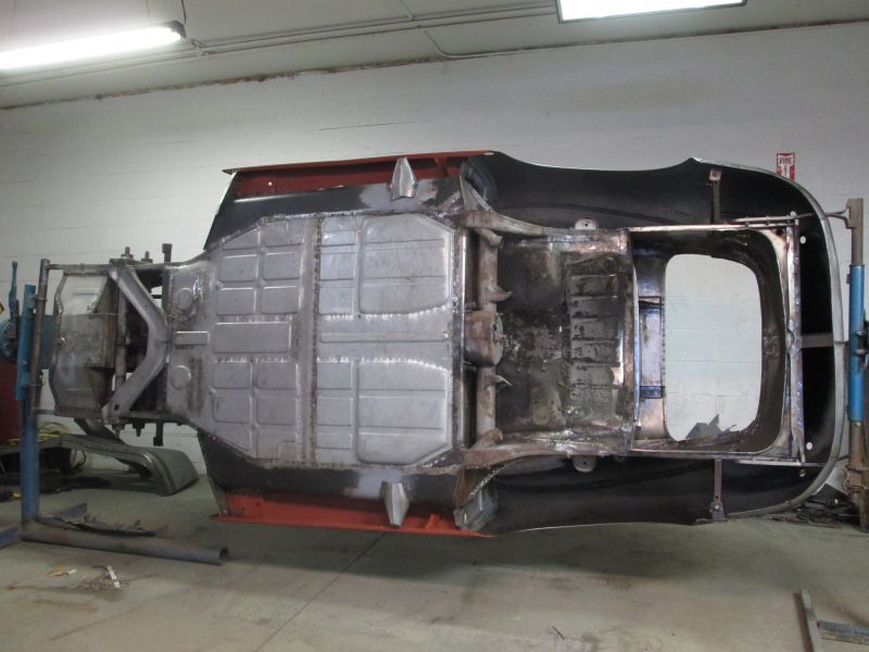

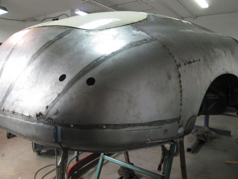

          With the tail end in basic form I'm now onto tying numerous loose ends in and around this area. There is a lot to finish up but as before I just take it a bite at a time.

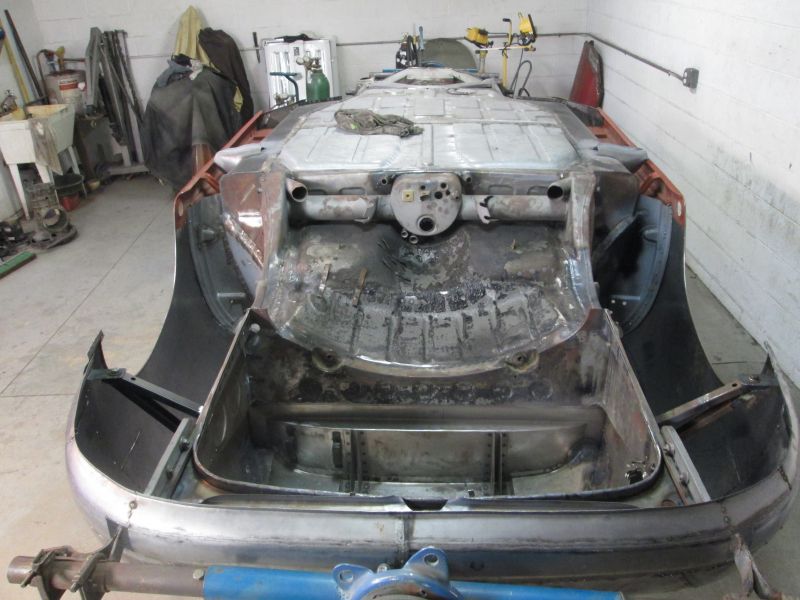

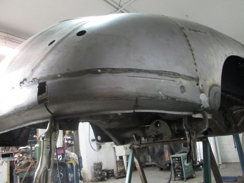

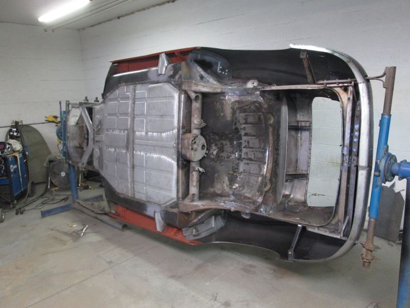

          This full underside view was helpful in checking for consistency with the chassis from side to side.
          Lower apron still has a ways to go.

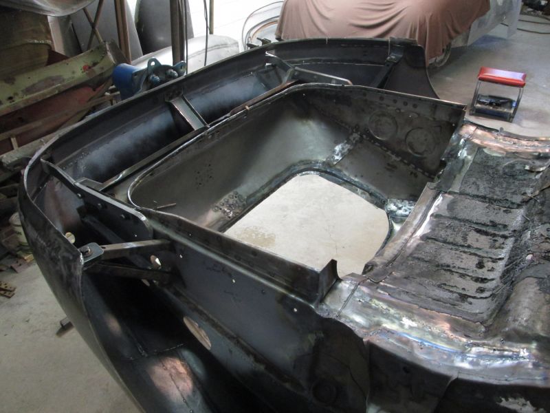

          Having it back on the hoist now allows me to finish the upper side closing walls of the engine compartment where I had to adjust and reweld.
          Finishing up that joint with the fender will be so much easier this way.

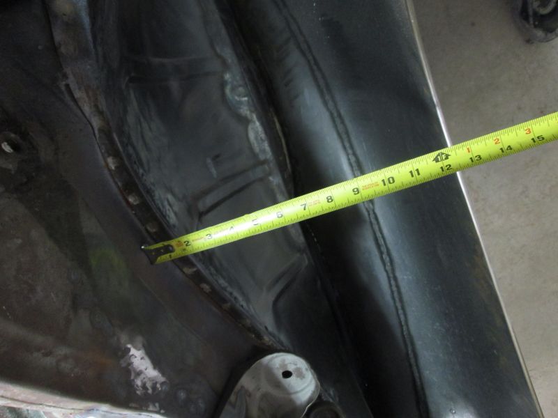

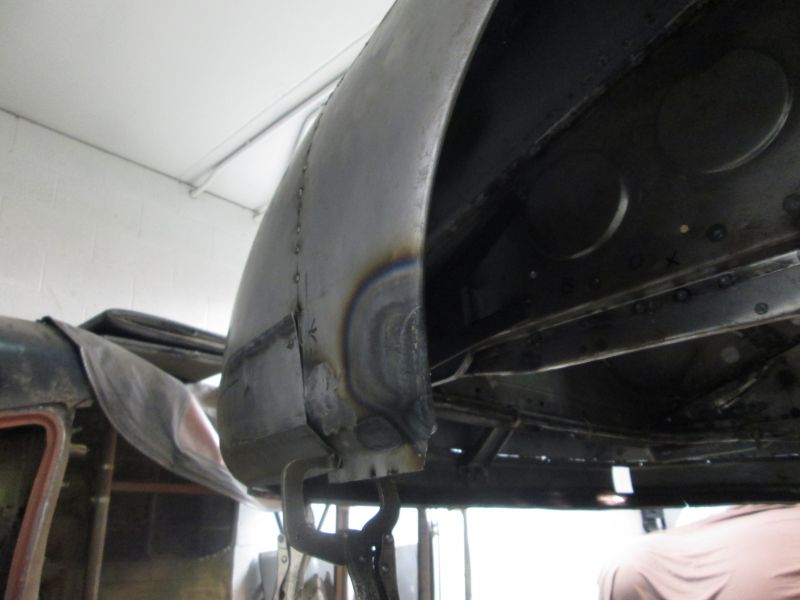

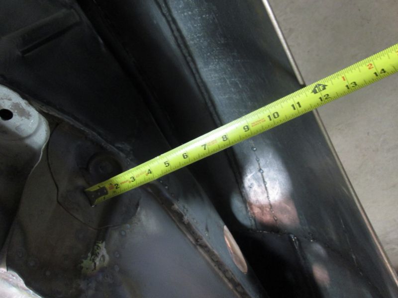

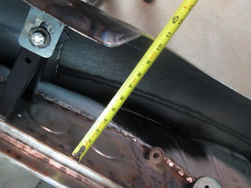

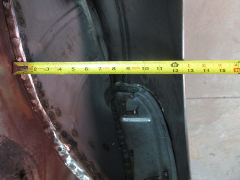

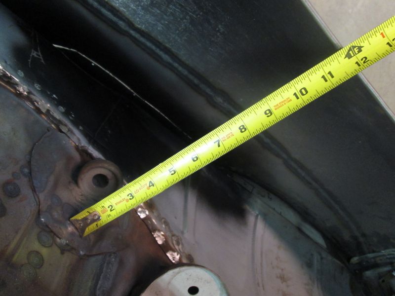

          comparison measurements
          Right side at center of the shock mount reads about 11 3/4 at the lip.
          Left side at center of the shock mount reads just shy of 11 3/4. So about the overall thickness of the wired edge of difference side to side.
          Forward left at approximately the second rib area on the chassis is just shy of 12 1/2 inches.
          Forward Right at approximately the second rib area on the chassis is just over 12 1/2. Again about the edges thickness worth of difference.
          Back right lower corner reads 10 1/4 inches from the frame.
          Back left lower corner reads 10 1/4 inches from the frame .
          About as close to symmetrical side to side as a hack like me could hope to get.
          On to those loose ends tomorrow.

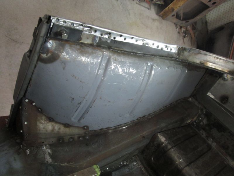

                Finish welding up the top frame mount and upper channel details. I needed a break from that tail skin.

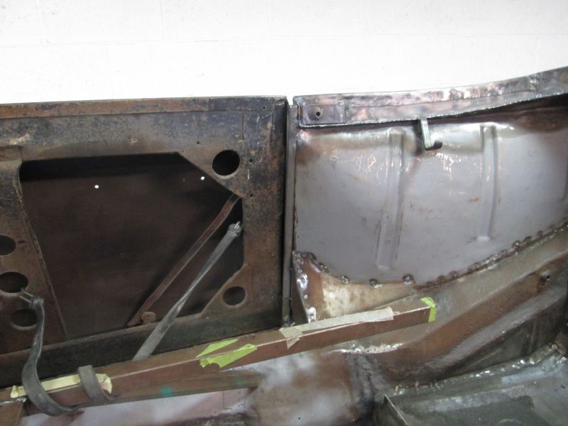

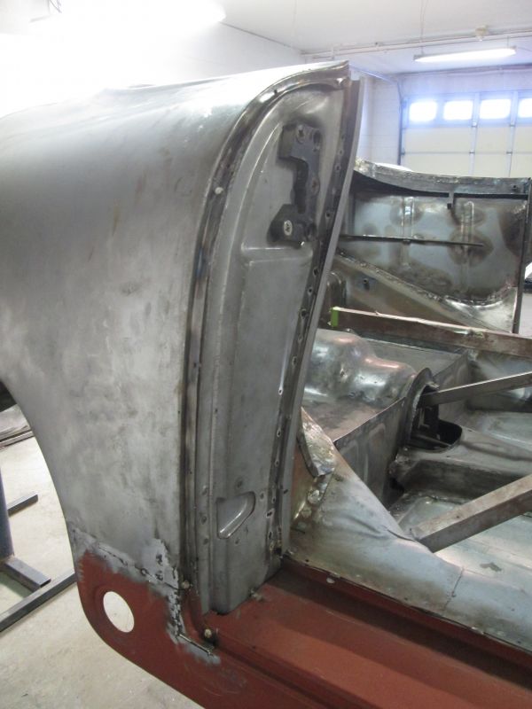

                Quarter panel flange welded up and the top frame resting hook installed.
                Folded frame cradled and resting evenly.

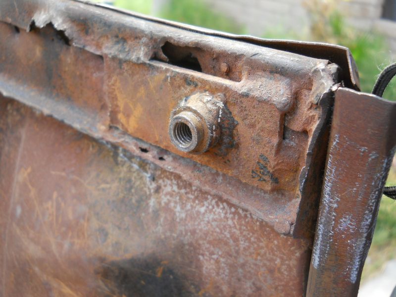

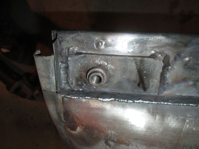

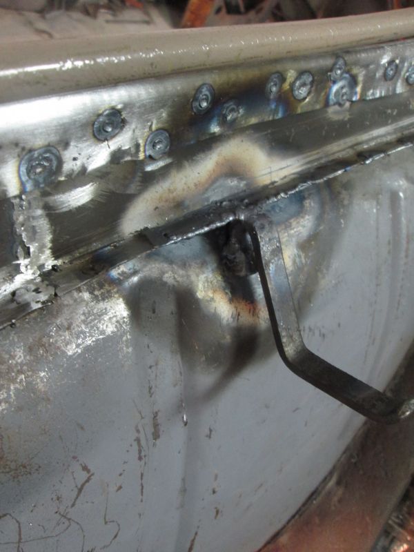

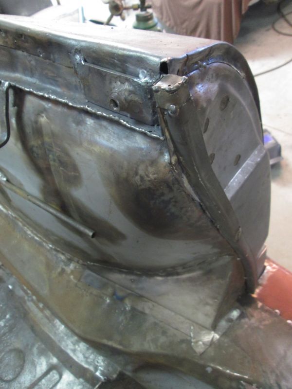

                Top frame mount gas welded to replicate what my OG reference speedster showed. I'm hoping this gas welding practice will carry over into my TIG welding. I need loads of improvement there.
                OG Speedster...

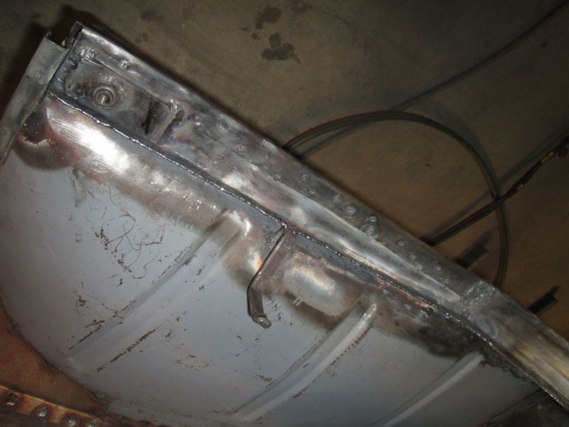

                Lower flange run also fused together up to the end of the quarter panel overlap as the original showed.
                Officially done with top frame mounts and the related upper flange run. Rewarding to get one more aspect in the finished column.

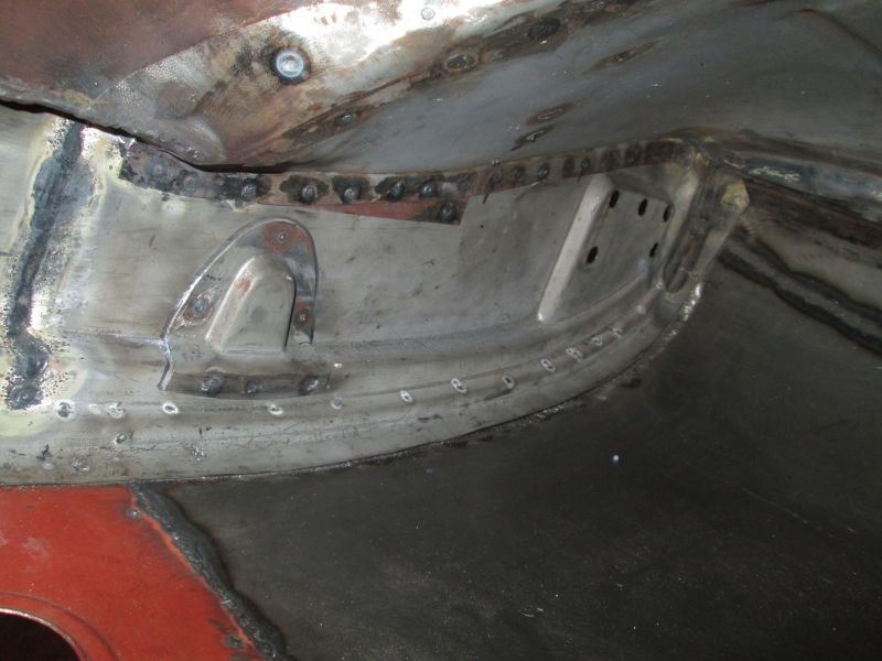

                • 9/1/16

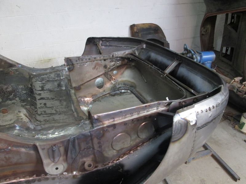

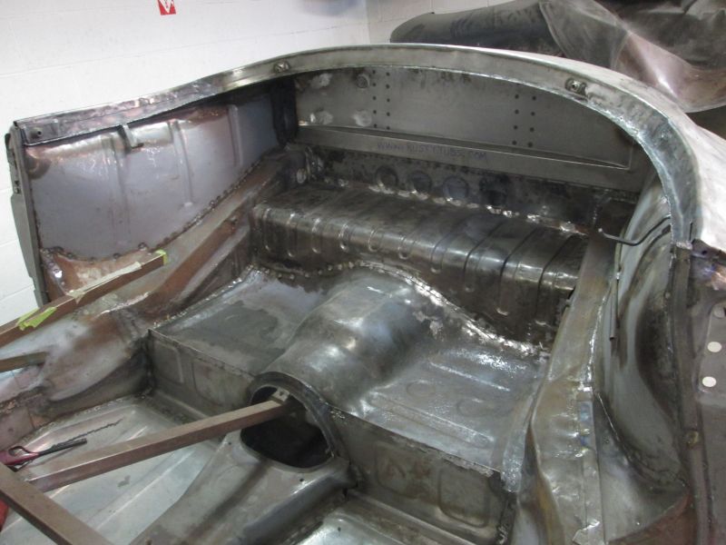

                  Finished out the rear cabin and now working my way from the doors posts to the tail.

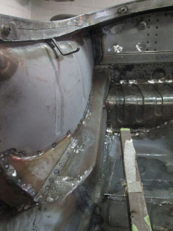

                  All remaining plug welds from that deep corner on down and around the parcel shelf to the lower door post gusset were finally completed on this side.
                  A very long and involved road back here but this officially wraps up my duties for the back seat area.

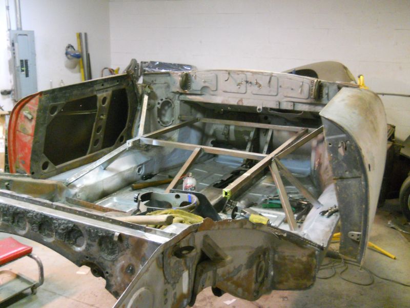

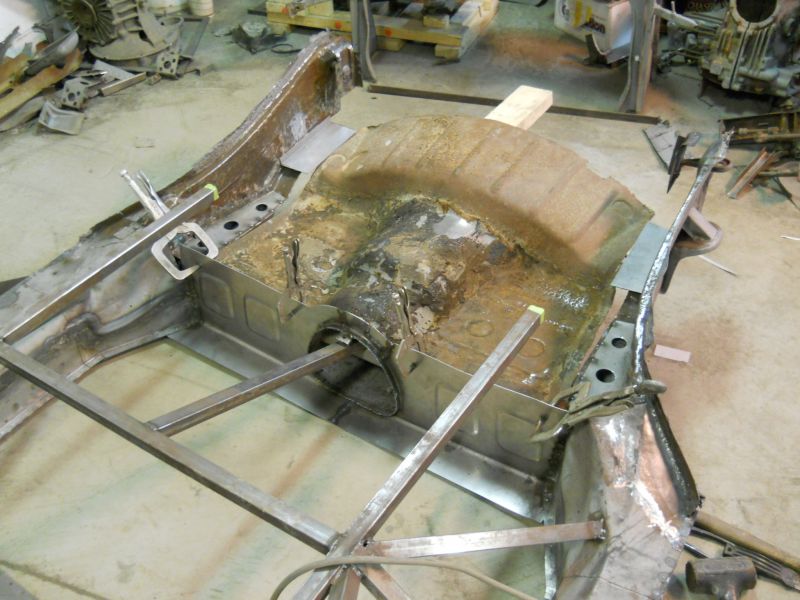

                  Easy to forget how far it has come so here's a look back. Fitting the new/used donor rear seat tray to the new vertical wall.

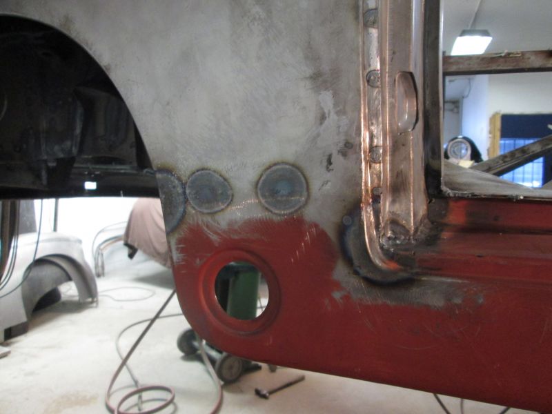

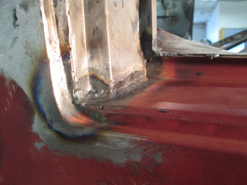

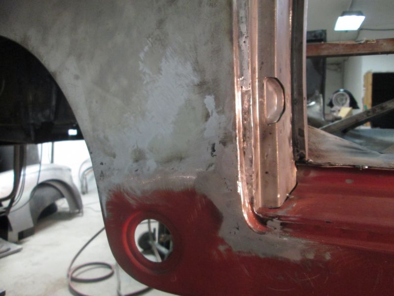

                  Vertical flange run welded and dressed to the lock post. Closing the upper corner details beginning with capping the seal channel.
                  Finished off the rest of this upper corner with a little gas weld. All done here.

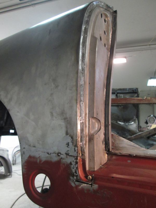

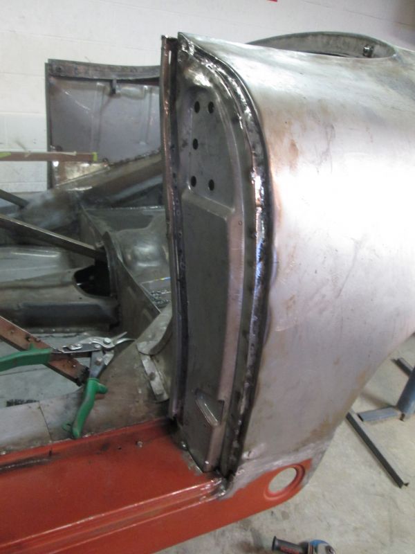

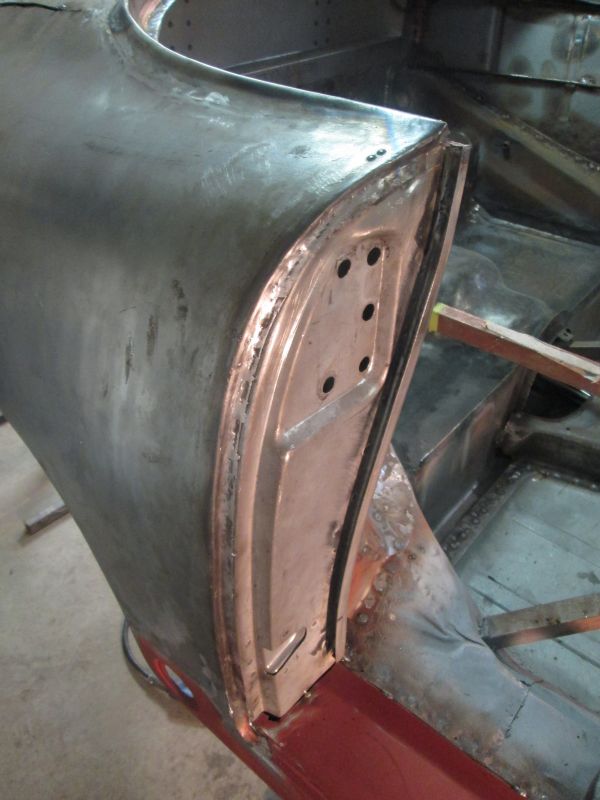

                          Right striker post completed.

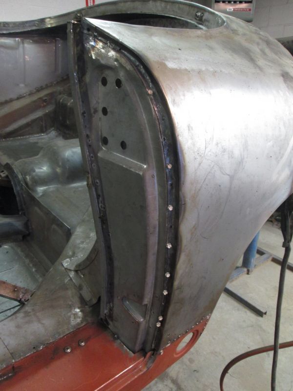

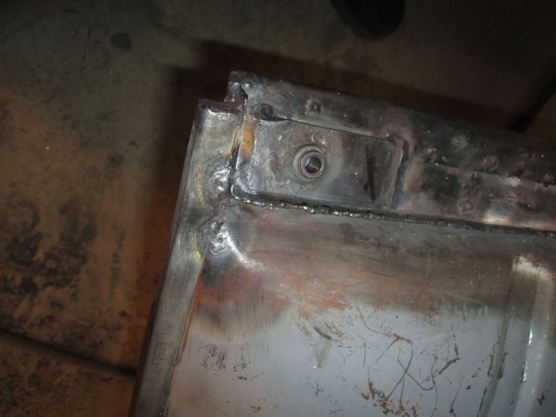

                          Threshold hold run welded up. The main concern was getting the weld flat enough so it doesn't interfere with the eventual rubber mat.

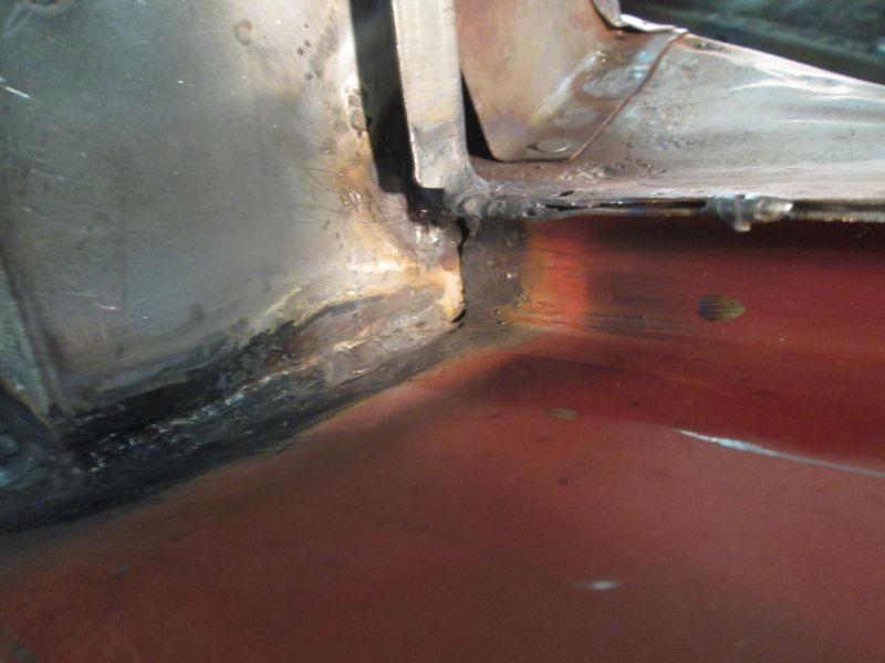

                          Left the inner corner open for drainage if any moisture finds its way behind the rubber seals.

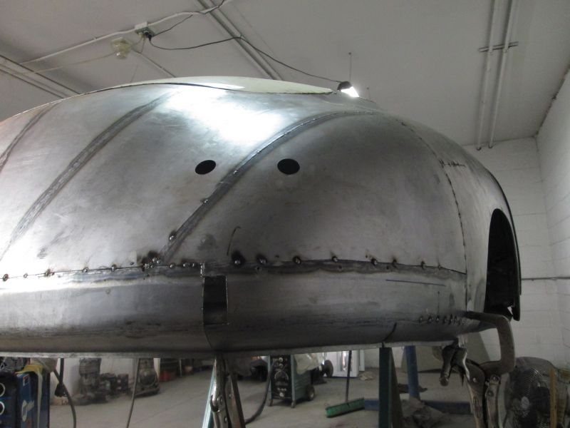

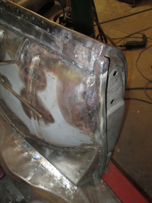

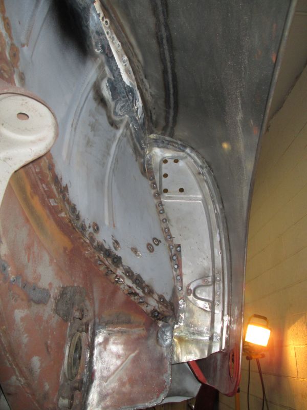

                          That completed the loose ends on the top side so I turned the car over to address the backside.

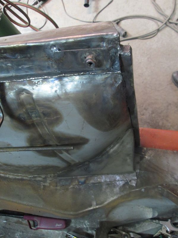

                          Needed to backfill all the setscrew holes and tap that leading edge of the striker closer to the skin(green arrow)to keep crap from accumulating in there. It would require some heat to stretch it out.

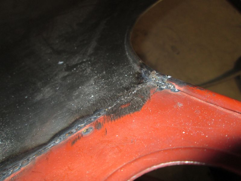

                          Also needed to finish off the inside on the wire joint.
                          After I finished welding up the wire the joint the skin swelled a bit requiring a couple of heat shrinks to bring the area back level again.
                          Forward inner wheel well area completed. The wired lip did get a little frogy on me but after the shrinking and a bit of hammer work a consistent contour across the two panels came back...thank god.

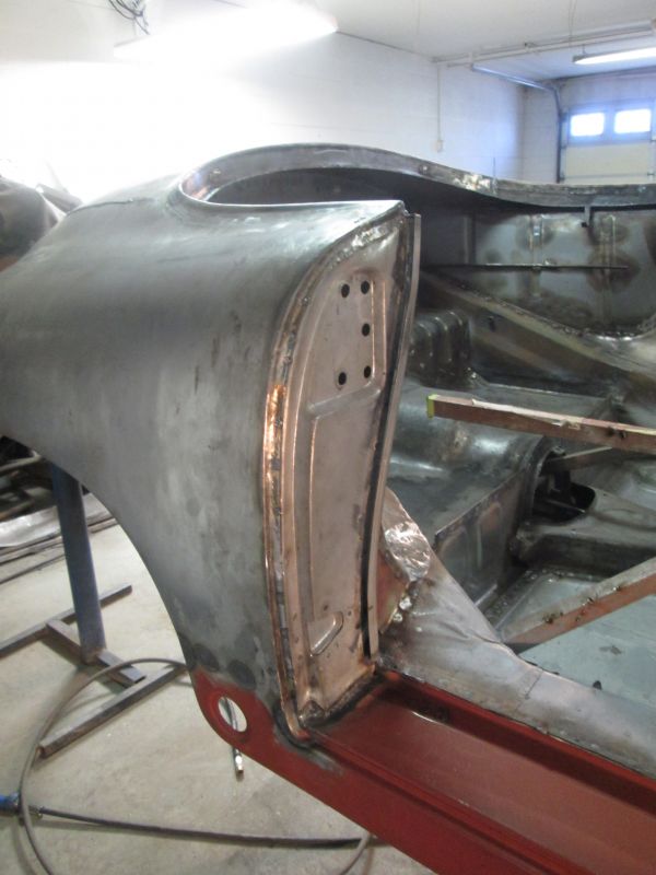

                          This post and related area is now complete.

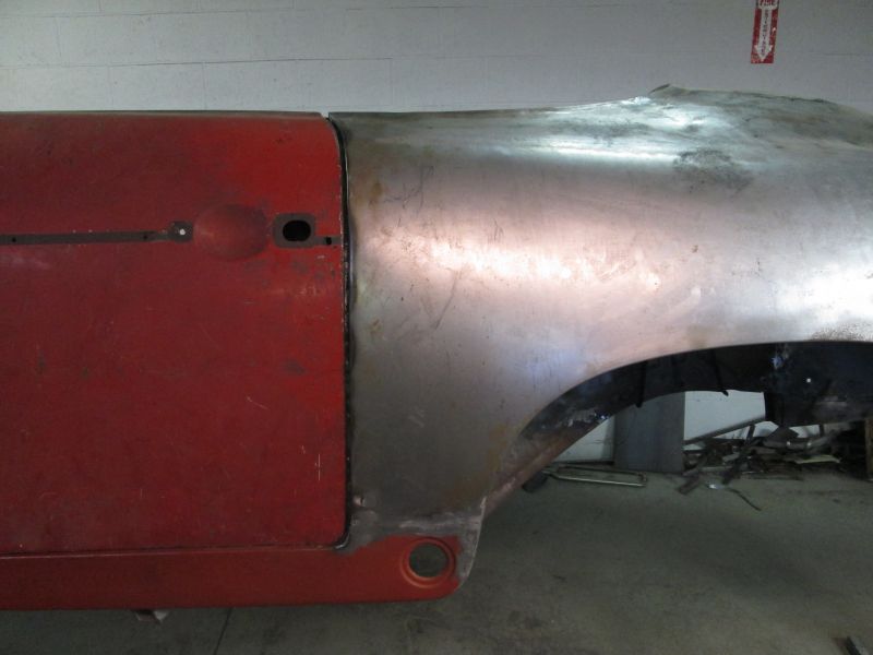

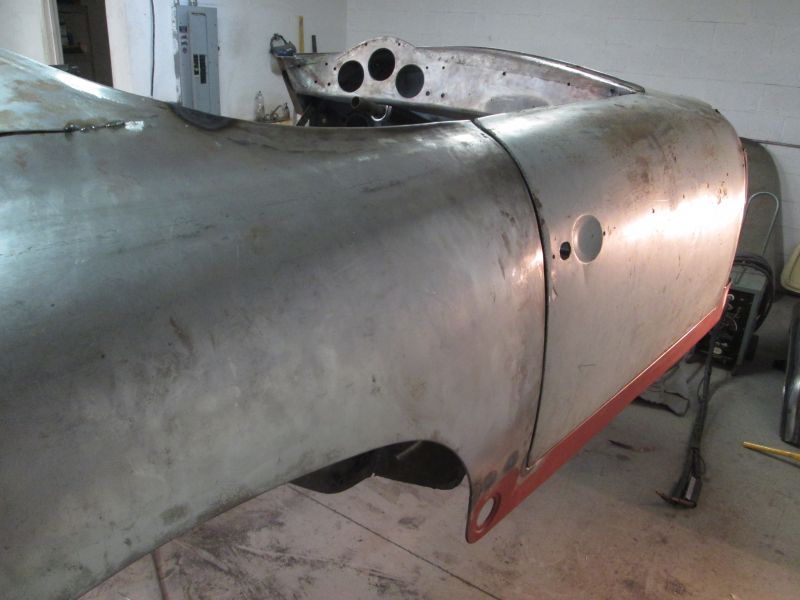

                          Door remounted for another confirmation fit and look for any changes to the quarter panel after all the heat and hitting.

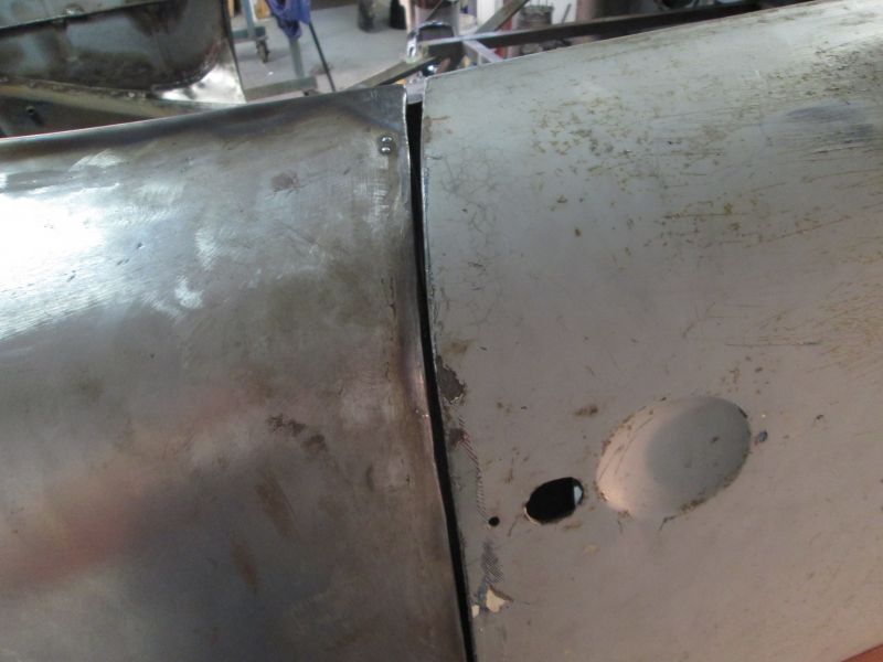

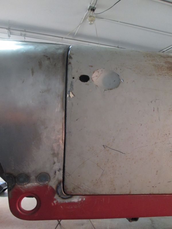

                          Raw gap but still runs pretty consistent with the door. It will of course need solder for a perfect gap and contour shape from the door but it won't need a whole lot.
                          Opens up a little at the top. If Jack hadn't confirmed that the OG cars do this I would have been freaking out. Again the leadwork will smooth out a lot of that.

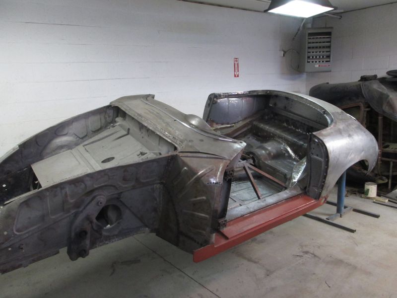

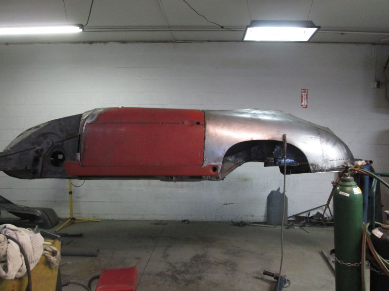

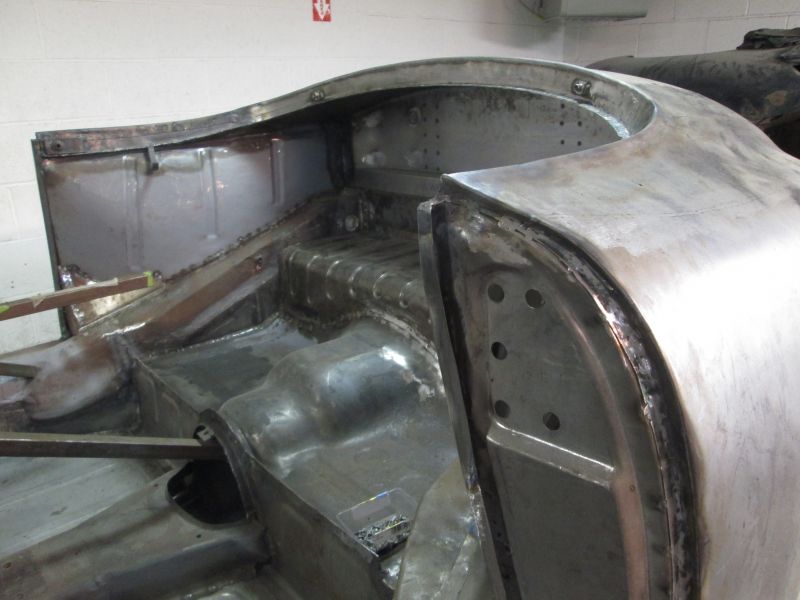

                          Another look back. Just a couple hinged doors sort of hanging out in space. Had to start somewhere; ground zero for the body here.
                          Just getting the rear cowl located and set here so many miles yet to go.
                          All done building this area. Moving over to the left side now.

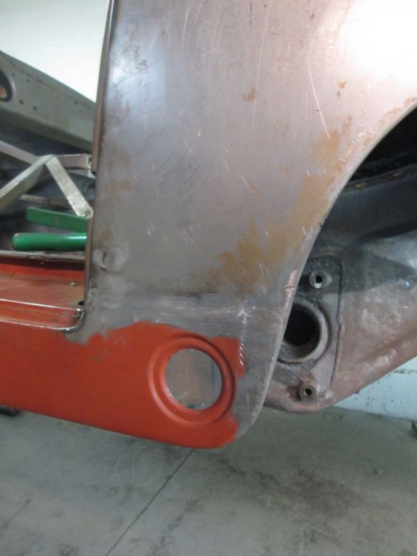

                              Loose end repeat on the left striker post.

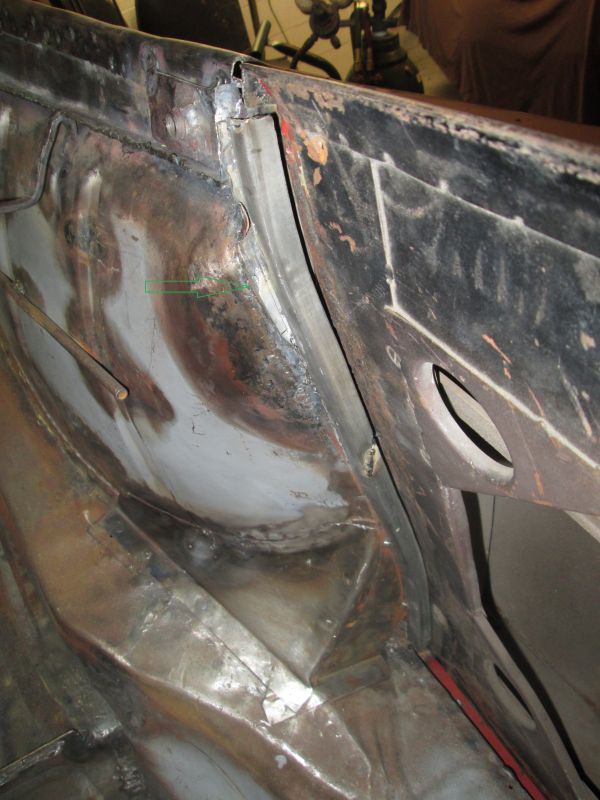

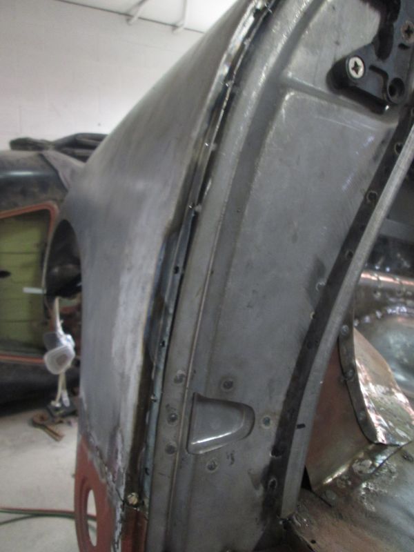

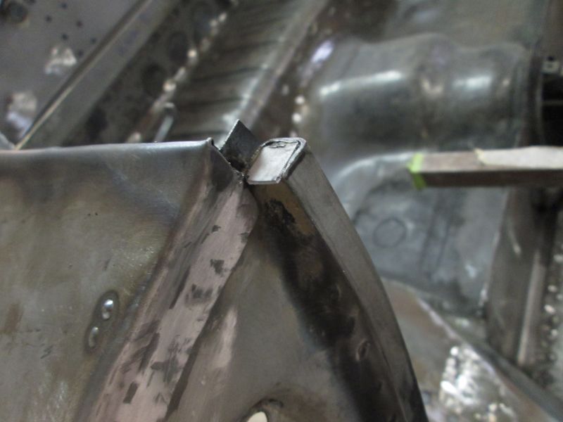

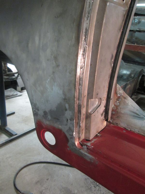

                              Some time ago Bruce had warned about not assuming that channels on these new strikers were necessarily going to hold the seal in a snug position against the latched door. I heeded his warning and sure enough I found that the last upper half of the channel swung way too wide. I ended up cutting it free and tacking it into a position that matched the lower run which was fine. There where no issues like this on the right side BTW. So, I've got a little more to do on this side before I'm finished.
                              Should have this side wrapped up by tomorrow...I hope.

                                Left lock post area nearly complete.
                                Channel now runs evenly along the door. The green arrow highlights the edge of the residual flange where the channel started out. It swung way too wide.
                                Channel fully welded, capped with all the excess cleaned off.
                                This post is officially done on the outside with all the gas welding details done up here.
                                Will roll the car over next to address the inside details which will wrap it up completely.
