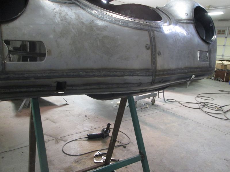

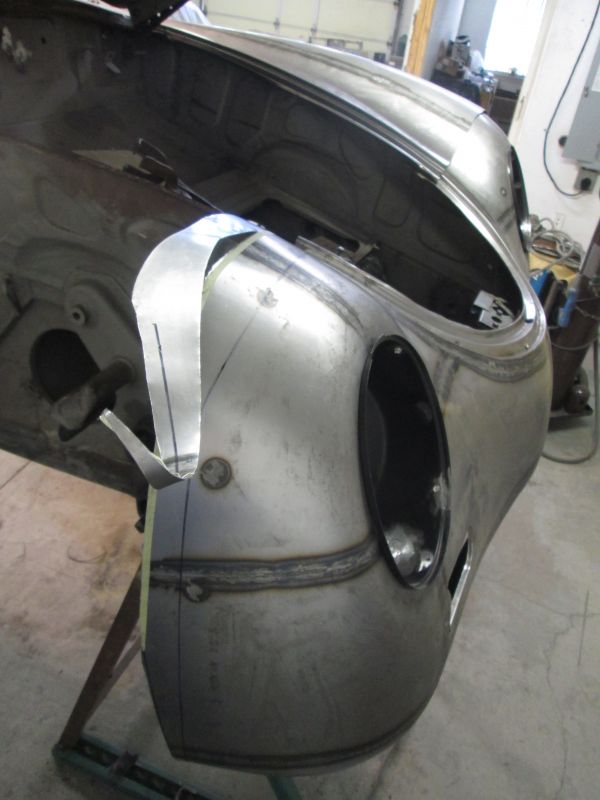

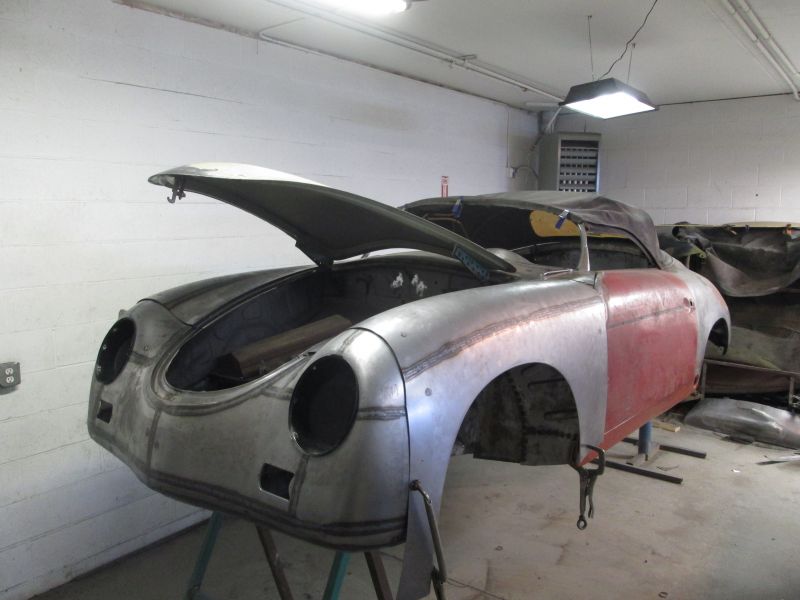

              1/19/17

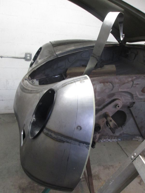

              Initial excess metal trimming at the fenders to nose joint.
              Getting a little more material out of the way for a closer and improved fit.
              Inital cuts remain very conservative but allow for closer alignment.

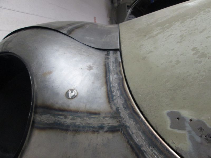

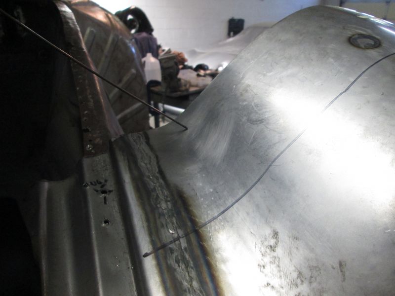

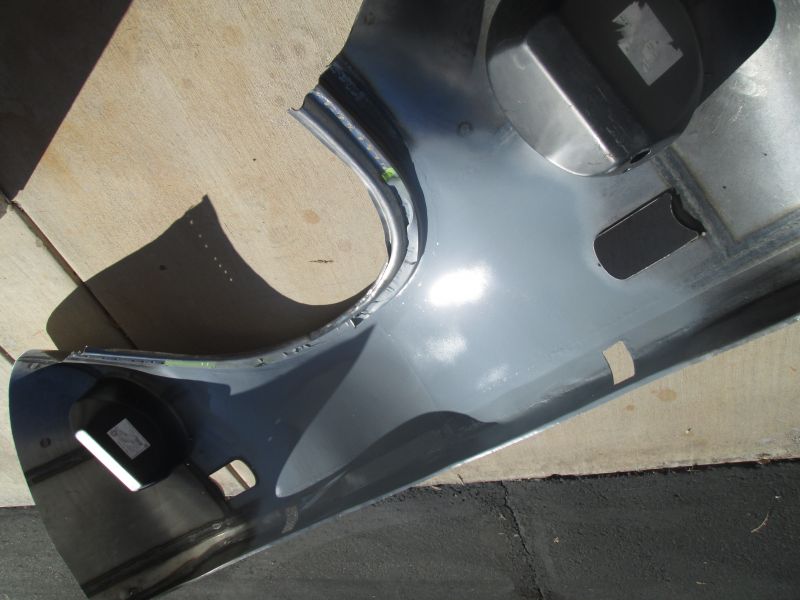

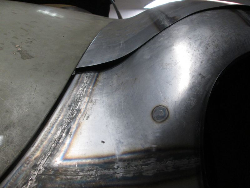

              Removing excess and the roughest sections from both the nose and fender side.
              A scary commitment but I've still left myself a sold inch of overlap for future adjustments as it goes.
              Repeat left side
              This left side trough or spillway profile is a bit tighter than the other side and the corrosponding fender sections on both fenders.
              You can see here how much deeper the nose profile is. I'll soften it later when the time comes to mate it to the fender but it will most likely be some give and take from both sides.
              By comparison this right side profile is much softer and better aligns with its fenders contour. I want both sides to match as closely as possible so everything is telling me that the left side is too tight.

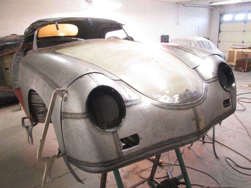

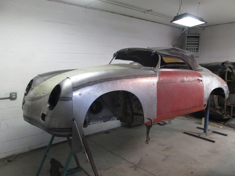

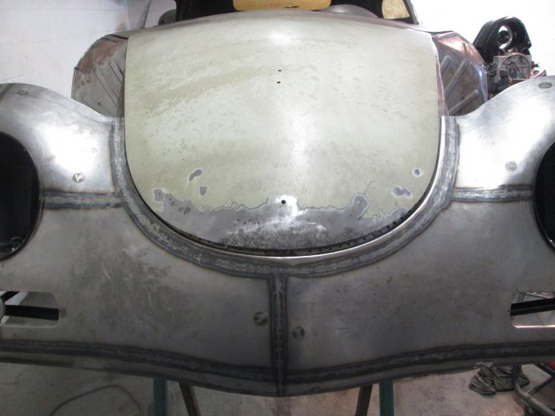

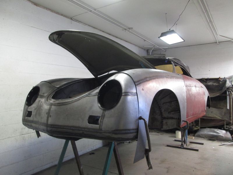

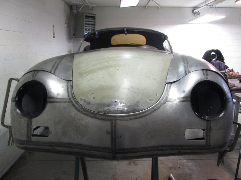

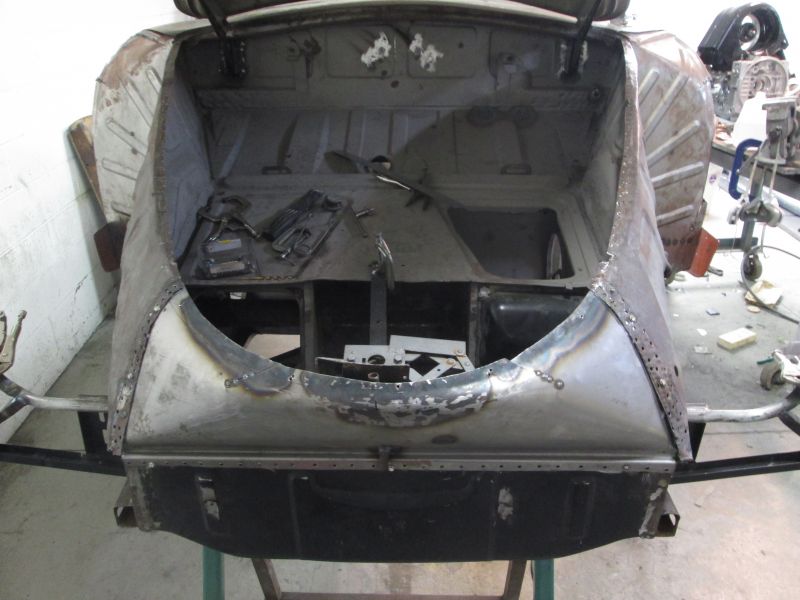

              Panels staged once more after all the trimming to both sides of this joint.
              Everything fitting just a little bit better than before.

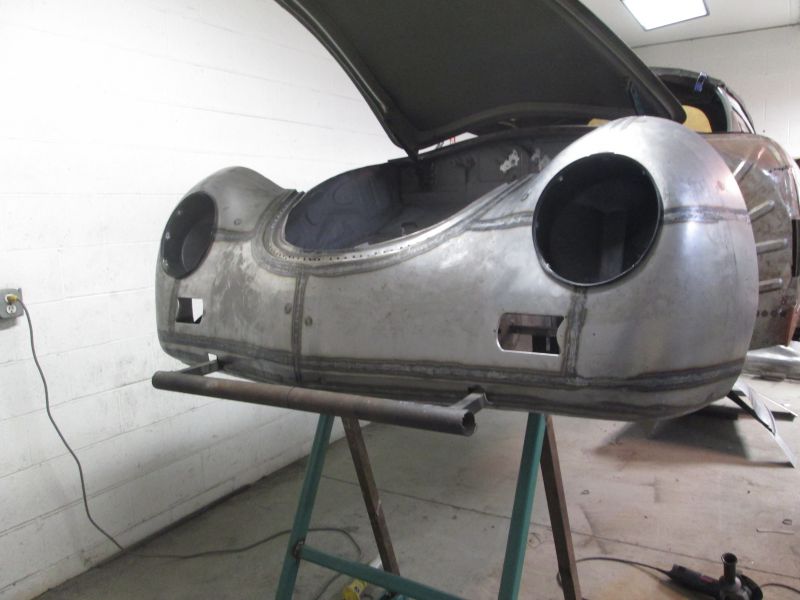

              Hood now has clearance to latch fully with fenders in position.
              Thankfully all the pieces seem to be falling closer into place.
              Fender openings set to center with chassis, close initial gaps with a latched hood and decent general body contour; I've gone as far as I can this time around. As things will certainly change once welding begins I came to the decision that it was time to start getting the nose "set in stone" then add the fenders in from there. Breaking all this down next to finish out the battery box and inner closing walls so this nose can go on for good. Tying up those loose ends next.

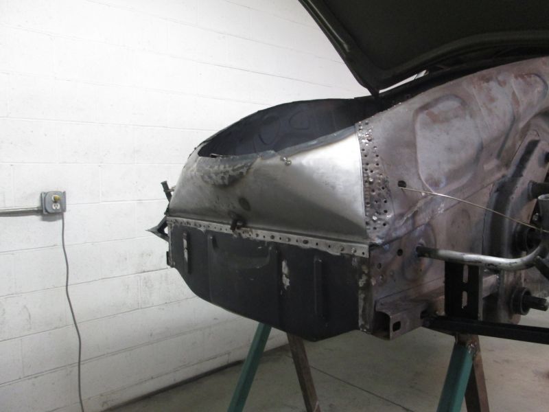

                  1/20/17

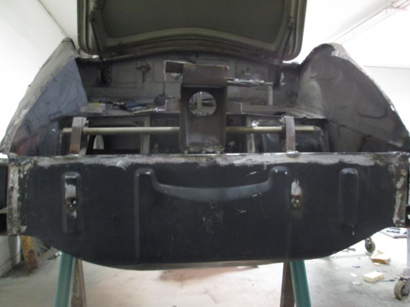

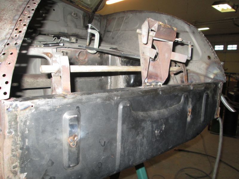

                  Lower forword battery box closing wall loose ends.
                  Skins and upper closing wall removed(again) to address several PIA details down here that I could not get motivated to complete until absolutely necessary.

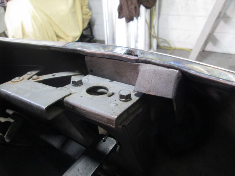

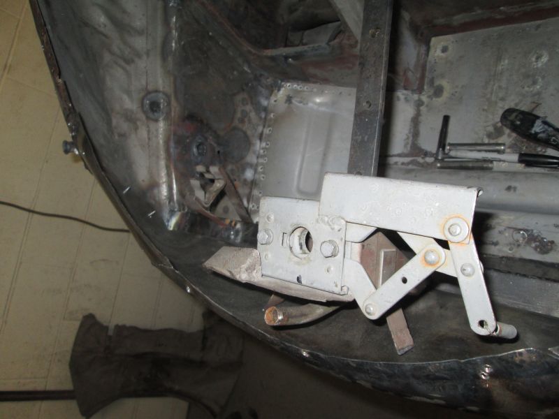

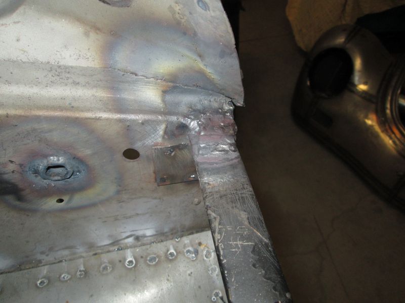

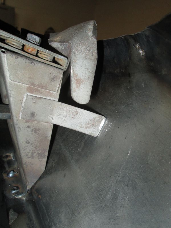

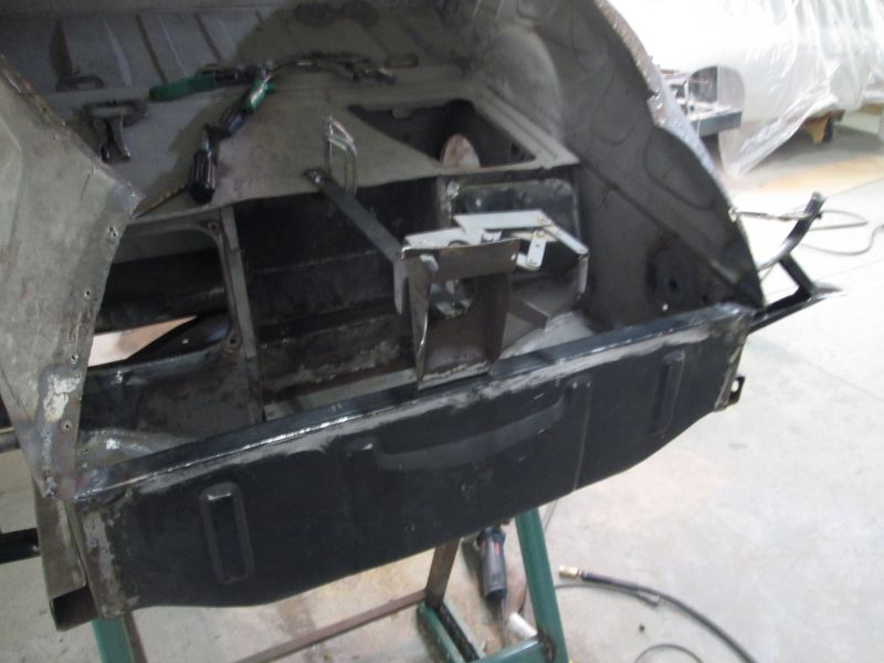

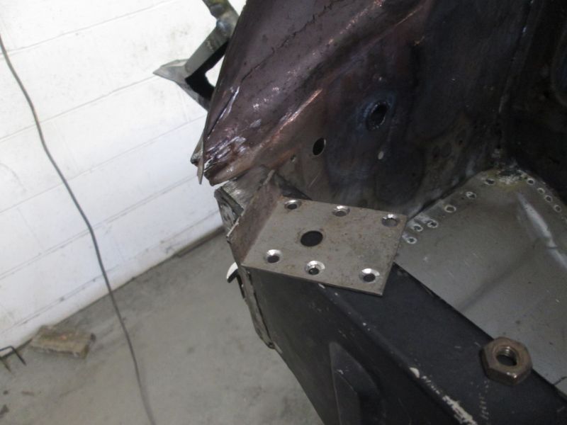

                  Install these harvested OG reinforcement corner plates for the USA version bumper bracket mounts as well as the actual welding details at the upper corners of this box.

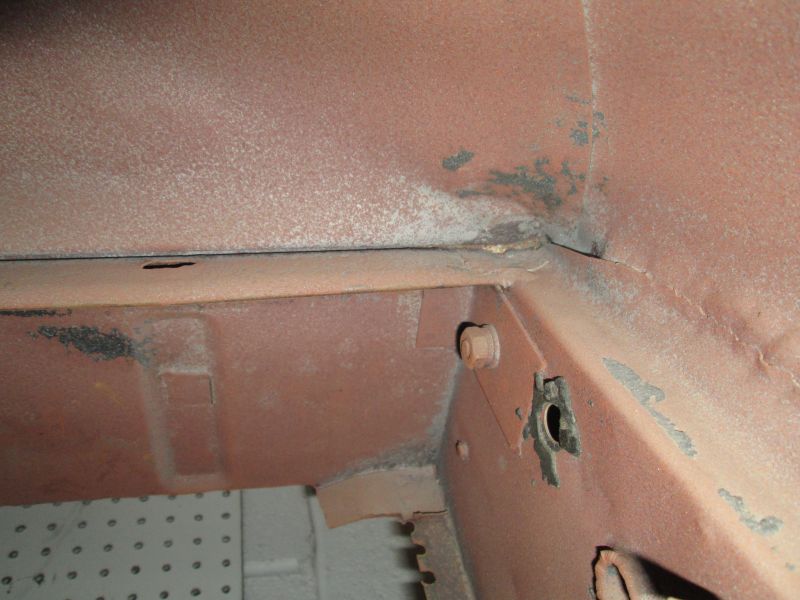

                  Originally there is a small lap plate that helps tie these two panels together up here.
                  corner and lap plate installed.

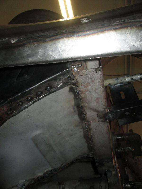

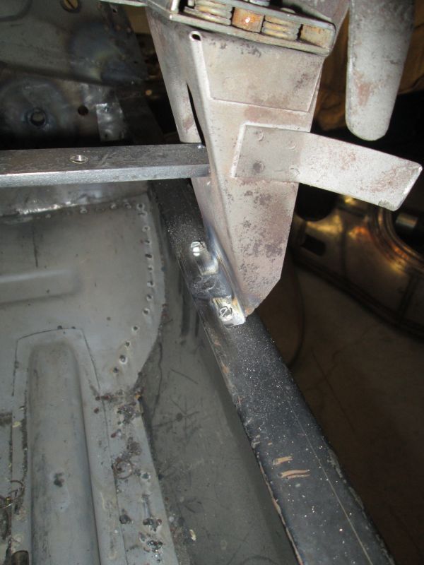

                  Commitment time; trading screws for spot welds at the base of the latch mount.

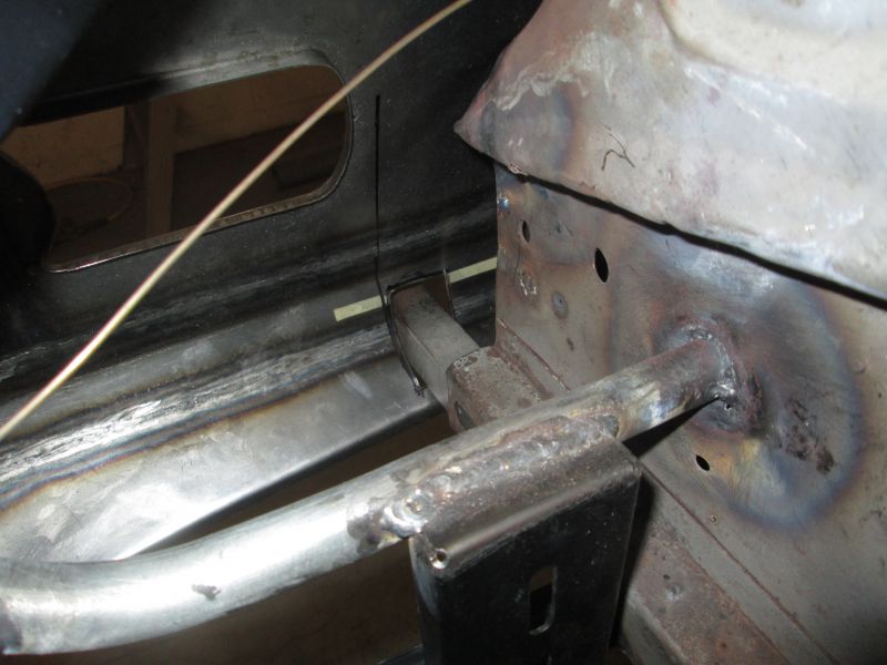

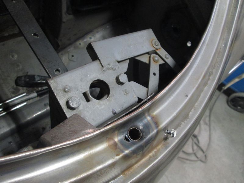

                  Final lower closing wall chore to complete before moving onto the upper section are the jack perches. Harvesting the originals then some restraightening. As you can see they are all bent to shit.
                  Spot welded at the bottom and gas welded at the top.

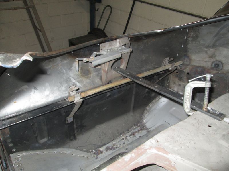

                  The spacing and placement on that old original T2 wall has them right of center about 14 3/4 inches apart(sorry Per) with the right side perch mounted just before that embossment. Green tape represents position.

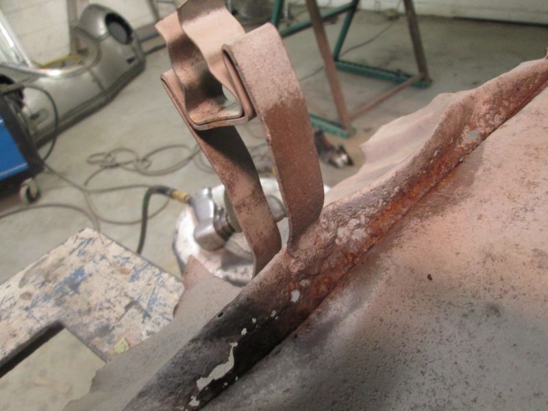

                  The remnants on my '56 T1 has the right perch seated into the embossement and them spaced away from each other about 15 inches even.
                  1957 T1 shows the right perch mounted down in the embossment too. Perhaps yet another subtle T1 to T2 chassis difference.

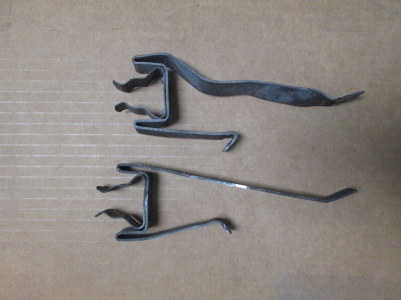

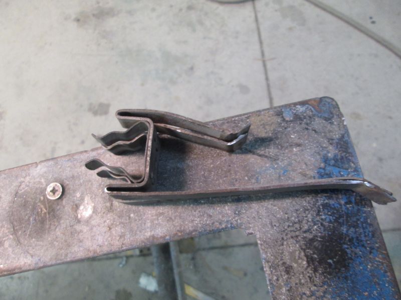

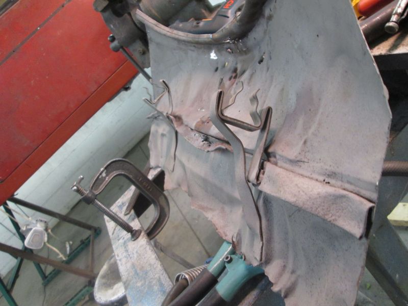

                  Harvested and straightening half way done.
                  To help with alignment when mounting the profiles where tweaked to match one another after the basic restraightening.
                  Perches mounted in the known T1 location that matches my referrence cars.
                  Cross bar seated to test for level and square; All good.
                  I have an actual jack but it wouldn't clear my makeshift holding strut there. Lower wall duties completed! Onto the upper wall, drain tube and latch base next.

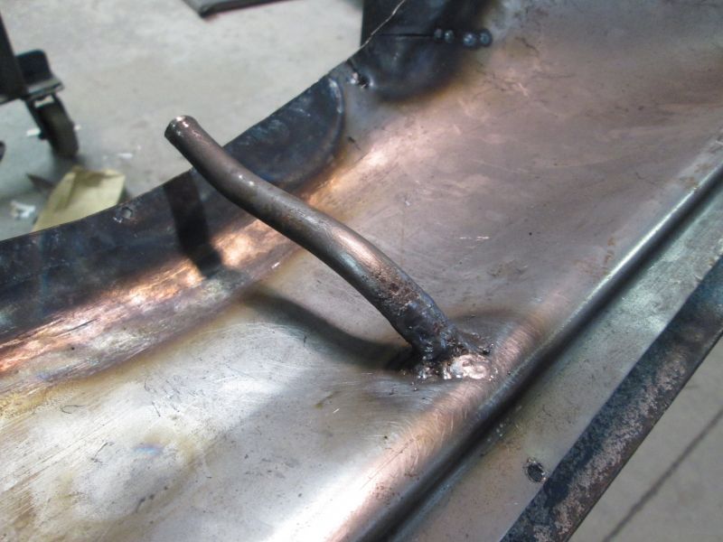

                      Original drain tube indexed and base welded as before.

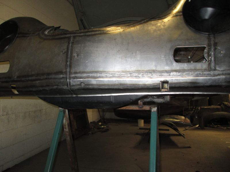

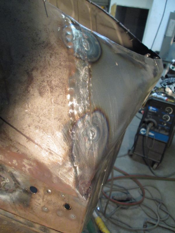

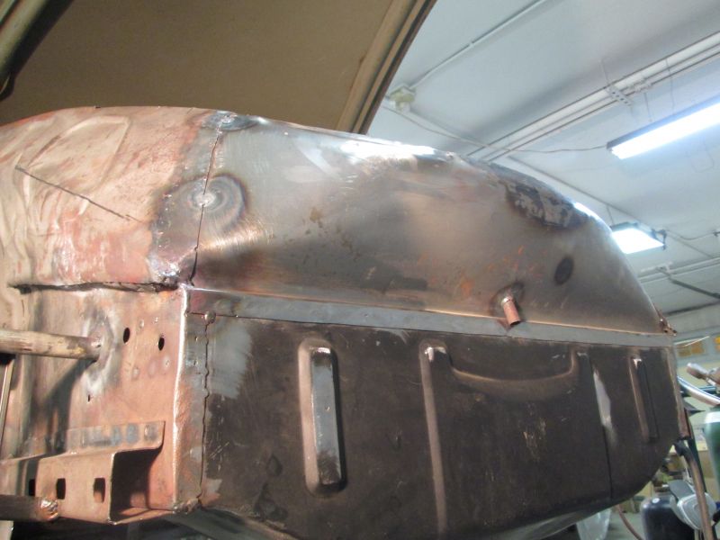

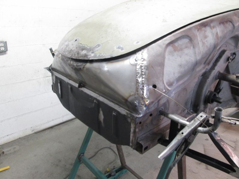

                      • 1/22/17
                        Upper closing wall welded in.
                        Plug welded and dressed.
                        Twin gas weld tacks at each side were replicated as found originally.
                        Damaged side buttoned up alot cleaner than I was expecting. I had my doubts.
                        So glad that this wall is behind me!

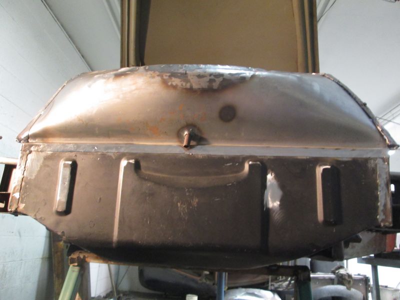

                        Prepping the nose panel for final install next.
                        • 1/25/17
                          Prepping the nose panel for final install.

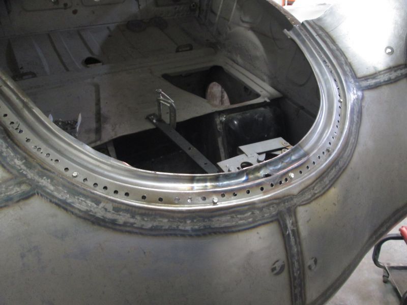

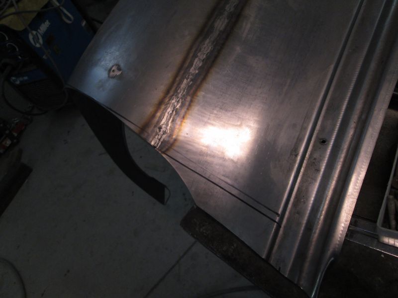

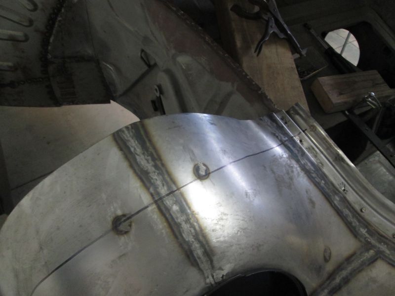

                          Drilled for plug welds and center trough heated then beat down to match-shape it against the latch base.
                          Both fit tightly and are ready to be seam welded.

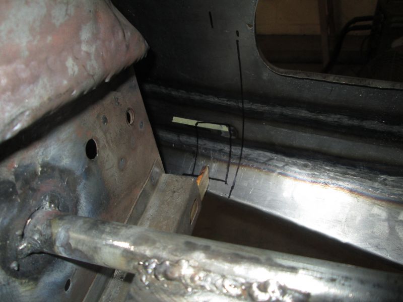

                          Next was locating the cutting the holes in for the bumper brackets.
                          Cutting in square holes wasn't exactly straight forward as the apron is both curved and angled in relation to the chassis. By the time I had bracket mount opening drawn on the wall it was set just a little cock-eyed. I had it originally sighted more squared in but it more closely matched my original example to I went with it. "centering" the holes was another project. The bumper irons are sandwiched against the outer wall of the bracket so I had to set the holes center more to the outer edge of the bracket to account for this arrangement. The paint stick represents this configuration.
                          Done.
                          Much to my great relief the holes line up just about dead on with the brackets.
                          The true test was whether the pegs for my rotisserie mount were going to clear.
                          Fit just fine. I'll be able to remount the car back on the hoist here shortly which will make adding on the fenders a little more pleasant with the ability to roll it over again. This nose is just about ready and I should be welding on it before my next session is over.

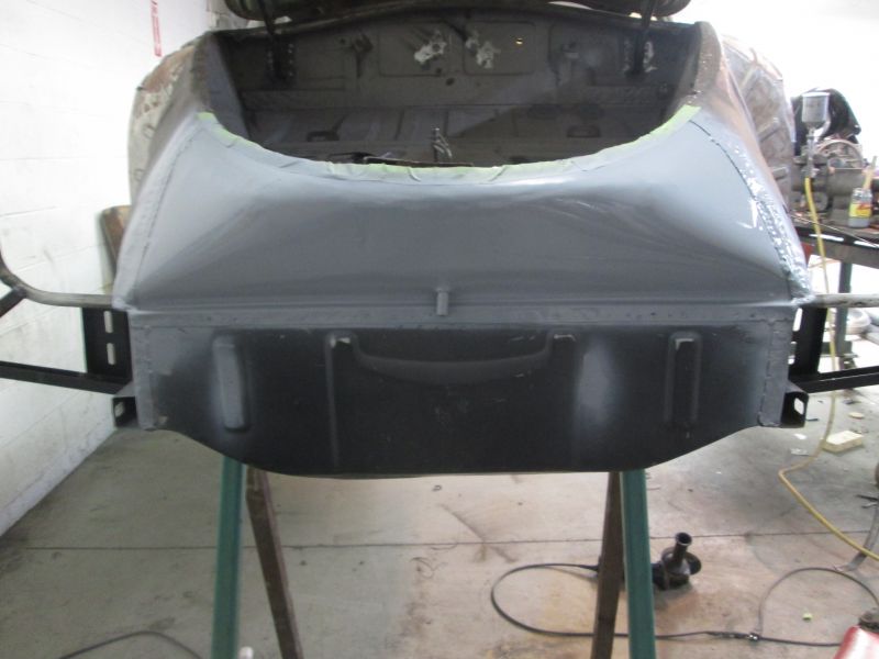

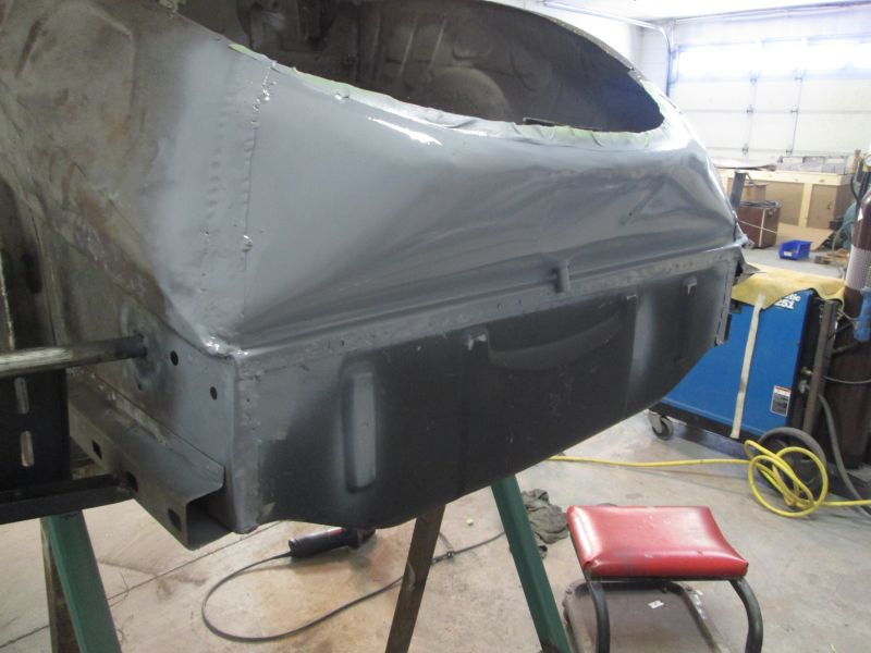

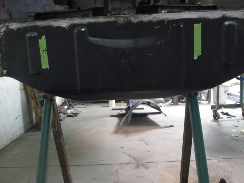

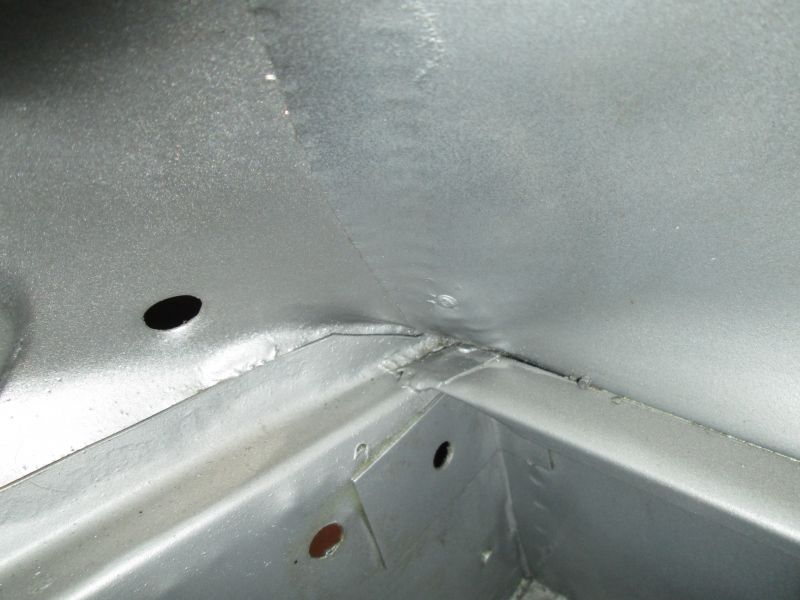

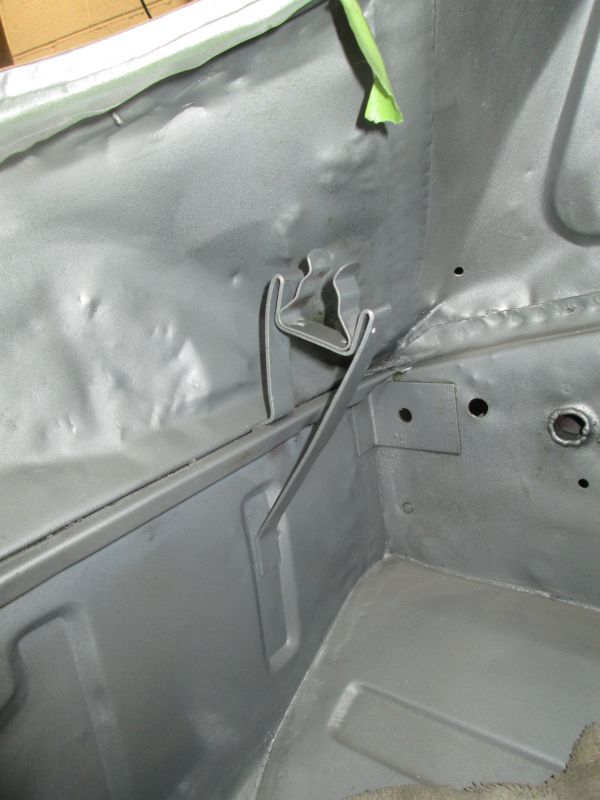

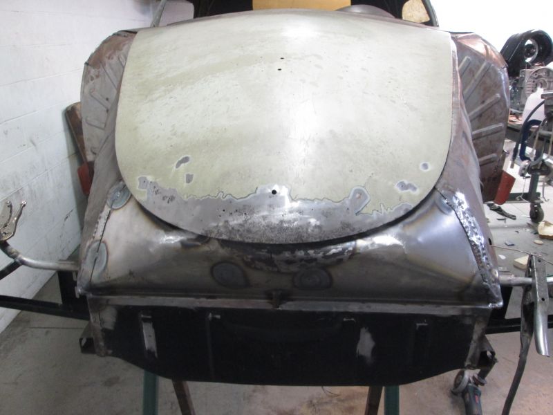

                                Before mounting I wanted to get these soon to be deep surfaces behind a good coat of Epoxy.
                                This car needs to be media blasted one more time so its just a temporary coating at this point.
                                Some of it might survive

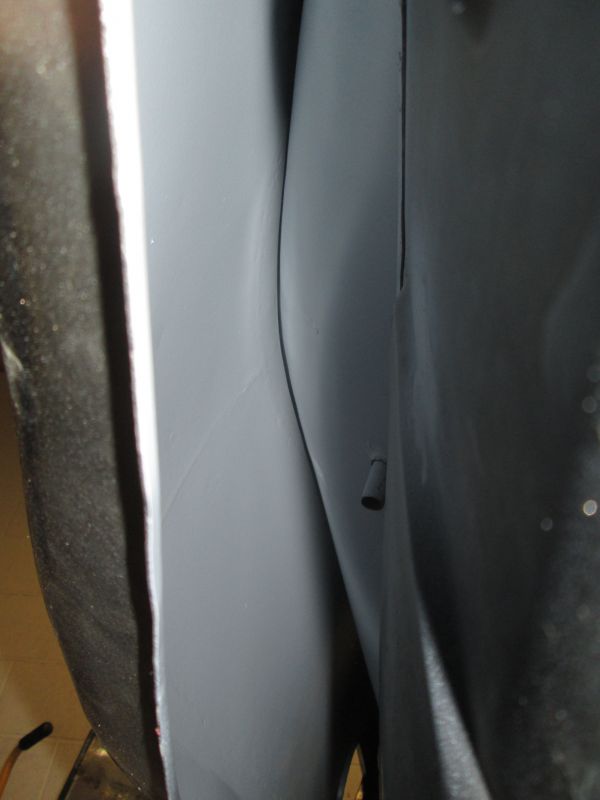

                                You might get okay coverage by blowing paint up here after the fact but nothing like spraying them before hand.
                                Okay, now I'm finally ready to begin welding this on. Of course with all the welding and heat the upper wall shifted ever so slightly and threw off my hood gaps.(looks worse here because its not latched) Only by a MM or two but enough to where I'll have to reset it from my original set screw position before all the welding. Its good that I was expecting it otherwise I really would have been pissed!
                                reseting and applying the first series of welds next.
