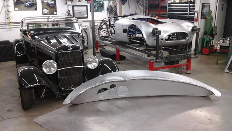

  • Watching this build is incredible. Justin, this is quite a talent you have that many beginning coachbuilders can appreciate.
    Why polish this turd?
    I would never buy a part that didn't work or fit. With all of the parts available for these cars, does anyone make a part that fits? The obvious is that Steve Hogue made this dash. His ad on the registry says, "craftsmanship of the highest standards"
    really?
    He should be hired for the Mad Max car builds, not speedster parts.
    • Thanks for the really nice empathy filled posts you guys, very much appreciated!
      Welcome Ryles and thanks for joining us here. Very nice of you to say but actually after all my cutting and splicing its my work that is Madmax worthy. As misshapen as these panels were they both sure were shiny, smooth and civilized the day they showed up.
      John, to be honest I don't think Steve has an interest in what's going on here; He's down the road and onto the next deal. I had one conversation with him on the phone to discuss my initial concerns then a follow up email with photos that went unanswered. More than the dash, I was disappointed in the lack customer support from the manufacturer (S.H.E). I asked the vendor,Rusty Tubs LLC,to follow up with the manufacturer Steve Hogue Enterprises shortly afterward: Steve stated that his dash and cowl are correct and that the fitment problems I'm having are because I don't have a clue of what I'm doing. He had seen the photos of the cut cowl and said I had completely ruined it.
      I'll tell you, right after that conversion I was really second guessing myself and what I was doing. My only saving grace through it all was that I had this original dash assembly, with an original windshield frame with all the original related speedster parts and they were ALL telling me his dash was wrong. If not for that I would have surely believed him in that I was just in over my head. (which I still was) This is why I feel extremely sorry for any other hobbyist who attempts this without an original reference car or parts. You buy 10k worth of conversion metal with big dreams and tons of enthusiasm then the dash doesn't fit or look right. You call up the metal master just to be told you're an idiot and you don't know what the hell your doing. As a grunt novice myself I don't know how you'd ever get past that kind of criticism coming from an expert. The project would either go up for sale or you'd take it to a "professional".
      Again, fortunately I had the real deal here to guide me. I'd have been frozen in fear and doubt otherwise.
      Roy, that makes perfect sense as none of these panels are stamped. These are all knock out on a power hammer and test fitted over a jig. I know Steve if fully capable of making a dead on perfect dash but for god know what reason they are not. Who knows maybe an apprentice did this one or these even may have been farmed out to another metal shop to keep up with demand. This is why I am so curious if anyone else using his parts is running into the same problem?

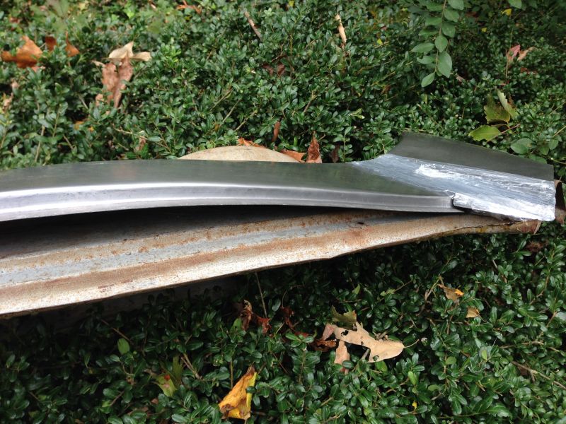

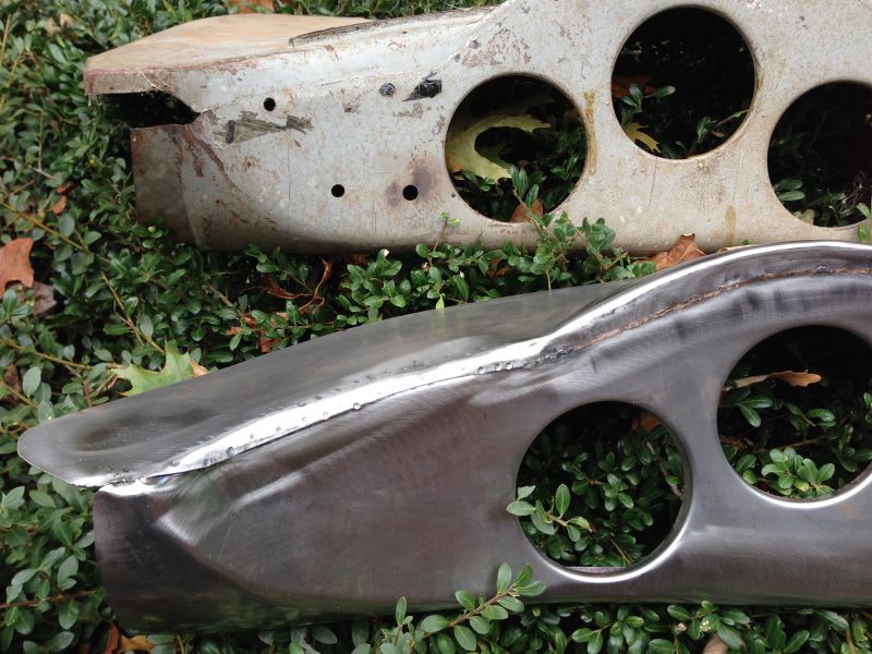

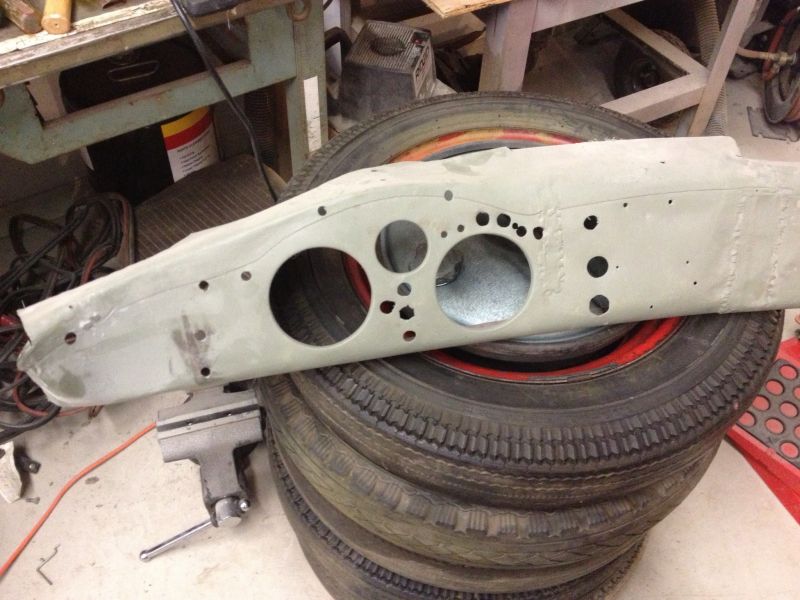

      Here's a pre-A dash he just did and has a similar shape and feel to the one he sent me. So this still is the standard offering.
      Compared with this original pre-a dash the new owner will be experiencing similar issues. IE: the lip flange and contour etc.

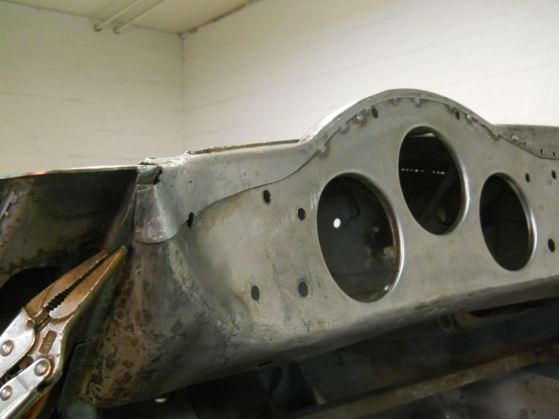

          5/25/15

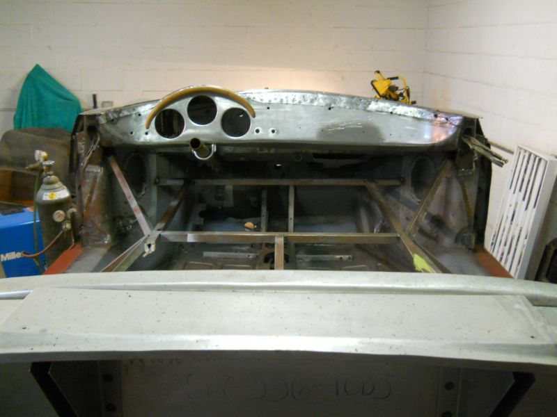

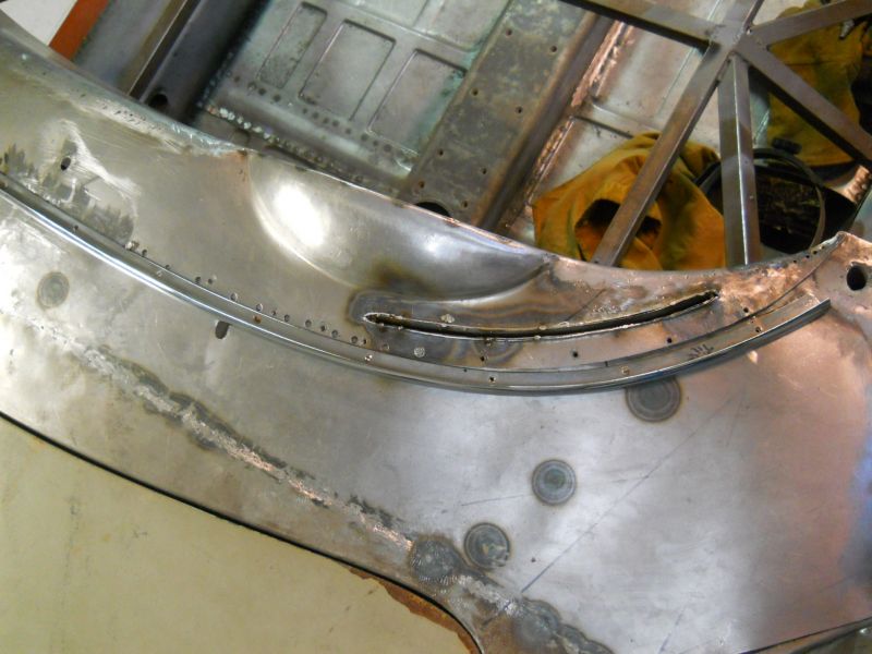

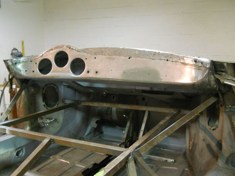

          Left corner of dash finished.

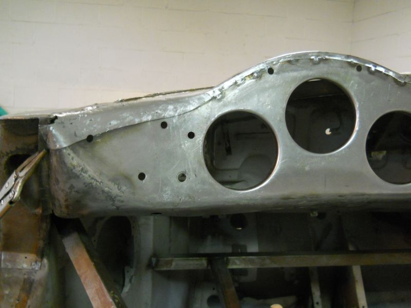

          Only able to get this left side welded and dressed before time was up. The very tip of that corner I'll close up after final installment.

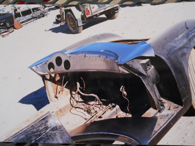

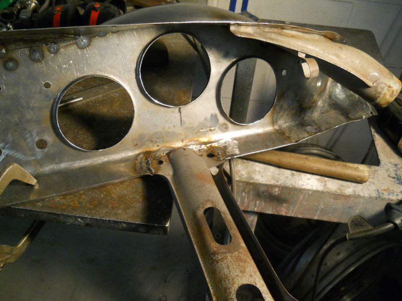

          As you can see from the original the factory very quickly closed this area with a patch flap which was then leaded over and filed to shape. Nothing fancy.
          Working my way over the right side tomorrow.
          Thanks for looking! Justin

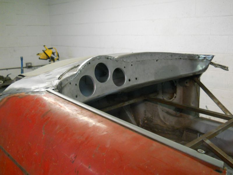

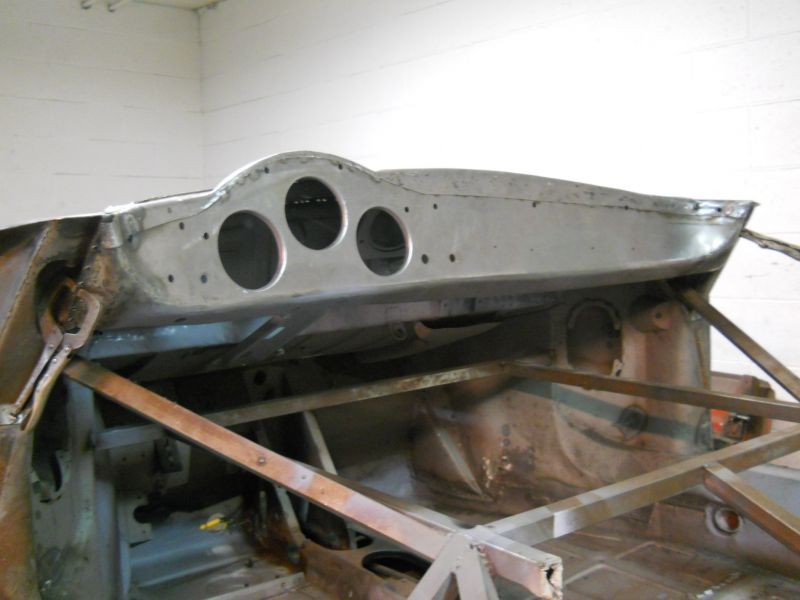

                • 5/27/15
                  New dash finally mounted on for good!
                  Been a long road but after tying up the last of a few loose ends I was able to mount the dash on for the final time.
                  Filed and pecked at the upper leading edge about as far as I am able to chase it.

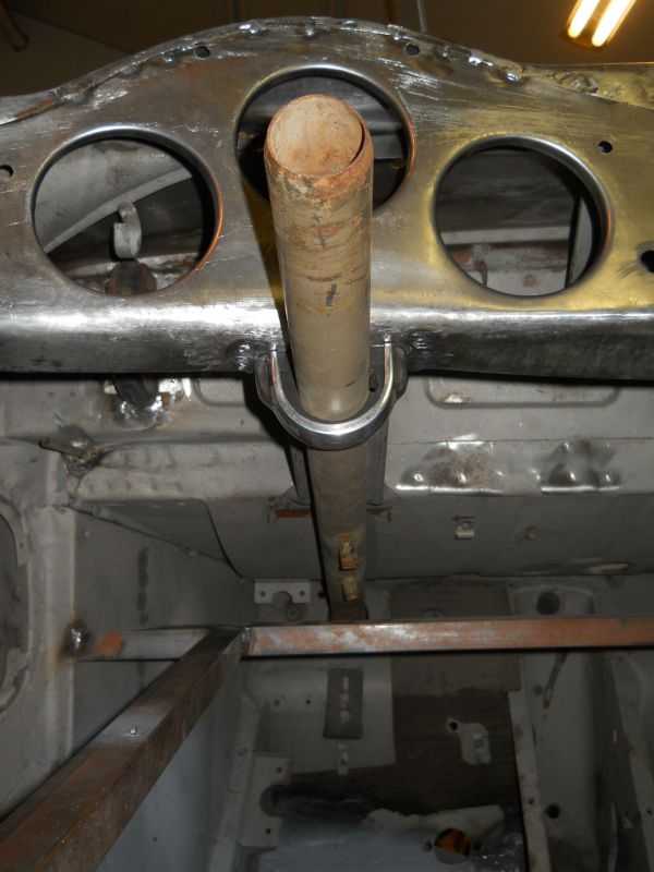

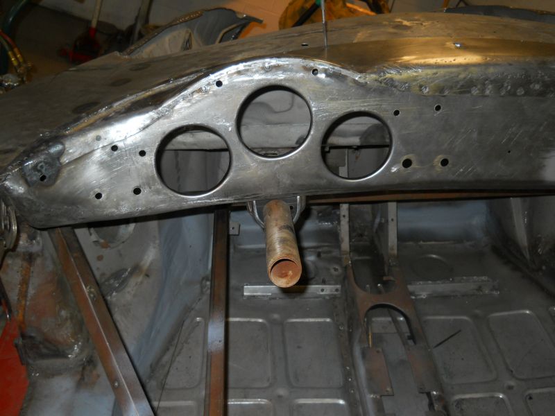

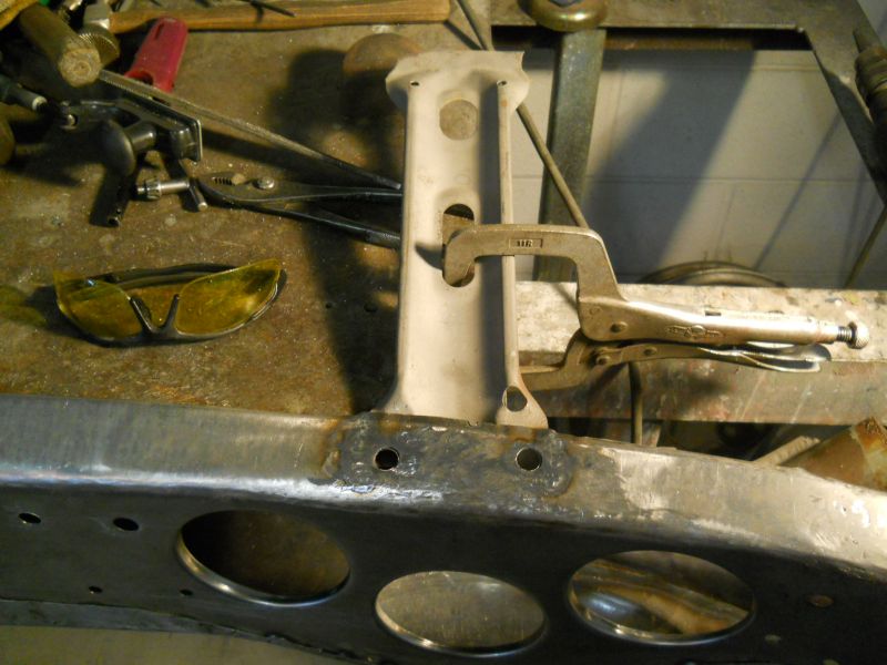

                  The next loose end was mounting the steering column strut into position. Column was mocked up once again to make sure it was mounted centered above it in its best adjusted position.
                  Dash was removed(again) then the end was seam welded along the sides as it was done originally.

                  Funky cock-eyed yet correct approach angle.
                  Column not perfectly centered under the tach and angles toward the left door as Tom McCoy was nice enough to point out. Thanks again for sharing that critical detail Tom!

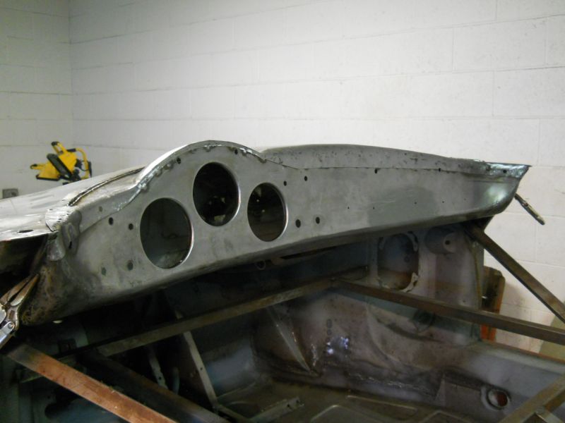

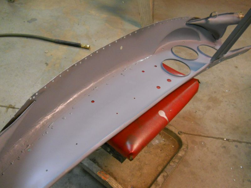

                  Dash was removed for a final time to punch in the plug-weld holes and to seal out surface areas that won't be as accessible for primer once its mounted.
                  At long last its ready to mount on for good.
                  Mounted!

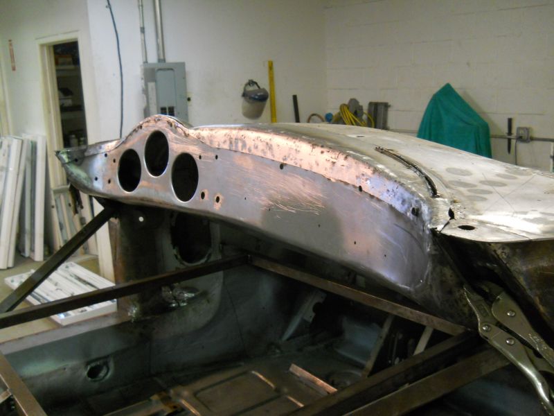

                              5/28/15

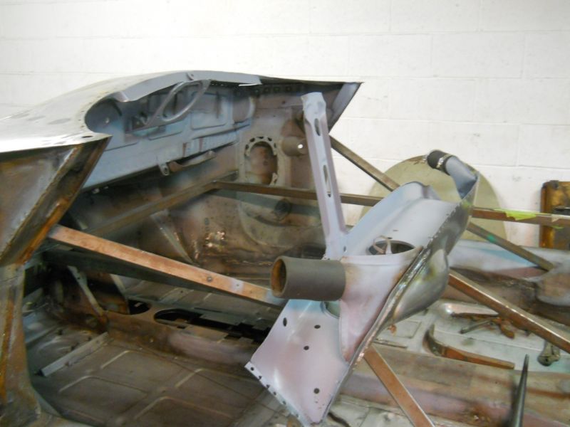

                              Some welding and test fitting along the way.

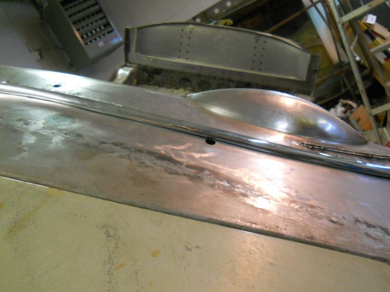

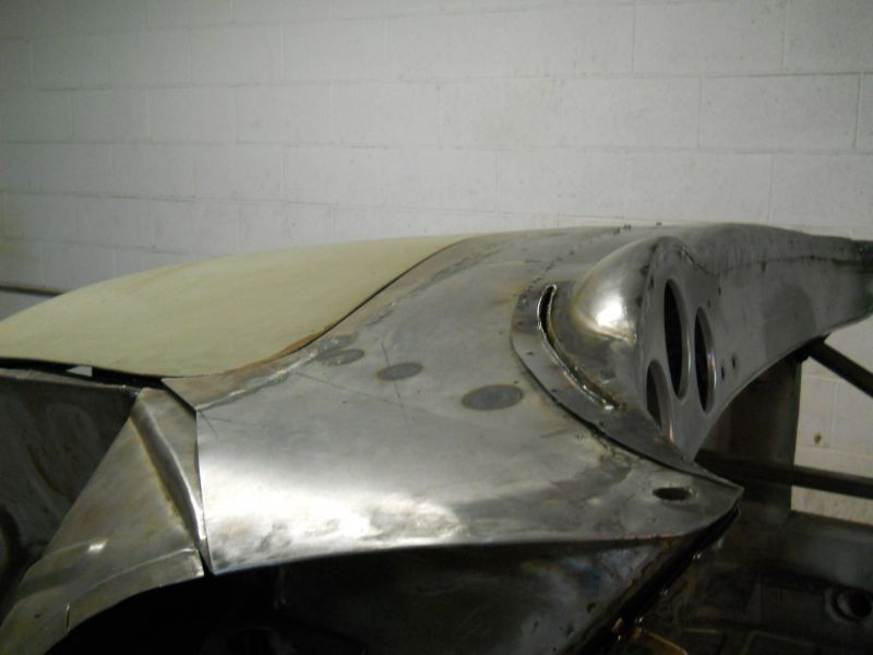

                              Once a few plug welds were laid down on the center of the cap I thought now might be a good time to remount the hood and check the body contour.
                              The line remains consistent enough.
                              one more..

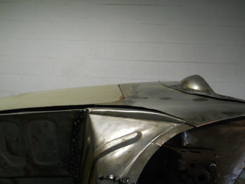

                              A test fit of the base frame was next.
                              Cowl profile runs consistent enough with the base. The corners will be tricky but its all still within striking distance.

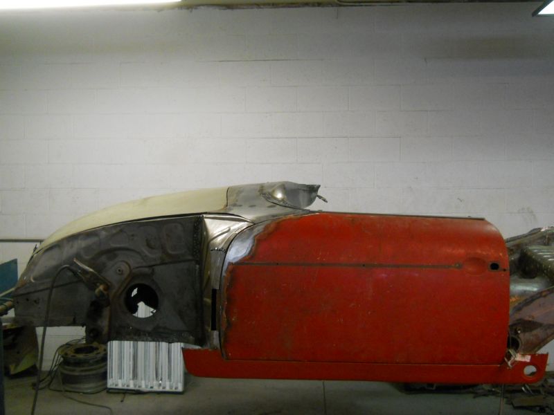

                              Left door was mounted next so I could get a better idea of the general body shape that's slow happening.
                              Getting more speedster like all the time. With this bit of confirmation I can continue welding the cap with confidence.

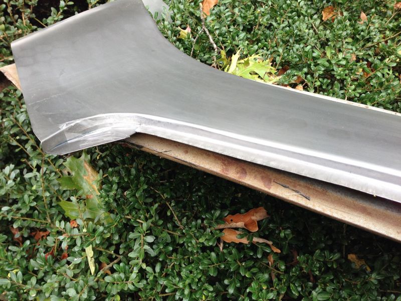

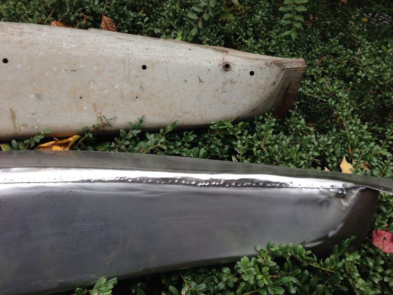

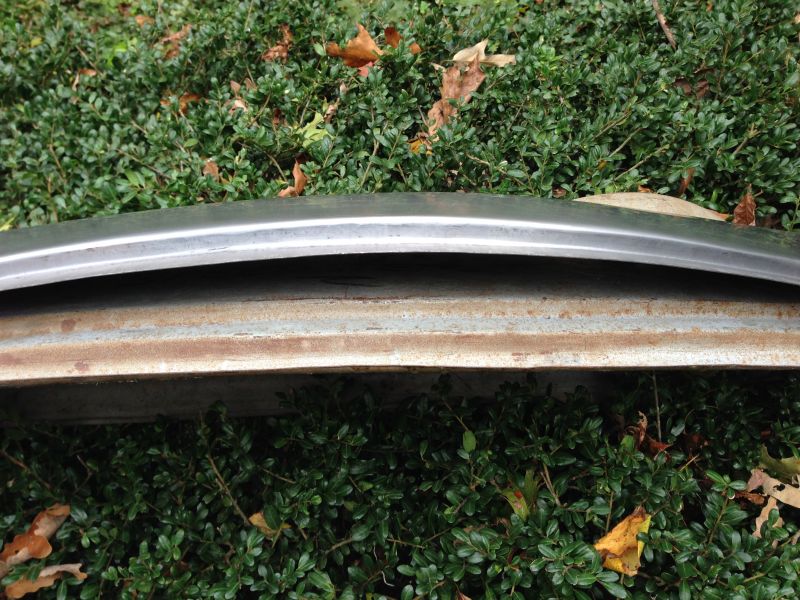

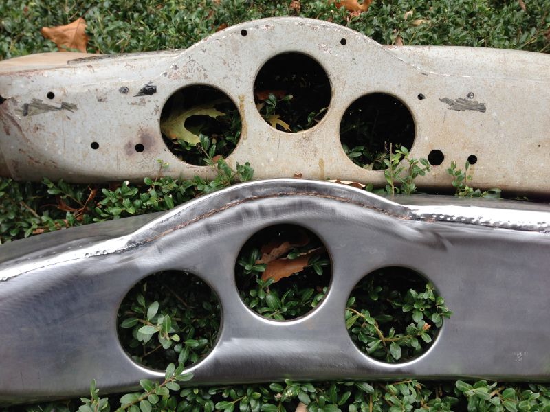

                              • Justin, these are the images we spoke about.
                                New Old Stock vs repro.
