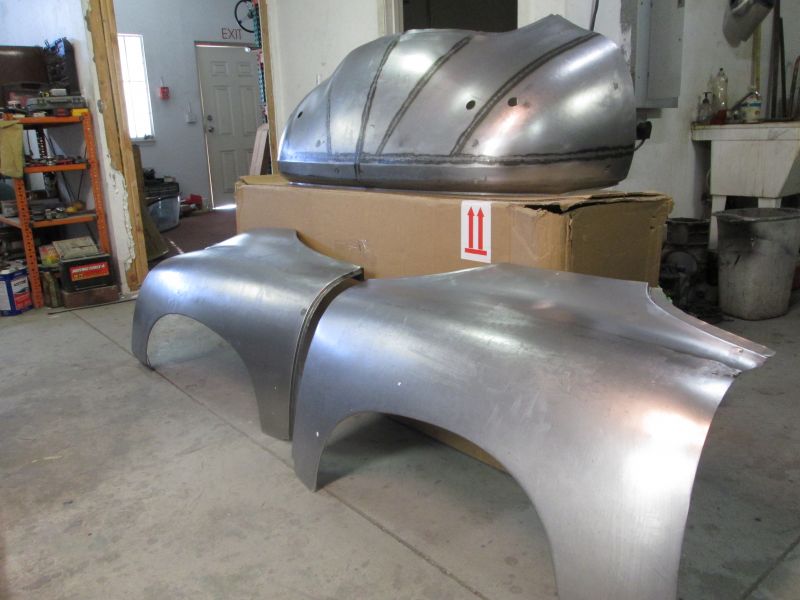

        New rear panels here!
        Trevor was nice enough to get these out to me before the years end so I could keep going on this project.

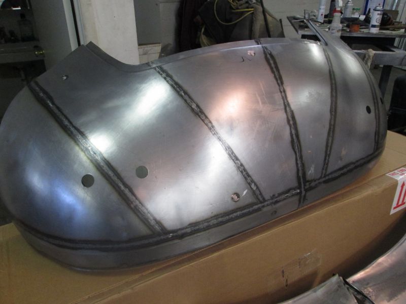

        In my confirmation email to Trevor I told him how much I appreciated all the time and effort that went into just welding these panels together. Several feet worth of welding just in this tail section alone.
        Another long run here.

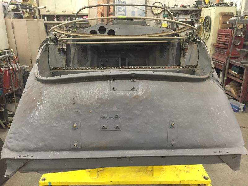

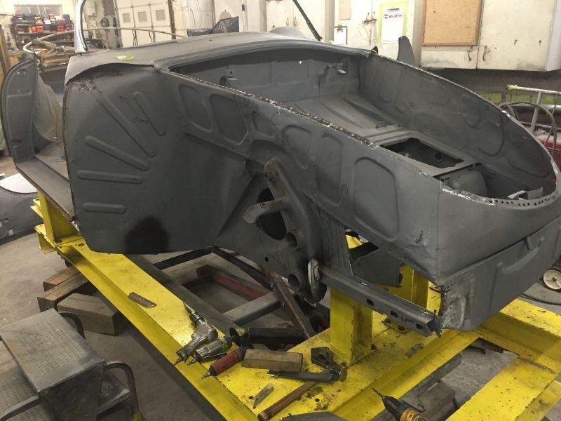

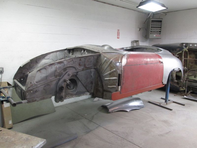

            • I guess I am a way behind. I have left messages for Trevor to make another Speedster as he claims he can in one of his ads and I will add the serial number...no, really, just to buy "all the rear and front end parts I can't make myself."
              Not much rust, but a racing roll, a rear hard hit and another hard hit on an already replaced nose. But it's a Speedster.
              Deconstruct, assess the damage, measure well everywhere and tack back together from the doors and lids front and rear and hope eventually Trevor will call back.
              Justin, you will likely cross the finish line first...and happy New Year you guys! I will be having a nice dinner with friends in a nice waterfront hotel where we all have rooms to sleep in after watching the city's fireworks at midnight after toasting (many times) one of my wife's friends who has a New Years birthday...turning 70, a major milestone!

                        I don't think I'll beat you to the finish line Bruce, once you have the parts in hand your crew will make up ground very quickly. Wow, I didn't realize you had cut the firewall and upper substructer out. Too bent up from old race damage I take it. I sure could have used a detailed shot of the substructure under the cowl but its now apparent you didn't have one to show. You're really brining that old warhorse back nicely though. Much the same way you did with your old racer.

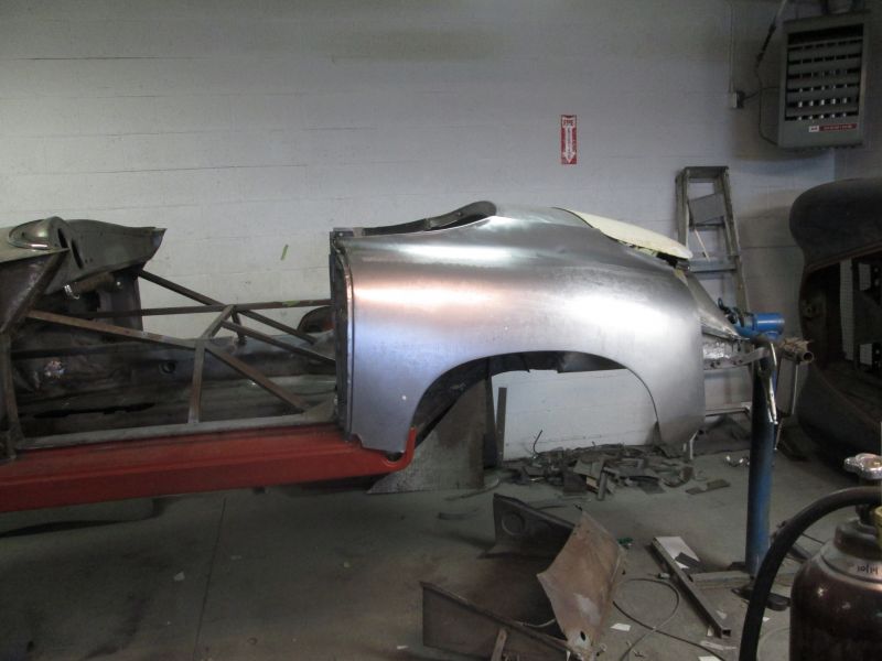

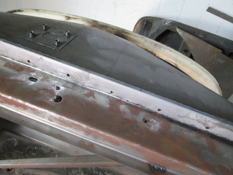

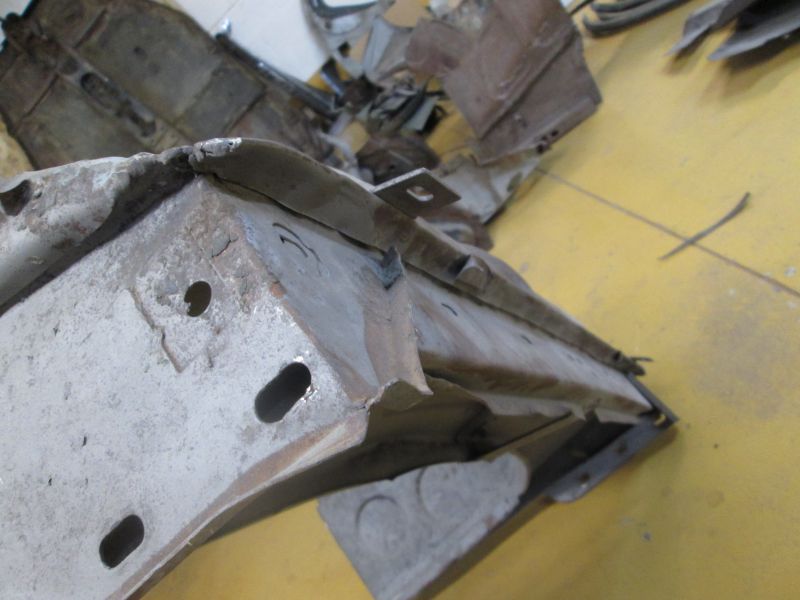

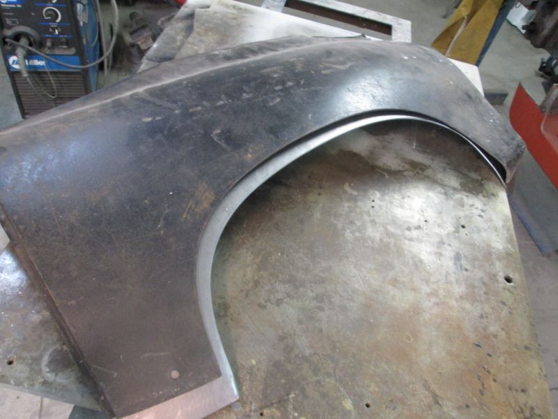

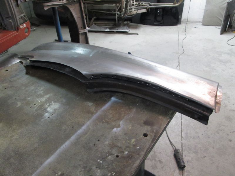

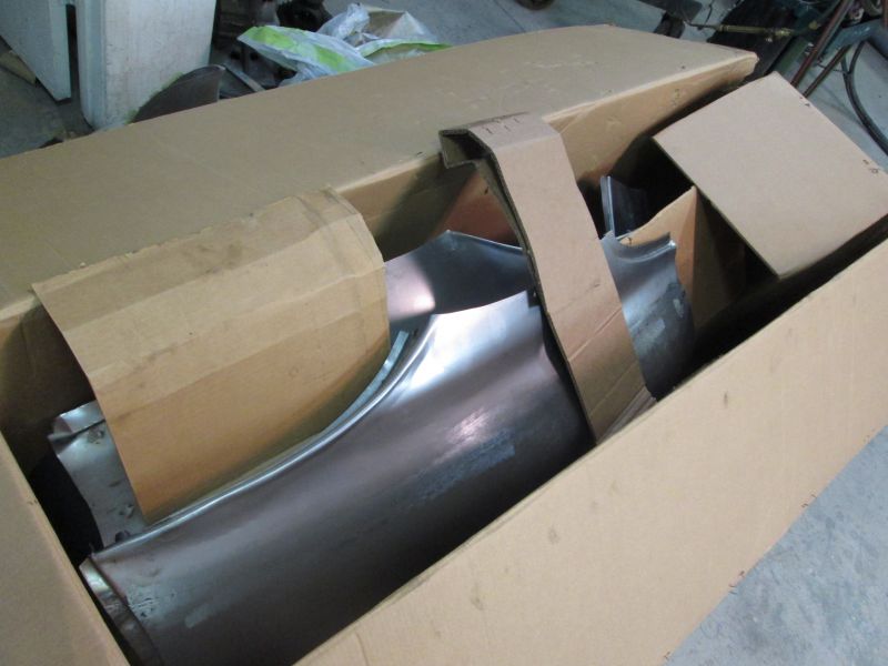

                            12/31/15
                            Last entry for 2015, I can hardly believe it. If all goes well I'm hoping to have this conversion completed in steel by summer of this new year. If all goes well mind you but it usually doesn't.
                            A nasty streak of optimism I guess.

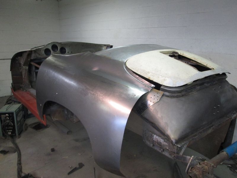

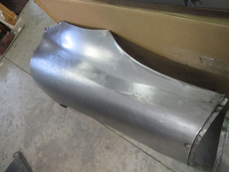

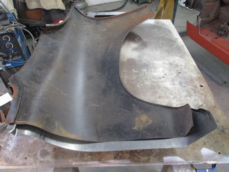

                            Just a quick direct comparison with an original Speedster fender. About as close as I could hope for.

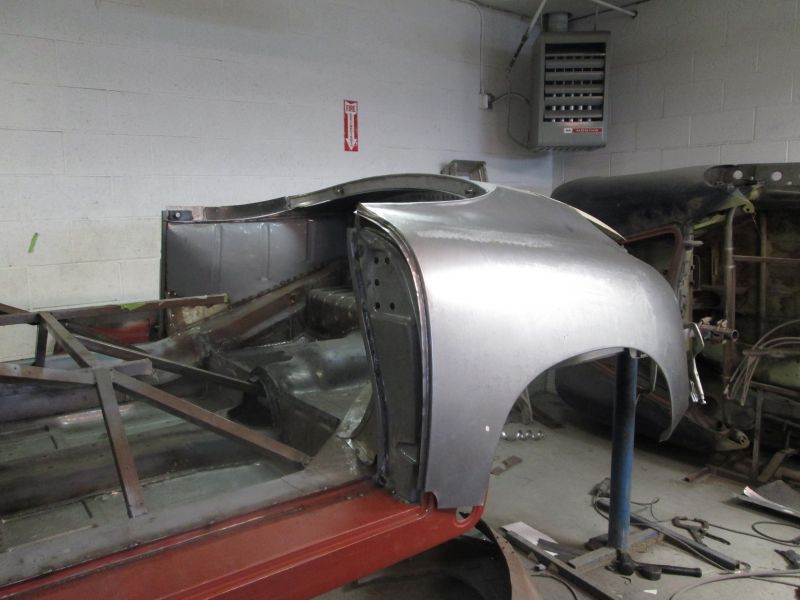

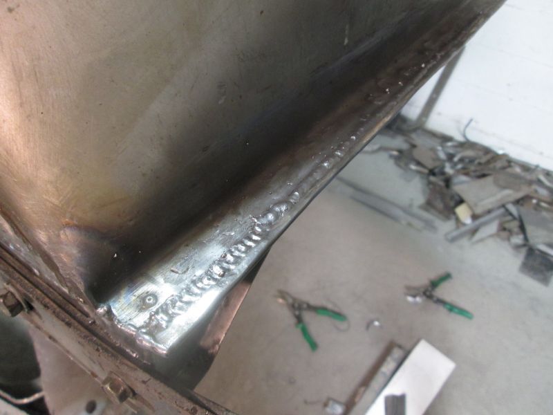

                            Upper openings and flanges line up pretty well.

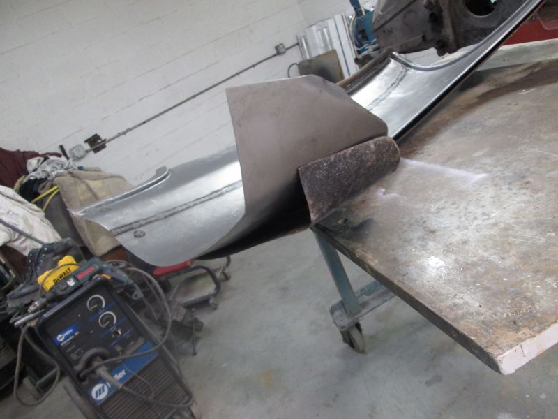

                            A bit more excesses to work with on this lower corner here. Better to have too much than not enough...

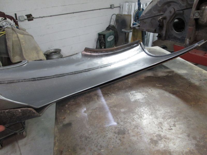

                            General contour and shape also within margin

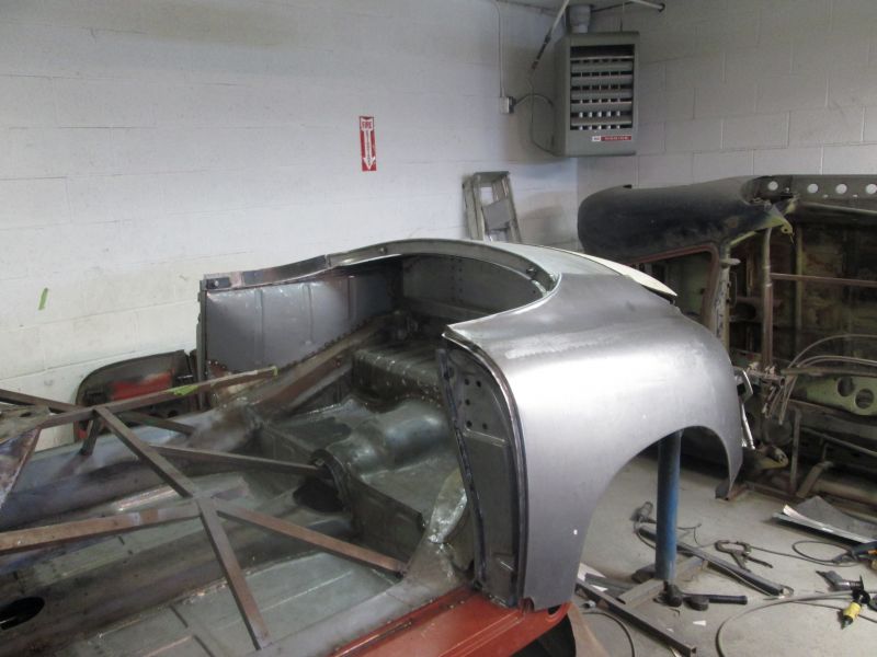

                            Wheel openings also runs very consistent. The upper flange would not allow for perfect alignment of the two parts but I would guestimate height to vary only by about an 1/8 of an inch or so.
                            Door remounted to begin locating and fitting this fender in earnest.
                            More tomorrow.
                            Thanks for looking! Justin
