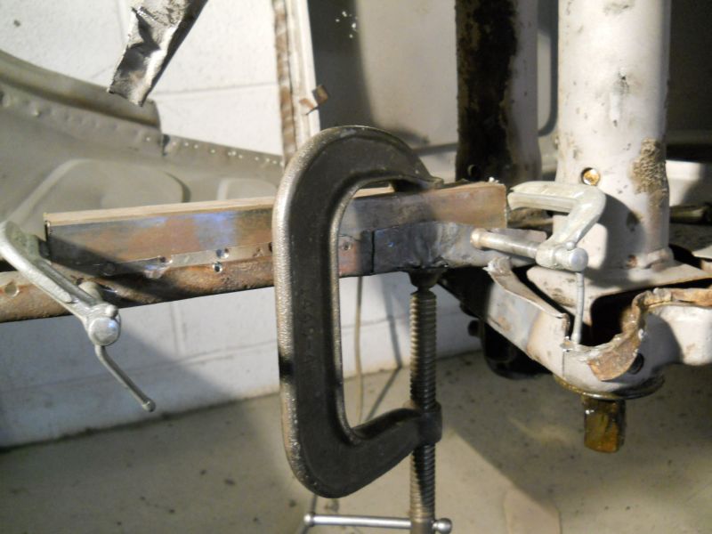

    Clamped some heavy bar stock to the outside to act as guide and anvil to get that last little curve there relaxed.

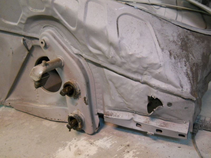

      Just a quick update: 3/13/13

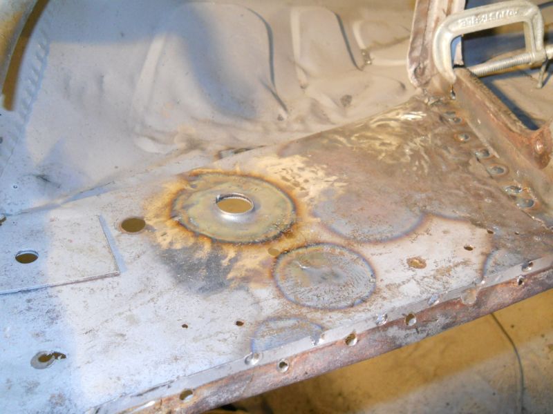

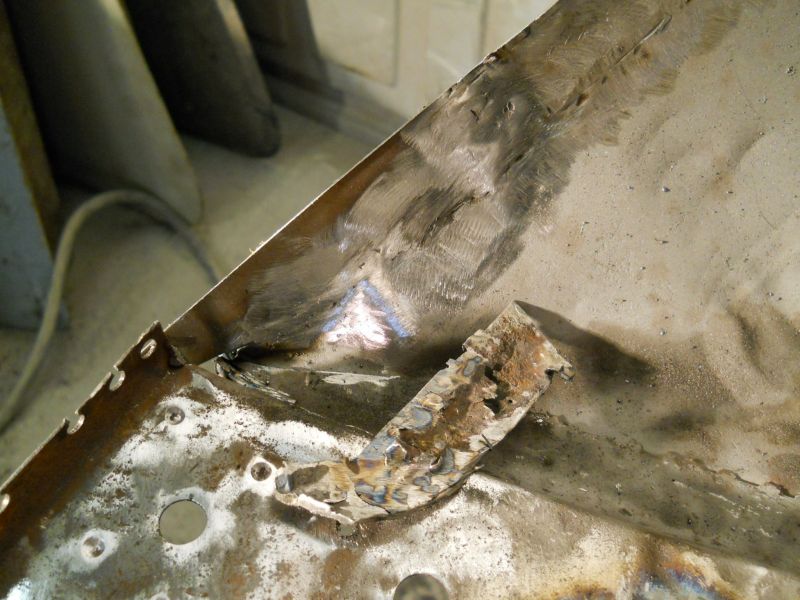

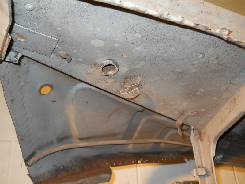

      With the old collision damage settled I moved onto this ripped out hole where the headlight conduit once mounted. Installed a patch along with repairing the tears.

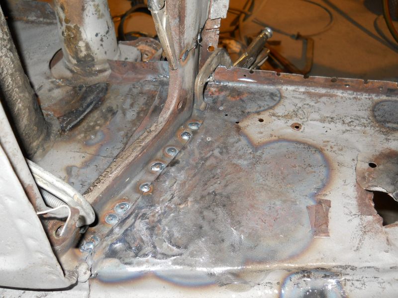

      Drilled the new hole to size and "boinked" it on the inward side to seam weld it to the new tube opening as originally.

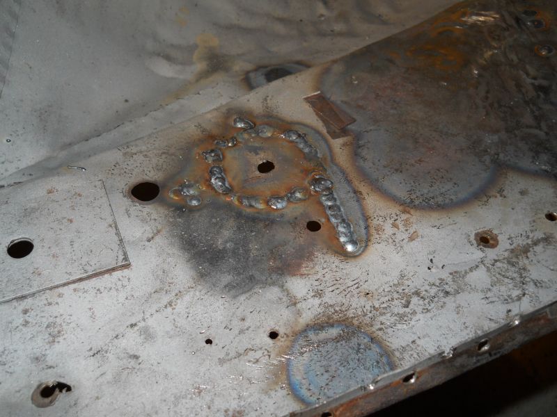

      here is the other side and how the factory joined them. Will be drilling out more spot-welds tomorrow in prep for the new floor and forward walls. FUN! Thanks for reading this! Justin

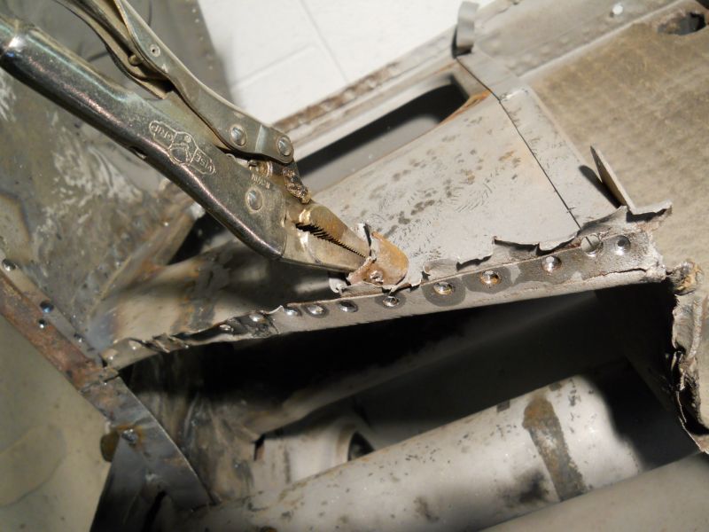

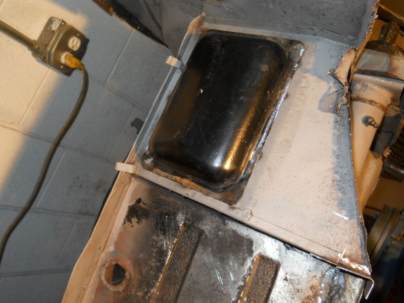

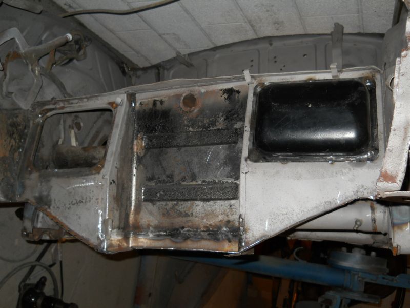

            3/23/13

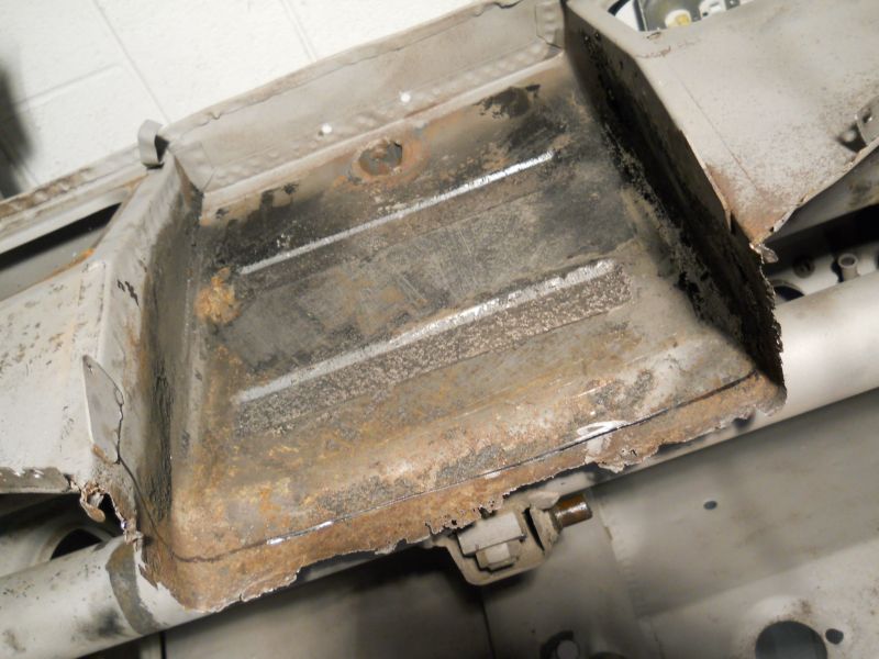

            Been sick with a cold for that last week so today was my first real day back in the shop. Spent this afternoon continuing on with my prep for the new battery box sheet metal.
            removed whats left of the original floor along the flange joint. the very teadious task of drilling spot-welds.

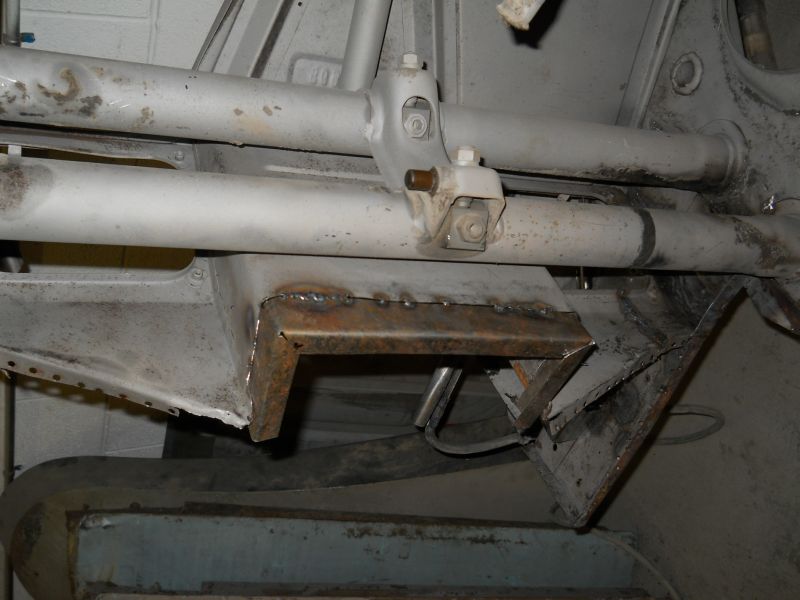

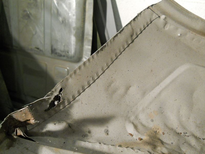

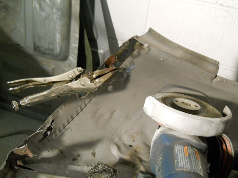

            It would be suicide to drill out all of these to get the last of front closing wall off.
            I take my grinder and make whats left razor thin so I can peel it off like opening a can of Sardines.

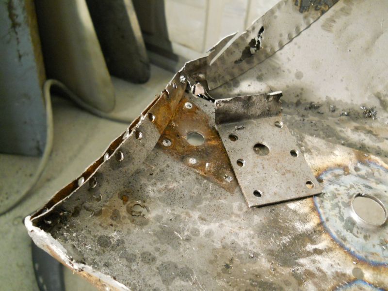

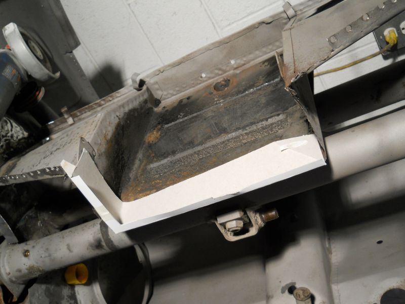

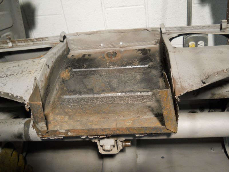

            Also started making my paper template to repair the flange joint on the rear bulkhead wall.
            Exact same repair I did on my coupe several years ago.(above) Thanks for reading this! Justin

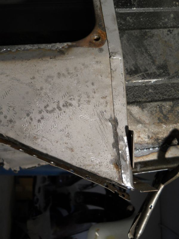

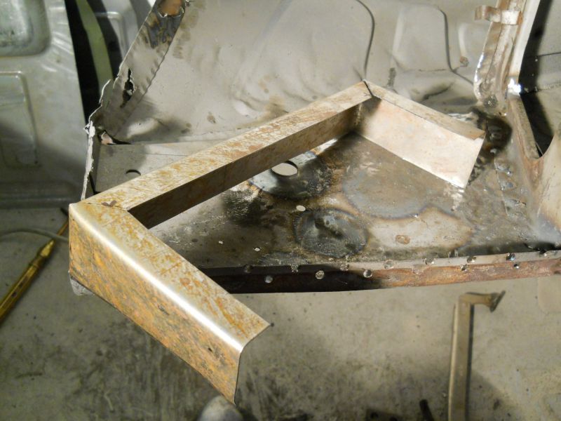

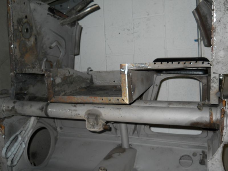

                    3/24/13

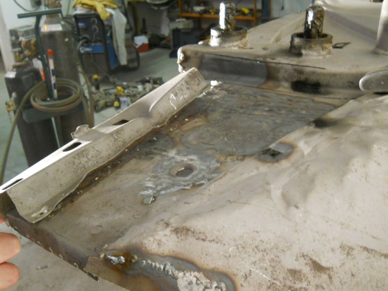

                    Went from paper to steel on the new flange.
                    New repair flange
                    Quick mock-up to decide how far up the wall I'm going to go. Want to get past all the pitted stuff because it just blows through as you try to weld to it.
                    Making the cut here.
                    Should have it tacked in tomorrow. Thanks for reading this! Justin

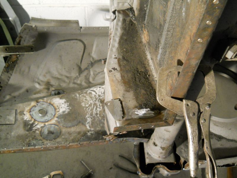

                    • #40

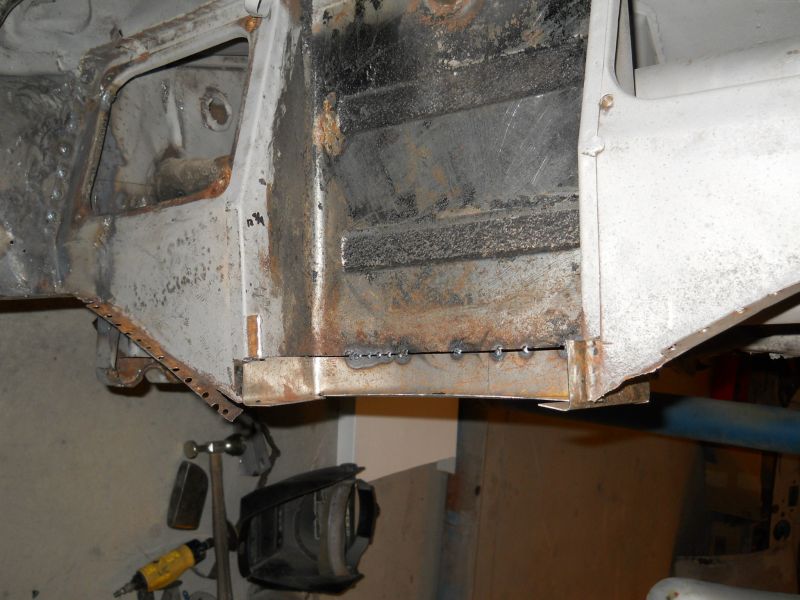

                      4/1/13
                      Lower center relief repair flange almost complete.

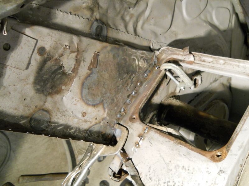

                      Slowly tacking it in. This relief wall was also bent and deformed a bit too from the old accident. It quickly made itself known once I started fitting in this new piece.
                      Just like with my coupe before the holding tangs for the battery cover had to be removed to get a clean job out of it.
                      Forward section of this repair fully welded and dressed with holding tab remounted. This tab crosses the weld joint and makes for a nice reinforcement.
                      Repair flange folded around the corner and is left raw to continue the line of the upper original section.
                      Continuing on around and to the other side tomorrow. Thanks for stopping by! Justin

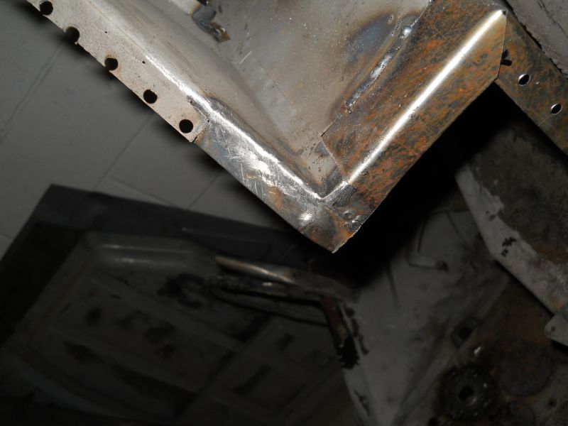

                          Rear bulkhead wall repairs just about done. 4/4/13
                          Keeping with our T1 themed build I prepped a new access cover to plug weld on permanently like the early A's were. The Doc's a real stickler for details and wants it as authentic as possible.
                          Plug-welded here. Will follow it up with my panel welder for a more correct finish.
                          Lower flange repair is complete on this rear wall.
                          The flange joint/seam wraps partially around the bottom just like it was done originally. Will spot-weld and gas weld the joints were necessary once the new floor is in.

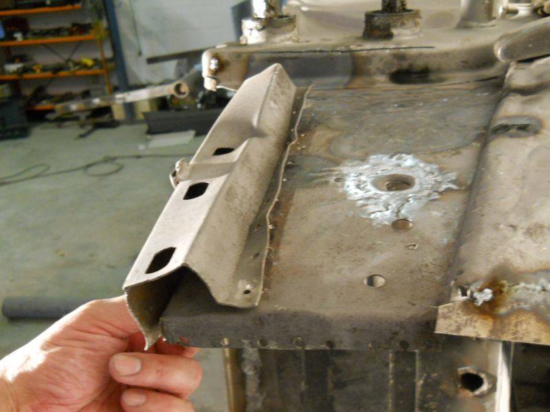

                          Just about ready to move onto the foward portion of the sides to remove whats left of the original front closing panels. Alot of time required for prep-work before the new panels can go in. Thanks for reading this! Justin
                          • #43
                            4/7/13
                            Installing the new panels goes relatively quick however it is the preperation of the "parent" panels that really eats up the time.

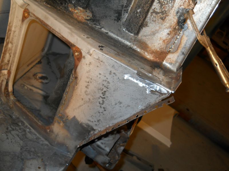

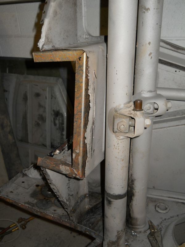

                            Needed to remove that remnant strip of old rusted out front closing wall. As you can see the upper portion of it is sandwiched under the reinforcement plate for the overrider strut brace. To do a proper clean job more welds will have to be drilled and this plate too will have to come off. This one example as to why these cars are such a pain to repair. Alot of two steps back to move one forward..
                            now that the plate is out of the way the rest of that flange is now free. Notice I still need to clean the upper flange and repair a rusted out section of it.

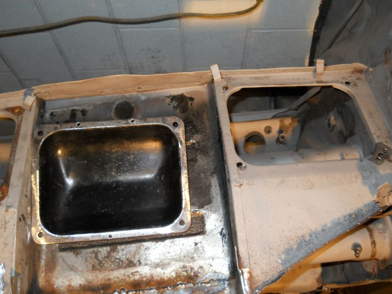

                            • #44
                              Flipped the carcus back over to address the other side.

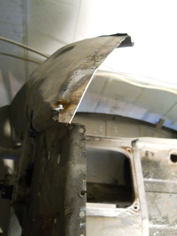

                              Note the stretched dome shape...

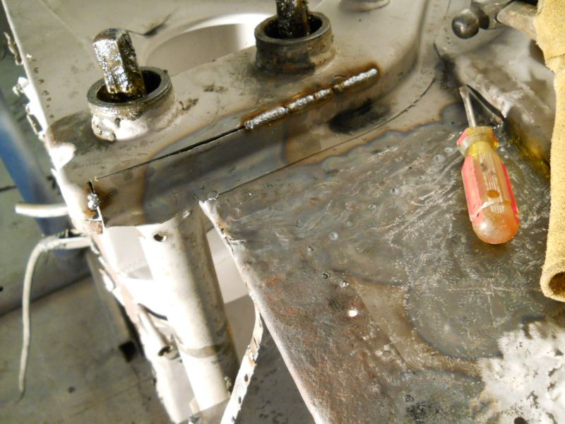

                              straightening out that old bracket next but also tying up alot of loose ends like this relief cut I had to make in the horn. Thanks for stopping by! Justin
                              • #45
                                Justin,
                                Just think 25 years ago and no digital camera to take quickly a before and after photo of an area that needed to be removed and repaired. You are correct a week goes by and you forget what went where! I remember so well some problems like that when I was doing mine.
                                I like the way you rescue so much of thbe panels. Really nice and not easy to do. I do have a question: The relief cut in the horn you show with the small infil plate welded in. The horn looked in okay condition in a previous picture was it slightly kinked?
