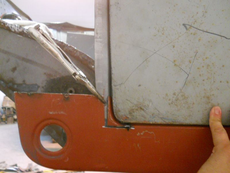

      Begin right striker post prep.

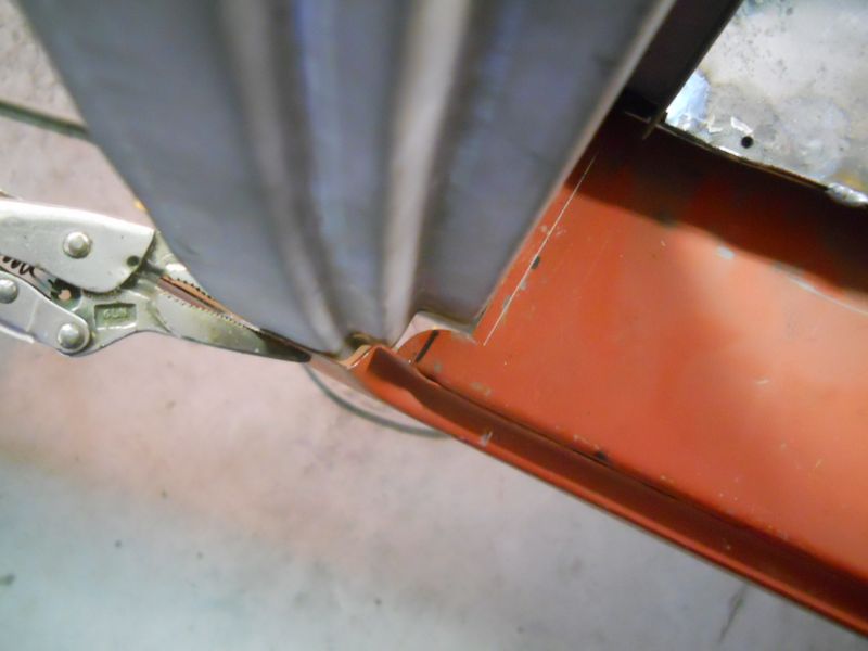

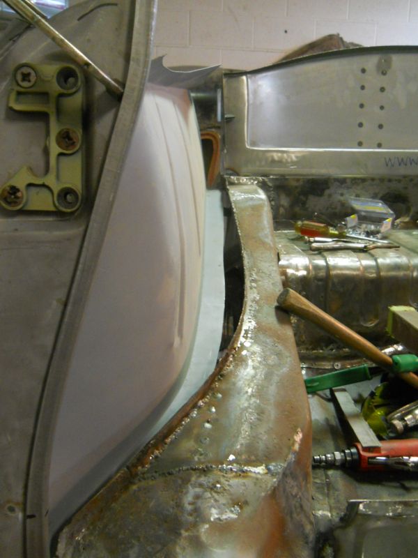

      Began the session by removing the remains of the original closing panel flange.

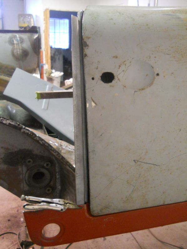

      old flange removed, car rolled back over and door mounted to begin locating the new striker post.
      Adjusting striker to door for the closest alignment with the post profile.
      The usual series of trimming and repeated trial fittings began as the part slowly moved into closer position.
      Once in basic position it was clear that bits of the threshold profile will need trimming to close up those gaps.
      Big gap with the bottom edge of the door is great confirmation that its on the right track.
      It was a start. More tomorrow. Thanks for looking! Justin

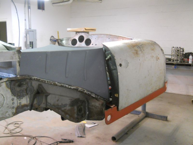

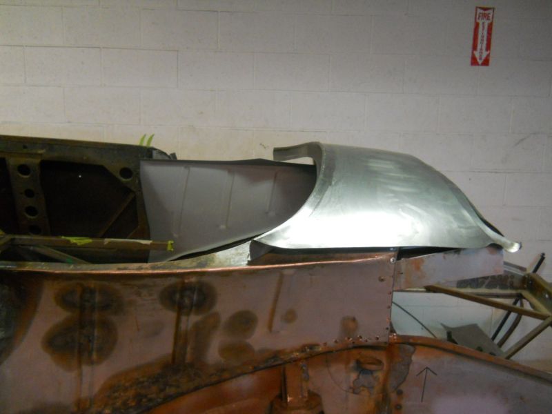

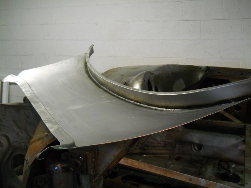

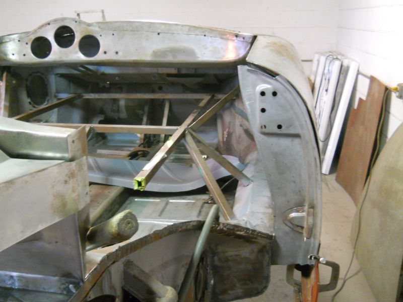

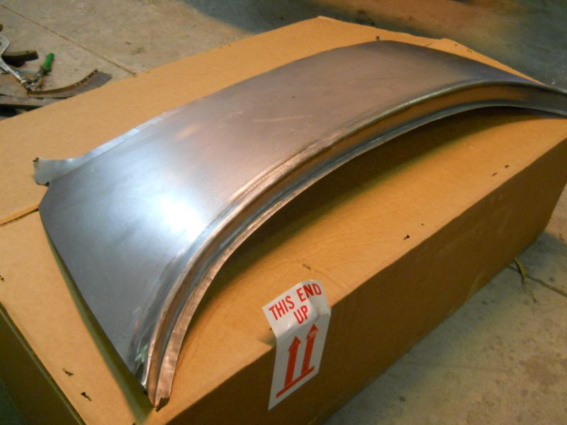

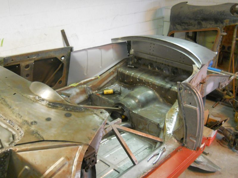

                New rear speedster cowl section arrives from Trevor's Hammerworks.
                We'll be going with Trevor Marshall panels from here on in and the first item from our new order arrived last Friday.
                Nothing more beautiful than a fresh curved piece of metal.
                Profile looks promising.

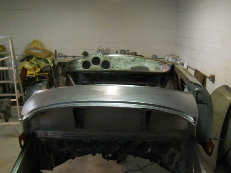

                Initial rough fitment.
                Looking more like a Speedster all the time.
                The profile looks pretty good but I'll be comparing it to the reference car's cowl, an original top frame base bow and the decklid we're using to see how much tweaking it needs if any.

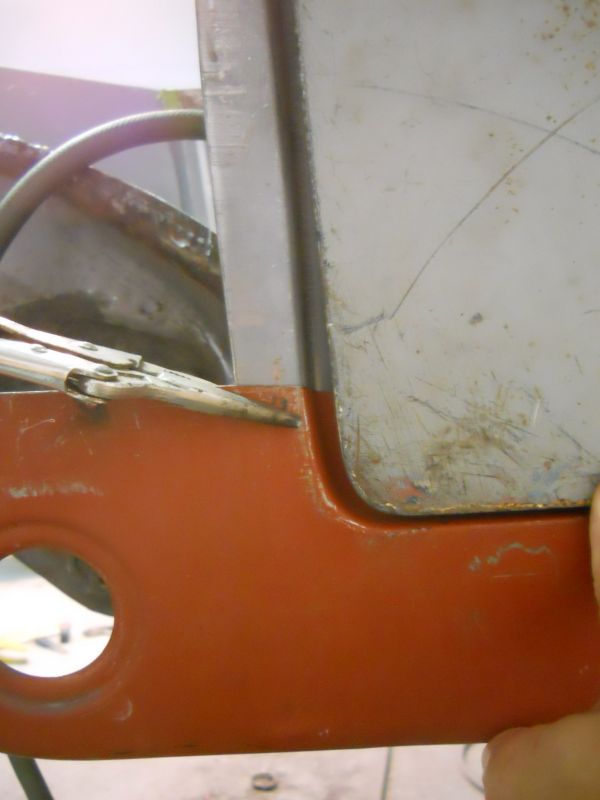

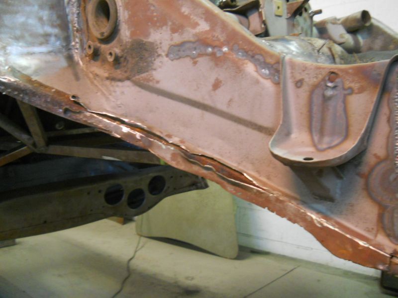

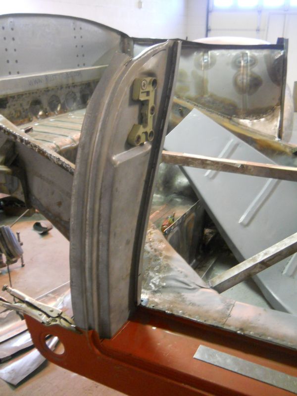

                    Right striker finishing prep and mounting.

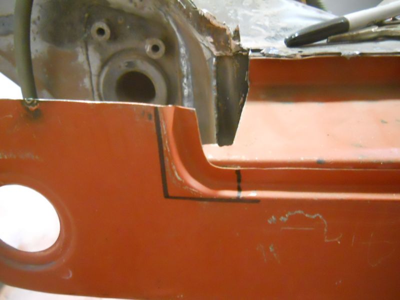

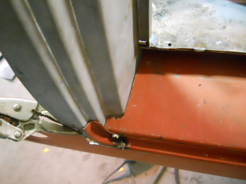

                    The striker and rocker were beginning to finally fit together but I decided before going any further that I needed to close this corner and eventual vertical gap up just a touch more to reduce the need for lead or any other filler.
                    cut line established here so I could move this corner forward just a touch more.
                    Liking this new initial gap much better which we need far less filler to create the final gap line once all is said and done.
                    Corner tacked and set screwed into its new position. Basic striker fitment complete.
                    Striker distance is just a touch tight here but its about ready for its first tack-weld.

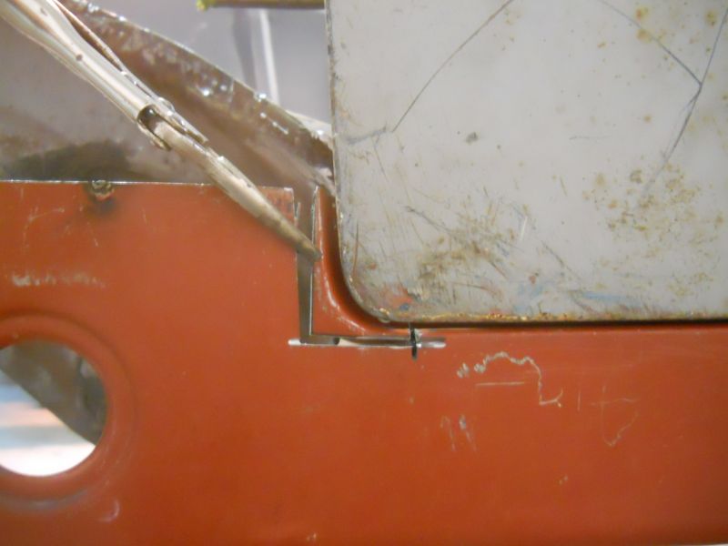

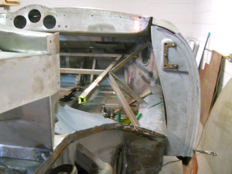

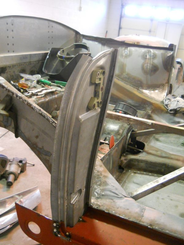

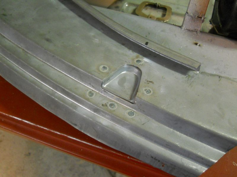

                    BUT, before that could happen I needed to get the door wedge receiver housing located and mounted.
                    After some careful cutting and filing to the opening the new housing was installed. Now the striker is ready to mount.
                    Post in best adjusted position and ready for its first weld.
                    Post tacked and in for good.

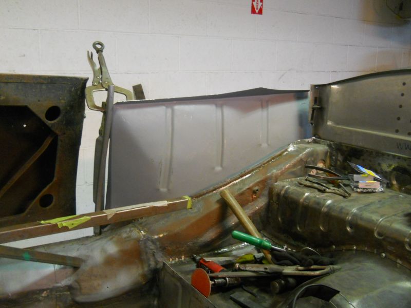

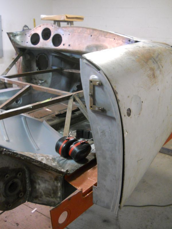

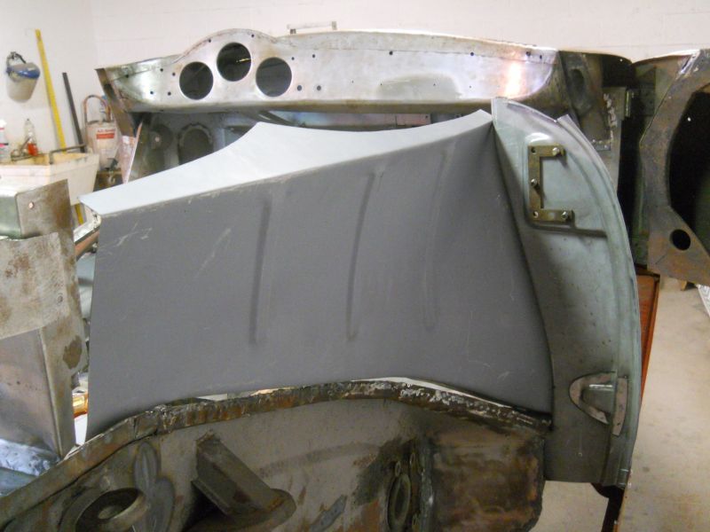

                    With the post set and established the closing wall can now begin going in.
                    This wall was shaped more to the frame profile than the other side but as you can see its a bit flat overall so it too will need some manipulating.
                    Fitment process begins next. Thanks for stopping by!

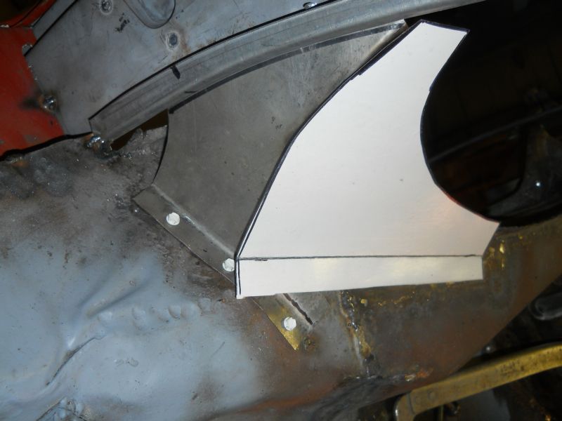

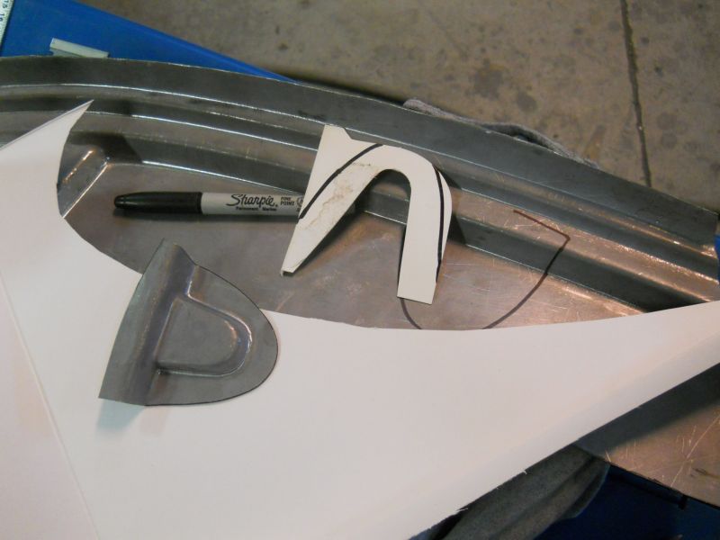

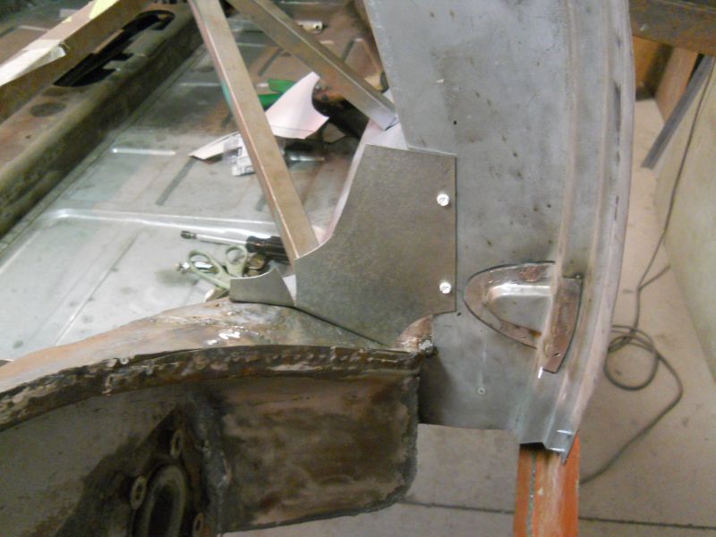

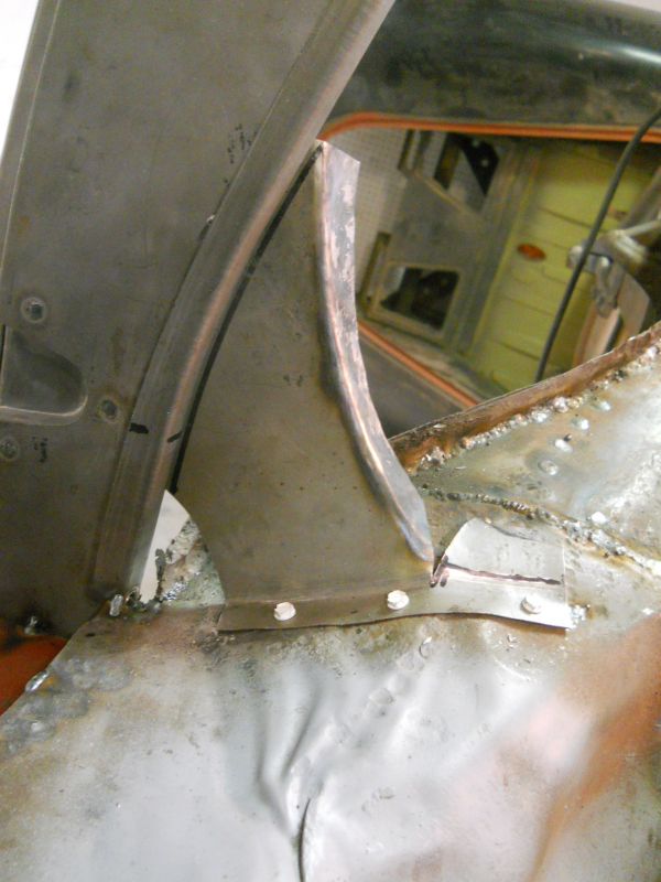

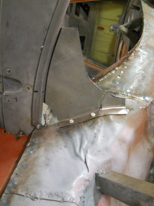

                                Striker Post gusset

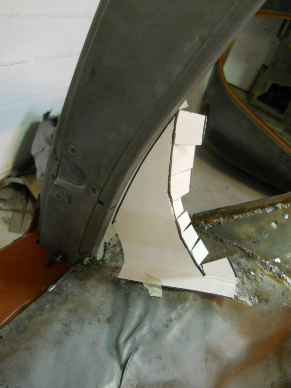

                                Final template shape and ready for metal.
                                Initial set screwed position of new piece.

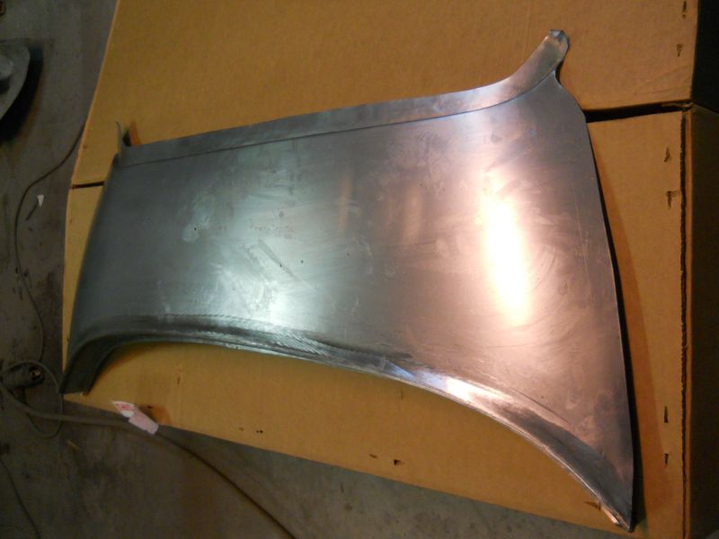

                                Now ready to add the last arching profile flange for the gusset cap.
                                After a little torch heat for easier stretching the flange and final shape to this part was in.
                                Ready to make the cap tomorrow. Thanks for stopping by!
