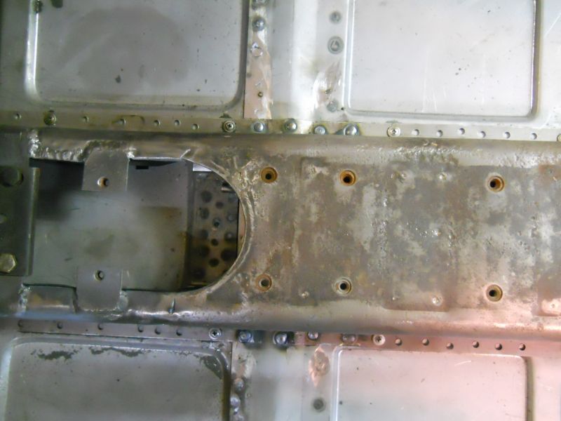

    I worry about "survivor cars"....really nice 356s that come in with easy answers to questions like "what's wrong in this picture?"
    • Bruce
      I have even started a log of taking measurements for John
      No challenge in buy that tunnel from resto design, right Justin?
      Nothing wrong with that picture: just the new, improved support for the rocker.

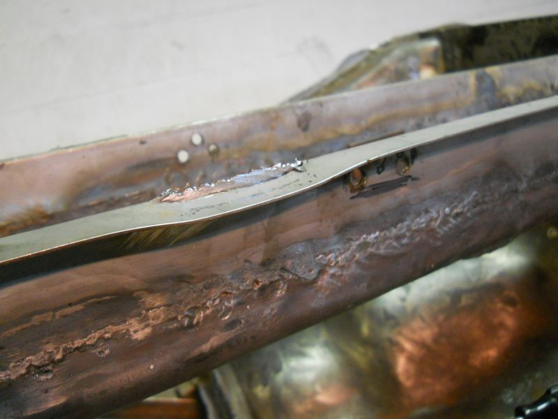

          • Hey Bruce,
            Yikes, no way, this project was not a bid job. I would have absolutely refused to do it had the Doc insisted on a set budget. This is strictly by the hour plus whatever parts I need to finish it correctly so I can tell you to the minute how many hours I've put in since the day it showed up at my door or I can have Phil tell you. I have no where near your experience and expertise but with my limited amount of exposure with these cars I know that there is always the sleeping dog of deep hidden rust and extra work lying in wait to bite you right on the ass. (this frame of course did not disappoint) All of which you simply can never account for until your waist high in it. Then to have added stressor of my hourly worth nose diving because I'm now locked into a set price for labor and I just discovered more of it I have to do to complete the job; Its too depressing to even think about and quite un-motivating to continue moving forward as well. I've already experienced that with a speedster several years ago and won't make the same mistake twice. The rusted out conduits are a perfect example of this, I never would have dreamed they'd be shot. But thanks to time, the laws of thermal dynamics and the price of these cars going up the "new Donor grade" 356's are more rotted out then ever before. If this was a set budget job I could have never foreseen this trouble and those old conduits would have most likely stayed in there too. This goes back at your earlier statement of the best job for the time and money and what can be seen and not be seen. Being in a locked in budget predicament I would be well underwater by now and of course would be looking for my best way out to cut corners instead of concentrating on how to best to repair it. I would have closed that tunnel up with them, omitted the photos of the damage on this thread and moved on. They'd of worked and by the time the worms of grease would have made themselves known I'd probably be 5-10 years removed by then and could claim "oh they weren't leaking back then"... I don't want to be that guy or be forced into that position so this is why I am strictly by the hour until its finished or he pulls the plug on the project which he is always free to do at anytime. Also if I spend an hour working on someone else's project that's an hour I didn't spend working on my car. By the same token I'm not milking the poor guy either and am all for saving time and grunt-work when I can. On several occasions I have weighed the cost of replacement versus my time to fix it. The tunnel is a perfect example RD wants 1025.00 for a new tunnel, the time it took me to re-flange and convert the original to a T1 still put us at well over 300.00 in savings over buying their new one. The rear frame section runners and cross member a while back was just the opposite. It was far cheaper to have Steve Hogue knock out those new panels than to pay me to clean all the mount flanges, fix the rust and old accident damage to the left side. A far cleaner end result as well as saving money.
            This flange detail you referred to literally took 10 minutes to cut shape and reweld.

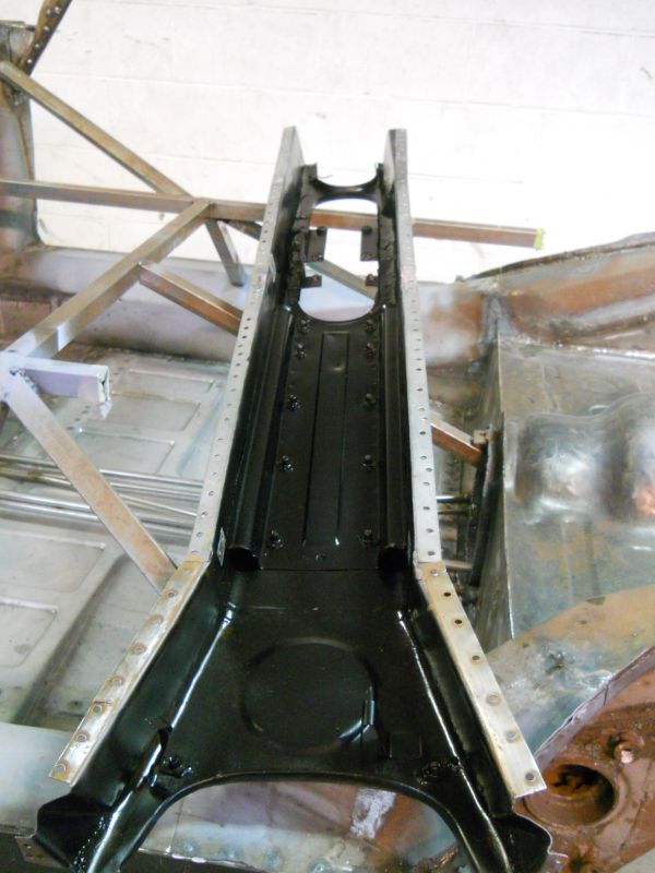

                  • 8/24/14
                    Tunnel finally mounted in the chassis for good!
                    Tied up the last of the prepwork including hole punching the mount flanges and getting the underside cleaned and in a good coated of epoxy sealer.
                    Went ahead and shot some satin black over it for the finished look.
                    Tunnel mounted for the final time. I can hardly believe it after what it took to get here but we finally arrived.
                    Profile reliefs to the mount flange I added earlier is allowing everything to fit together snuggly.
                    Adjusting and squeezing the sides where necessary as the screws are installed. I should be plug-welding by tomorrow. Thanks for looking! Justin

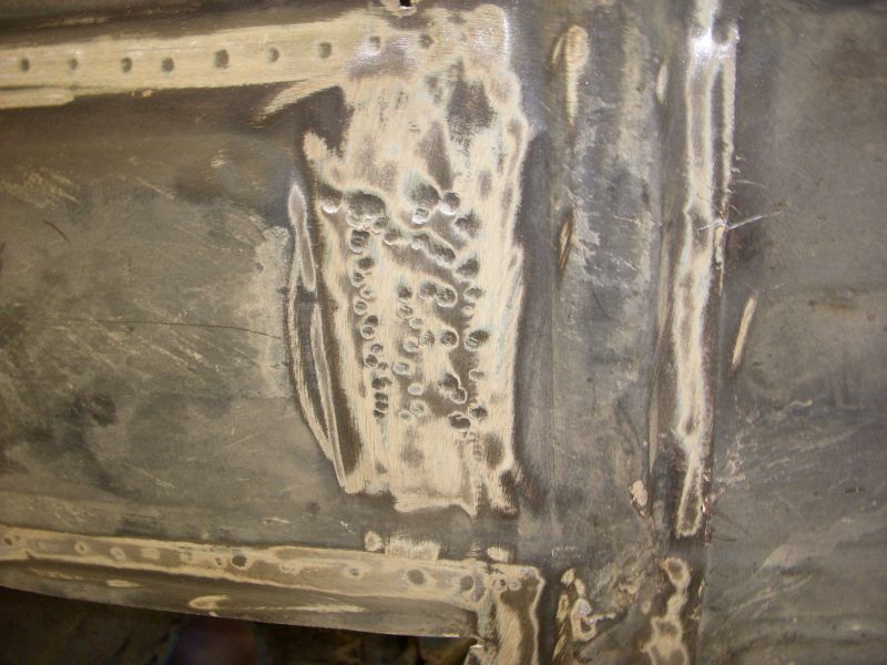

                    • Thanks, Justin...great rap session and for you, a wrap session on the tunnel....(segue back into the thread's origin)

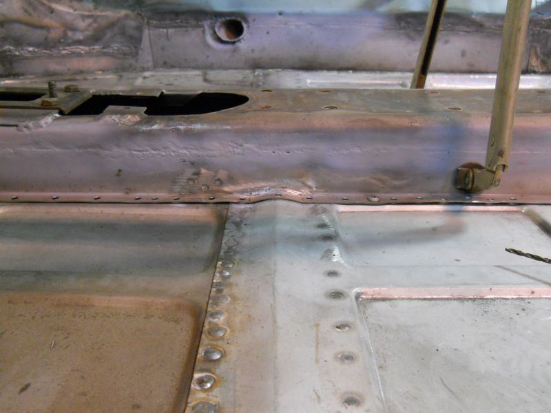

                      For reference, here is a picture of my old Speedster's original interface of tunnel and floor lateral 'hump.'
                      I have seen many 356s where the fitting was not as good as this (or yours) and was not forced into a weldable proximity. On this one, the last spot weld was forced and then the builder stopped and began on the other side. Many original gaps I've seen have been rather spacious at that junction. One of the many "no two alike" areas of a 356.
                      (edit) I'm sorry the glue residue from the carpet I yanked up masks the weld spots and that I have yet to learn how to add circles and arrows to a picture, but the fact the spot welder, by nature, would crush the tubular shape of the lateral front and rear floor overlaps would make this an area to avoid in assembly on the chassis jig and thus in accurate restoration. Just a detail but maybe a nicely finished plug weld (or more) would go unnoticed and make it all stronger.

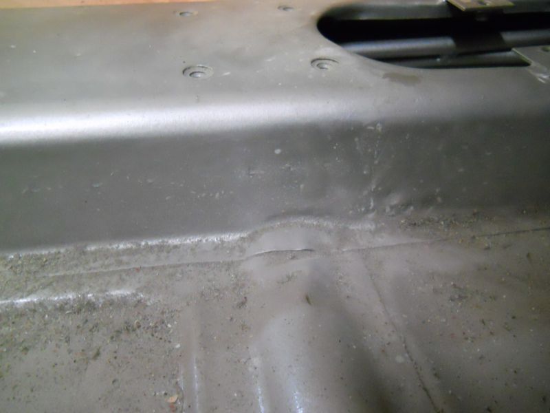

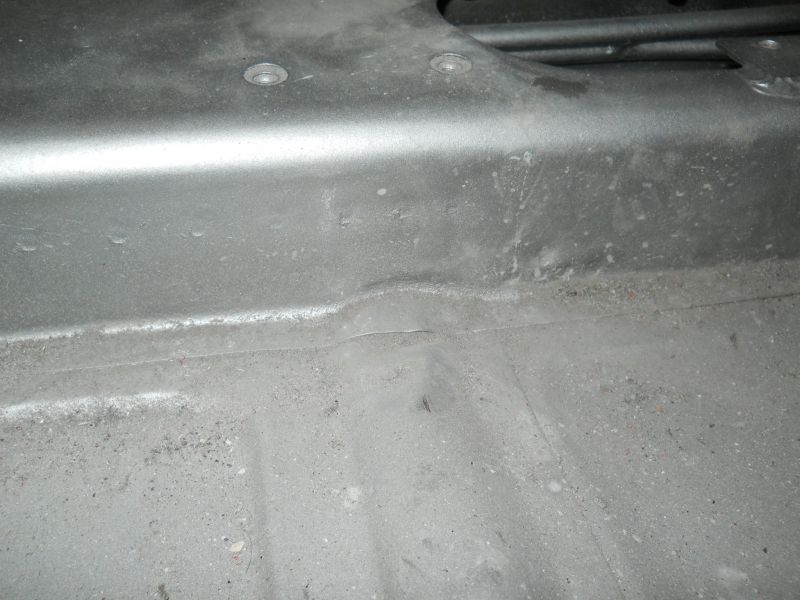

                          Your pic and description of the area sounds identical to my original floor. The embossment is a bit pounded down just as it hits the tunnel flange. The embossment of this new floor is so shallow that one strike of a hammer would about erase it entirely.

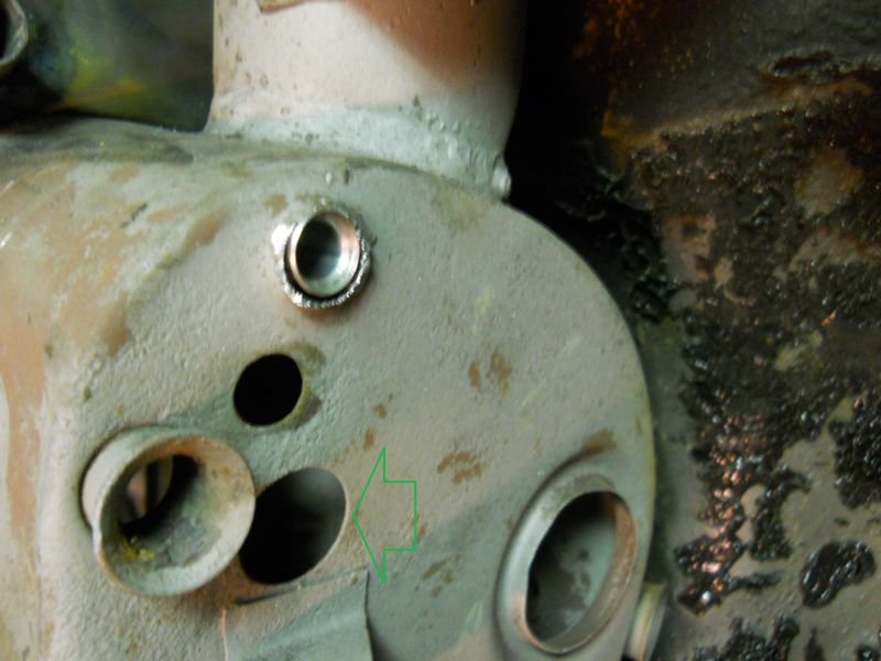

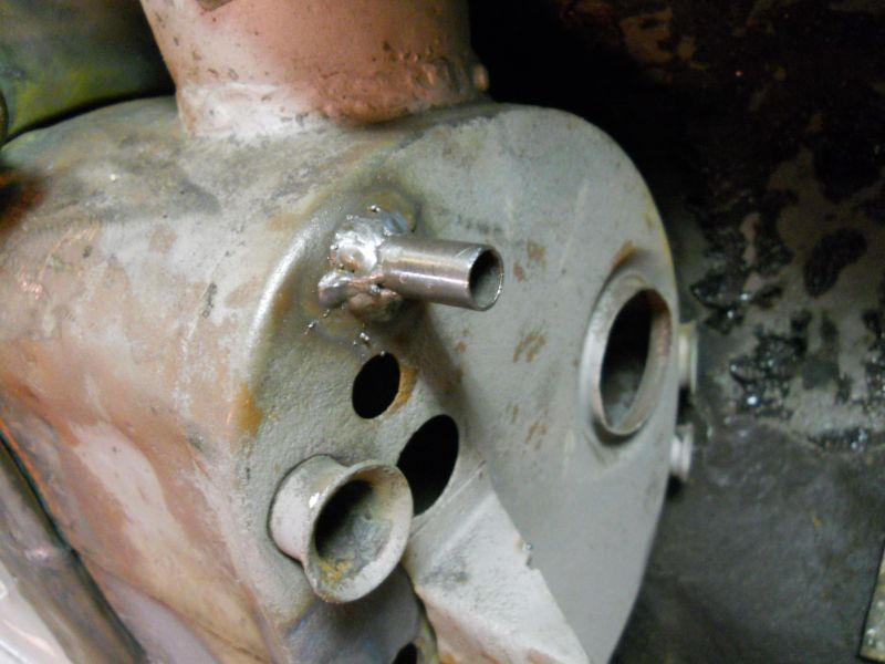

                          Very happy to post that the remaining pluming details around the tunnel bulkhead are complete. The clutch cable tube end was the last one finished today.

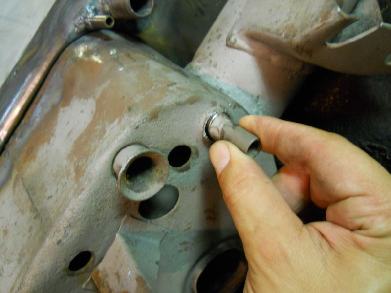

                          The new tubing is a hair larger in outer diameter and the protruding tip of this conduit is the eventual mount that the Bowden tube slips onto. I wanted to make sure there were no fitment issues with it so I thought it best to recycle the original tip.
                          The new tube was cut even with the bulkhead and the end was flared to both ensure it was thoroughly attached to the wall and to offer a smooth transition as the cable is fed in.

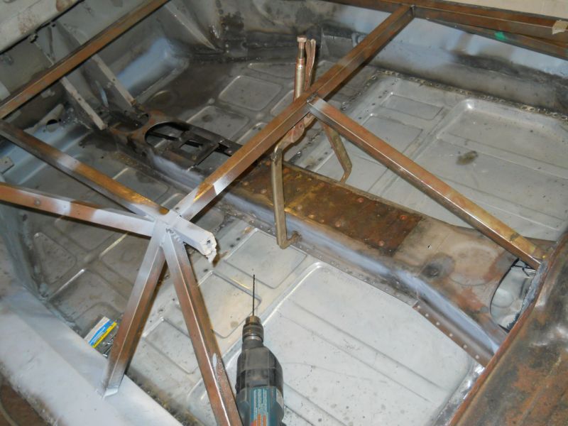

                          After tying up that loose end I finally began welding the tunnel on starting from the center and working outward. Should have the plug welds wrapped up by tomorrow. Thanks for looking! Justin

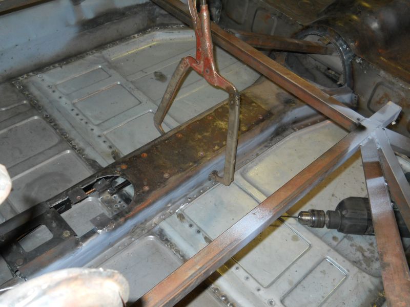

                            Removing that tunnel plate today to remove what's left of an original floor in an A, I counted 46 spotwelds. I guess the workers at Porsche didn't want them to move or be REmoved!
                            This is a sickness, counting spot welds! Before Justin got going on all this, I just knew it was a LOT of spotwelds and a PITA.....
