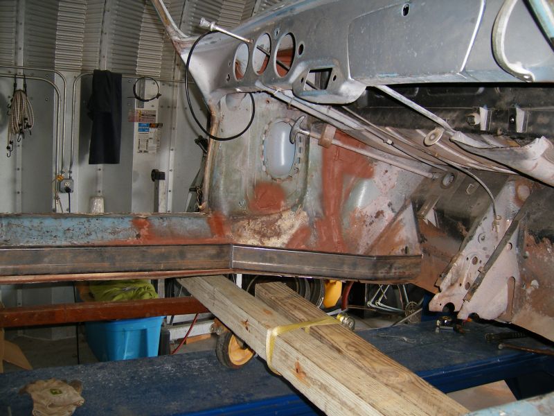

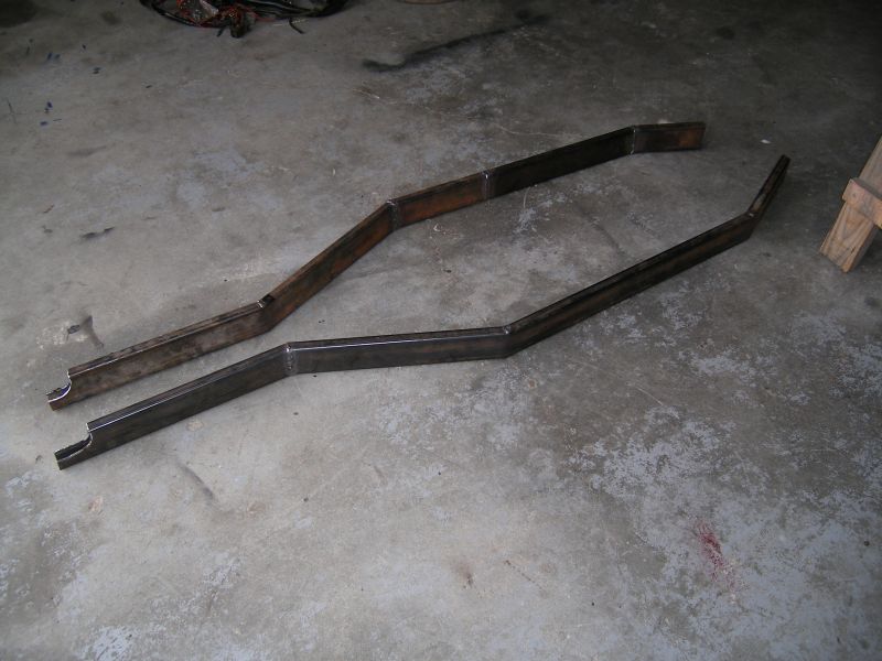

        Got some work in on the car today, finnished up some welding and some grinding. Also got one subframe trimmed and bent to fit against the inner long. I will get the other one bent and both welded up ready to go in tomorrow. PICS asap....

              Justin, I have a JDM EJ20 DOHC coming. A fellow Samba member is now working with me to get a harness/ECU going. Got both of the rails cut/fitted and welded. Going to start putting the pans in tomorrow.

                Nice Brock! What is the HP on that motor? You're sub-frame is off to a great start. Looks very similar to the one we put into that 58 coupe build.

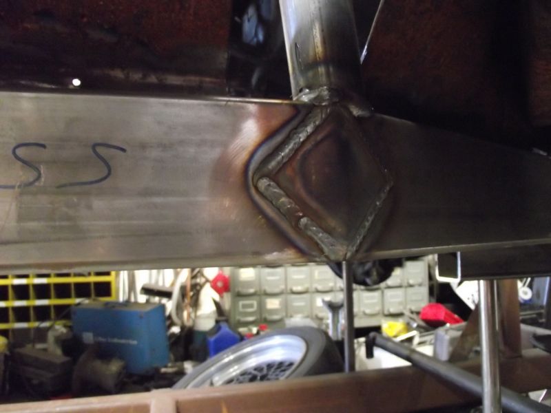

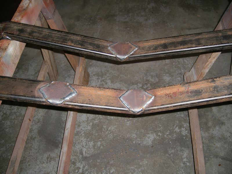

                My buddy Warren also added these gussets across the mitter cut/joints to spread the load out. Maybe something to consider for your frame as well; just throwing it out there..
                Nice work! Keep the pics and updates coming! Justin
                  Thanks ! Hard to get good numbers on the JDM stuff but about 150-160. I was thinking of something like those over the welds. Also have to figure a way to tie it to the rear torsion without haking out the rear panels.

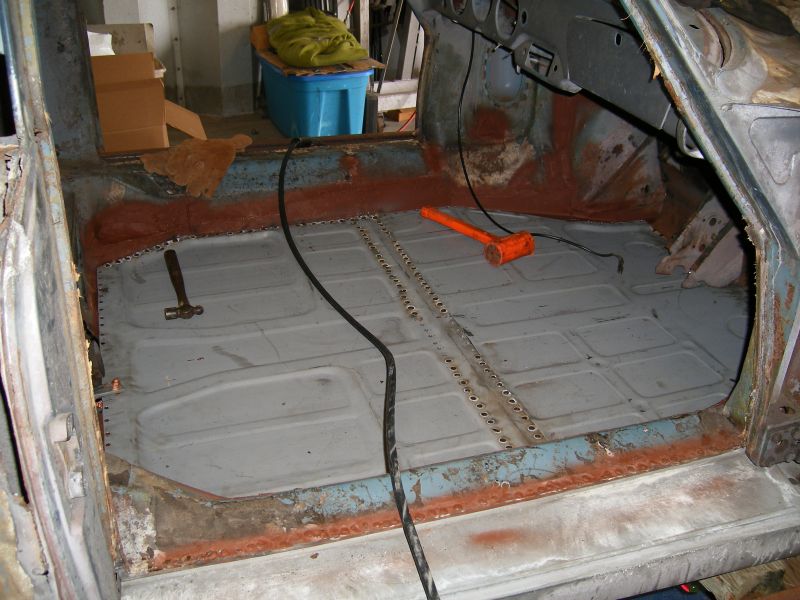

                      Got the pans drilled and almost welded in.....MAN thats a LOT of little holes to drill! My air punch wouldnt pop the hole in the heavier steel.Click image for larger version

                          Nice job on the new floors Brock! I know what you mean, all those required holes for plug-welding large pieces like these pans are a chore! Your sub-frame plans are coming into focus now. Your staying outside the longitudinals with your new frame runners? Looking forward to the next install! Justin

                            Thanks Justin ,Yeah wanted to put them inside the longs but the longs were already done when I got the car.

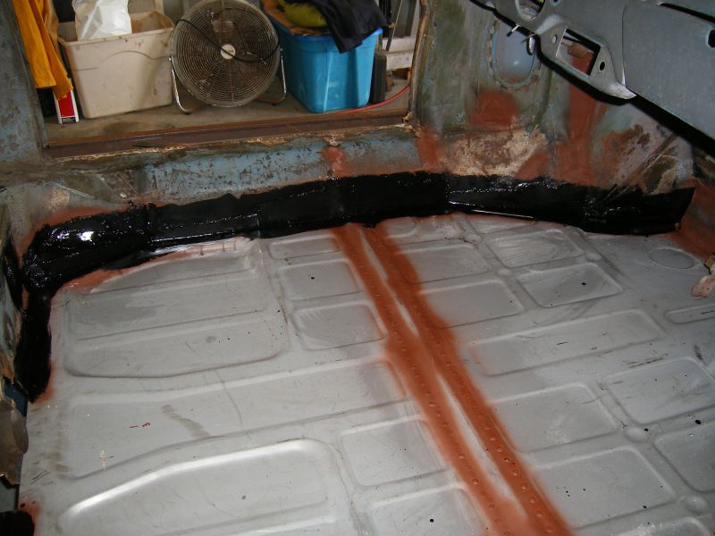

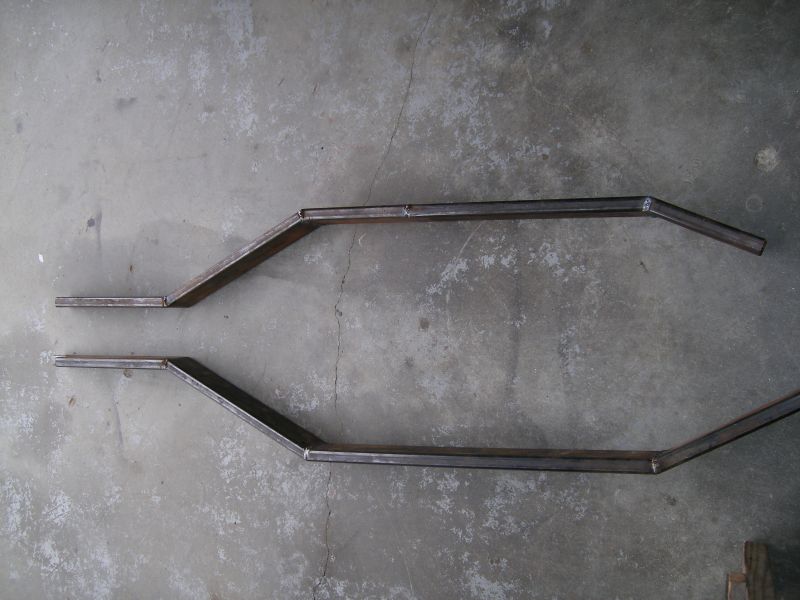

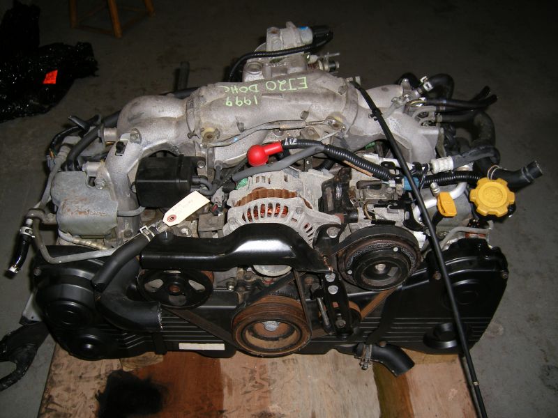

                              Well my engine came in today, looks pretty good. Got the edge of the floors painted. The subframes plated and painted so they can go in asap.
                              Engine adapter and clutch is on the way and I think I will order the trans in the next couple days.

                                Looking good Brock! I see you've got the gussets done as well. Is that POR15 your using? Congrats on getting your engine! Looks killer and really resembles a water-boxer 911 mill with the alternator placement etc. Have you taken some rough measurements? How's the width of it compared to distance of the frame runners? How about length? I would guess that push-rod engine tray/shelf will have to come out. Keep at it! Justin
