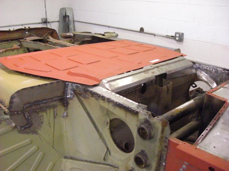

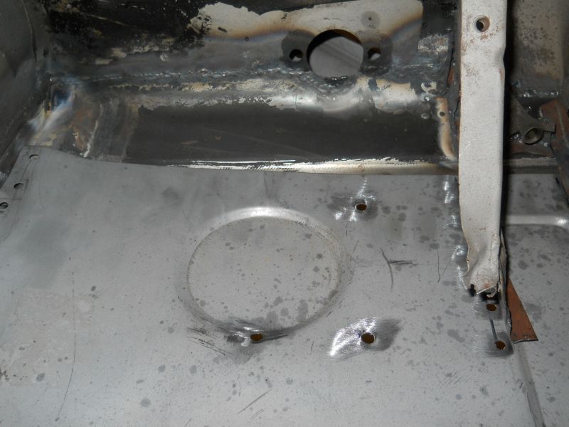

    Nice job spooning that contour in Mark!
    Went through the exact same thing on the coupster project. It seems pretty much standard fare with these floors as the embossment just isn't punched in heavy enough there.
    Simonsen floors by contrast were much more defined as you can see here.
    Keep up the great work!
    • #92

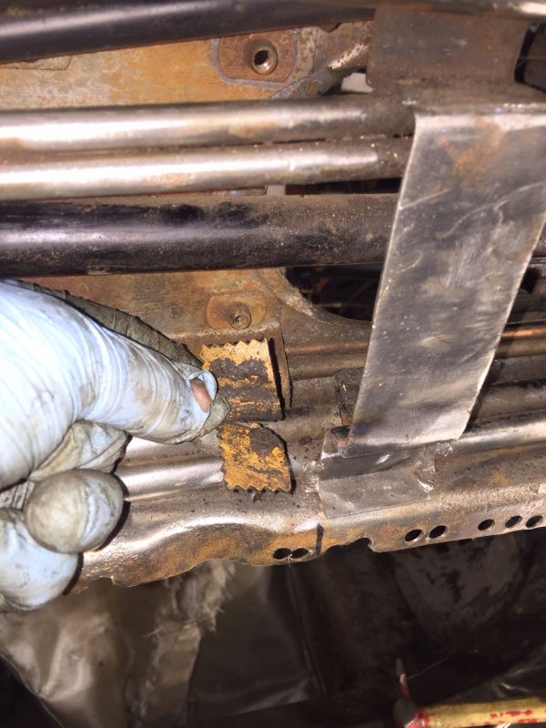

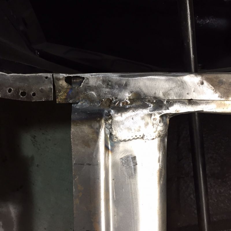

      Front foot well in and floors roughly fitted. Getting there.

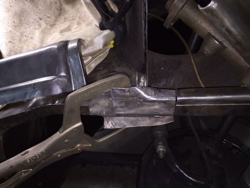

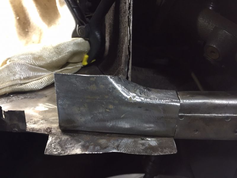

      • #93

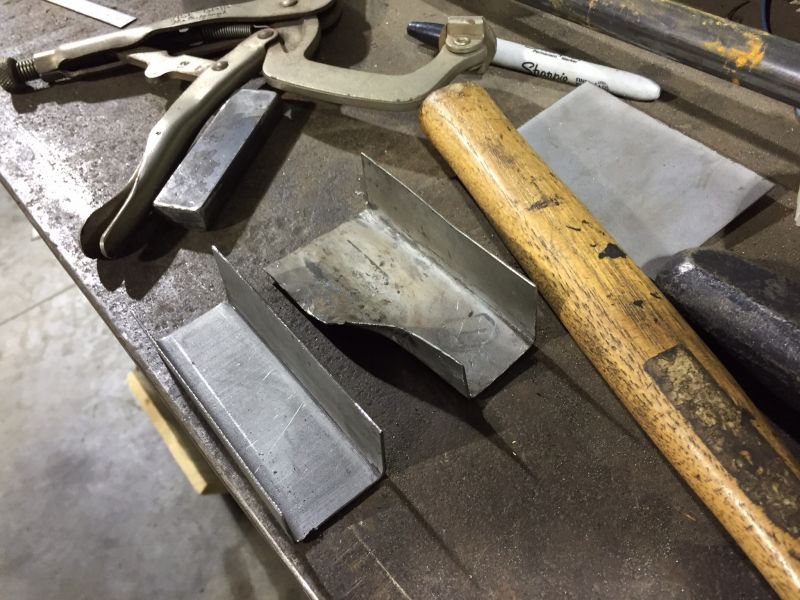

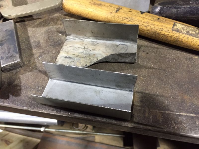

        Next up, these little buggers. Not sure what the whole part is called, but it is the little extension off the edge of inner fender. These were bent by me and then pounded out. I will have to open them up to get them in place and then use the torch to form them around the bottom of the pan. The parts I removed were quite well formed, read "pounded" bye the factory. I left the side of the edge of the pan and inner fender well loose so they can slip in where they are supposed to go. Not sure this makes sense, but hopefully the pics will explain it.
        • #94
          Looking good Mark! Yes, that's the early T1 versioned reinforcement runner your working on. They went external with it sometime in '57. My photo in that earlier post shows this later external runner. Keep up the great work! Justin
          • #95
            So it's the old "external reinforcement runner" is it! That's a mouth full. It is fun to be excited again about being in the shop and fabricating. Sometimes it's hard to get through the hard dark jobs we have to do in order to see the light at the end of the tunnel. I am glad we have you, Justin, or torch bearer to help light the way. Thanks also to all the other great contributors out there in space.

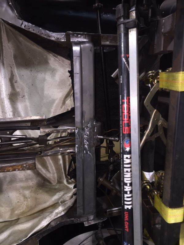

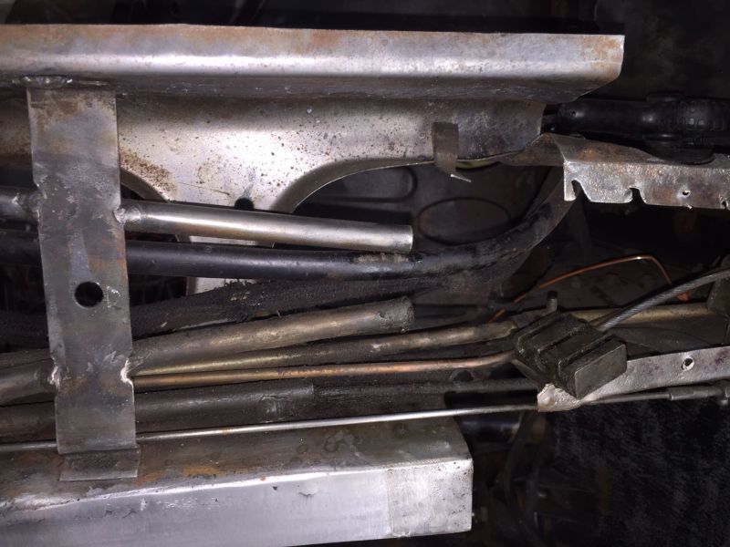

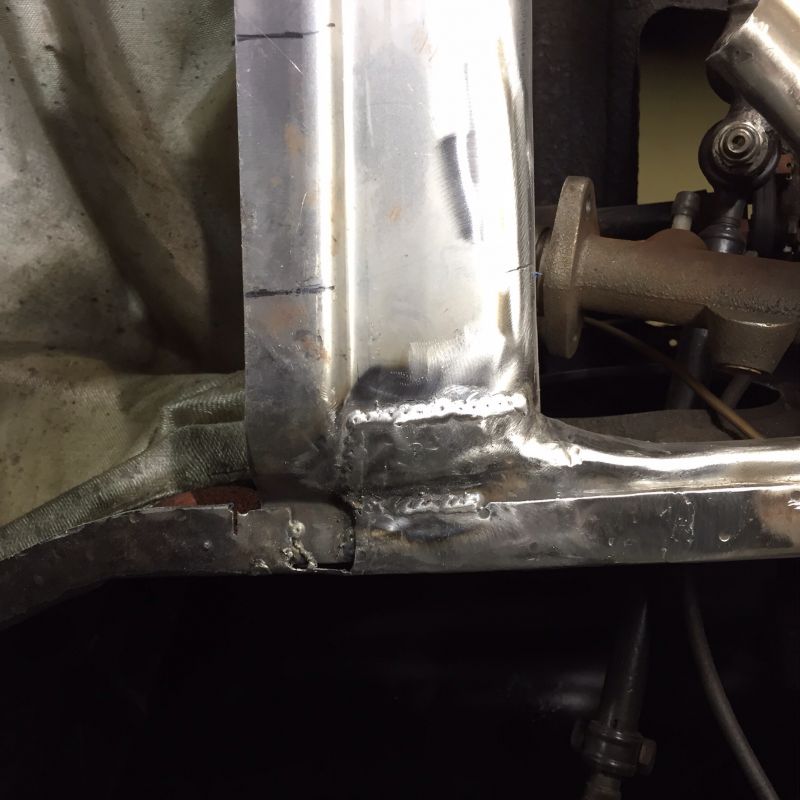

                    External reinforcement runner completed.

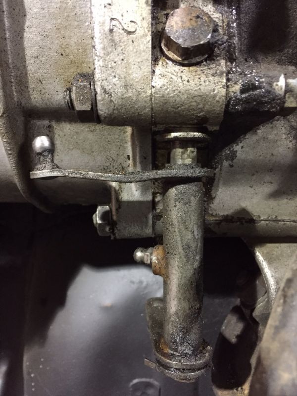

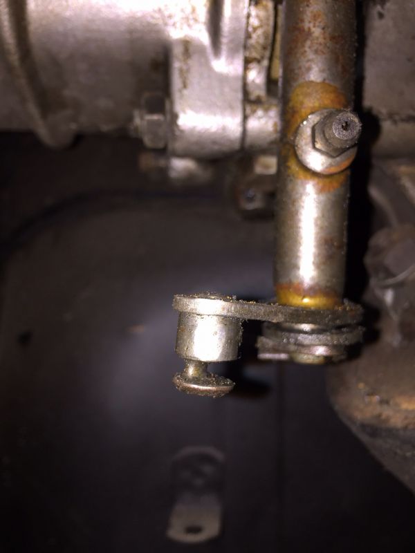

                          • Work continues on the pans and such. I have been taking my time and trying to "enjoy the journey" vs. getting in a hurry and feeling stressed. I have some questions. I will try to be organized w my questions. Any help is appreciated.
                            1 My throttle lever looks like it could be bent? Can anyone tell by looking? Seems like the ball should be perpendicular to the rod but it is at a slight angle. Clearly I need a new linkage end and probably also the ball end as well. I see a repair kit is sold. My transmission is a 741.
                            2 I think this lever is from some other car/transmission. It is loose and slides on stud, and needs spacers or something. Does it get bronze bushings or just spacers. Does not seem like a bushings would fit.

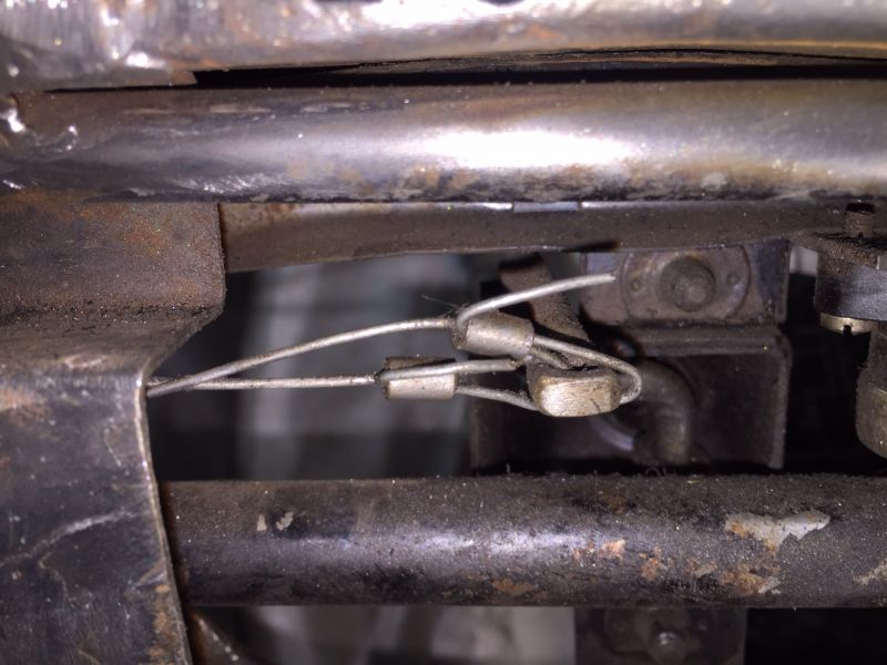

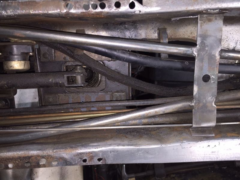

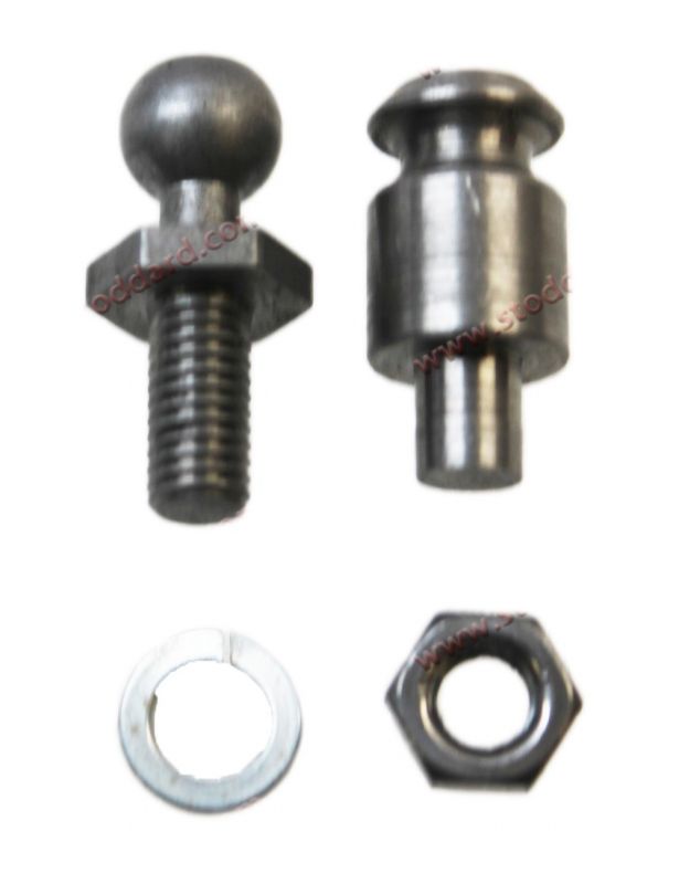

                            3 Where do I find the little crimps for the new heater cables?
                            4 What do I use as cushion/guide for the throttle rod where it goes thru the tabs in the tunnel? Where these pieces vinyl or leather? Seems like a piece of Poly or Plastic might be better? Like used in later 911's.
                            5 Does the accelerator rod have any bend to it? This refers back to question no. 1 because mine had sight bend towards end after exiting the tunnel. Wondering if the bend was due to improper lever angle. Clearly I need a new link end kit.
