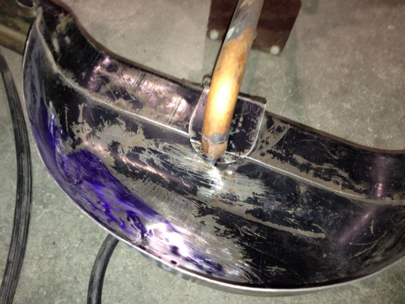

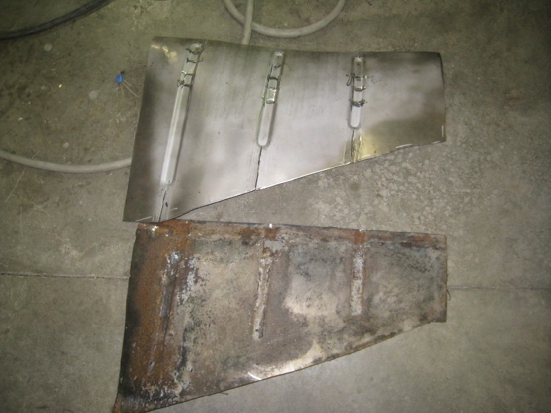

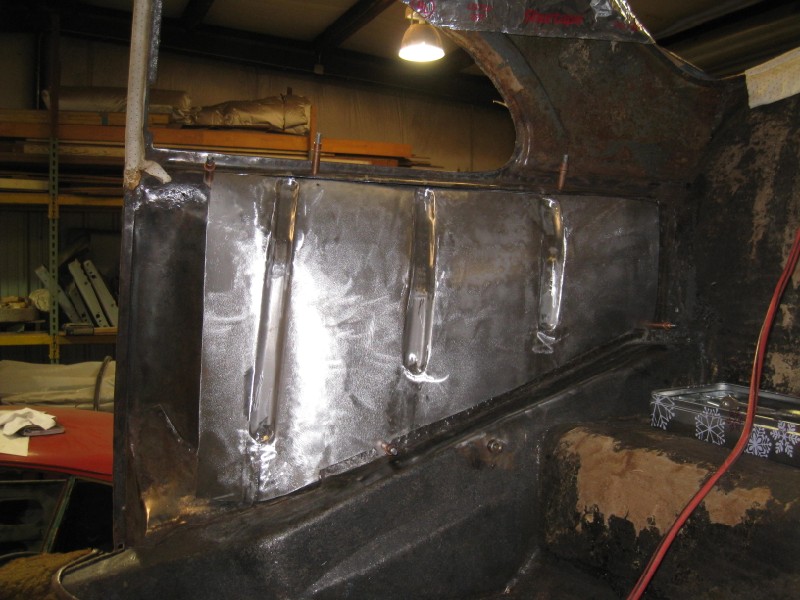

                During:
                After:
                PS before:
                During:
                After:

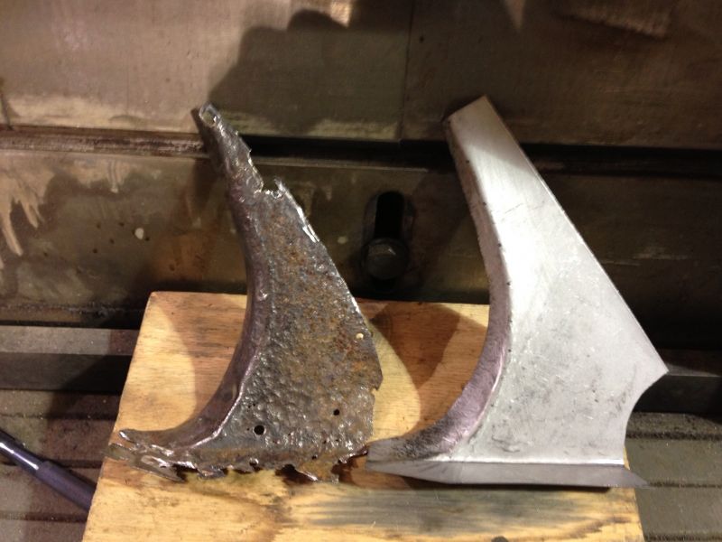

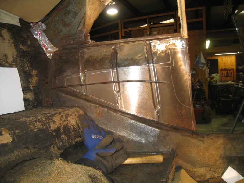

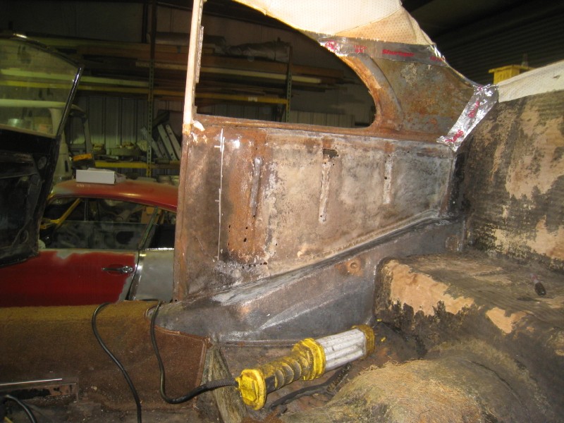

                The process was fairly involved. First I made a paper pattern, laid it out on the sheet metal and transferred it with my punch. I then began to use the metal brake to create the corrugated ribs. 8mm down, 16mm across and 8mm back up. My break is a Chinese suck ass piece of shit so it made the job very tough. Did I say don't buy Chinese tools! So once the ribs were laid out and in place I then had to hand form the closed curved ends. From doing this in the past I had a steel buck that I made for the Land Cruiser that was almost perfect. I have also learned from the past to not make myself too crazy about the ends bc once they are welded, finished, seam sealed and under coated who can really see much. Because the ribs create rigidity and the piece has multiple curves, compound? It was necessary to cut relief slices into the ribs so it could flex when beating it on the sand bag. I also had to slice the ends of the ribs so they would close up when hitting against the buck. Lots of whacking with mallets and body hammers. Once the shape was there, I tack welded the piece together, metal worked it more and then more smoothing. I also used the English wheel several times to smooth out the dents from the sand bag. Still more work to go. I planished the areas as needed and generally worked the piece until it was close. I decided to wait for my buddy, Scott's help holding it in place before the final fit and welding. I only have two hands and needed three or four. In the end, as I said, a good experience, but smart money would be to buy stamped metal, assuming they are good pieces. Looking at the time invested, I probably would bill out at $1 per hour and still have to file bankruptcy. Sort of how our government works. Sorry this is so long. Thanks for up loading the pics Justin.

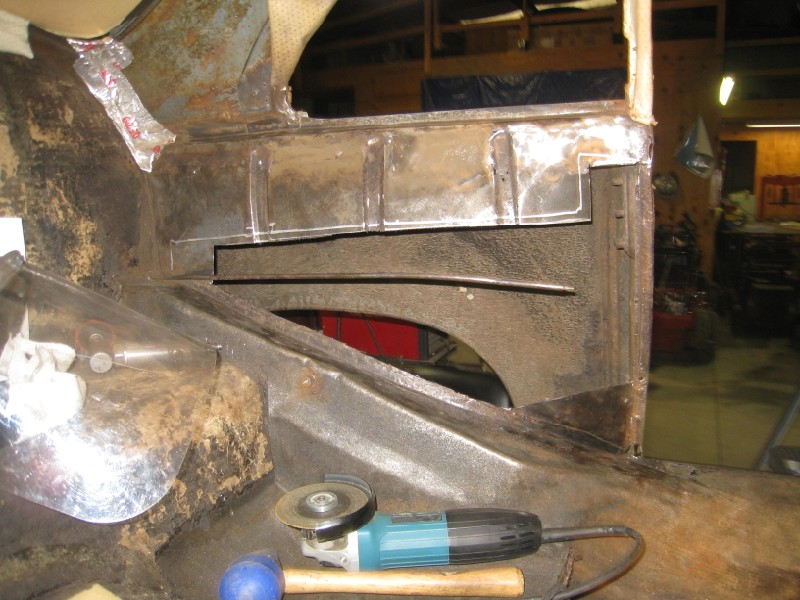

                • #68
                  I am posting this from my iPad. If it works I will update info.
                  Wow, it worked from my iPad and not my PC?

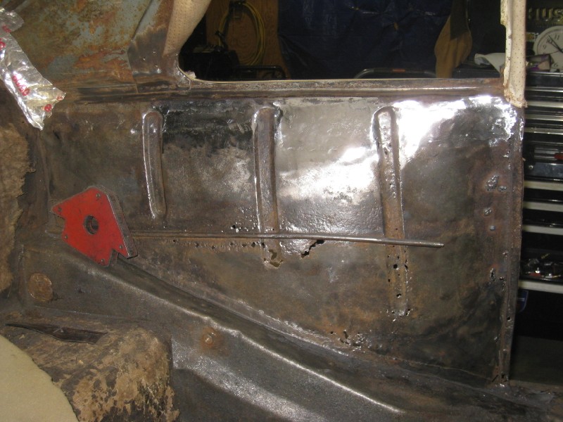

                  Anyhow, this is the brace at the door corner. I have more pics showing the process, but much the same as above. Pattern, transfer, bend, form, smooth etc. this one was very challenging bc the curve is very extreme and had to be worked a little at a time. I was worried the metal would tear, but it just moved along as I asked of it. Again, this is not finished, just about 90%. Thanks

                    Really nice fabrication job on those repair pieces Mark! You're right those closing panels are curving in several directions all at once. Those ribs really do thier job don't they? Looking at the condition of the originals this was the right choice. The reinforment plate patch looks great too! Alot of time invested for sure! Great job! Thanks for the update! Justin

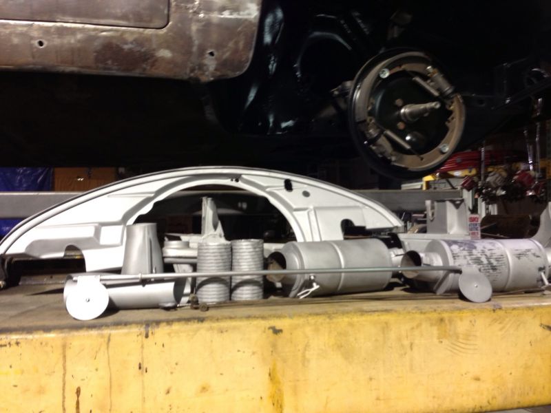

                          Been also working on all my sheet metal readying it for the Powder Coater. Mostly just metal working the kinks and a little bit of repair followed by glass beading.

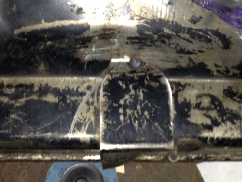

                          Also re-spot welded the little flipper panel, not sure what it is, where I could see it was spot welded from the factory. Must be an old access panel hold over for early 356 engine. This is a 69-912 motor.

                              The small parts restoration is a nice diversion isn't it? They look nice! Your car's front wheel well area and brake detail look great too in the background shot. That Tiny access hole in the front tin is an old hold-over from the early days. Its for a hand-crank to start the motor. Can you imgine? Justin
