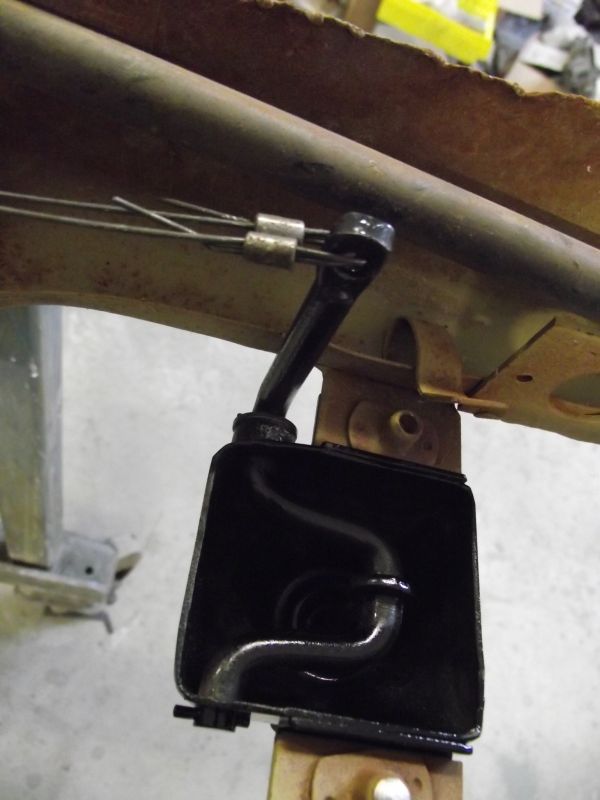

      • Mark,
        Are you sure that's a 741 transmission? By the view of the underside of the tunnel it doesn't look like a 741 shift linkage.
        • Originally posted by Don C" post=30962
          Mark,
          It is stamped 741. That is part of my question. I don't know what part is correct but someone who knows more than me said it was mixed and matched linkage. For clarification, car is early 57 T1, engine is 69 912 and transmission is 741.

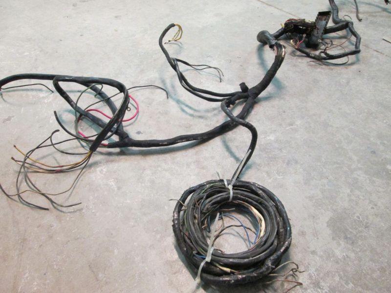

            • Mark, From what I have seen your harness it looks pretty good save for the usual breaches in the cloth from age or being man handled. Unless you're planning on replacing it I'd leave that sleeping dog lay. Removal (& re-install)is very hard on it as it has to make a couple of sharp corners which will completely destroy what's left of the sheathing.

              You'll either have to rewrap it old fashioned black electrical tape or a hockey stick type cloth tape or section it in shrink tubing; Or a combo of all like I had done years ago on my original harness above. A freak'in mess.

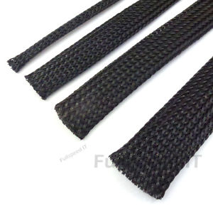

              I was seriously looking at this really nice nylon sheathing that's out on the market but all the various branches of the harness won't really allow me to cleanly re-sheath the main section of it. A lot more trouble than its worth in my final estimation. Now if you leave the main portion in I think this stuff would work great for "end" repairs like recovering the headlight runs in the trunk area or the tail light run in the engine compartment.

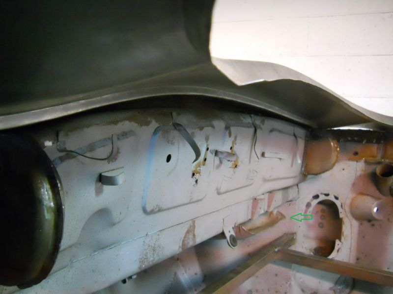

              85% of the harness has to pass through that metal shroud that's welded to the bottom of the trunk floor.(green arrow) It would be so much nicer and easier on everyone including and especially the harness if the factory just would have made that piece removable. Most of the harness has to be fed in there first for install or pulled out like one long root from the mouth of that shroud for removal. I suppose you could pull it out from the top but you'll of course have to remove the fuse block. At the time I was to scared to do that. Now that I am installing a new harness I may feed it in from the bottom of the sheath as the distance is shorter but not sure if that would be easier or not. Be interested in Jack's or Bruce's opinion on that. What's particularly hard on the wires especially as the thicker parts snake through is making the sharp corner at the base of this shroud down under where the floor boards would be. Also too while your pulling the harness out of the tunnel the old metal holding tabs just love to snare the loom as it passes by. It can be a total PIA if I haven't relayed that clearly already.

              • Originally posted by JTR70" post=30970

                Justin, this is exactly the info I needed to convince me to NOT pull it. I have a friend who is helping me some days. He likes to take stuff apart, but he is not the one who has to deal with putting it back together. He is a good friend and a good helper, but I have to keep him in check sometimes. This helps. Also, thanks for letting me know about the reusable wire keepers. Of course I did not throw them away, so one less think I have to buy.
                Too bad the don't make shrink wrap with a zipper, LOL. My wires are pliable so I will def. let that sleeping dog sleep.

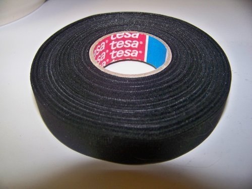

                    • Just bought this tape. Looks good.
                      http://www.amazon.com/gp/offer-listing/B00EH6IZ6Y/ref=sklp/186-7287210-3974332

                        Most likely, it is a 741 with a 644 'nose' and selector that then works with the earlier shift linkage. T-1 torsion bar tubes have a solid center that precludes the formed dent in the center bottom for shifter clearance of the B/C cars. T-2 A cars have a hollow center that allows the top 'dent' to be replicated from underneath once a window is made for access. Heat-n-beat with a rounded air-hammer head and use all 741 shifter compontents to get rid of the 'monkey-motion' early shifting. Some just exit the trans and support the shift tube above the tunnel, but that's 'racer stuff.'
