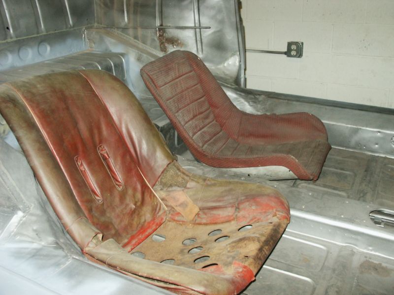

              Well I finally have something to report. For the record, I have not been screwing off. I have been helping my buddy Scott build his 68 hotrod 911 and we have been hitting it hard for the last couple of months or so. (visible in back ground)
              Any how, I got the right side Beehive holes closed up along with the over rider holes. Still need to clean the areas up and do some metal finishing. I have also media blasted all the engine tin in prep for the Powder Coating. Quite a job, but it all looks like new.

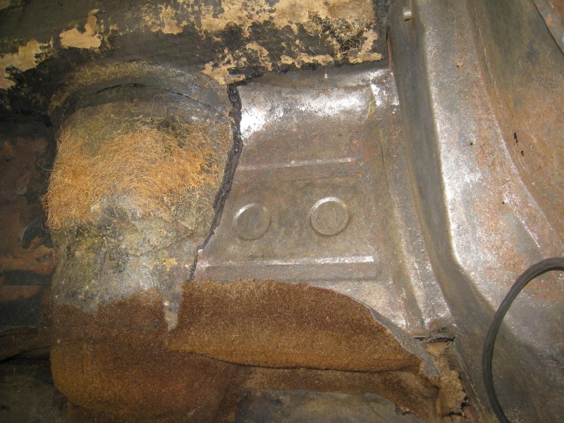

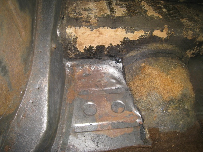

              I have now moved onto the rust repairs on the rear inner fenders. This was a bit of an unknown. I knew there was some rust, but was not sure how bad it was. After spending the day removing the undercoating on the outside and the sound pads on the inside (yuk) I am fairly pleased with what I found. Much of the areas are shinny metal. The seat bottoms looked like new, mostly. Unfortunately, where the water ran in the qtr windows, it left it's mark. You can see the how the water traveled. I think the pics look worse than the real thing. Not sure how I want to attach this. I could replace the entire panel, but seems a bit over kill with so much of the metal very solid. But it is usually easier than working a bunch of small patches, however, my goal from the start was to leave as much original metal on the car since it is so "rust free" as they say. At least for a 356 that is. Here are the pics.
              Gordon, I saw in your build where you made your own panels. Was it very tough? Why did you not buy them from one of the sources? I think it would be easier to buy the entire panel if I go that route, if I patch it, I would probably buy the panel if not too expensive. Anyone have experience with any of the suppliers as the whether they fit or not and which suppliers is best? Thanks, Mark

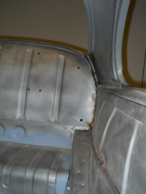

                I forgot to document this repair because I just slowly closed the holes in stages. Very teadious but it saved me from making a patch. The middle rib was the worst and forward rib was just heavily pitted but did not go through. A perfect pocket created here with the original tarpaper deadner.

                  Scott is only running that wheel on one spot while he waits for another one of our buds to deliver on the matching Fuch. I agree with you about the water leakage, makes complete sense and I also have a hole back under the qtr near the engine compartment. Not sure how to fix that one. I am not cutting things apart to get to it. Thinking about an extended carbide burr bit to clean out the hole and then leave it for drainage. I have also poured converters and blown it through with compressed air followed by Zero rust. I think that will put the rust at bay for many years, esp given it will never see rain. Where did you put drain holes? I don't recall seeing that.
                  I will definitely be making my own panels, just looked and they are $535 from RD. I can make my panels myself with about $2 bucks worth of metal and several hours of time. I have made much harder bits. Still debating whether to remove the remaining sound pads, but my gut tells me they are ok bc they are up high and no signs of any issues, though you never know.

                      Roy, my qtr window bottoms are perfect. The pics don't really show how good the seat pans actually are. When I removed the tar, they were actually shinny silver colored like brand new steel that had not been exposed to air. Amazing for 55 years. As for looking under the other areas, it is sort of you do or don't, once you start you are committed to ripping them off. I will definitely do some serious snooping before I remove them, especially the back one to be sure the window leaking did not cause any problems there.

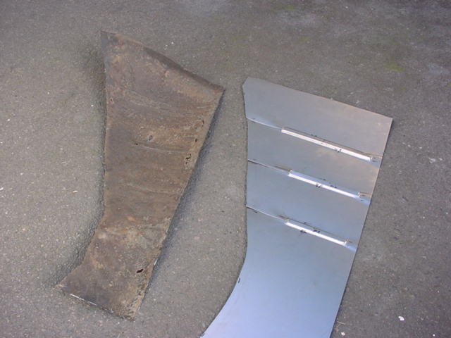

                        Mark, the fender well metal I replaced was pretty straight forward
                        I used common 20 Ga. cold roll steel which would not make that deep
                        of rib by pressing with out splitting. I slit above and below the ribs and formed the ribs on a finger brake. Then scribed and trimmed then
                        welded. I did the shaping with a planishing hammer last to match the
                        original. One more thing, some of the welds are hard to make in
                        that area. I found this pic. to help explain. Good luck, Gordon
