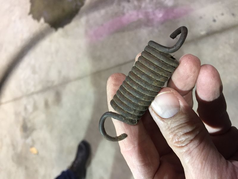

  • Is this a Porsche part? Laying in engine area and not sure.

        The part you show certainly looks like a (clutch package) return spring for the trans' transverse arm which holds the clutch release bearing. That's the arm that has the clutch cable attached via a clevis pin.

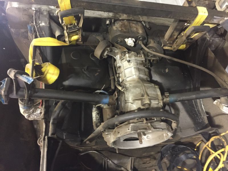

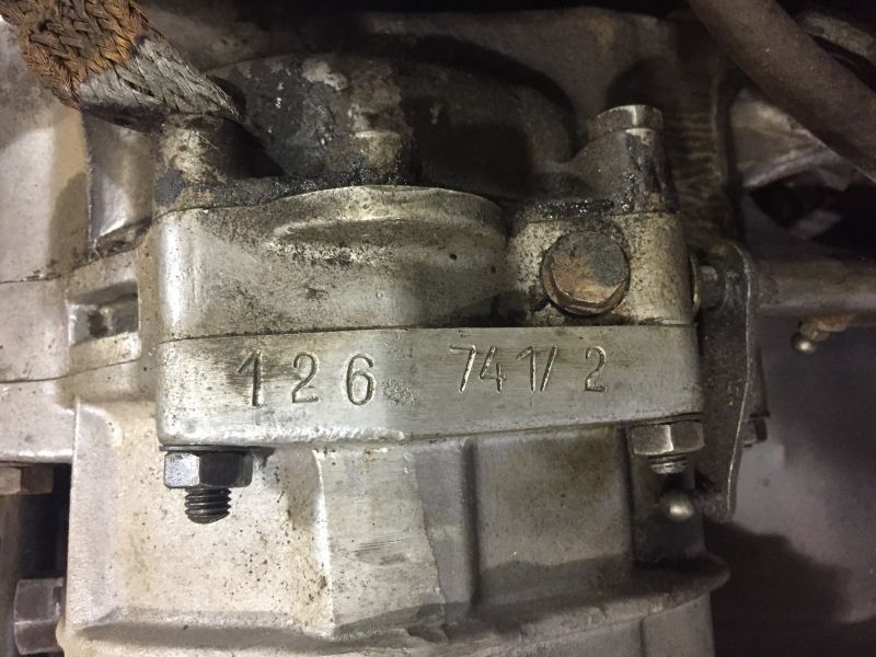

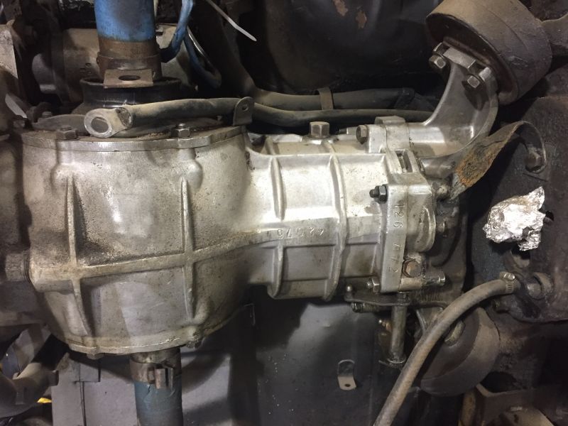

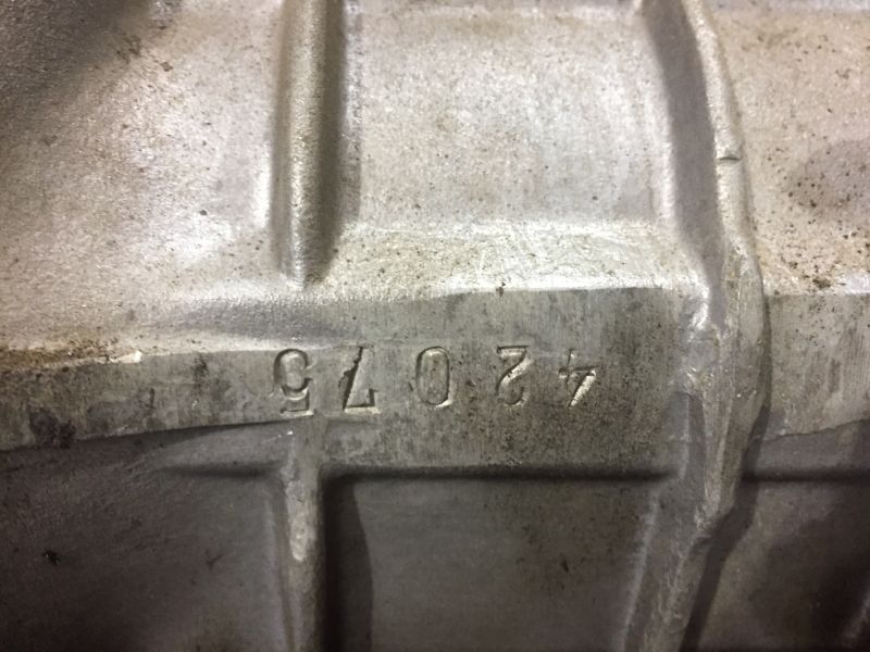

                        • Originally posted by bbspdstr" post=31014
                          Originally posted by merbesfield" post=30963
                          Originally posted by Don C" post=30962
                          Mark,
                          Are you sure that's a 741 transmission? By the view of the underside of the tunnel it doesn't look like a 741 shift linkage.
                          It is stamped 741. That is part of my question. I don't know what part is correct but someone who knows more than me said it was mixed and matched linkage. For clarification, car is early 57 T1, engine is 69 912 and transmission is 741.
                          Most likely, it is a 741 with a 644 'nose' and selector that then works with the earlier shift linkage. T-1 torsion bar tubes have a solid center that precludes the formed dent in the center bottom for shifter clearance of the B/C cars. T-2 A cars have a hollow center that allows the top 'dent' to be replicated from underneath once a window is made for access. Heat-n-beat with a rounded air-hammer head and use all 741 shifter compontents to get rid of the 'monkey-motion' early shifting. Some just exit the trans and support the shift tube above the tunnel, but that's 'racer stuff.'
                          I wanted to follow up on this post. Here are pics of my transmission. I do see 741/2 stamped on it. My engine is a 69 912. The car is a T1 A.

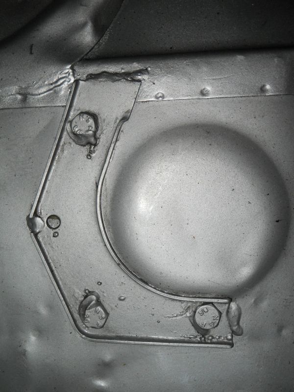

                          • I am in the shop today trying to knock down cob webs and get back at the car. Silly how long I let this sit for how close the pans are to being in. But life has its challenges. I am trying to remember something I read about making sure the pedal cluster is positioned properly before welding the pan in place. Is it just that simple, mock it up first or are there other points to be checked before welding the pan in? Thanks for the help. Mark

                              • So glad you were able to help yourself out here Mark.
                                Here's a shot of my factory undisturbed bracket though don't expect that round embossment to be in the right spot on the new floor.
