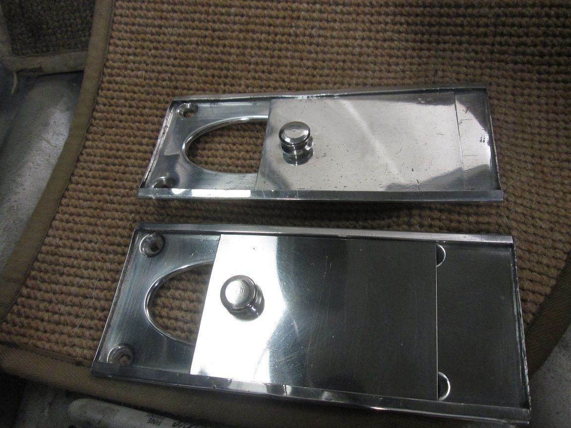

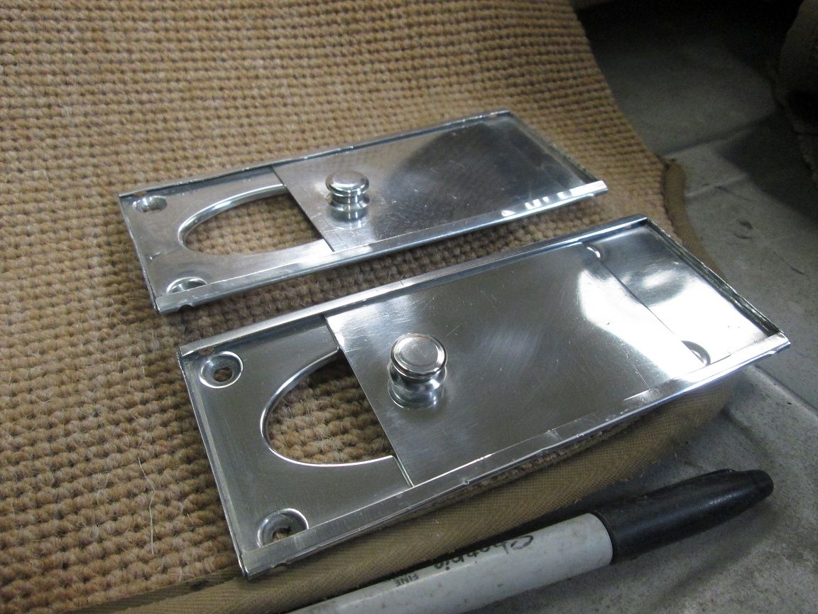

  • Restoring original heater slides:
    Fun little diversion projects before I can really get back on it.

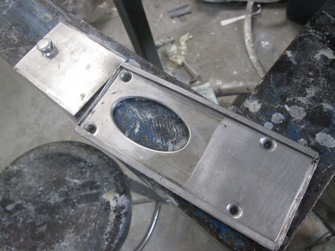

    Click image for larger version  Name:	IMG_5747.JPG Views:	0 Size:	160.3 KB ID:	109198 Again keeping my old friend Craig's recommendation of building this car with as many original components as possible I removed the slider door from each cover for a complete clean and polish.
    Click image for larger version  Name:	IMG_5748.JPG Views:	0 Size:	155.8 KB ID:	109199 Cleaned, polished with slider reinstalled. Some old scars and noogies remain, even some slight electrolysis on the back of one where the carpet had held some moisture way back when but all part of their charm.
    Click image for larger version  Name:	IMG_5750.JPG Views:	0 Size:	173.0 KB ID:	109200 The reproduction's offered are actually quite good and near spot on but this was an easy and satisfying little project to preserve a little more authenticity in honor of my late friend.
    • Yes I must polish mine Justin. A nice little job !
        Thanks Roy, it was fun little diversion with an end to it well in sight.

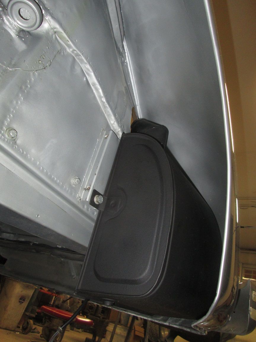

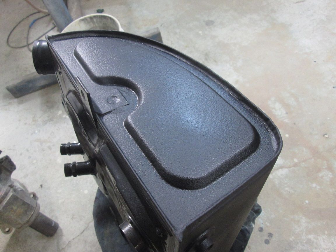

    • Prepping the oil tank for final installation:
      Click image for larger version  Name:	IMG_7245.JPG Views:	0 Size:	143.4 KB ID:	111041 No reason at this point why it cannot go in for good, so in its going. Coated the exposed side in undercoat for a more durable surface.
      Click image for larger version  Name:	IMG_7246.JPG Views:	0 Size:	123.4 KB ID:	111042
      I really like this 3M coating for small areas and parts. The finish is not too aggressive and its more of a brown-black tone which replicates tar very nicely.
      Click image for larger version  Name:	IMG_7251.JPG Views:	0 Size:	106.3 KB ID:	111043 Before the tank can go in I had to adjust and set the rear bumper and its irons to their final adjusted position.
      Click image for larger version  Name:	IMG_7249.JPG Views:	0 Size:	119.9 KB ID:	111044 The reason is that the final bolt on the frame side sits behind the tank and there is no getting to it without disturbing it. The bumpers needs to come off again but this bracket will remain in its adjusted position.
      Click image for larger version  Name:	image_64239.jpg Views:	3 Size:	111.8 KB ID:	111045
      At long last the tank is mounted for the foreseeable.

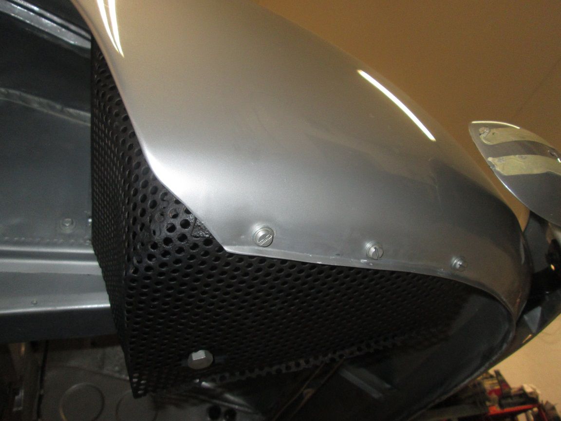

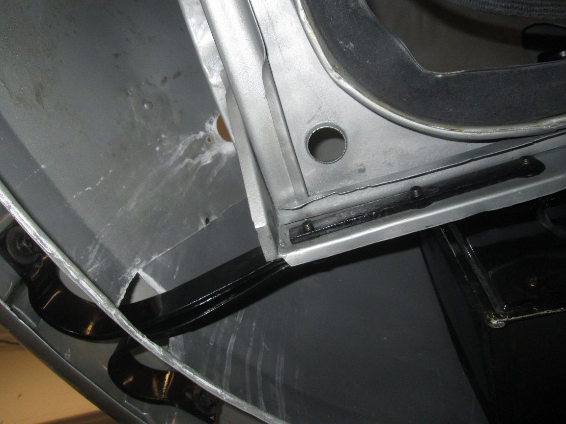

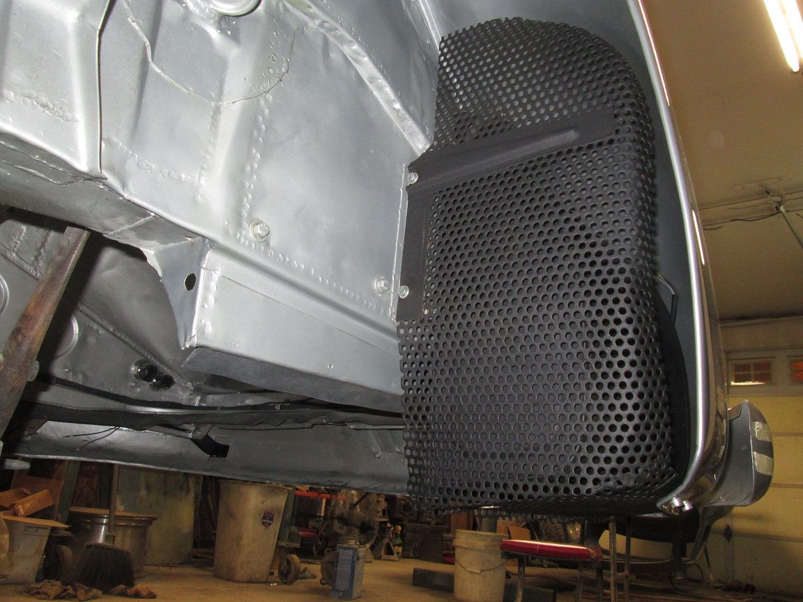

      • Screen/fender brace installation:

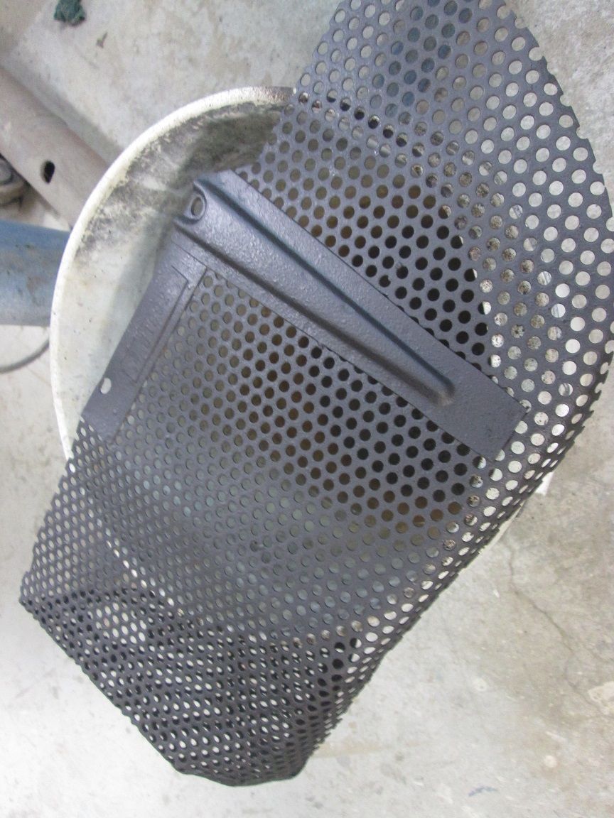

        Tank screen received the same undercoating treatment.
ID:	111048 Screen in for good.

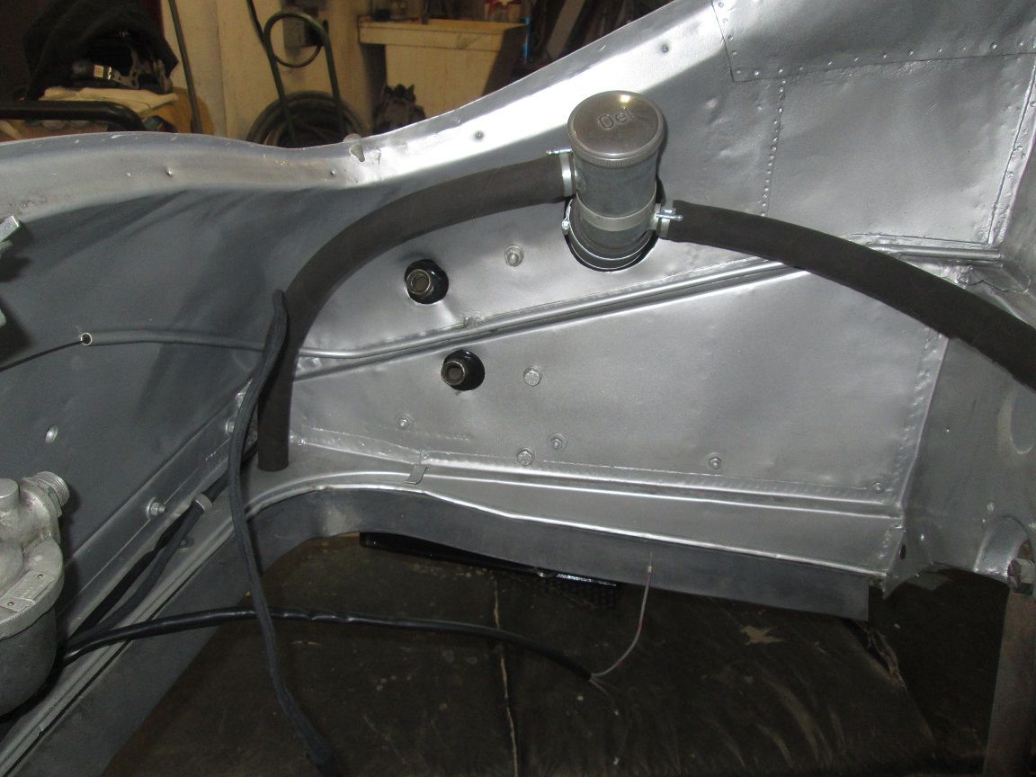

ID:	111049 Always assumed it was mounted with bolts after seeing some vintage photos it was clear that its mounted originally with cheese head screws.
ID:	111050 Filler neck and vent hose installed. It was one of those very fun and rewarding instant gratification sessions.
        Onto the next deal...

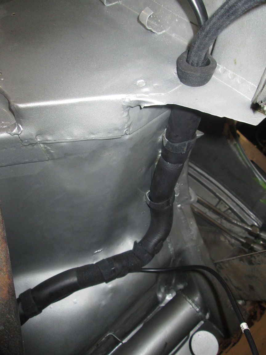

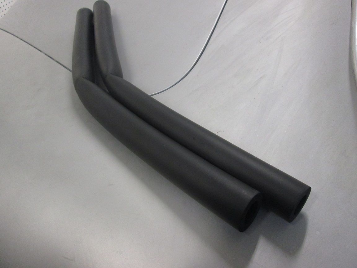

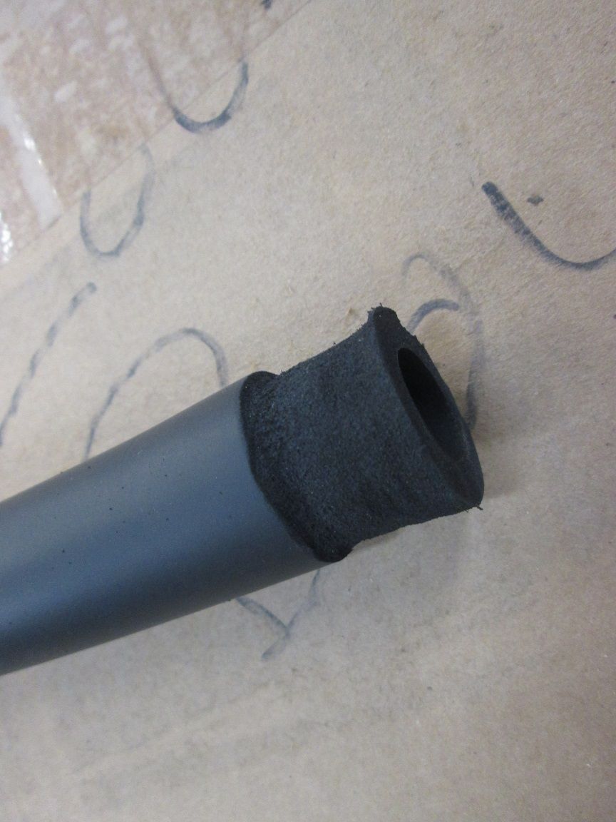

          Click image for larger version  Name:	IMG_3098.JPG Views:	0 Size:	218.0 KB ID:	111681 I was looking for a replacement protective sheathing for the harness run under the rear seat pan. I remember the original being of a thin foam rubber type. Jack Staggs had recommended using bicycle inner tube as a stand in replacement. Sounded like the perfect answer and I was going to go with that idea until I had a look under this car where the restorers had used that very material. This car was only recently assembled with no exposure to the elements or even engine heat but the inner tube was already cracking. I was now back in search for another material to use.
          Click image for larger version  Name:	IMG_7139.JPG Views:	0 Size:	85.5 KB ID:	111682 I was back looking into a durable foam rubber type sheathing. I figured out my minimum ID and went hunting. After several dead ends I found what I was looking for in these foam rubber grips for mountain bike handle bars.
          Click image for larger version  Name:	IMG_7140.JPG Views:	0 Size:	78.4 KB ID:	111683
          The ID was perfect though the wall thickness was slightly heavier than what I remember the original stuff being. Other than that I had my answer; foam rubber and most definitely on the durable side being for handle bar use.
          Click image for larger version  Name:	IMG_7141.JPG Views:	0 Size:	104.8 KB ID:	111684
          Prepping for installation: shaved the OD down a bit on one end for an insertion into the conduit existing the tunnel.

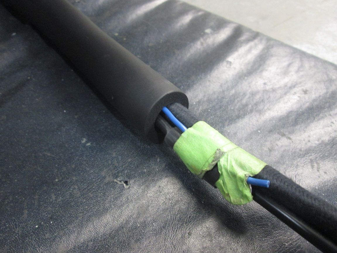

          Click image for larger version  Name:	IMG_7142.JPG Views:	0 Size:	144.9 KB ID:	111685 Passing the harness through. Again the ID was the perfect size for the wire leads.
          • Part 2:

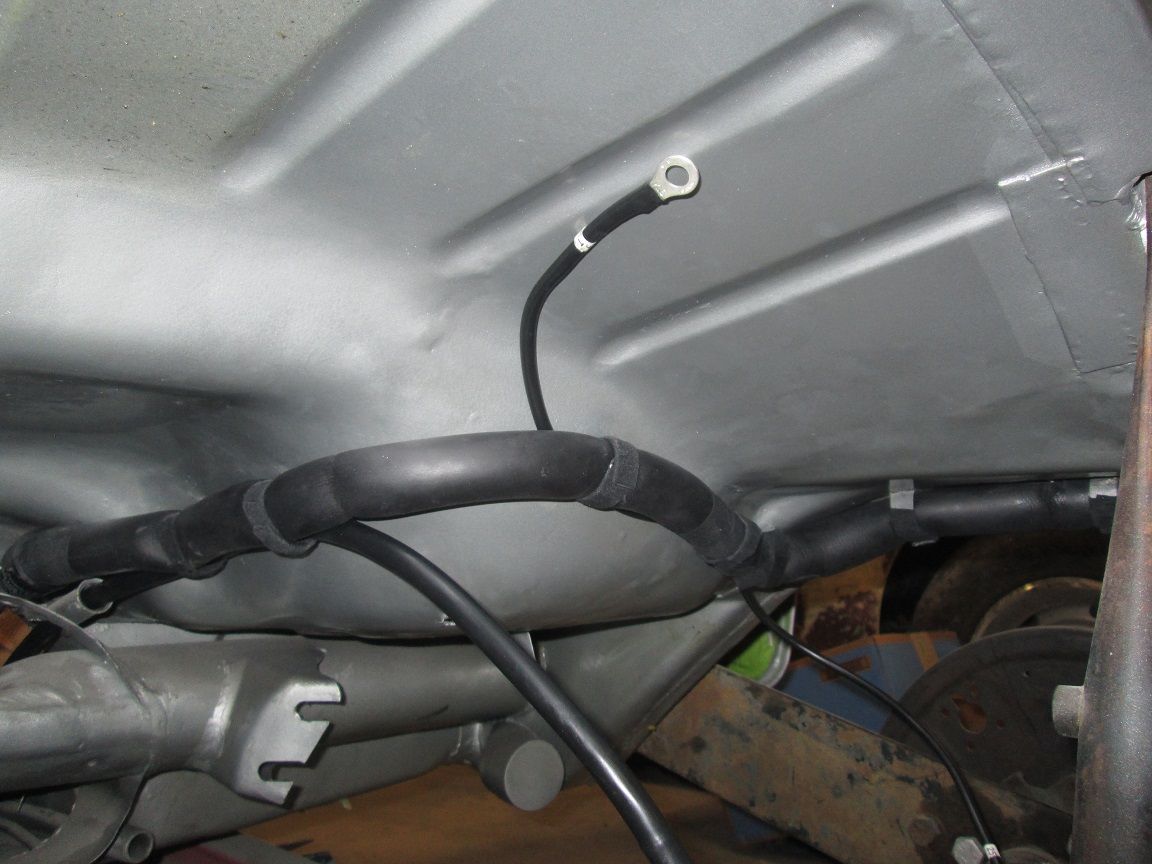

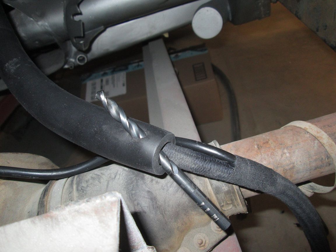

            Click image for larger version  Name:	IMG_7143.JPG Views:	0 Size:	126.9 KB ID:	111687 The being for handlebars they were precut to length making me a little short on the overall length needed to cover the run in one piece. A problem soon turned into an advantage as I decided to place the joint in between the two starter leads that need to exit mid point out of the sides of the sheath. Making the exit hole for the first lead just ahead of the joint here.
            Click image for larger version  Name:	image_64646.jpg Views:	3 Size:	125.3 KB ID:	111688Those starter leads exit in opposite directions so having the ability to slide those out the sides first then pushing this joint together after the fact made much easier and cleaner on the sheath versus trying to fish the ends out as a one piece covering.
            Click image for larger version  Name:	image_64647.jpg Views:	4 Size:	138.4 KB ID:	111689
            This material just loves super glue so worries about this joint opening back up in the future.
            Click image for larger version  Name:	IMG_7147.JPG Views:	0 Size:	125.2 KB ID:	111690 Joint glued making this run all ready for final installation.

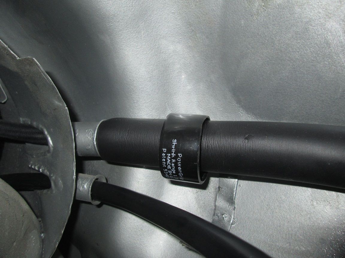

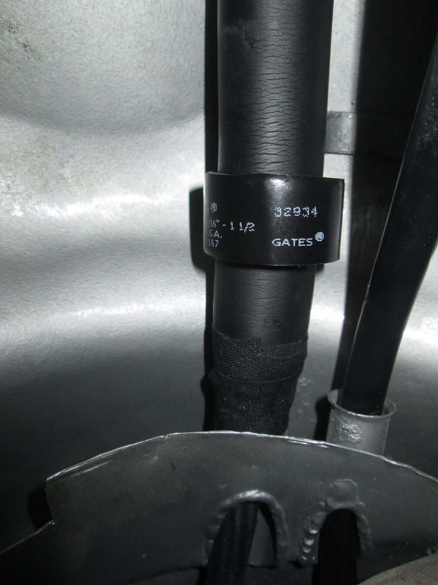

            Click image for larger version  Name:	image_64649.jpg Views:	3 Size:	161.5 KB ID:	111691 That shaved down end inserted into the conduit. Securing this end always seemed a bit iffy at best. I bought this shrink collar in hopes of bridging these that junction securely.

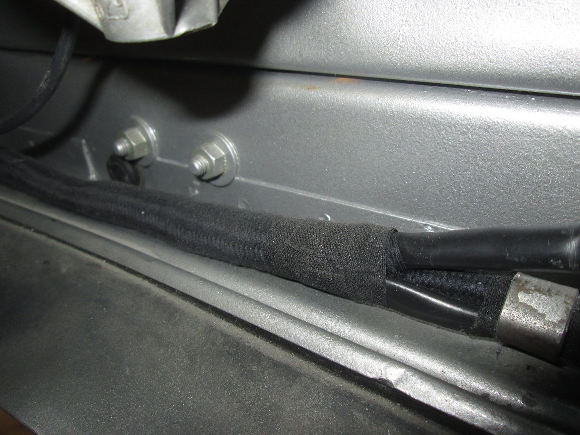

            • Part 3:
              Click image for larger version  Name:	IMG_7168.JPG Views:	0 Size:	114.2 KB ID:	111693

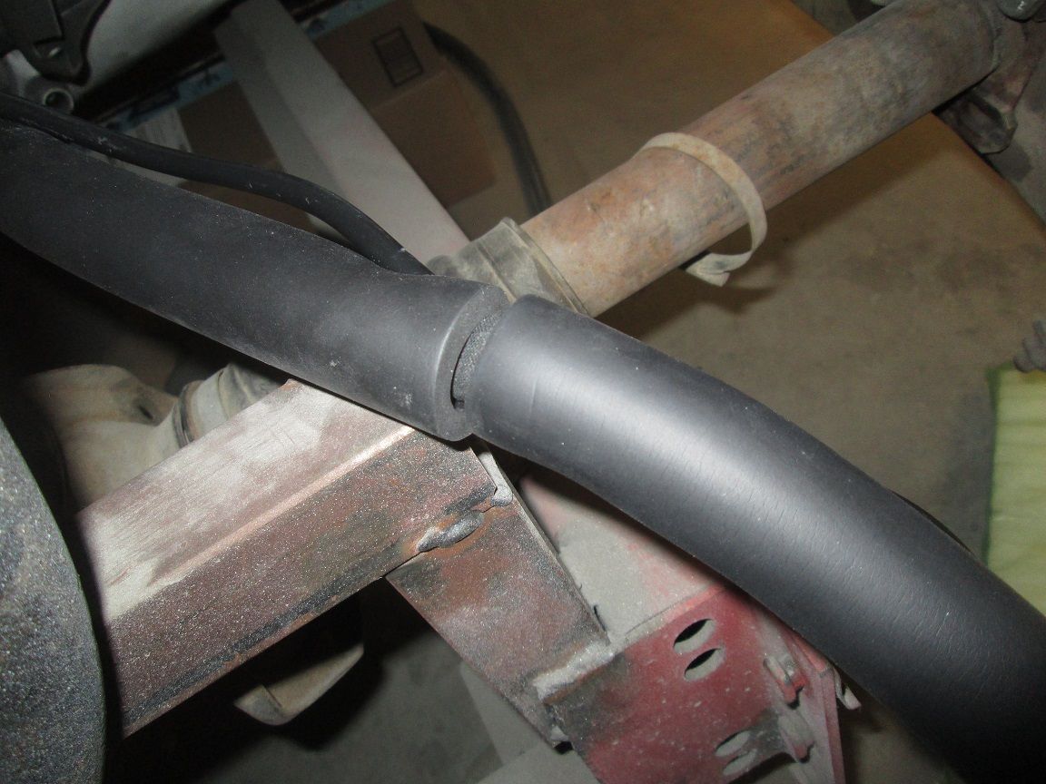

              I put my heat gun on it but I was limited as to the amount of heat I could throw at it for fear of ruining and blistering the sheath. I ended up taping the joint as I remember it being when I first pulled the harness out. I may follow up with a zip tie later. Anyway moving on for now.
              Click image for larger version  Name:	IMG_7170.JPG Views:	0 Size:	114.4 KB ID:	111694 The rest of the run now fully tab locked into position. Went ahead and taped the tang leads just to make a life a little easier on that foam covering.
              Click image for larger version  Name:	IMG_7172.JPG Views:	0 Size:	138.5 KB ID:	111695 The entire run feels firm , secure and well insulated.
              Click image for larger version  Name:	IMG_7171.JPG Views:	0 Size:	125.5 KB ID:	111696

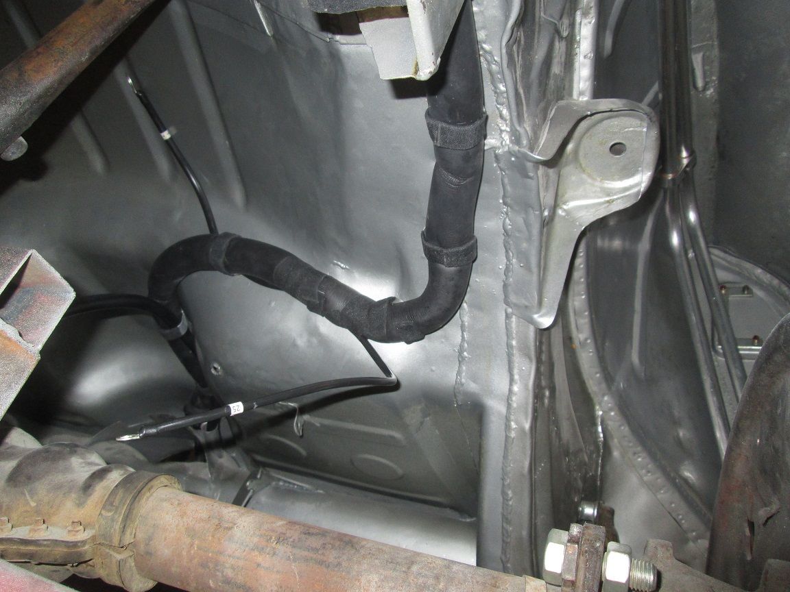

              The additional wall thickness secures the tubes end at the entrance into the engine compartment. Couldn't have been happier with the final result. Material is close to what was there originally and thoroughly insulates the new harness. Best 20 bucks I ever spent.
              Click image for larger version  Name:	IMG_7173.JPG Views:	0 Size:	139.5 KB ID:	111697 Getting that section out of the way allowed me to finally run the rest of the harness through the engine compartment.
              Thanks for looking!!

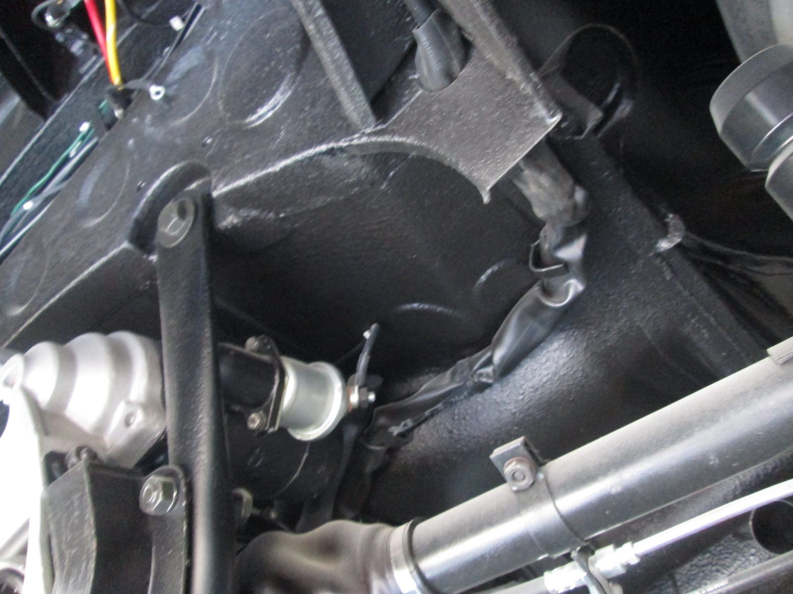

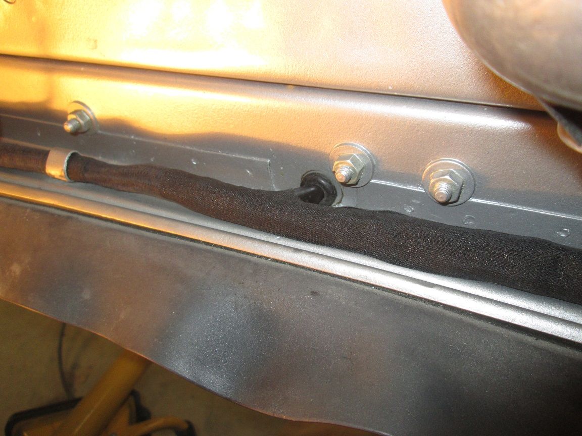

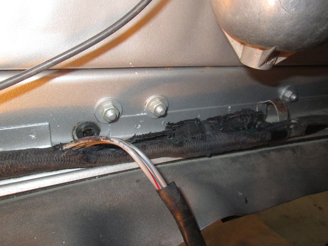

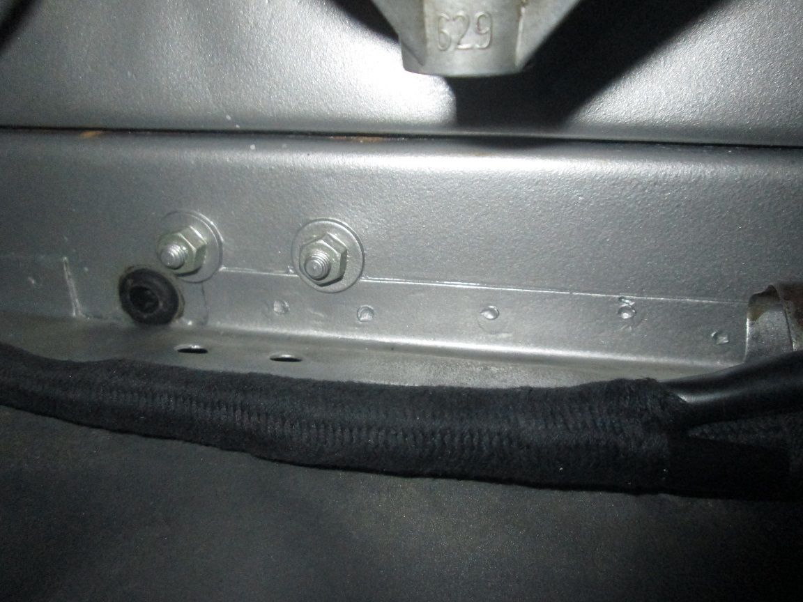

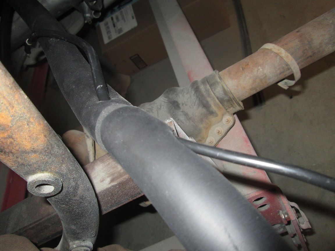

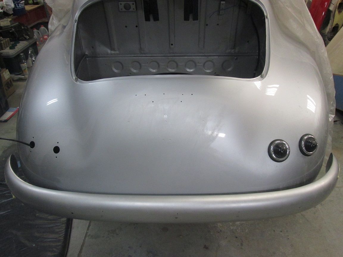

                  Ran into another little snag while running loom around the back of the engine compartment.
                  Click image for larger version  Name:	IMG_7320.JPG Views:	0 Size:	174.8 KB ID:	111708 The wire lead for the reverse light, the hard plastic tube on top in this photo should have exited a few inches back.
                  Click image for larger version  Name:	IMG_7321.JPG Views:	0 Size:	138.9 KB ID:	111709 It should have forked back where the plastic sheathing begins down in cloth sheathing to make it into that hole. I investigated all my possible options and if I doubled it back to the hole the lead itself was then too short to reach the reverse light.
                  Click image for larger version  Name:	image_64661.jpg Views:	3 Size:	160.7 KB ID:	111710 I really hated to do it but my only option was to cut the cloth sheathing back and free the lead back where the hole is.
                  Click image for larger version  Name:	image_64662.jpg Views:	3 Size:	153.0 KB ID:	111711 Sheathing re-taped and lead now exits into its hole as it should have. As nice as these Y-n-Z's harnesses are they are still reproductions that need correcting so they'll fit correctly. I was so disappointed that I had to cut into that cloth sheathing but I care less and less as time goes on. A lot more fish to fry....
                  • Justin from the photo you would never know, as you say it was the only way ! It looks fine!
                      Thanks Roy! Wish I could have avoided that but again no other way...
