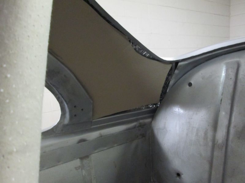

      added in that section of additional sound dampener in prep for closing.
      this is going to be yet another tough area to get wrinkle free once all is done just as Gordon has warned about.

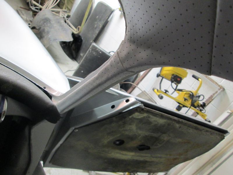

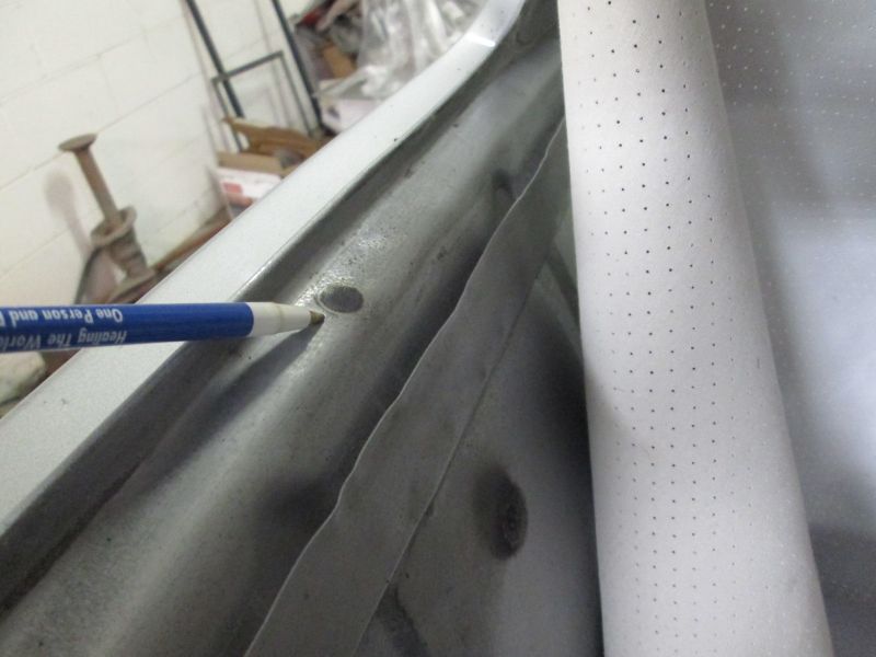

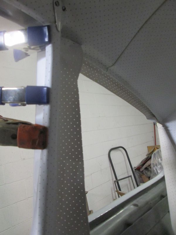

      Finished up the right A pillar wrap while I procrastinate on addressing that sail panel. Turned out tight and clean. A lot of the raw shape of the pillar transferred through like the factory welds etc. but this is how it came originally so, okay...
      I terminated and shaped the bottom to the mildly stepped shoulder pressed in the metal.

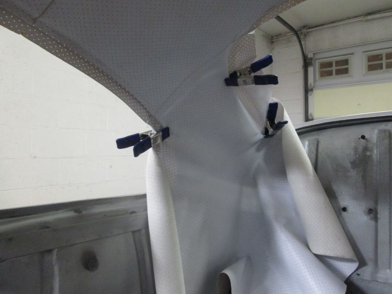

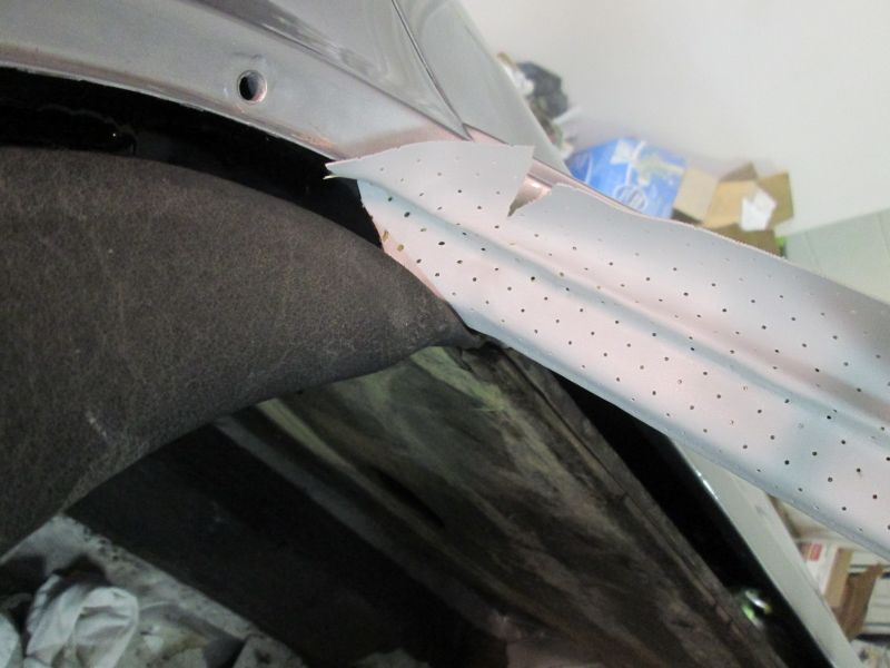

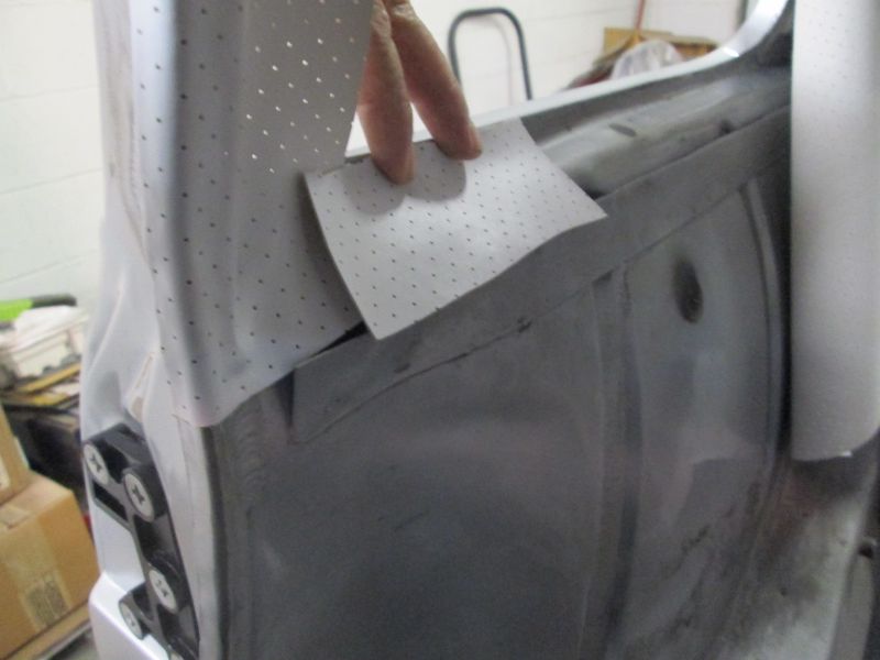

      Began wrapping the B-pillar.
      Have a question for Roy: ( anyone else who knows)

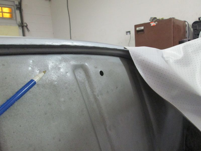

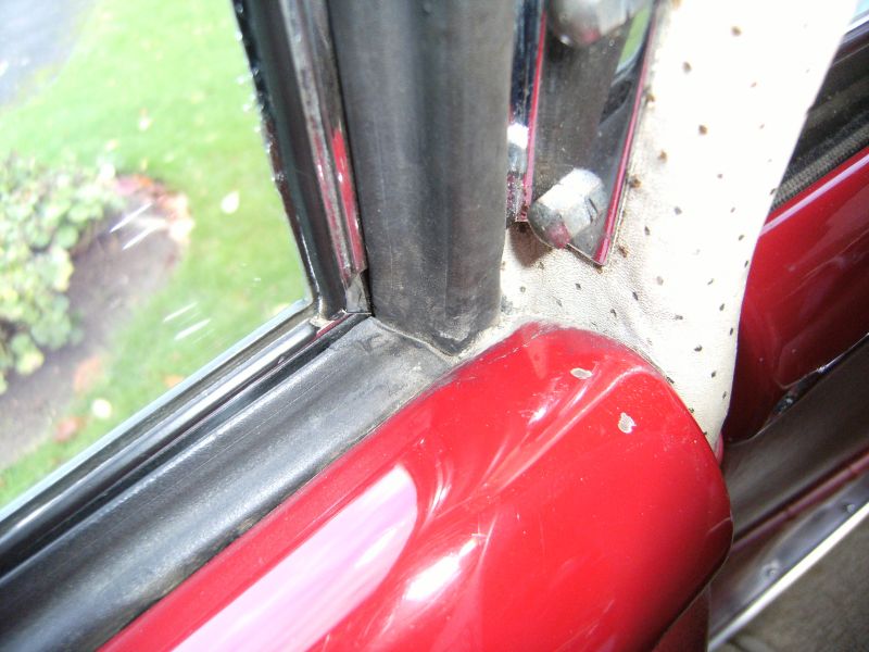

      On your car Roy, Does the center section glue over the side panel sections of the liner or under them at the joints?
      Also is there headliner material running along this bottom lip of the quarter window opening? Thanks for any help on that.

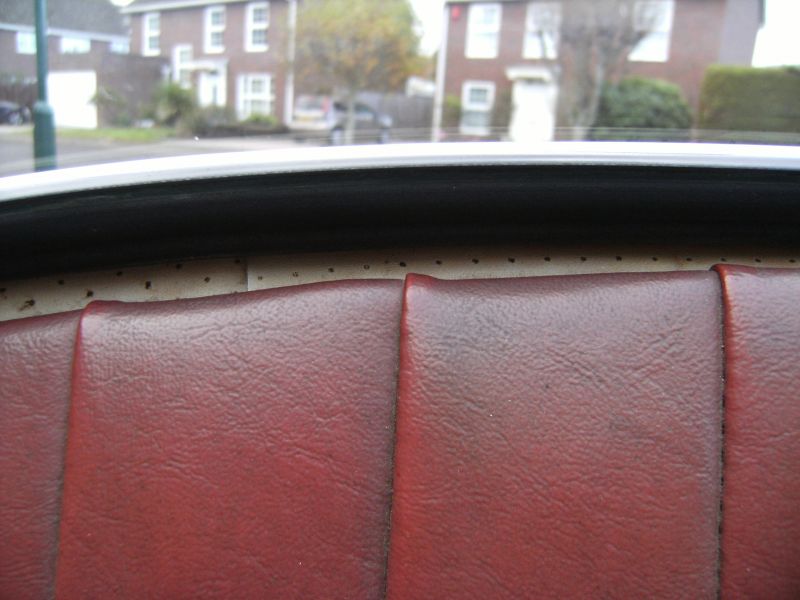

      • Justin,

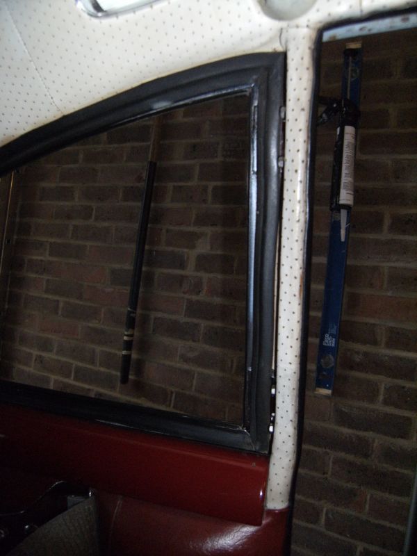

        You are a doing a really nice job with the headliner. I noticed your clothes hooks. I did not know T1 versions had steel, the T2 like mine has rubber versions.

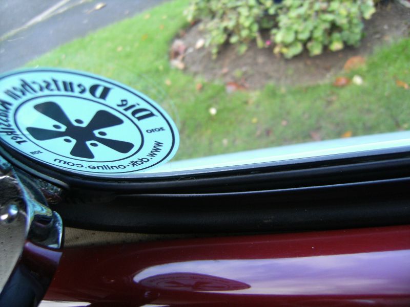

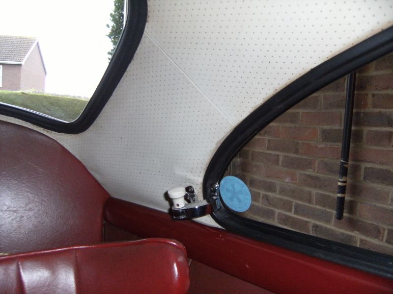

        The fitting of the headliner onto the B pillar and the quarter light window area I make this comment. I think the material of the headliner goes down the upright and then does travel along the bottom of the quarter light window. I say that because if you look closely at the 2 photo's the material seems to disappear under the red metal capping on the side panel. The rear end which goes under the red vinyl side panel would have been stuck down I guess all along to the B upright. It would help captivate the headliner and without doing that the red vinyl side piece would have exposed the steel body
        at the rear end of the window.The headliner can be seen going along the bottom of the window for about 2 inches then the rubber window seal presses against the capping so you cannot see more of it.
        I have only ever once had the capping on the side panel off the car once when I replaced the quarter light rubber seal over 25 years ago.. I seem to remember the capping was held in place by a screw and metal clips. So I would glue it down with plenty of spare to go under the side trim panels.
        I attach 2 photo's possibly sent before of that area.
        To me you need it just for cosmetic purposes really and to assist in being sure the vinyl side pieces will cover everything you need it to.
        Come back to me if you really have a nagging doubt.

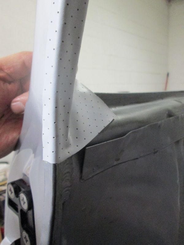

            I understand what both you and Dick are confirming. What we're seeing is just the continuation of the B-pillar wrap; all set on that one.
            What I was wondering is that if the factory continued the liner across the base with a separate piece like my quick example above? By your nice photo however it seems that there is not much of a gap between the mounted garnish rail and the seal to be able to see down in there anyway. So I'm guessing probably not; easy enough to add at any time after the fact though. You're right, there is not much holding that rear rail in place. Just a single screw in the door jamb under the seal with only a hook at the back just behind the rear panel.
            Same question: Is there a joint along that center bottom run of liner just out of this photos field of view? can you take a pic of that area?
            The coat hooks weren't steel but rather potmetal. Either way a very unforgiving object to put your head into. Thanks again for the help!
            • Justin,
              You are correct you have to really ' peer' over the top of the garnish rail to see any of that headliner material. Only for about 2 inches or so can you see a small glimpse of it the rest is hidden by the contact of the seal against the garnish rail. I will take a photo. I would say if it were easy to bring one piece along the bottom half way, and then join up with the other end it would be fine. I will take a photo of that and the back firewall area to show you mine.

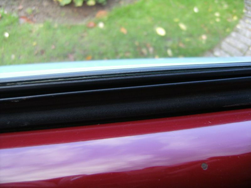

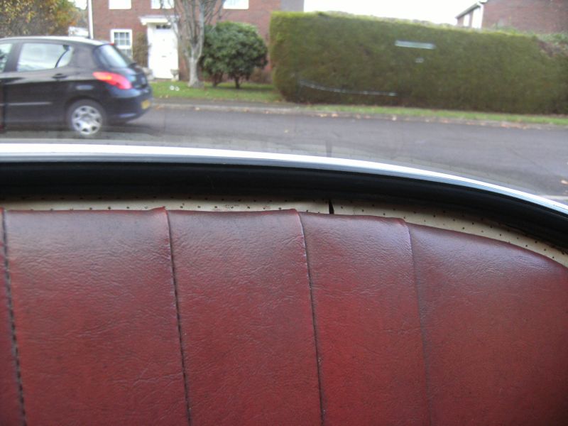

                • Justin,
                  Can't see the muslin Dick was talking about without taking the liner off. However, that headliner needs sticking and don't quite see how you could do that easily with the muslin in the way??
                  Attached the photos of the seal to the garnish rail it butts up close!
                  Attached 2 photos of the rear firewall. You will notice a small split on the headliner in the middle of the first thin panel of the red vinyl. If you look at the next picture of the other side the same split is on that first thin panel. They must have put a separate panel in that back area to match up with both sides? Or that's how it looks to me!

                    • Justin,
                      Just realised what you wanted regarding the back firewall placement of the central separate headliner section.
                      I reckon they put the central section under the back window on first. to make it equal to each side.Then they were able to bring each side part over the ends of the central panel and to me almost cut through both 2 pieces of headliner on each side in the areas you can see in my photos. That would make it a 'butt' joint. That how after 56 years one side of mine has lifted like a 'split'.
                      For sure you could have the side parts overlap by a 1/4 " to make sure as security. I can see though if there is an overlap its very small indeed on my car.
                      This is where car trimmers earn their money. You just cannot make a mistake.
                      Dick's comment about the hessian under A and B pillars would make the surface smoother but I looked again at my pillars like yours they show the surface underneath and when you push on the surface there is no 'give' in it. I have said to Dick I would like to prove it but they have remained stuck for 56 years! As he has said to me maybe by the T6 they changed methods.
                      I have now wondered if the pillars were worked on with filler to smooth them but maybe that's going to far

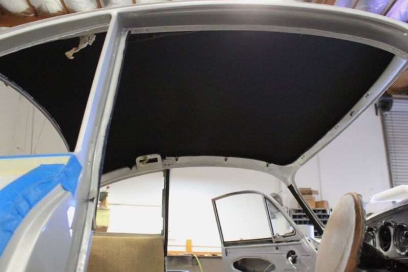

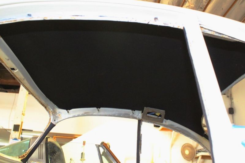

                          This are a couple of pics that I took from the Autos Int website on their jobs.
                          You can see the posts are wrapped, they used a black material for some reason.
                          and
                          Hope this doesn't muddy up the waters too much.
