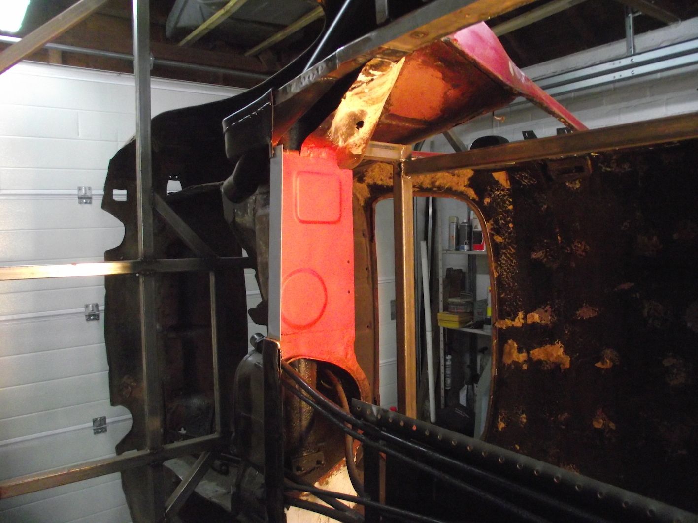

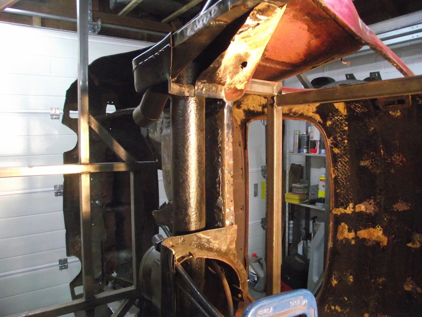

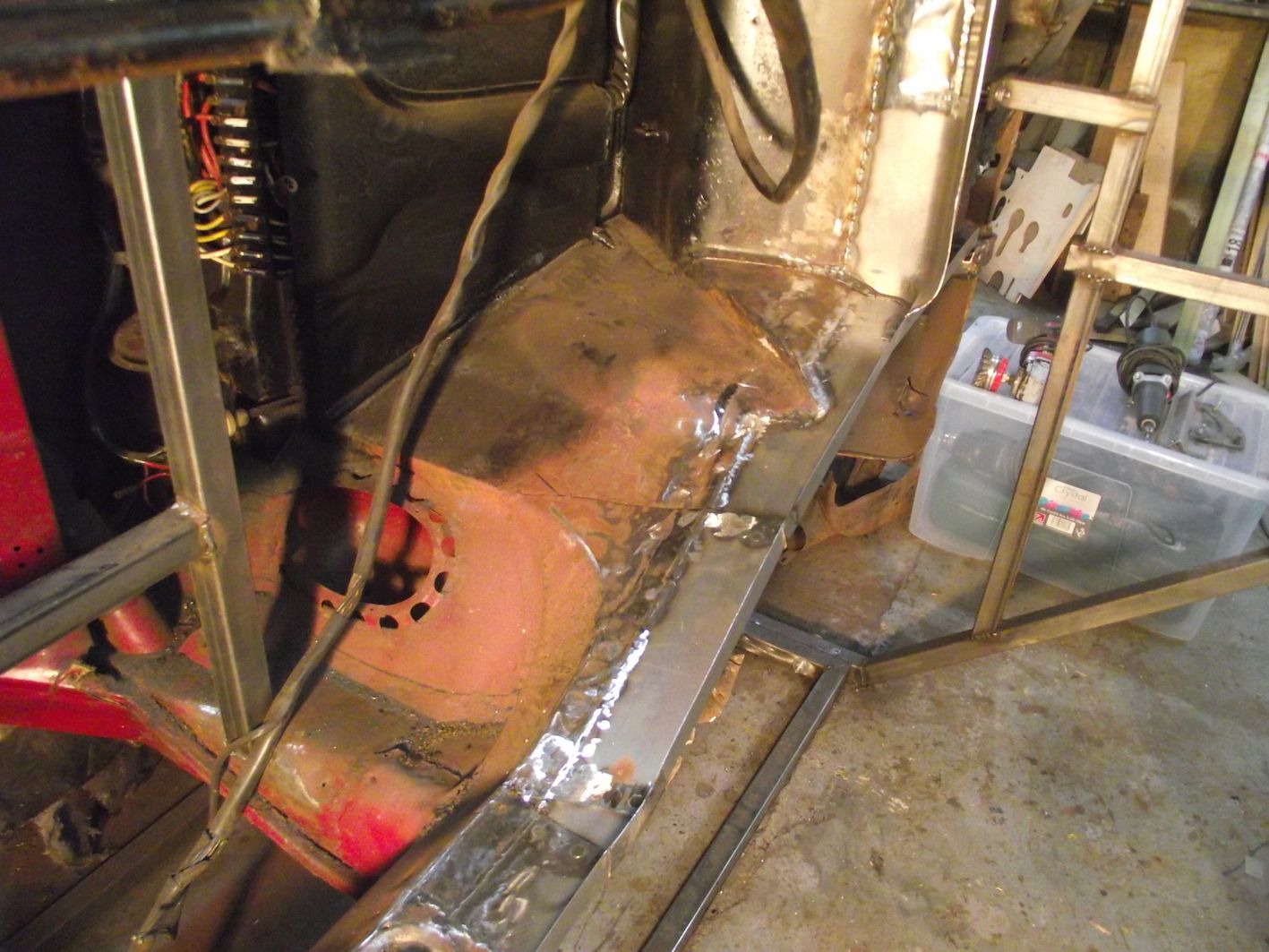

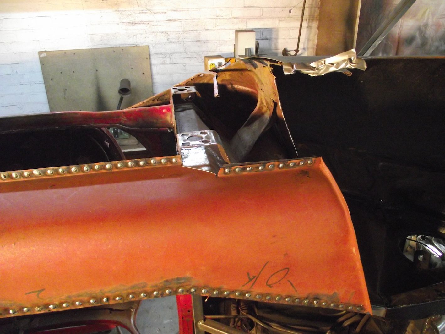

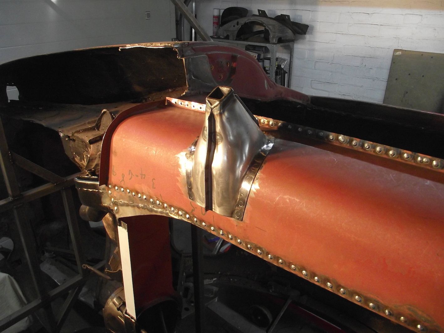

    • Click image for larger version  Name:	DSCF8236.JPG Views:	213 Size:	164.8 KB ID:	105232 Click image for larger version  Name:	DSCF8238.JPG Views:	207 Size:	188.3 KB ID:	105234

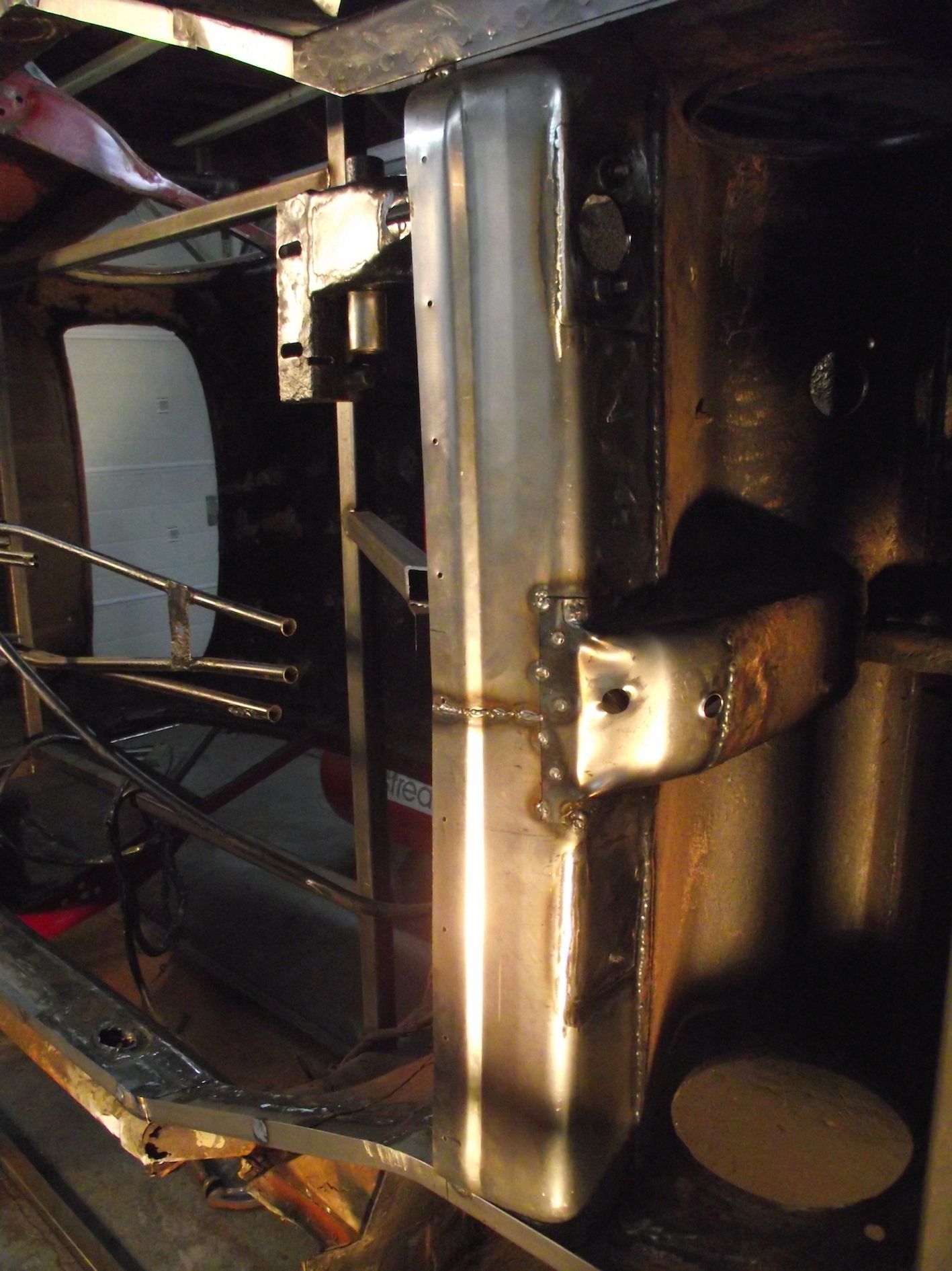

      Moved onto the rear kick panel, remains of old panel removed and new panel welded in, easy! I will be fitting eye bolts for the seat belts into this panel, when they arrive.
      Click image for larger version  Name:	DSCF8235.JPG Views:	211 Size:	213.0 KB ID:	105235 Click image for larger version  Name:	DSCF8239.JPG Views:	204 Size:	180.2 KB ID:	105233
      So to take stock, the right side is all but ready for the new floorpans, the front toe panels will be next to go in and then the central tunnel.
      Click image for larger version  Name:	DSCF8241.JPG Views:	178 Size:	225.7 KB ID:	105236
      The slightly daunting task is that soon I will have to turn the body over and do it all again on the left side.

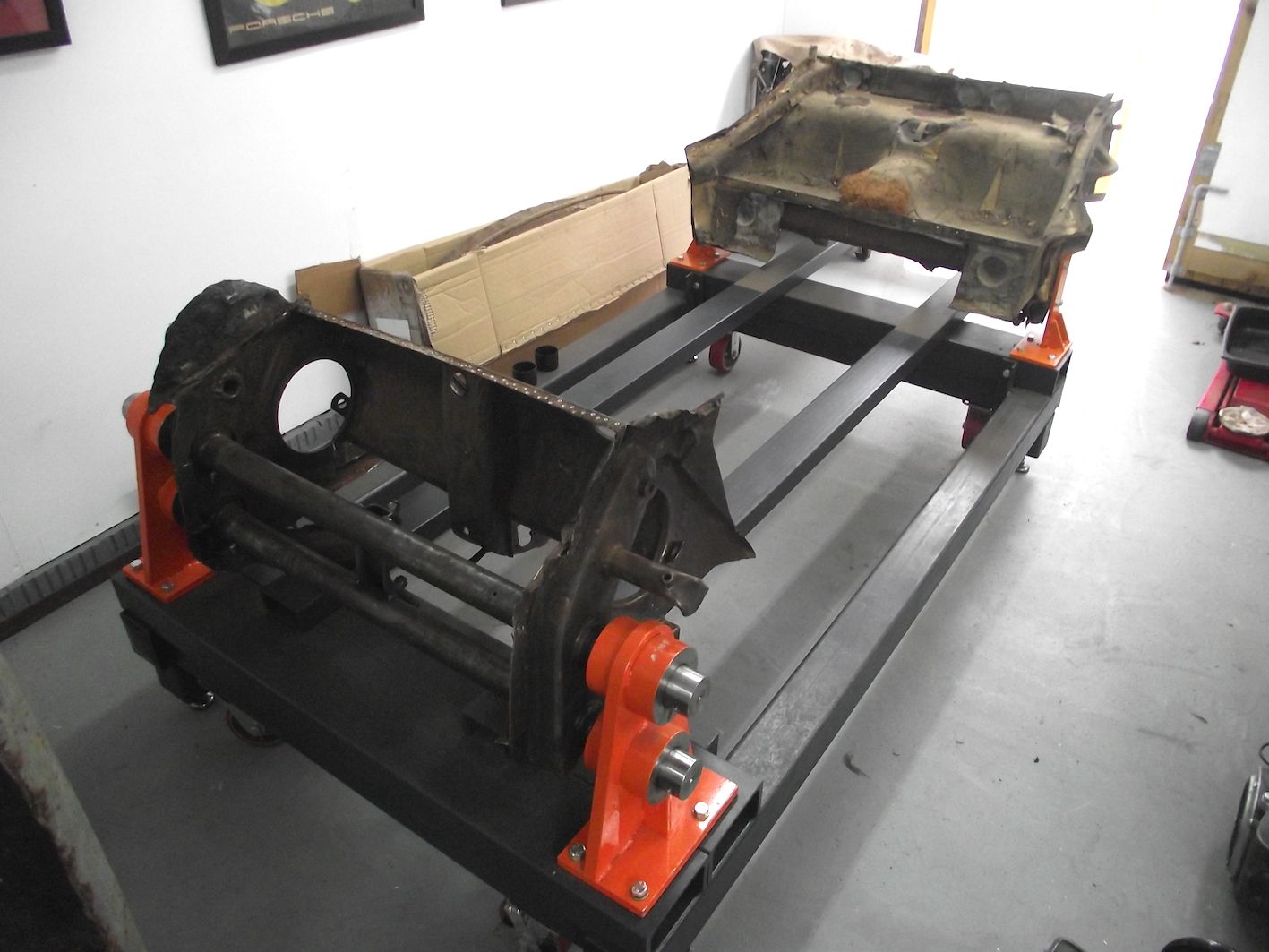

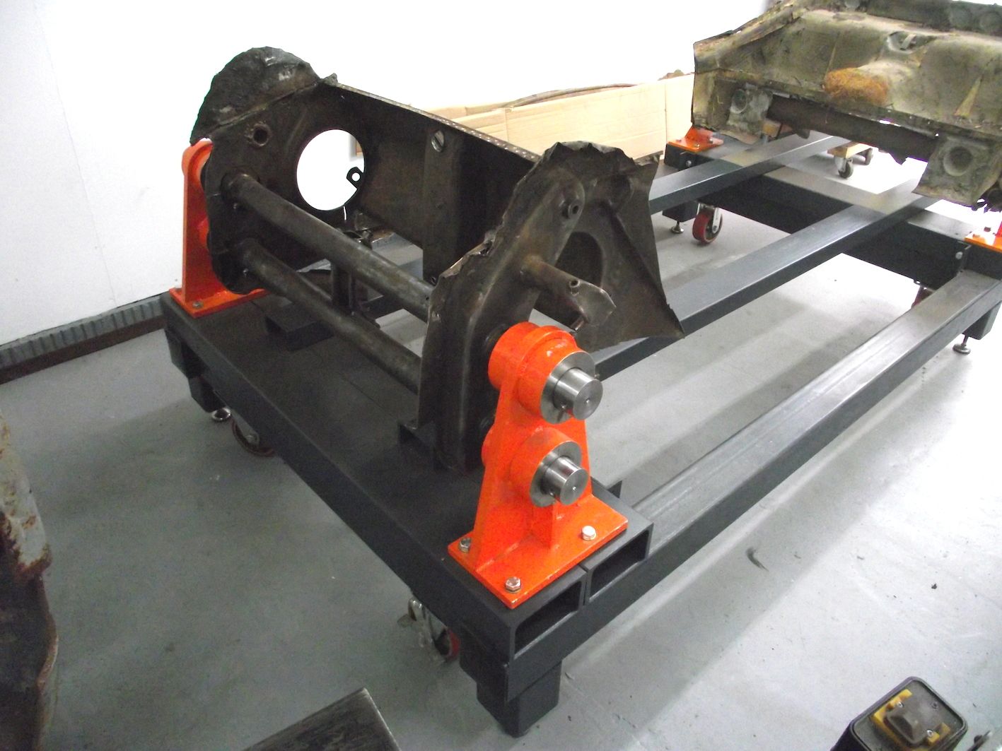

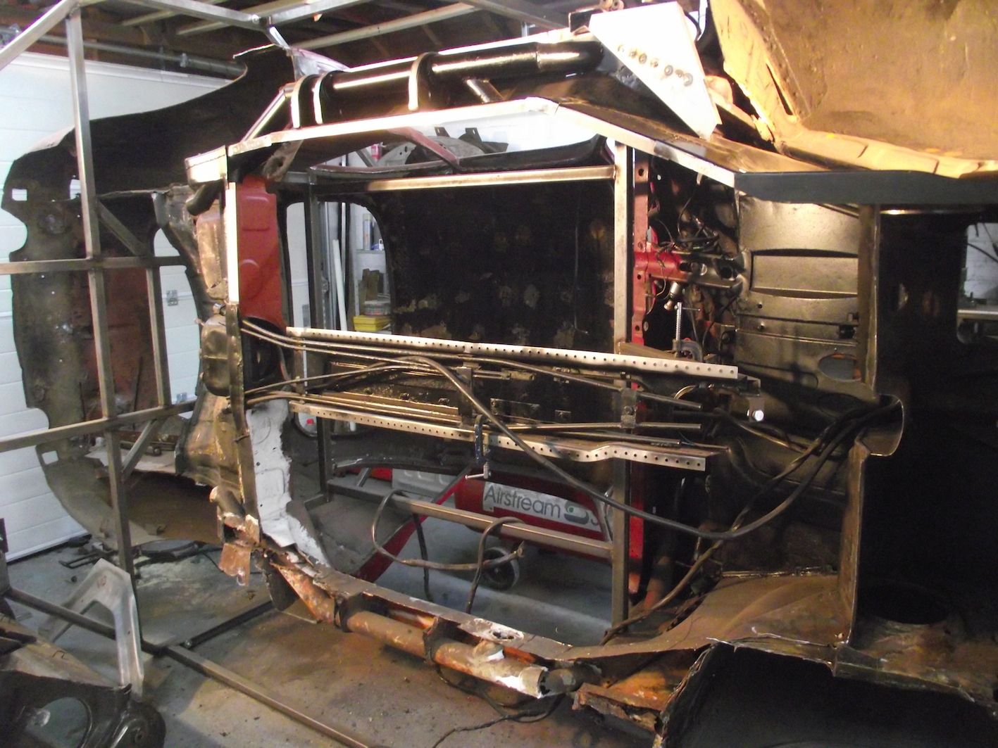

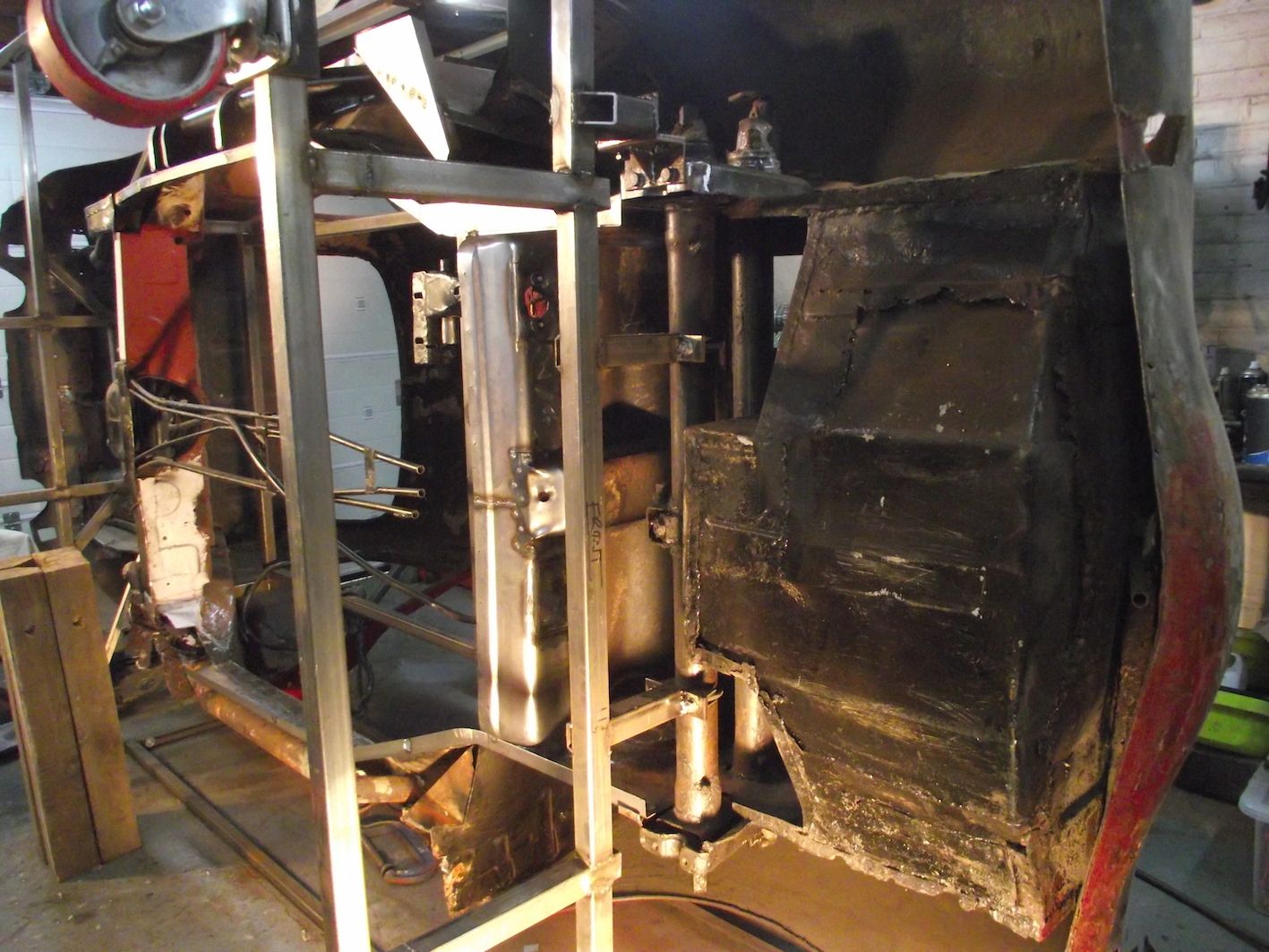

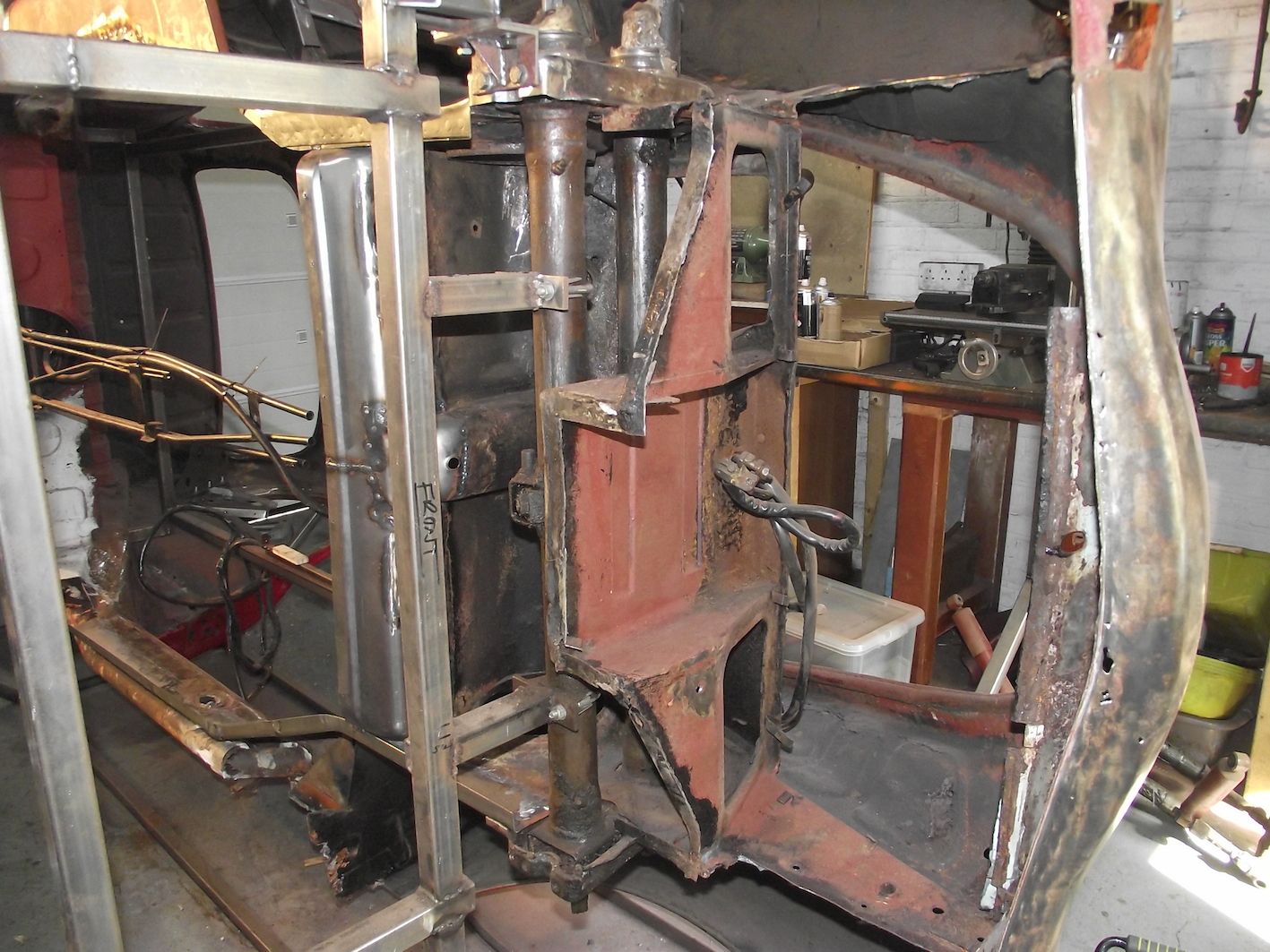

            • I like that "baby Cellette"....my description. Anything more you can share about that would be interesting. Cheers, John
              • Hi Roy
                I've always been a bit scared of Plasma cutters but I will have to look into it, thanks for the info.
                Hi John

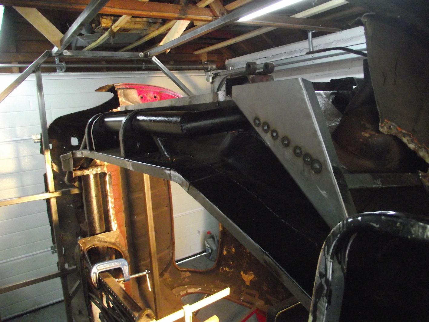

                The 'Baby Cellette' (by the way I like the name) started out as a simple 'heavy duty' dolly that I welded together out of box section steel, added castors and levelling feet at each corner.
                It served me well as a checking jig to make sure my projects were within factory spec.
                But when the Con 'D' project started to take shape I had to upgraded it, with 'U' channel cross beams and longer smaller 'U' channel beams running the entire length and beyond to take the rearmost trans hoop mounts.
                The front torsion bar mounts were purchased from a guy in Norway or Denmark, he was advertising them on the Samba, they are beautifully made.
                But these front mounts didn't come with the pins so I had a local engineering company turn some for me.
                The rear torsion bar mounts and the long rear trans hoop mounts were my own design and I got a company to laser cut all the parts and then I welded them together.
                It is now a rock solid and millimetre accurate platform that I can use to build complete chassis on.
                If anyone needs more info, dimensions or drawings let me know and I might put up a separate building thread.

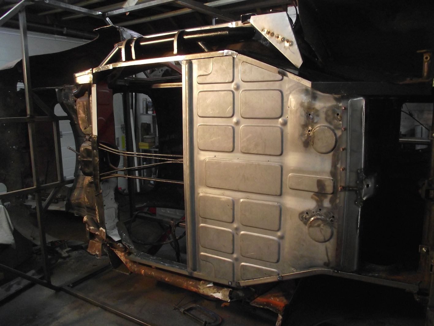

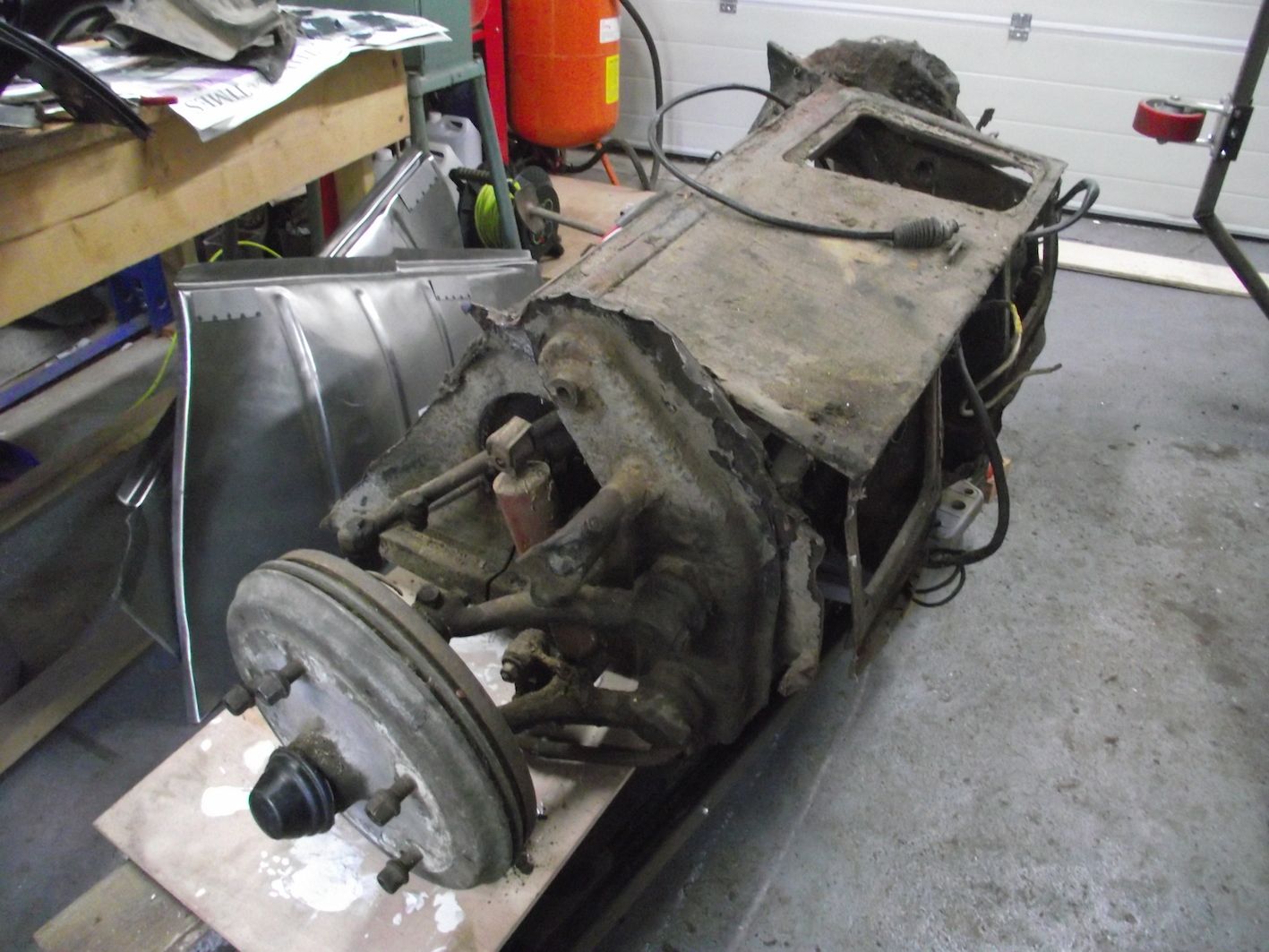

                OK back to the bodywork and the front floorpan has been trimmed and trial fitted.
                Click image for larger version  Name:	DSCF8262_sml.JPG Views:	172 Size:	161.9 KB ID:	105740
                One thing I did notice was that the two rear most stampings (upper most and lower most in the picture) overlapped the perimeter sheet metal.
                But after checking out Justin's original Carrera pictures it seems that the factory just hammered these flat where they meet and so that's what I did and it has worked out fine.

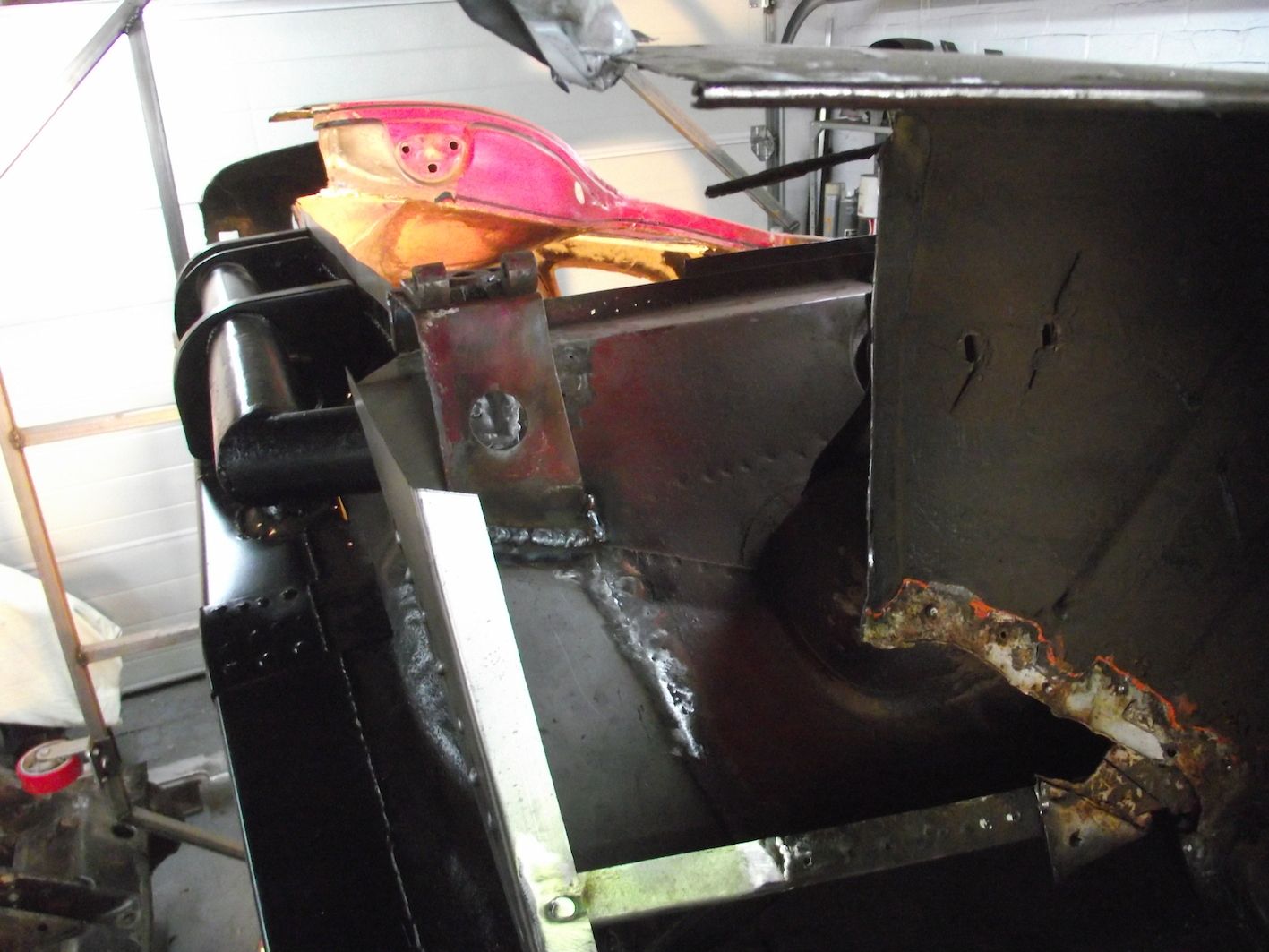

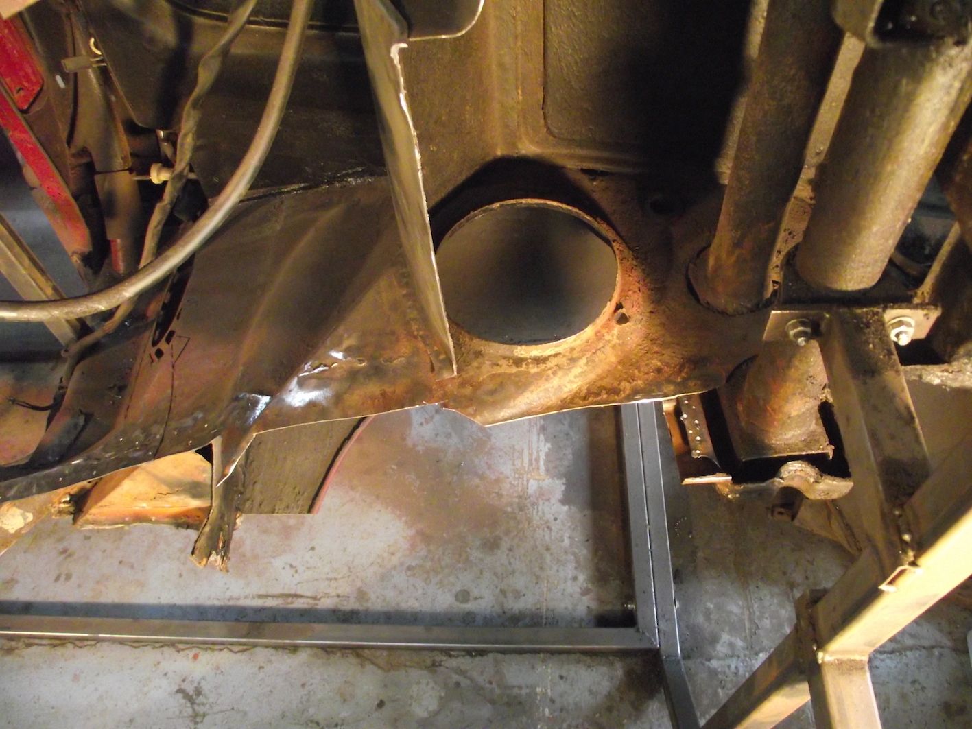

                  • Hi Guys
                    I got very excited with the front floor pan fitting so well that I almost started punching holes and plug welding it in, until it dawned on me that the outer longitudinals need to be welded on first.
                    When I thought about it, if the floorpans are installed there is no way to clamp the outer longitudinal up really tight.
                    A lesson learned and proof that there is a very logical order to rebuilding these cars, deviate from that at your peril.

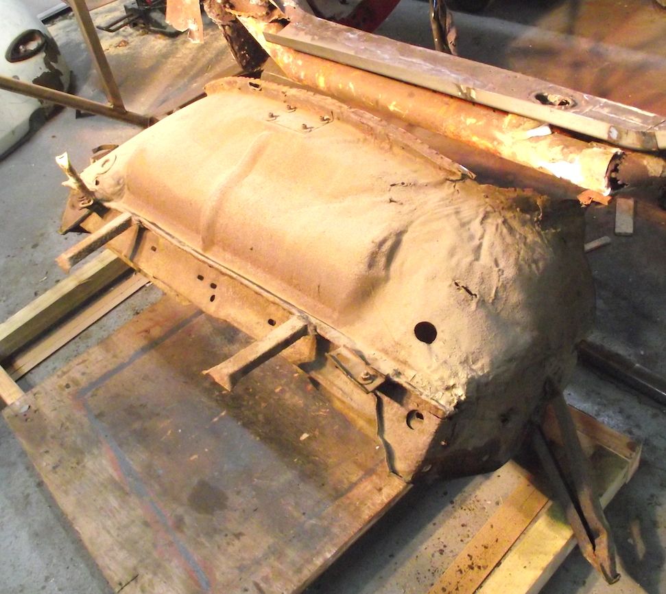

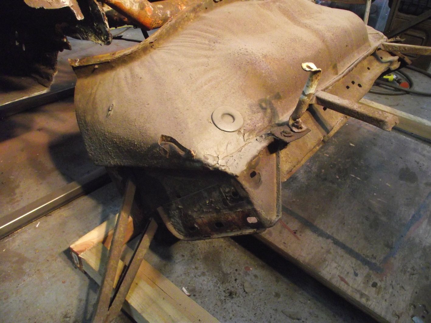

                    Click image for larger version  Name:	DSCF8285.JPG Views:	92 Size:	180.0 KB ID:	106270Click image for larger version  Name:	DSCF8284.JPG Views:	90 Size:	163.3 KB ID:	106269

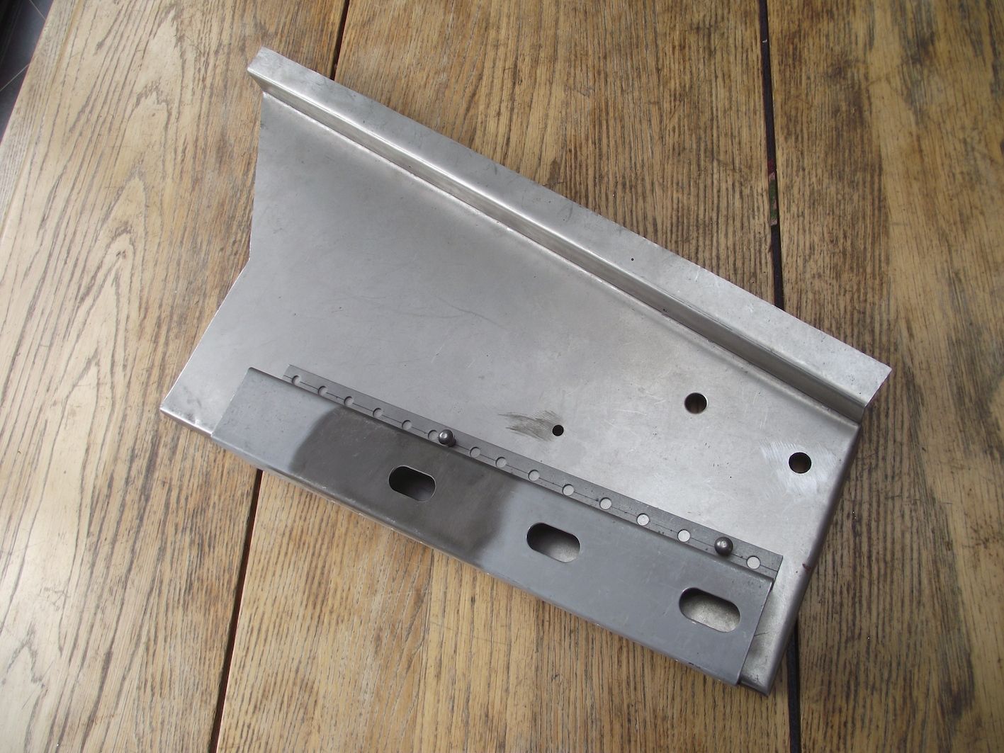

                    As a bit of light relief I have also attacked the old patched battery box, I am fabricating my own side panels as I need a bit more length to get past the rot and I need to position the wiring conduit tube so having panels without holes will give me some flexibility.
                    Click image for larger version  Name:	DSCF8283.JPG Views:	72 Size:	242.7 KB ID:	106273 Click image for larger version  Name:	DSCF8267.JPG Views:	92 Size:	257.3 KB ID:	106272 Click image for larger version  Name:	DSCF8288.JPG Views:	91 Size:	242.6 KB ID:	106271
                    Removing all the sheet metal behind the nose panel will also allow me to tackle the rotten and dented nose without removing the whole front section (fingers crossed).

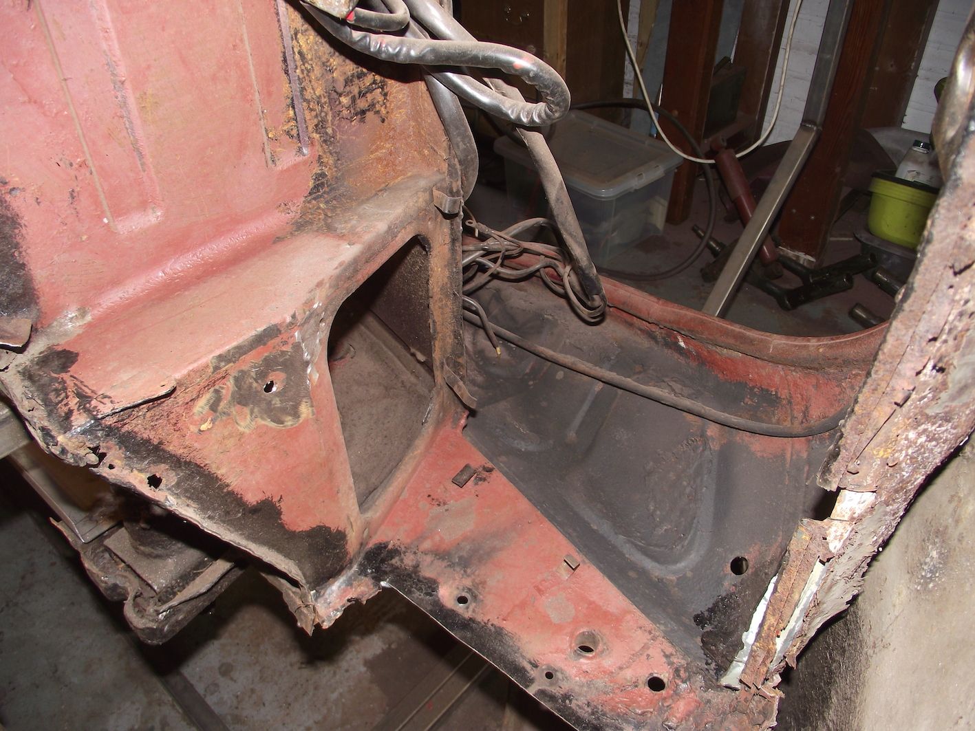

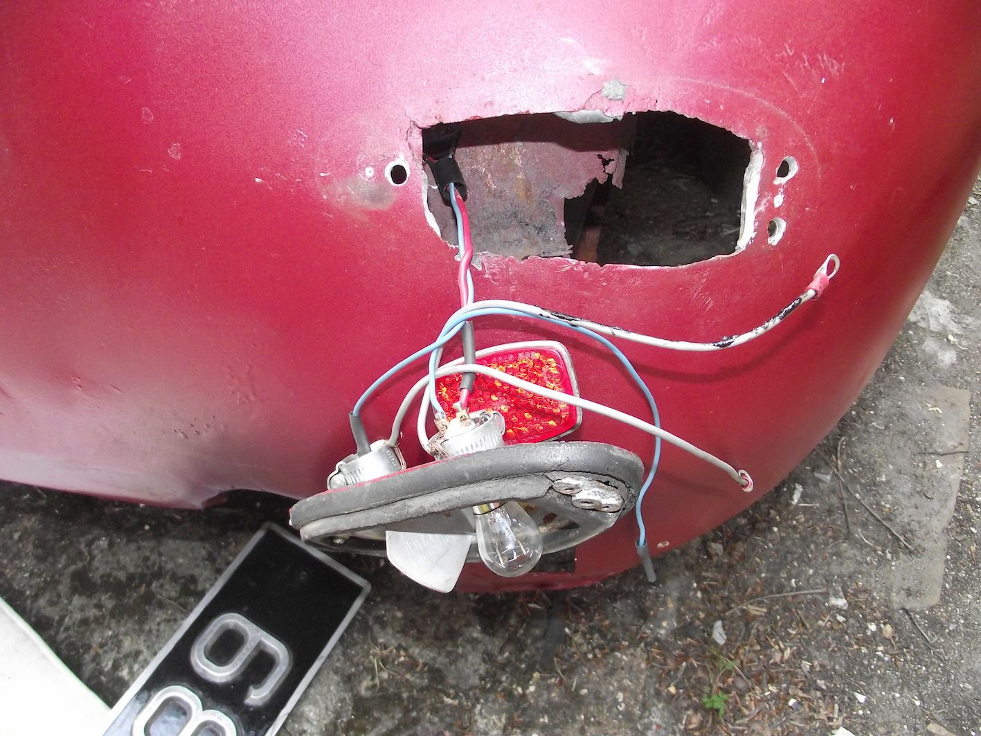

                    • Click image for larger version  Name:	WP_20141017_12_39_04_Pro.jpg Views:	0 Size:	259.3 KB ID:	106654 Click image for larger version  Name:	WP_20141017_12_38_50_Pro 1.jpg Views:	0 Size:	320.3 KB ID:	106655Click image for larger version  Name:	DSCF6116_sml.JPG Views:	0 Size:	282.5 KB ID:	106657 Click image for larger version  Name:	DSCF6121_sml.JPG Views:	0 Size:	250.2 KB ID:	106656
                      But help was at hand...
                      More soon
