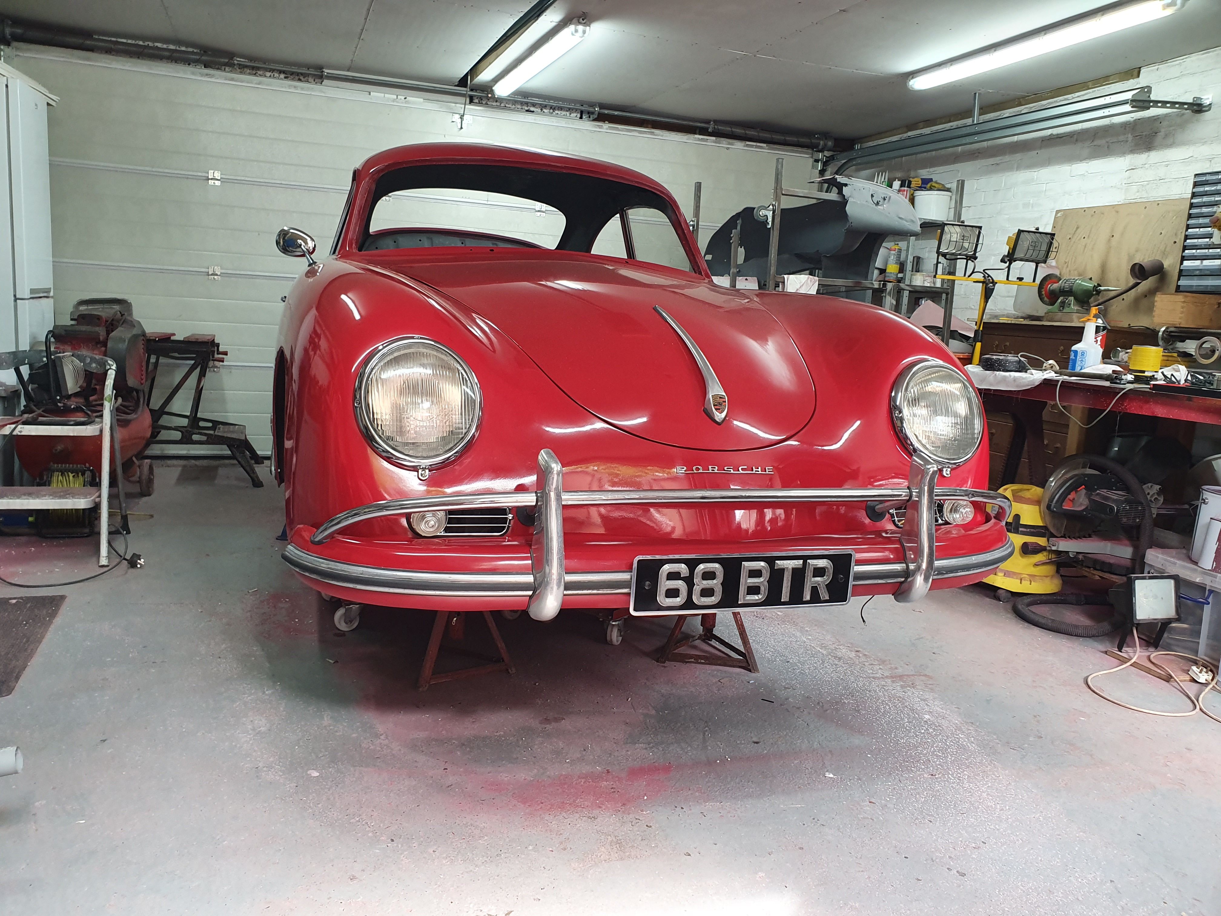

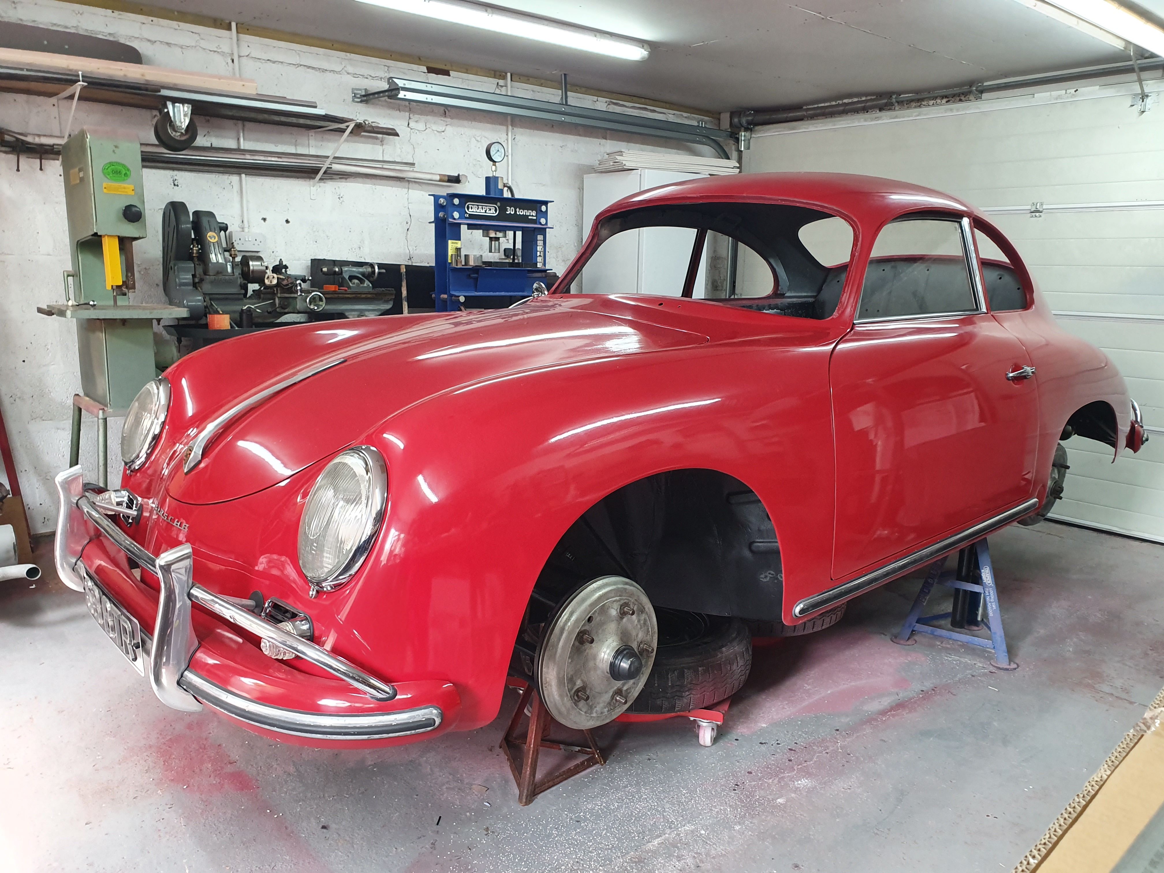

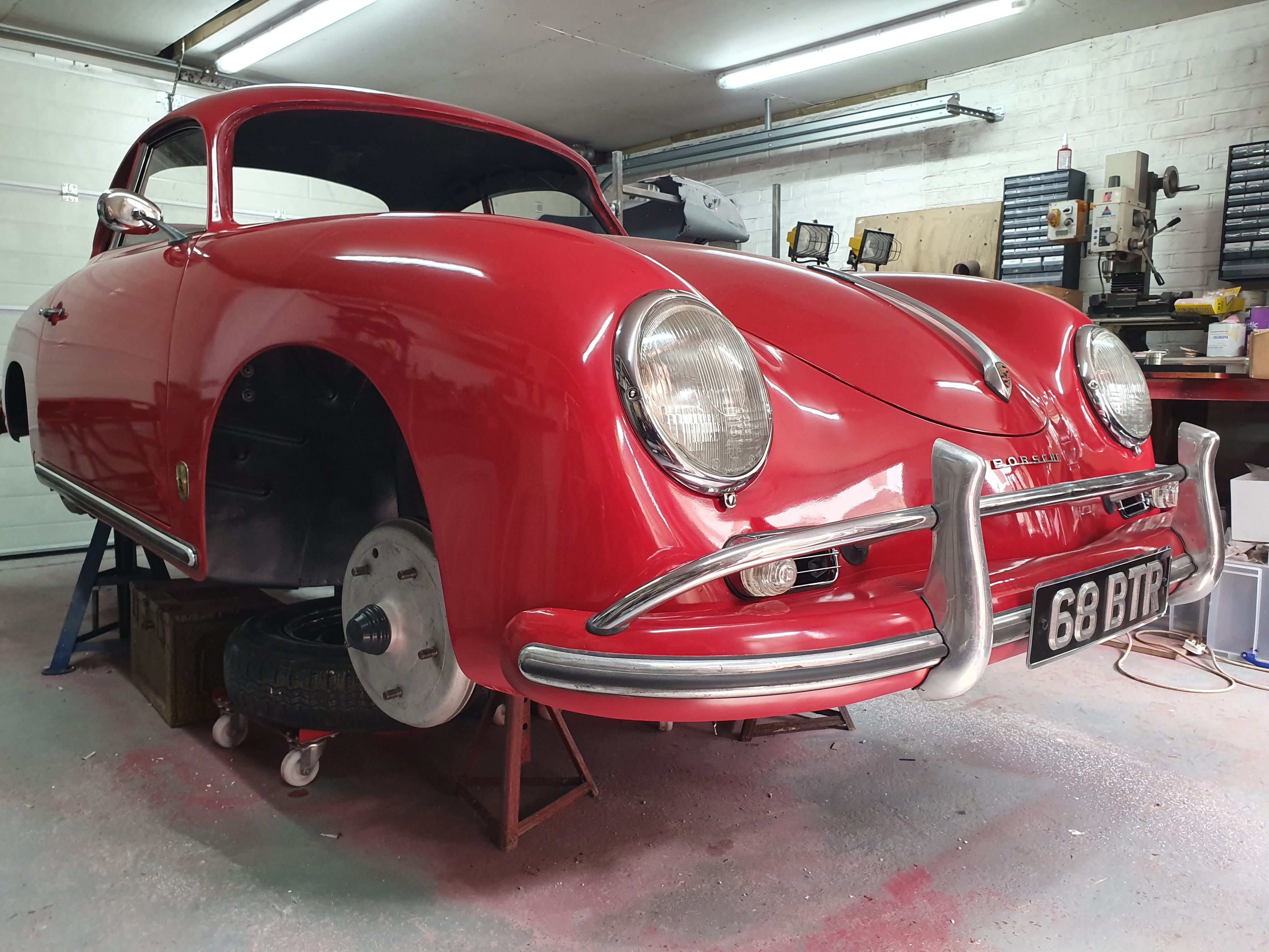

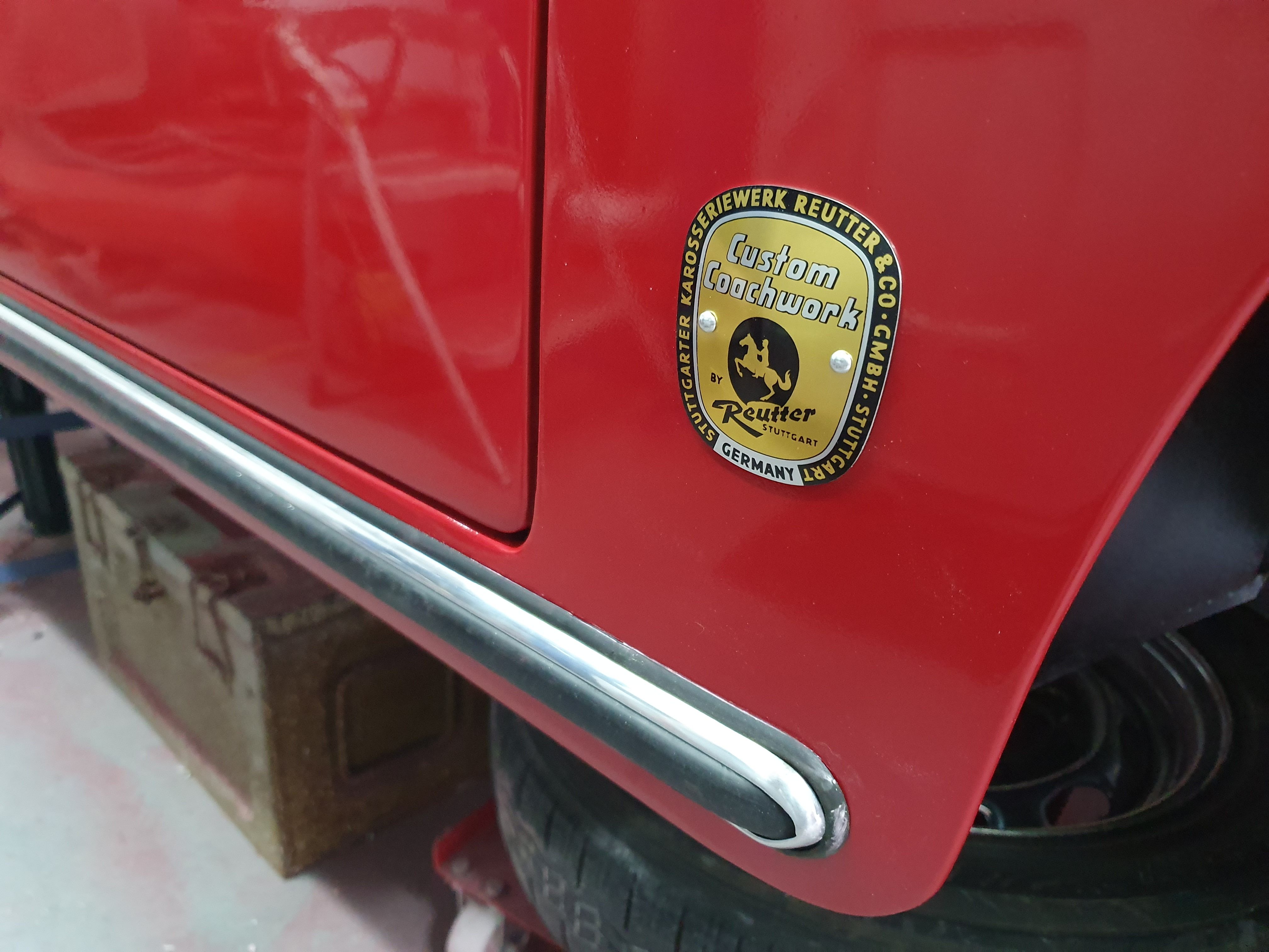

      OK so the build moves on, door glass and frames are in, headlights are in and some of the small details are being fitted.

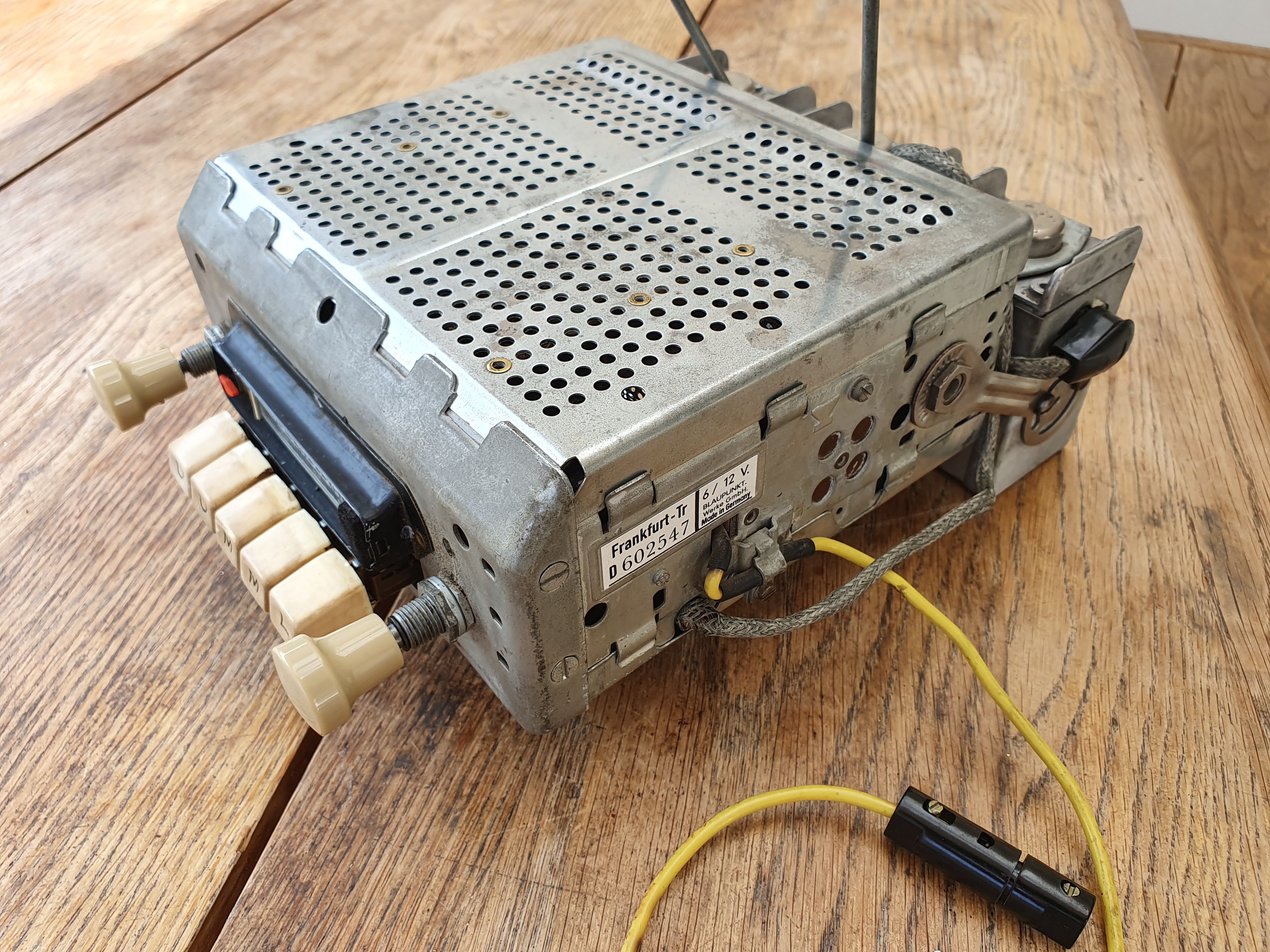

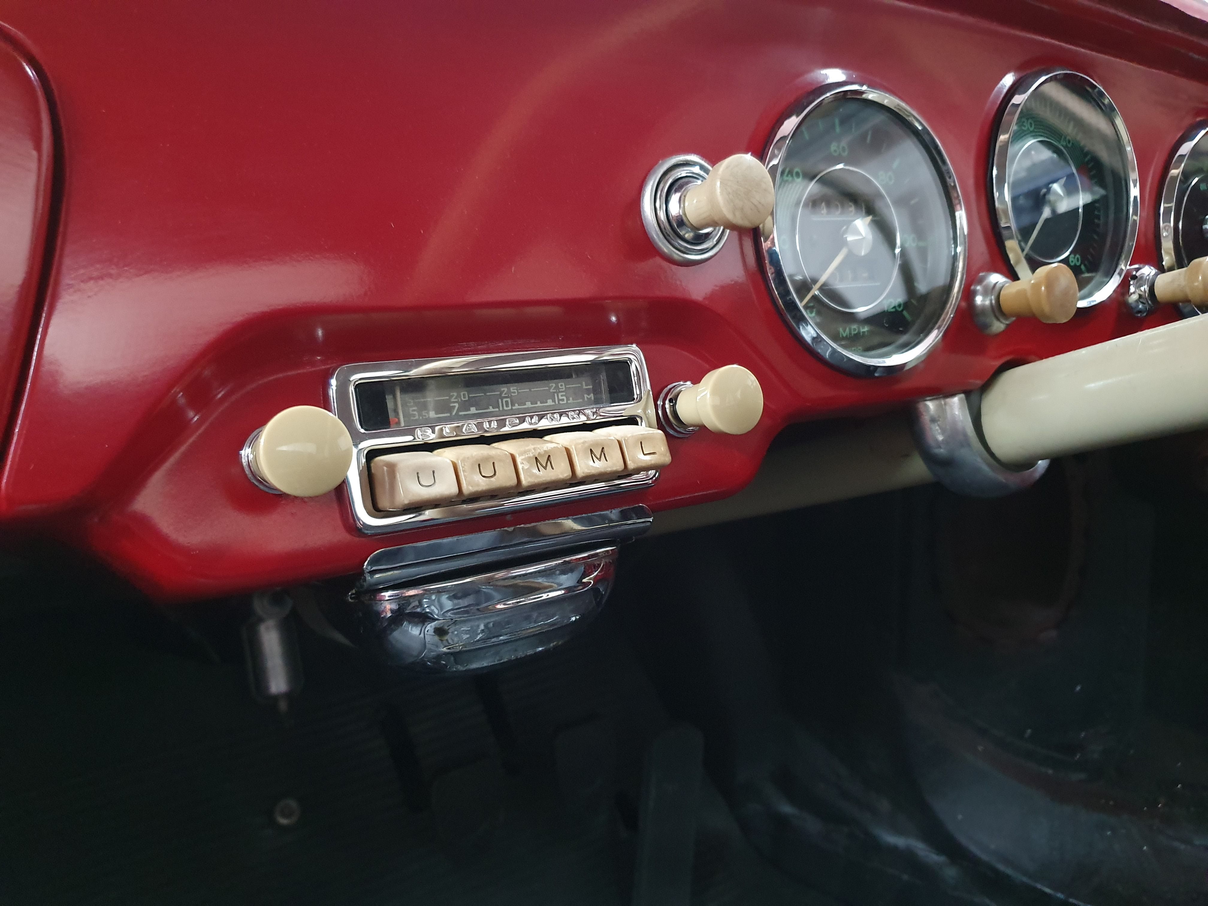

        I have been collecting Blaupunkt radios over the years and this one is the best I have. It's a 1960 Frankfurt Tr which is a part valve, part transistor radio.
        It was top of the range in it's day and works beautifully with a really mellow valve sound.
        I forgot to re-chrome the faceplate so that has gone off for plating.

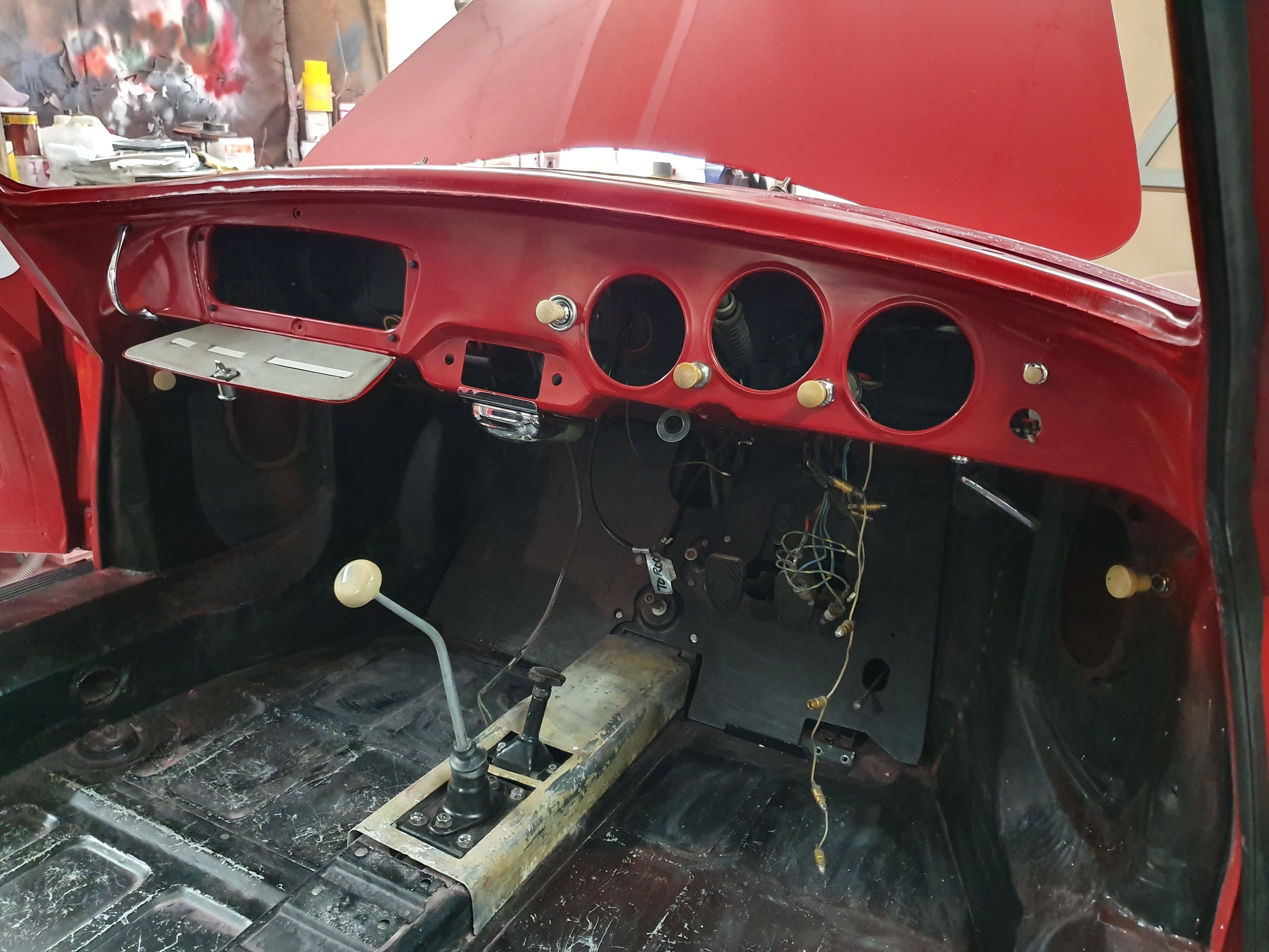

        Dash is coming along with knobs and switches going in, from the start of this restoration I decided to keep the original wiring harness and I'm glad I have as the new harnesses are all LHD and not quite right for a RHD car.
        Just one little problem, the glove box lock wont unlatch so if anyone knows how to solve this issue please let me know otherwise I will have to source another one.

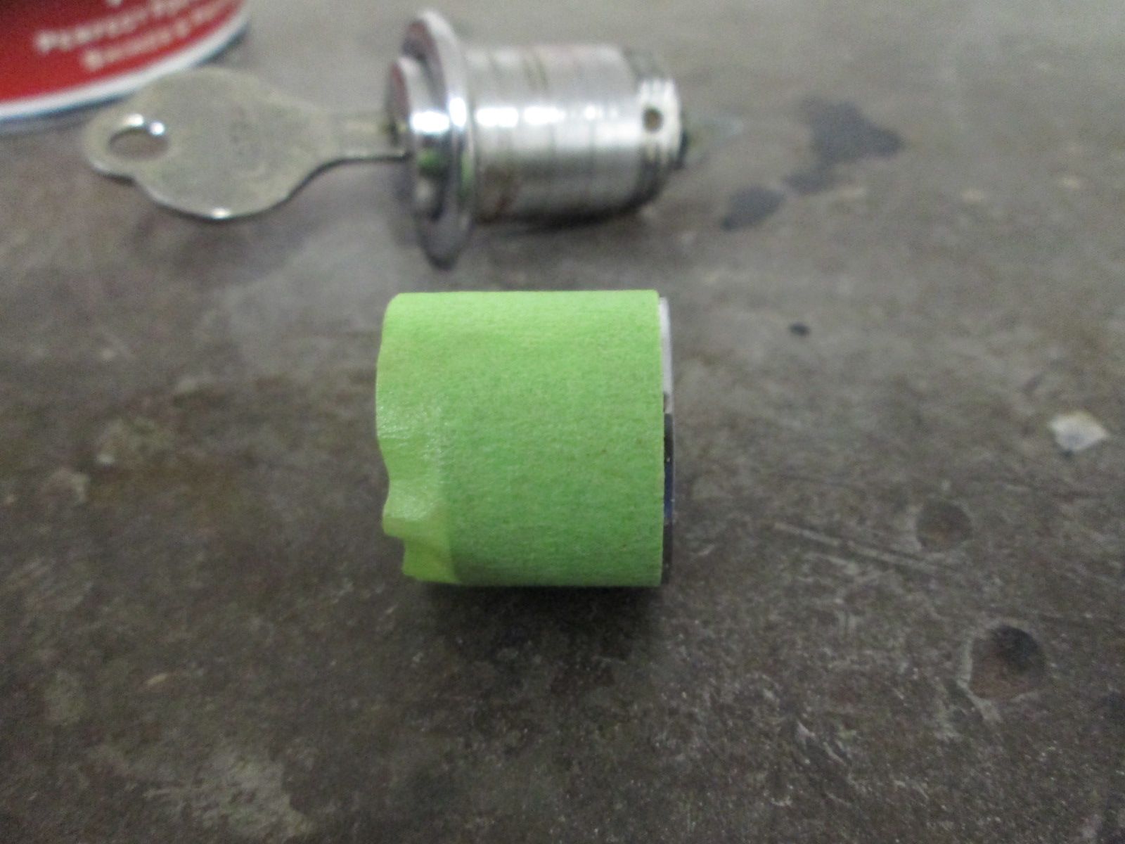

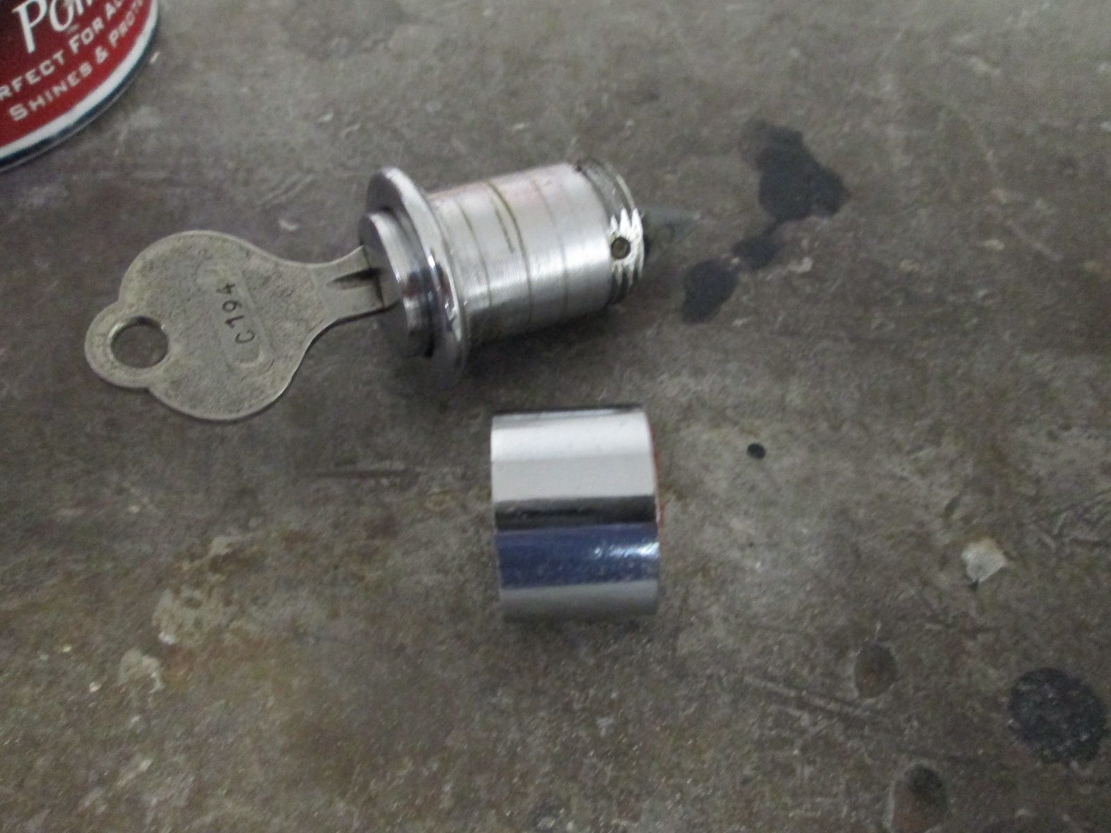

        • Its looking great in there Drew! This is really the most fun and rewarding part isn't it? I had the same issue with my glove box latch as it wasn't the original to my car.
          Click image for larger version  Name:	carrera 2602.jpg Views:	0 Size:	200.1 KB ID:	114286 You're probably having the same issue where the hook just isn't reaching deep enough to catch on the back of the jamb. After some messing about I realized that this chrome beauty sleeve also double as a spacer. You could mock it up without the ring and measure the distance needed for it to engage.
          Click image for larger version  Name:	carrera 2603.jpg Views:	0 Size:	177.3 KB ID:	114287 I cautiously starting filing slivers of it off until the catch firmly engaged. Hope this helps and keep up the great work! Justin
            Sorry about that Drew, I misread your earlier question; It wont unlatch. Do you have the key for it? If the "flipper tail" won't move when you push the button it means that it is in the locked position.

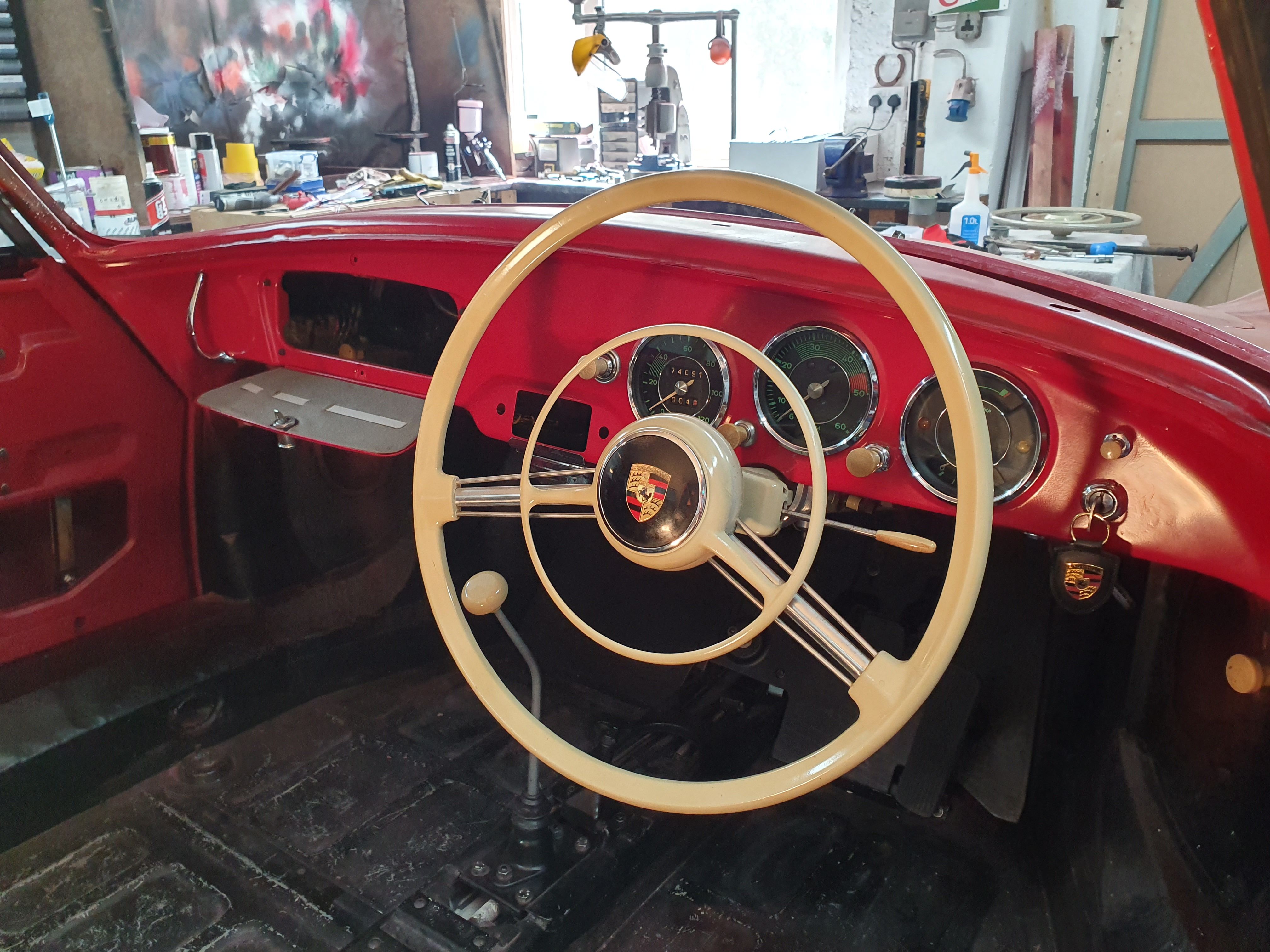

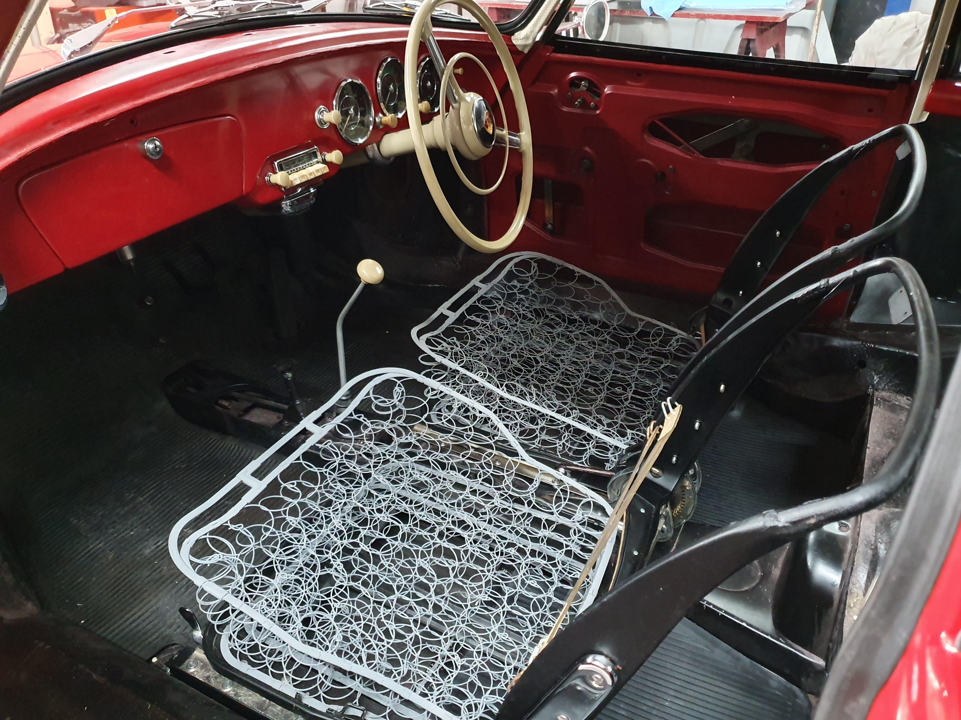

              OK all the instruments are in and in the correct positions for a RHD car (it took two attempts after stupidly following the LHD layout in my owners manual).
              Restored steering wheel and original horn button is now in place so we can now call the dash finished except fitting the radio and sourcing a new glove box lock.

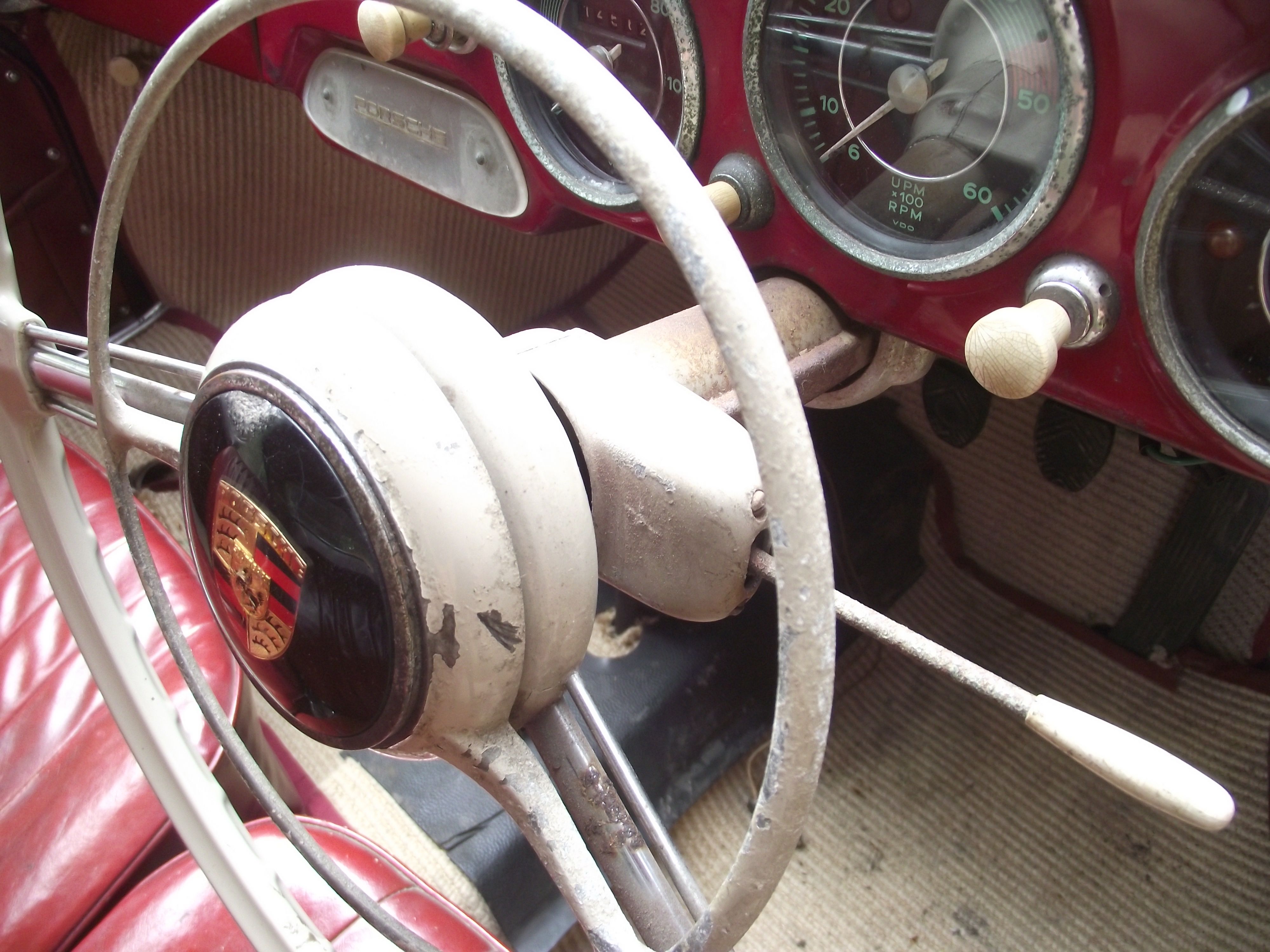

              Here is the dash as I found it, complete but in a very poor state.
              And here it is today.

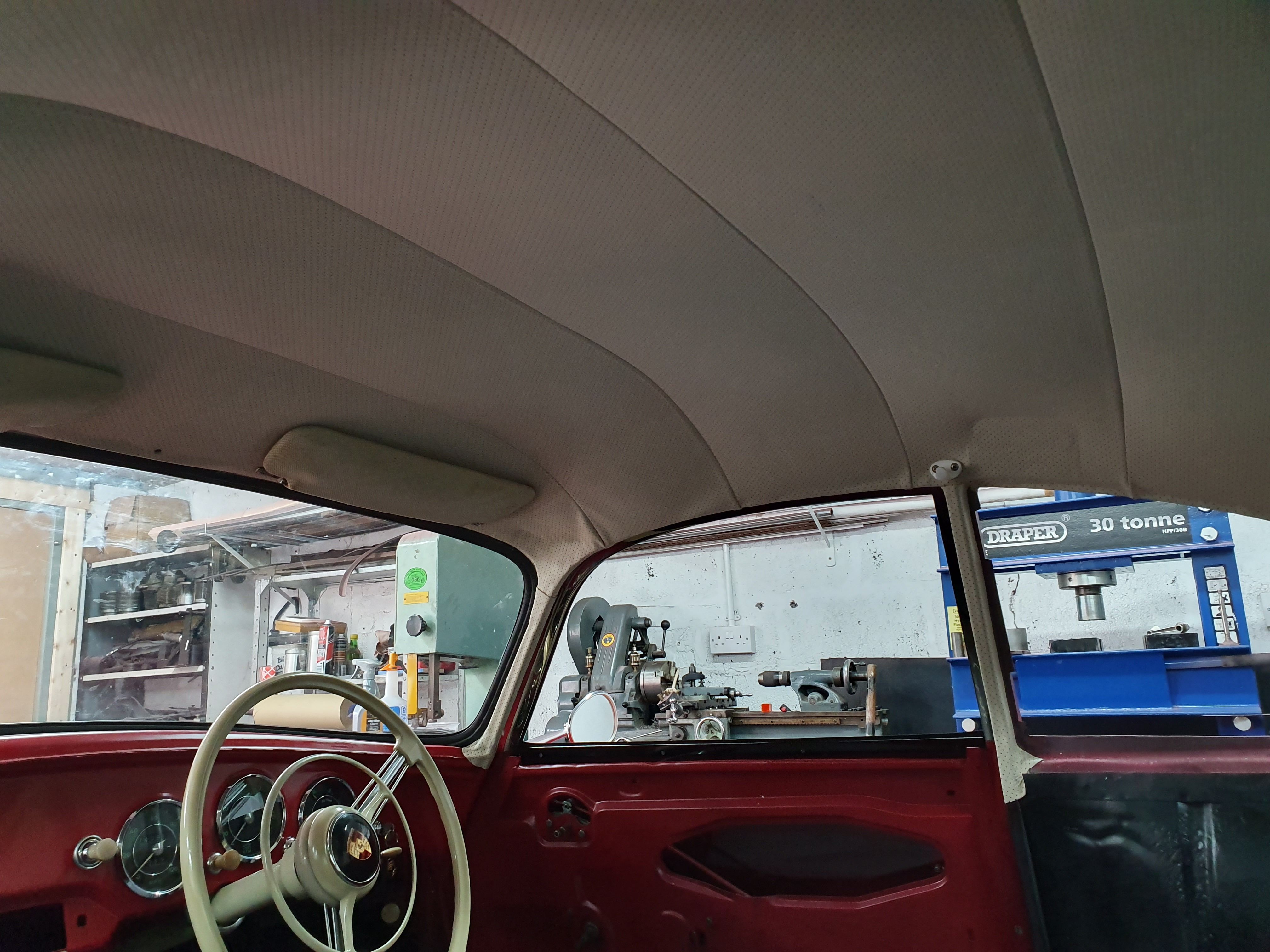

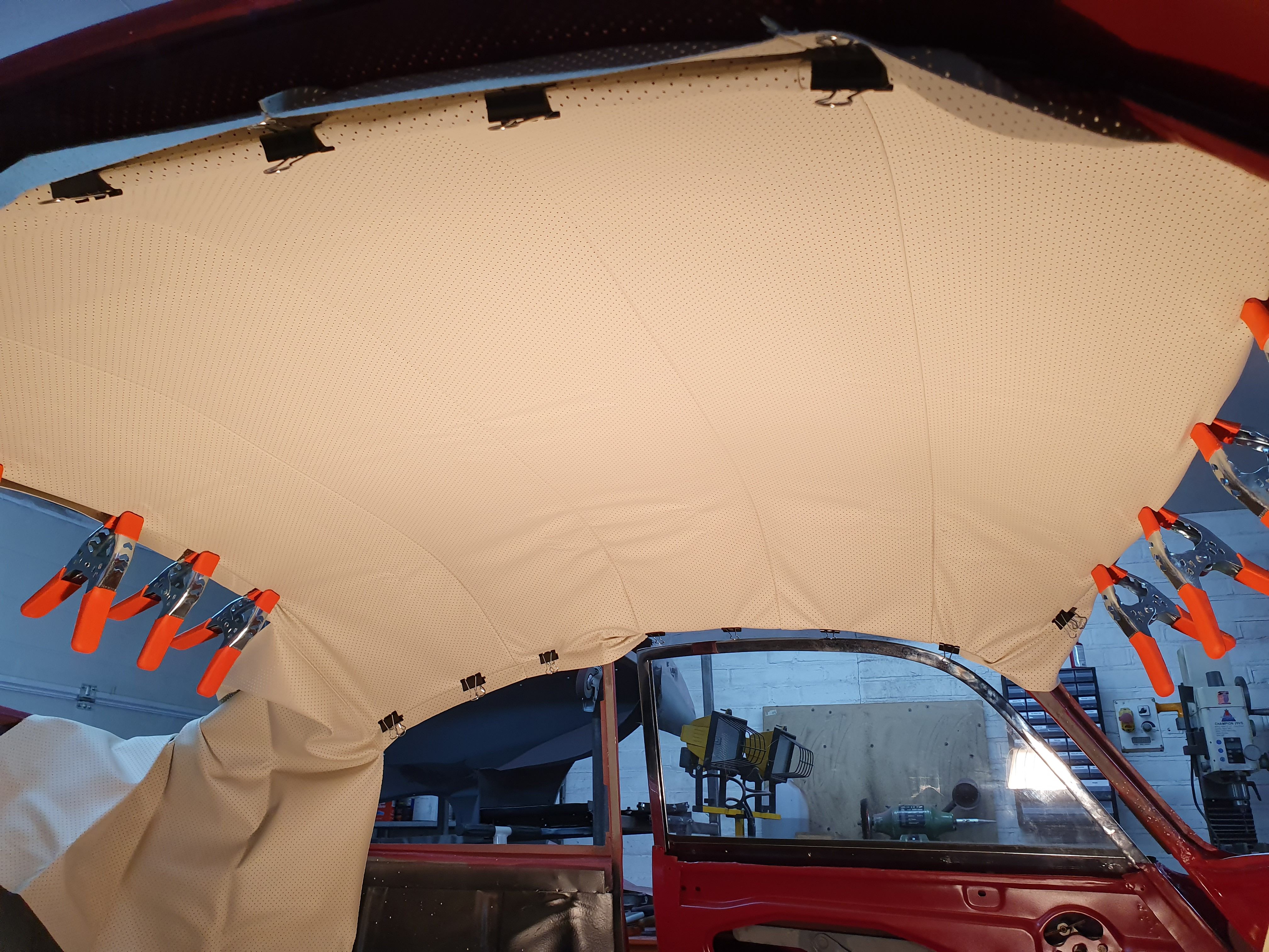

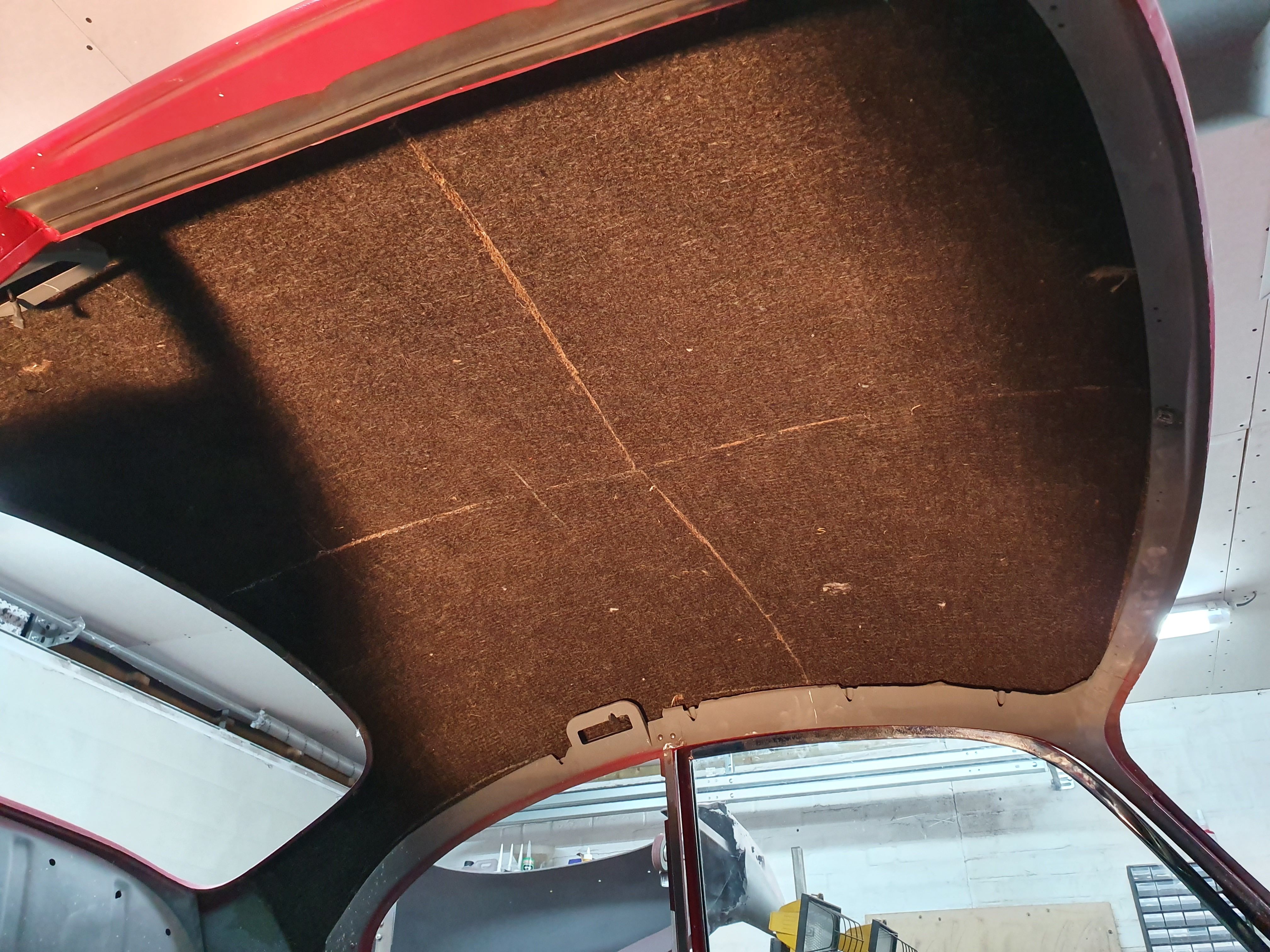

              • OK Guys here is the headliner going in...
                I opted for as close to original sound deadening material, it is a thick felt underlay material with a black rubberised side.
                Next up was the headliner, I followed Justin's write up but it was a fight every step of the way.
                I am happy with the final result and any persistent wrinkles will be removed with a gentle use of the heat gun.

                  Parts are back from the chromers so the radio has been fitted.

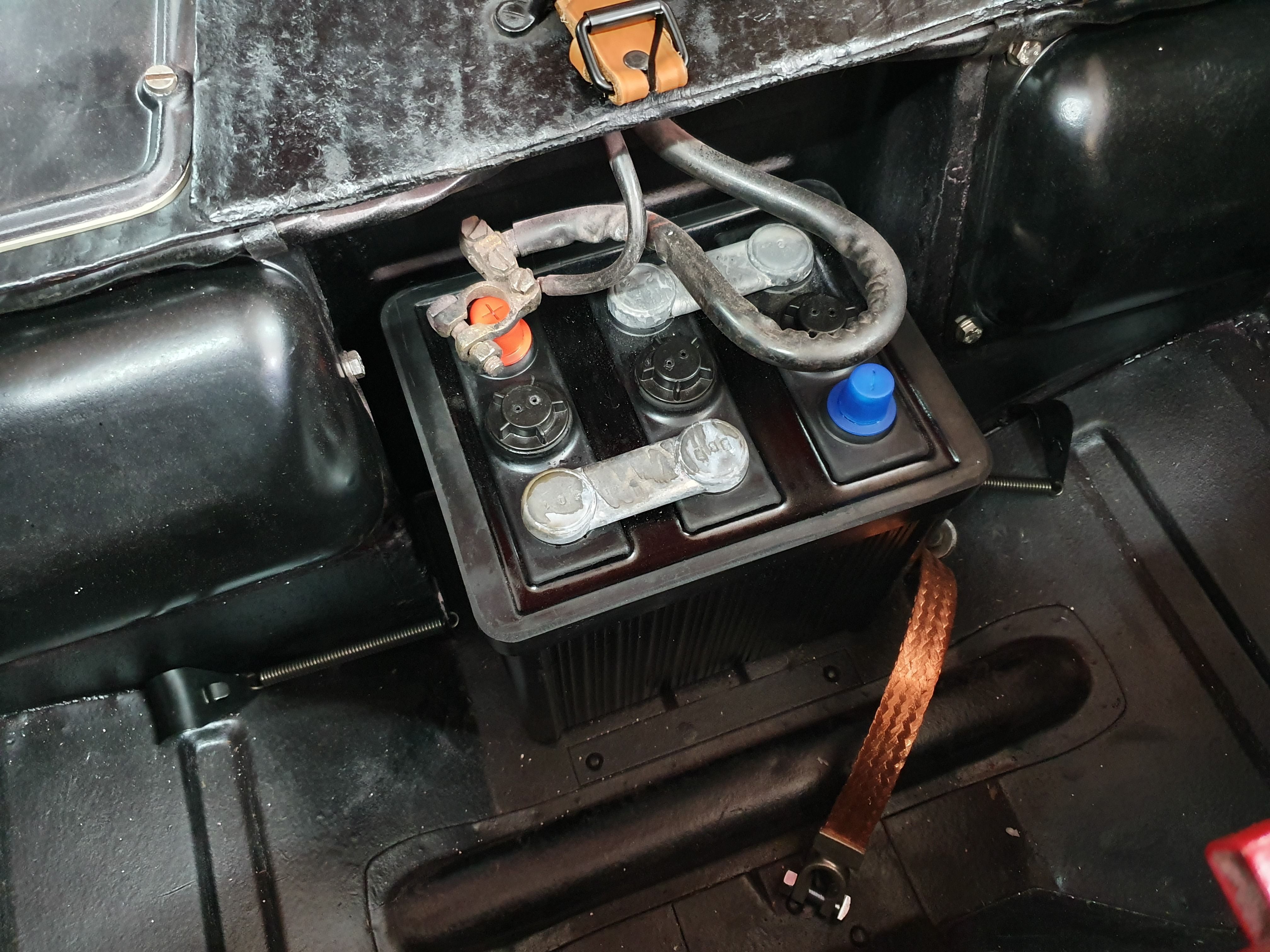

                  New 6V battery is in ready for connecting up.

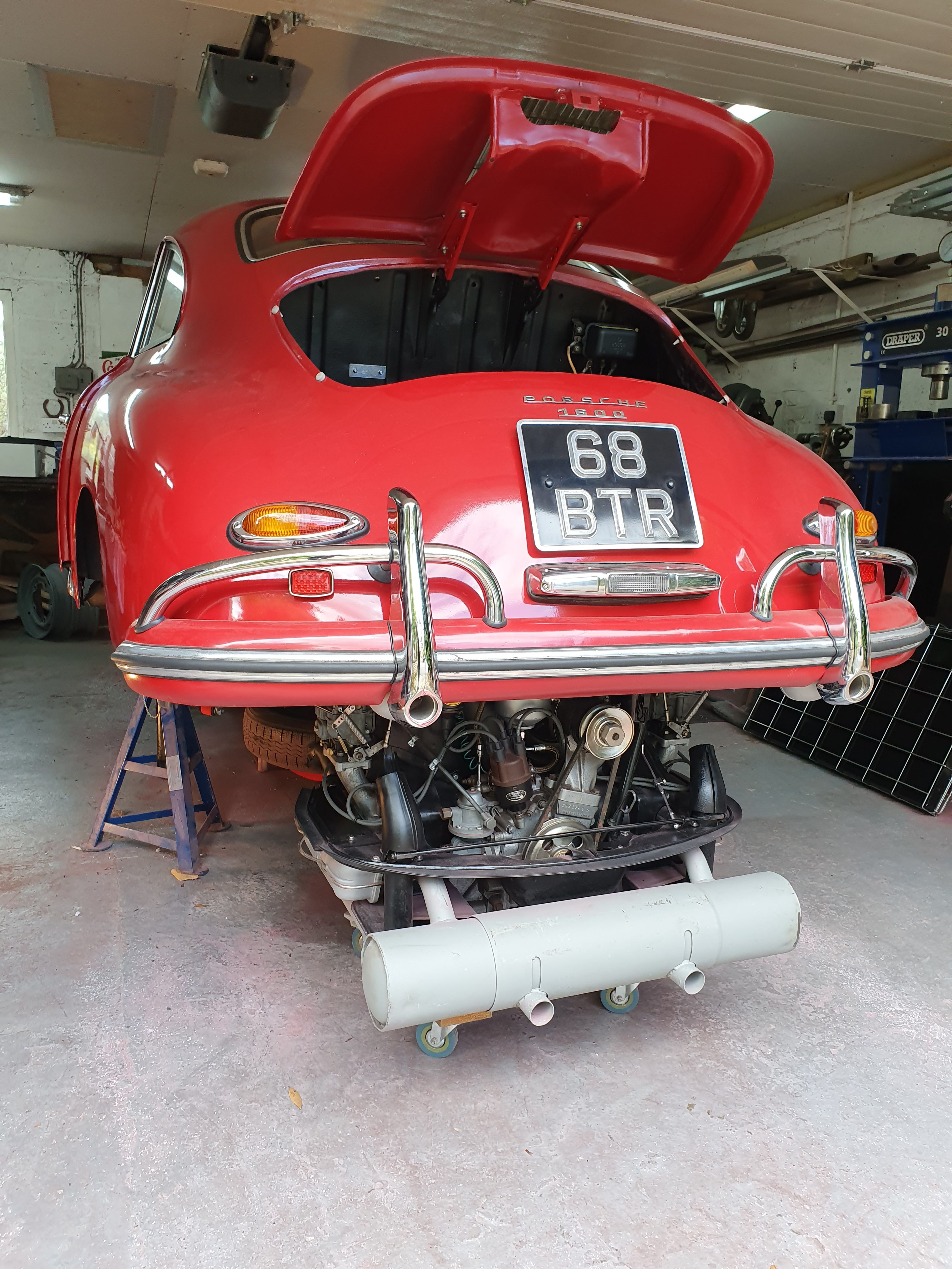

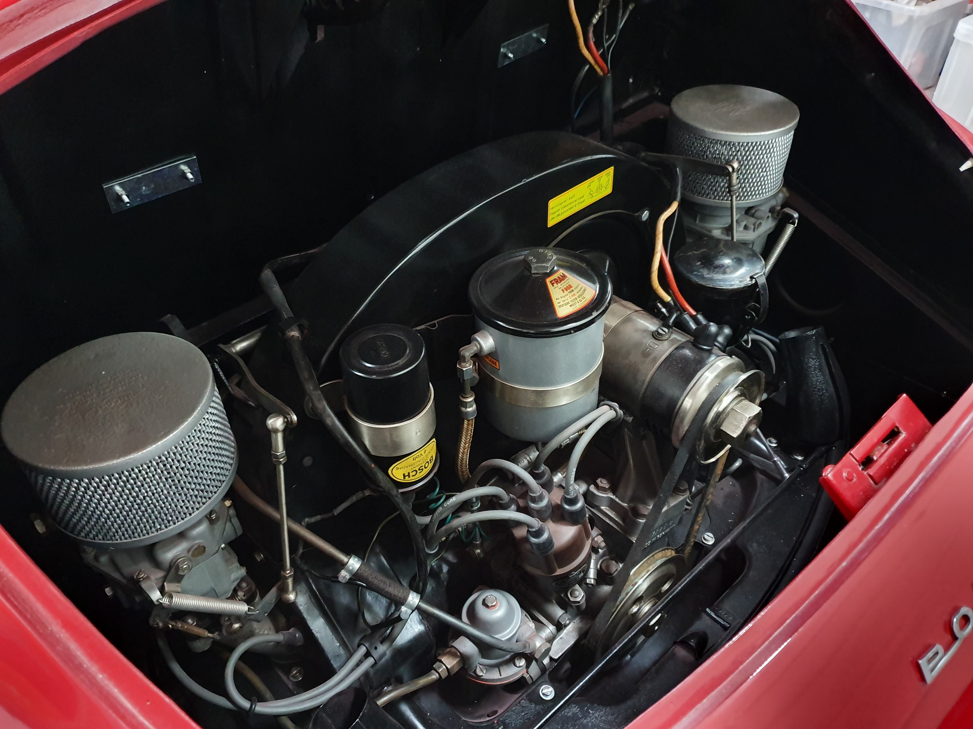

                  Rear quarter windows are in and finally the original engine is back in.
                  Getting very close to the end.
                  KTF
                  Drew

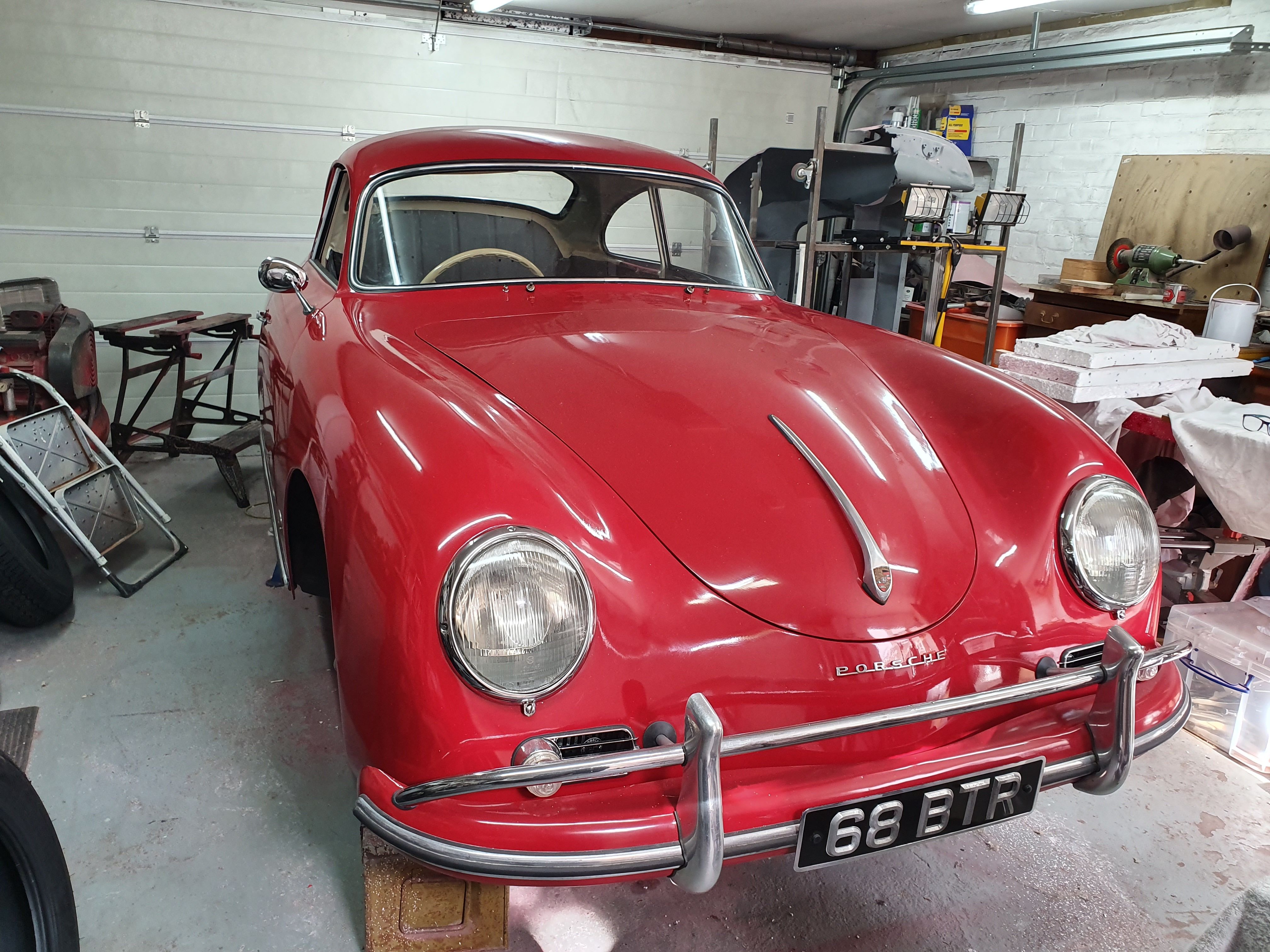

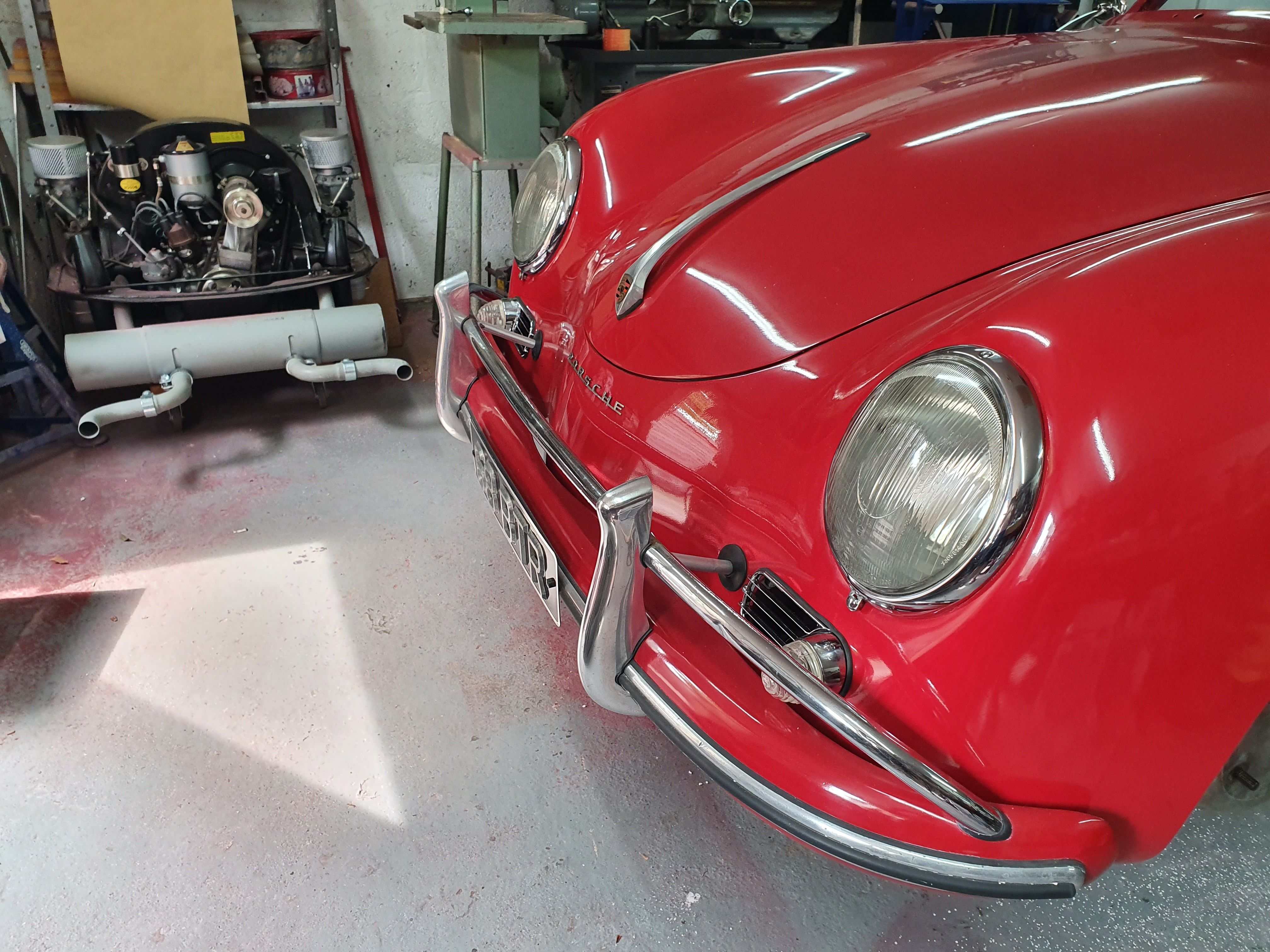

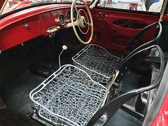

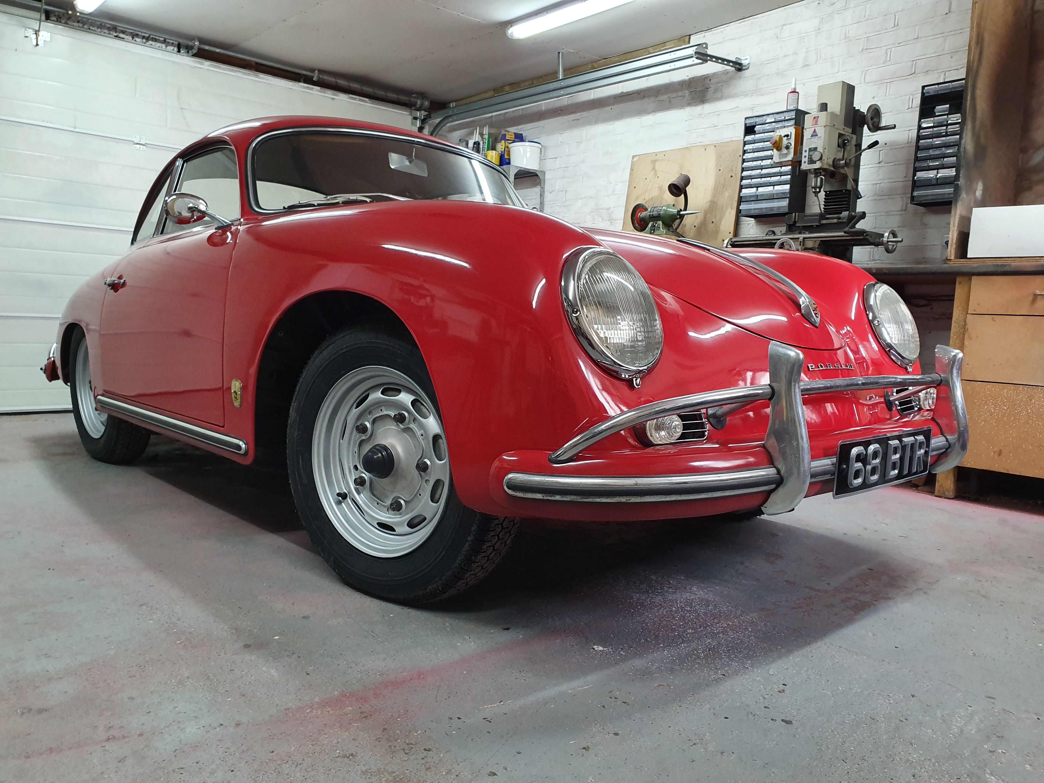

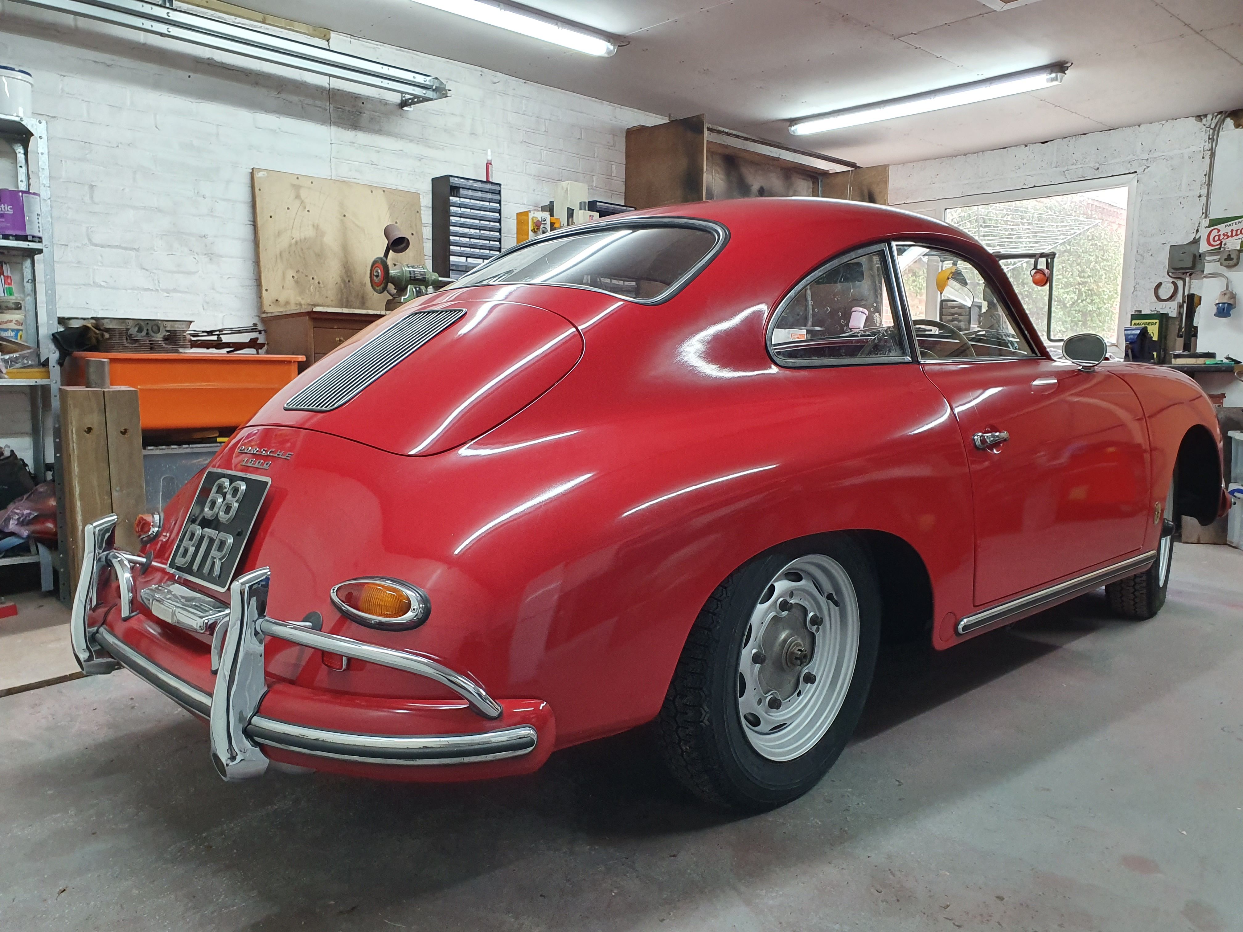

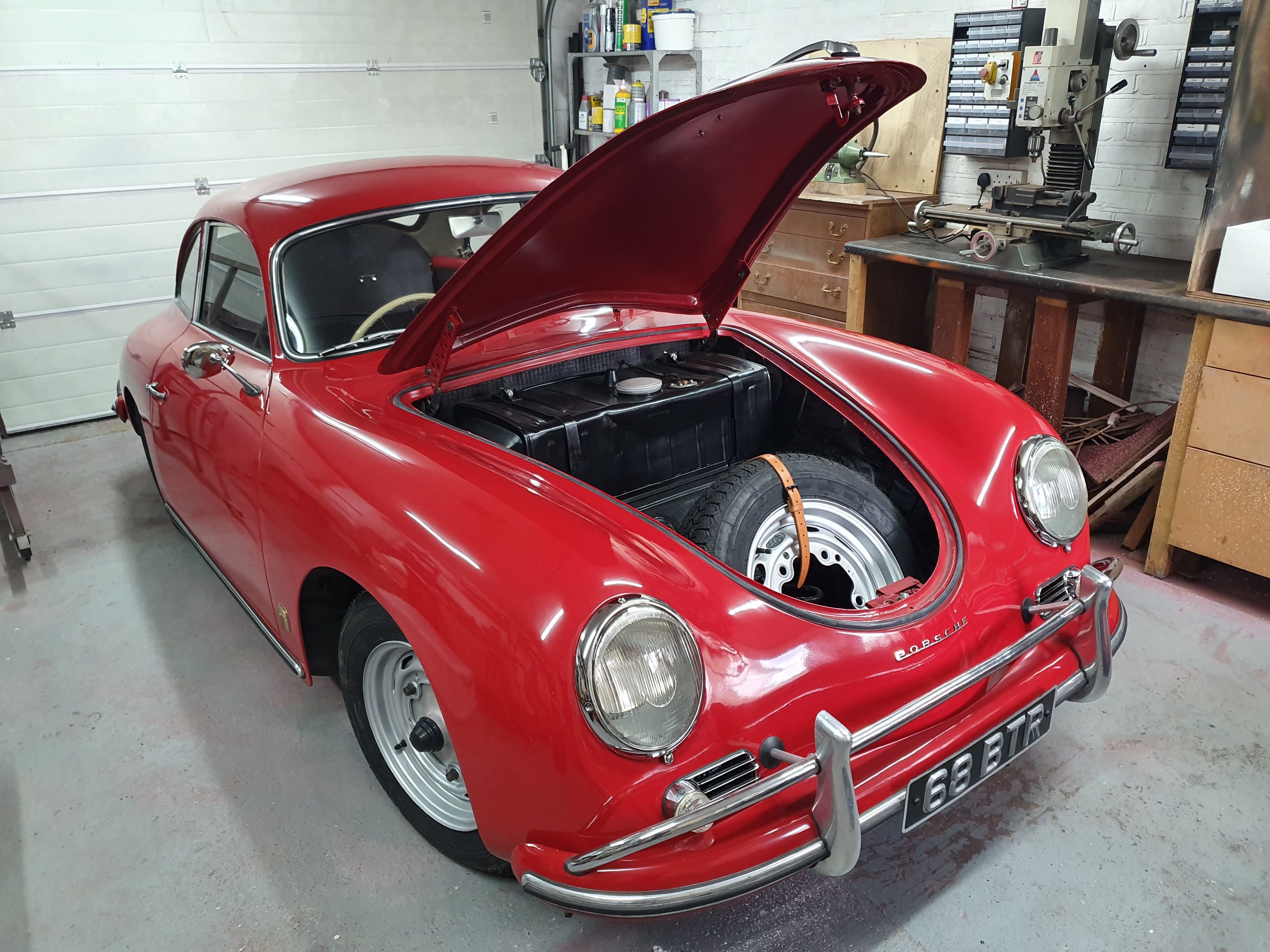

                    Here are a few pics of the almost finished car, if anyone is after a bargain just get in touch.
