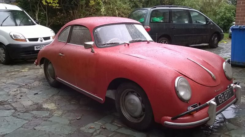

    Hi Guys

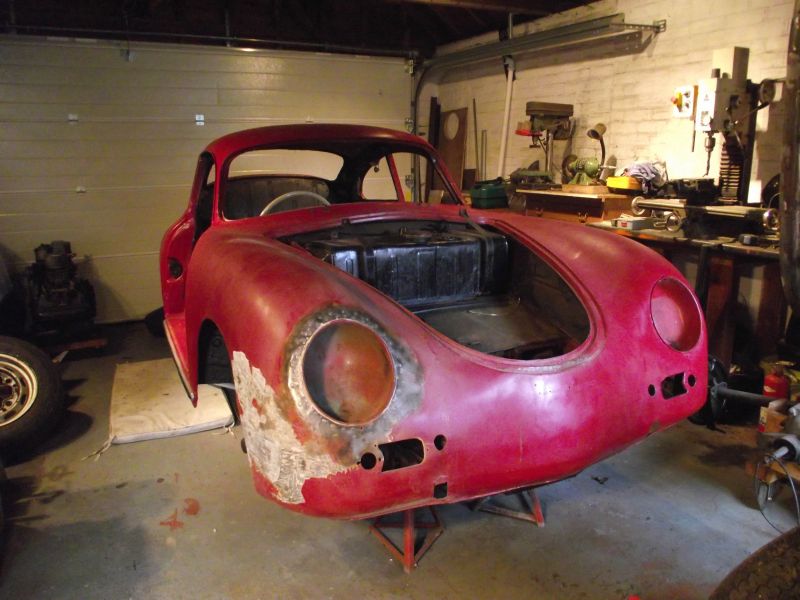

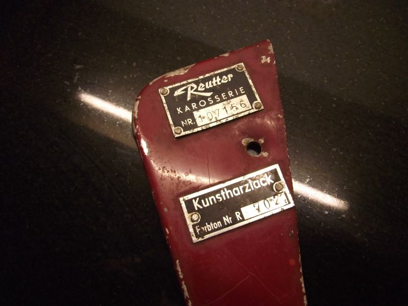

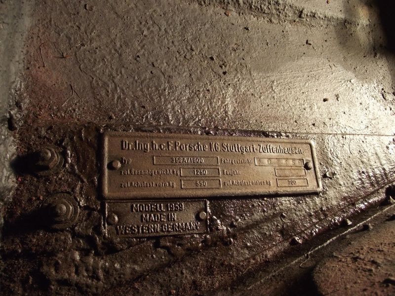

    So here we go again, another 356 in the workshop.
    The details are 1959 356A Right Hand Drive Originally a South African car imported into the UK in approx. 1964.

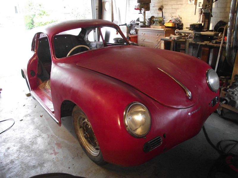

    The floors are new I would say 1980 vintage and poorly stamped and poorly installed.
    The outer longitudinals are the wrong profile and need to come off if I am going to have any chance of fitting jack mounts.
    The front hood is more like a patchwork quilt but at least its numbers matching.
    The battery box needs replacing.
    I could go on but you get the idea.
    Let the stripping commence.

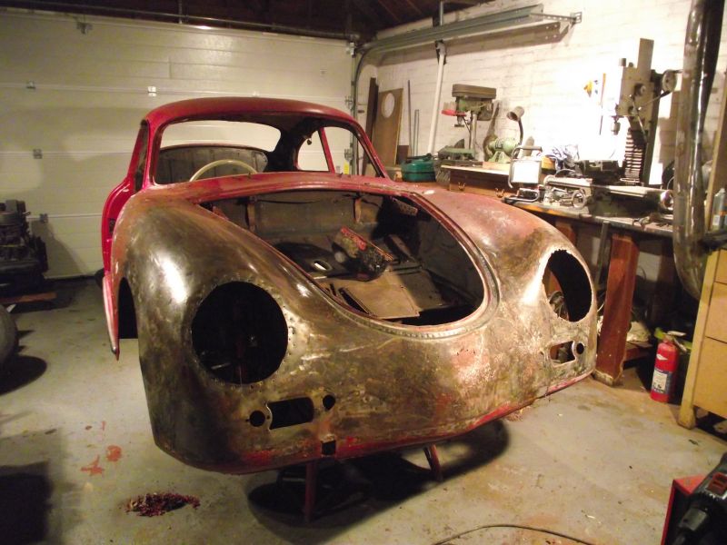

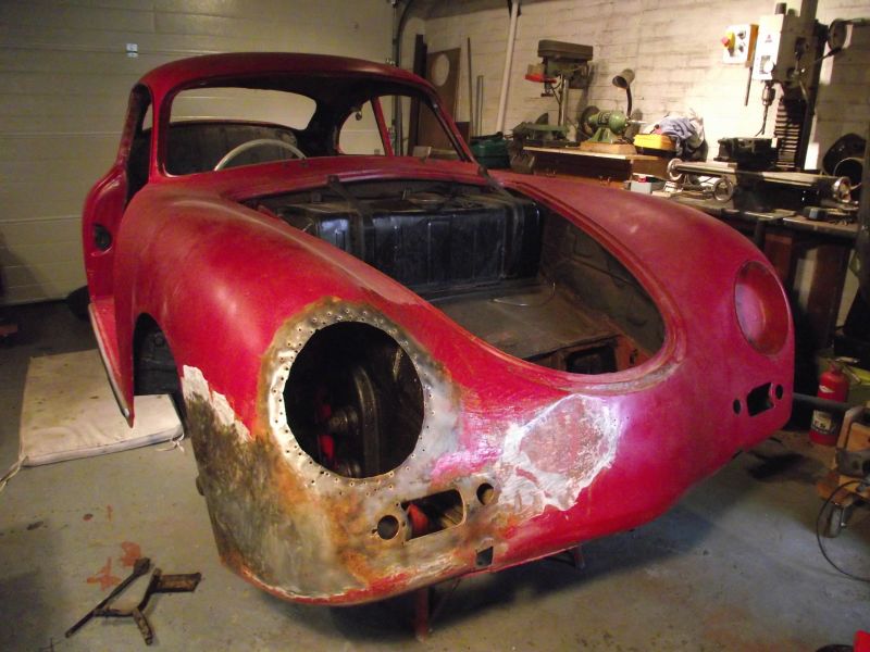

        The paint is coming off..... I took some advice from an old restorer many years ago (Tony Standen who is now unfortunately no longer with us) who said "break the jobs to do into manageable chunks, start at the front and slowly work back" so that's what I am going to do.

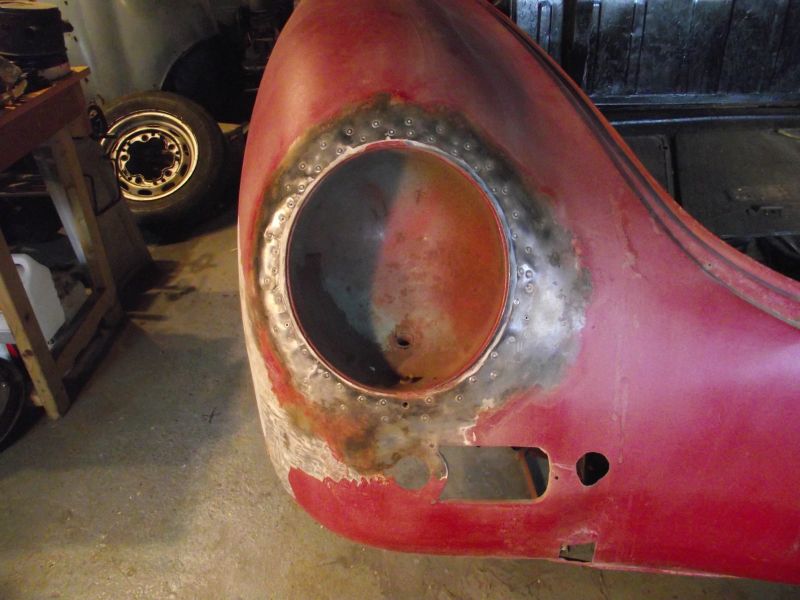

        Starting at the front right I have found the first surprise...
        I think the previous 'restorer' was more familiar with aircraft judging by the rivets.
        The good news is that he didn't try to arc weld in a new headlight surround which would have left some pretty bad heat distortion judging by his other 'welding' skills around the car.
        The eagle eyed amongst you will have also noticed that he has used a VW headlight bucket which is shallower than the original.
        Does anyone know of a source for a correct bucket for an A as all the ones I have seen need slight modifications and unwanted holes welding up?

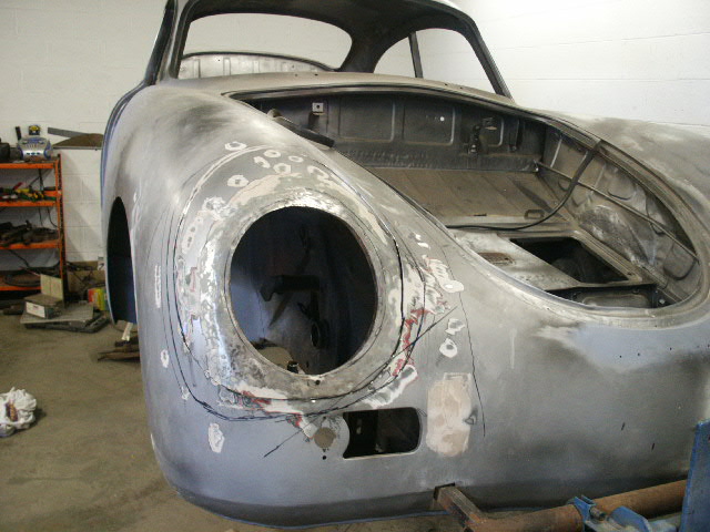

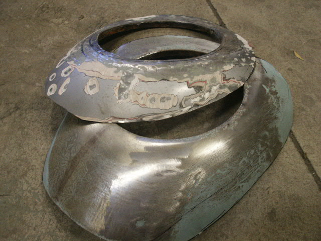

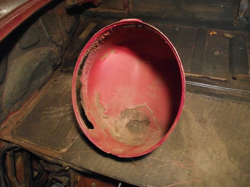

                            Hi Guys
                            With all this talk of poor repro headlight buckets I went back to the shop and retrieved the old VW bucket from the bin, I think I can use this to save the left bucket.
                            As you can see the left side had an original bucket but it was held in with bondo so I will need to fabricate a new mounting edge. Luckily I have just received my order of Lancaster shrinker stretchers so this will be a great test to see if I can create perfectly oval repair pieces.
ID:	74552Click image for larger version
