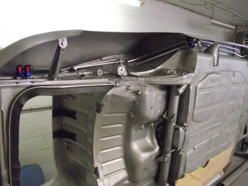

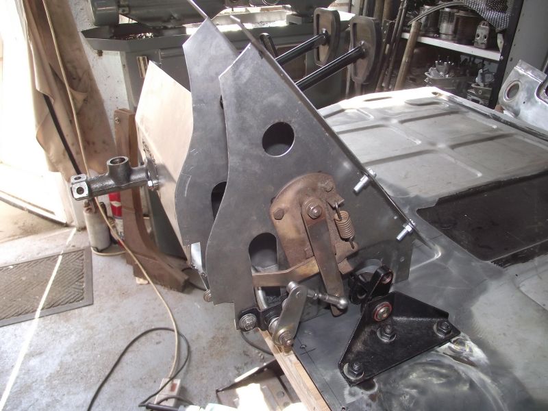

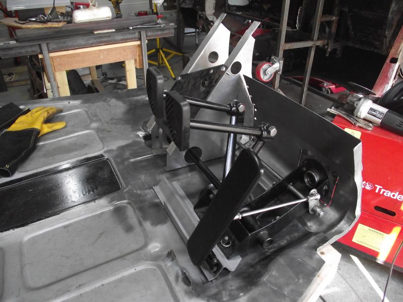

      More work on the 'African Queen'.

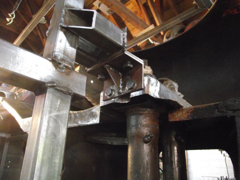

      In preparation for the new floor I had to get the RHD pedal cluster and associated linkages all lined up.
      So some may find these picture interesting to see how complex the RHD set up was.

      • #93
        Super looking RHD area Drew, it is quite complex on left side too with the hand throttle adjustment. Nice pics!

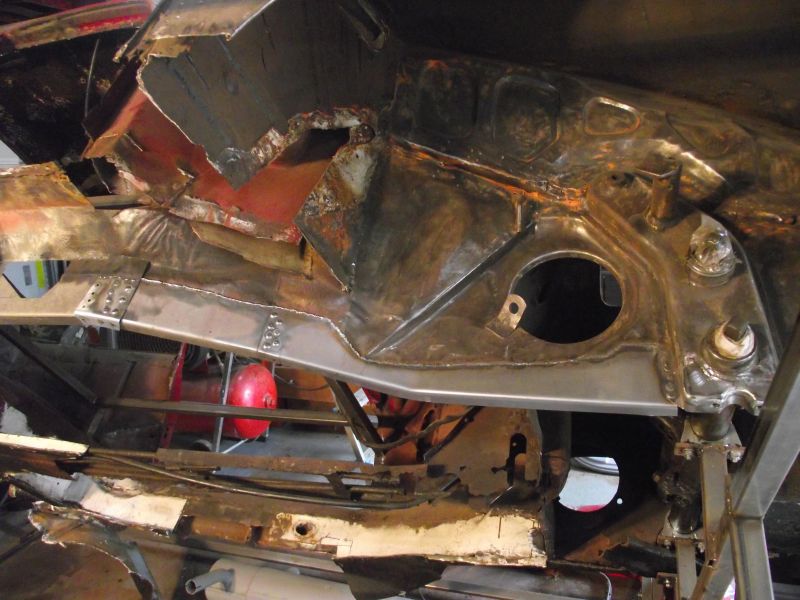

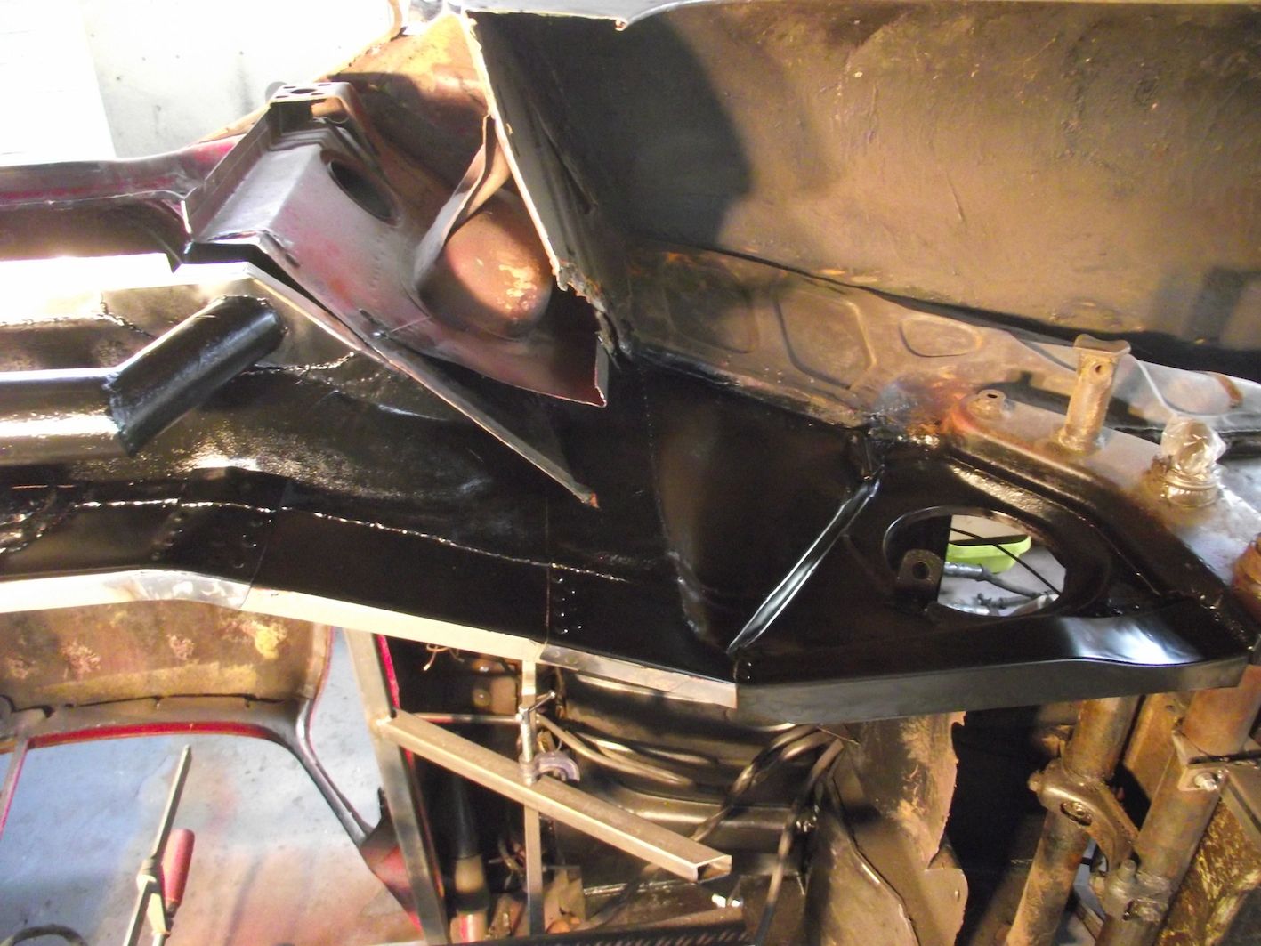

                Here is the left side cleared out.

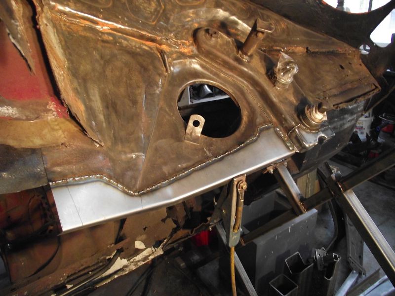

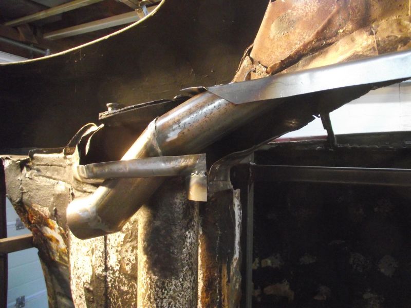

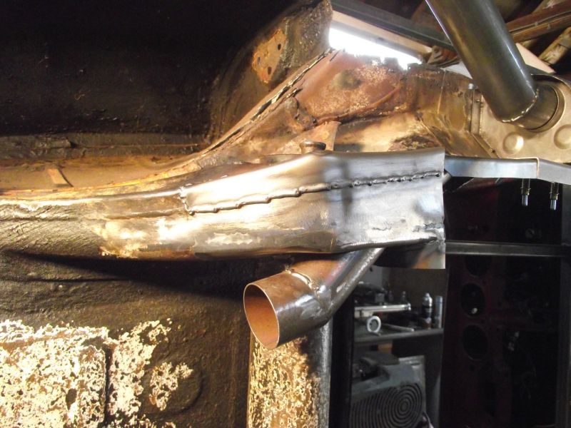

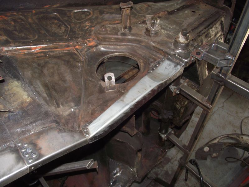

                New heater tube fabricated and welded in.
                • #98
                  Really nice job fabricating all those intricate pieces from nothing Drew. Looks great!
                  • #99

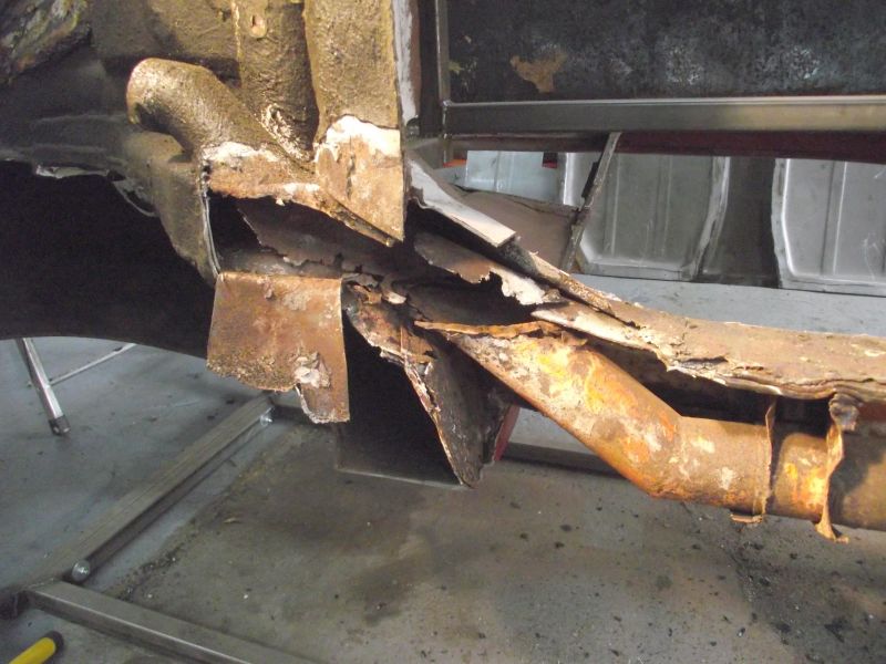

                    Well done Drew that looks really good. Frightening to look at before you started. That area has frightened many guys I reckon over the years. So pleased I caught mine just in time and it only needed a caps to the bottom.

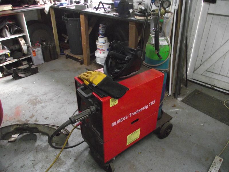

                    • What nice work you're doing. Great job. May I ask what brand of MiG you use? The welds look great. John
                        More soon
                        Drew
                          I'm under no illusions about that Drew. My car did not breach through in that area so I left it alone but the longs of course rusted out. I know there is still thick old cancer lurking in the bowels of my chassis. But I've added drain holes to let any future moisture that might get in there some place to go. And also access to spray penetrating oil or perhaps wax as the years go by so it doesn't advance further. At this point To me its akin to prostate cancer at 85 if it can be kept in check and its not causing issues (structural integrity in this case) then I'm willing to just leave it be. IMHO
                          Keep up the great work!
                          • Drew,
                            I remember well the lowest flat area of that torsion bar area and the pinholes of rust. The sides were sound but I remember making the 2 off bottom cappings for each side out of much heavier gauge sheet. I thought if ever anyone lifts the car its got to hold it and not collapse.
                            And I was correct those who don't know the proper area's always used these flat area's. I did not though put in a drain plug !! Would have been a great idea Drew. But..it was 1976 or so then and I knew the best way forward over here was not to drive on wet roads!!

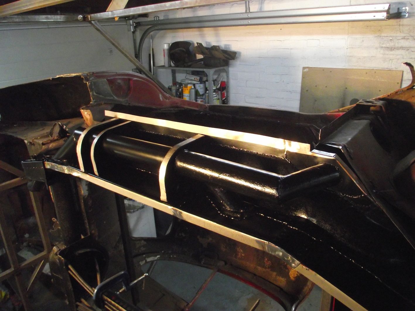

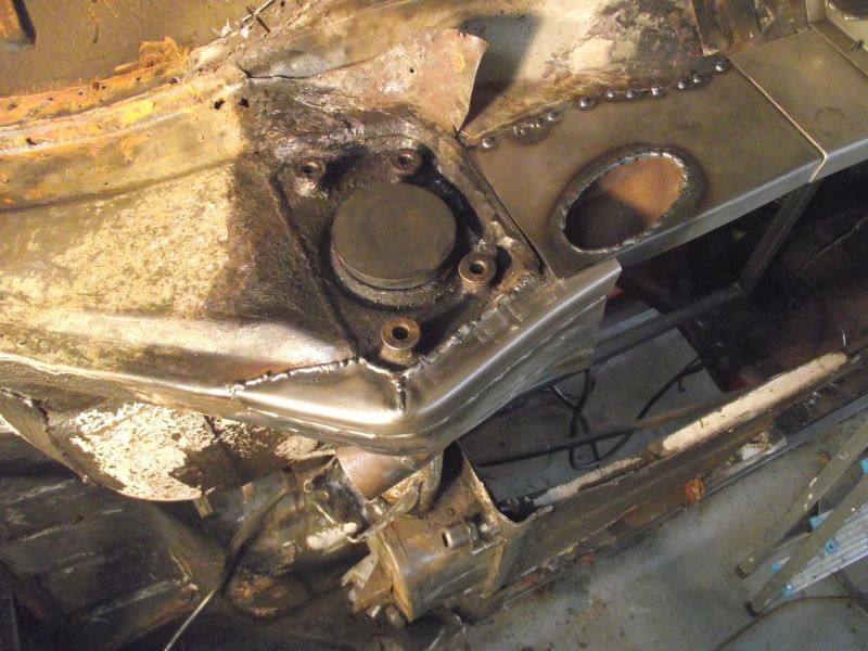

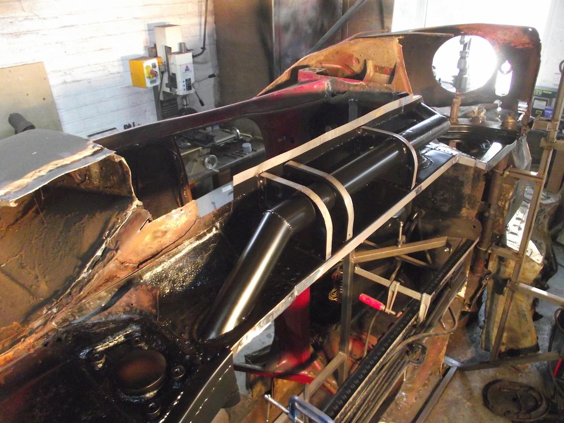

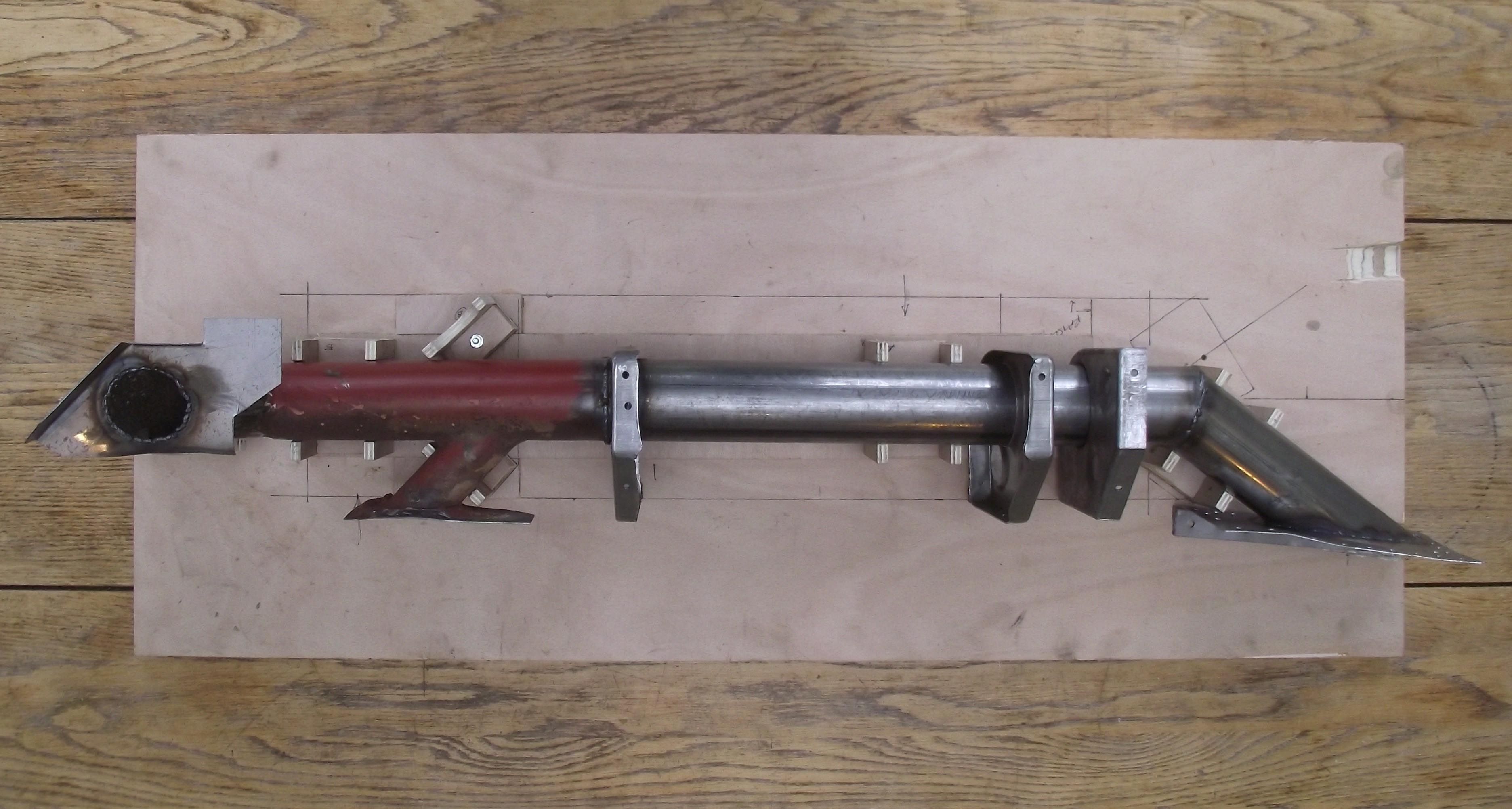

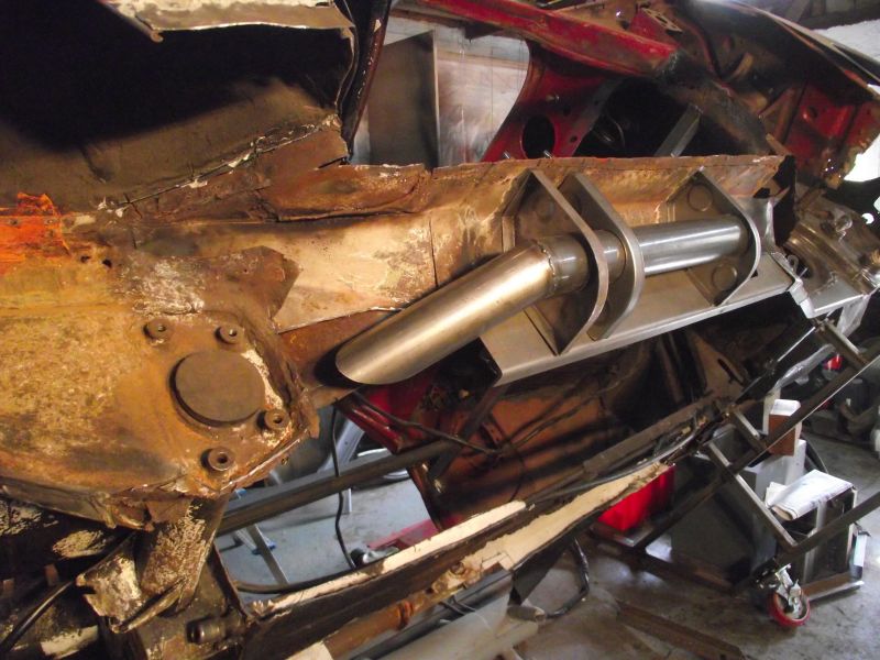

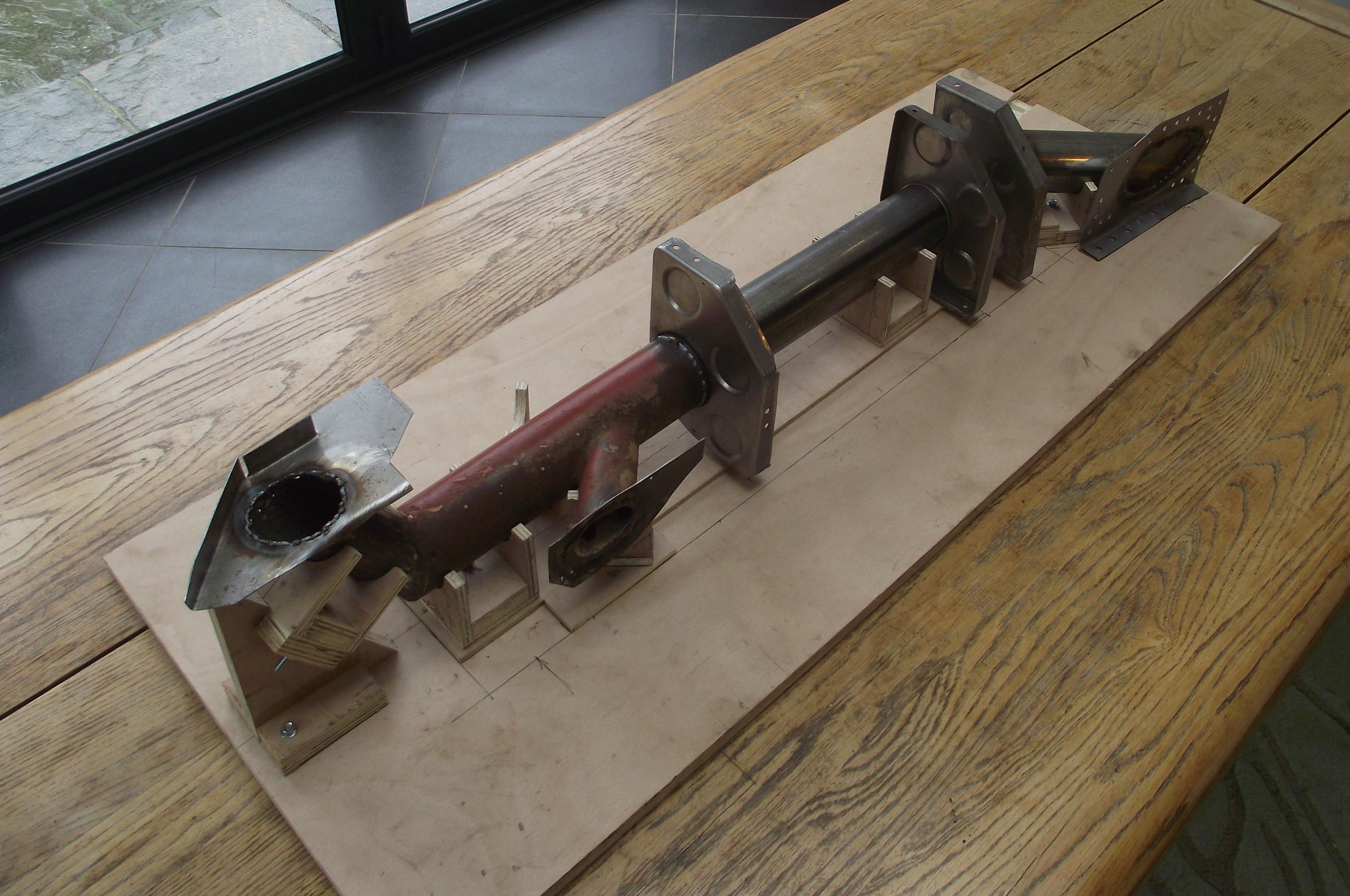

                              • After taking many measurements and studying the angle/intersection of each tube I can now weld the various size tubes together to form accurate left or right side heater assemblies.
                                Click image for larger version  Name:	DSCF8037_sml.jpg Views:	39 Size:	811.0 KB ID:	105101 Click image for larger version  Name:	DSCF8042_sml.jpg Views:	40 Size:	574.5 KB ID:	105097
                                Click image for larger version  Name:	DSCF8051.JPG Views:	36 Size:	182.1 KB ID:	105099 Click image for larger version  Name:	DSCF8050_sml.JPG Views:	36 Size:	167.0 KB ID:	105098 Click image for larger version  Name:	DSCF8052.JPG Views:	39 Size:	207.3 KB ID:	105100
                                More updates soon
                                Thanks for stopping by.
                                Regards
                                Drew
