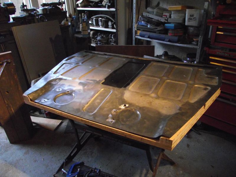

    The hammer form worked a treat, here is the finished front floor pan.

      That turned out nicely. Great job. You could go into business modifying pans

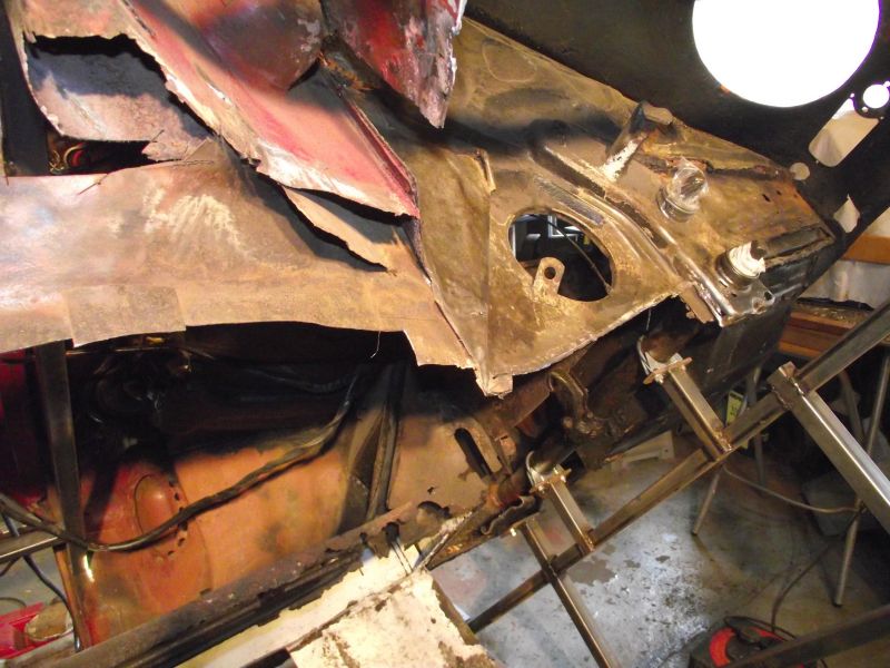

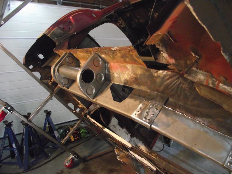

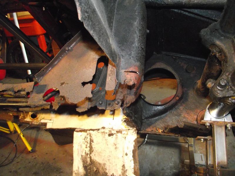

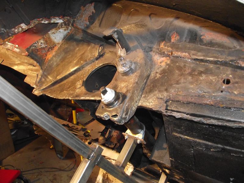

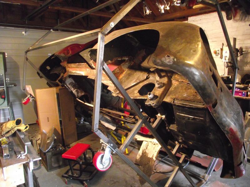

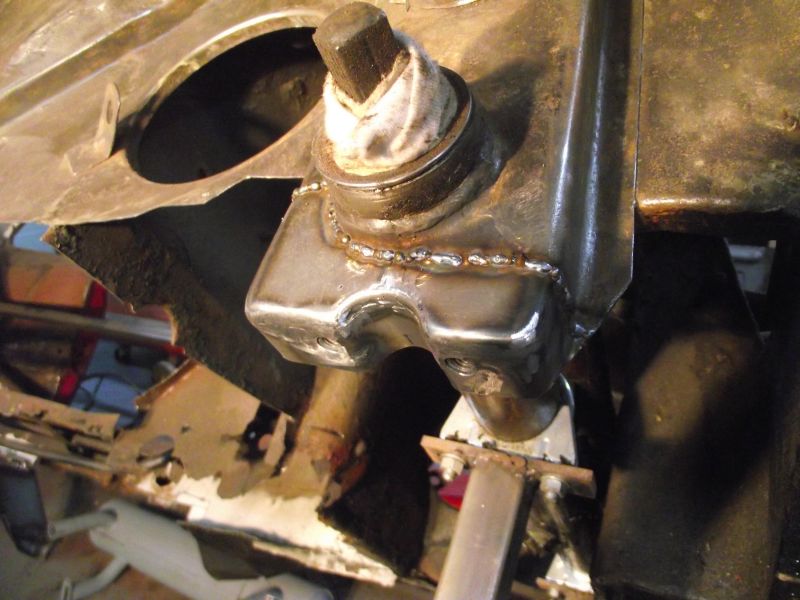

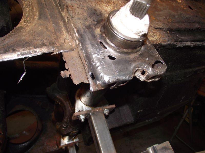

          Here are some shots of the rot in the chassis being cut out.
          The front lower torsion bar area will need some TLC but at least with the previous bodges removed I can start to see the way forward.
          Thanks for looking.
          Drew

            I will have look on mine tomorrow,its strange that drop away. My car is the same 1959 but chassis 106954 a bit before yours. Drew, you have the skill I think to do it all, but I think its not easy. If I had seen that car in N Wales and bought it I would be in serious trouble getting around that work. A lot of fabrication but something you are so good at though.
            These cars always look so good until you start stripping them down. No wonder RHD cars are rare even if they have come from S. Africa in the 60's.

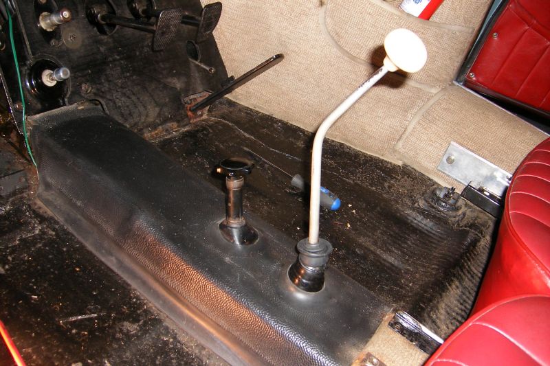

            • #81

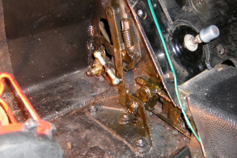

              Drew,
              I took some very old photo's when I changed the reversing light on the interior of the tunnel. Two of these show my still original floor and the tunnel leading up to the kick board. The base of the tunnel where it reaches the kickboard area seems to be flat with no drop down. I also do not see the two round impressions, maybe you can.
              The set up for the adjustment for cold start ( depresses the throttle lever is also shown ) That might be useful for you later.
              Maybe these photos are not what you need at all sorry if they confuse! rather than help.I can say that area now ten years later is much tidier than shown but still all original. Forget the green wire thats re-routed now.

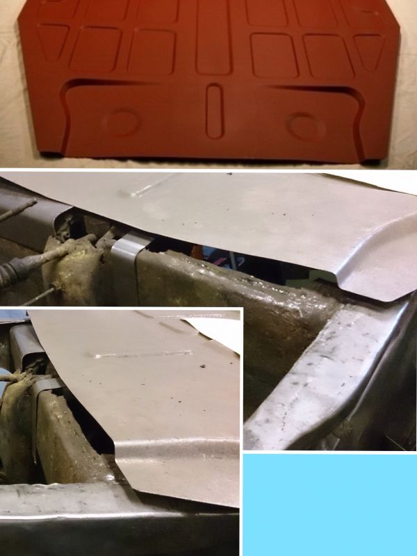

                  Moin Drew,
                  You have done a BIG job on adjusting the metal parts.
                  This is the only pictures I have on hand.... you can see the middle part are same level as the "tunnel" and its just sloping down to the sides....not perfect but something to go on...
                  The RED one is Simonsens own photo of the floor panel...the unpainted is his part but my photo

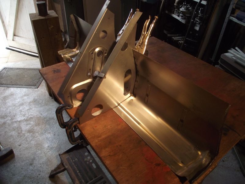

                    It seems that the front toe board stamping is the one that needs adjusting next.
                    I am going to move this flange back up to give me a good average.
                    It's just a shame that these new panels need so much extra work to get them to line up.
                    Regards
                    Drew

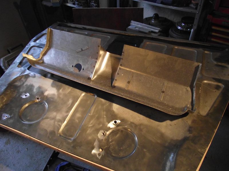

                      Hi Guys

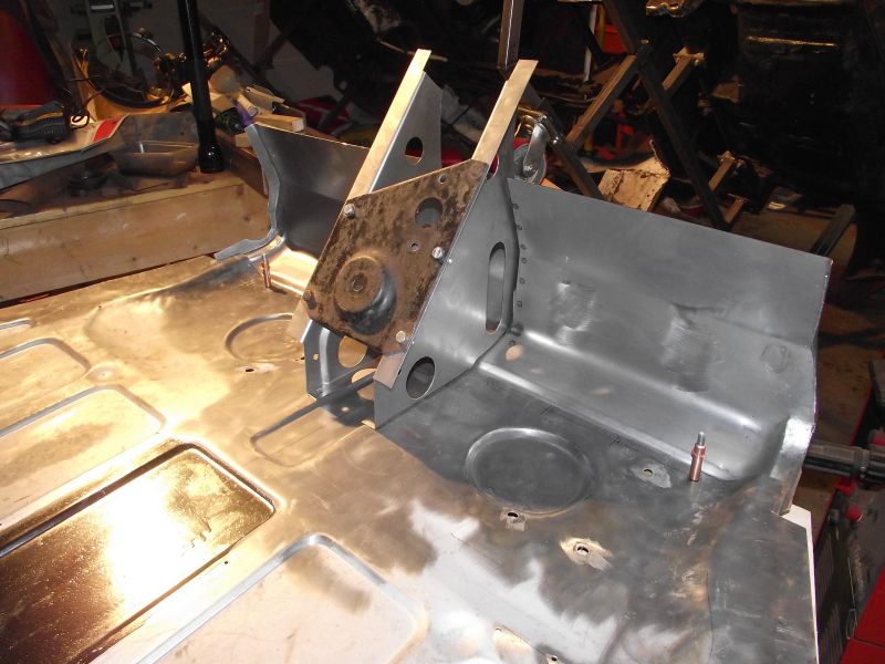

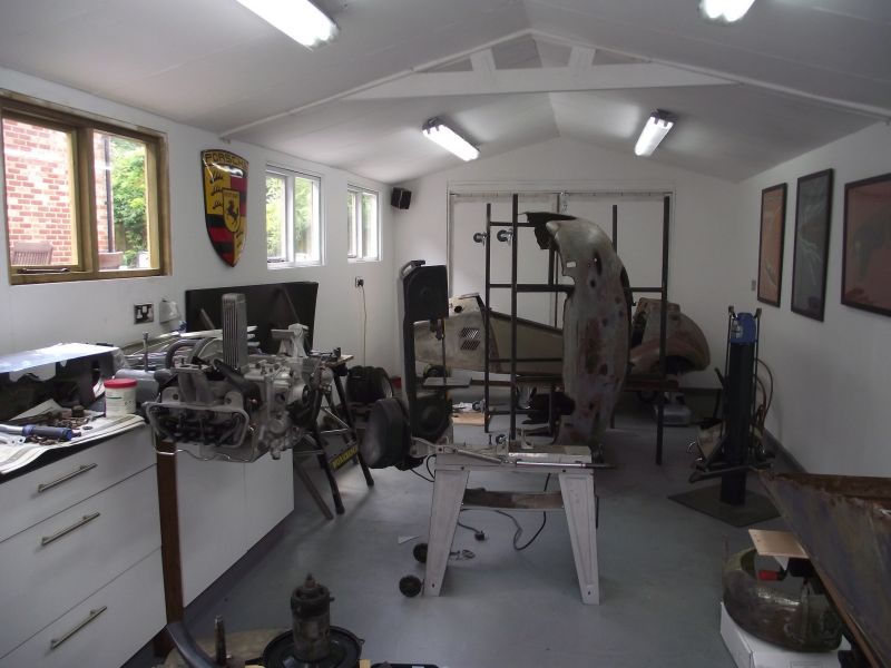

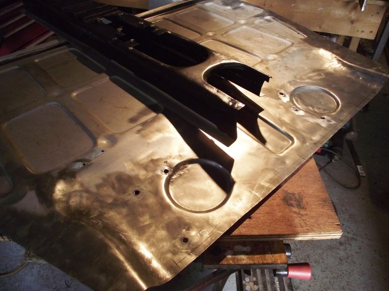

                      Slow progress in my cold workshop, but here is the front floorpan mocked up, it's starting to all fit together.

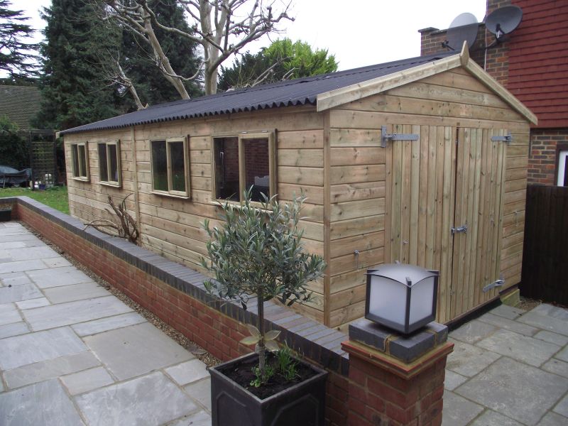

                      I've been busy adding some more workshop space. Putting the insulation in at the moment so it should be a lot warmer this winter.

                        • #87
                          Nice workshop there. Very neat.
                          • #88
                            Really nice Workshop! Puts in mind of an old converted sawmill in Zuffenhausen.
