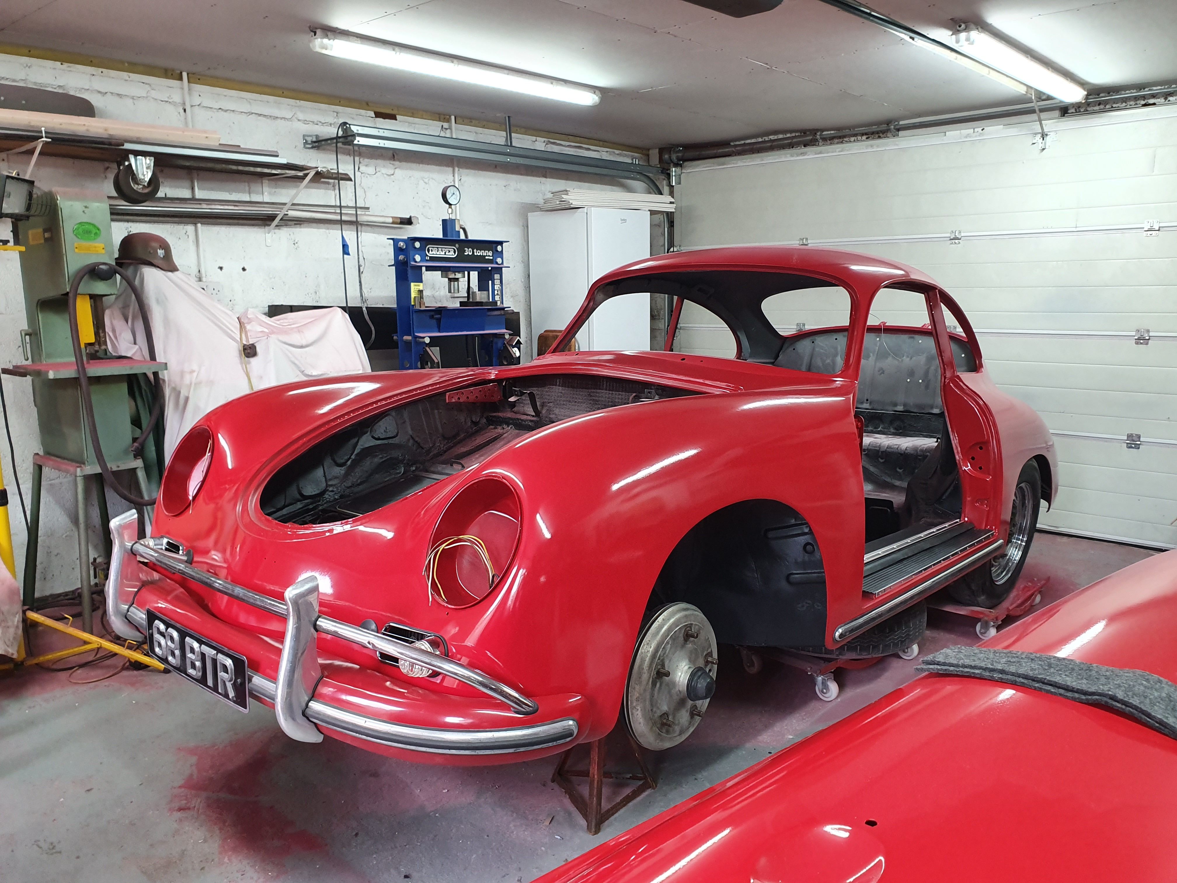

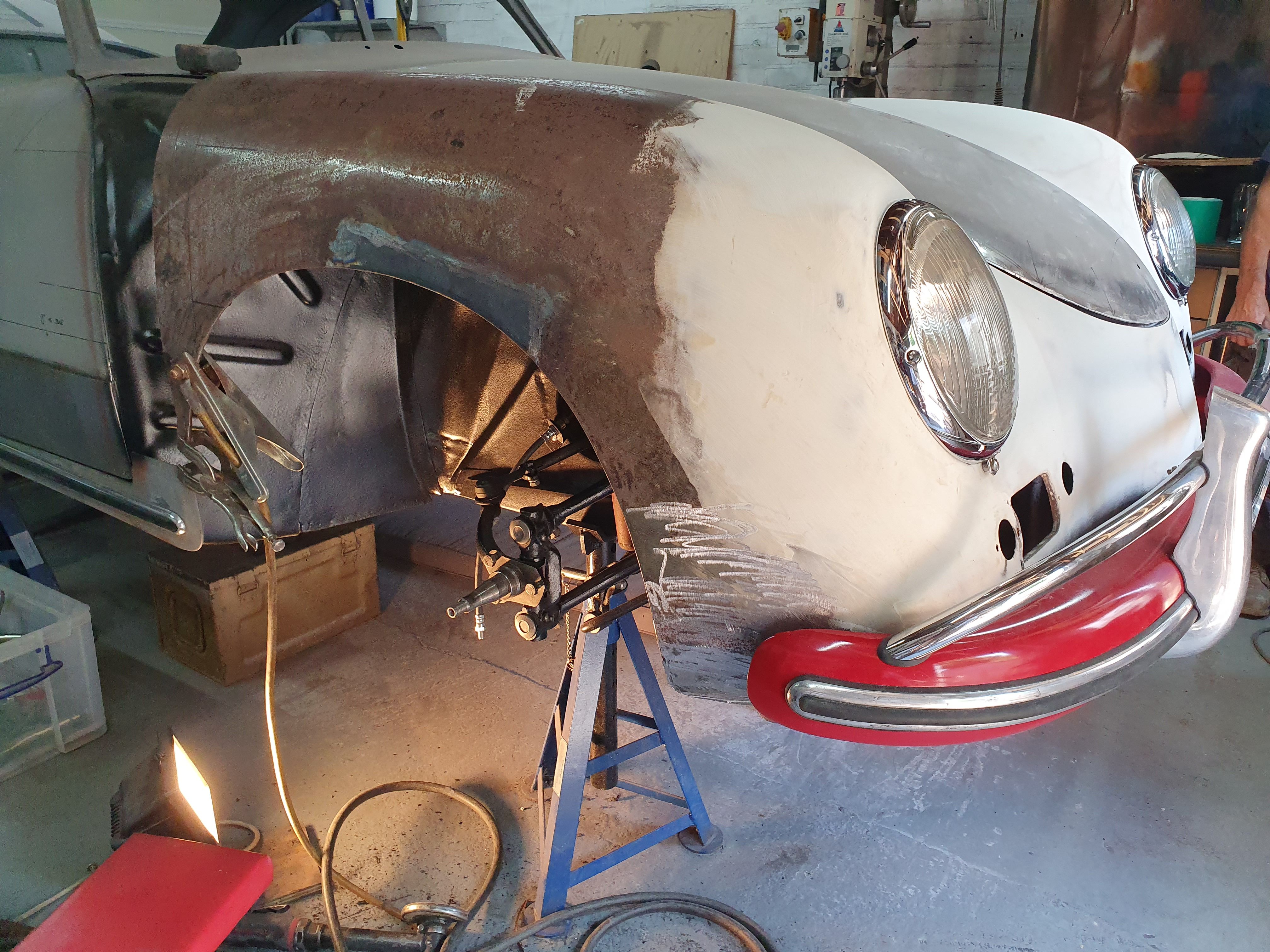

      So next up was sorting out the lower front fender corner and support bracket.
      On with the bumper to check the final adjustment.
      We also addressed a small bit of rot at the top of the wheel arch.

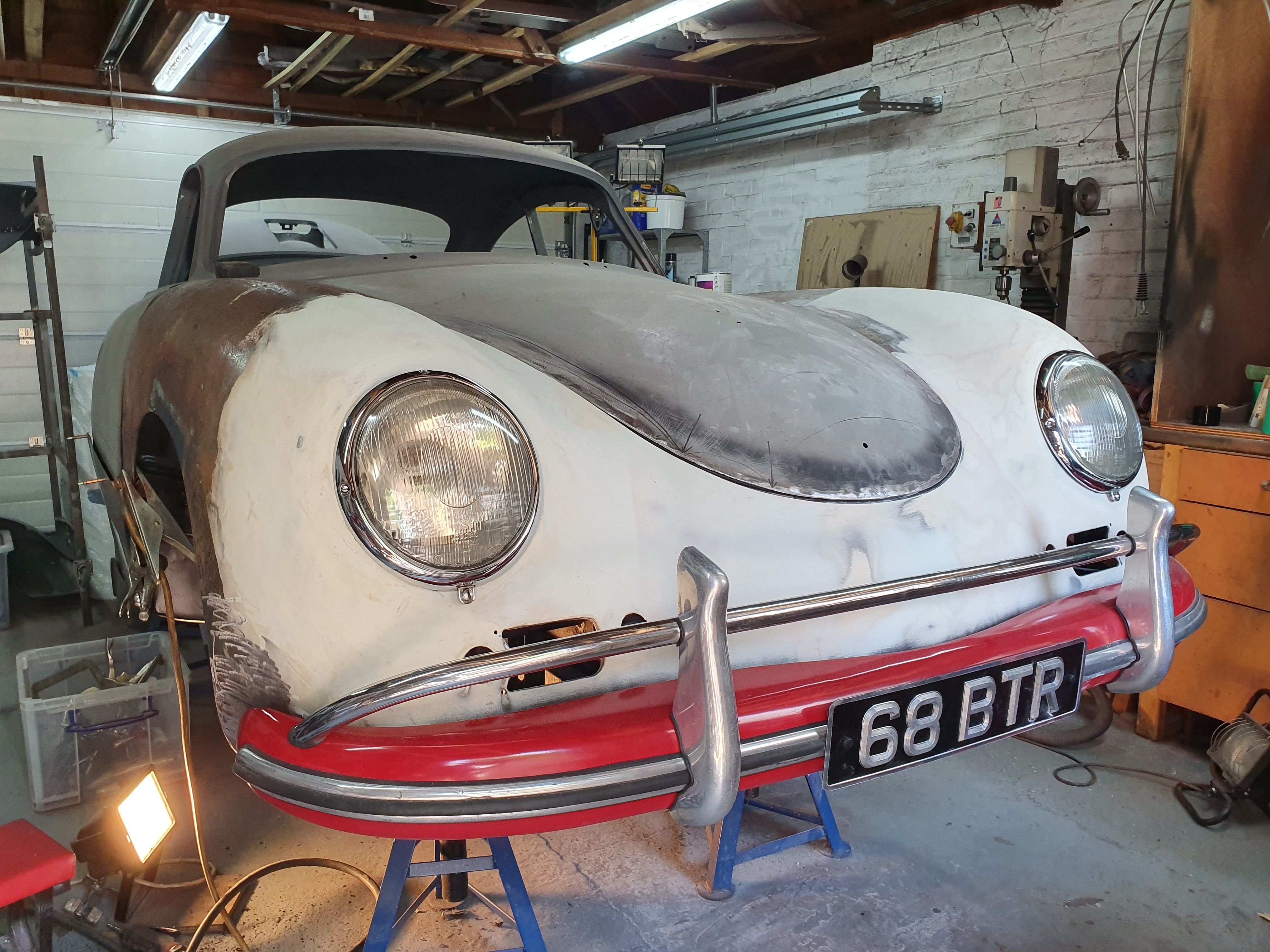

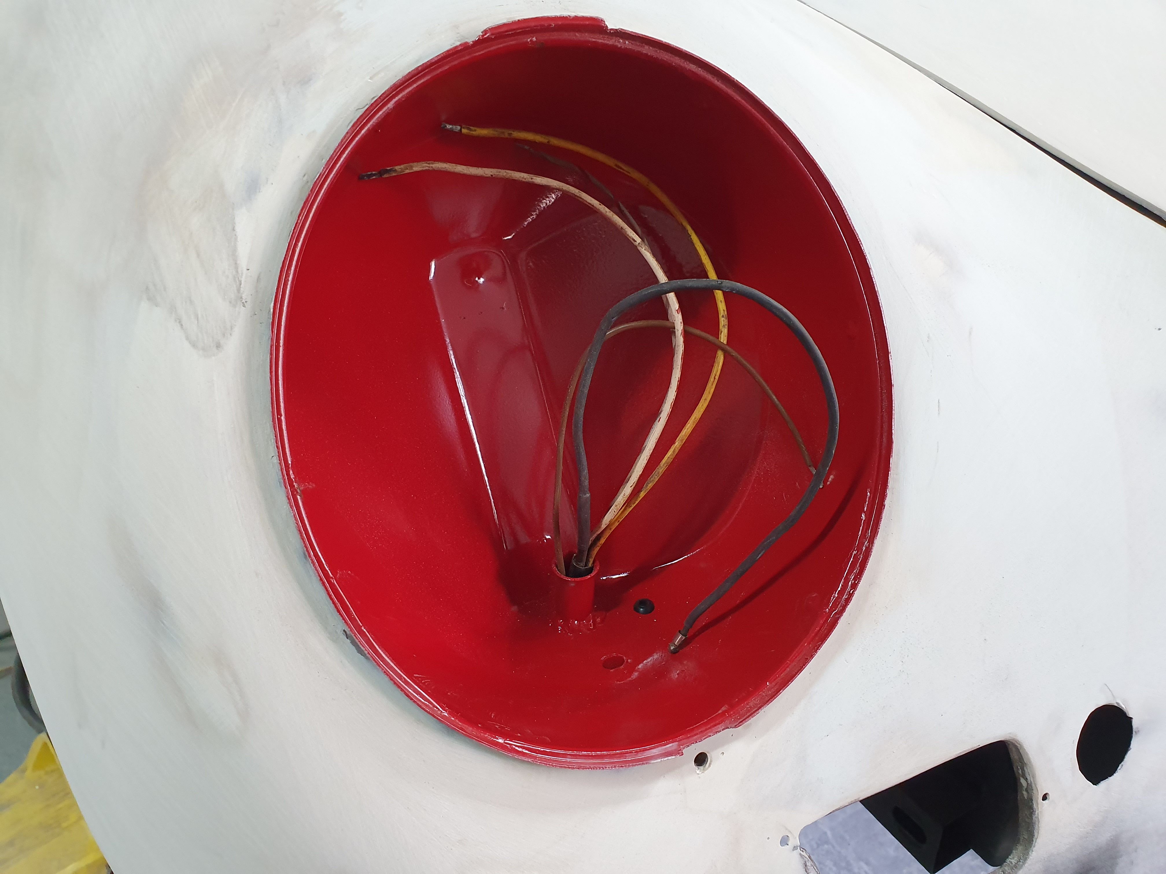

      At this point we thought it wise to trial fit the headlights, up until this point I had just been using a spare chrome headlight ring.
      The chrome ring was a snug fit to the buckets but at least it was a fit.
      But when it came to fitting the complete headlights they would not fully engage with the bucket rim.
      This is where having a spare body with original buckets in the shed next door pays dividends.

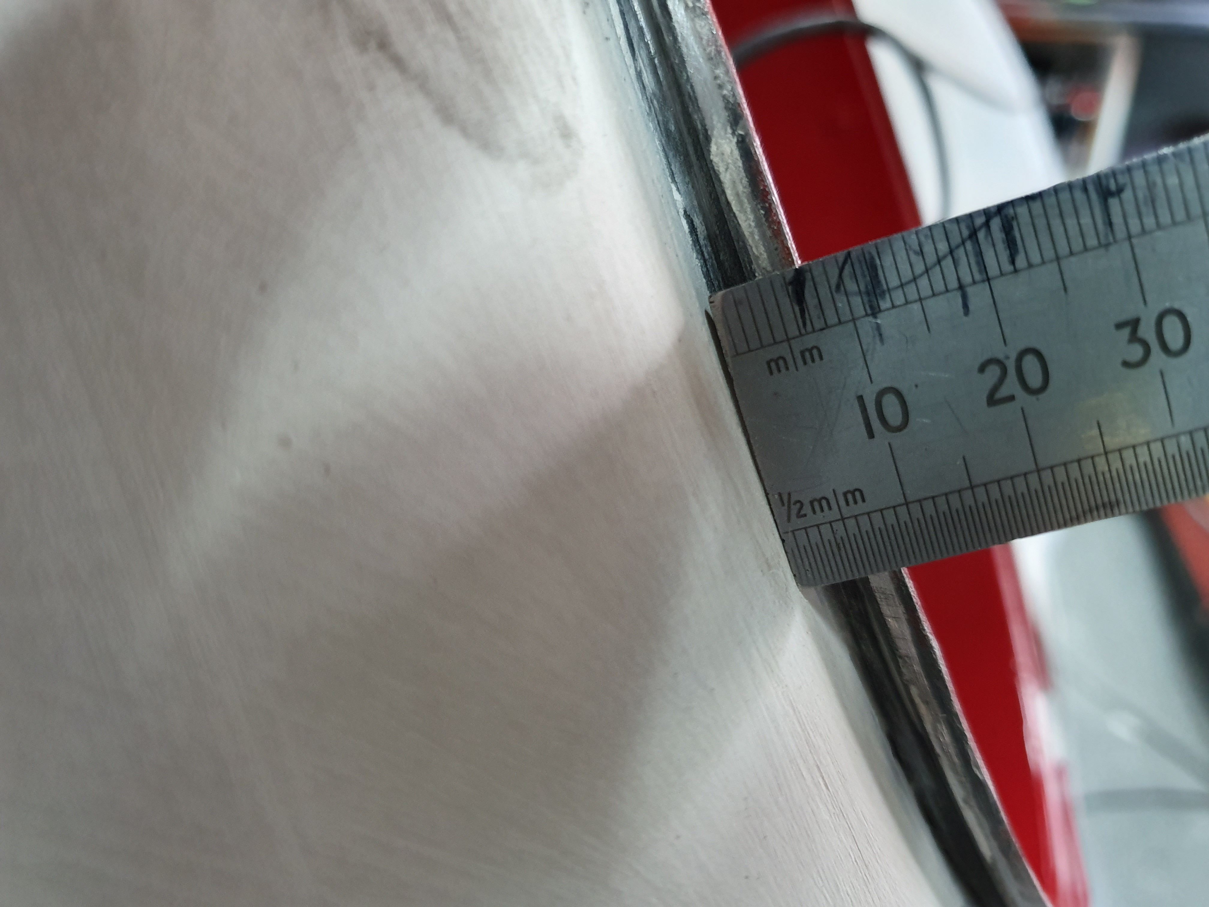

      After careful measuring I realised the the repro (Dansk) buckets had a rim that was taller by about 3mm so I fabricated a depth gauge and ground down the rims.
      It was the spring clips in the rim of the complete headlight that were not allowing the unit to fully seat.
      An important lesson learnt, trial fit everything before paint.

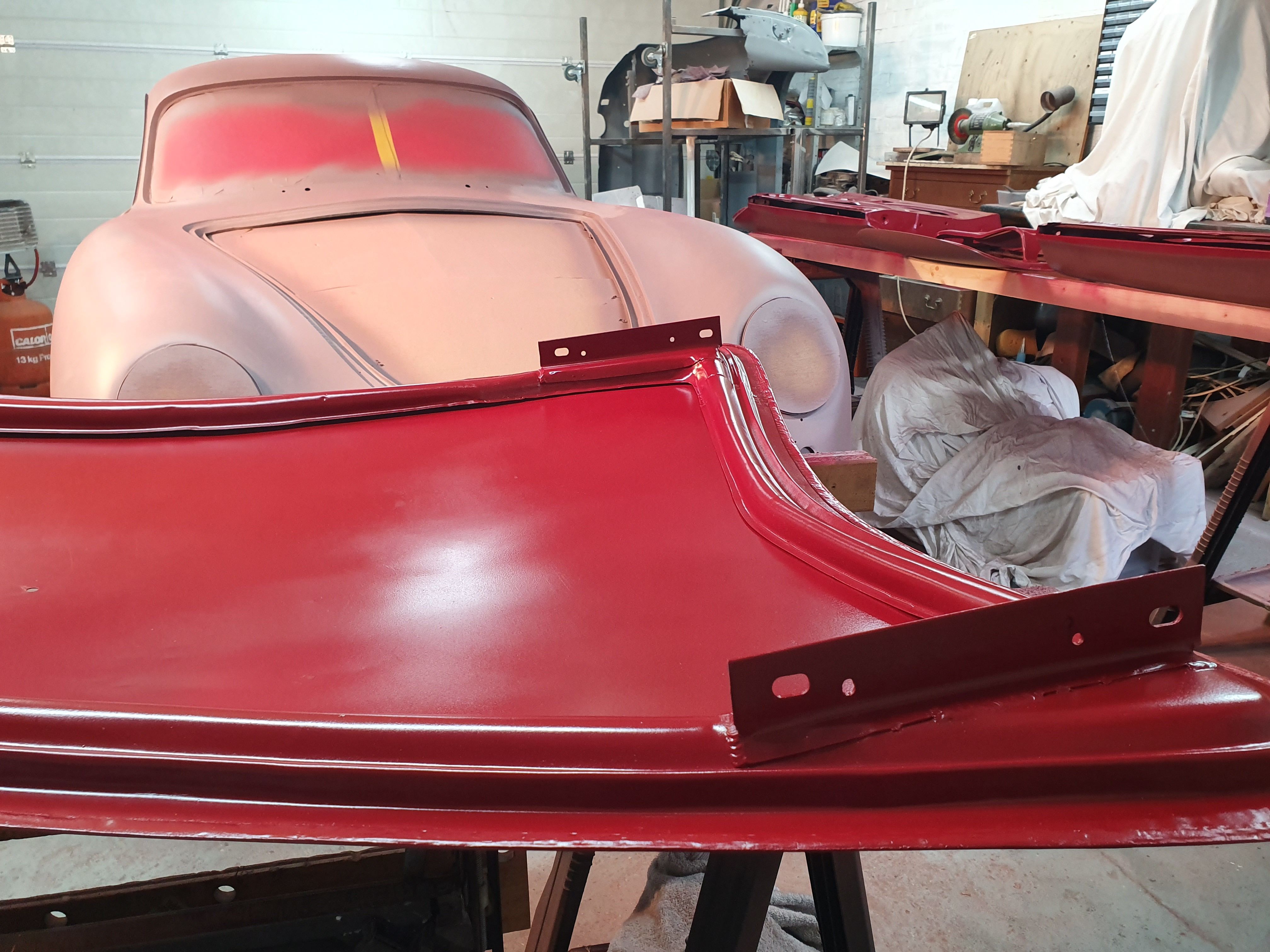

      • OK guys we are in the final phase of this very long restoration. In fact it’s taken six years to get to this point.
        I must say a big thank you to everyone on this forum for all the help over the years.
        We are almost finished with the welding of this very rusty tub and Kevin is working his magic with the door and lid gaps.

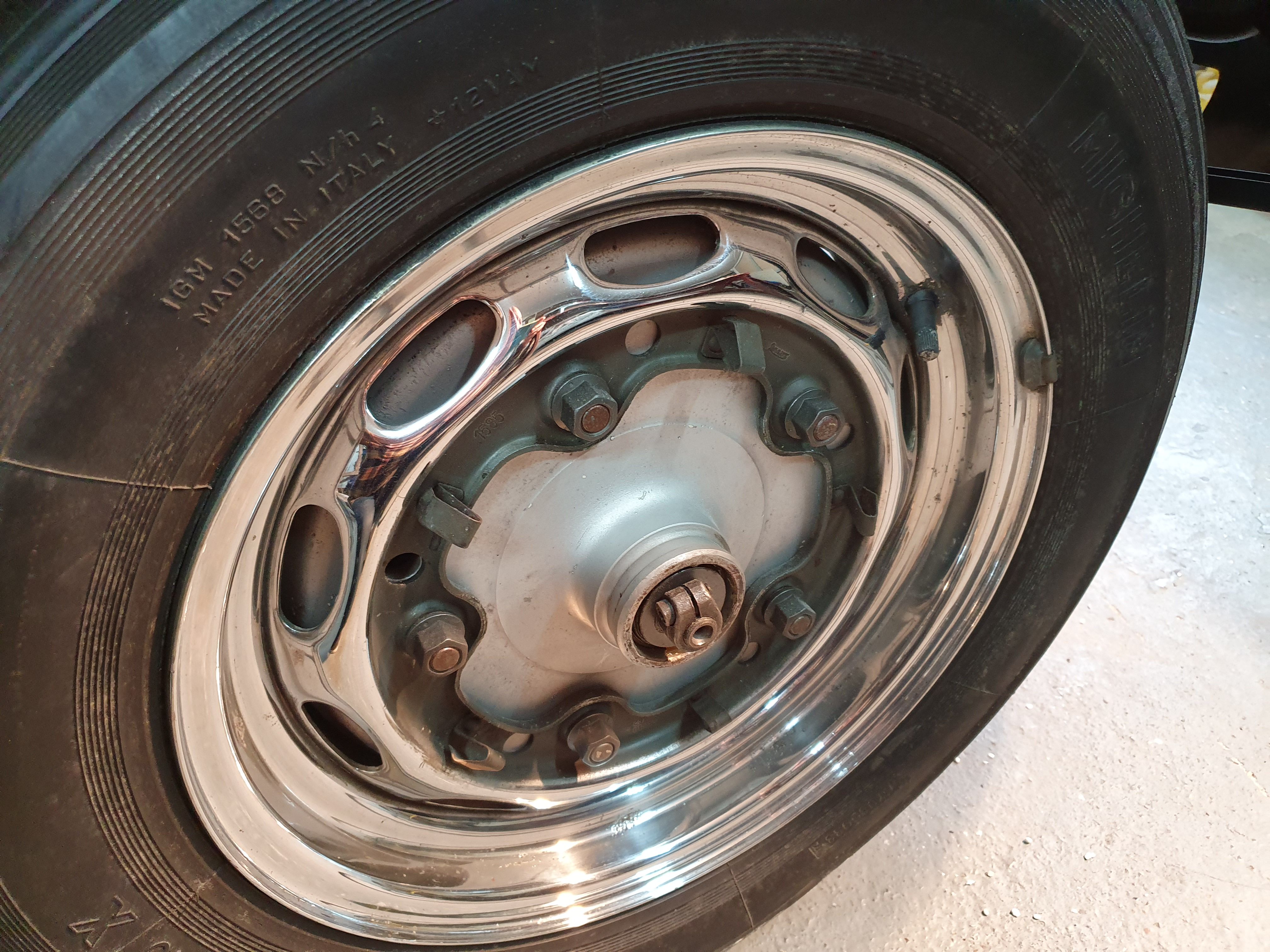

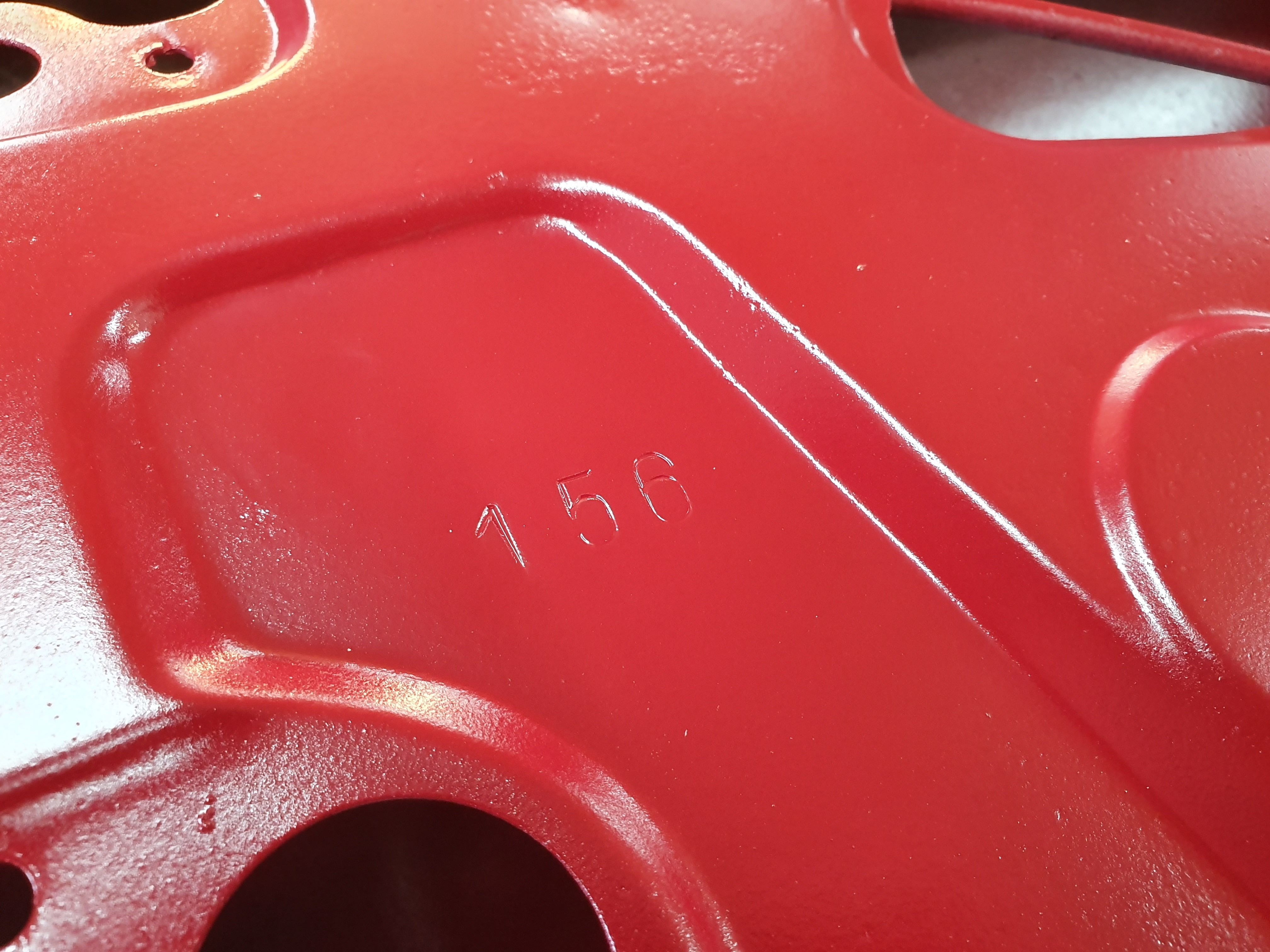

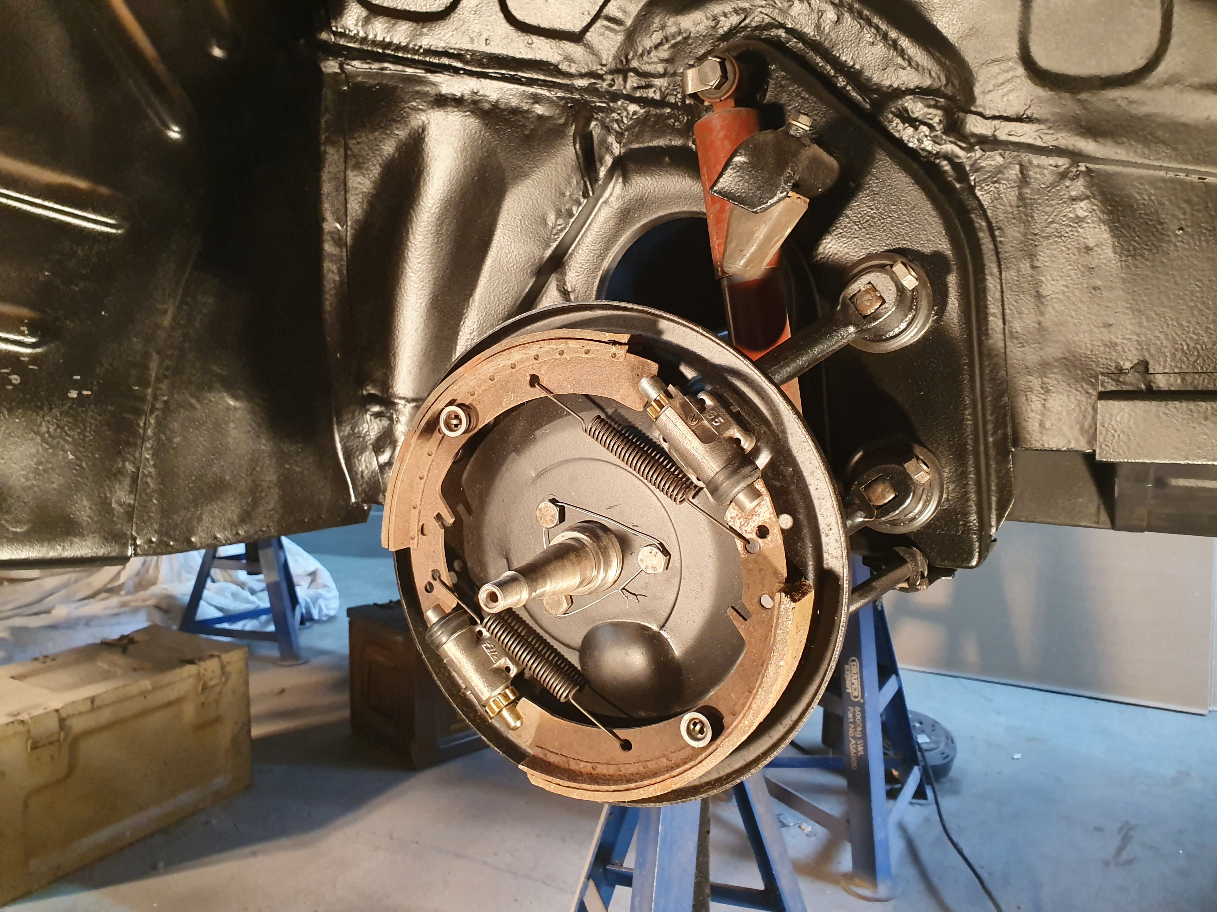

        I have been busy getting the running gear back together in preparation for fitting some ‘Original’ chrome wheels, they are a 62 dated set of
        Lemmerz rims so not original to the car but so much nicer than the repro chrome rims that are around.

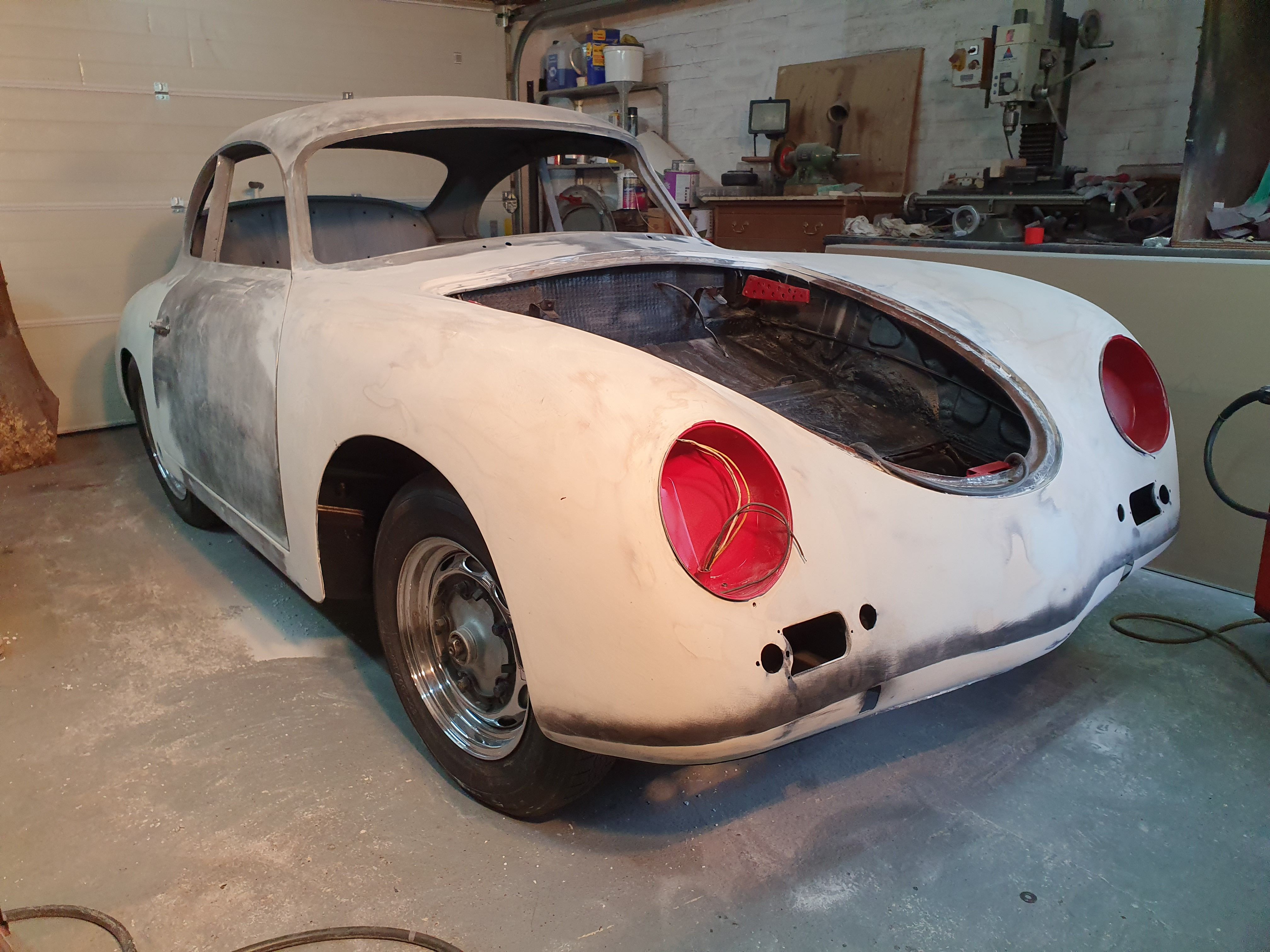

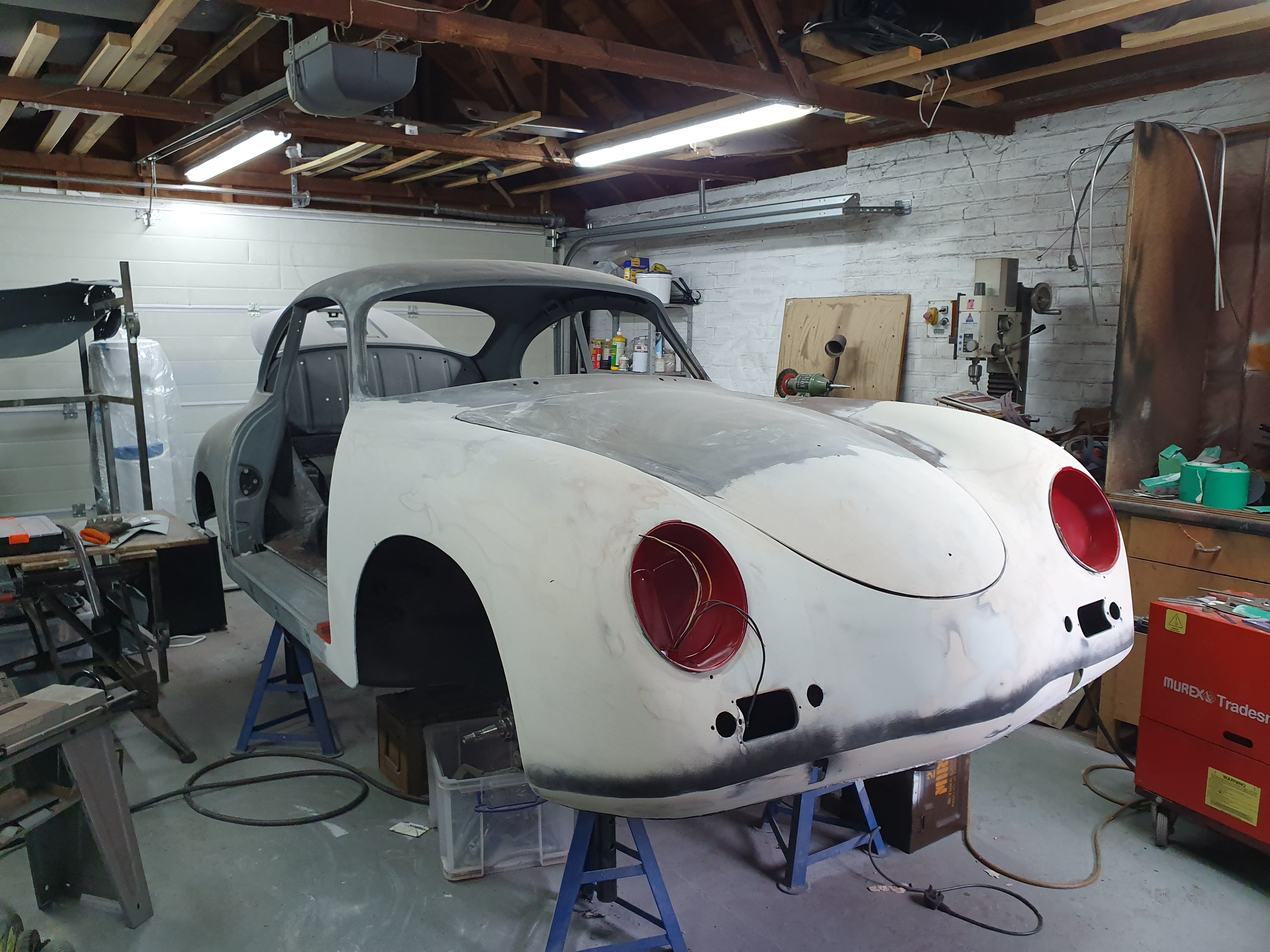

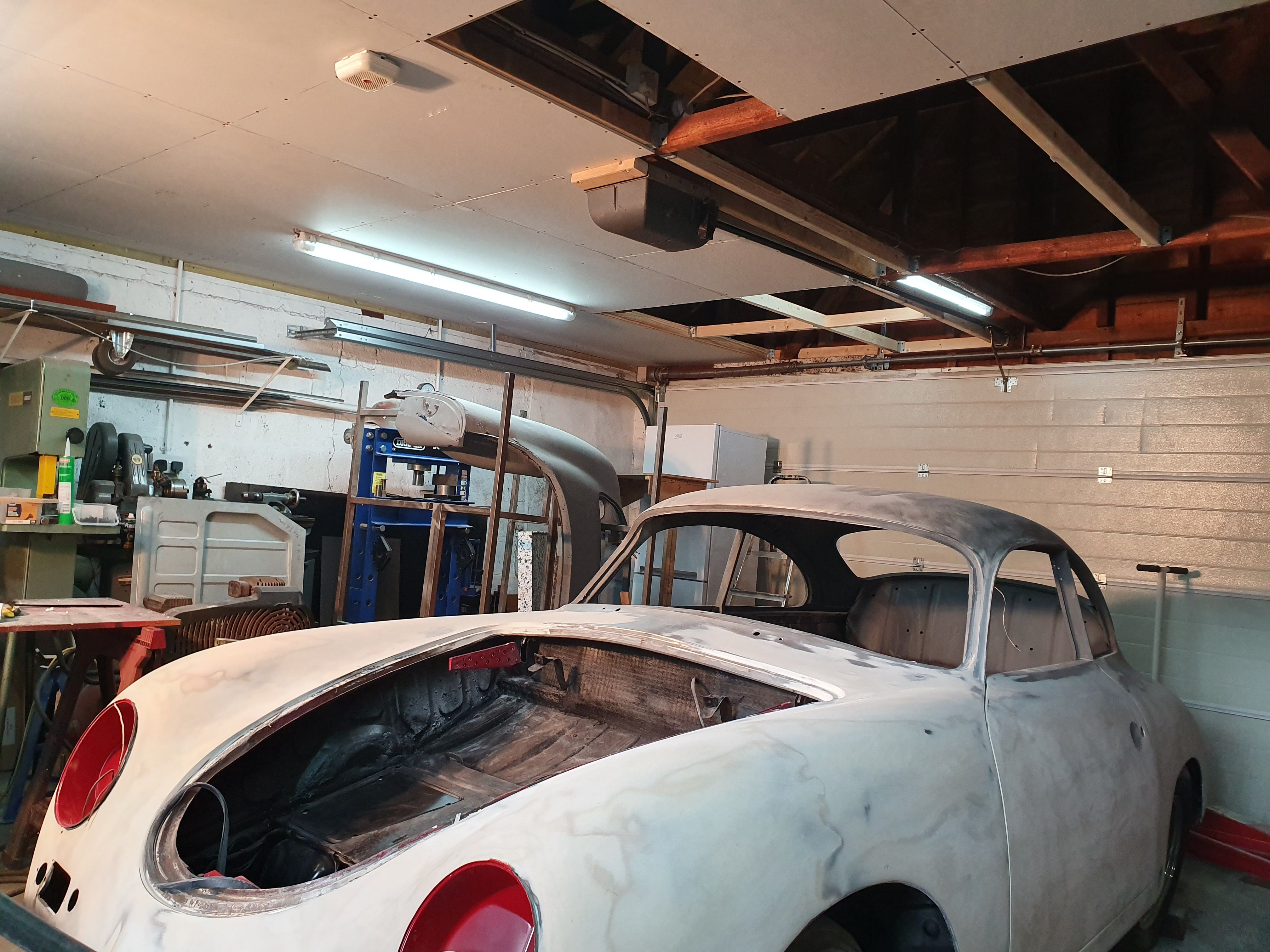

        With the body almost done it was time to think about priming and final colour coat, but my dusty, draughty garage was not the ideal environment
        for spraying so I have started to board out the ceiling, should be a lot warmer this winter as well.

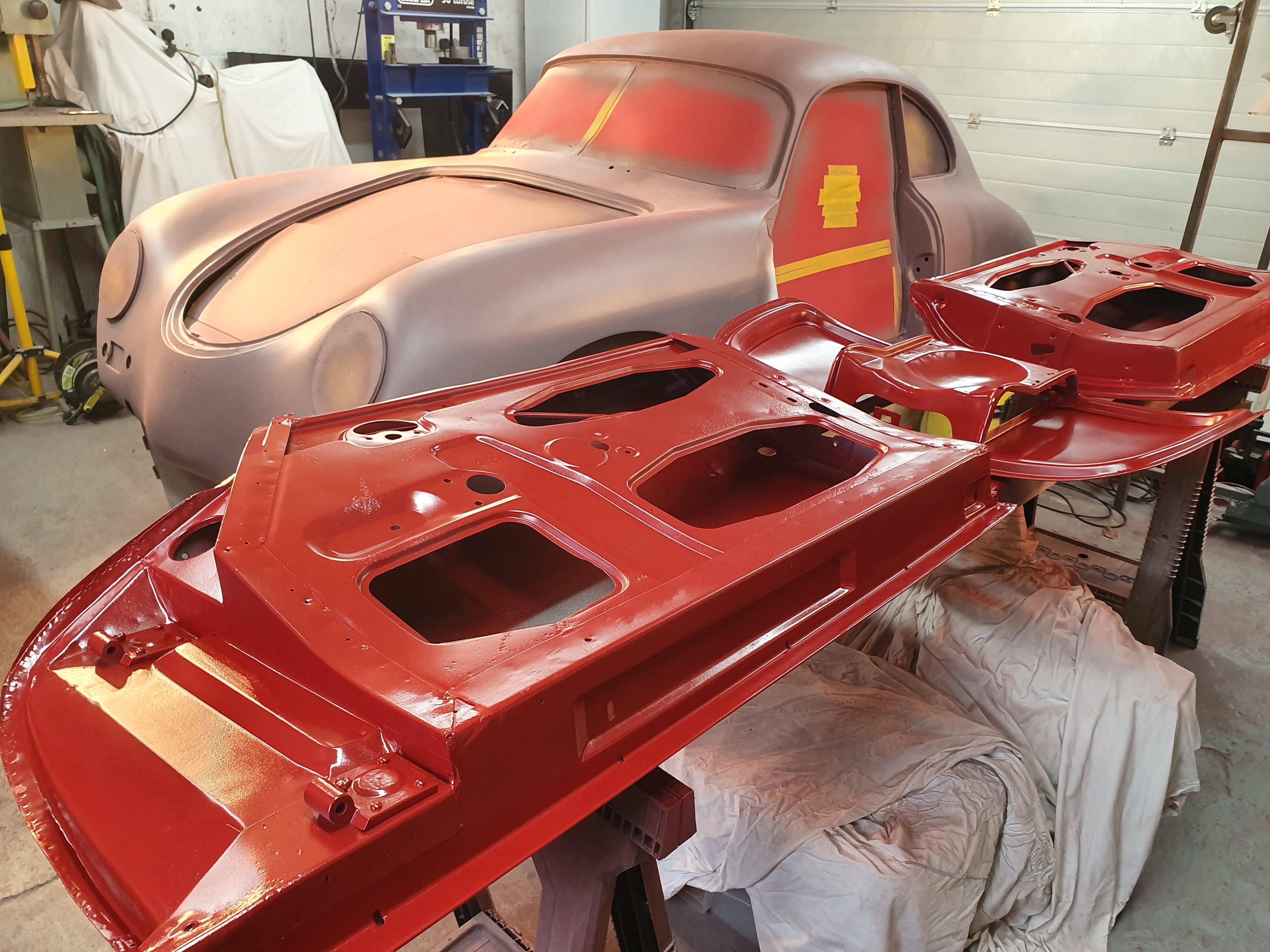

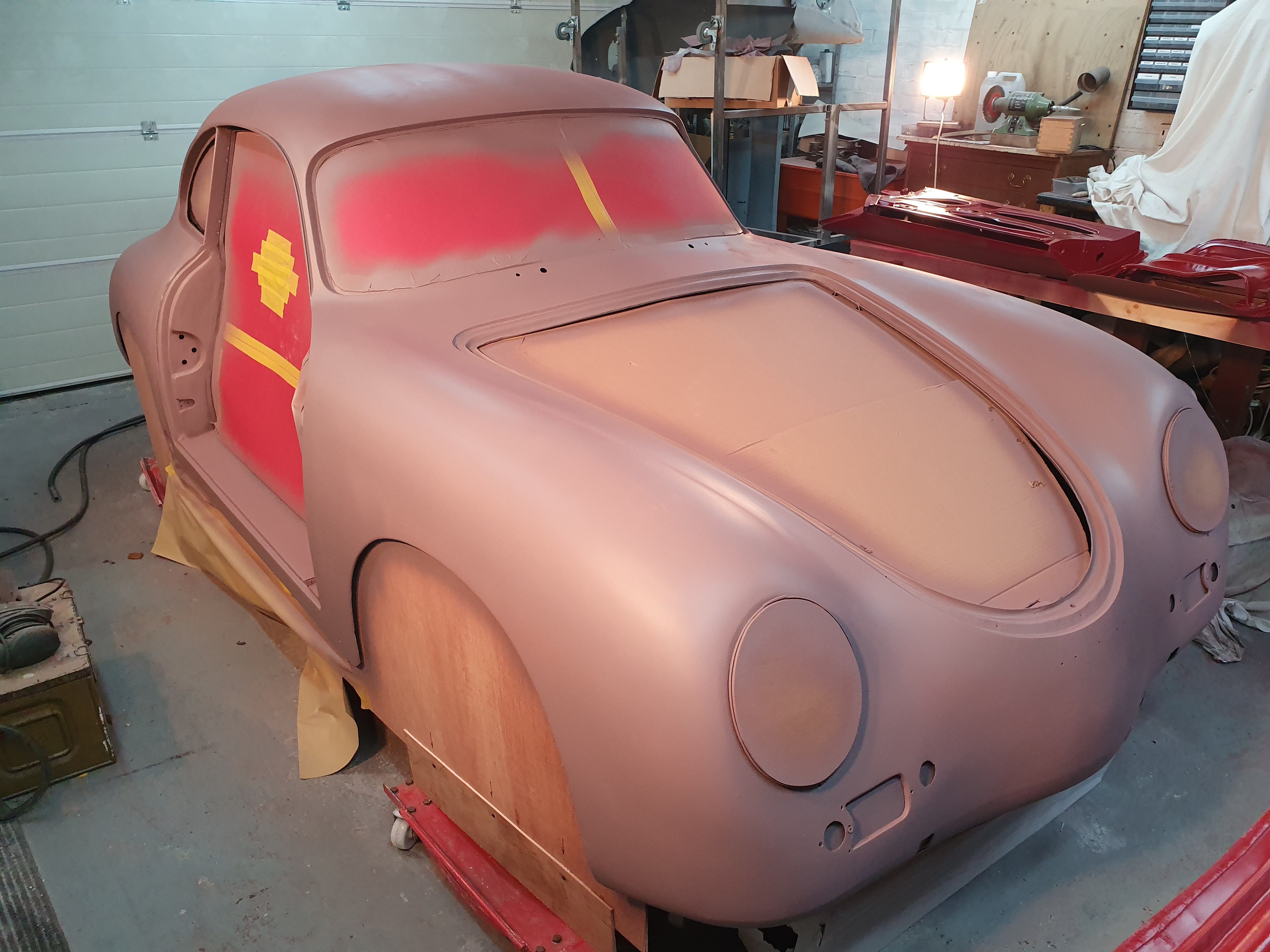

          We are in the final stages of priming and paint, I have had to mix up a tinted primer to achieve the really deep colour of Porsche Ruby Red as spraying over light grey primer produces a red that is too bright.

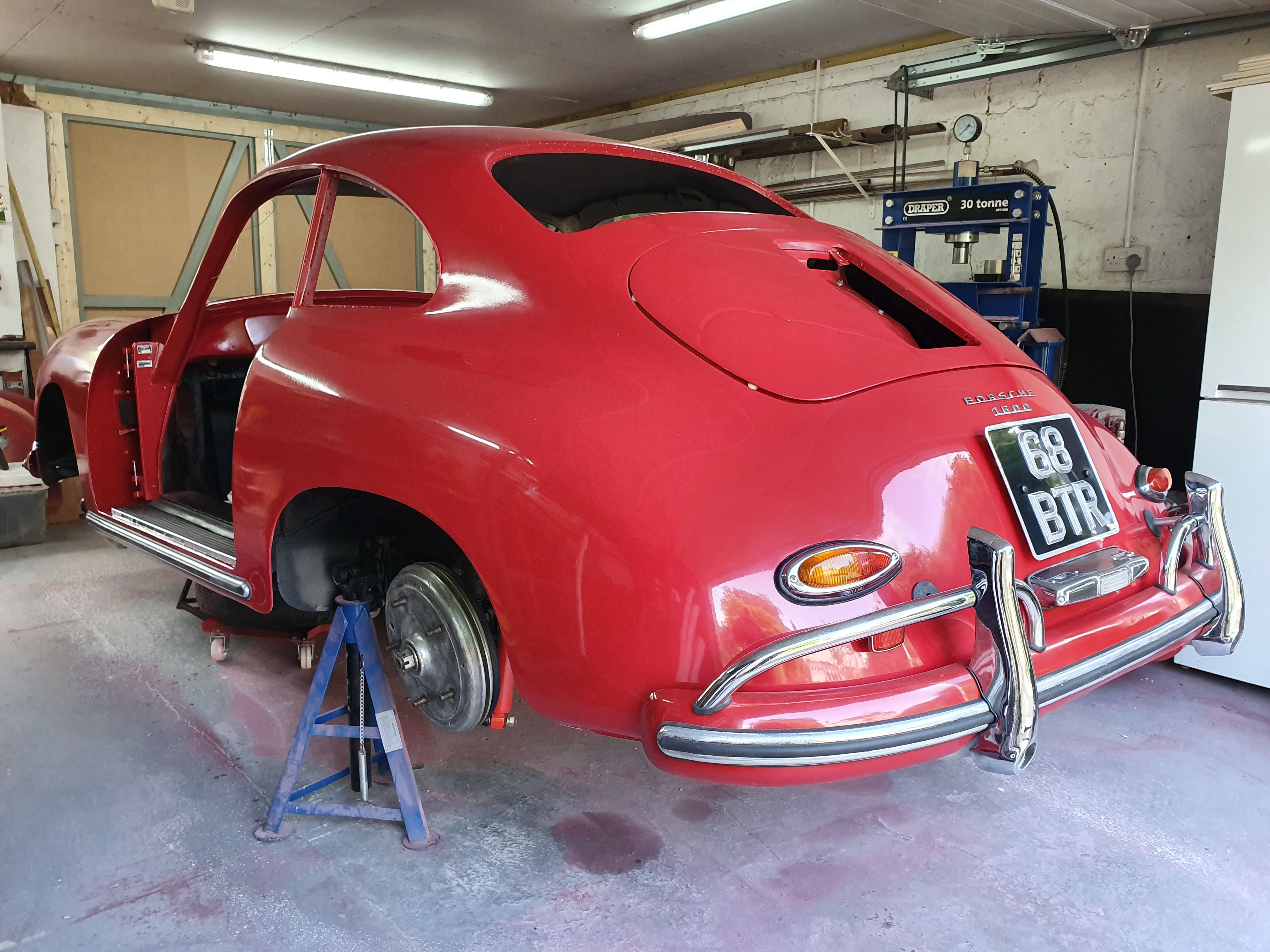

            With the temperature rising in the garage I could finally put some colour on the body.
            I'm using 1K cellulose which will give me a classic 'lived in' look rather than an overly shinny modern 2K look.
            So 6 coats later and with only one very small run it was finished and I could start fitting all the restored bits and pieces.
            The paint finish is pretty good but will need a good polish in a couple of weeks time when its completely dry.

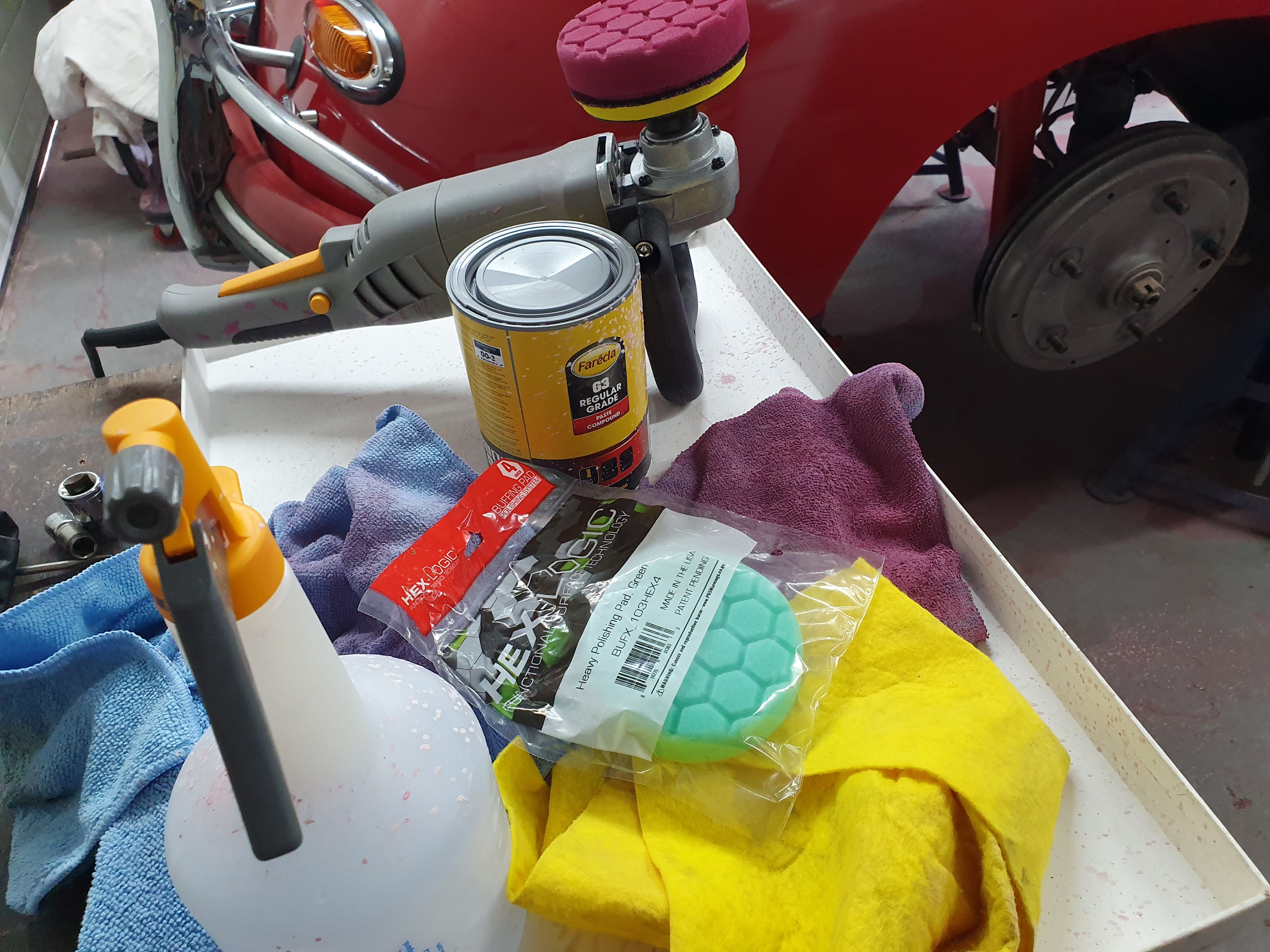

                      I have to admit that I got a bit ahead of myself with all the excitement of fresh paint and started fitting lights and bumpers etc. only to realise that the paint will need polishing and all this brightwork will get in the way.
                      So off with the shinny bits and on with the polishing.

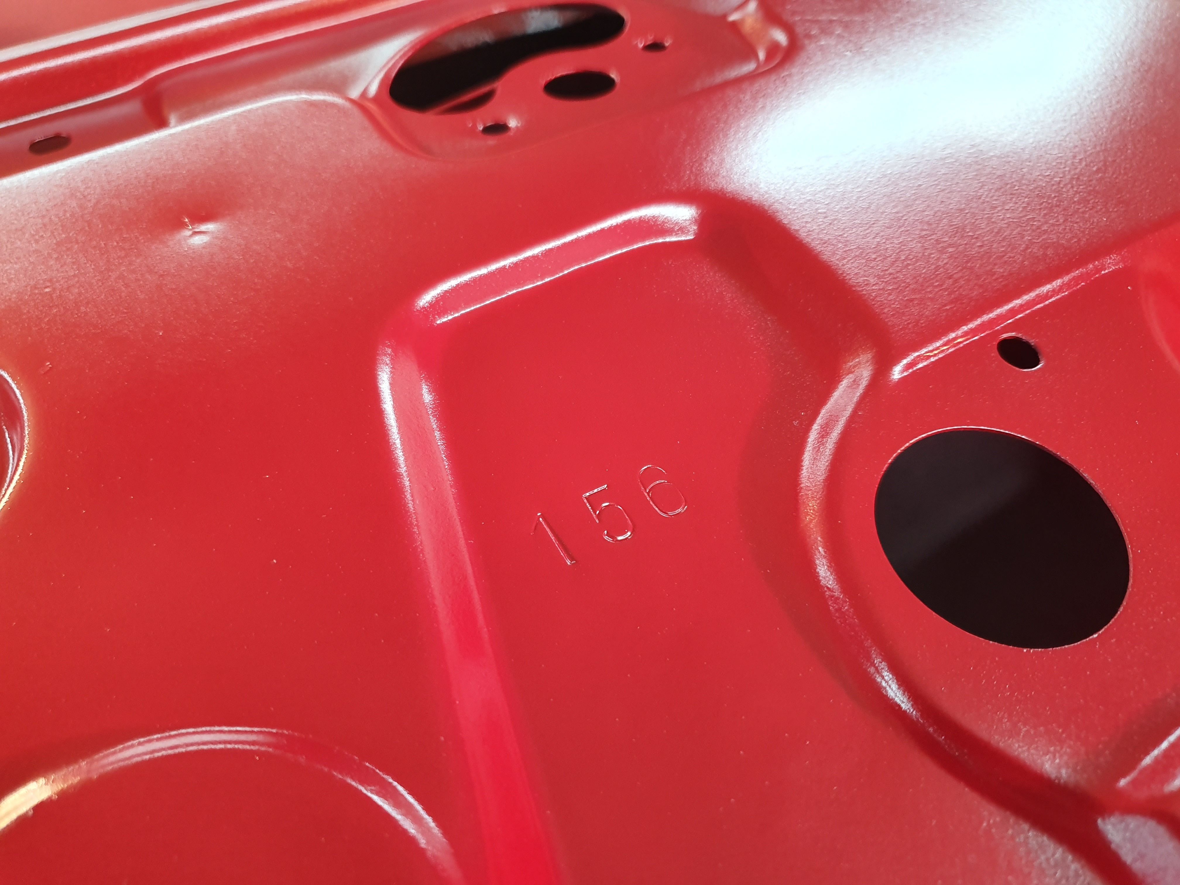

                      With a good thick layer of cellulose on the car I was able to machine polish it to a really nice shine. I used ‘Farecla’ G3 polishing compound on a ‘Hex-Logic’ pad running at just over 600rpm with plenty of water spray.
Name:	Polishing stuff.jpg

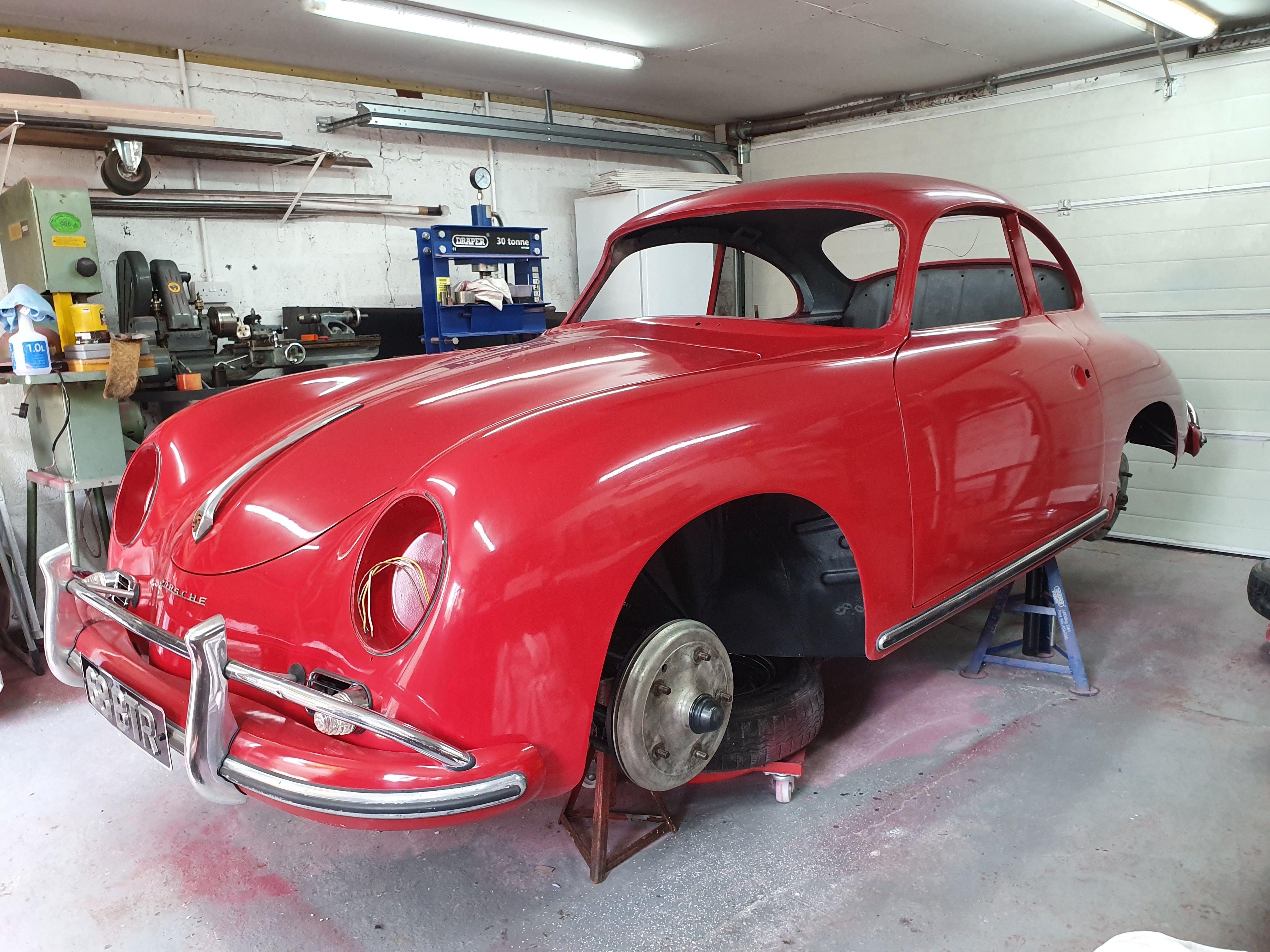

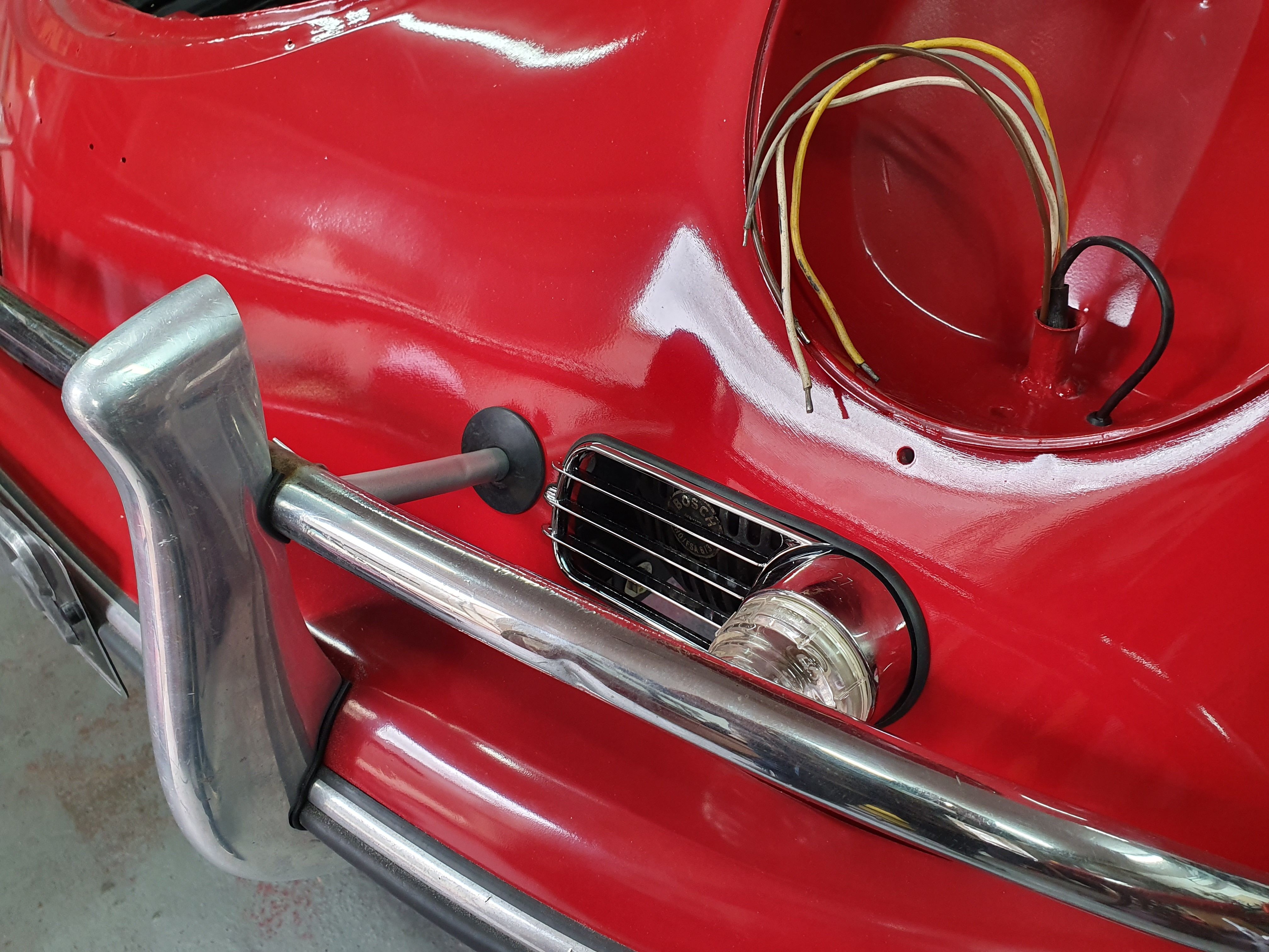

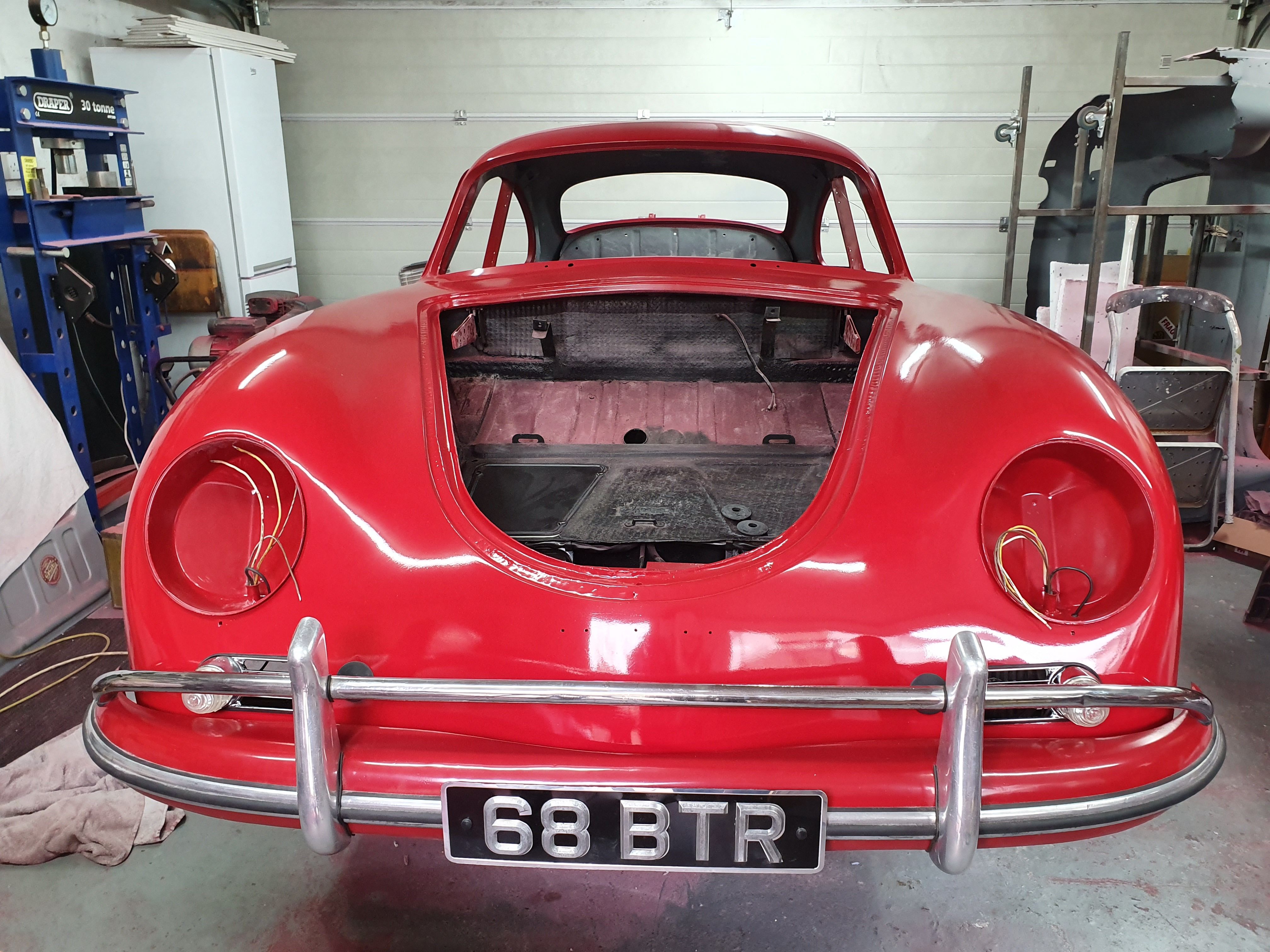

                      Here is the back end polished and fitted with bumpers, lights etc.
                      Moving forward and polishing as I go, should be in a position to start fitting up the doors and hoods in the next couple of weeks.

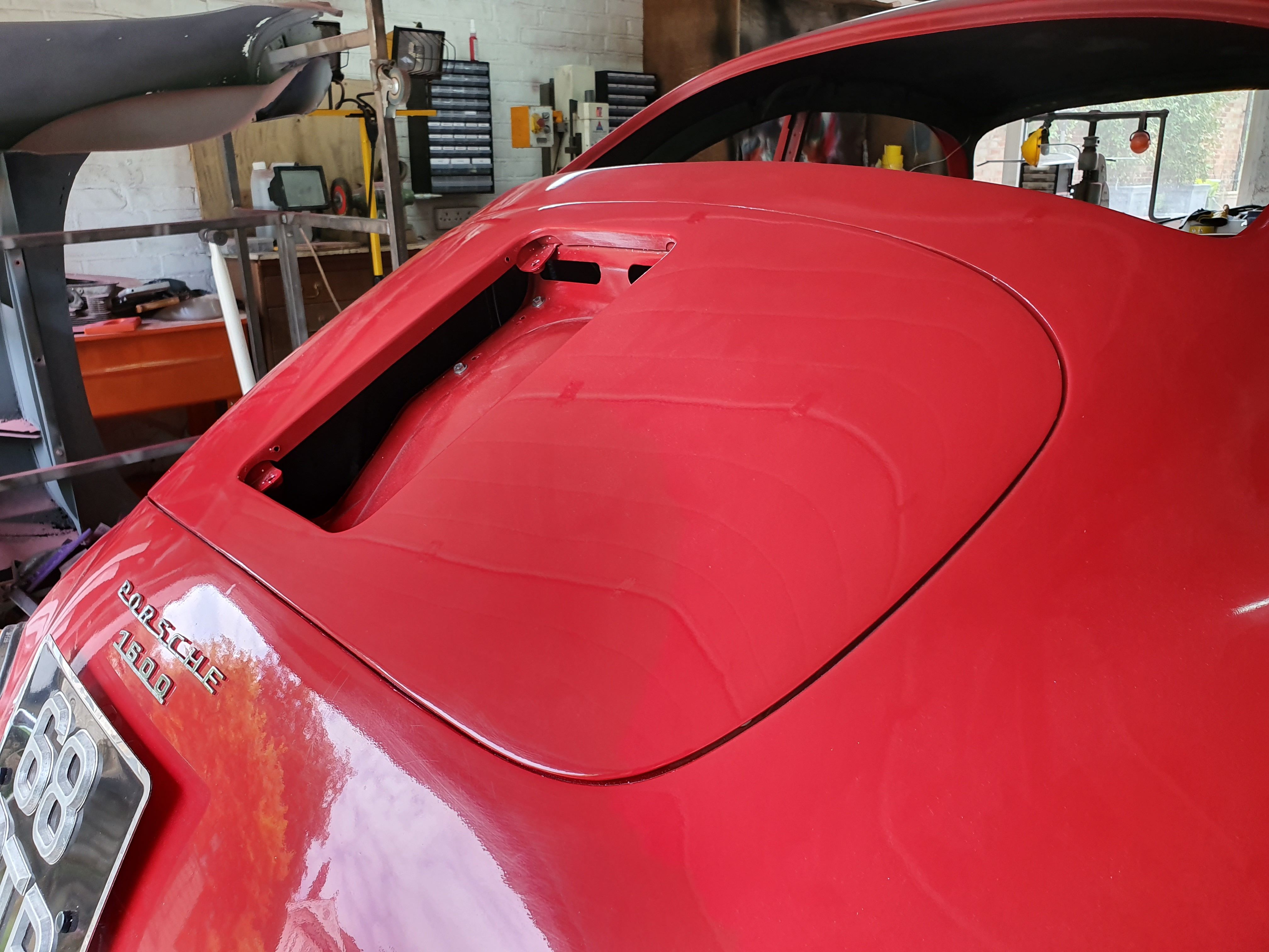

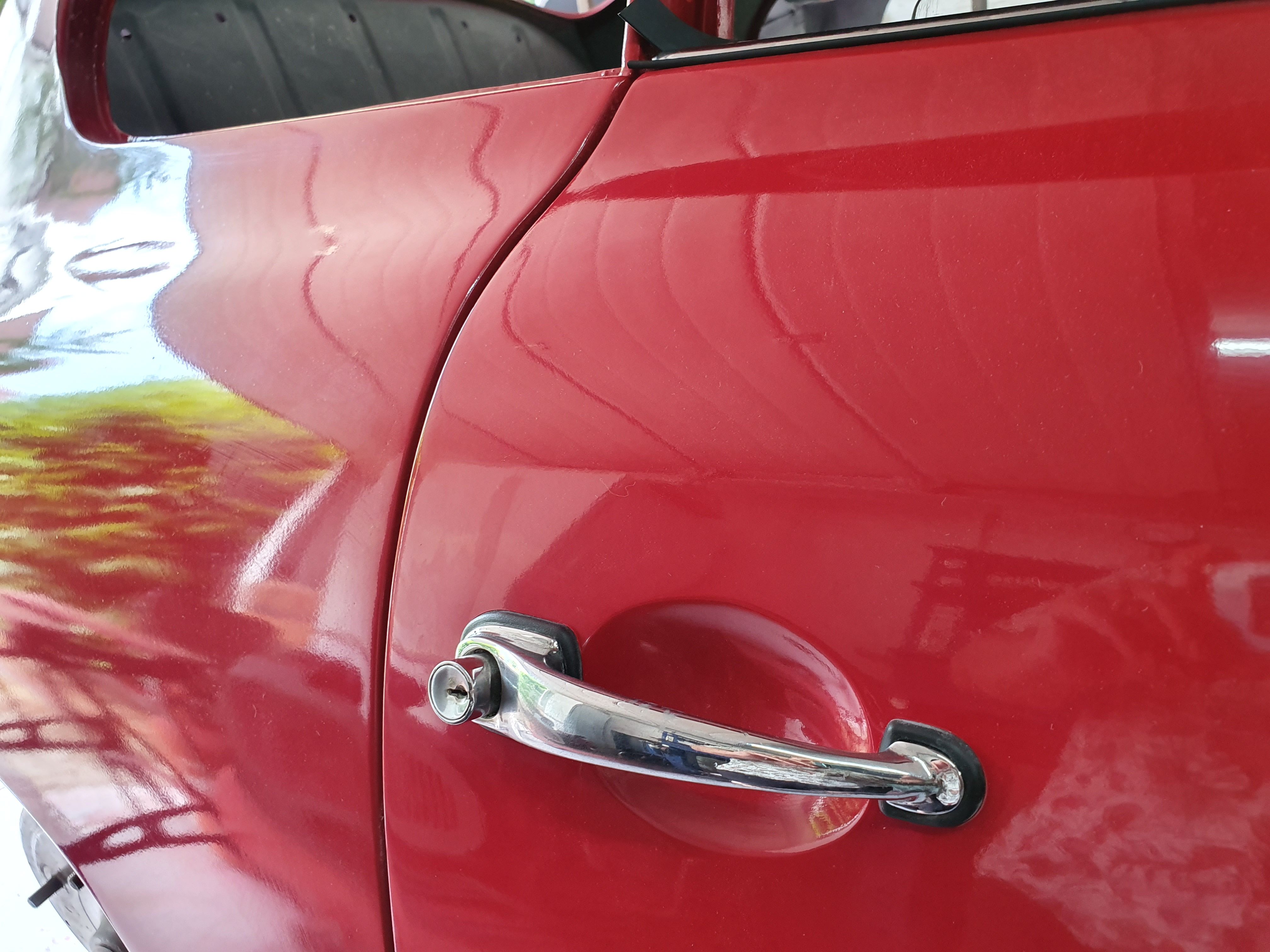

                        So the temperature is hitting 30 here in the UK and the time had come to enlist Kevins wisdom to re fit the doors and lids.
                        We thought we would do the easiest fist the rear engine lid, how wrong we were, it was all perfect in primer but somehow the position had changed very slightly with the top coat on.
                        It took two hours to coax it into the correct position but we got there.
                        Next up the doors... the right had one fitted perfectly first time with no dramas but the left one was a real bitch, in the end we had to reset the hinges very slightly to get to fit and latch properly.
ID:	114237 Click image for larger version

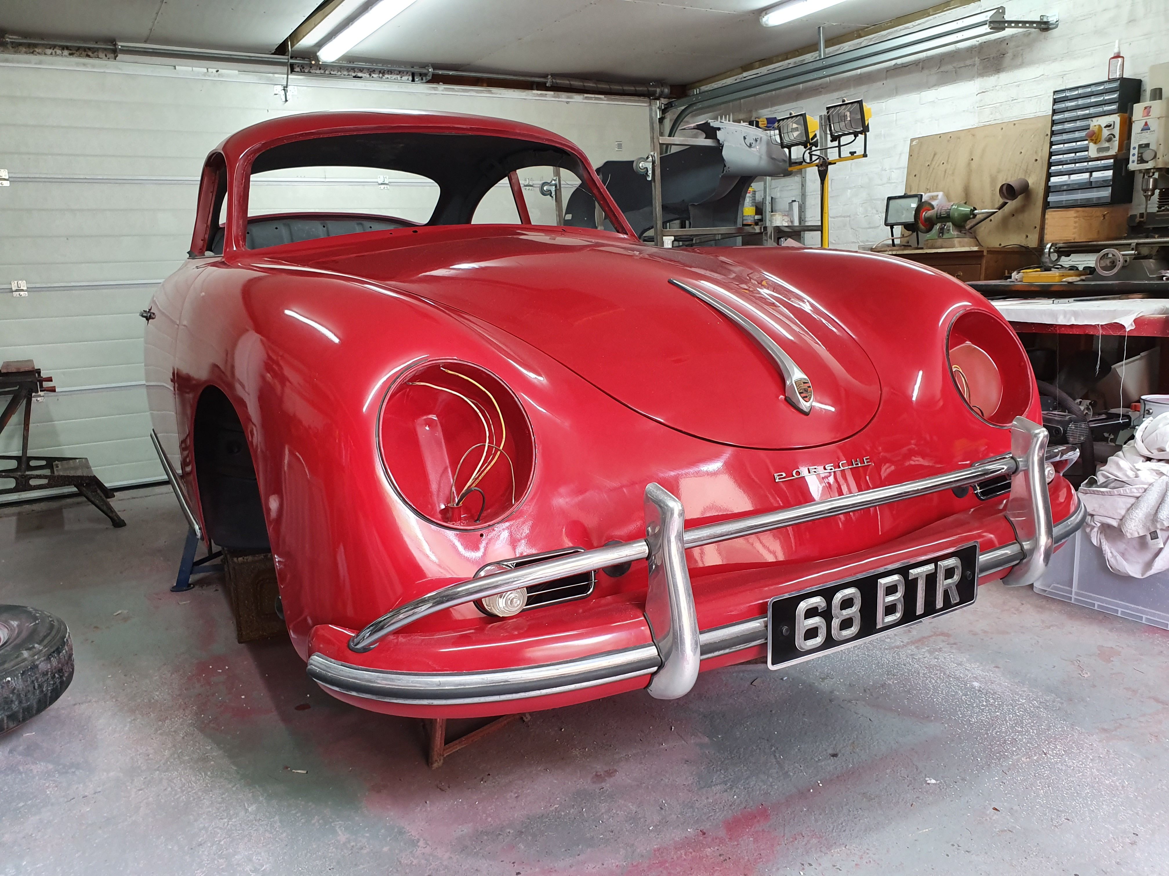

                        We had left the front hood till last as we knew it was going to be a struggle in fact when we were gapping it in primer the lid locked solid into the latch, thankfully I had left one of the access covers off in the battery box and attached a very solid safety wire to the lock which allowed us access to free things up, but it was touch and go for a while.
                        So with this previous experience in mind we nervously bolted up the hood, I was tasked with the final push on the front to latch it closed (if it locked solid it would be my fault).
                        I applied pressure with both hands, the hood clicked shut, the gaps were perfect but would it unlatch?
                        With a sharp pull of the release cable it opened...what a relief.
                        The car is one step closed to completion, thanks for stopping by.
