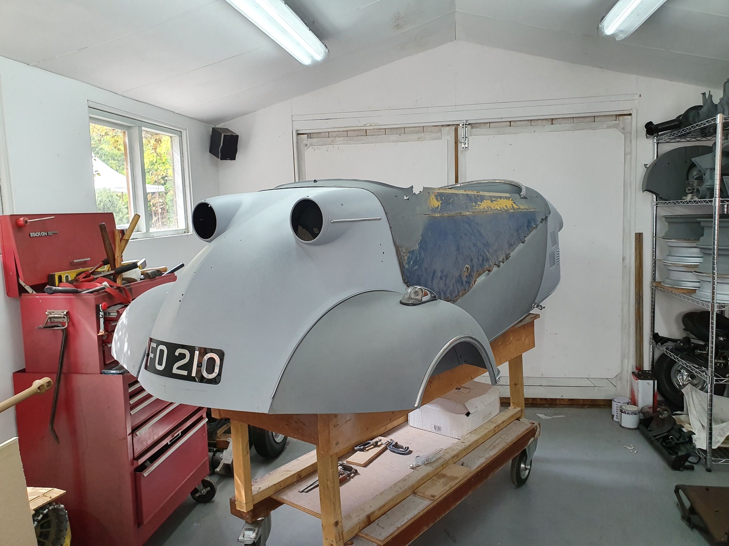

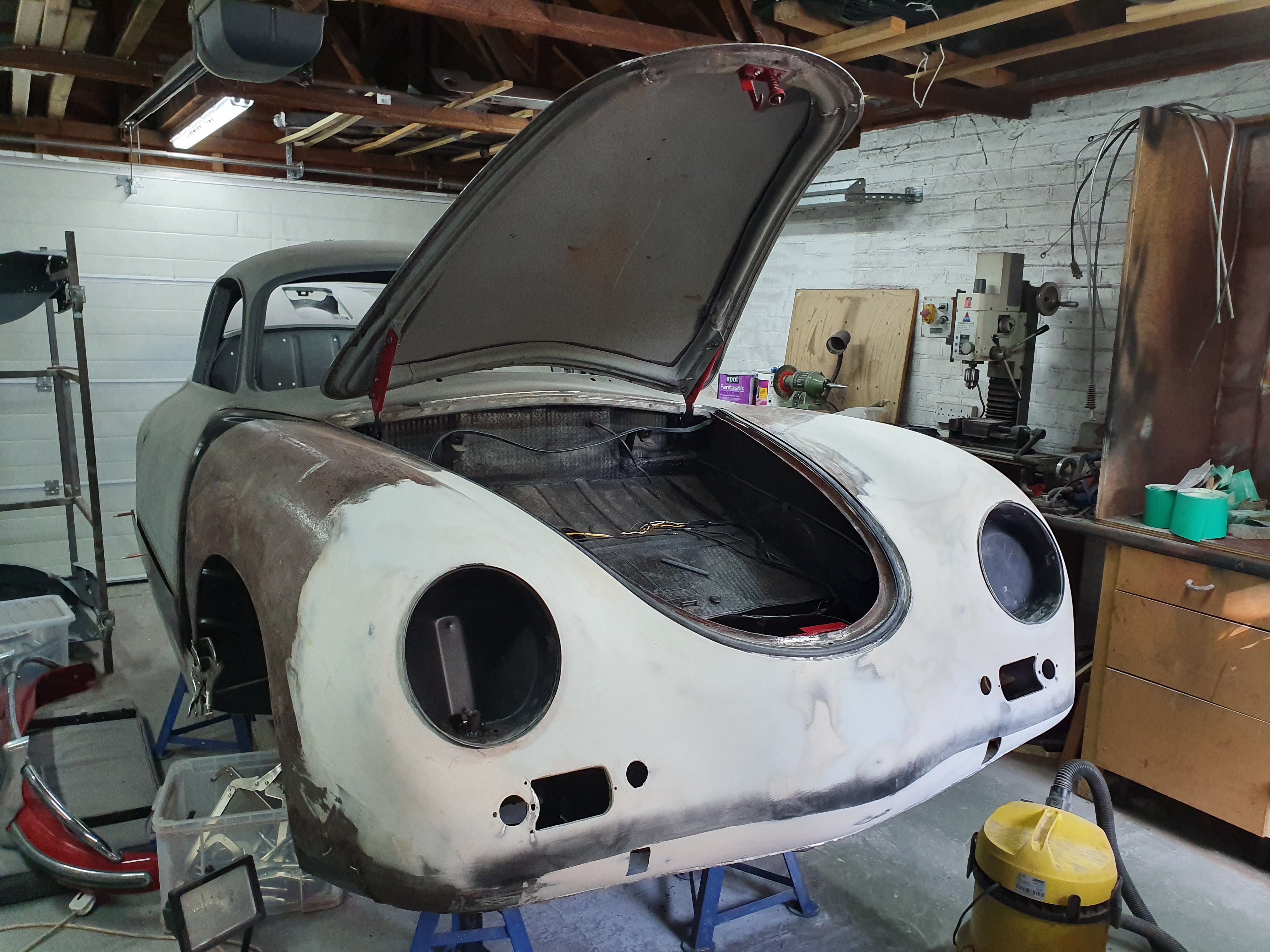

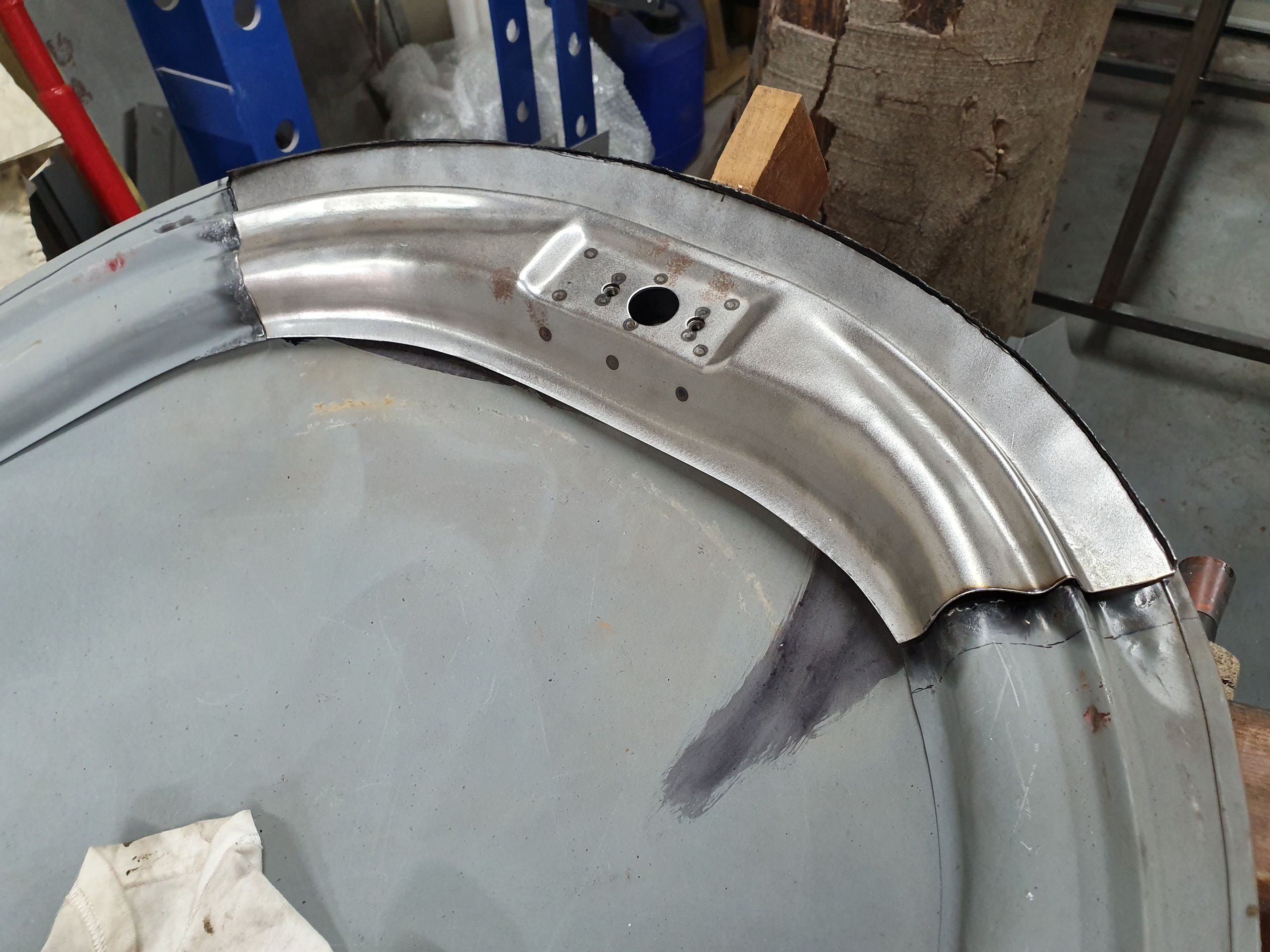

      Sometimes it’s good to leave a problem for a while and then come at it from a different angle and renewed enthusiasm.
      Neither hoods were fitting and after countless rounds of fitting, adjusting and re-fitting I returned to the first hood and cut out the front rusted through stamping.
      With this out of the way I could flex the nose of the hood just enough to get it all to line up ‘eureka’ time to start tacking.

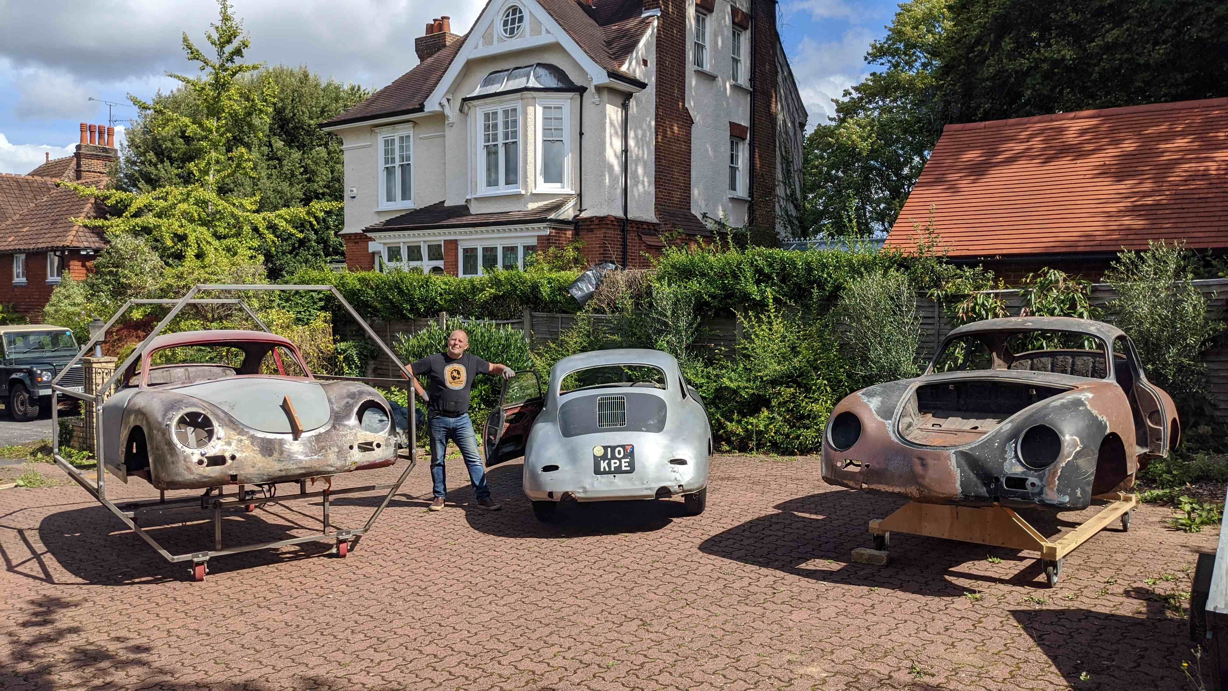

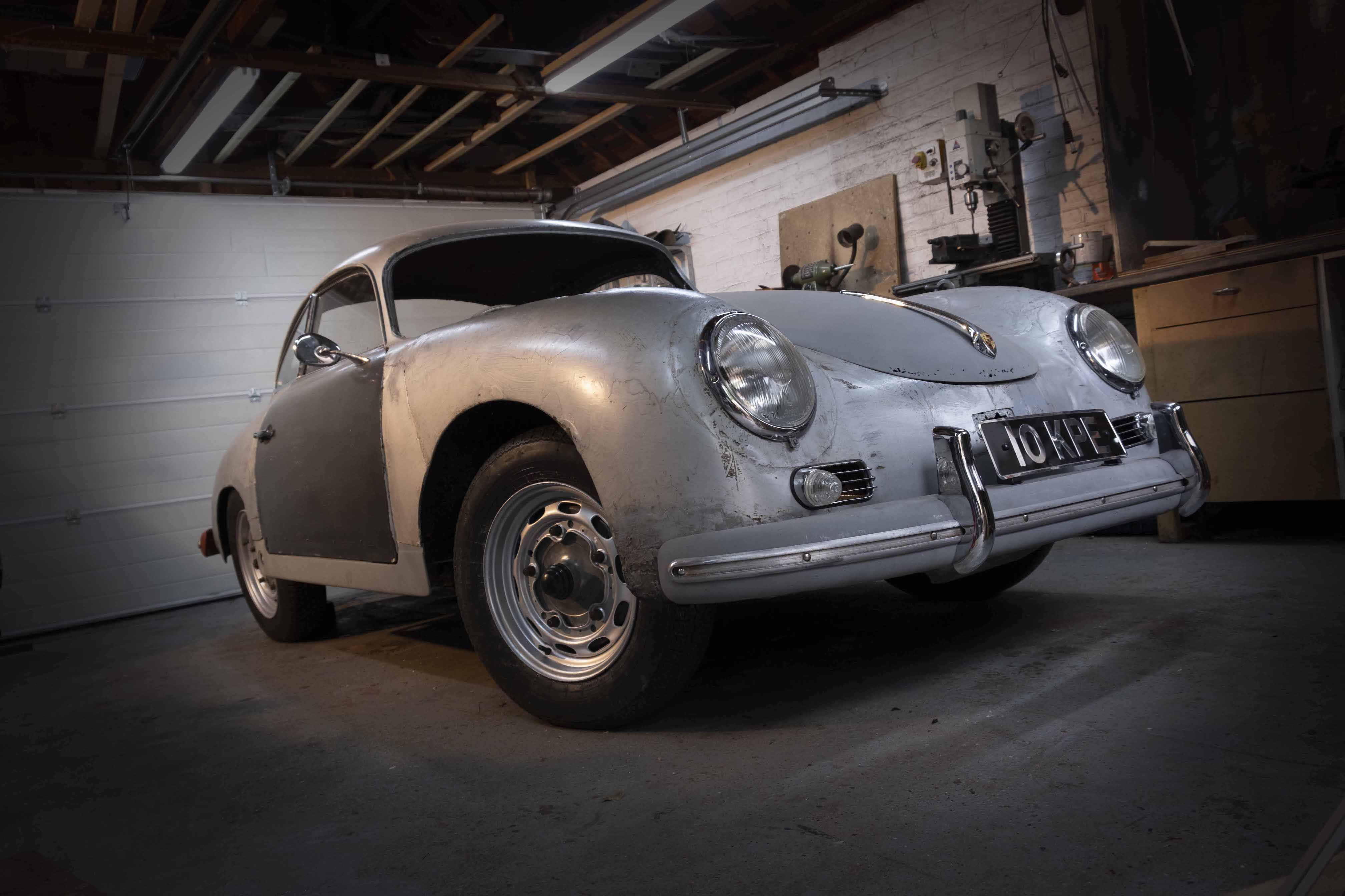

          Click image for larger version  Name:	My cars_sml.jpg Views:	0 Size:	1.72 MB ID:	112356
          The South African Queen (on the left) has had many, many hours invested in it and will eventually get finished and sold. The LHD body shell (on the right) will become my final project so that one had to stay, so that left 10 KPE (the on in the middle) I was never going to get around to this one so she had to go.
          It’s a 1959 RHD 356A super coupe, original UK AFN delivery car with original rebuilt super engine, so quite rare. I spent a few weeks digging out all the parts that I had hidden away over the years and set about finding her a new home.
          The first person to see her paid almost my full asking price and will give her all the TLC that she deserves.
          Click image for larger version  Name:	10 KPE final copy.jpg Views:	0 Size:	534.8 KB ID:	112357
          So then there was two, a much more manageable figure.
          Hopefully 2021 with see renewed enthusiasm for finishing The African Queen.

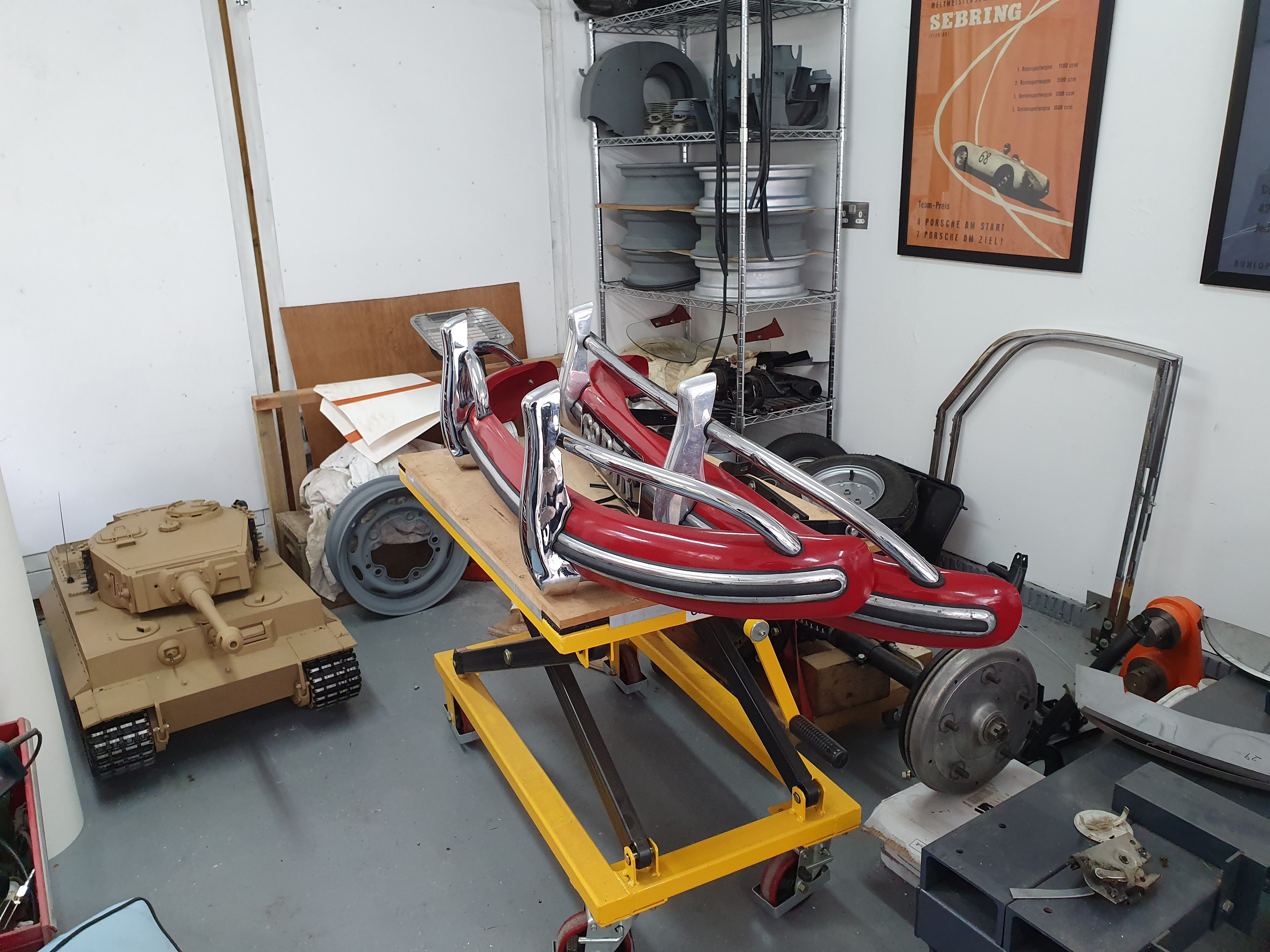

          • OK so here's the next update from back in early 2021.

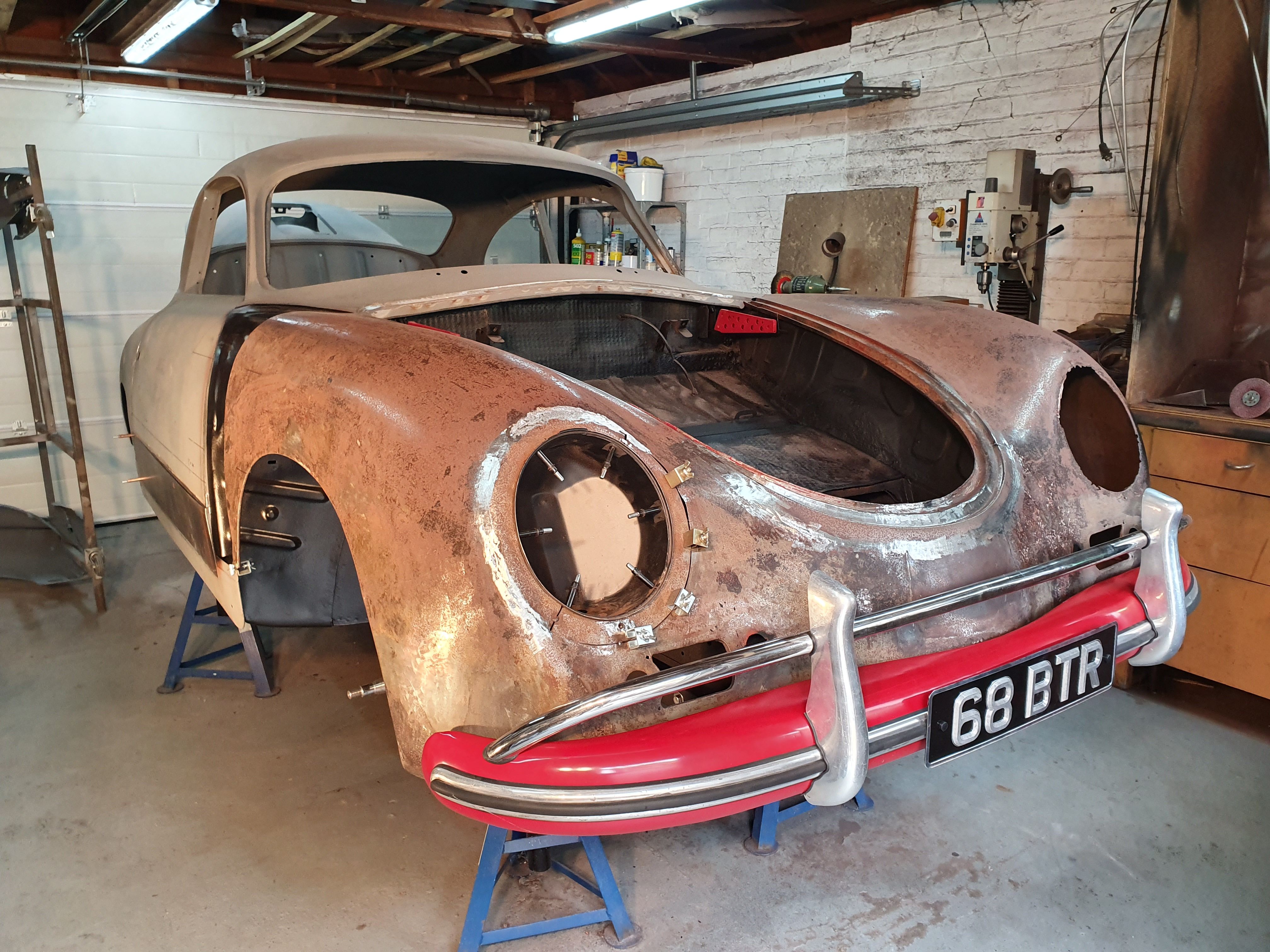

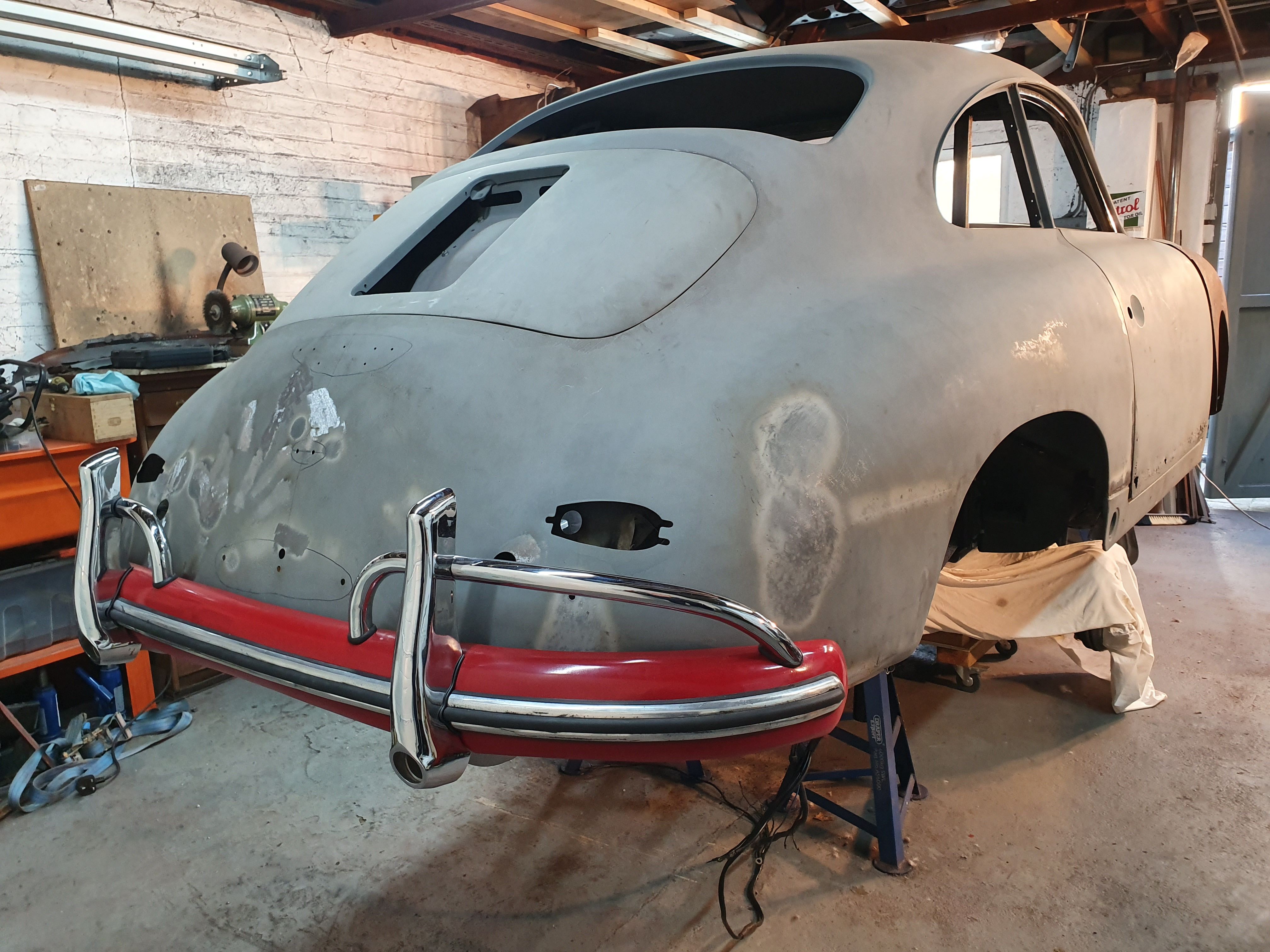

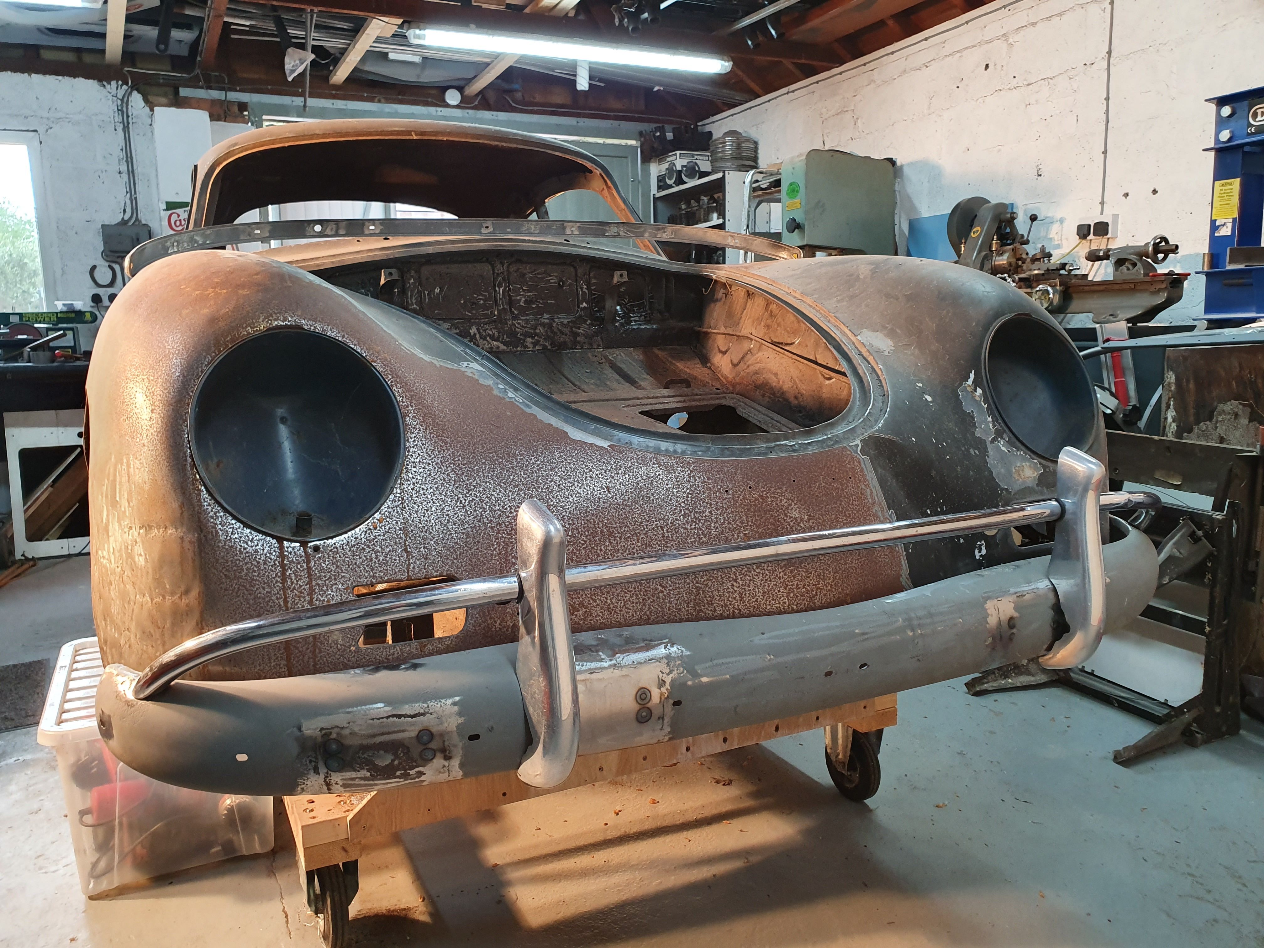

            I needed something to kick start the final push on the 'South African Queen' so I decided to put the bumpers in the 'Done' pile, I know this seems a bit strange when the body needed so much work but I needed a psychological lift with all this Covid still hanging around.
            The original bumpers were in a bad way and with no attachment points on the 'Queen' I used the 'LHD 58 body shell' as a jig to get the correct shape.
            Click image for larger version  Name:	20210525_163547.jpg Views:	0 Size:	1.48 MB ID:	112359
            Click image for larger version  Name:	20210525_163526.jpg Views:	0 Size:	1.48 MB ID:	112360
            After a load of welding, cutting, bending and more welding, the bumpers were ready for a coat of Ruby Red.
            Click image for larger version  Name:	20210822_143002.jpg Views:	0 Size:	1.22 MB ID:	112361
            Click image for larger version  Name:	20210822_143013.jpg Views:	0 Size:	1.29 MB ID:	112362
            It's funny how a diversion like this can get you in the mood to finish the rest of the car.

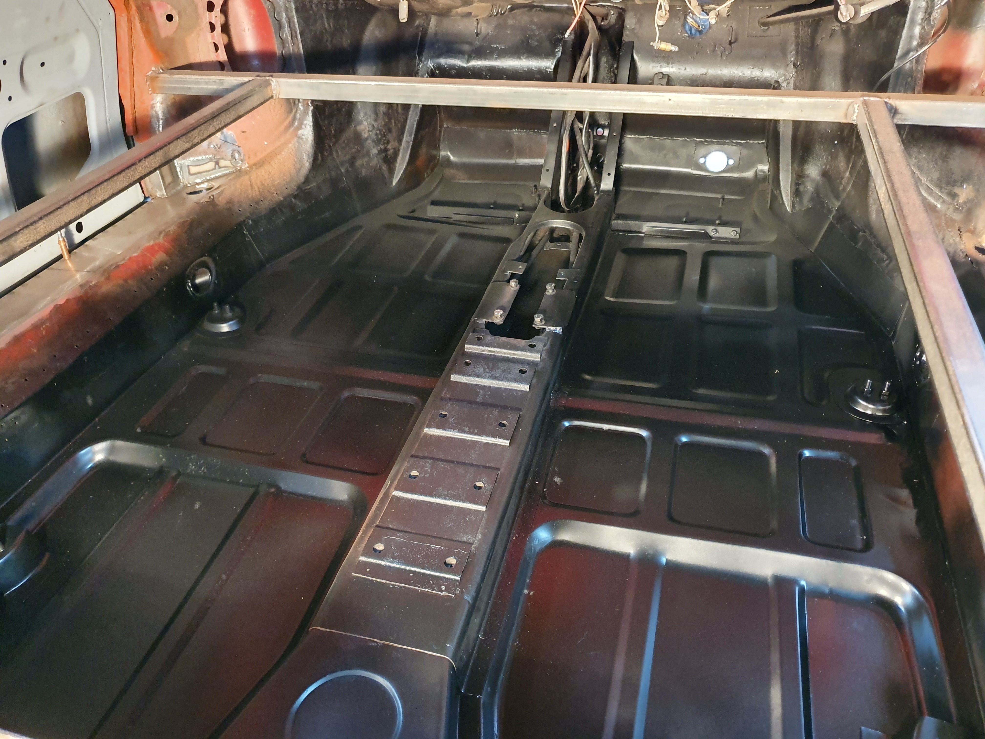

                  Next milestone was the floor in for good, what a delight to see so much fresh, painted steel.
                  Click image for larger version  Name:	20210816_150937.jpg Views:	0 Size:	1.14 MB ID:	112762

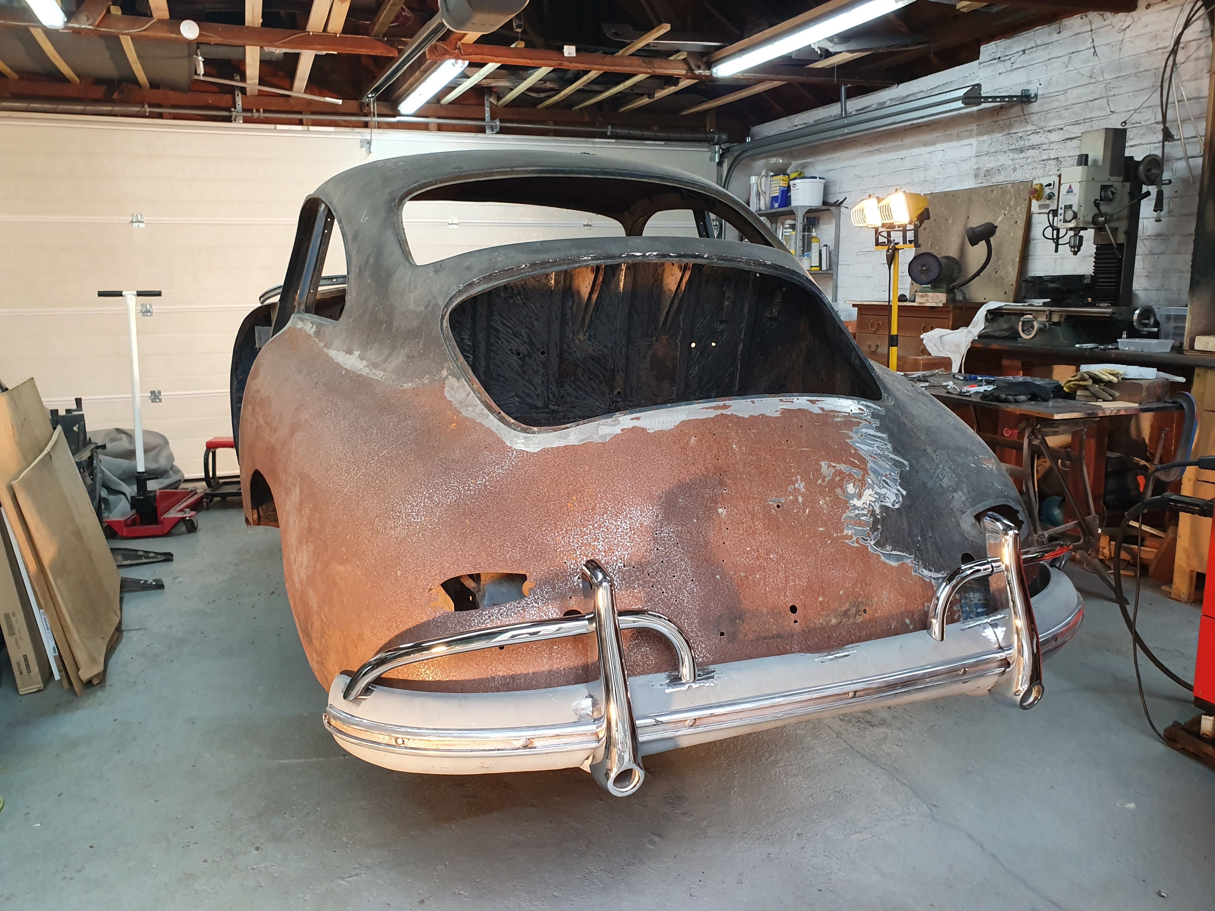

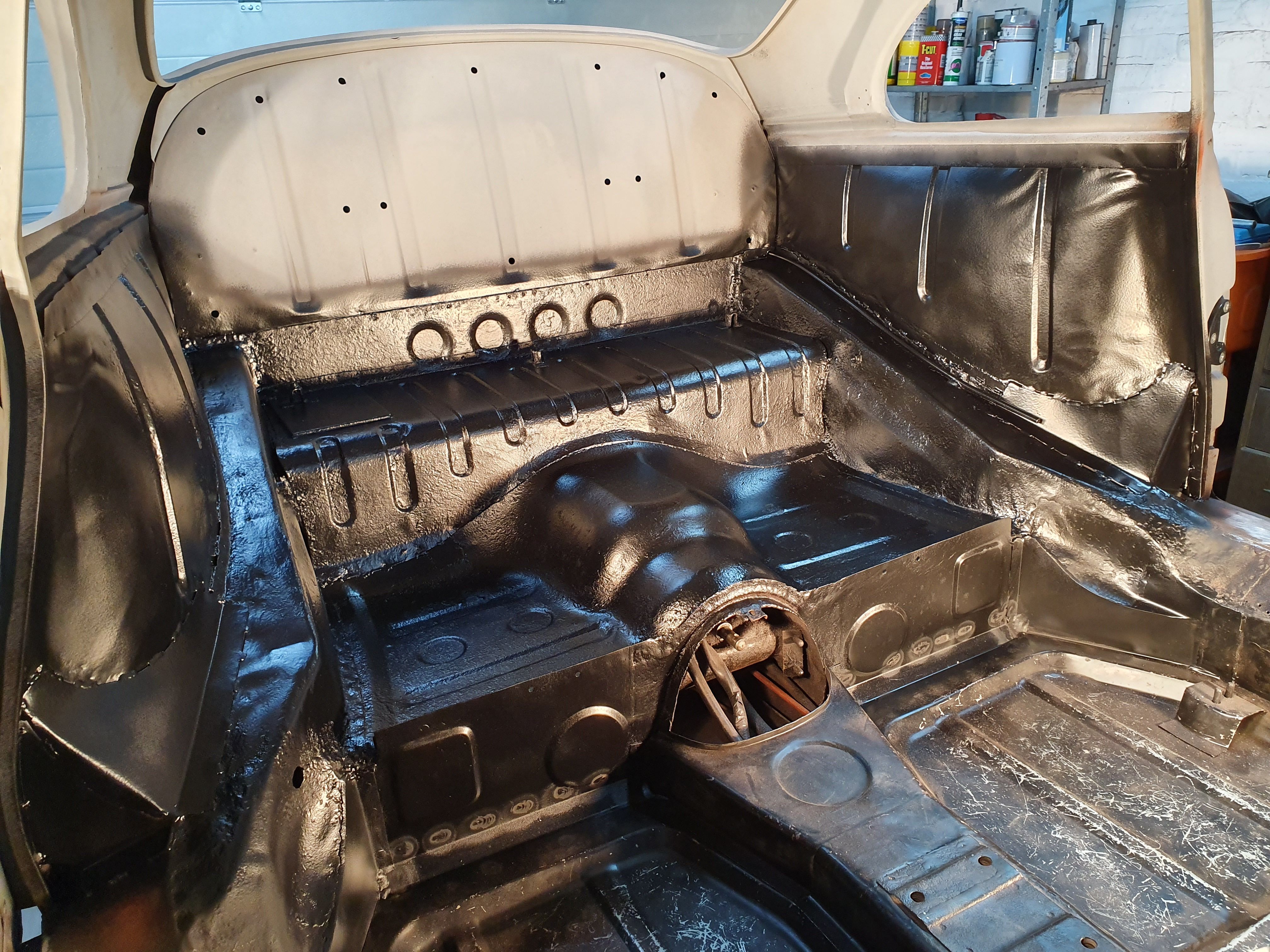

                  Then the whole rear was blasted, repaired and finally hammered and dollied into shape.
                  Click image for larger version  Name:	20220116_151339.jpg Views:	0 Size:	1.27 MB ID:	112763
                  Now I know what your all saying… WOW Drew is really motoring, but I will have to admit that I have had some help. Every other Saturday for the past few months my brother in law ‘Kevin’ has been helping out and he’s not your average ‘brother in law’ in fact he has been panel beating and welding up some incredibly expensive cars for over 40 years.
                  This next picture of the rear interior will give you some idea of his immense skill.
                  Click image for larger version  Name:	20220316_121057.jpg Views:	0 Size:	1.80 MB ID:	112765

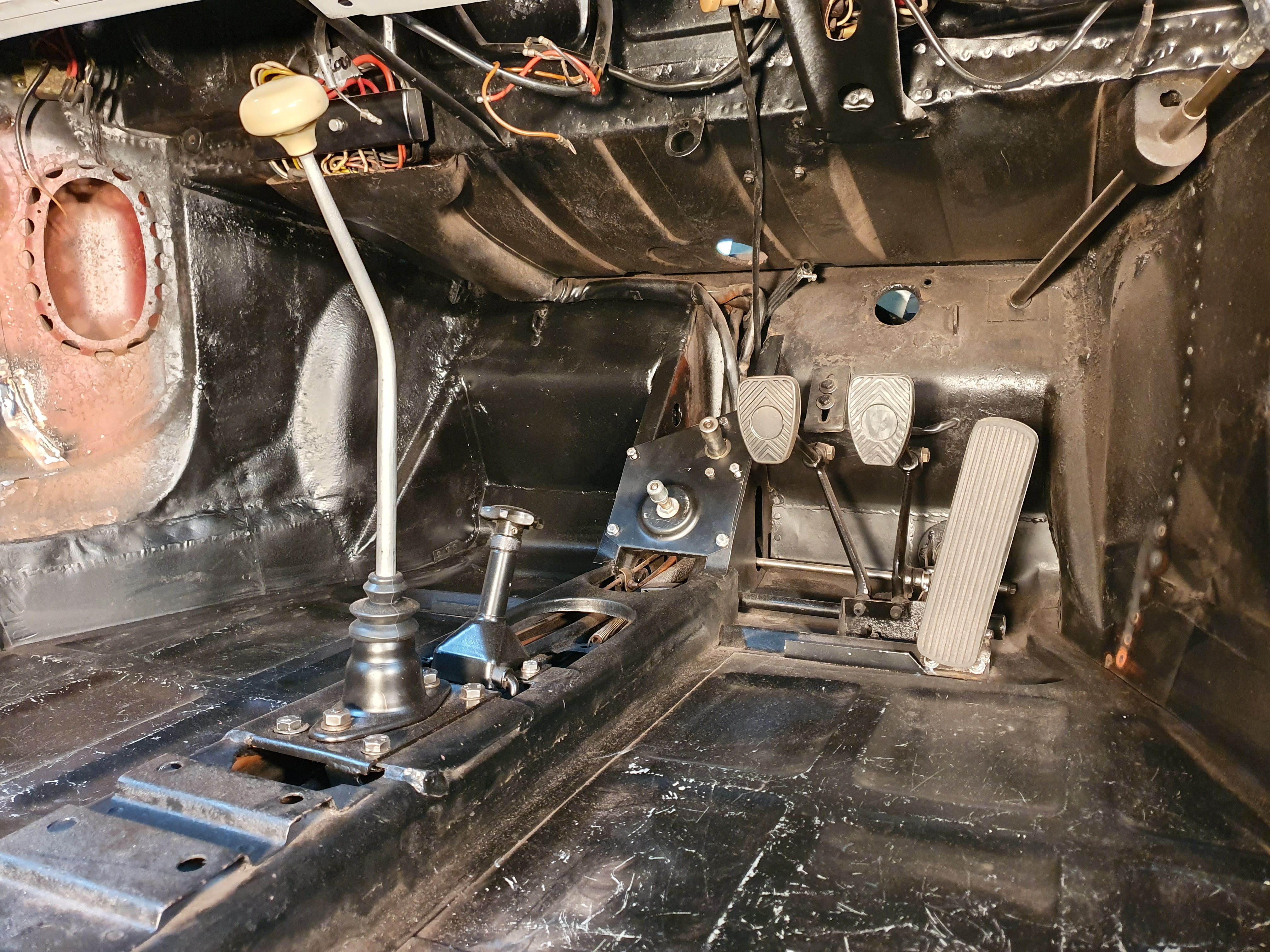

                  That about brings me up to date, RHD pedal assembly is in, gearbox is in, front ZF box and running gear is in…..we are getting close now.
                  Click image for larger version  Name:	20220404_131228.jpg Views:	0 Size:	1.80 MB ID:	112764

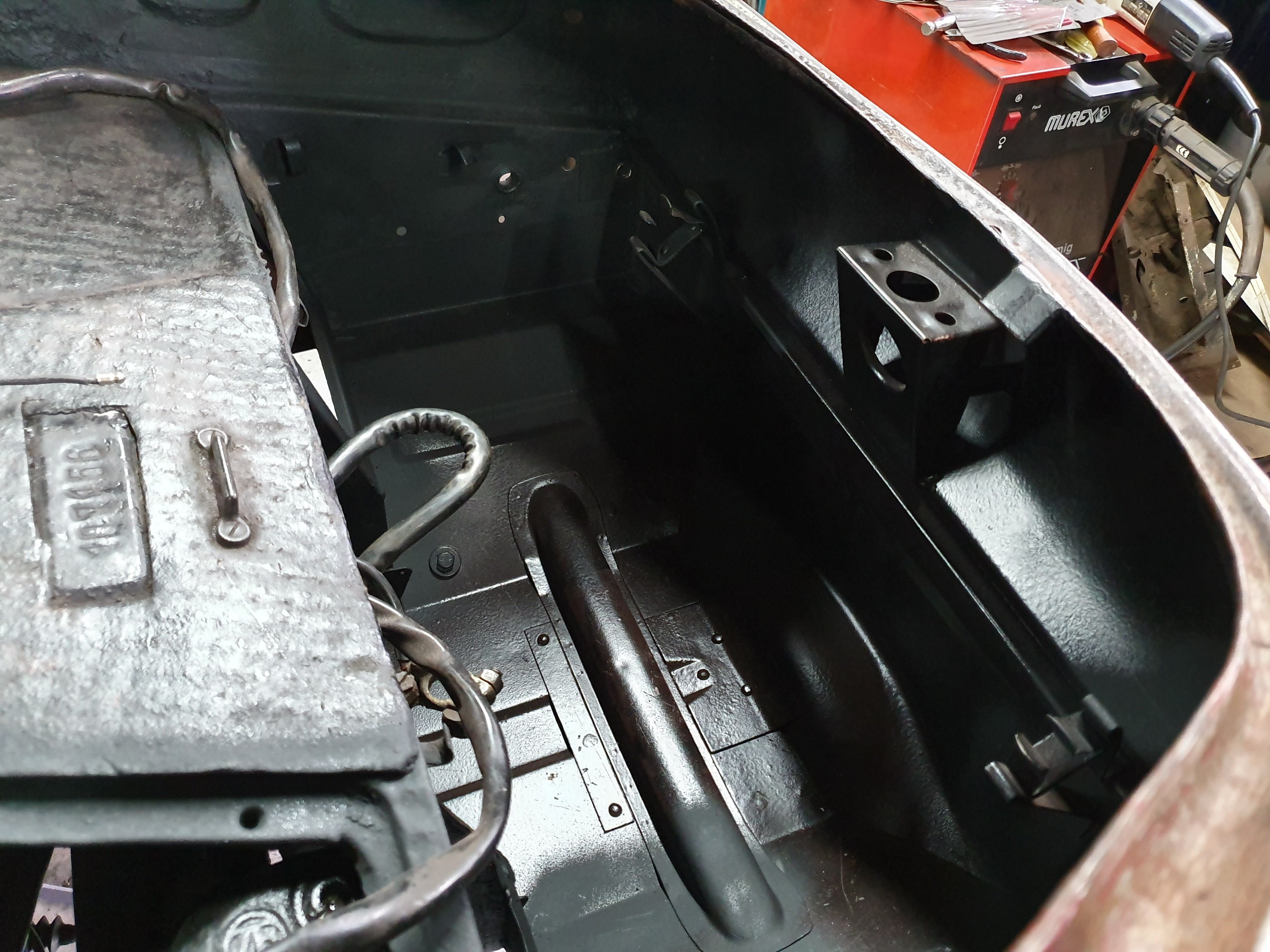

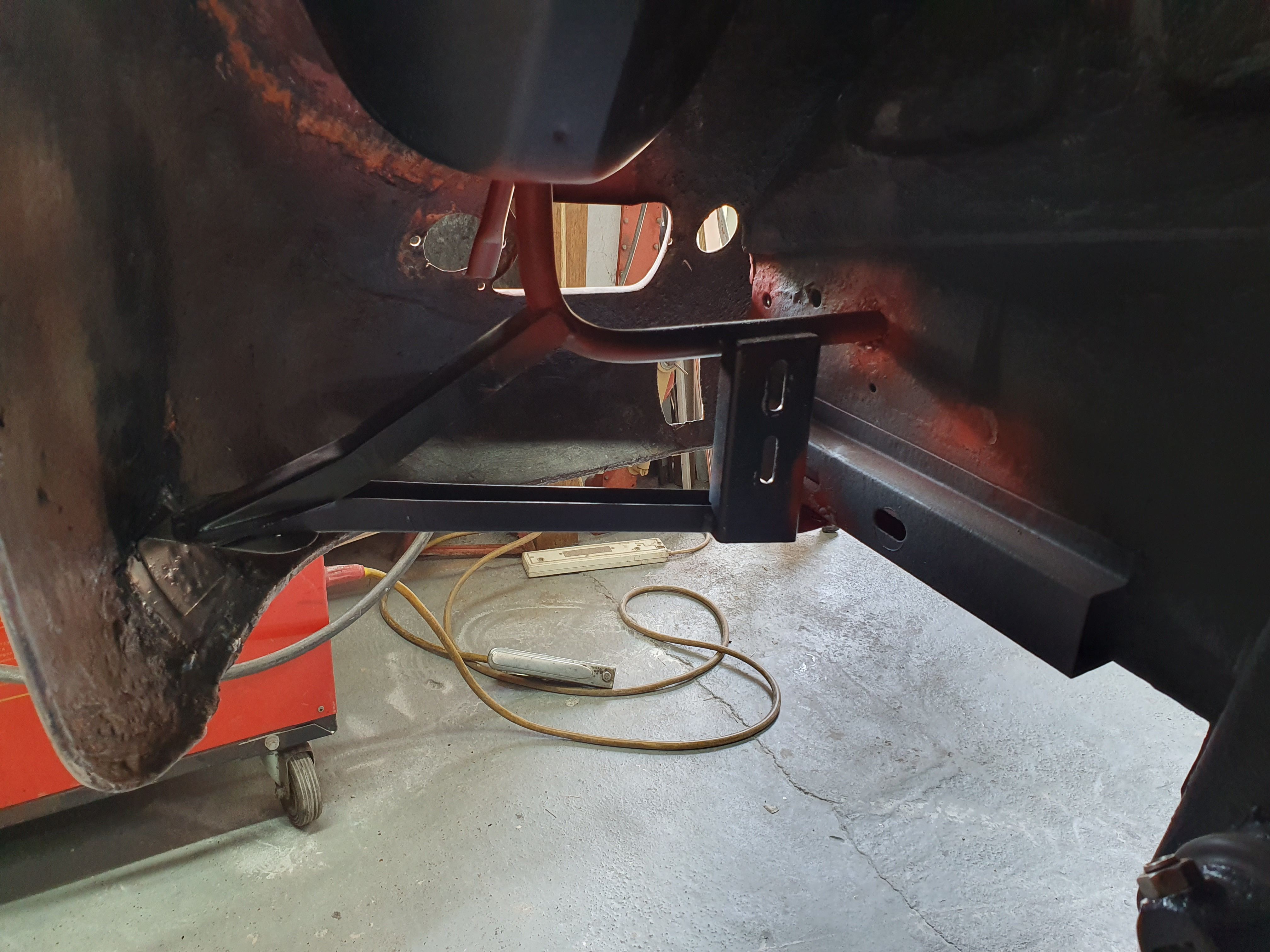

                    Things are starting to come together, with the battery box all sorted I could finally check the front bumper fit, which is spot on.
                    We have also made a start on the headlight buckets and surrounds which I have been putting off for some years (thankfully my brother in law is not phased).

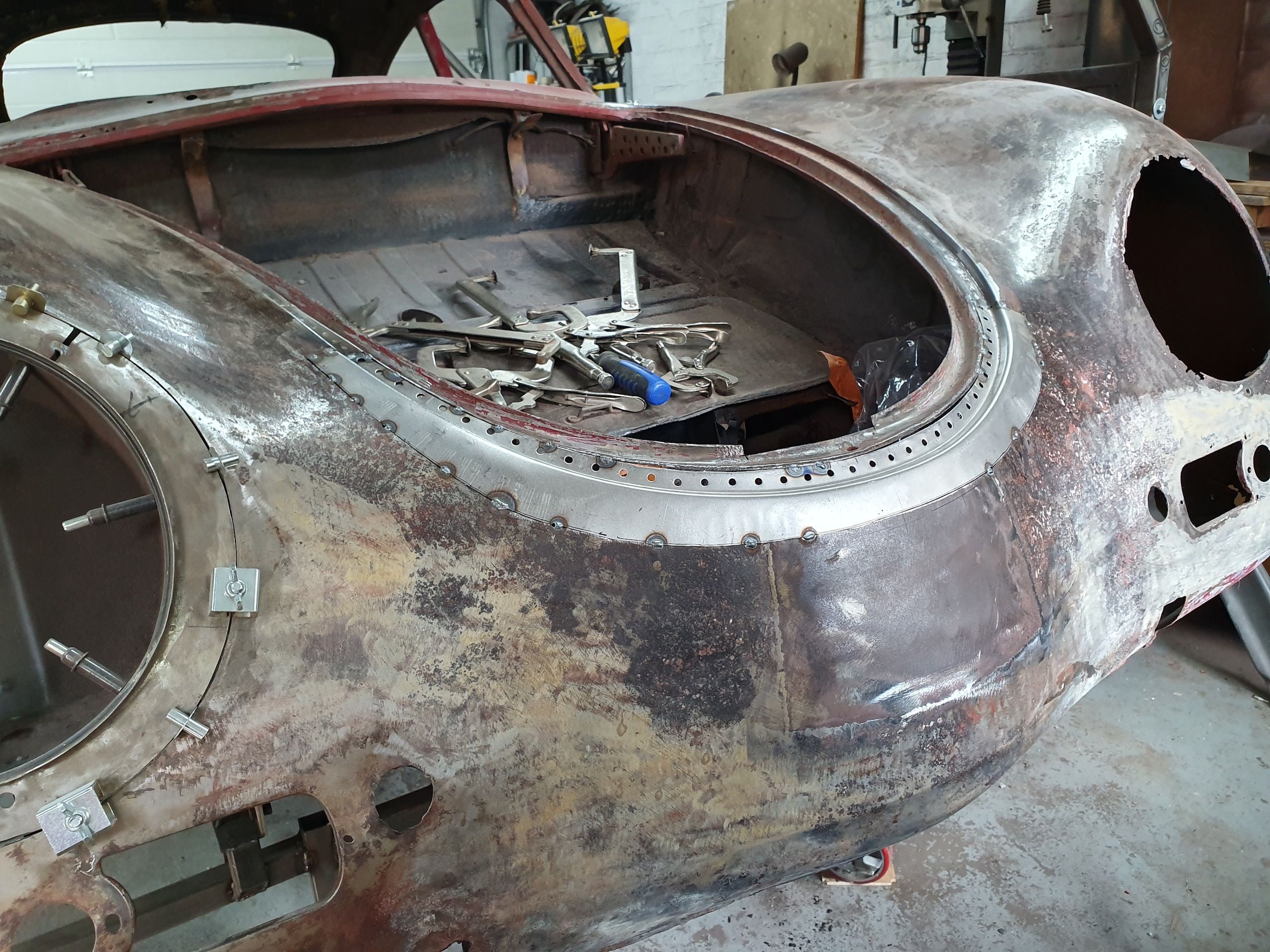

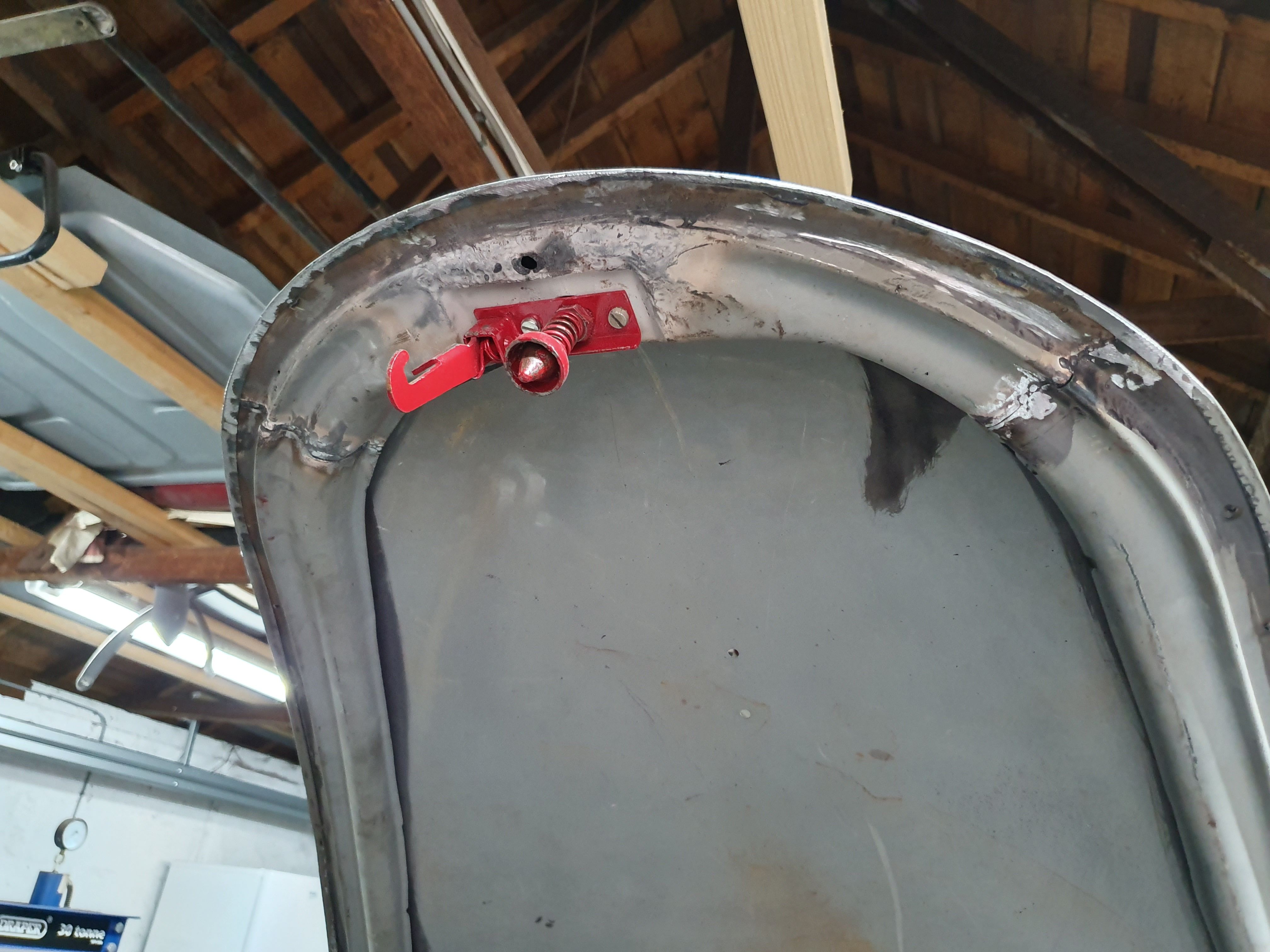

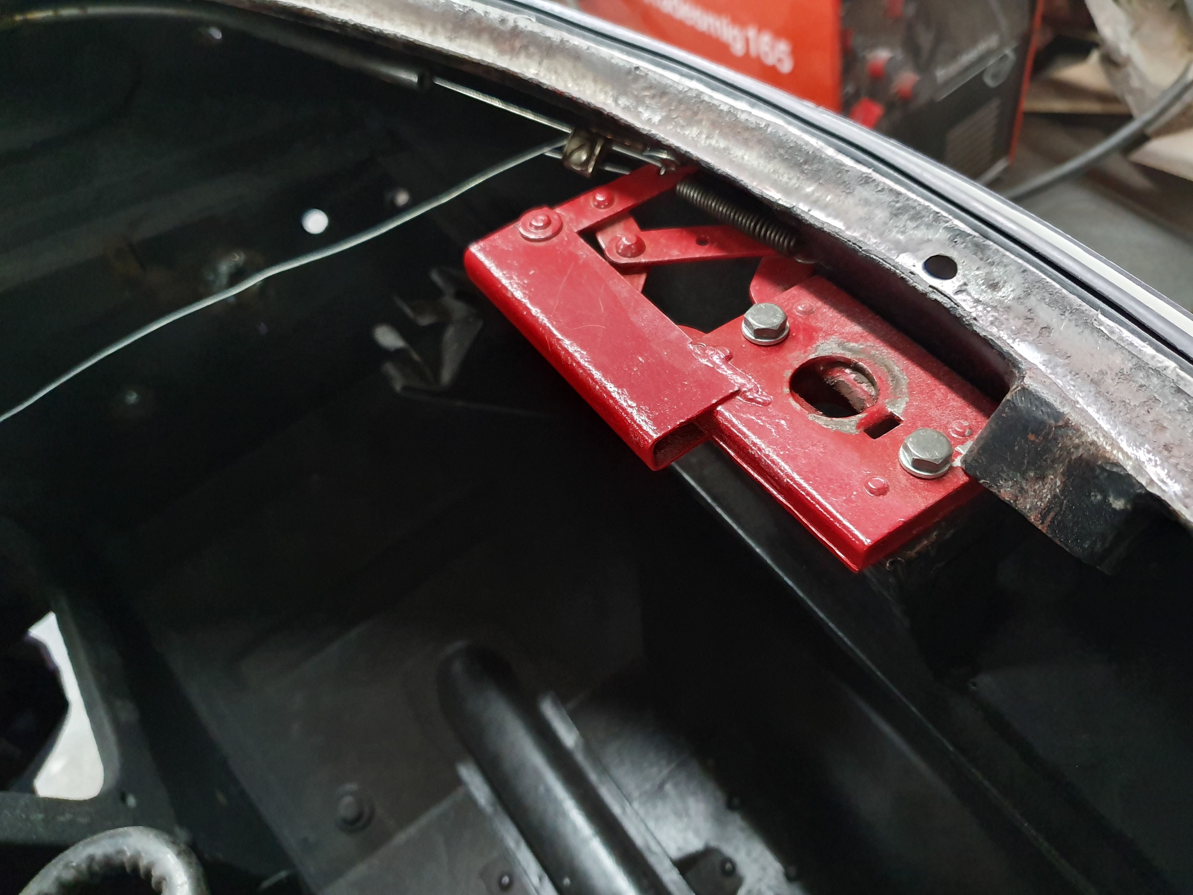

                      One of the trickiest parts of this restoration has been the front hood, it had been kinked by a gas station attendant at some point and in my haste/desperation to get it to fit I cut out the lower front structure.
                      My plan was to use a new repro panel from Germany but Kevin (the brother in-law) had a different idea, luckily I had saved the original panel and after a couple of hours he had removed the outer skin and welded up the complete frame.
                      Click image for larger version  Name:	20220717_180008.jpg Views:	0 Size:	1.00 MB ID:	113079
                      This is where years of experience comes in, with the front hood as a bare frame we could bolt it up and push and pull it until we had a perfect fit to the opening, then we crimp the original hood skin back on and hey presto! We had a perfect fitting hood that slid into the lock with a lovely Porsche ‘Clunk
                      ’. Click image for larger version  Name:	20220717_180001.jpg Views:	0 Size:	1.08 MB ID:	113084
                      Click image for larger version  Name:	20220717_175952.jpg Views:	0 Size:	1.37 MB ID:	113081
                      With the front hood in the ‘done’ pile we could finish off the headlight bucket supports, fabricate and weld in the flared wire conduit tubes and finally weld in the lower fender support brackets, these allow a small amount of flex in the lower front wing which we used to get a perfect fit to the bumper.

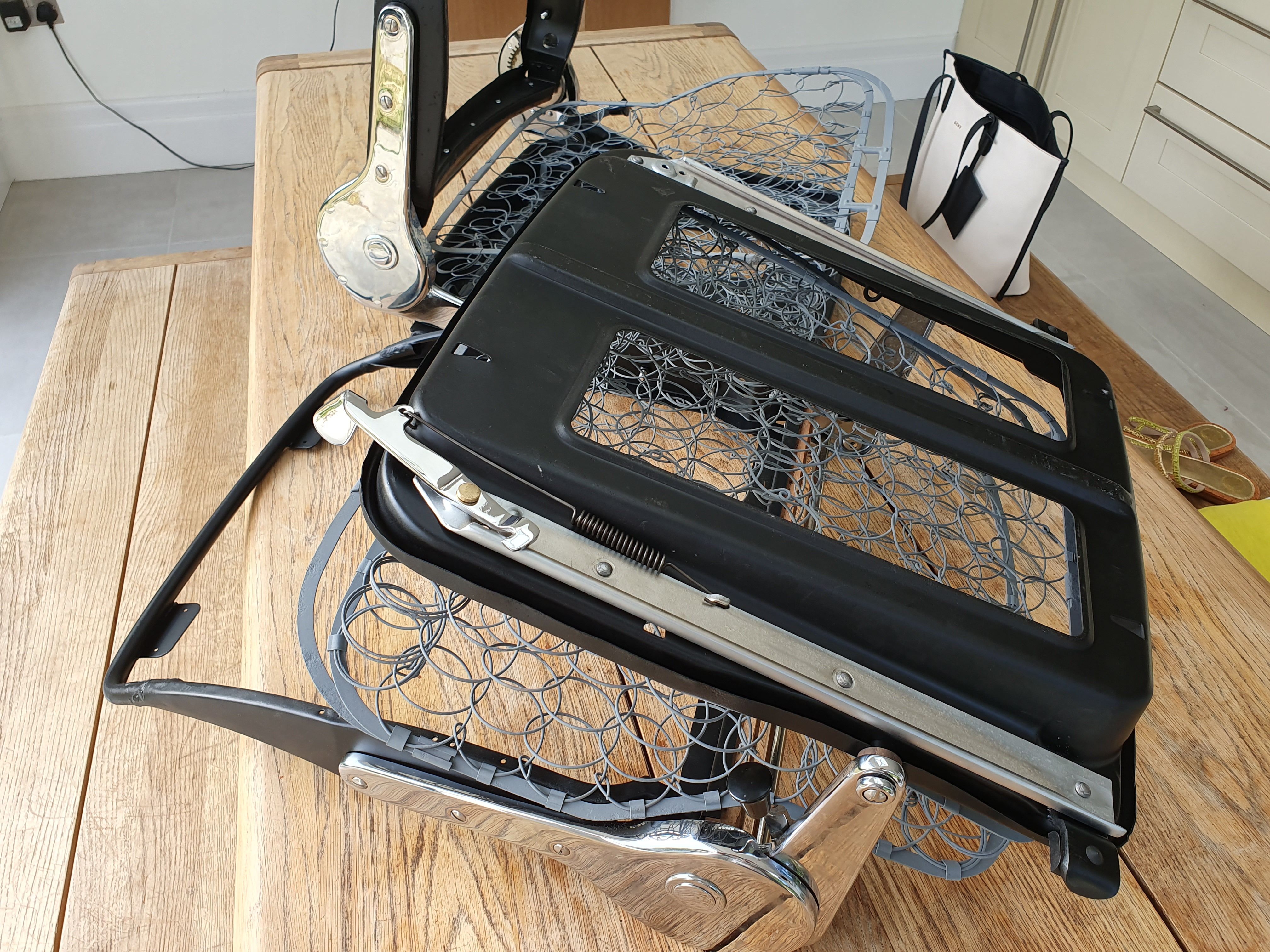

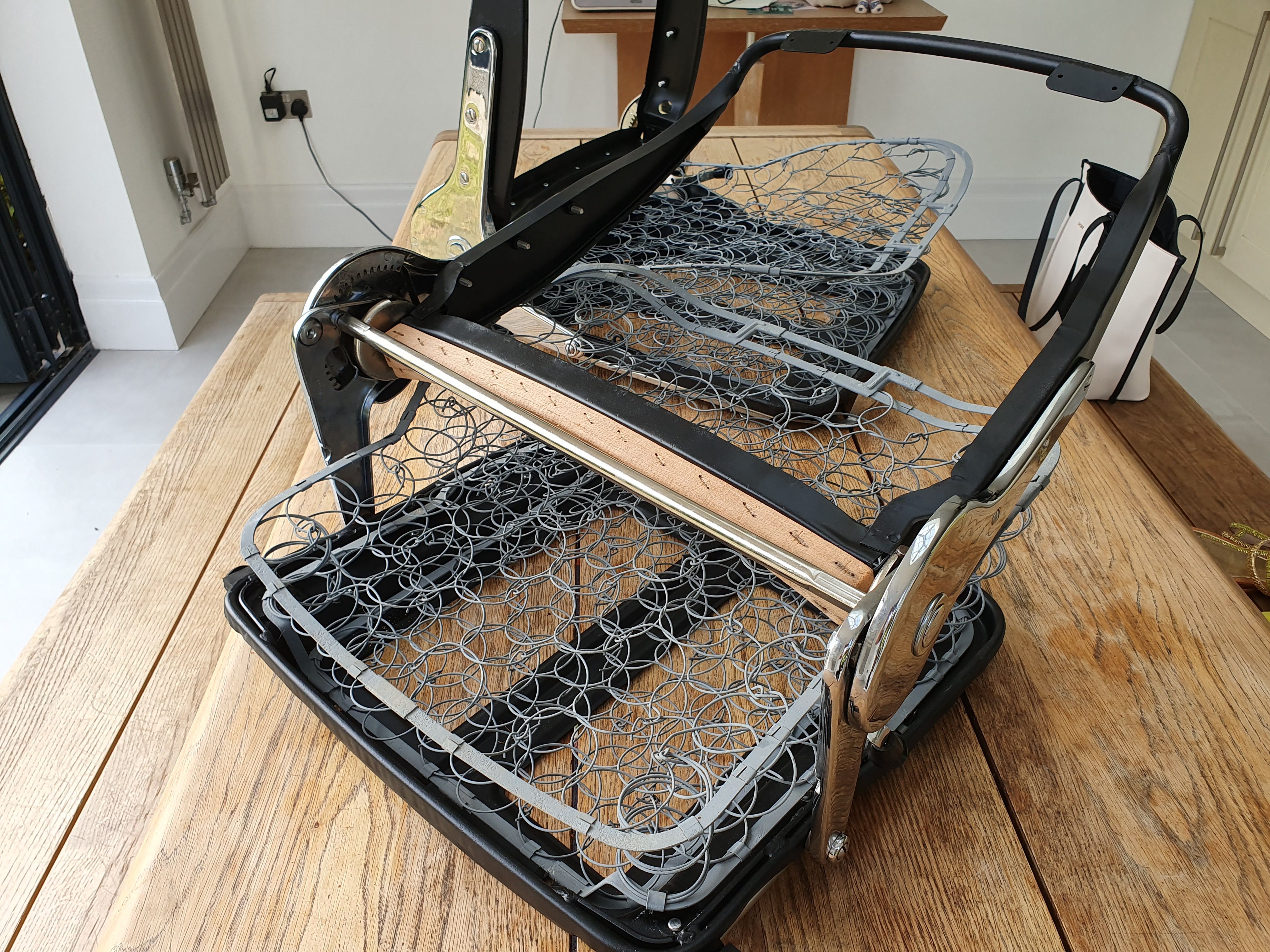

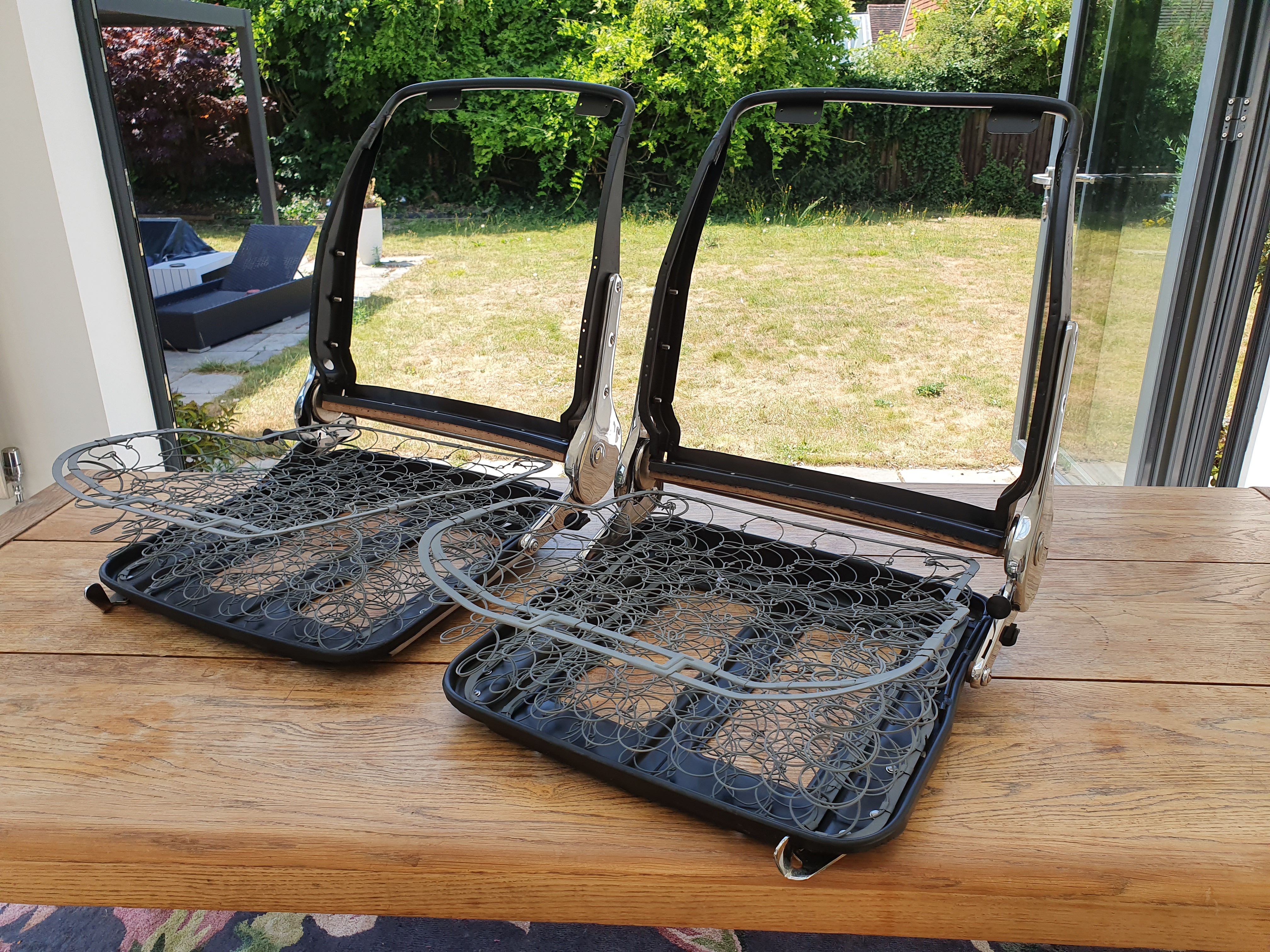

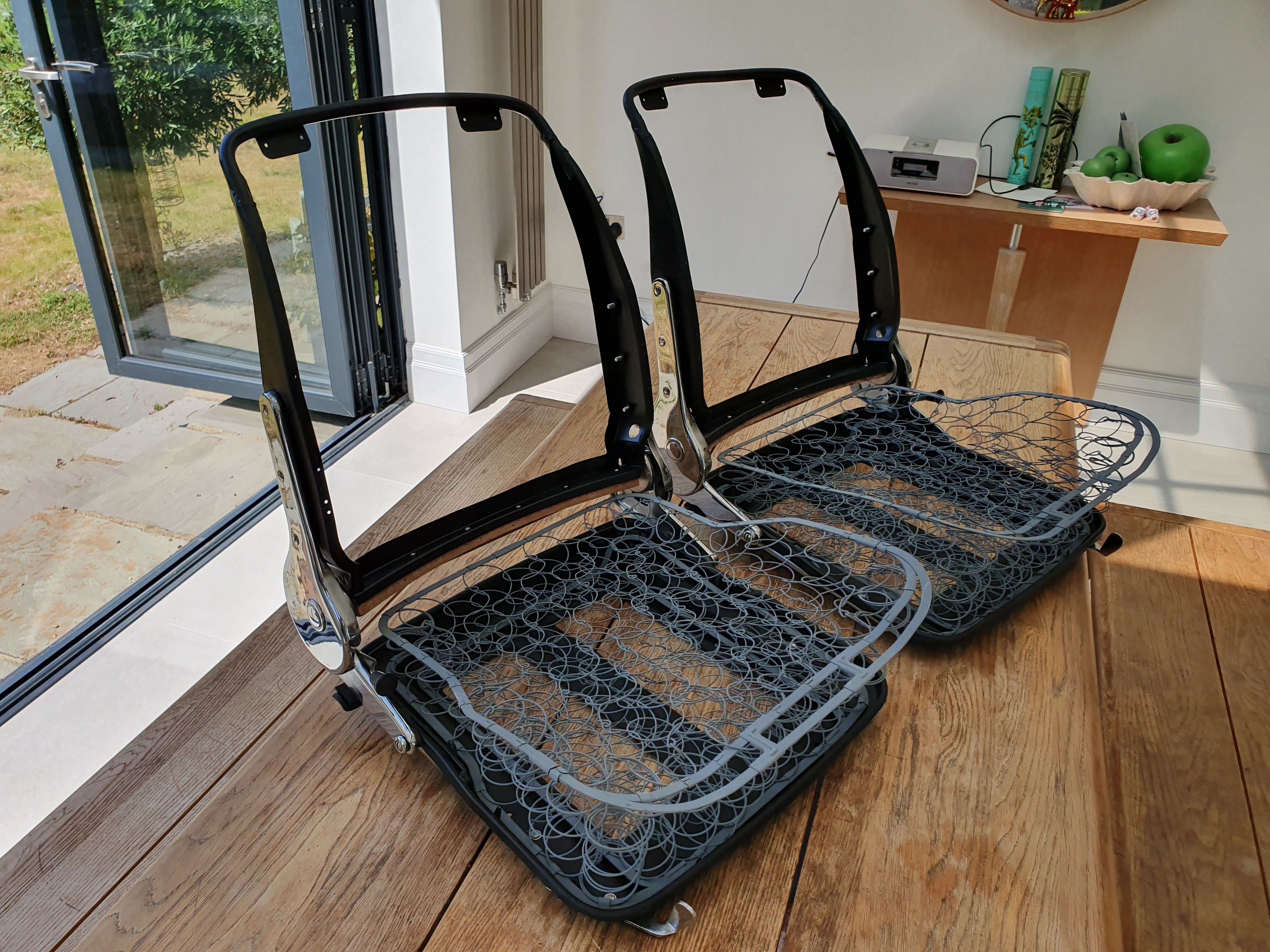

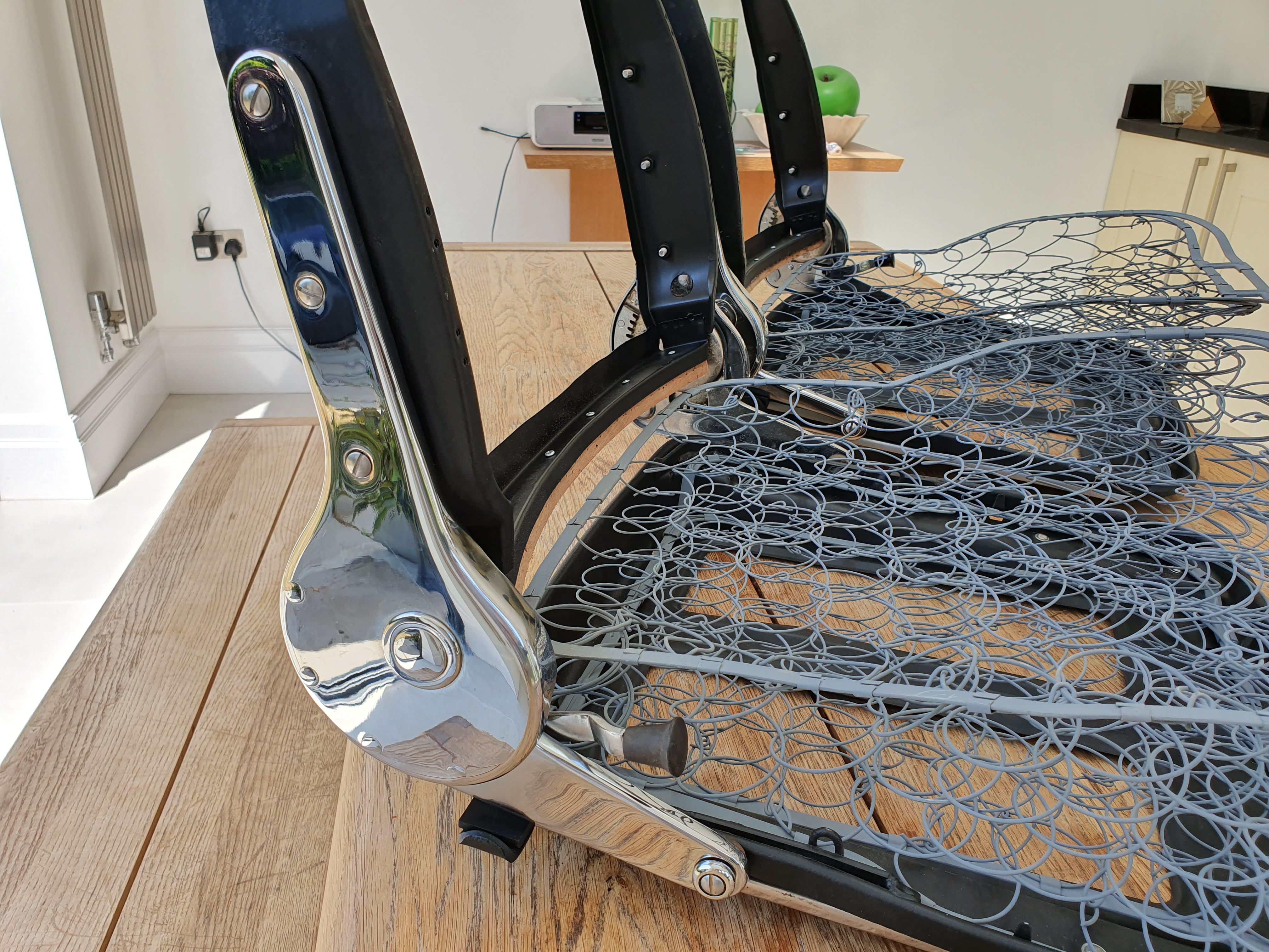

                      • As temperatures continued to rise here in the UK I turned my attention to prepping the seats ready for the trimmer, these are very complex but beautifully engineered pieces in their own right but very time consuming to restore back to factory fresh.
                        Here is what is involved:
                        Careful removal off all the original horse hair cushion pads (hopefully they can be re-used by the trimmer as they have that old Porsche smell).
                        Seat back hinges were completely dismantled and sent for chroming.
                        All seat rails (that are riveted to the basses) were removed and sent for satin chroming
                        New brass adjustment lever pivots were turned up on the lathe as the levers have to be removed for chroming
                        Removal of the wooden tack strips and many hours carefully removing all the rusted tacks and staples
                        All cracks and rips in the steel seat bases and uprights were welded up, blasted and painted satin black.
                        Seat rails re-riveted back on to the bases after fitting the levers with new pivots.
                        So far so good but re assembling the hinges is a real pain, requiring the fabrication of a special spring compressing tool and the creation of a padded holding fixture to hold everything in place without scratching the new chrome.
                        Here are a pair ready for trimming.
                        Hopefully the next time you see these seats they will be covered in nice new tan vinyl.
                        Thanks for stopping by.
                        Regards
                        Drew
                          Seat frames look amazing Drew. Very impressed with how the hinges and seat tracks where replated so nicely. Those rivets make it very tricky as you well know. Keep up the great progress.
