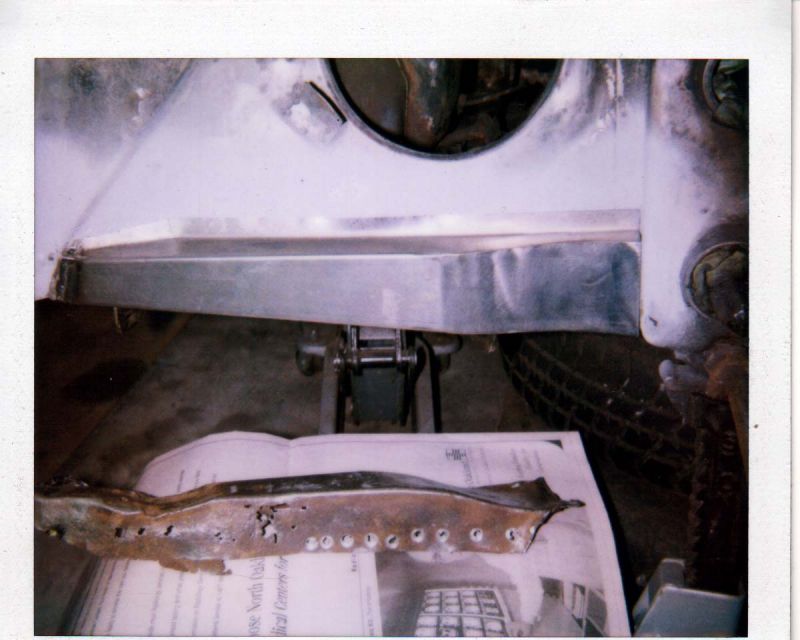

    • Just had to throw this pic in. I had rust on the inner metal also. Patch piece had a familiar shape:
      My repro part from Stoddard(T6fit pretty well, but this was 15 years ago:

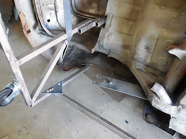

            • OK back at it after over a month off ...decided to go back and finish of the longitudinal now I have the front sections repaired. (I have also cut the rest of the floor out so another reason to get some rigidity back in the car asap.
              Spent time reacquainting myself of where I had left off. Setting the inner rocker up and the jack spur in about the right position, (it will need to move). Will test fit the outer rocker tomorrow so I can verify the height of the jack spurt and then do some tack welding to make sure it's all true still. Closing this all up is a major step for me and makes me a little apprehensive but excited too !

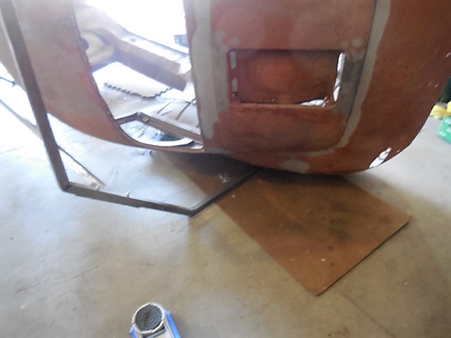

                • Sometimes it ain't worth getting up ! So there I was standing on one of the rails my frame with the car on its side to reach an "awkward spot"; and frame suddenly collapsed. No one to blame but my self as I made it . The problem was that I ground the weld joints down too far and weakened them. The car came down to the floor on it side and wrapped the rear fender around the box tube with nice crease.
                  Got the frame upright and welded the cracks - frame is twisted but solid - the crease largely popped out but will need dressing to get it back where it should be. Nothing like adding to the work list !
                  Moral: check all the joints for failure cracks once in a while and don't grind down more than is essential - ain't no use being pretty if it's going to fail !

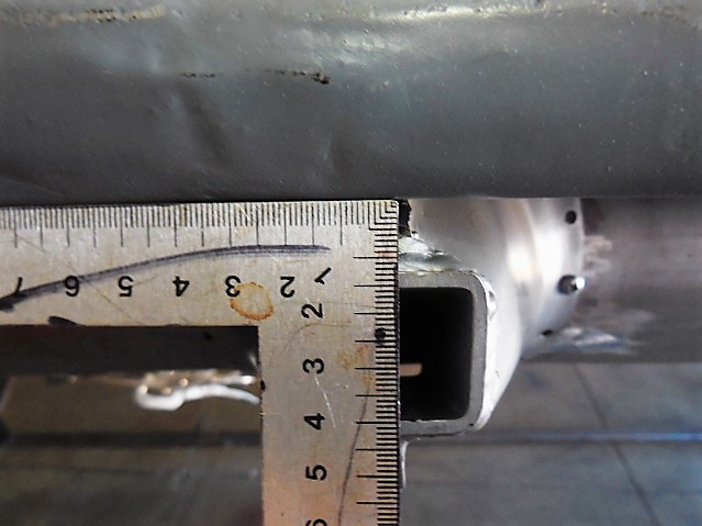

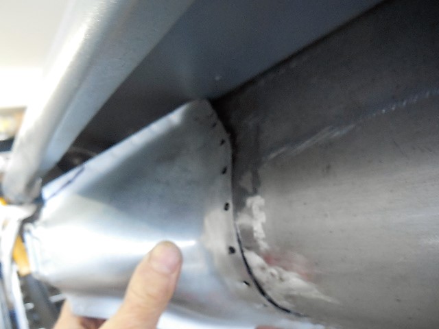

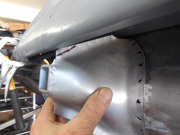

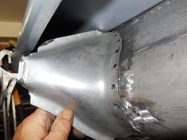

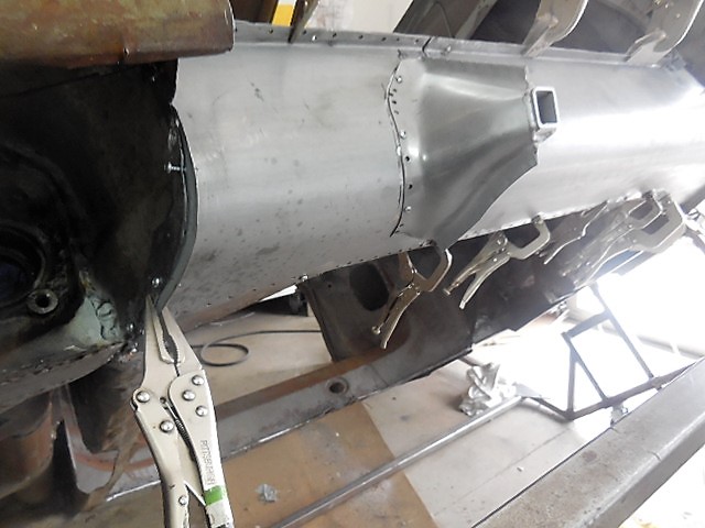

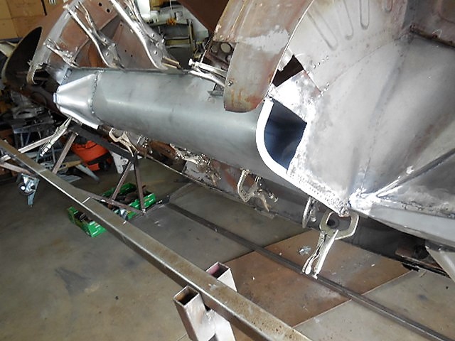

                  • So frame disasters apart, I managed to finally close up the longitudinal (apart for door well area) and started repositioning the jack spur, of course I needed to temporally clamp on the rocker to see how the spur was going to present.
                    To "high" at the top...
                    so had to remove some metal there.

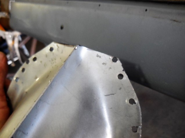

                    The upper weld seam on square end catching on the rocker
                    So trimmed that to fit...
                    Ended up with about 12-13 mm of gap - Roland in the book say 1/4" plus so I think I going with it as it is, the curve of the jack point is pretty snug against the longitudinal, so happy with that too.

                    • Oh man, that really sucks! Sorry that happened to you. I had one of my welds also crack. I was standing on it at the time.... So a good reason. Hang in there.
                      JP
                      • Well Steve atleast you are in one piece thats whats counts!
                        There is allways guys getting crushed under their cars while doing somekind of work
                        When I did my frame I think I might have overdone it .... You could hang a small truck on it ( maybe a BIG one ).....
                        The fender looks like it would be a easy one to pull out.
                        Thank you for being so honest and sharing your unfortune with us that might help others.
                        / JOP
                        • Bummer Steve. Hope the fender repair is not to hard to do. Rest is looking good.
                          • That really sucks. Personally, I don't grind my rotisserie welds (maybe a tiny bit) and brace all of them for this reason. Look at it this way, positive, just more to practice on.
                            • Sorry to see that cage fail on you there Steve. Your post had me double checking that stand I just built. Glad you weren't hurt and the car not too banged up in the process. Keep up the great progress!
                              • Steve,
                                I bet that frightened you, as said above the warning is now clear to others and so important for every one to know. It could have been far worse if part of you were under it. Like the work you are doing and the effort required to put all info on the forum.
                                Pleased the crease is almost out.
