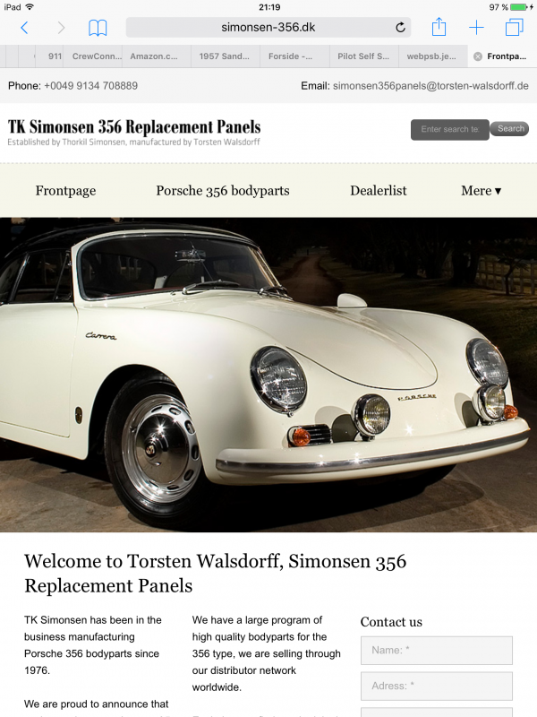

    • Already talking to them..there is '0' stock it seems in US for a A '57 , Zims who are their US distributor, were apparently unaware they were back in production - hopefully an order can be made soon!

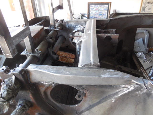

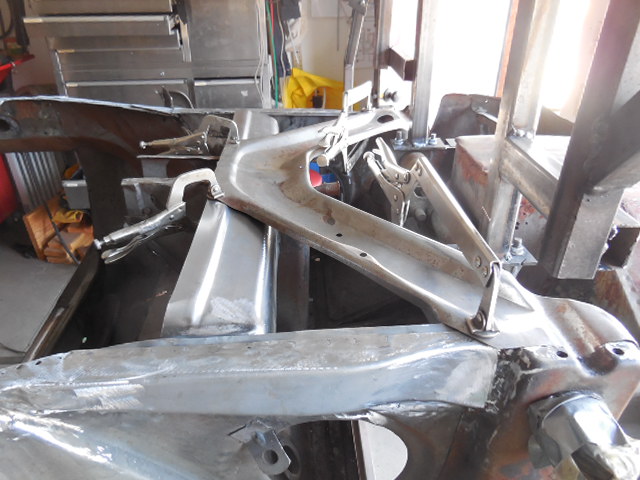

                  • OK tied up the front areas ....added the curved side rails, despite the "new" funky design from Restoration Design, with some cutting and hammering they seemed to meld in.
                    and placed the V piece in position- it will need some massage but fits pretty well.
                    Where the V piece meets the floor support that area underneath will be almost inaccessible so will paint and seal that prior to welding, although it will burn for sure How did they seal that in the original days ? (or didn't hence the rot there !)

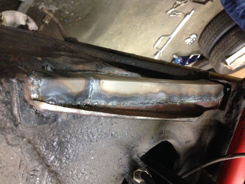

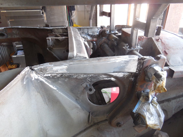

                    • How did the inner piece of the axle reinforcement look? I just welded in that inner piece on Friday.
                      [email protected]
                      • Opps confused me there for second ! Your pic was upside down .... I had to scarf in all new metal - came a pair (inner and outer )see pages 15/16 ish
                        Thanks for all the support.
                        Steve
                        • Sorry not sure why it loaded upside down, maybe Justin can rotate it for us.
                          Very rarely is just one layer of sheetmetal rusty
                          [email protected]
                          • I wouldn't bother to rotate the pic. It's in the same orientation as ukinu's. Trevor and I debated over whether or not to buy a replacement part. I've yet to see a side rail that actually fits, so we'll be making our own piece to fit in to the remaining good original metal.
                            • Yes Jack you are right - it was the angle of the picture rather than the orientation that got me muddled. I agree that the inside piece is almost a straight forward angle bend and easy to make to fit a specific situation; never having done this before I went the "easy route", and brought the piece, in hindsight one could argue that was a mistake as it actually involved more work ! I had cut and refit several times, including making a thin 'pie' slice as I over cut. The use of a card template from the start would have saved much time.
                              Steve
                              Steve
                              • Steve, just to be clear, we are making our own inner AND outer piece. Note in Trevor's pic the remaining part of the outer "curved" rail piece that we will attach to.
                                Nice work, BTW.
