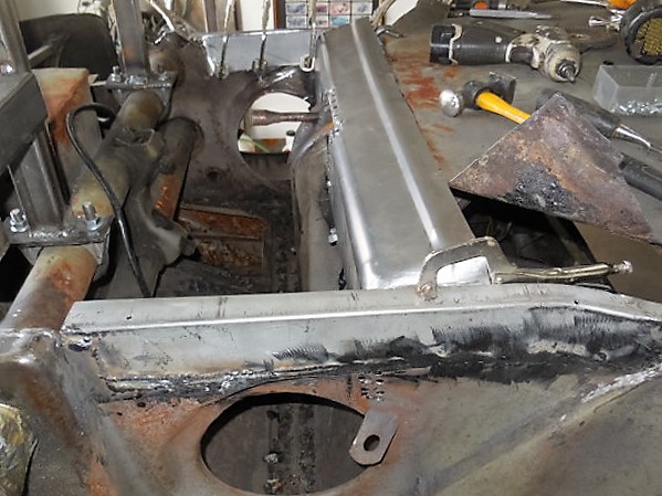

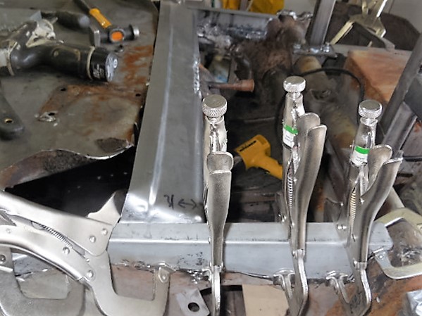

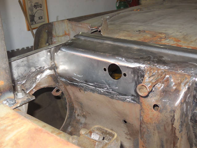

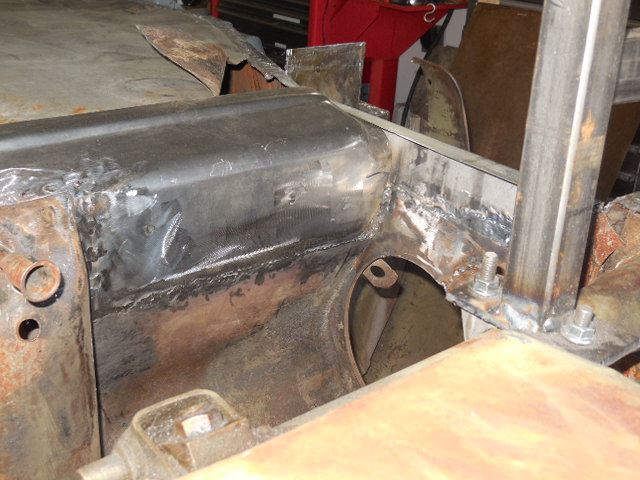

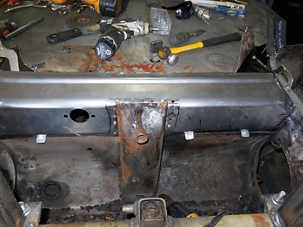

    Happy holidays etc... so slow work too. Anyway made good progress on the front section. Ready to start welding this all up, but decided to sleep on it first as much as I want to throw some welds down Getting everything to align for the butt weld and have good gap was a pain, much off and on again.

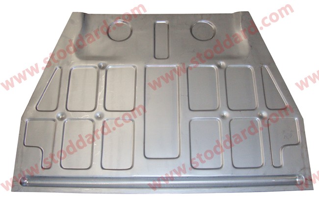

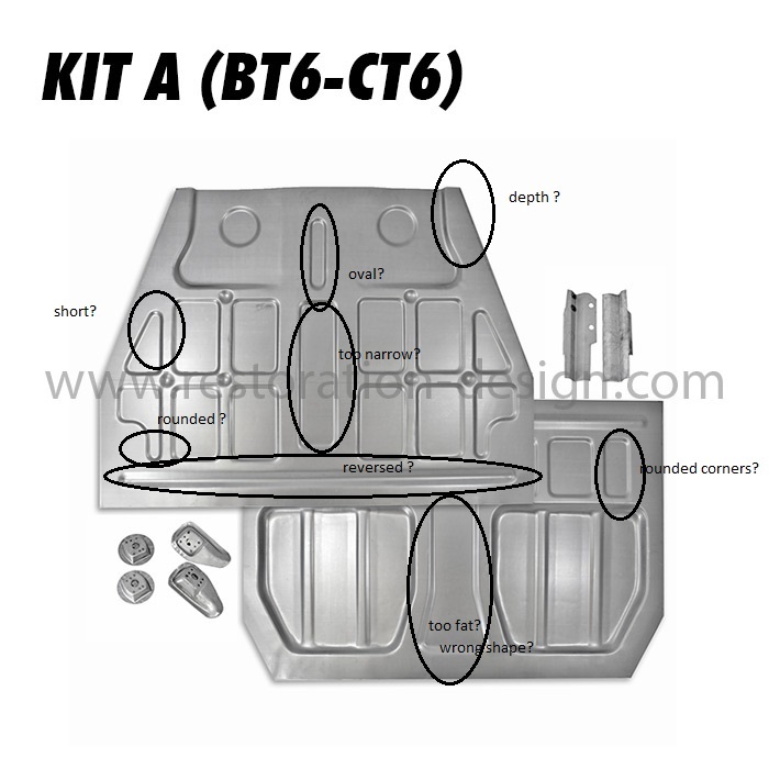

                OK Mark - heading you advice looked at RD and Stoddard - pics below, can't see any real difference but I guess the devil is in the details close up ? Maybe the Stoddard has a more pronounced step at the front that would reflect the front pedal bulkhead replacement "corner shape" better ? and the rear support tube where it overlaps appears reversed (if that makes sense...)
                Stoddard
                RD
                Thanks for all the support.
                Steve
                • #98
                  Stoddard
                  RD
                  Look at the rear half. I also see differences in the two front halves you posted. Details details. Look closely my friend
                  • #99
                    OK Mark I will play !! Reminds me of those kids drawings, "spot the difference". Did I miss any ?
                    Steve

                      • Originally posted by ukinusa" post=31249
                        Good eye. I am no expert. That would be Justin. But I like a good game. I think the main difference is you have a pan shown in your pics for B or C cars vs the A pan you need. If I'm not mistaken, I think there are even differences between "early" A and "late" A. I have an early A. I think the Simonson pans are spot on. If you can get those they are the probably the best, but I'm sure they are more $. If I recall, I think the most noticeable differences were the rear tunnel rib and the depression at the toe well were off.
                        • Details?
                          It's good that what was once sold as a "one size fits all" floor set is now identified as a T-6 B/C floor with the later mounts (un-circled in the screen shots as a 'detail').
                          The later trans shifting demanded a rounded-down rear entrance whereas the early shifting allowed a straight rear bulkhead mating to the floor, other than the pitch from outer longitudinals to the lower tunnel flanges. That alone means more work for installation in an A.
                          If one does not care about the dreaded 'originality' of strengthening depressions, it's all the same forward from the rear bulkhead. Yes, there is a pre-A floor and an A floor, but those differences are more subtle than from A to B, continuing into a few details of a T-6, mainly for the seat 'pods.'
                          I still contend that if one is doing all this work, the parts used should reflect the intent of the definition of "restoration" .....making the 356 as close to it was when made by Porsche, at least in appearance. That includes the floor and all things underneath. It counts in the ultimate value of the car more than, way more than, the slight cost differences of various parts.

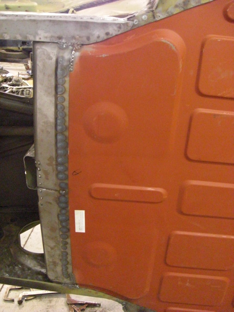

                            • OK back on task while I hunt for floor panels.
                              Got the front toe board and inner side rails welded on and started to smooth down.
                              Got my Harbor Freight spot welder (damm that's heavy!) and will try to get the outer ribs attached and will see if the pedal hole is anywhere close !
