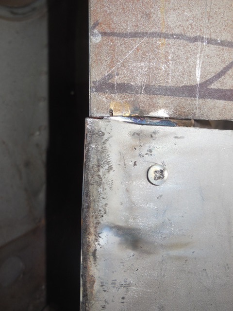

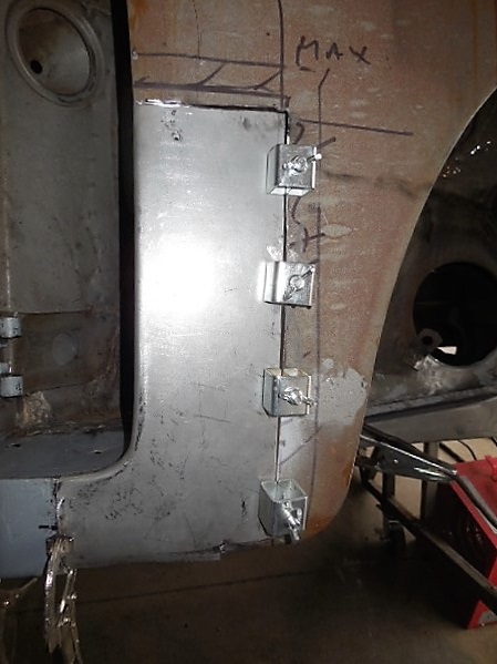

                • OK - this maybe be obvious but thought I would post it anyway ! I spent quite a bit of time setting the gap for the door vs the patch panel:
                  and we talked previously about how to create the pinch on the inner closing panel, I opted for gentle heat and hammer and dolly. It took a while but I got a nice tight pinch and not too much deformation. The biggest effect was the metal being "squeezed" out significantly, as I formed the crease...

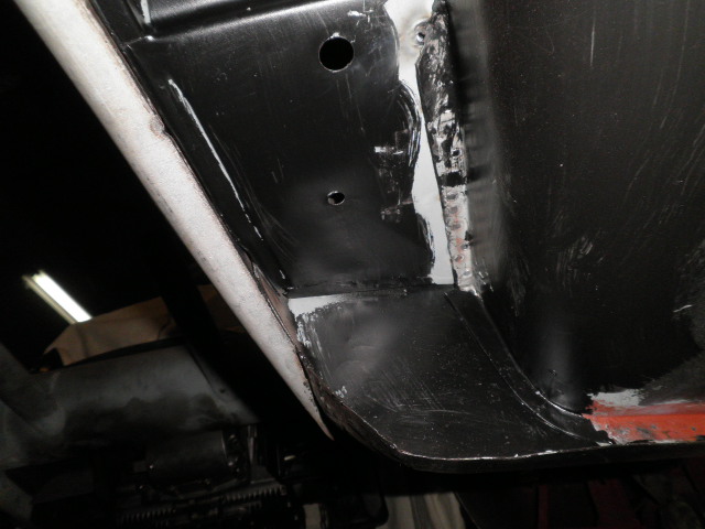

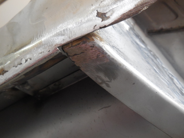

                  • After resetting the curve back into the patch panel and resetting it in position, I started to tack in the small patches on the rocker and welding the patch in.
                    BUT - HELP PLEASE - how does the lower rocker panel "gutter" (for want of better name), that folds up under the rocker, finish when it gets to the out curve of the inner wheel well finishing panel ?? (Hope that makes sense). Any pictures to help show me what to do ?
                    ....and yes I know the welding looks rough but I not going to clean up till I know I am not going to be changing something !
                    and shown from underneath ... the curve of the 'gutter' dives right into that front panel...
                    and no, that is not a 'step' in the rocker gutter, it's an optical illusion, I actually went back and felt it just to make sure. Weird.

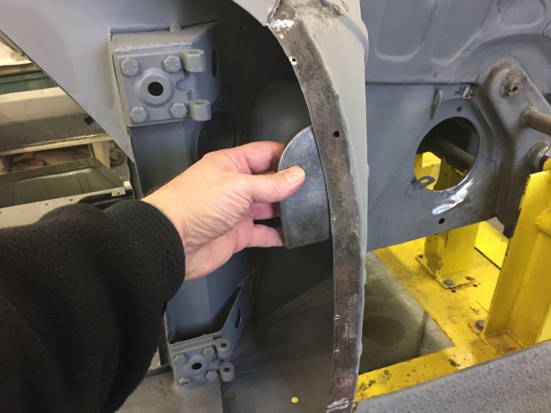

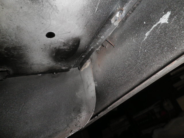

                        • Steve
                          Here are some shots I just took of a 63T6B(Foam Car) showing how I did it. Sample size of one. As you can see, the curl at the bottom tapers off near the splash shield on one side. The other looks likes it is still there. Not sure how the A was done - where are you Bruce? I would move the splash shield inboard to provide clearance.

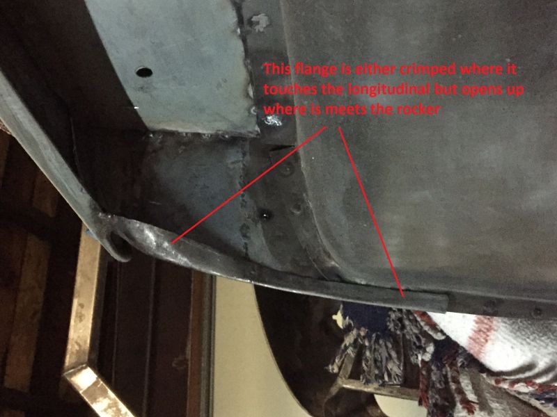

                          • Here's a pic of my "C" in that area. Not sure if the crimped flange is correct or not, but that's the way it was.

                              • Tom's pic shows it perfect.
