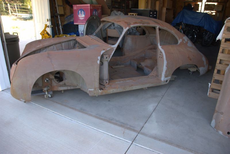

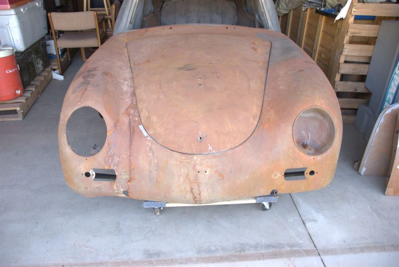

    Some background:

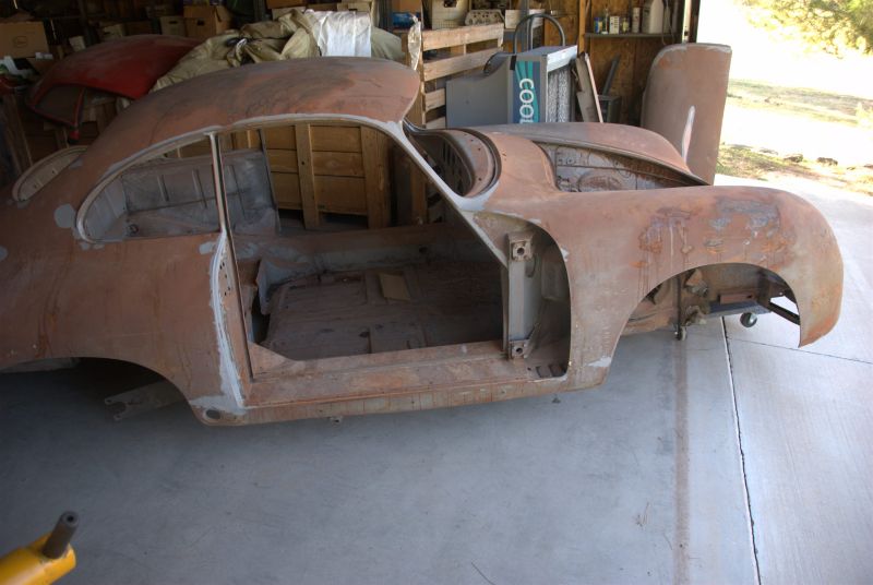

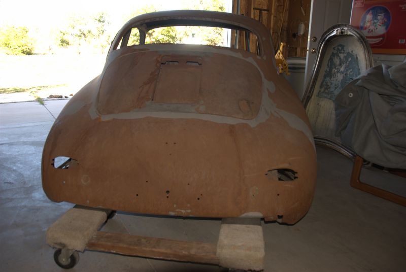

    Found in the desert of Utah ...Stored for over 25 years since being sand blasted and probably destined to be an outlaw. The center tunnel has been cut out, the gear shift 'cowl' under the back 'seats' cut off as well as the Y cable cover by the fuse block is missing. Overall in really great shape - rust holes scattered everywhere but still a great potential restoration. Pictures as found ...

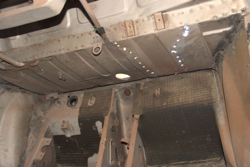

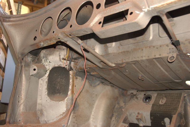

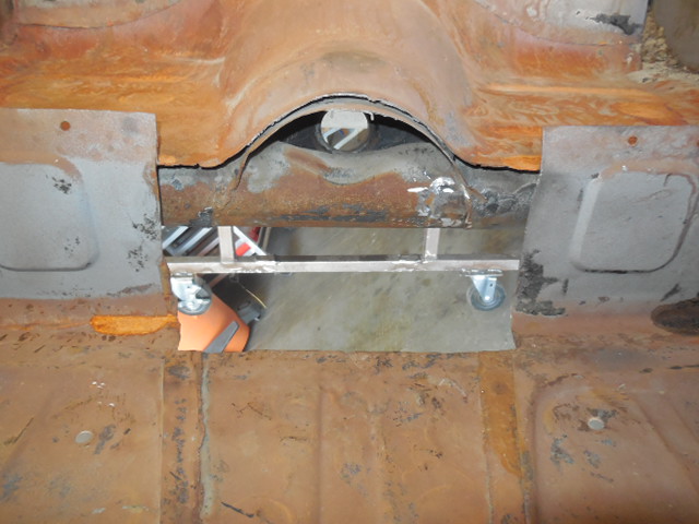

      Inside looks pretty fine too - apart from the butchered tunnel - well its so hardly butchered as its missing, and the gear linkage mount being removed. I have new tunnel from of the our vendors ... and I have fabricated a new mount...not pretty but unseen ...

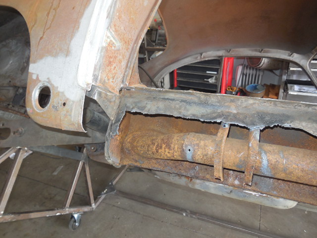

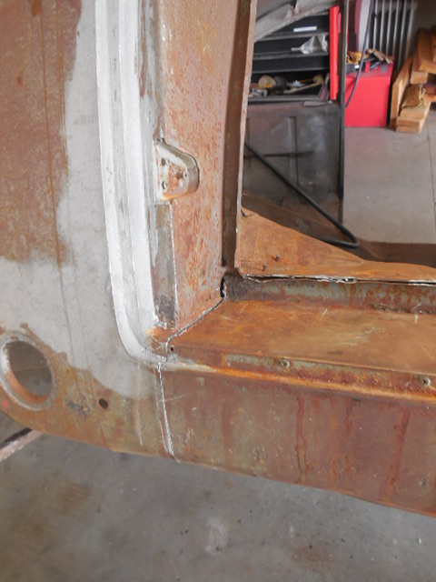

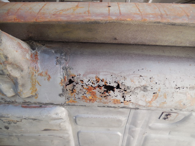

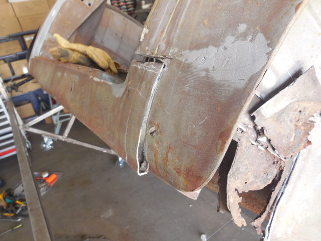

        The car is now mounted on Hexagonal cage - I would prefer a round one but hey ...and I have started to dig in.. where to start. the passenger side just happened to "up" when I got in the garage so decided the right longitudinal was a good a place to start...

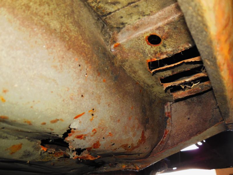

        Strange vents chiseled into the door well for ventilation - weird ! (on both sides too)

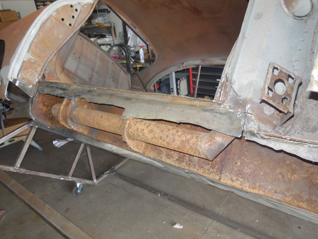

            Nervous about doing this so thanks to Justin for words of wisdom ...
            Bending the hinge support back - I REALLY hope it goes back to where it started !
            Air saw makes nice thin cut - no plasma cutter needed this time.

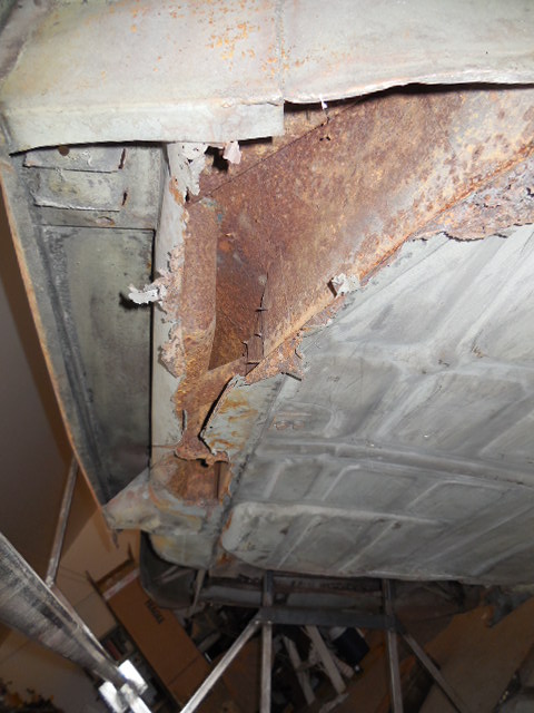

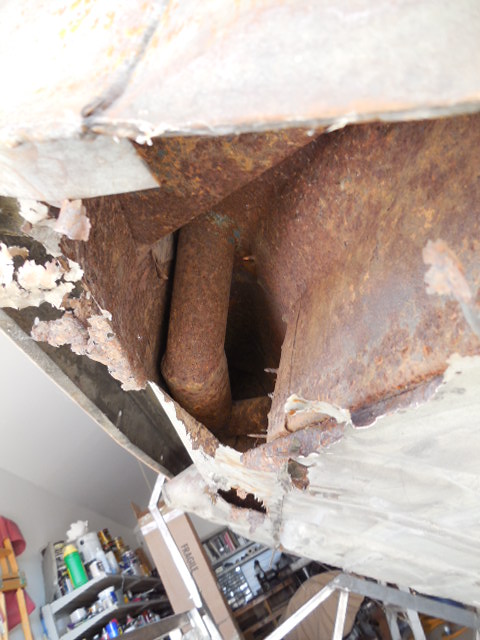

            Peeling back that front patch revealed all sorts of rot ...but all pretty much contained. The new cover will need to ordered soon before I go much further ...
            Jumping a couple of days; the panel is off, rust abounds but 95% sound and just pitting so all in all pretty solid so I am lucky - I think !

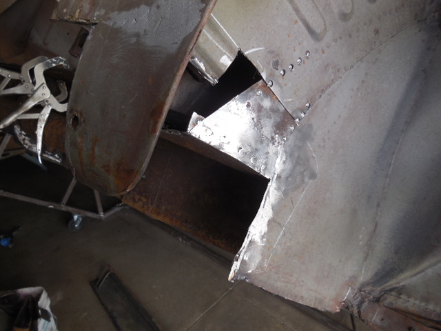

            Started with an air saw, switched to grinding wheel and then finally got the plasma cutter out - fast and dangerous in that you can do damage pretty dam quick eg: I nicked the heater pipe but an easy plug repair...
            Front patch panel removed to real more horror..

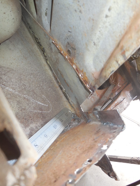

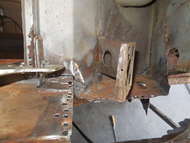

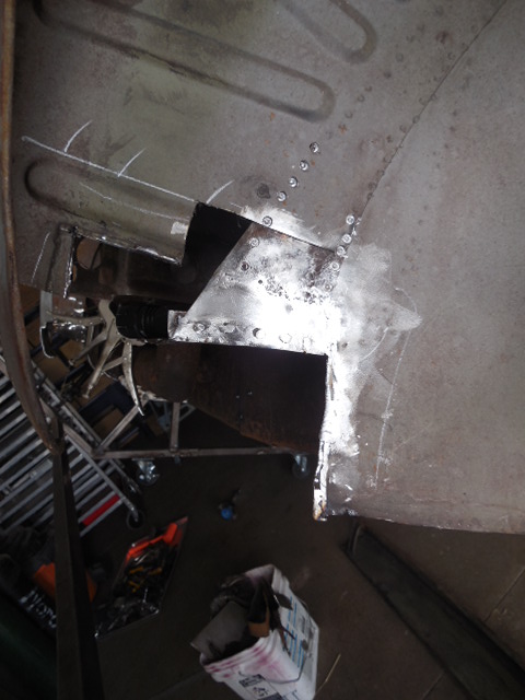

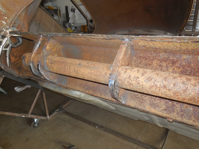

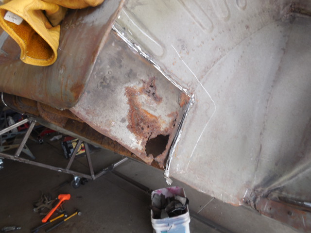

            The bottom of the tube supports were rotted so fabricated reinforcement /repairs. Not pretty again - relearning my welding skills.
            The front tray and wheel well got tackled as well today - repaired the tray lip and spliced in a new lower section of the wheel well that attaches to the shelf...hope I got it right...
            Thanks for all the support.
            Steve

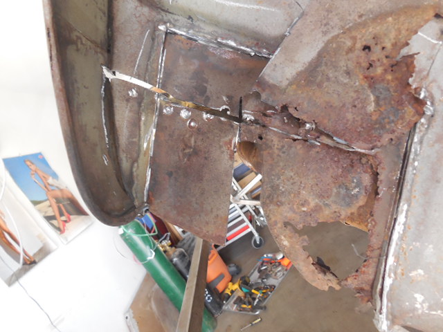

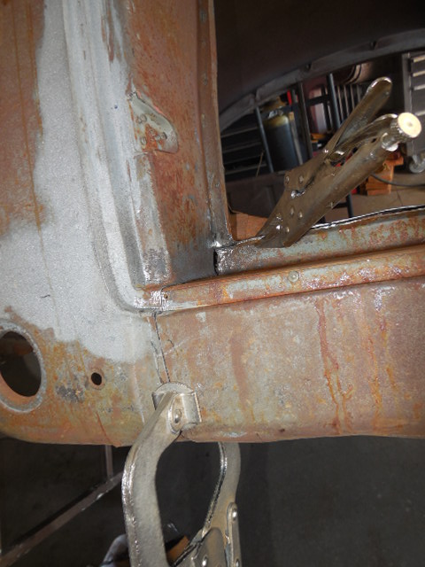

              Front door inner shelf / wheel well - a lot of simple rot - so lots of insert repairs to rebuild strength and integrity ... welding getting better
ID:	67045Click image for larger version

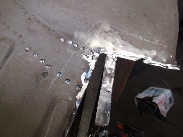

              Had to cut the wheel well panel up a bit more to get me room to weld the patch in, new lower "part panel" will cover this repair.

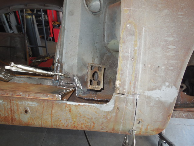

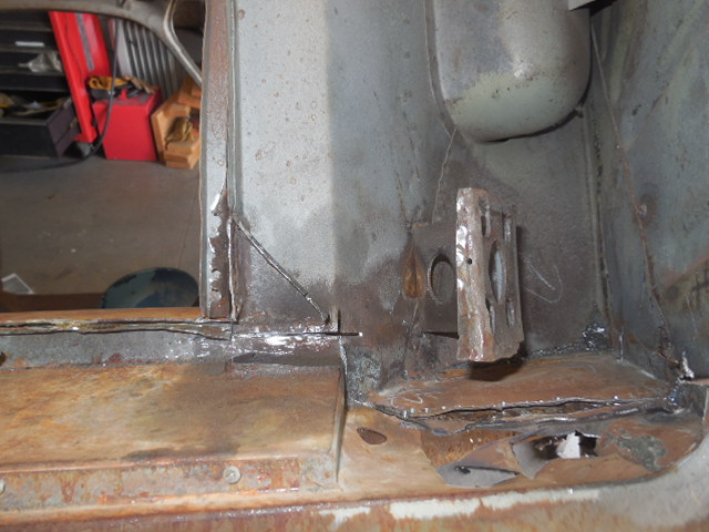

                    Sorry if some of the pictures have been out of sequence - been playing catch up. Now almost update.
                    So put the rocker panel back up after removing the front shelf. Have to fabricate that today.
